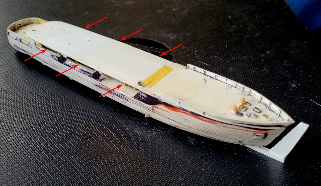

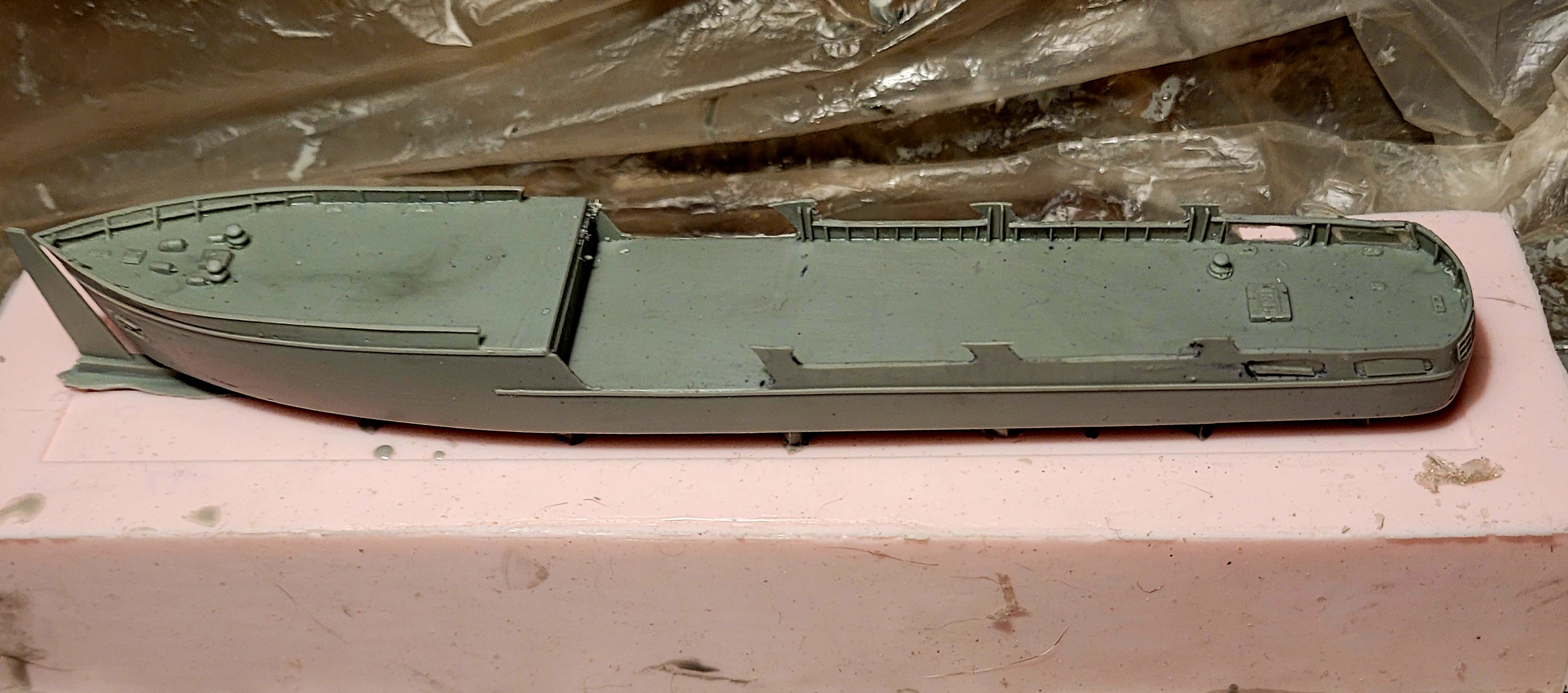

Chris aren't there going to be some major problems with the mold in these areas? Seems like a fubar undercut problem to me.
Ah! My sharp-eyed friend Paul sees a possible dilemma, eh? Thank you!
Yessir, that would be indeed problematic if the flight deck was permanently attached. I left it attached with Tamiya tape to protect the hull details while I was building the mold framework on the bottom.
The flight deck is, in truth a separate part and will be finished and molded later on. See all the dots? Markings for unfinished helicopter tie-downs.
Better to ask a silly question than to suffer a terrible mistake. It looked and I kind of thought that was what you had in mind (the tape hinted) but best to ask and it not be needed.

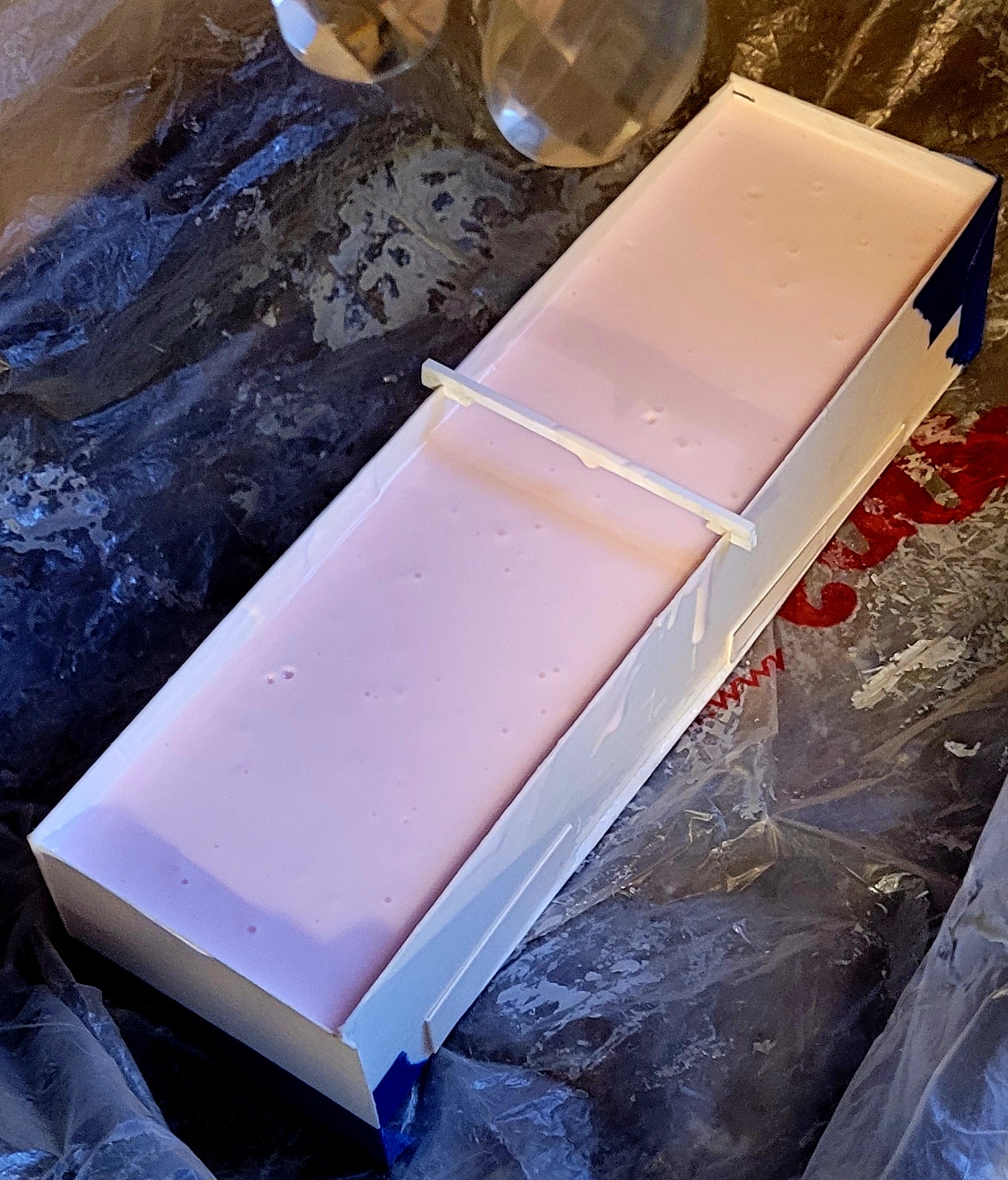

The game is afoot! De-mold the main hull happens 10 hours from now. Pressure is holding.
I mixed 482 grams of Moldmax 20, but the 467 gram mold box held all of it.
The math was correct.
Remembering not to rush the chemicals!
The Master sustained minor damage to her railings coming out of the thick, very stout, mold at 0516 today.
I could have done a better job blanking the openings in the after railing. Relieving the mold should address this concern.
As always, the first 56 ml. casting will tell the tale later on today.
Everything from here on out is easier and smaller!

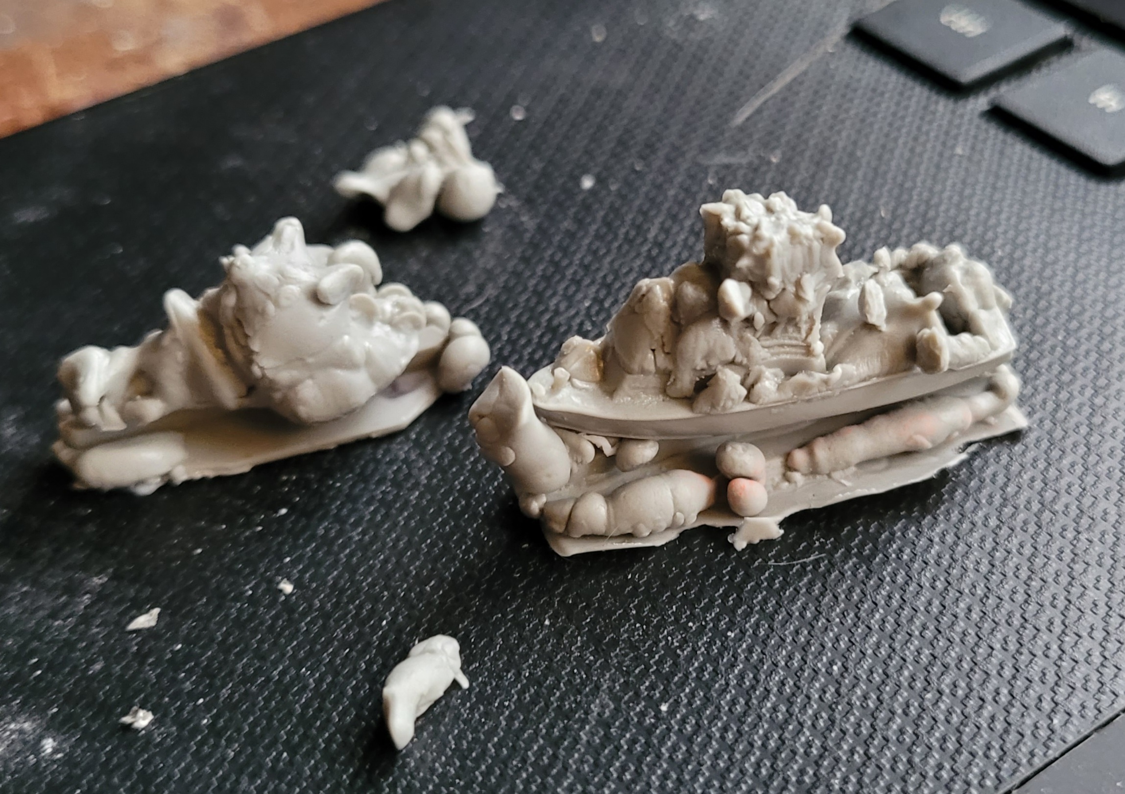

First casting of the 1/350 Reliance WMEC Hull. Only a couple teeny flaws on the exterior. This one sells! The bubbles on the bottom of the waterline hull make no difference, you have to cut off the mold frame and sand it flat anyway.
I could not be more pleased with how this huge (for me) mold cast!
Thanks again for looking in!

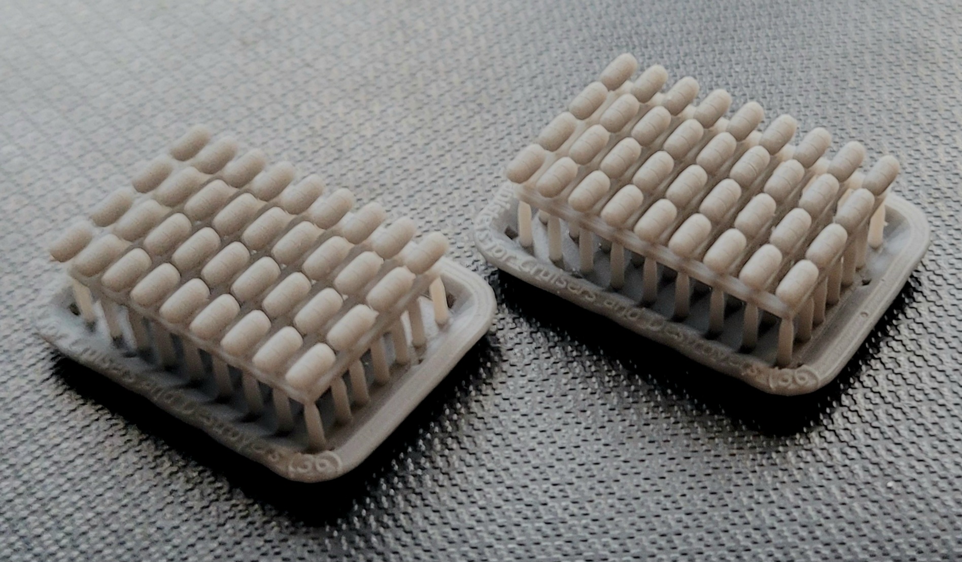

1/350 Life raft canisters came today from Model Monkey LLC in North Carolina.
He makes lots cool of high quality 3D printed parts for models ships of varying scales. These are suitable for US Navy Cruisers, Destroyers and (wait for it!) Coast Guard cutters!
I used the Model Monkeys for the carronaides my Constitution build. Fantastic prints, and only 4 days from order placed to my door! Those guys don't monkey around.

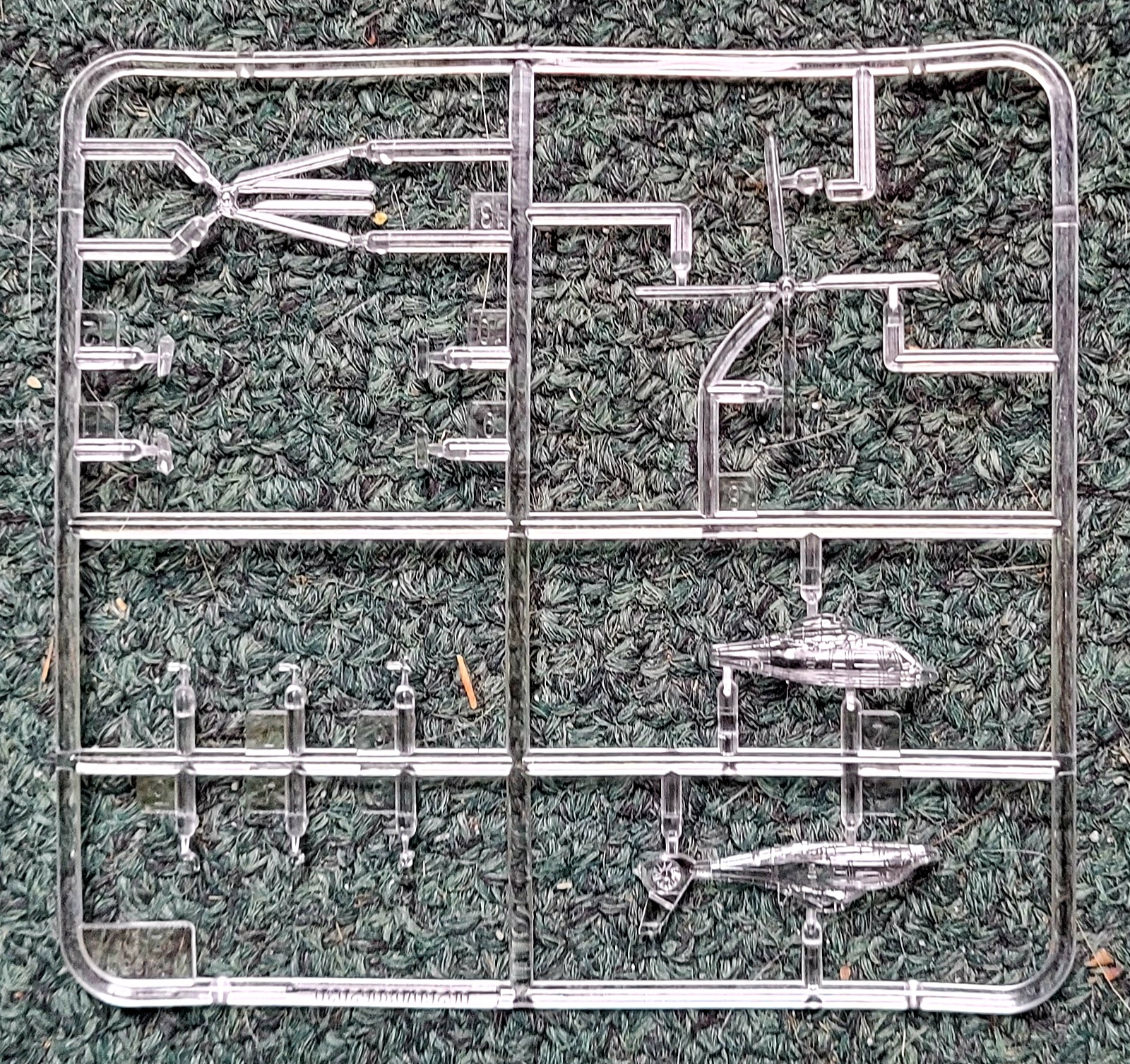

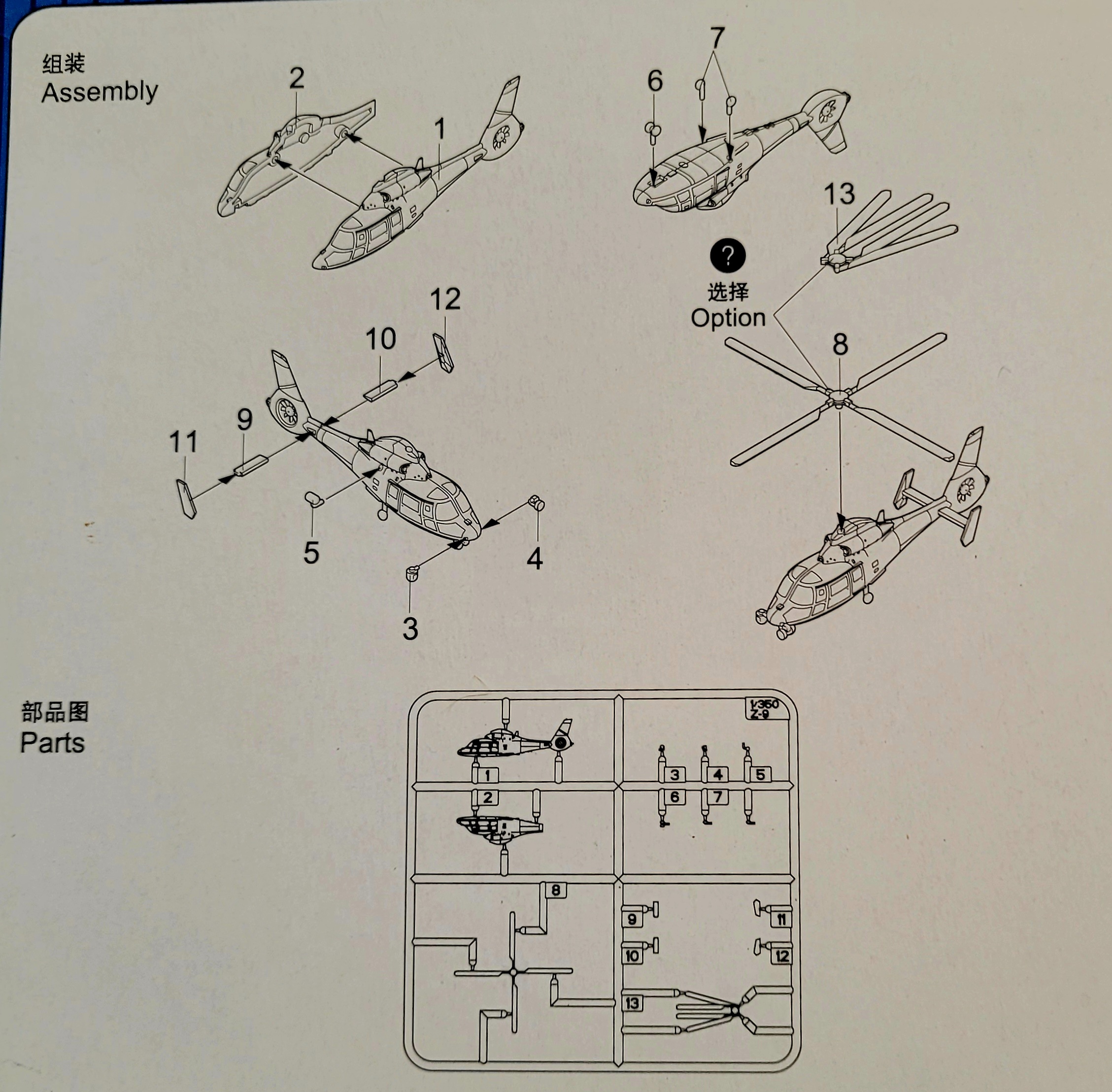

The 1/350 HH-65C Dolphin helicopter that I plan to include is a Trumpeter kit. The same Dolphin kit comes in the TLAR "Three Mile Limit" USCG Pursuit kit. The only thing fast enough to catch the 90-footer!
Chinese decal markings are included in the Trumpeter model.
