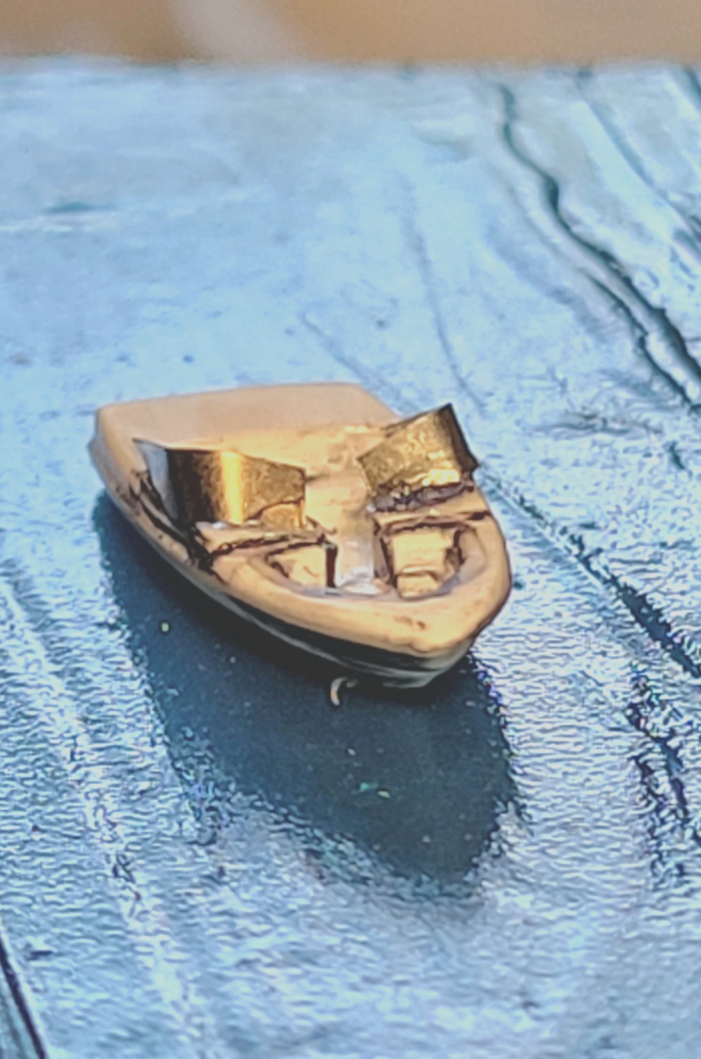

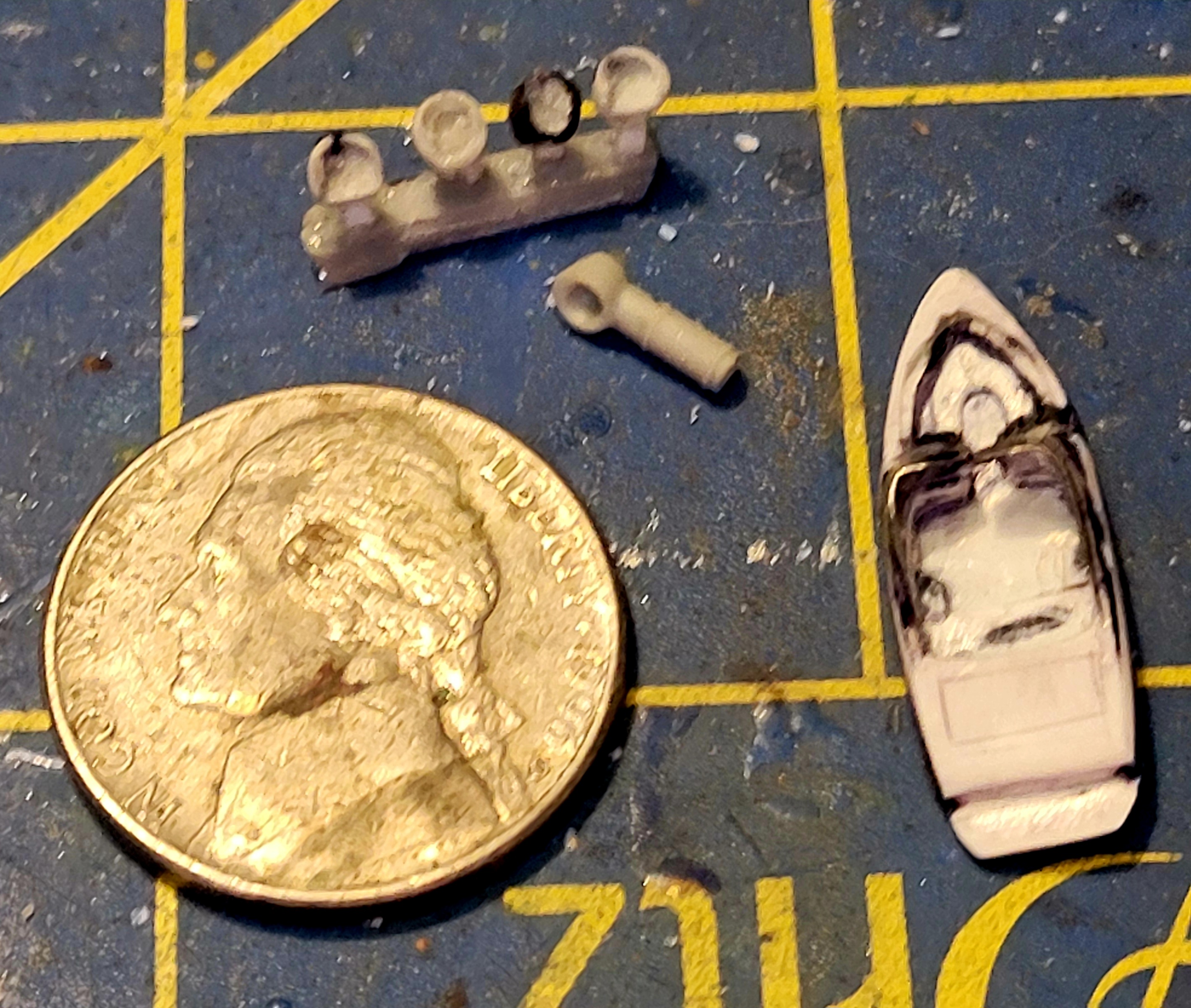

Now, since almost no ship model request goes unanswered, Mr. Brandon Lowe wanted a 1/350 model of his lake/river boat. Brandon owns a 2006 Caravelle Interceptor 232. And a speedy, loud, sexy thing she is too!
Brandon started this website for Caravelle boat owners http://www.caravellefans.com/
She's too broad in the beam at .312"
.285" is accurate.
She measures .783 overall, less the swim platform. On the money!

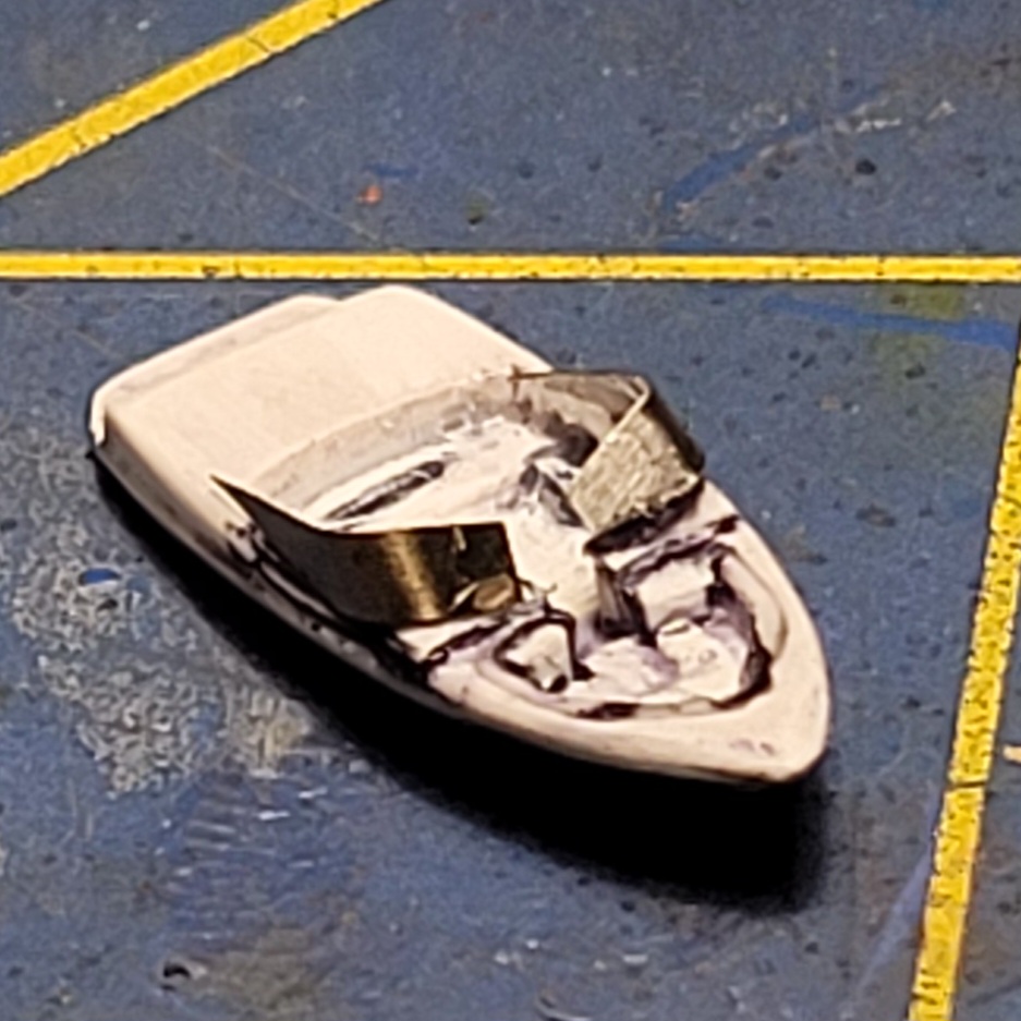

The bow rider could be just a little oversized. Hmm. Curved metal windscreens will need a little shaping after they are cast.
I need to add the folding panel on the windscreen before I mold Brandon's boat. I made the seats out of oversized deck ventilators, and I made 4 per mold incase any get lost during construction. I plan a couple of other 1/350 pleasure boats to round out a set that is more marketable.
I want to make a Midnight Express 60' Pied-a Mer boat they call "The Beast" in the same scale!
The sexiest, most muscular beotch in the water! I mean, if such things impress you.

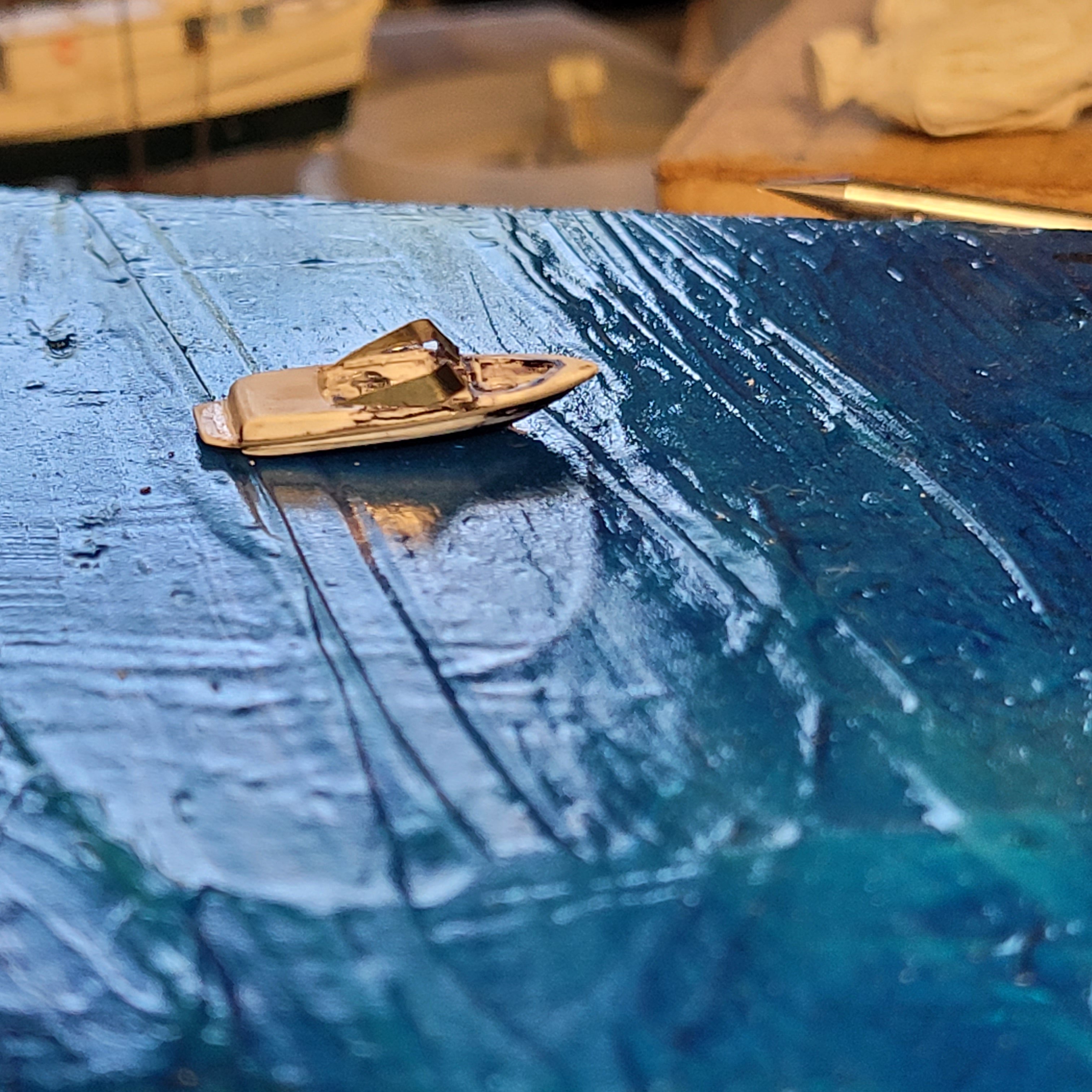

Brandon's Interceptor 232 is a "warm up". I tried a new technique that worked pretty well.

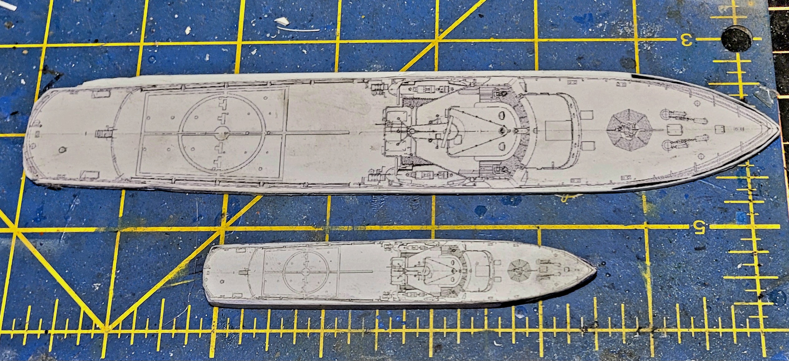

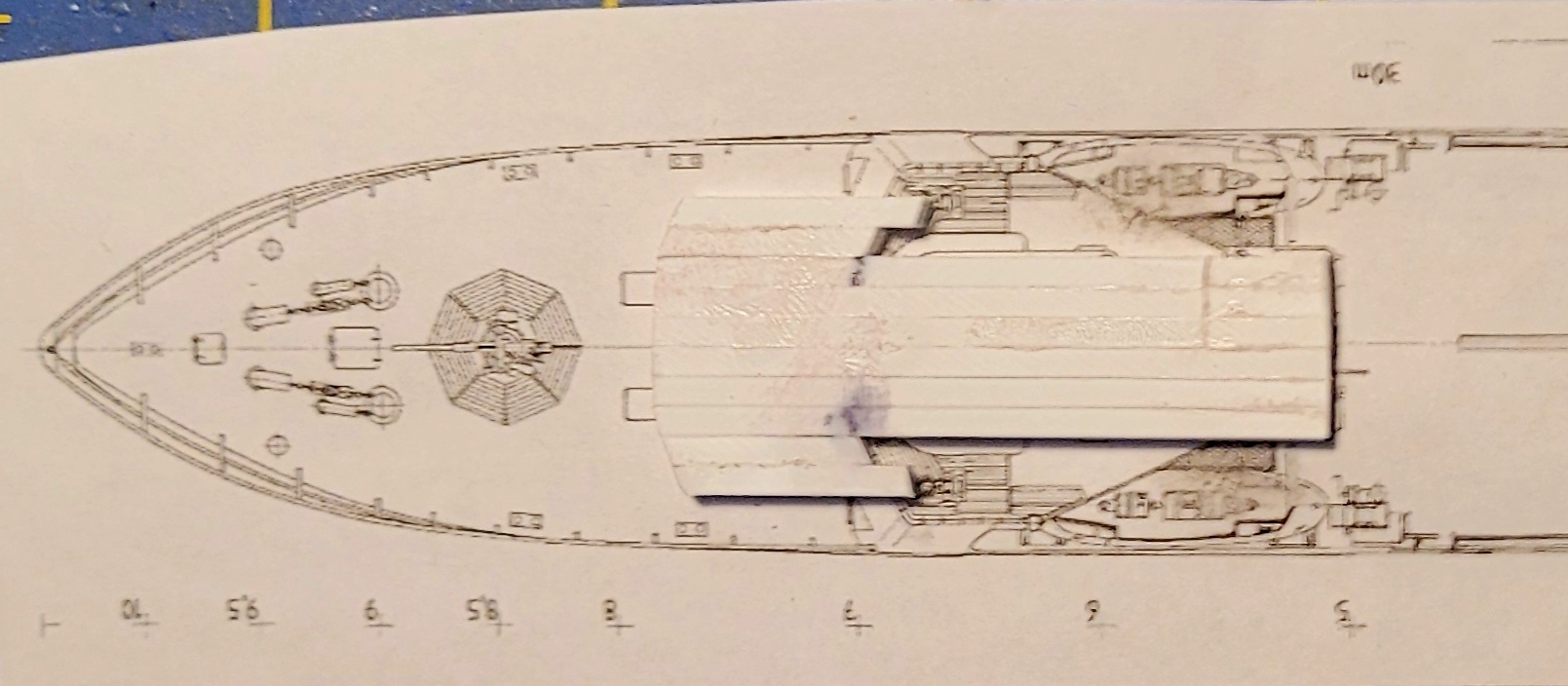

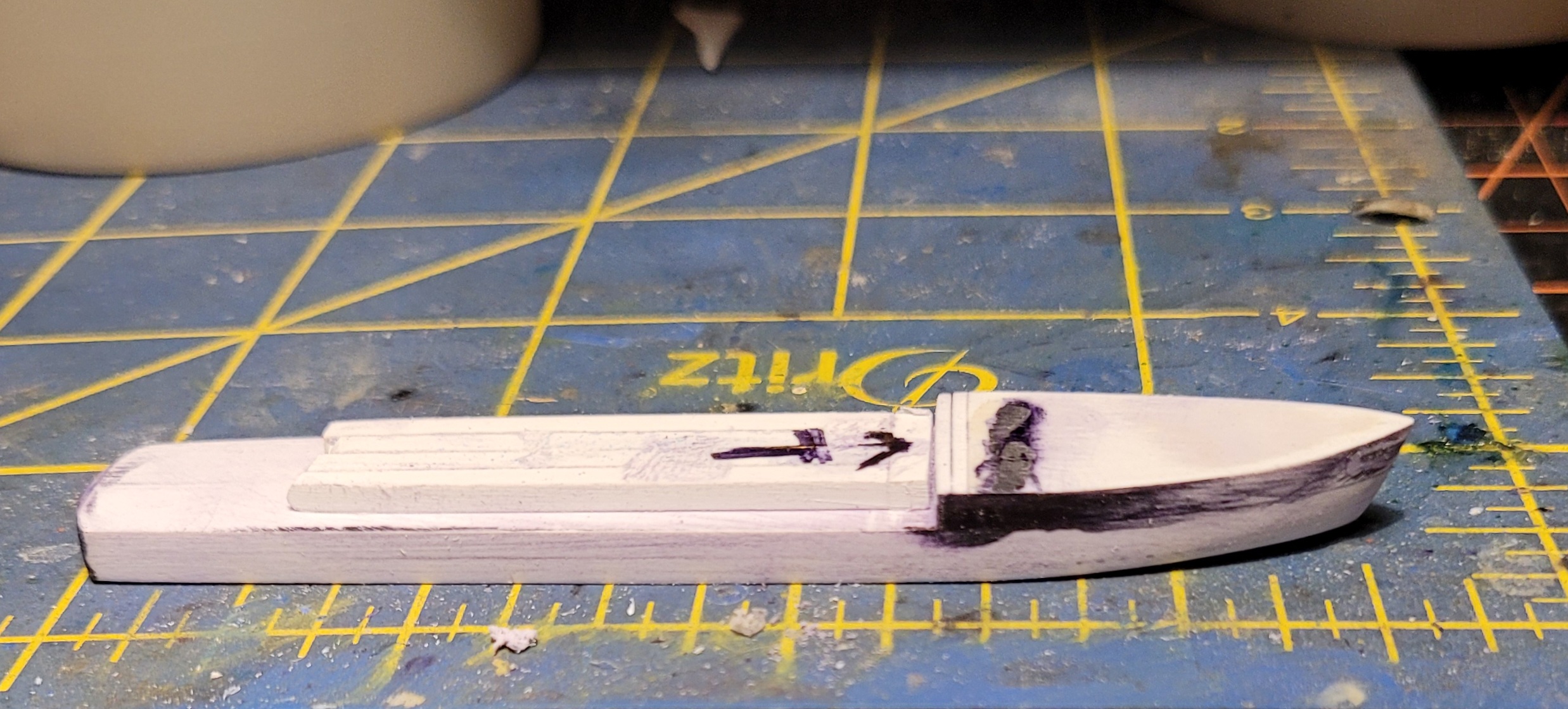

Properly scaled profile drawings make the shape and sanding much more precise. I apply the plans to the Master and shape & sand from there.

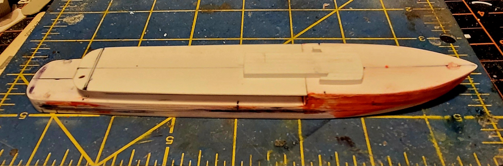

The 1/700 Cutter progresses much more quickly than her bigger sister. I'm still laminating .040 styrene sheets, one at a time and sanding the new layer to the proper shape on the 1/350 version. Six .040 layers will make up the basic waterline hull. My 100 grit "wrecker" sanding sticks are getting the work-out of their lives!
Thanks, 'Pup for looking in!!

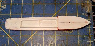

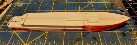

Shaping the bow of the 1/350 WMEC requires that it be solid. Pouring/sanding/refilling/sanding C/A glue in bow seemed like the best way to make this happen. You are looking at the bottom of the waterline hull.

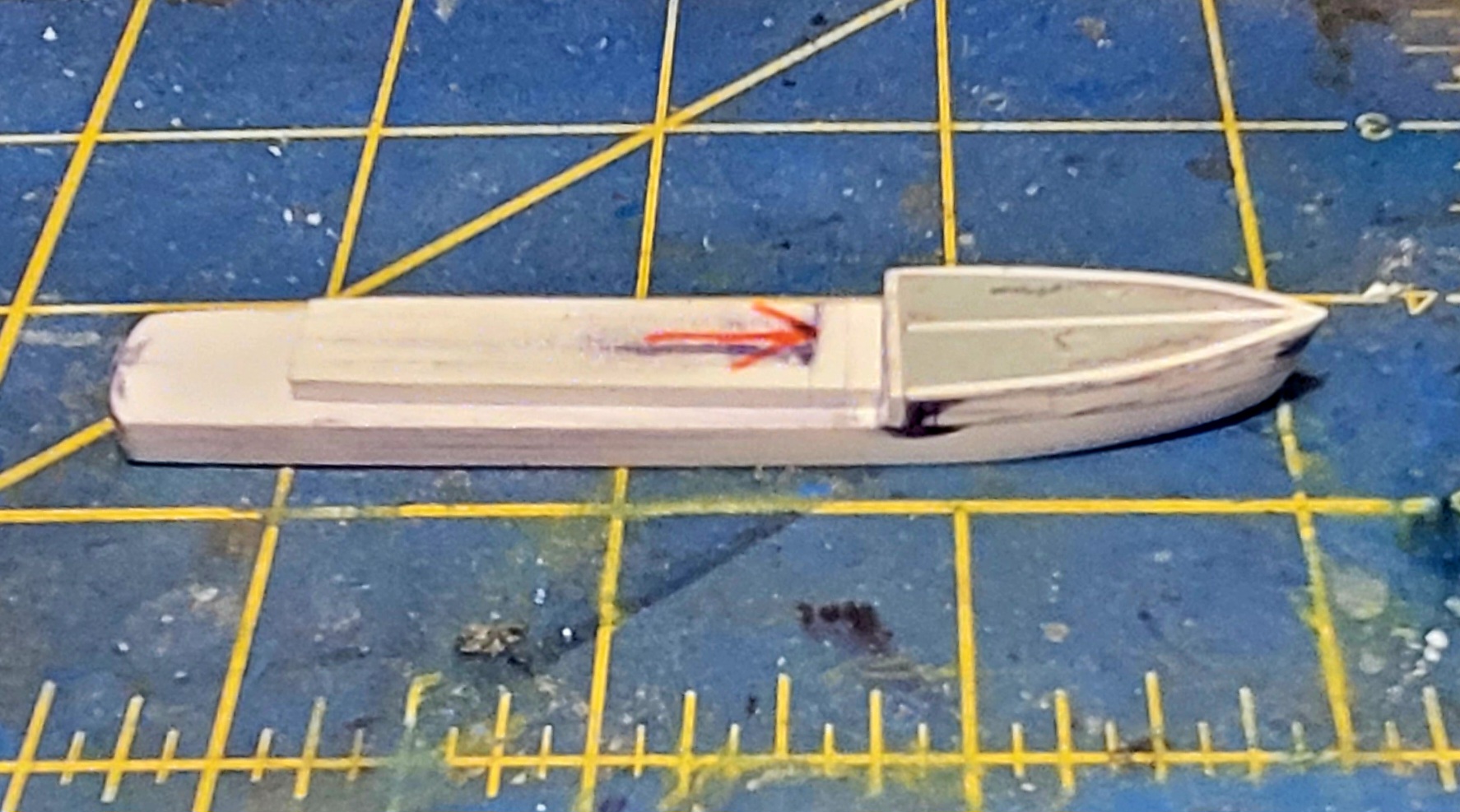

1/700 WMEC: A similar trick using Tamiya filler on the foredeck. The sheer of the bow, minus spray shields is correct. Shaping continues.

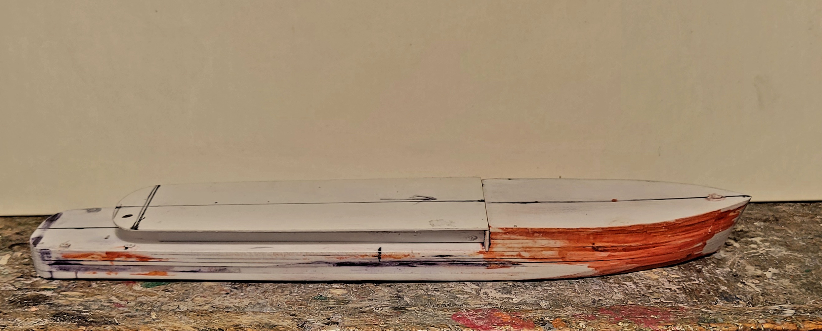

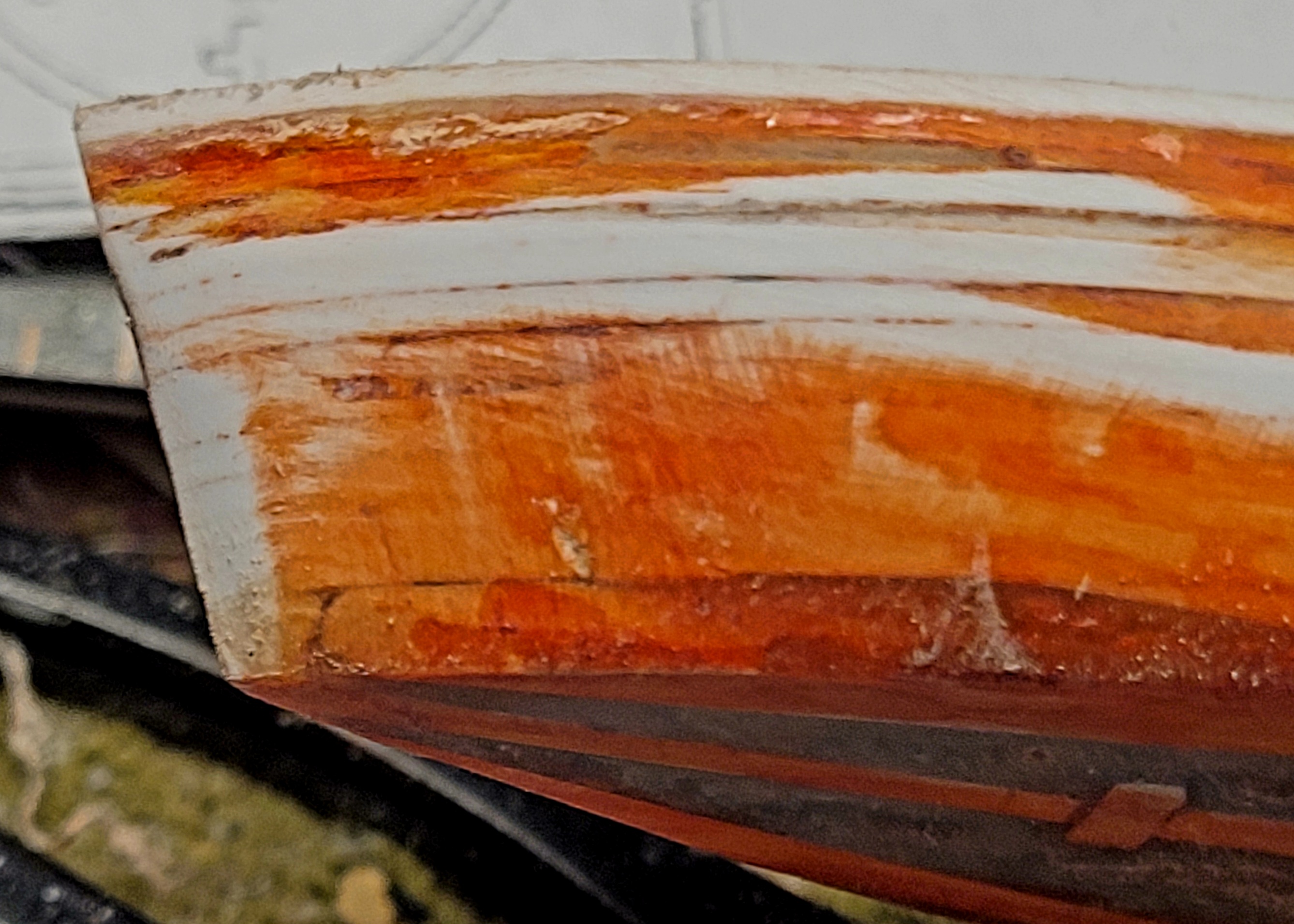

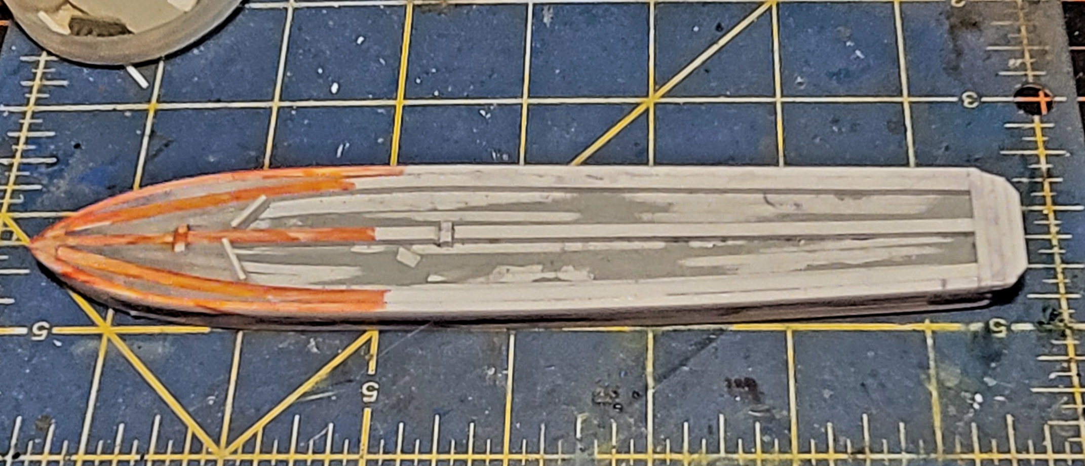

The process of filling with tiny amounts of C/A glue, 180 grit wet sanding continues.

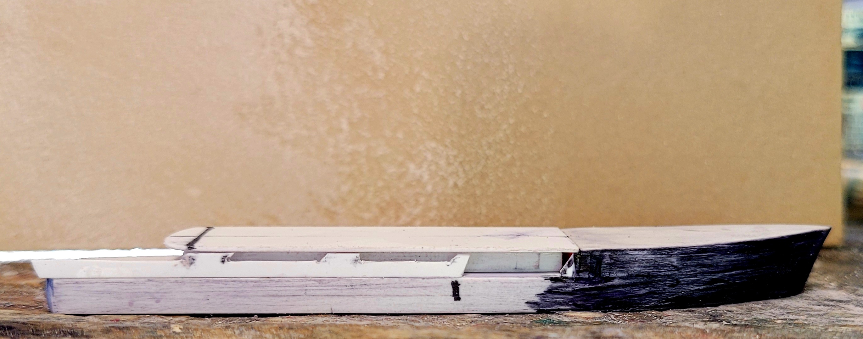

The Sharpie marker makes the hull profile more visible and flaws easier to spot.
Close inspection under bright light. Looking for the "shinies". Those places untouched by wet-sanding stay shiny until they are properly filled and smoothed. The .040 layers on the 1/350 lend themselves to lots of attention. It must be "just so" before I will move on very much more.

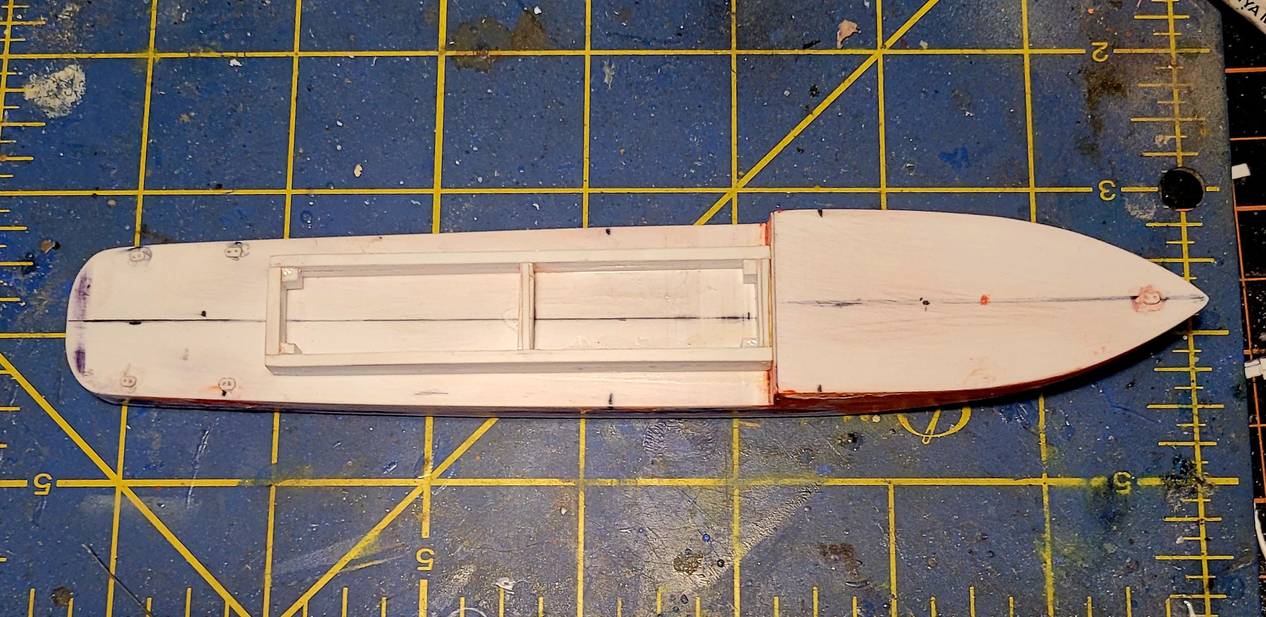

The Flight deck will be part of the after deckhouse. After bulwarks will be cast on the hull.
"Bulwark braces too, Rhino? Is that sane?"

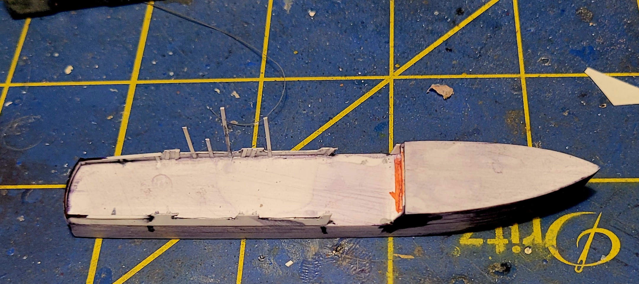

In truth I made the portside out of .010 and the starboard side out of .015 plastic strip. The braces are needed to hold up the rail caps on the .010 plastic. OOPS!

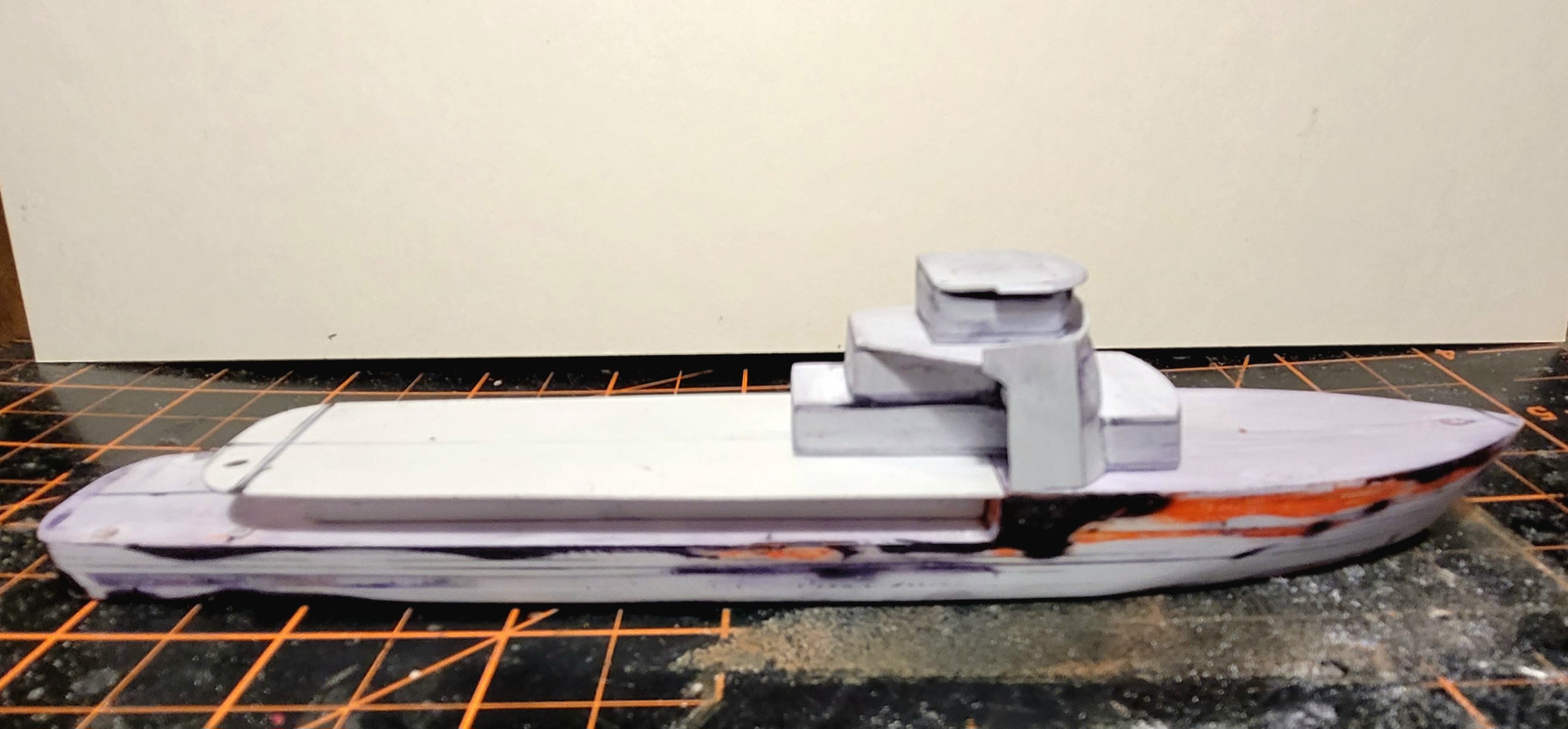

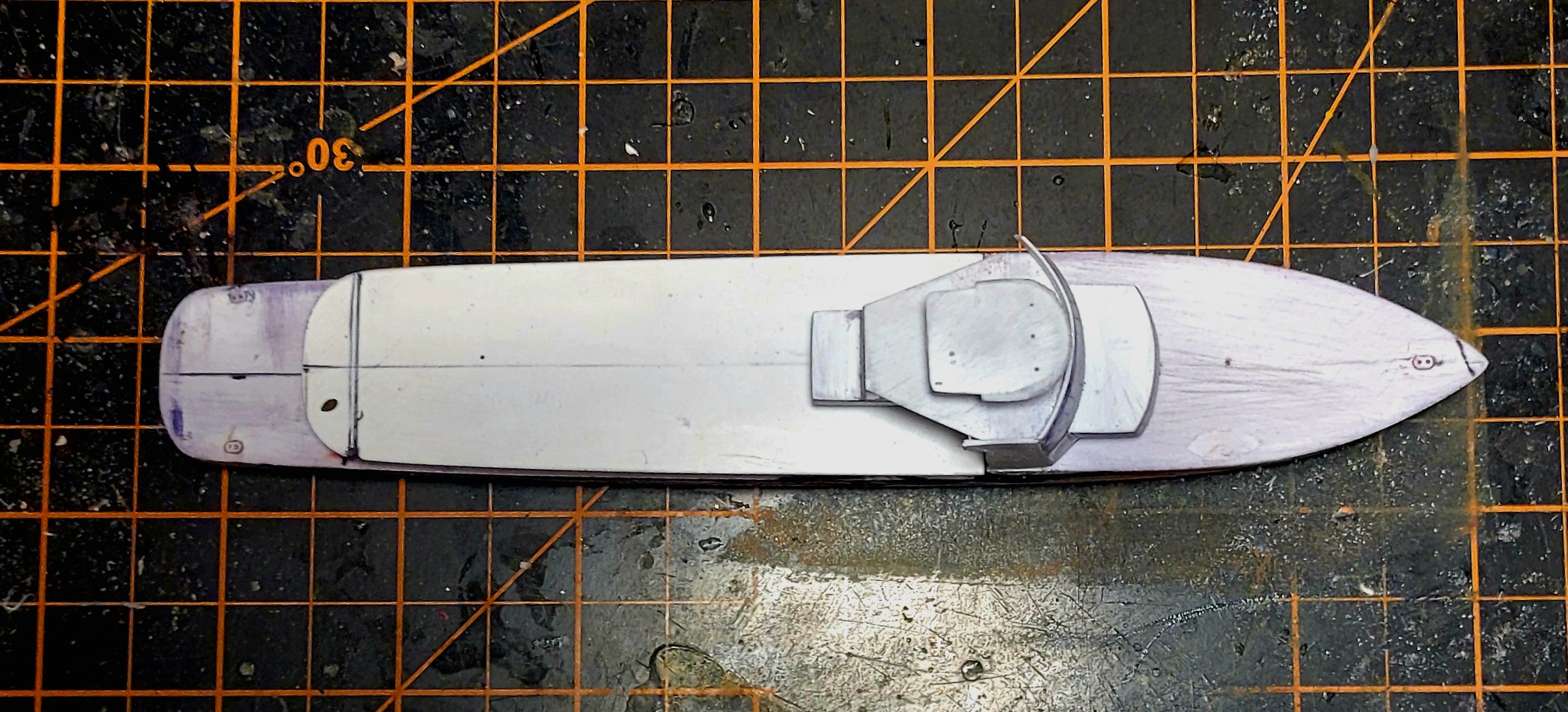

It wasn't time to add these yet, but I wanted to see how the fight deck would fit on the 1/700 Master. The fit is damn good!
This procedure will be the similar on the 1/350 scale Master.

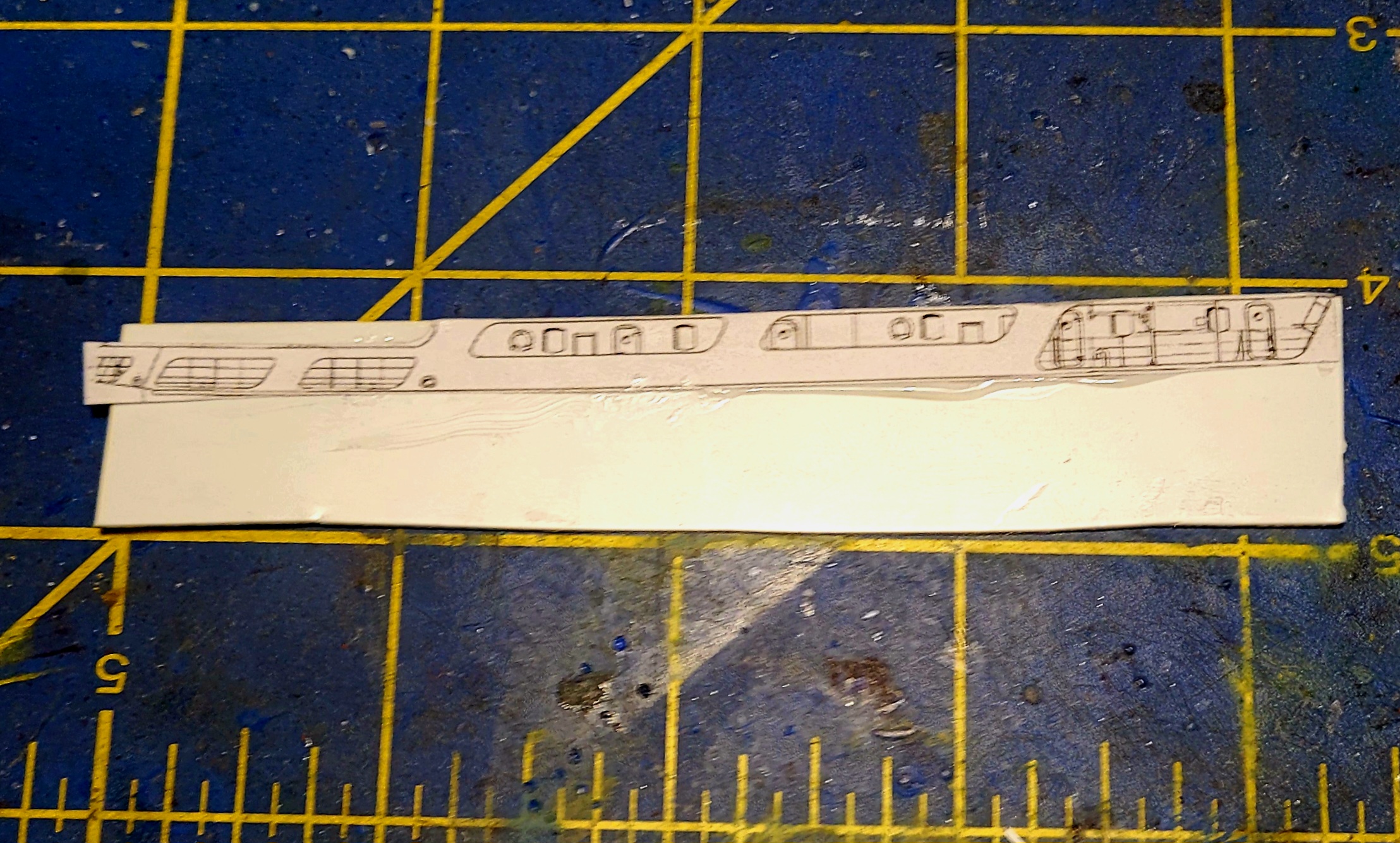

1/350 bulwarks will be cut/drilled/punched/shaped with the scale drawing as a guide on .020 plastic sheet. Gator's Glue is excellent for sticking paper to styrene (and many other things). In for a Deep Six and the soaked paper should be simple to remove from the finished plastic part.
I may have gotten carried away again.
Sheyit.

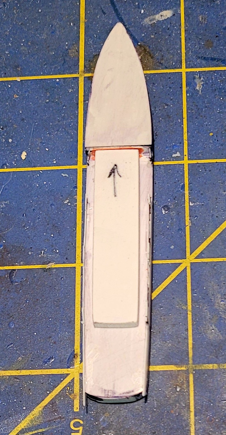

After deckhouse at .210 height. Afterdeck is .020 sheet and fits the foredeck swell! Mooring bit plates are going on.
I used Future to stick the deckhouse to the hull so I could fix the afterdeck to the structure in a couple of spots.
A bath in Windex dissolved the Future so the house and deck could be solidly affixed.

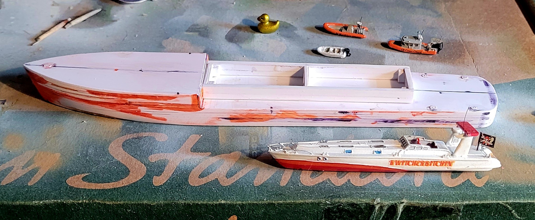

Just for the fun of it, size comparison with other TLAR 1/350 scale subjects.

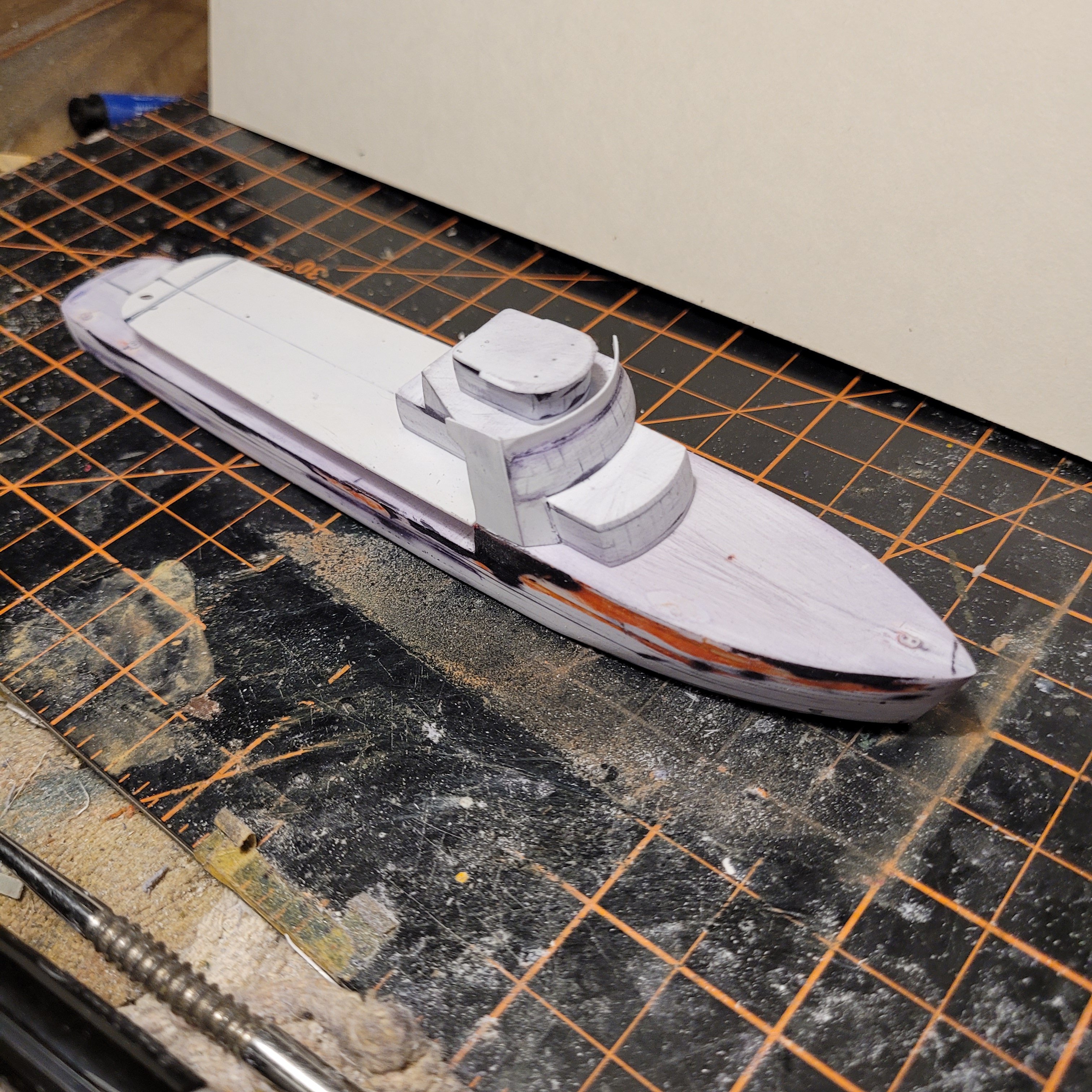

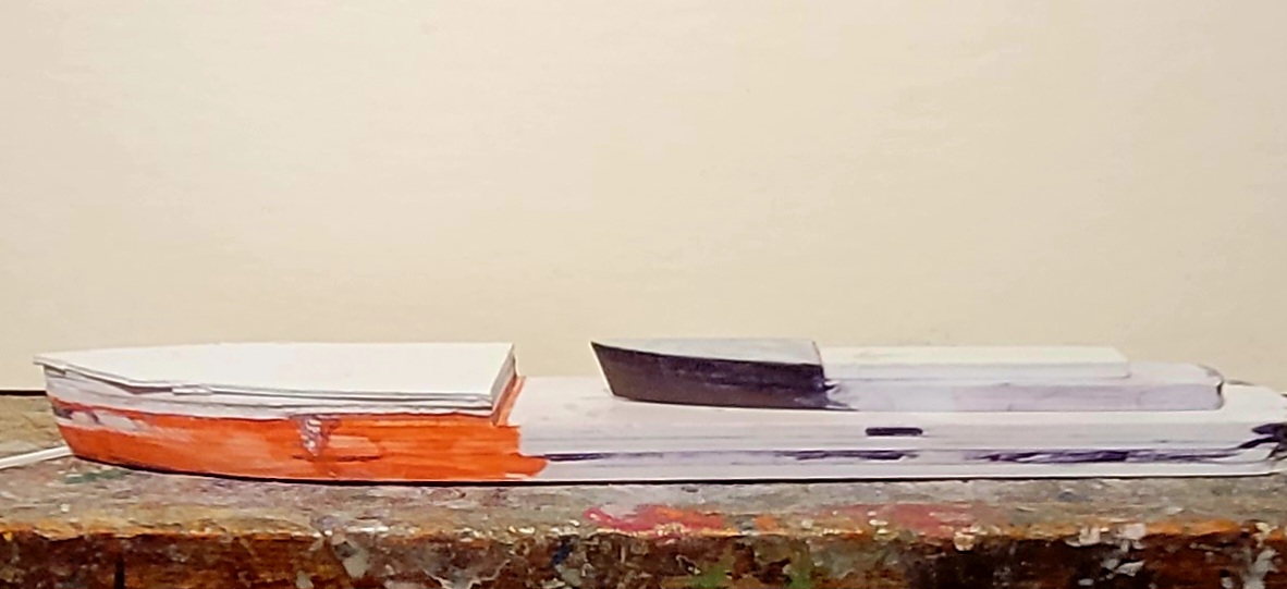

Time to start on the superstructure! The bow profile still needs fine shaping. She's a hair (?!) too long at the stern.
1/350 USCGC Dauntless is progressing, ever so slowly.

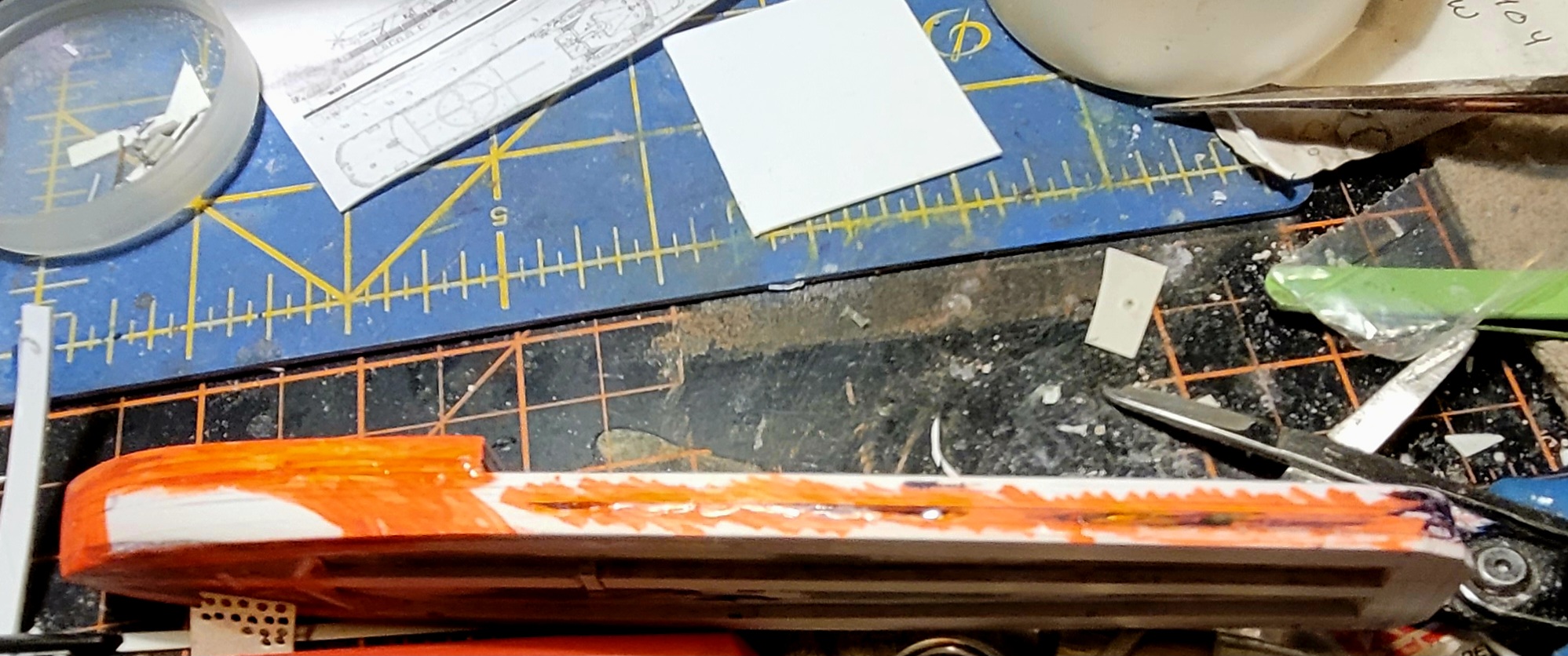

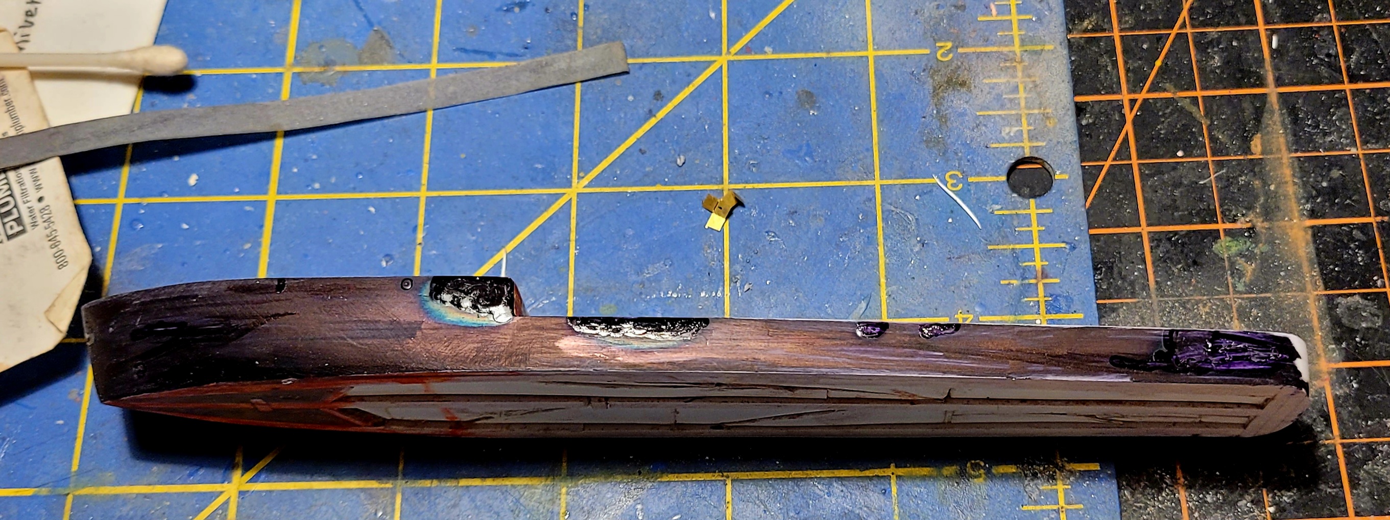

Note to self. Orange Sharpie does not work as well as Black does for finding flaws. Find the "Shinies" dab them with C/A glue, wet-sand and eval.
This was a good stopping place for today.
