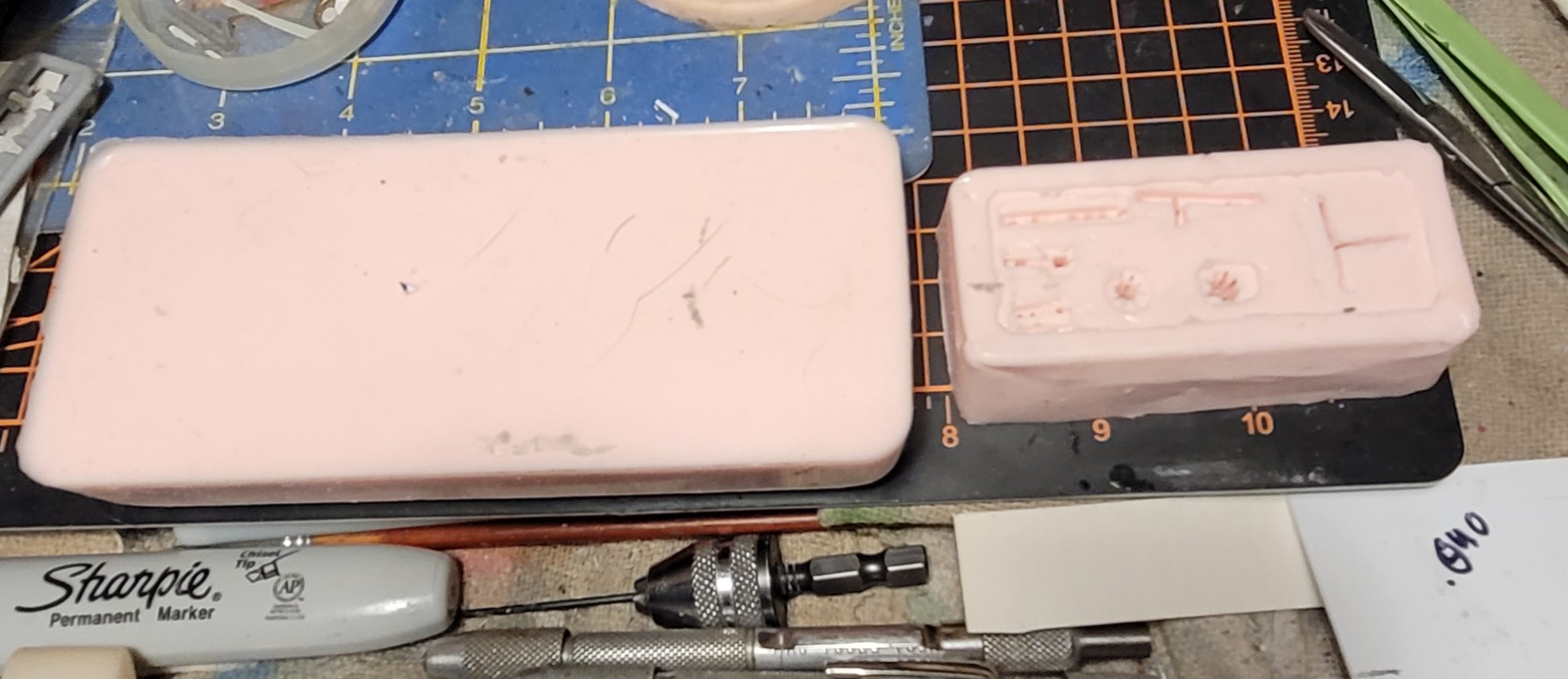

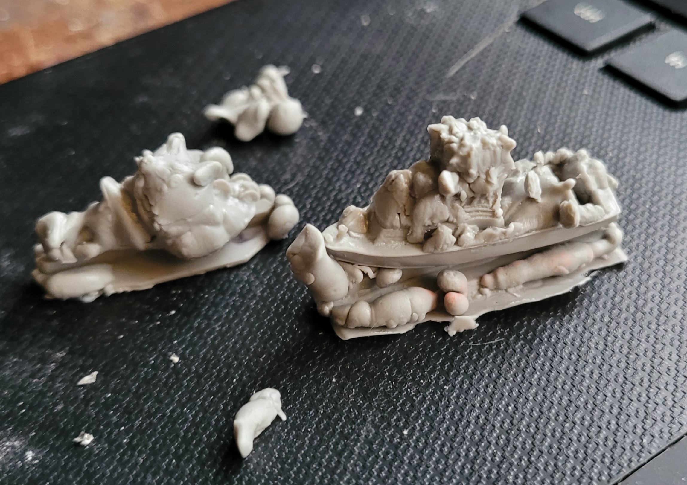

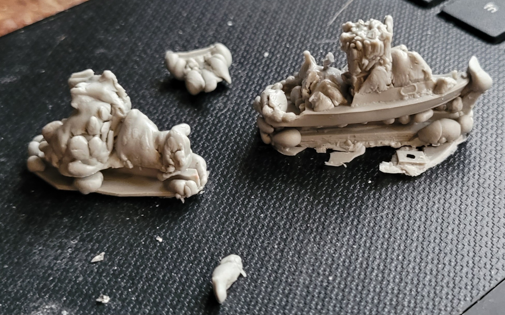

I think I know what went awry. I queried the Tech Guys at Reynold's Materials to see what their opinion is. I might have gone a little overboard on the mold release.
The Do Over molds lends itself to a smarter arrangement of parts. Picking every tiny morsel of gooey RTV out of all the details was time consuming, but worth it!
The 1/350 UTB mold poofed too, but I didn't cut it.
Who wants to see what those mutated castings look like, just for grins?

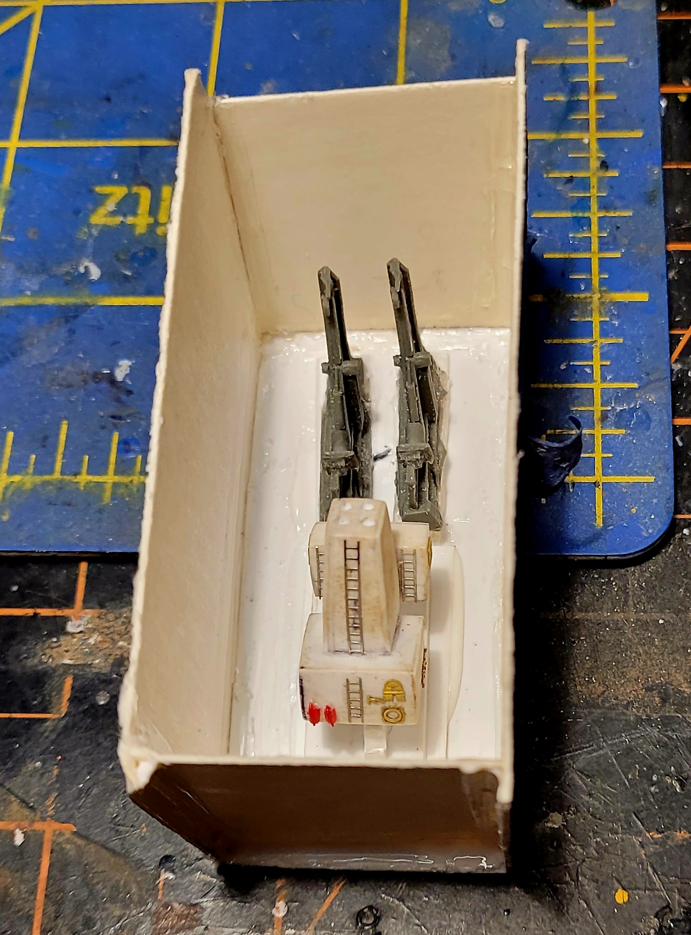

The mold box for the smokestack and modern cranes is complete and loaded.

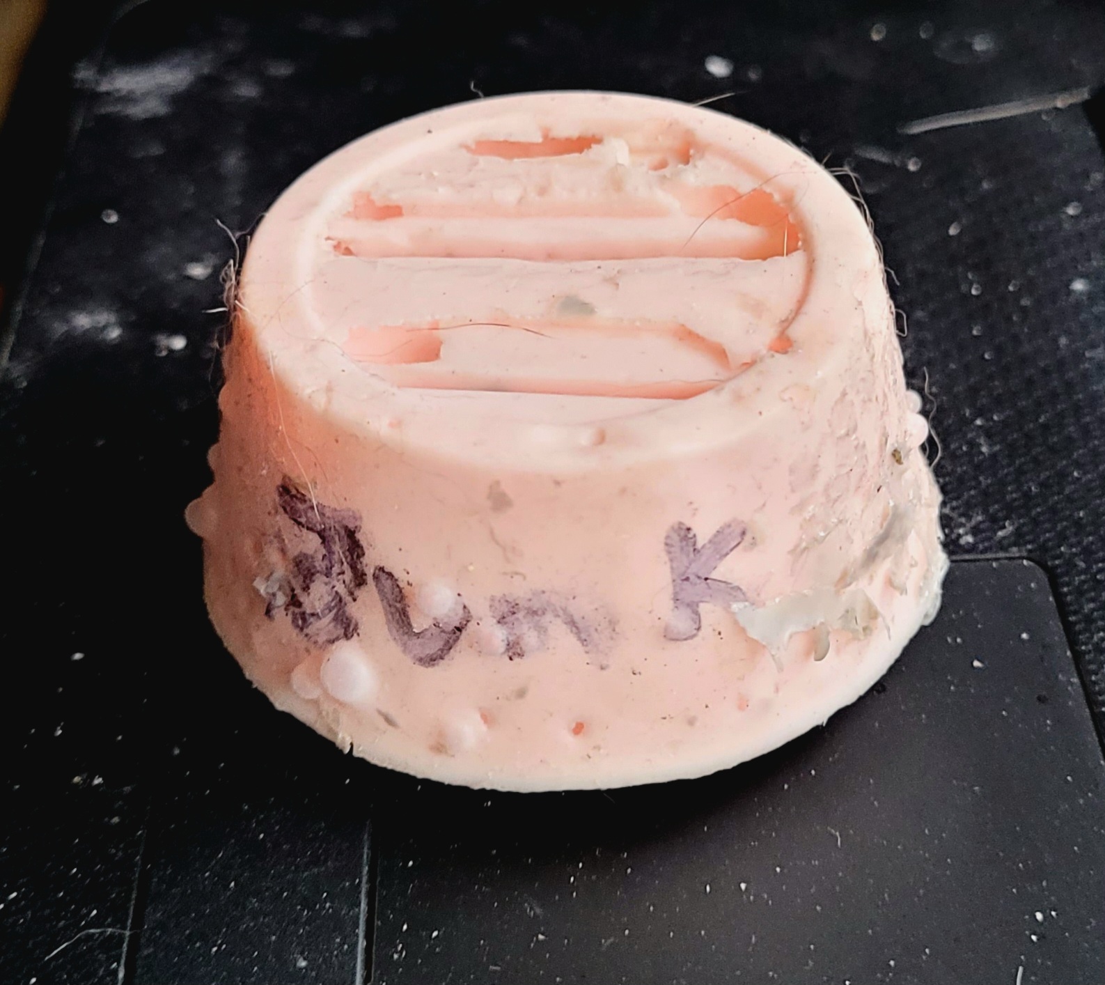

Just for Grins.................
See how 60 psi blew out the bubbles on the outside of the Junk mold? :lol:
This mold will not be cast again. It might make a dandy projectile for grandkids or a therapeutic hand squeezer.
A testament to "I don't know every-f-ing-thing". Keeps a Guy humble. :smack:

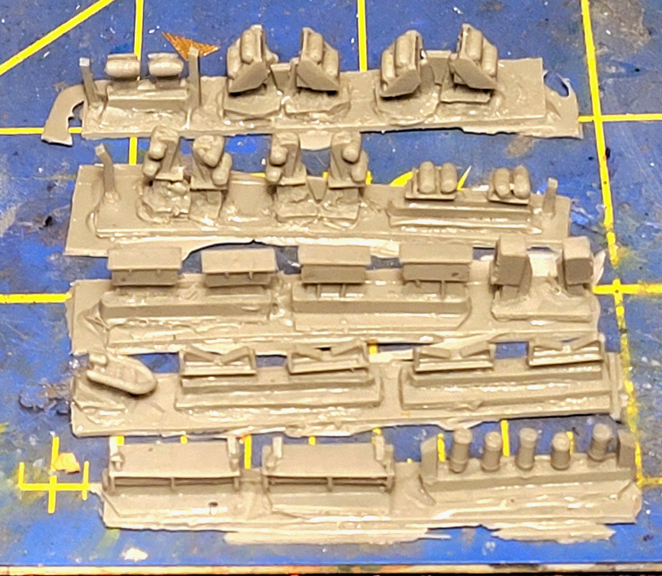

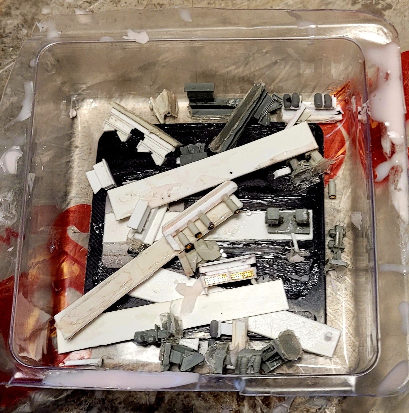

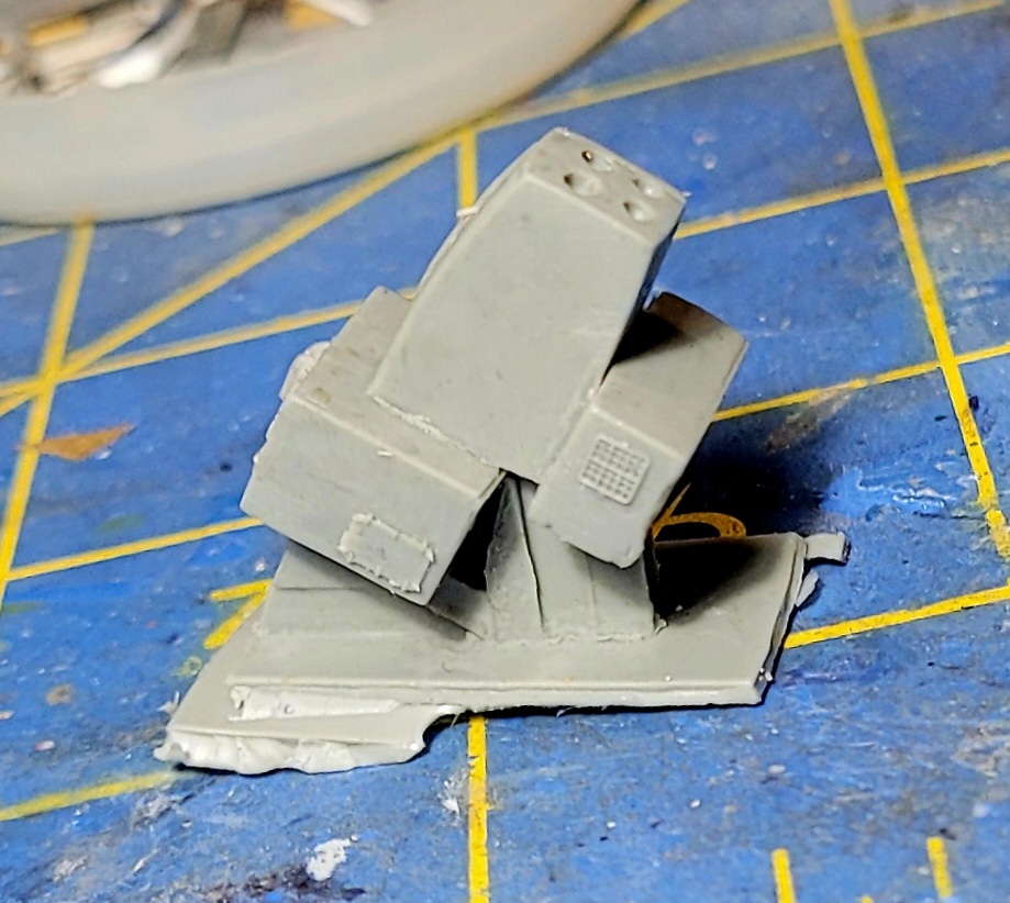

This looks like wreckage, but it is not. It's the catch-all for the intricate parts Masters removed from a successful mold. It seems "Waste not, want not" can be a detriment in the resin ship model business.
A couple of the twin canister racks pulled little hunks of RTV out of the mold, but they are in a spot that can be trimmed and sanded easily by the modeler. Absolutely forgivable.

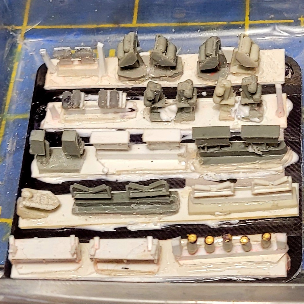

Final 1/350 parts mold. Main Hull guns, drums and porta-potties with the revised Big Bridge.
Carl was right. I just couldn't leave the handrail flaw and the winders wuz tew liddle.

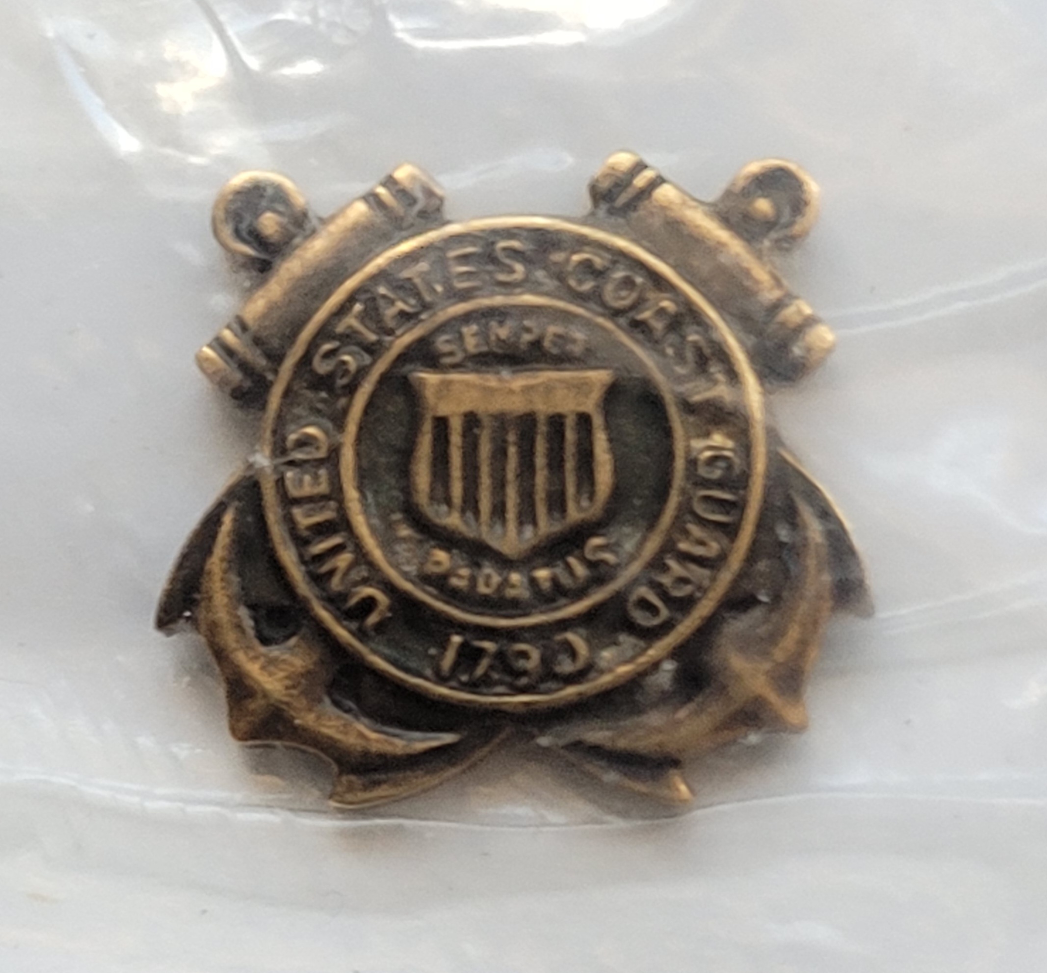

This 1/2 inch USCG crest will come with every kit. I a vendor in Michigan makes these. A little added interest for your Cutter's base.
The other bonus bit remains a closely guarded secret. Customers will find out when their very own Big Cutter kit arrives!

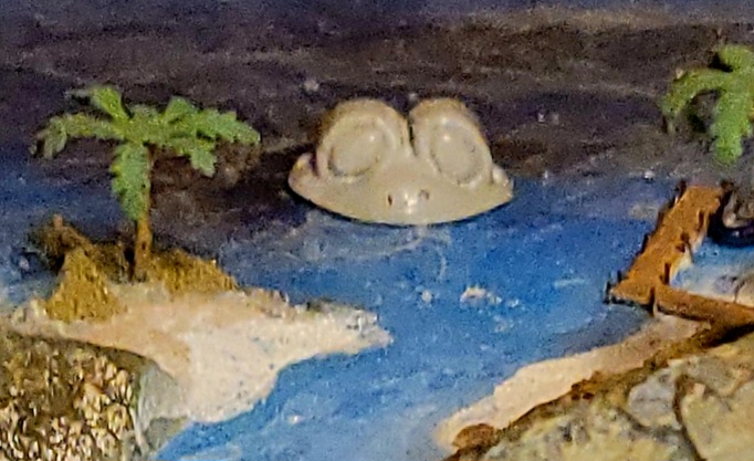

Mr. Frog is back. Flooded down, prowling shallow water for prey. Frogzilla? Seinaru Tawagoto!
I carved and sanded around his eyes to make him more frog-like. As if it mattered for such a silly, bonus piece!

First casting of fresh main hull parts mold. I couldn't be more pleased. A very busy (lots of small parts) mold that tools and casts very nicely.
It made sense to mold the smoke stack with the modern boat cranes in a tall, rectangular box. I'm pleased with these. Very pleased!

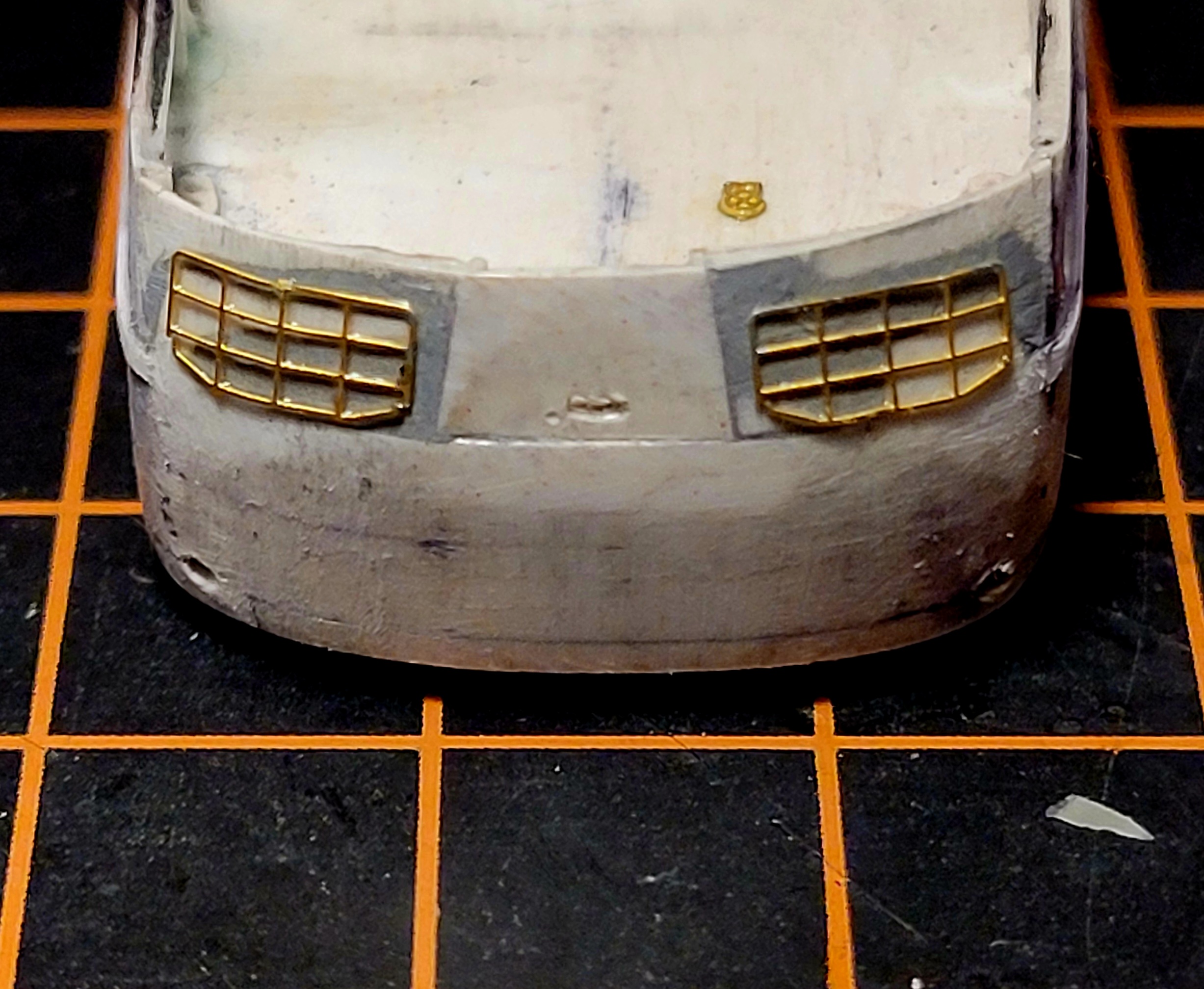

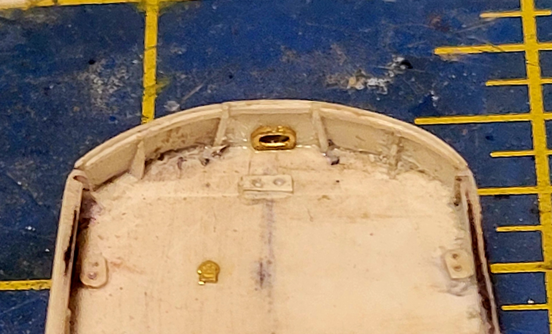

The last 4 parts went on the Big Cutter's main hull last night. Blanking the stern side rail openings with thin plastic card will see the main hull to the mold box.
Yes, The center of the stern gratings line up with the vertical stanchion inside the stern rail.

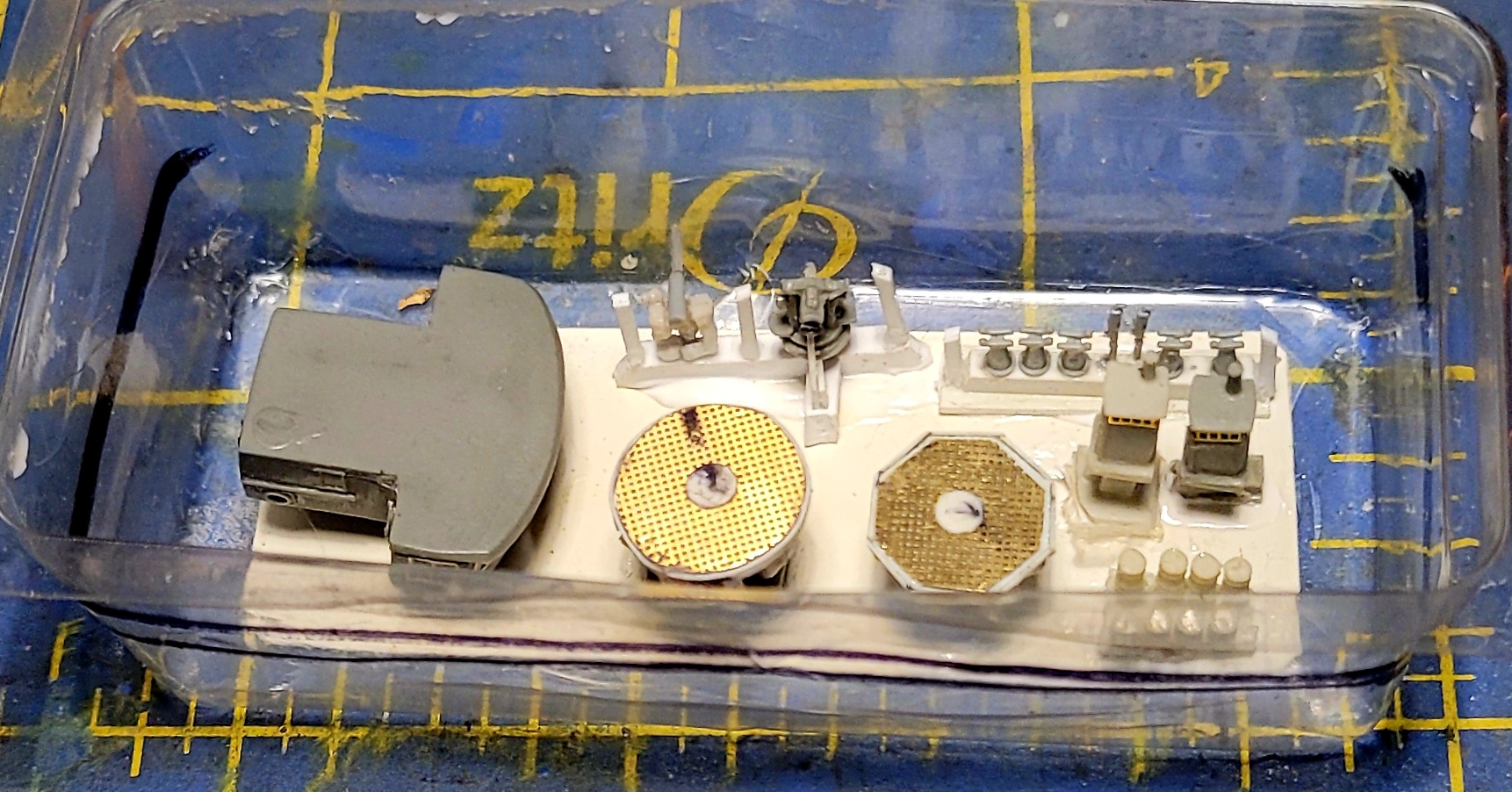

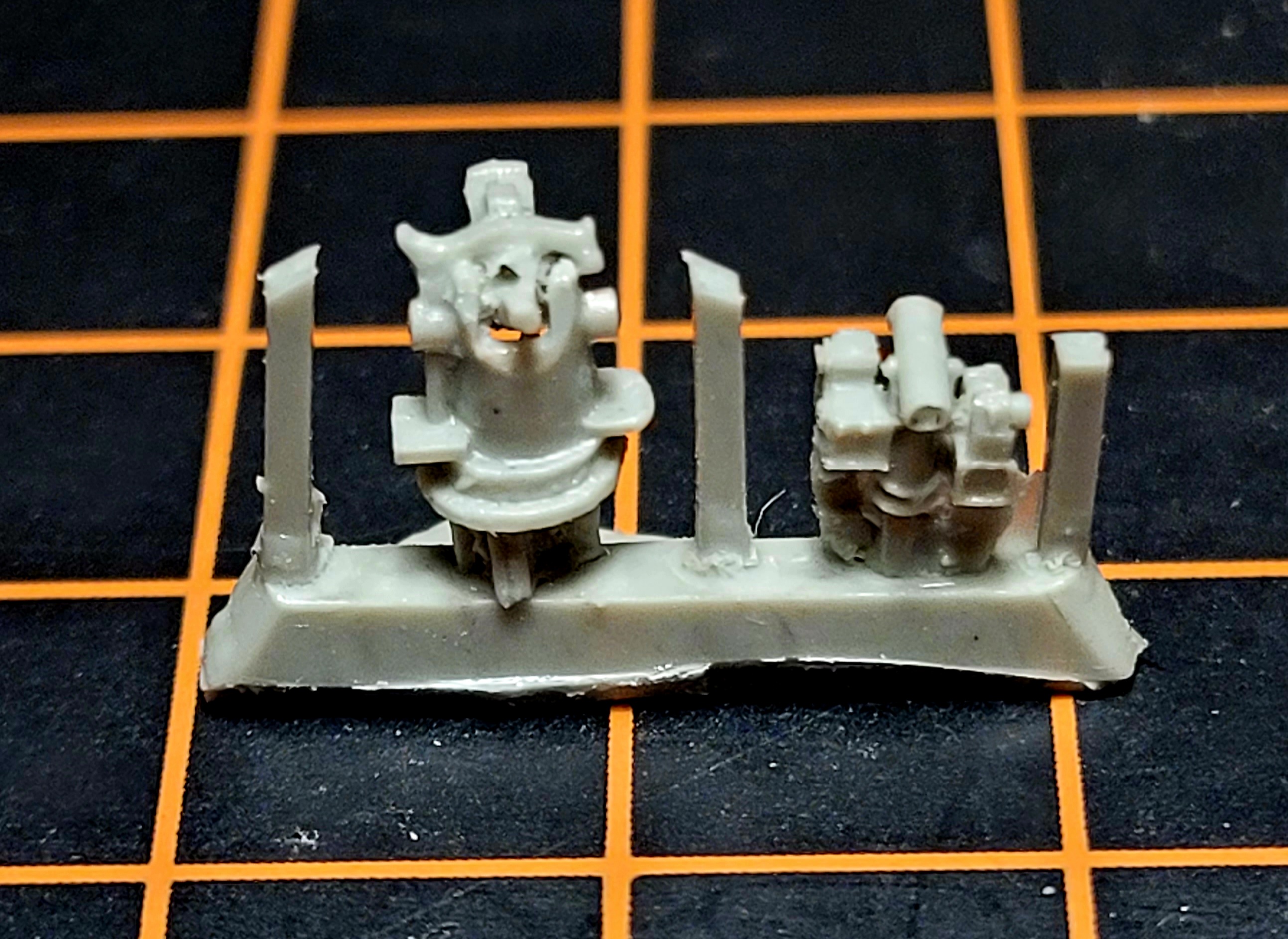

Mold Day went well! This smaller mold is the last parts mold to pour for the 1/350 WMEC kit. Mk.38 25mm & 3" guns, sans barrels, 2 fiberglass shithouses, the revised modern pilothouse, early and modern gun platforms and 55 gallon drums. Turned brass gun barrels will be included in the kit.
All y'all will discover what the bigger mold produces in good time. 7 hours from first casting of fresh molds. NO rushing the chemicals!

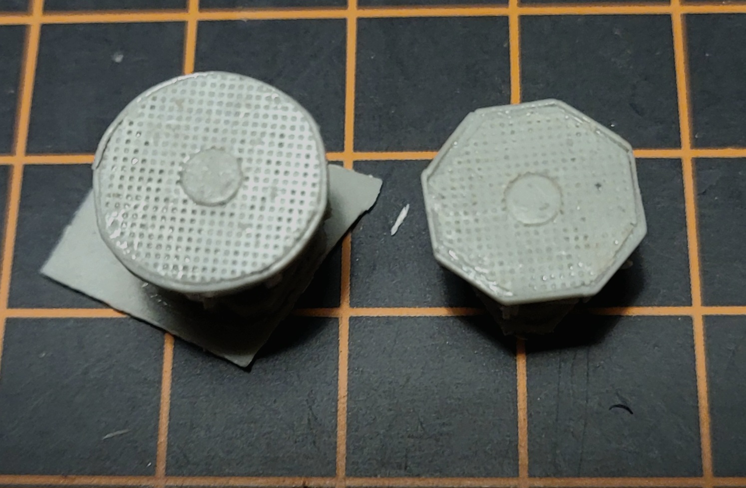

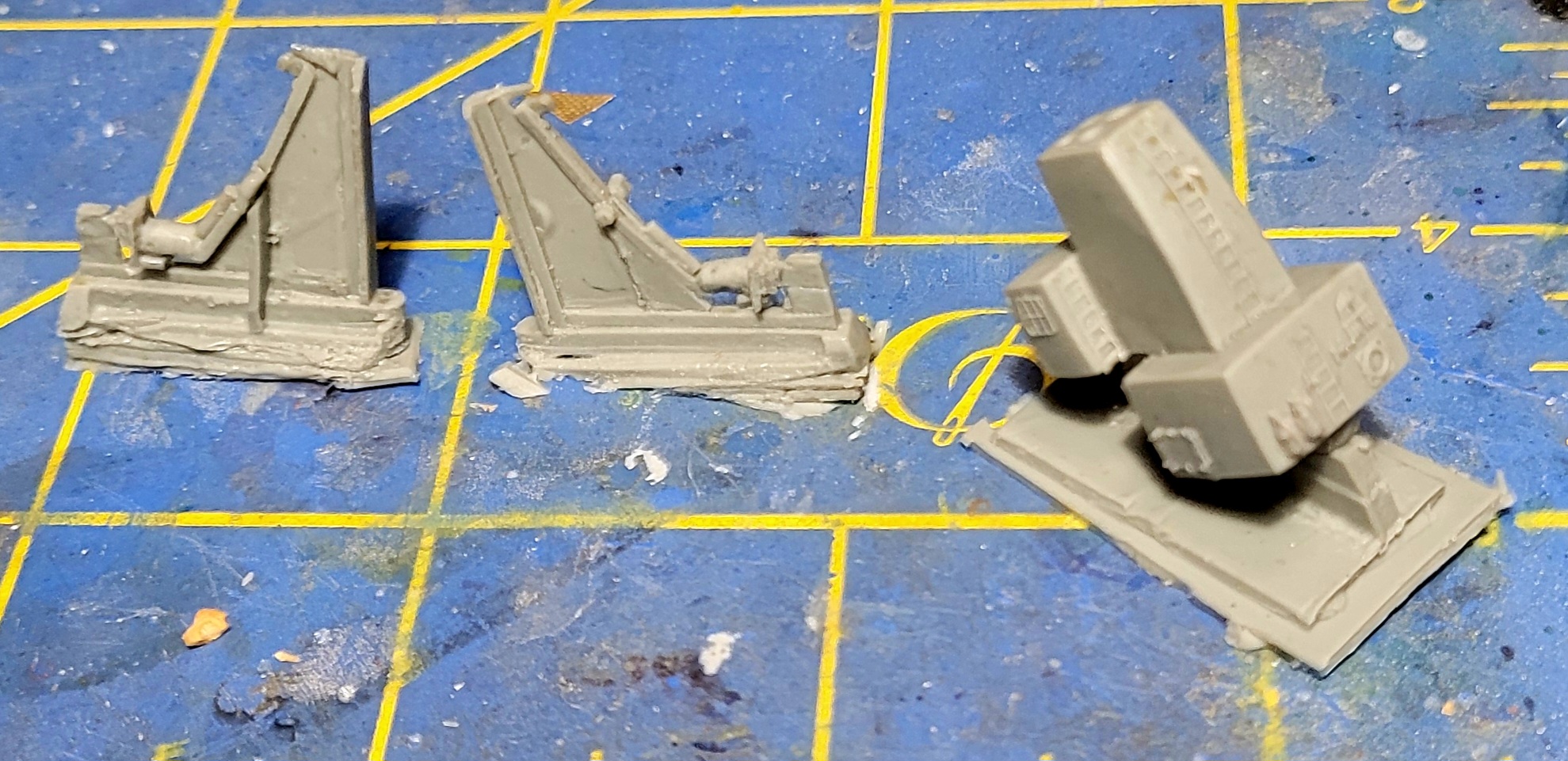

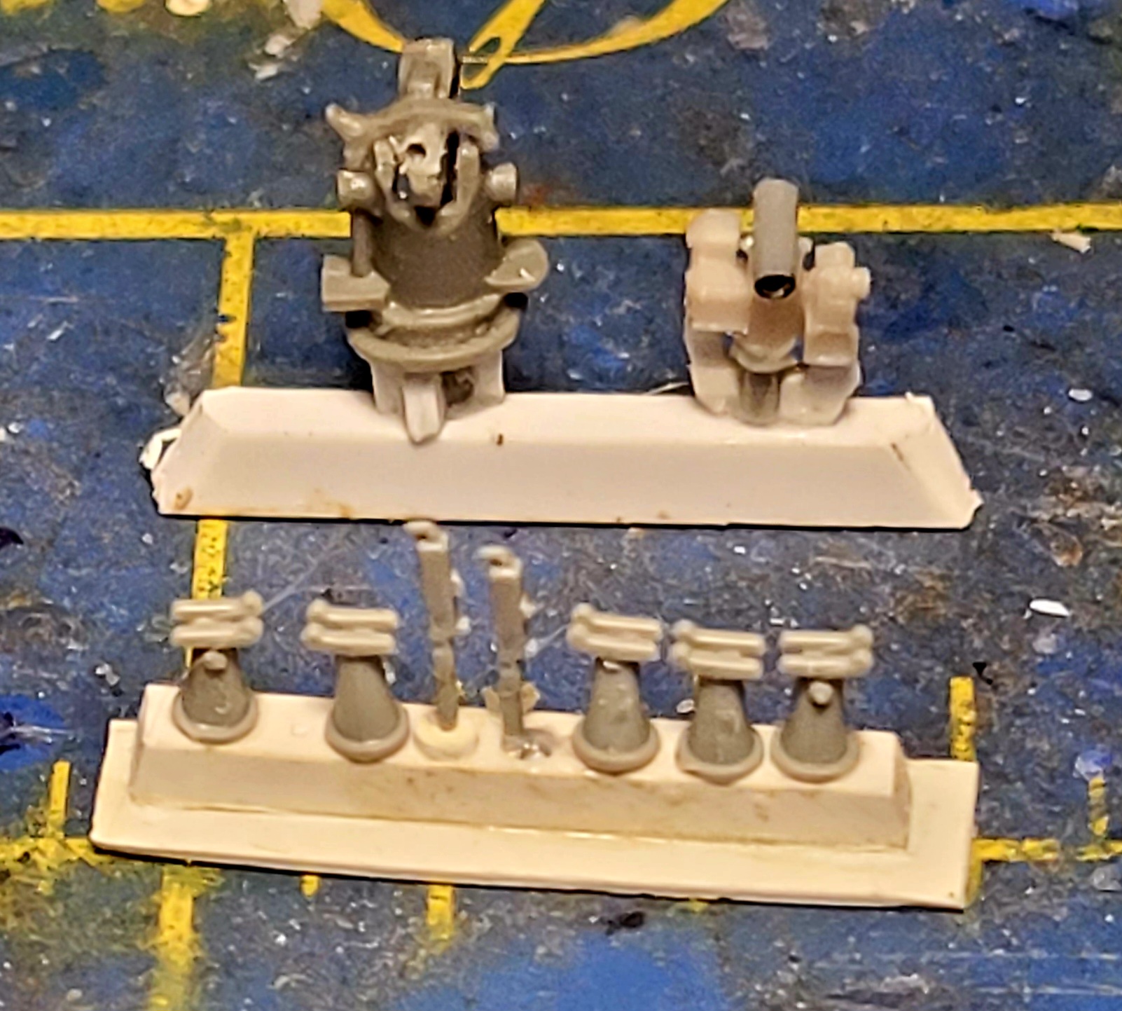

I'm a happy guy when it works the way I hoped it would! Both early and modern gun platforms retained their grating texture. The 3'.50 caliber cannon and Mk.38 25mm chain guns are just what I hoped for The Browning .50 cals and pedestals are nice too!
My Guns mold yielded fine castings, but these are the stand-outs.

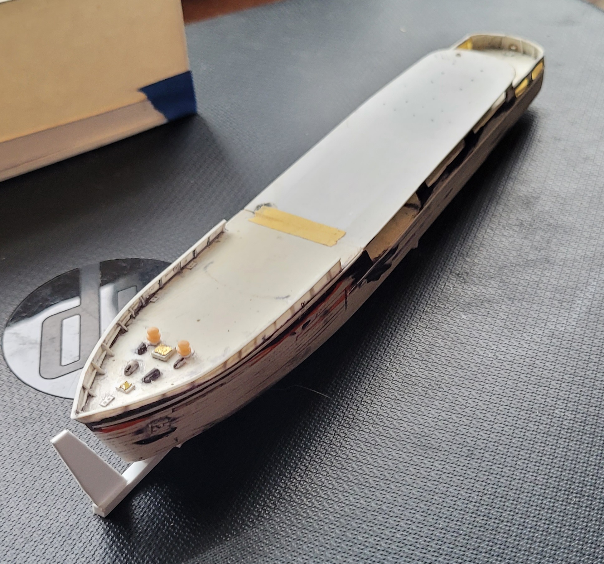

It started here, last July. A request and an idea.

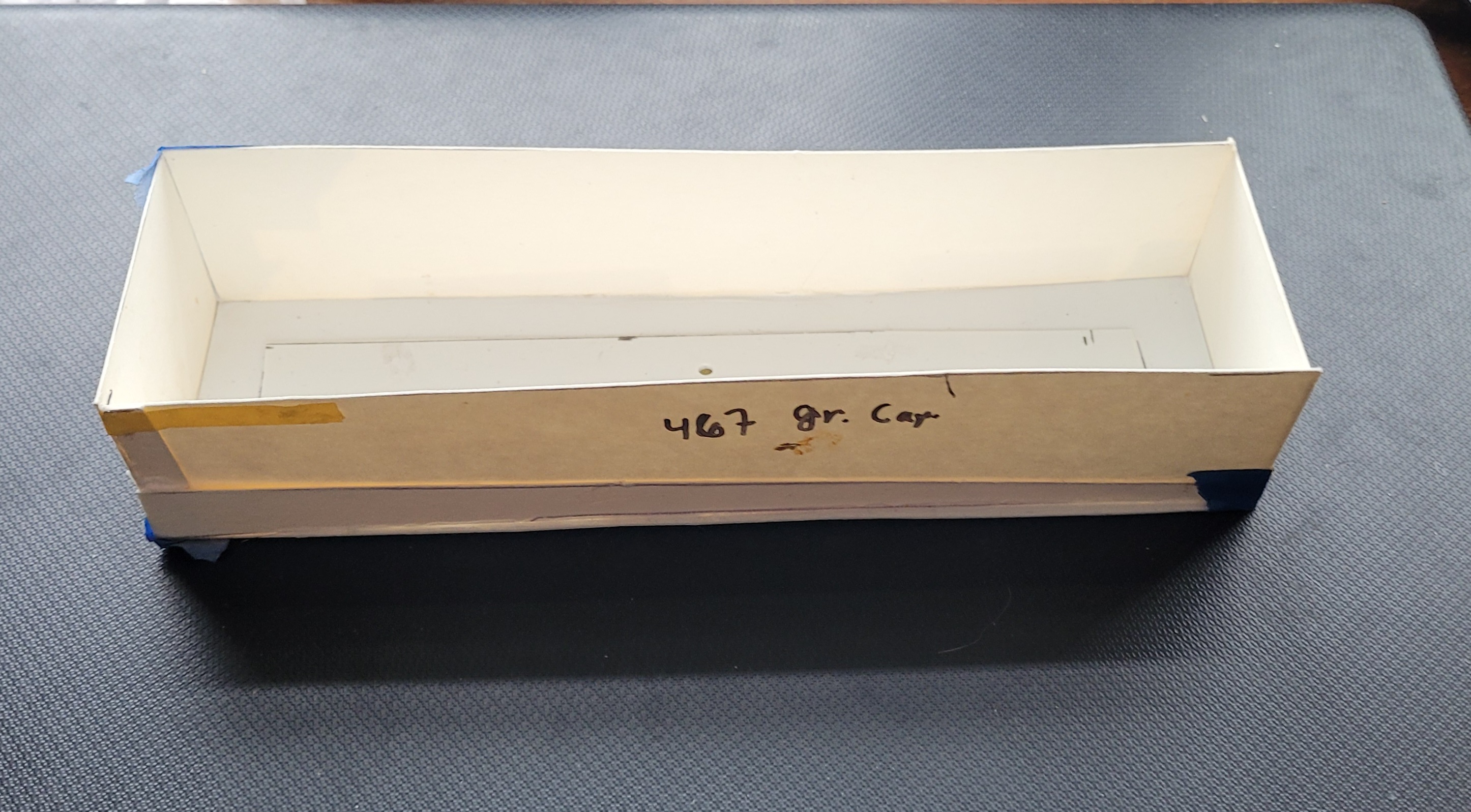

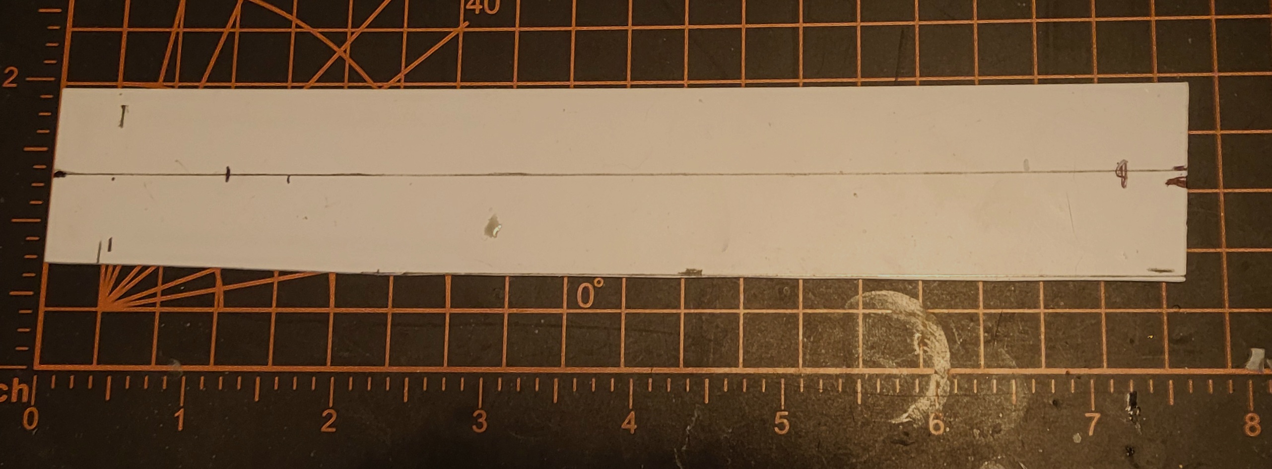

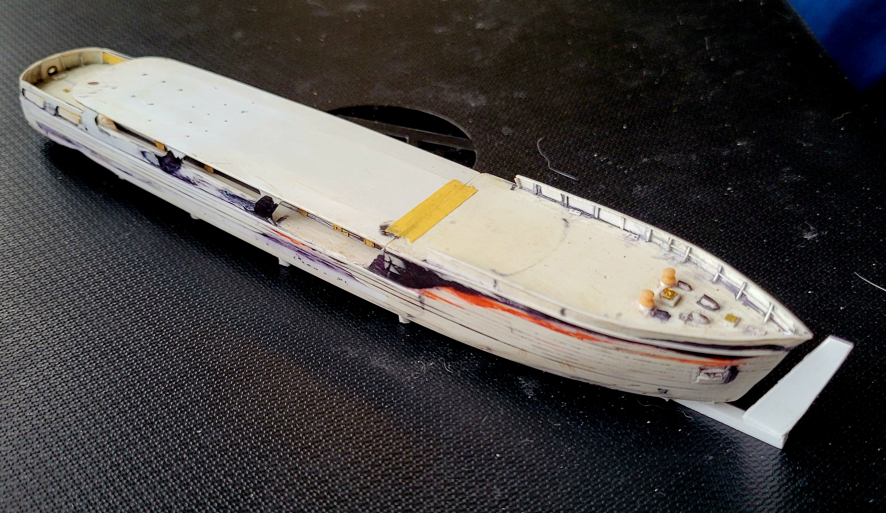

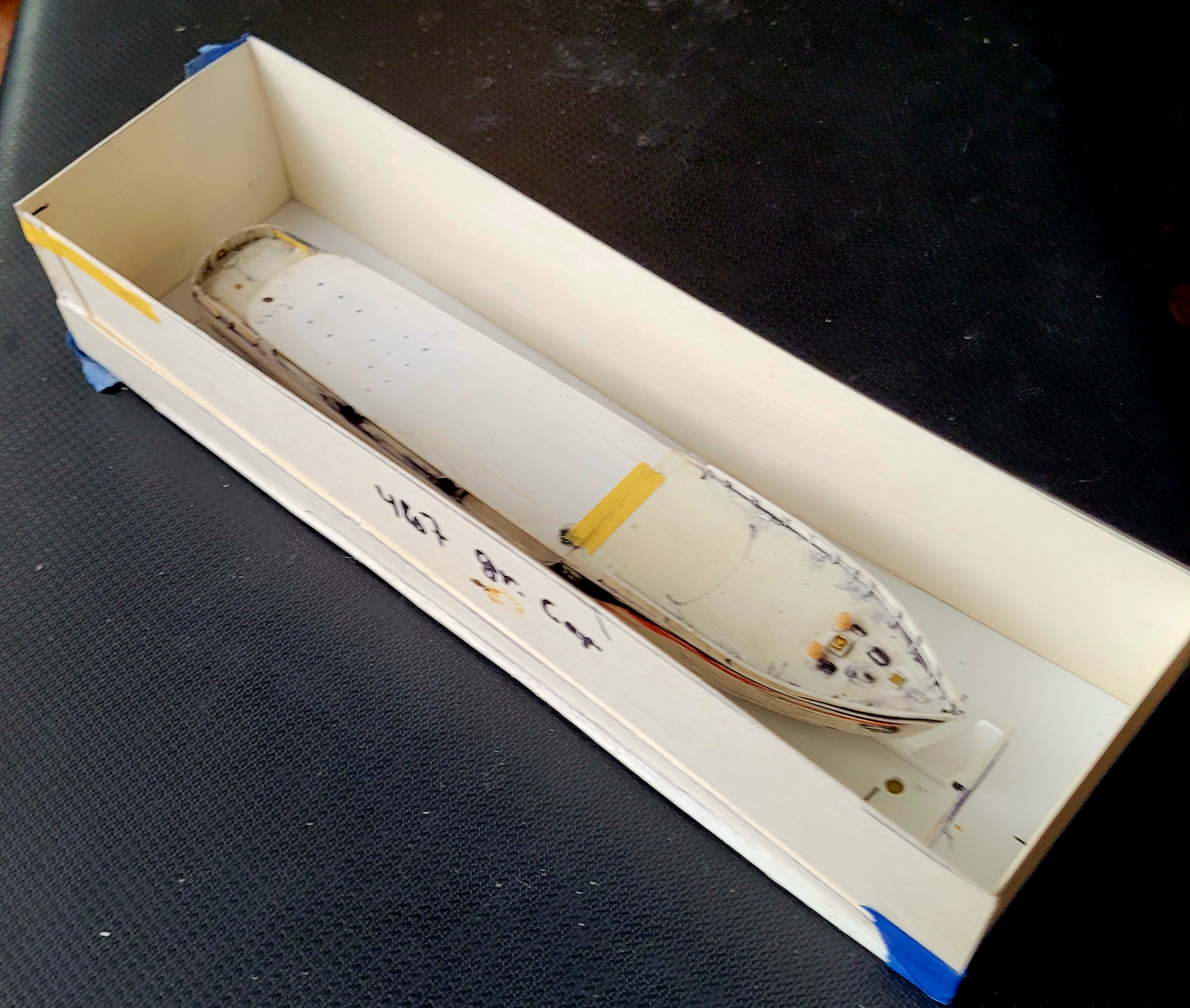

I had a Snow Day today. I figure I should work one job or the other. Mold framework and blanked stern, ready for RTV.
Blizzard chores are done. Our hungry snowblower was well fed, refueled and put to bed. Vehicles are both "up" for tomorrow's work day.
The mold box is 31.875 cubic inches by volume or 523 milliliters. The main hull assembly displaces 56 ml of volume. I mark the mold boxes, even if I don't expect them to survive. This one is a plastic base and thick paper walls. It isn't pretty but it won't leak.

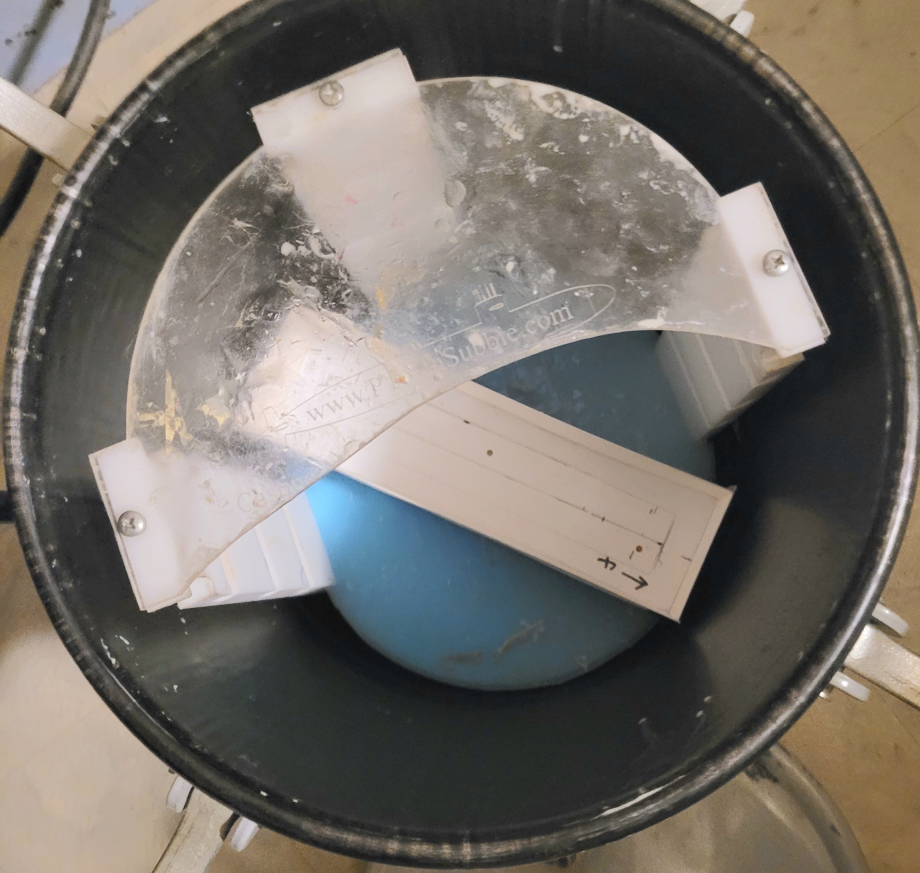

Fitting inside the pressure pot is kind of a big deal. This box just barely makes it. This, Gentlemen, is the upper limit of TLAR Models mold production capability. This is also the largest part of this kit. My Moldmax 20 RTV tips the scales at 688 grams. Tare weight is 165.
523 Grams total useable material. This mold will need 423 grams of RTV and 44 grams of catalyst. If my math is correct, this should be a little more than enough to do this job! Pshwoo!
Mold pouring is tomorrow after work.
Stay tuned for more exciting Big Cutter developments!!
Chris aren't there going to be some major problems with the mold in these areas? Seems like a fubar undercut problem to me.
