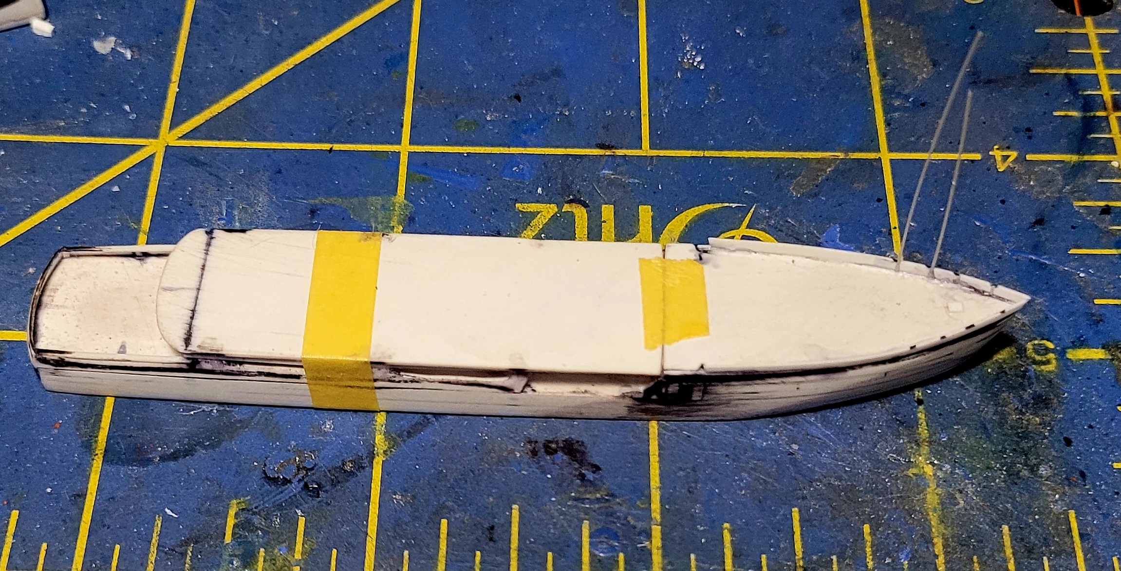

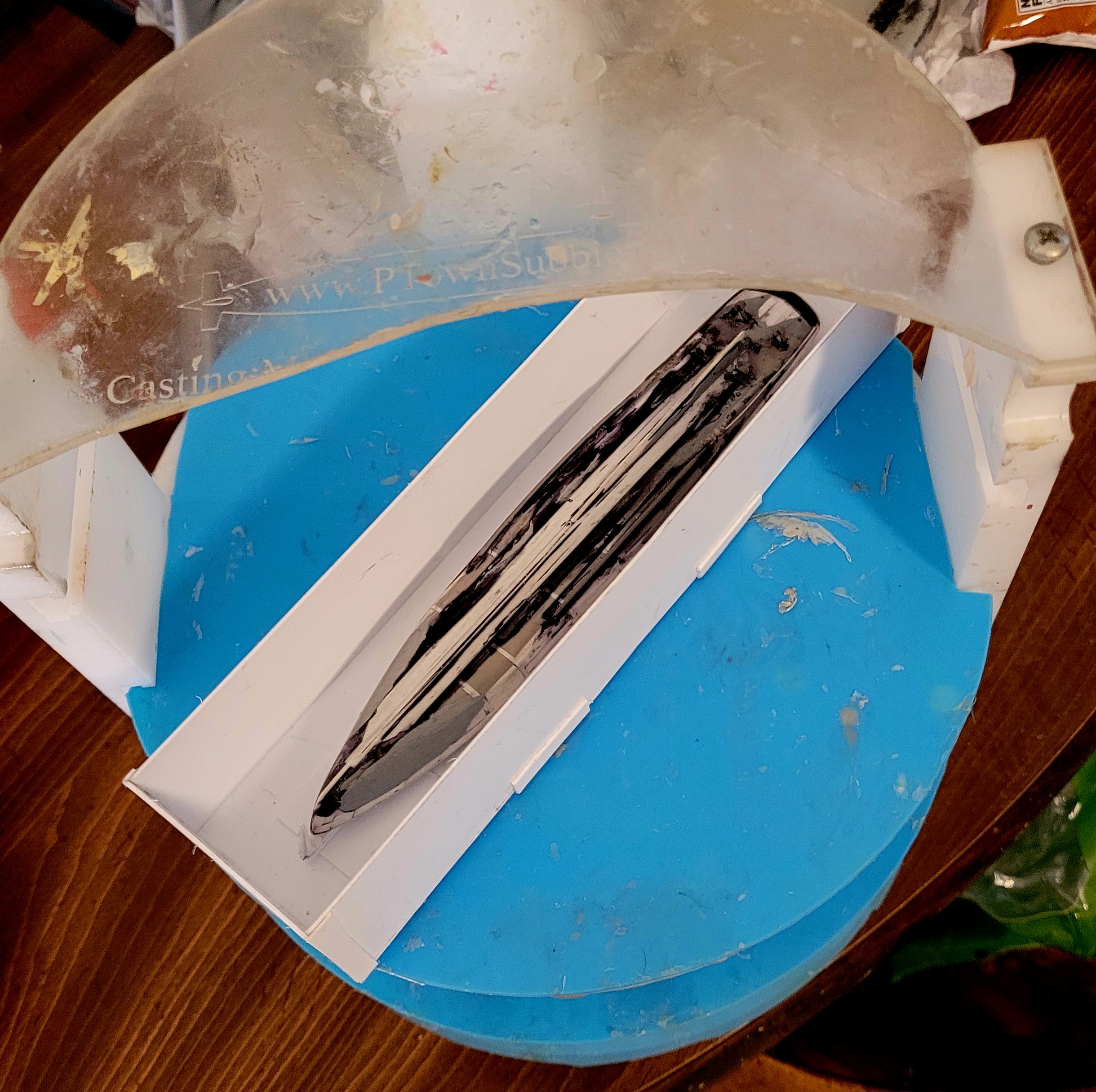

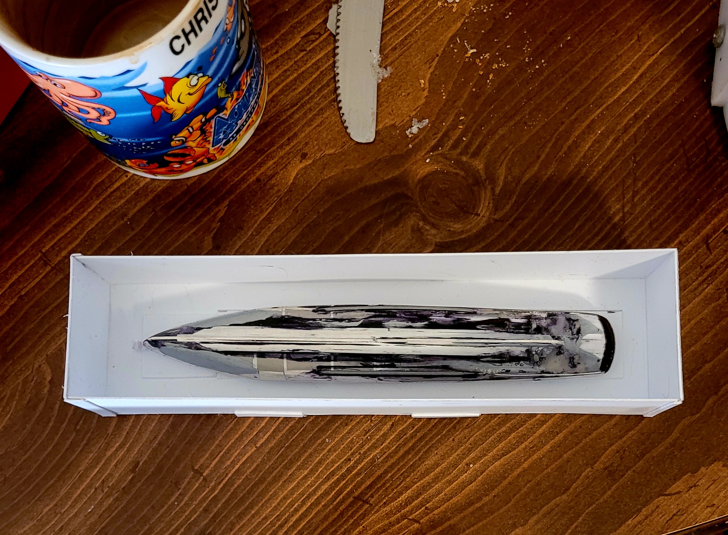

258 ml mold box for the lower hull. It is important to know how much RTV to mix. I figure the lower hull takes up about 60 ml of volume.
The rudders go in here too. Milliliters and grams are directly related. Weighing the Masters will tell me how much resin to be ready to mix and pour for each mold.
7 1/8 inch mold box fits in the rack for the pressure pot! YAY!! :yipee:
The main hull's mold box will be slightly wider and a shade longer to insure proper mold wall thickness, even using a more ridged RTV.
But now I know for sure this project, in fact, can be molded and cast with existing equipment.

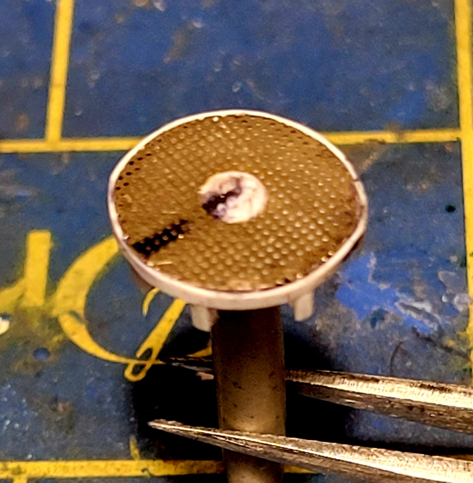

Really!? Funny 'Pup sees only the friggin' waffles?! 500 hours in these Masters since July? You are killin' me Smalls! :lol:

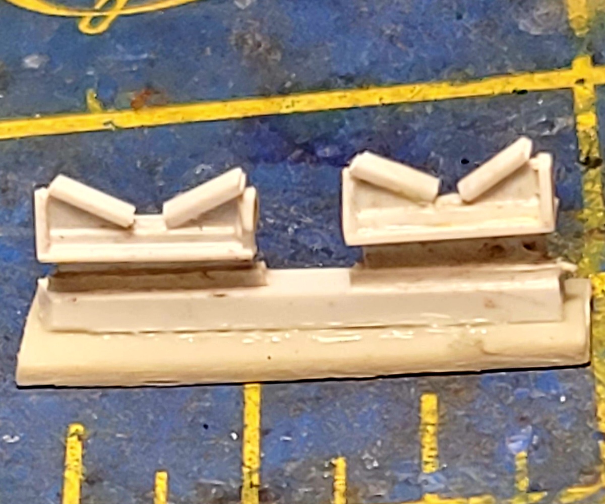

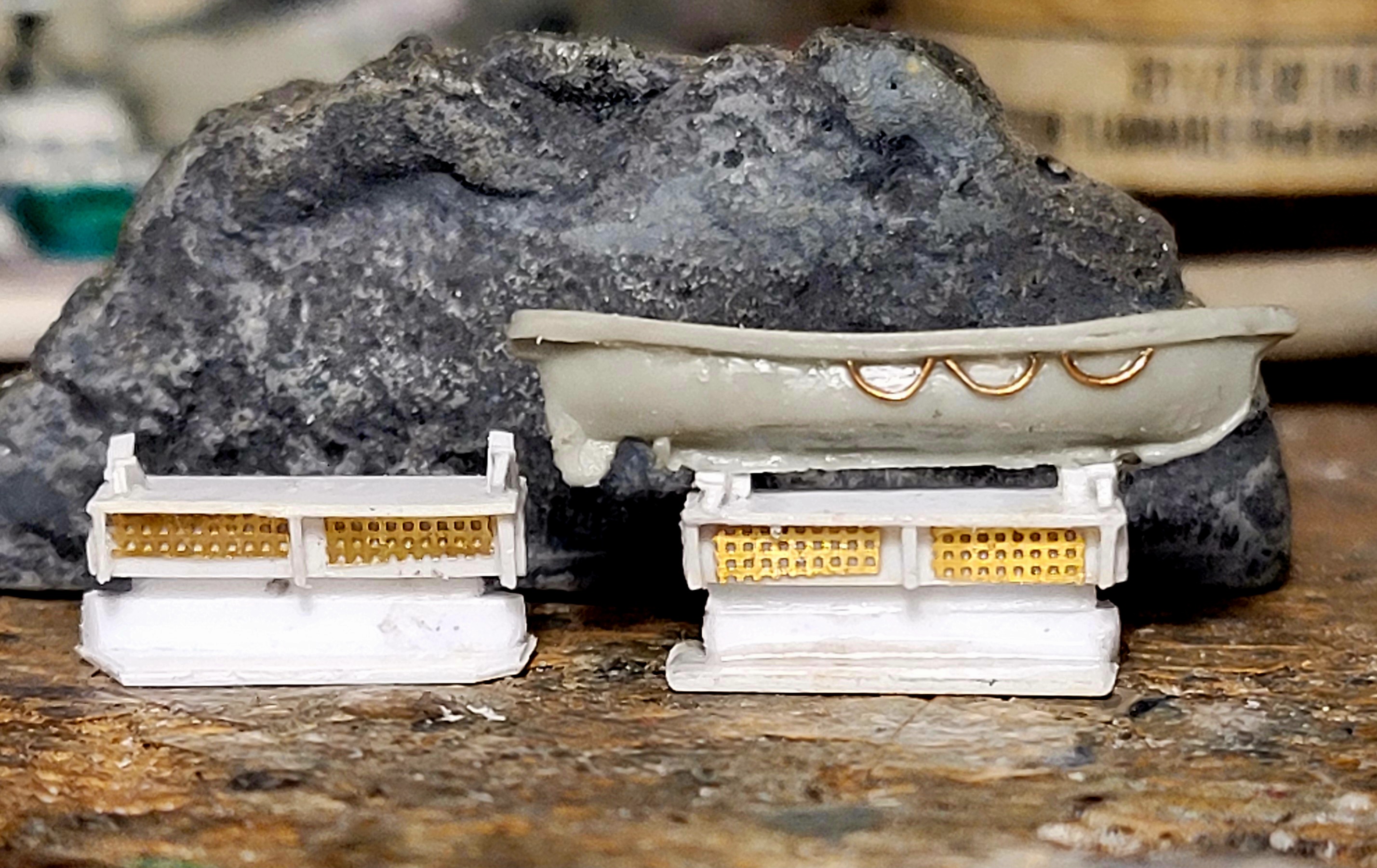

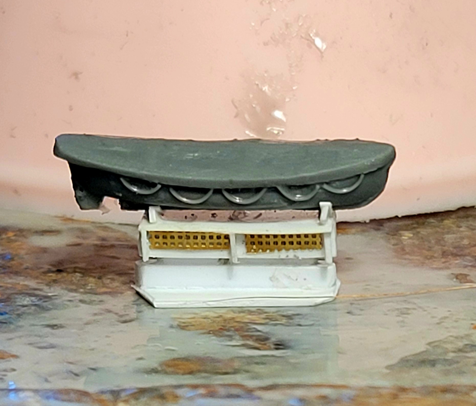

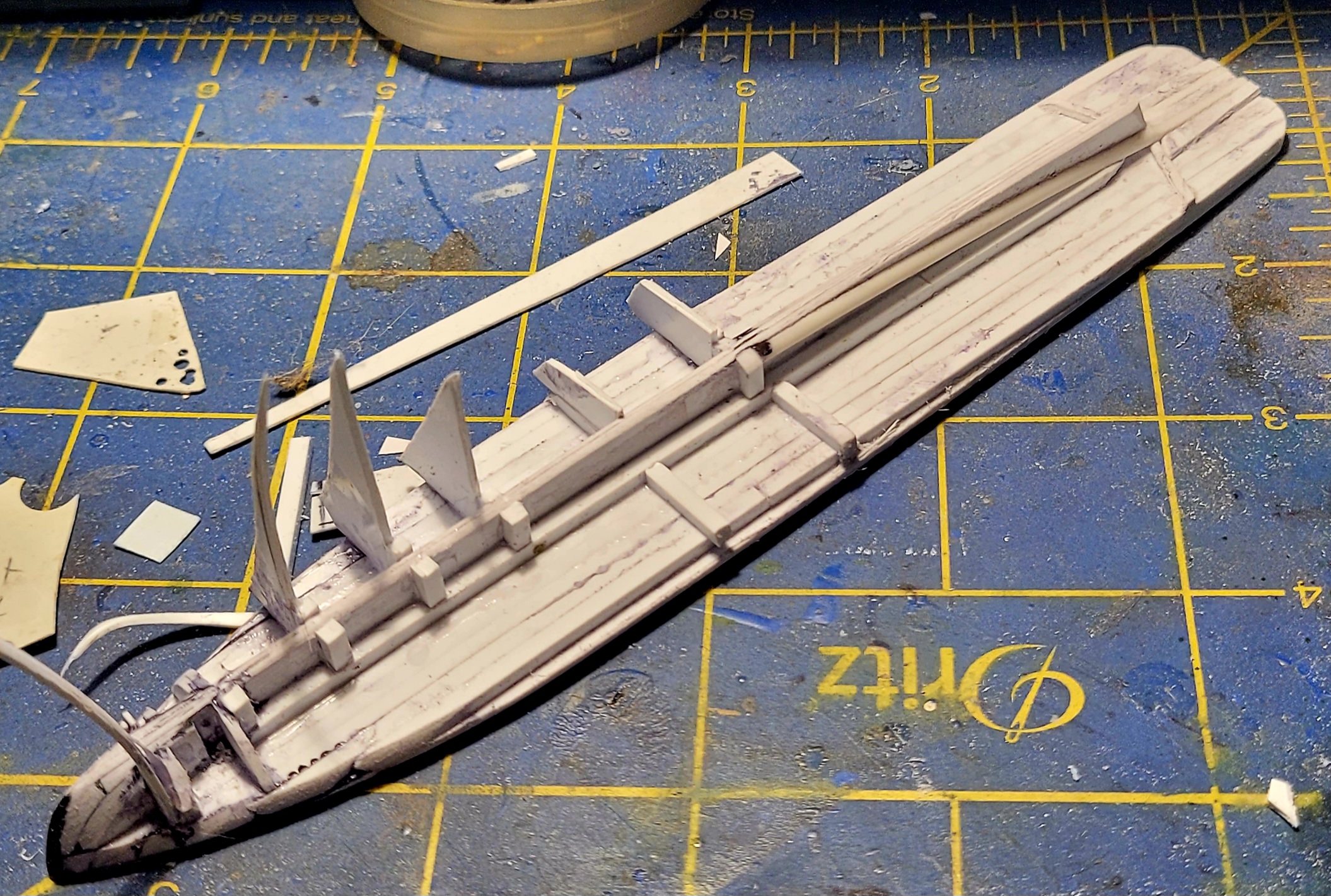

I spent hours measuring and Mastering the hydraulic small boat racks. Hydraulic scissor arms raise and lower to accommodate different sized USCG small craft. Grids let the heat out from the machinery and allow water to drain in a heavy sea. I followed the line drawing faithfully. (?!?)
These never existed. That's what I get for working on this cutter without any liquor!!
No photo of a Reliance class cutter ever shows such a thing. It was just my enthusiasm running away with me.
Basic fixed racks bolted to the deck hold OTH RHI and Motor Surf Boats on the boat deck. Nothing more. 2 sets of these will go in the "Deck stuff" mold. "It could be worse. It could be raining."

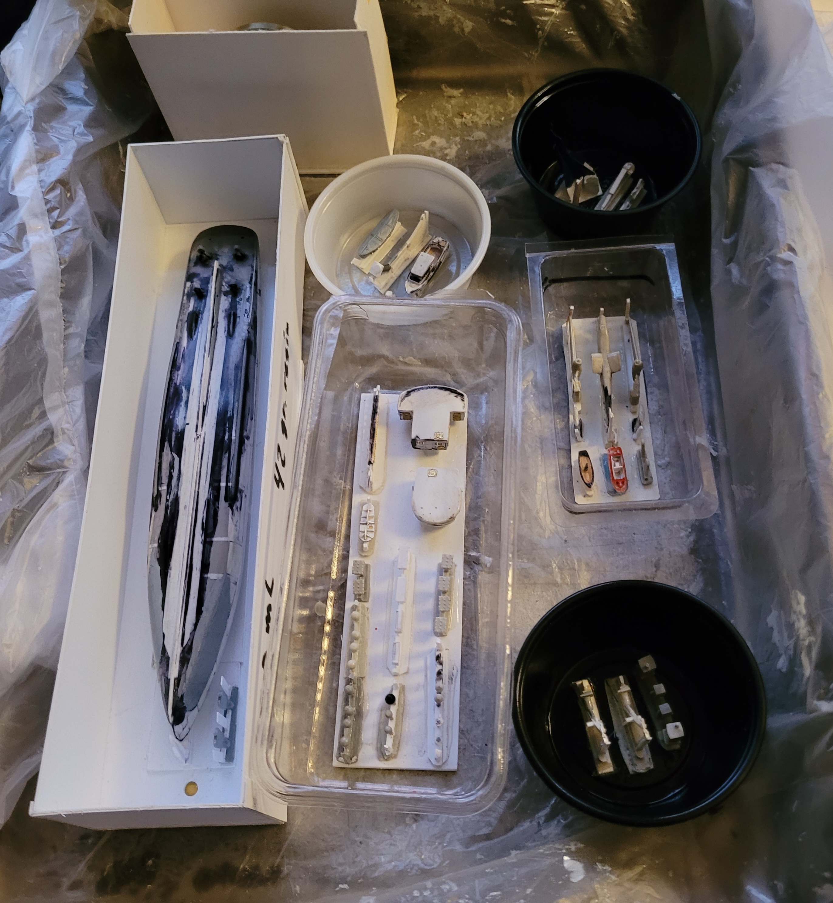

The Big Cutter's lower hull and 1/350 Cranes and shithouses will be molded in MoldMax 20. The bigger ship part needs a more robust mold. All the other molds, 1/350 "Upper Works stuff", Carl's 1/350 covered 25-foot Motor whaleboats, 1/350 Frazier crane, Cape Island lobster boat, 1/700 Martin P5M-1 Marlin flying boat and Convair F2Y Sea Dart and other 1/350 Reliance class WMEC necessities.
Never mind about the tall cardboard-looking mold in the upper left. That's a SECRET!!
Only TLAR Models 1/350 US Coast Guard Reliance class Cutter customers will find out what THAT is!

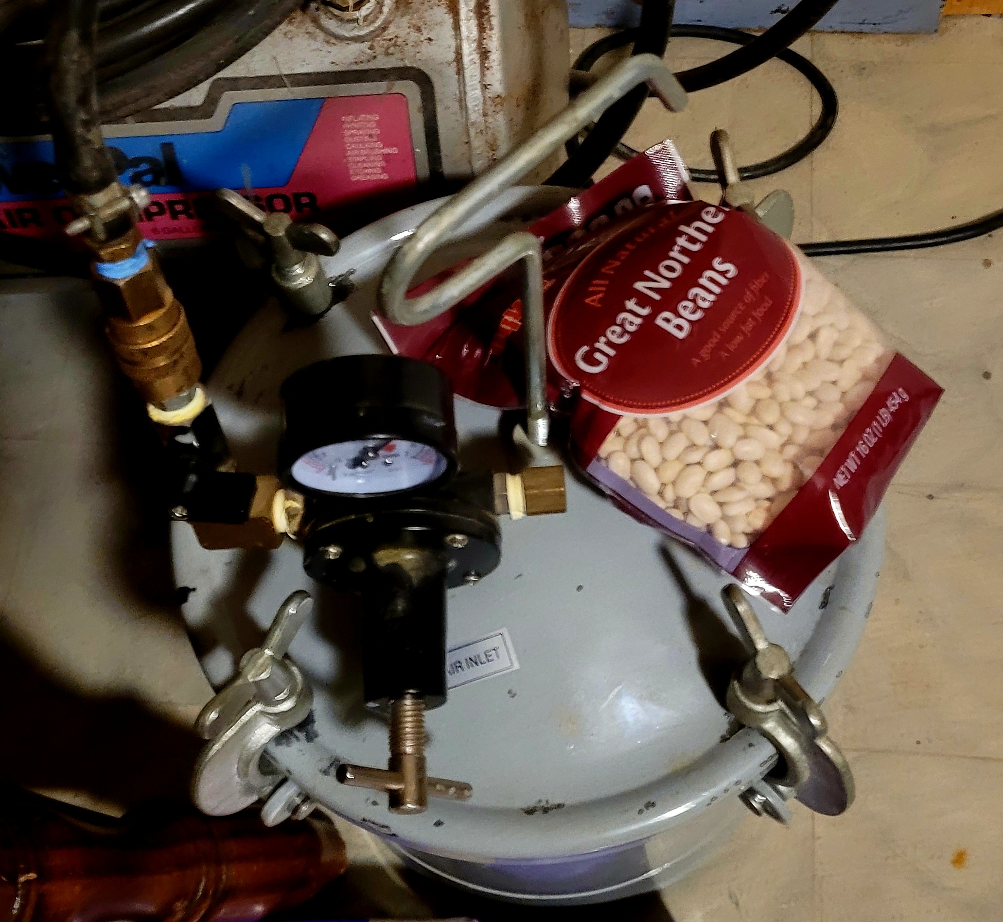

In the pressure pot! 24 hours from now, we'll find out how MoldMax 20 performs.
I used a bag of Navy Beans to keep the pressure relief from hissing! They seem fitting, No?!
Thanks again for continuing to look in!
Such a tease...

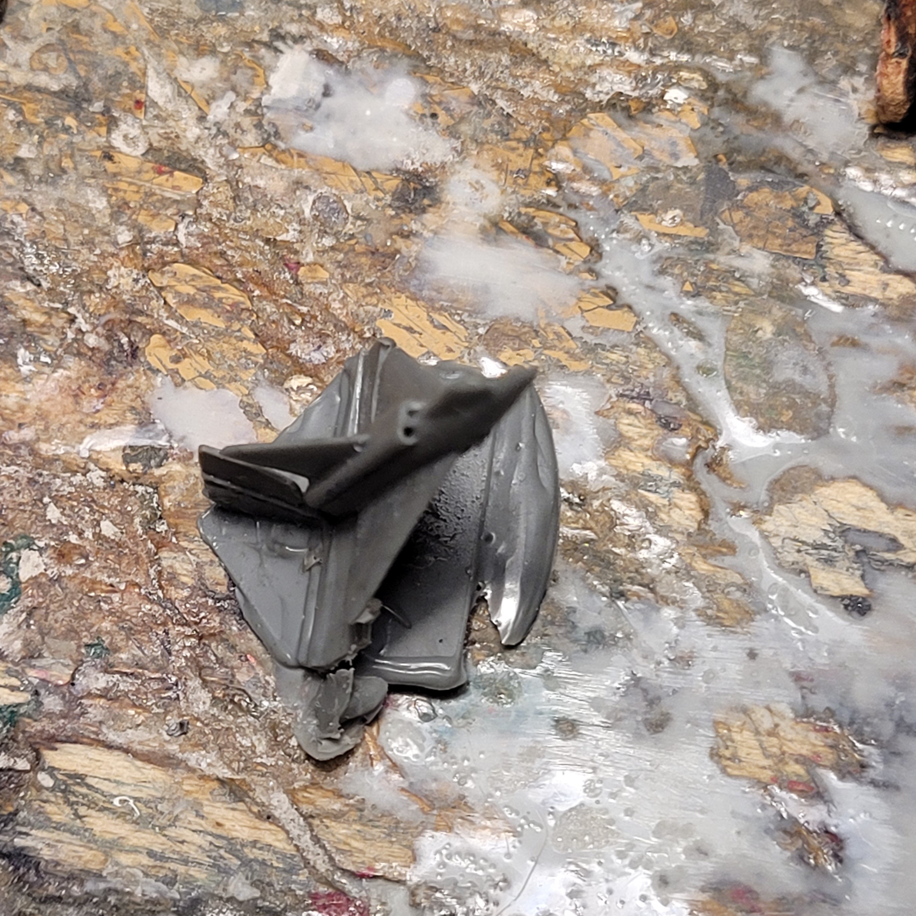

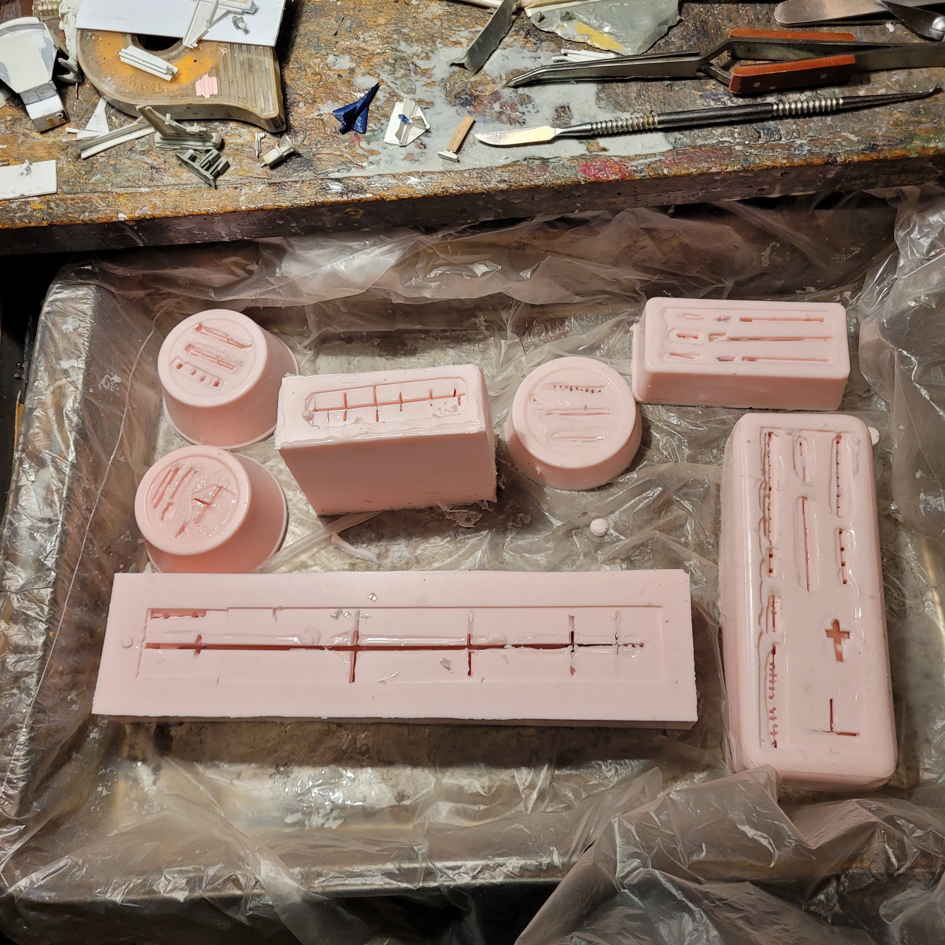

MoldMax 20 makes a stout mold! That is good for the lower hull mold, but extracting the Masters from the "Cranes and Potties" cup mold was strenuous! I may have to remake those in MoldMax 10. 7 new molds were cleared this morning with only moderate damage to the more delicate Masters. Everything can be repaired.

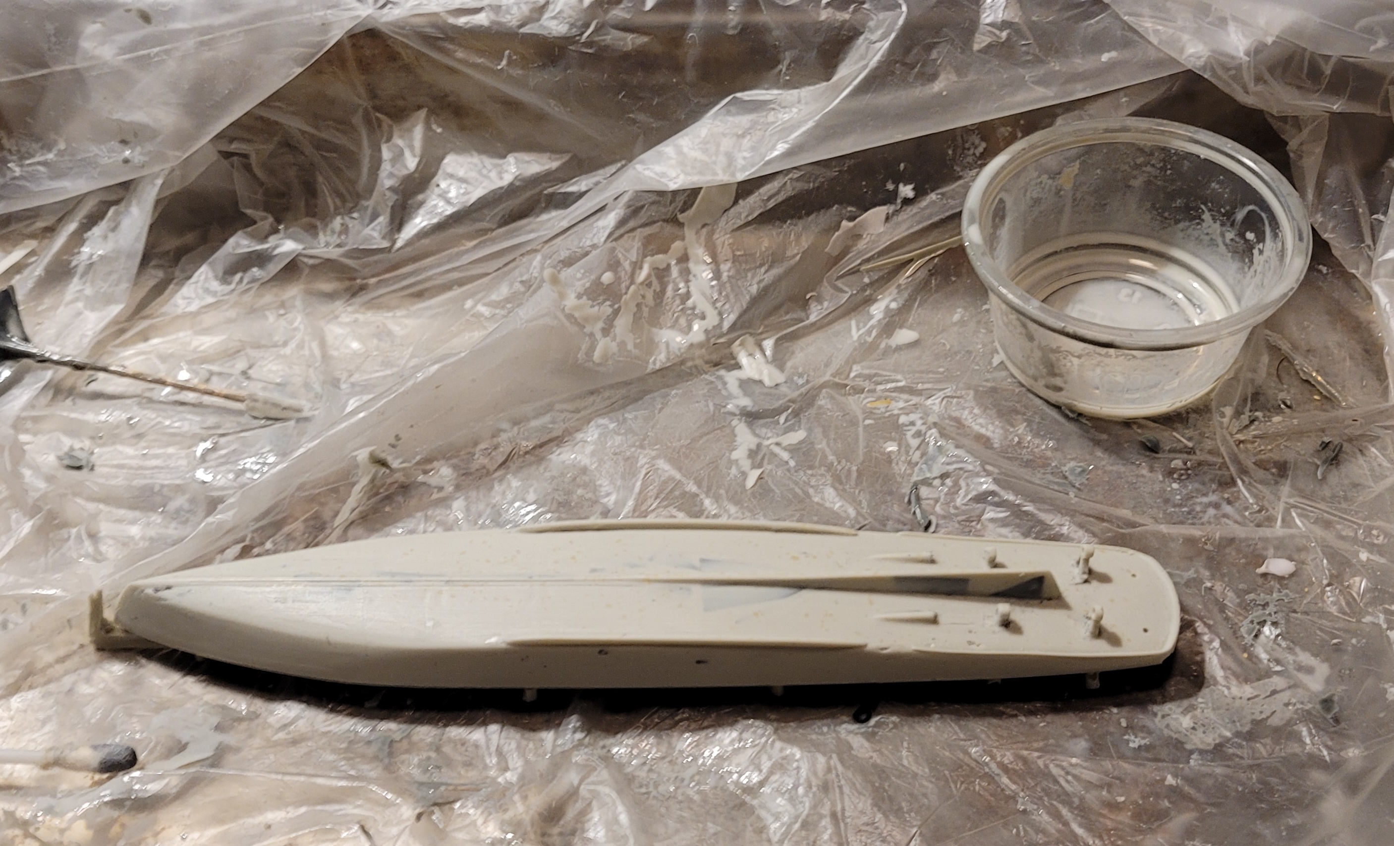

Remember where the lower hull started? The end result was certainly worth the effort! Not too shabby for a Guy that doesn't do bottoms!

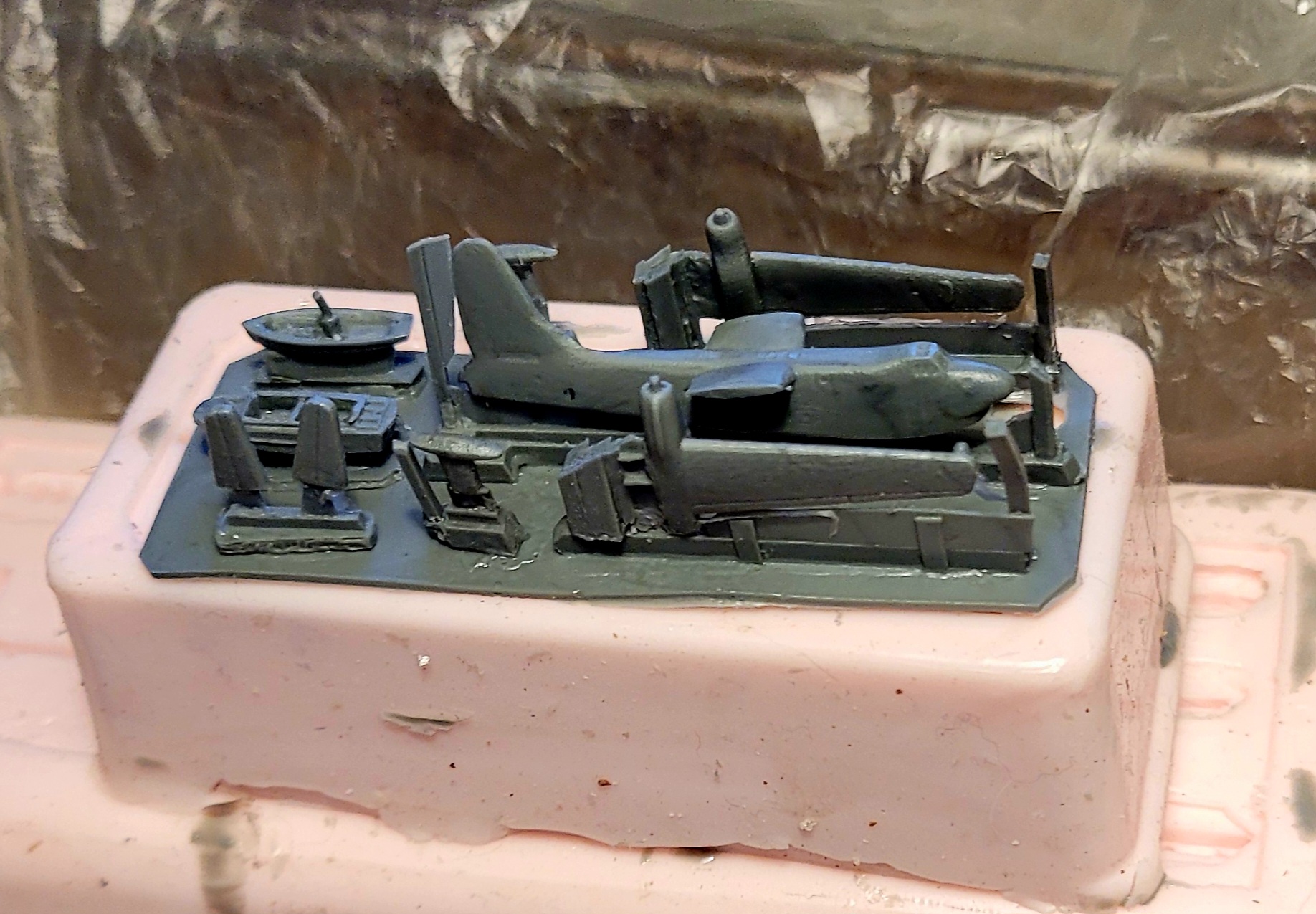

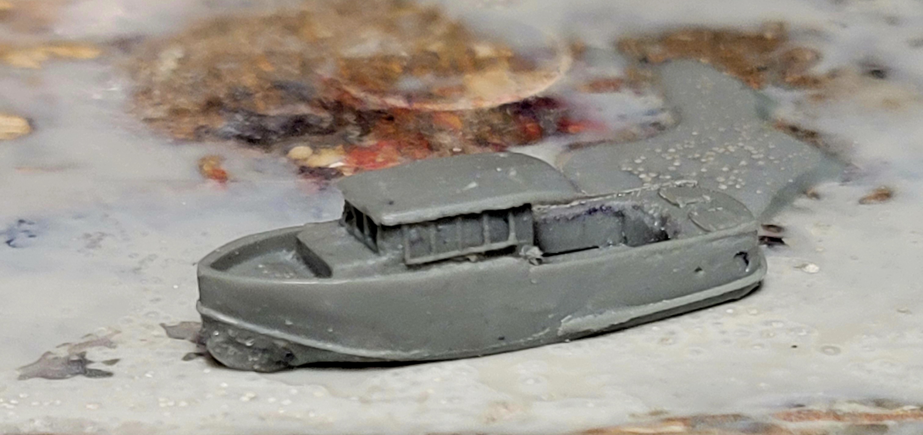

"Upper works Stuff", Carl Musselman's covered 26-foot Motor whaleboat, and a 1/350 Cape Islander fishing boat. Relief cuts in the Cape Island boat mold alleviated the air bubble in the bow.
Finished 1/700 Waterline Martin P5M-1 Marlin kit castings. The 1/700 F2Y Sea Dart for the 1950's "Strike From The Sea" waterline kit I haven't finished yet cast well.

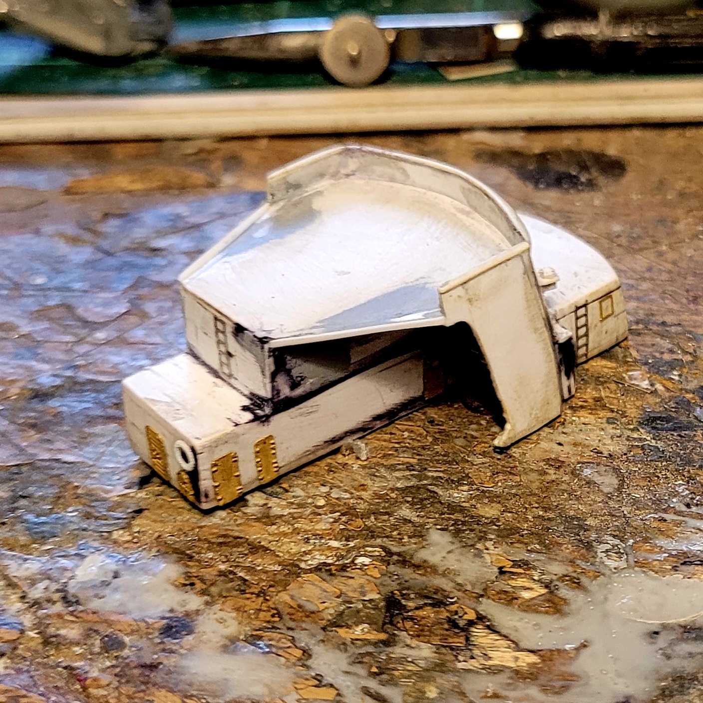

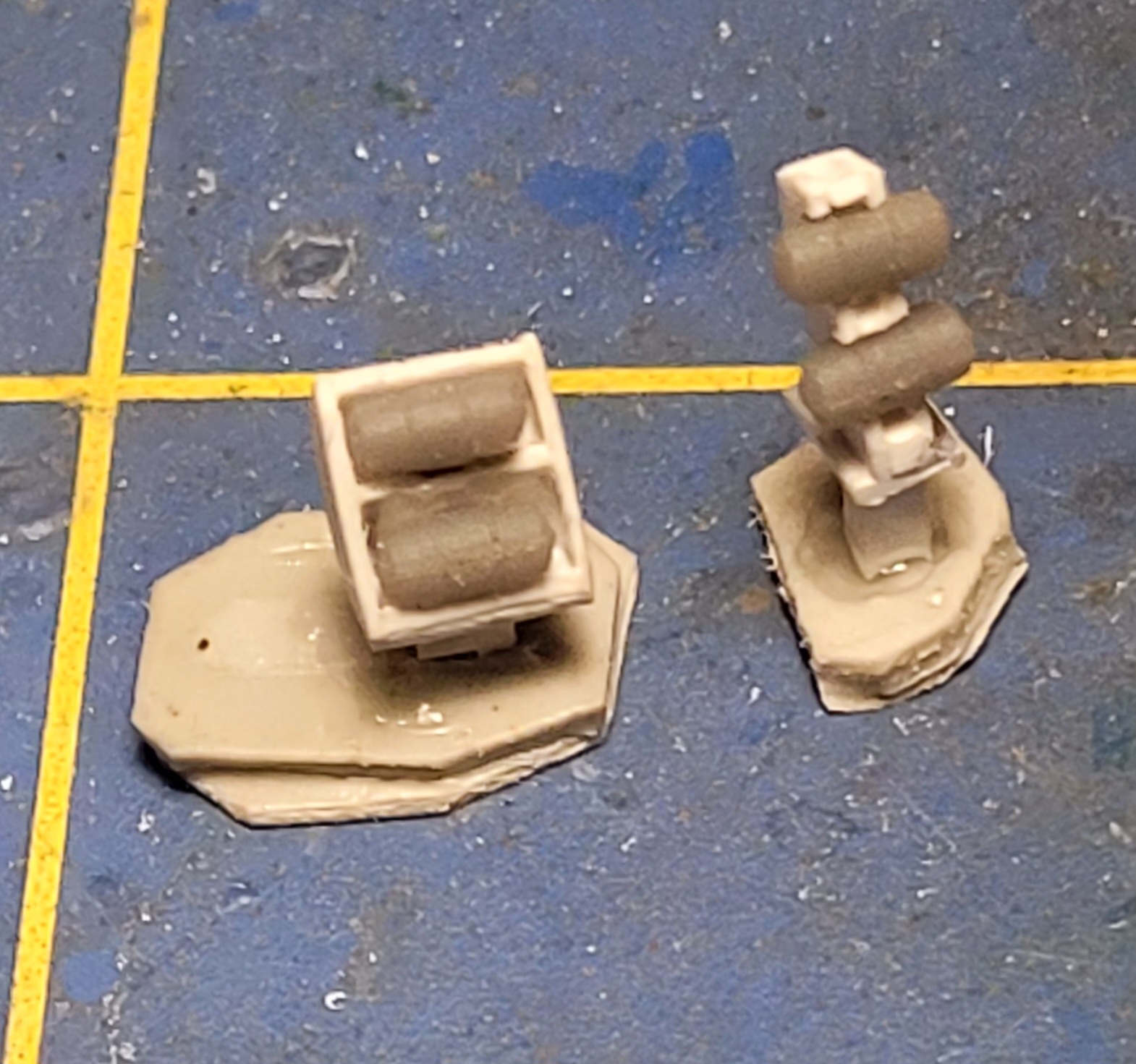

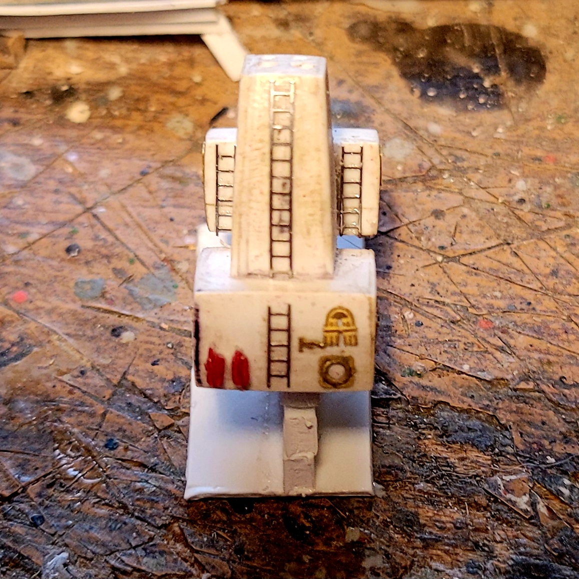

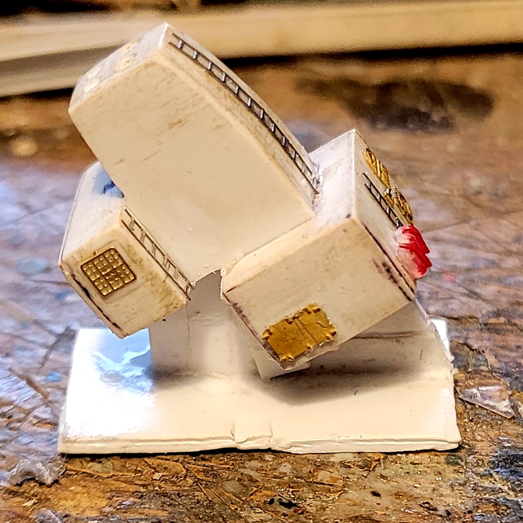

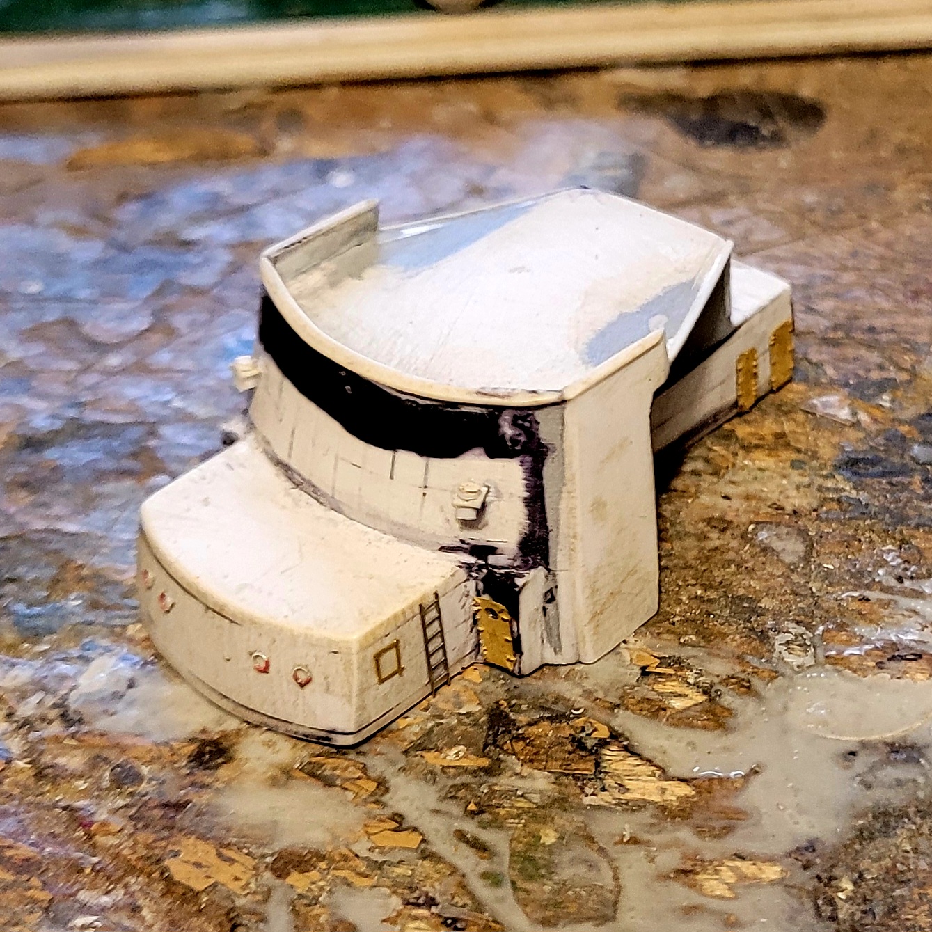

Using the cool visor, 2 1/700 life raft canisters became fire extinguishers on the smoke stack assembly. I could easily see to attach and bend stretched sprue for the hoses. This subassembly is ready for RTV.
Likewise, metal bits are attached to the superstructure. This section is close to molding.

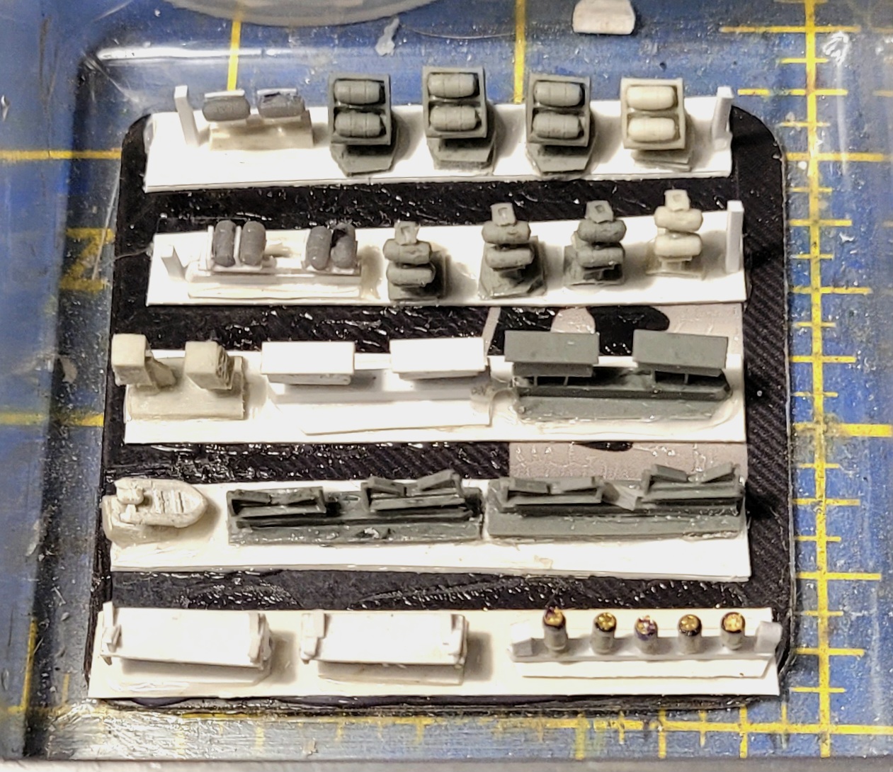

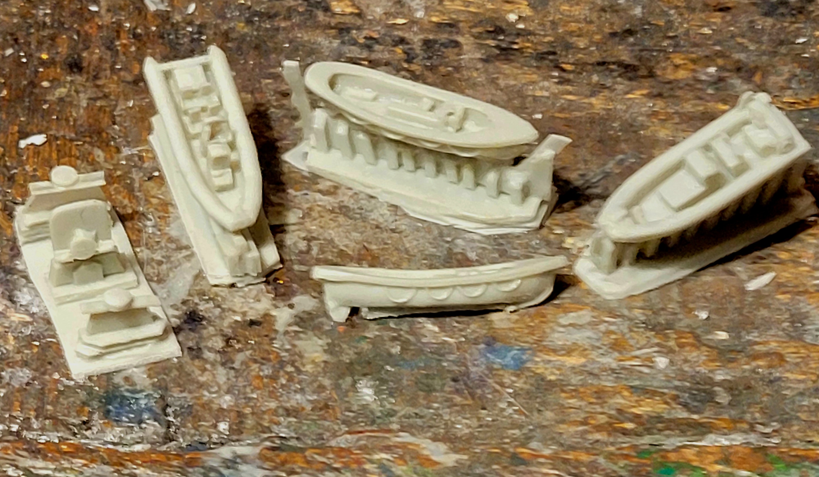

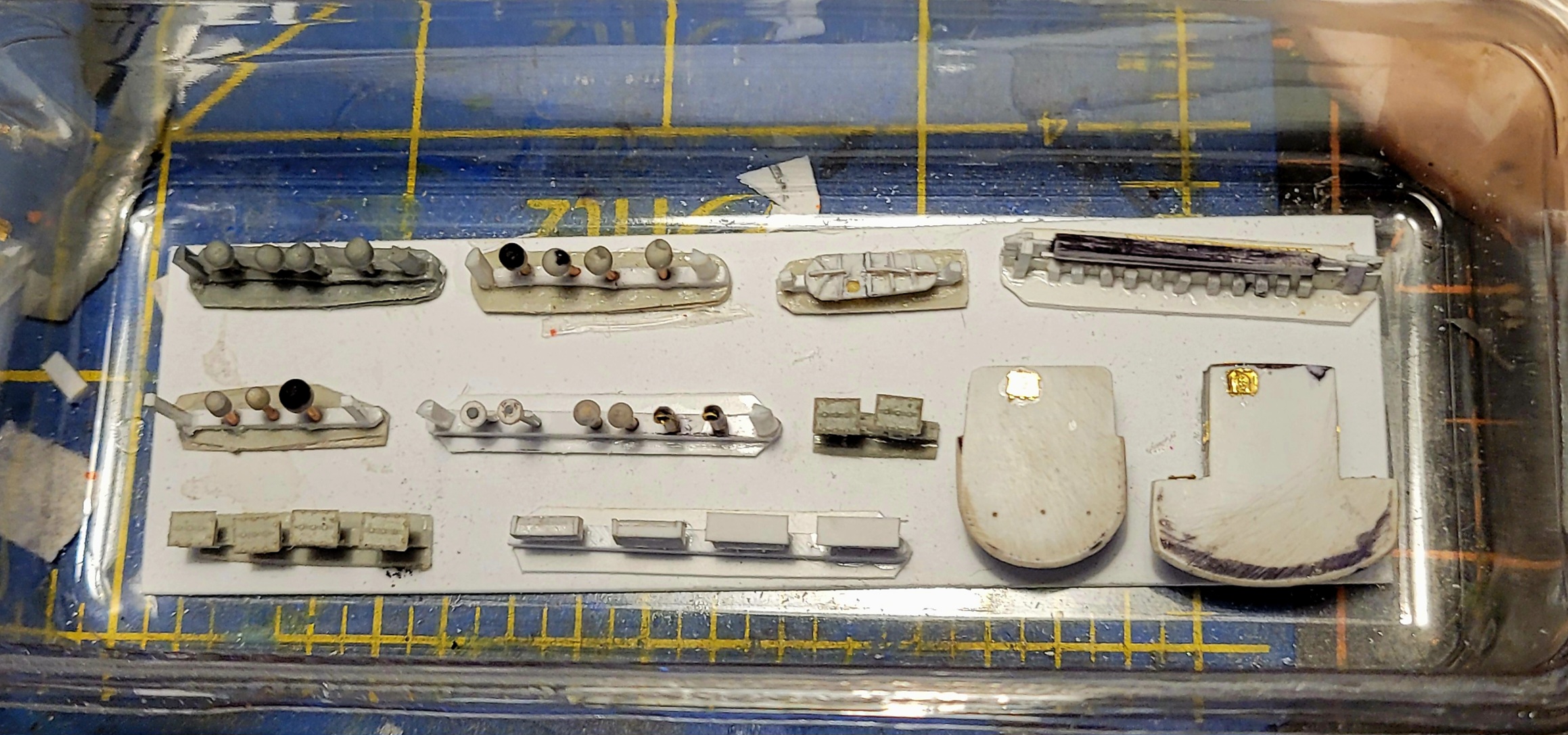

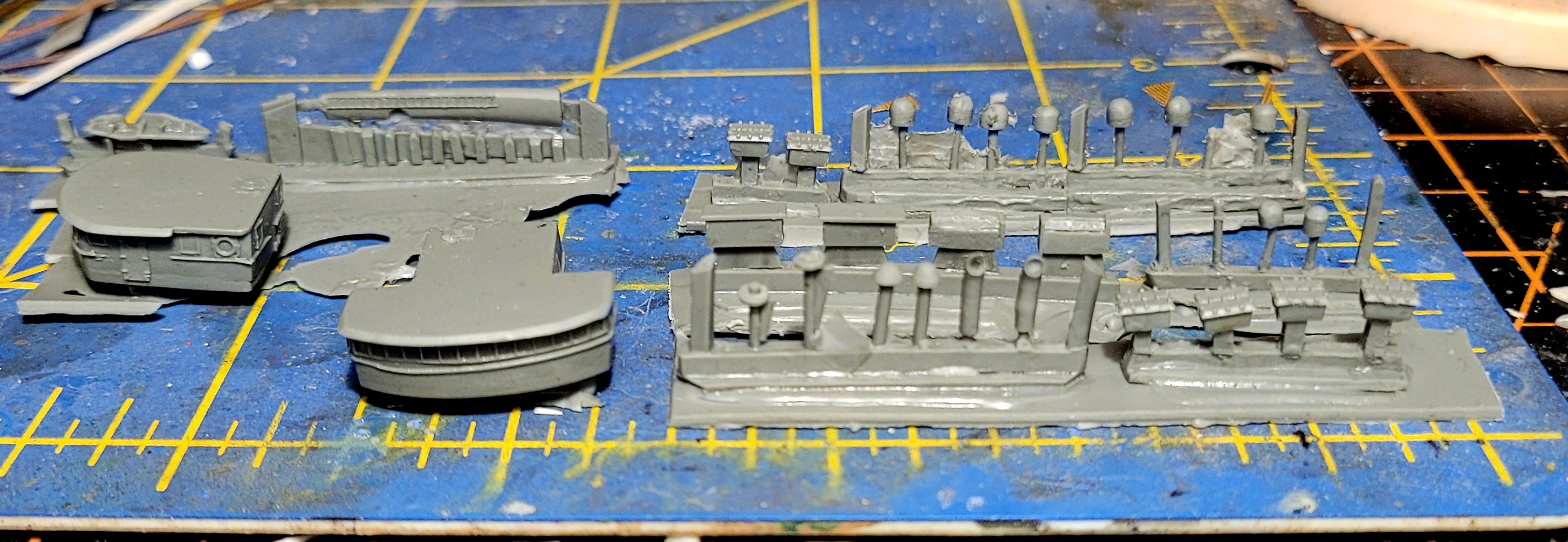

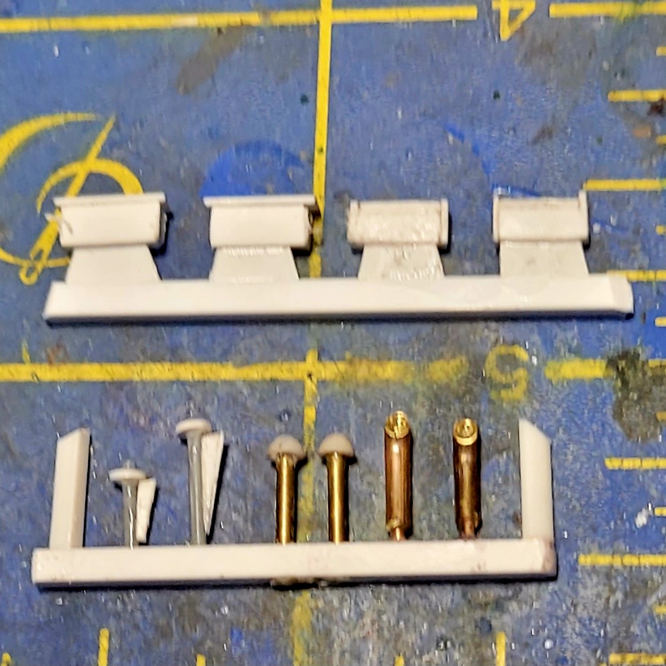

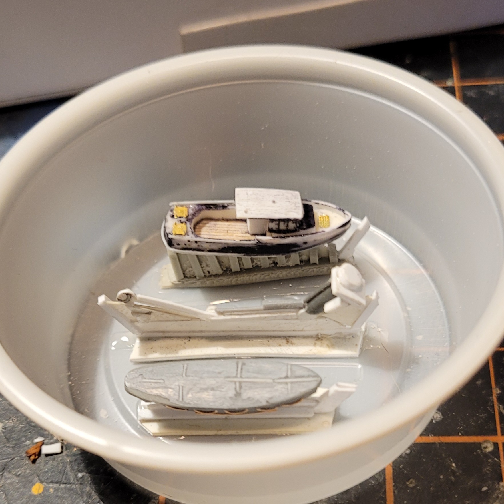

See here the Main Hull small parts mold. Life raft racks, lockers, boat cradles, a zodiac I don't need and powered main deck ventilators. I made 5 of these so a guy can drop one and still have enough for the more contemporary version of the Reliance class WMEC.
The vents are capped with DKM depth charge caps to give them some relief. The visor really helped trimming and installing these tiny P/E parts! Thanks Carl!
Why is this important? This is the stopping point for small details for the Big Cutter kit. The Line is drawn!
Larger parts, like gun pedestals, platforms and guns, will wrap up pretty quick, leaving just the flight deck assembly to detail.

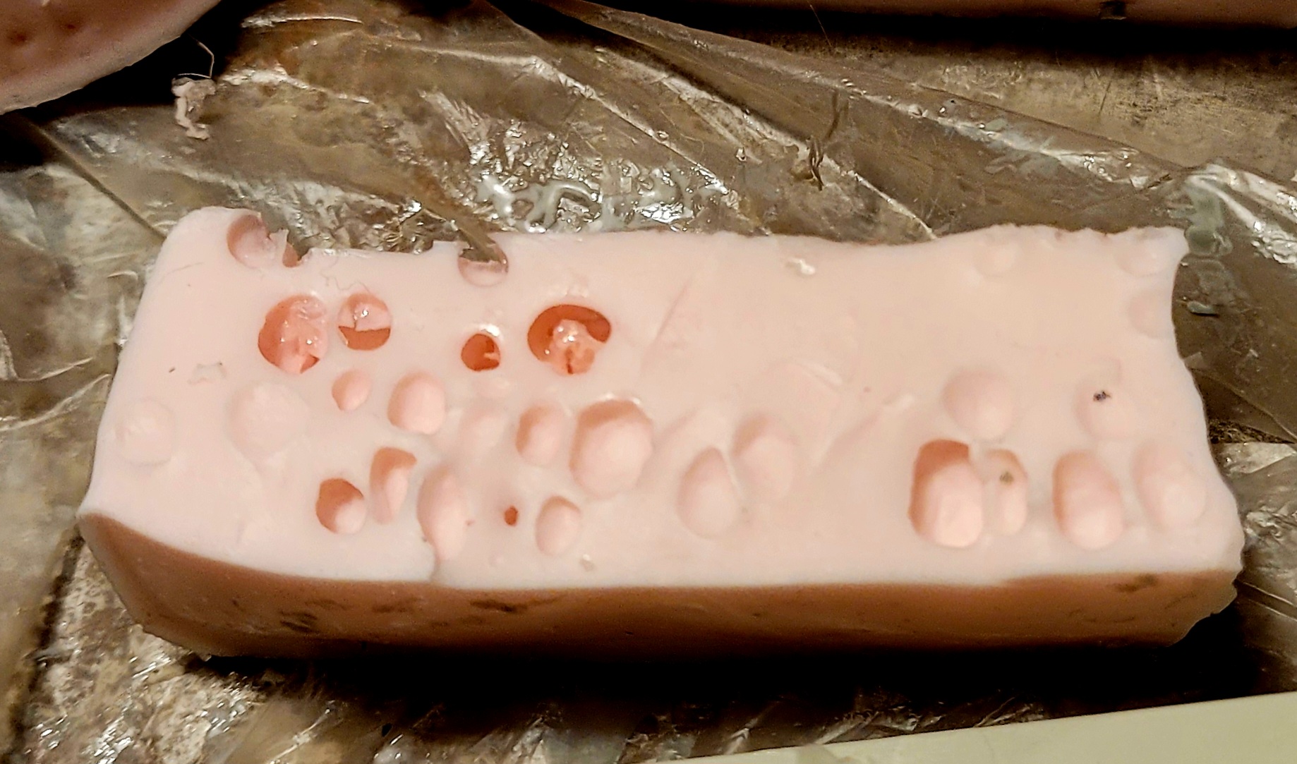

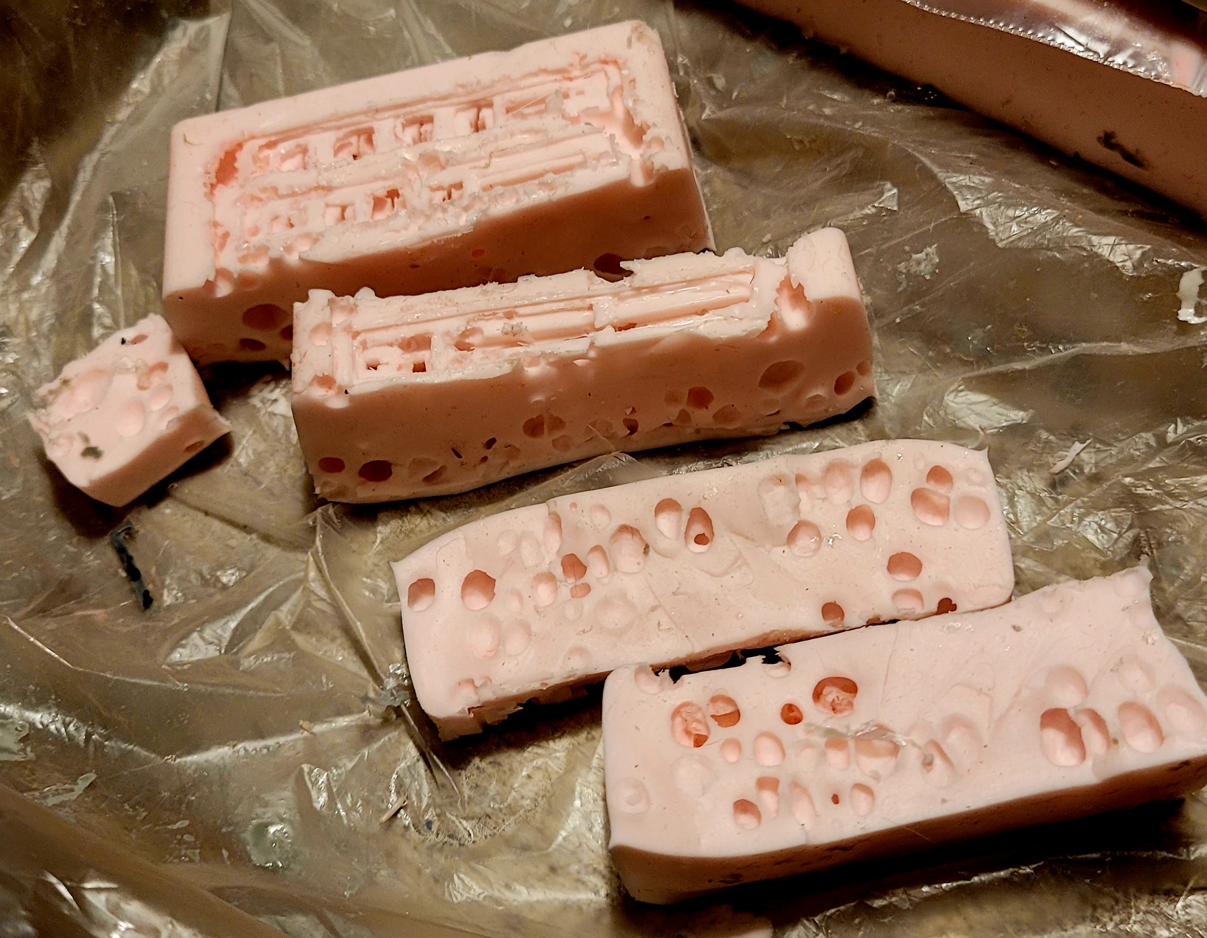

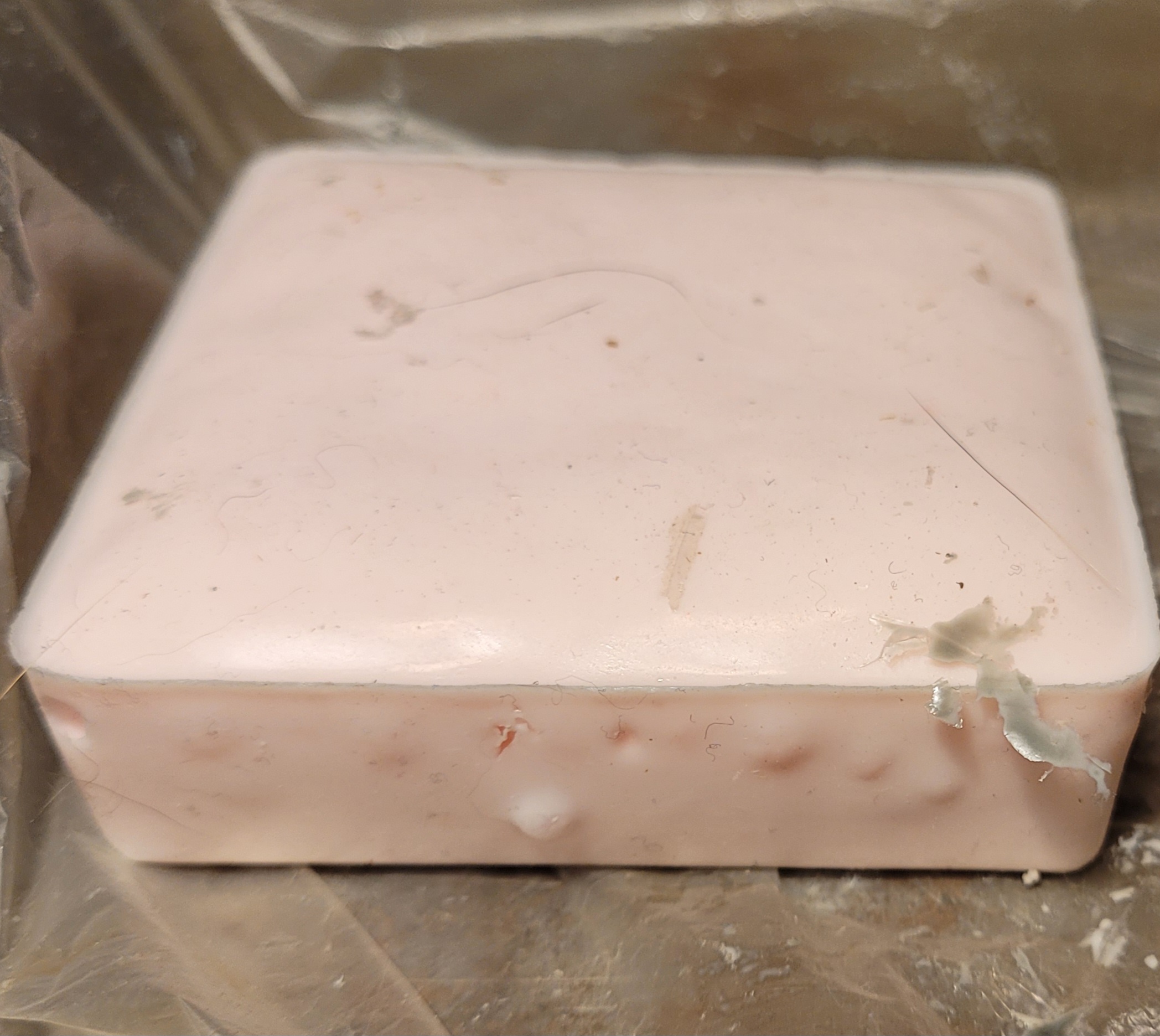

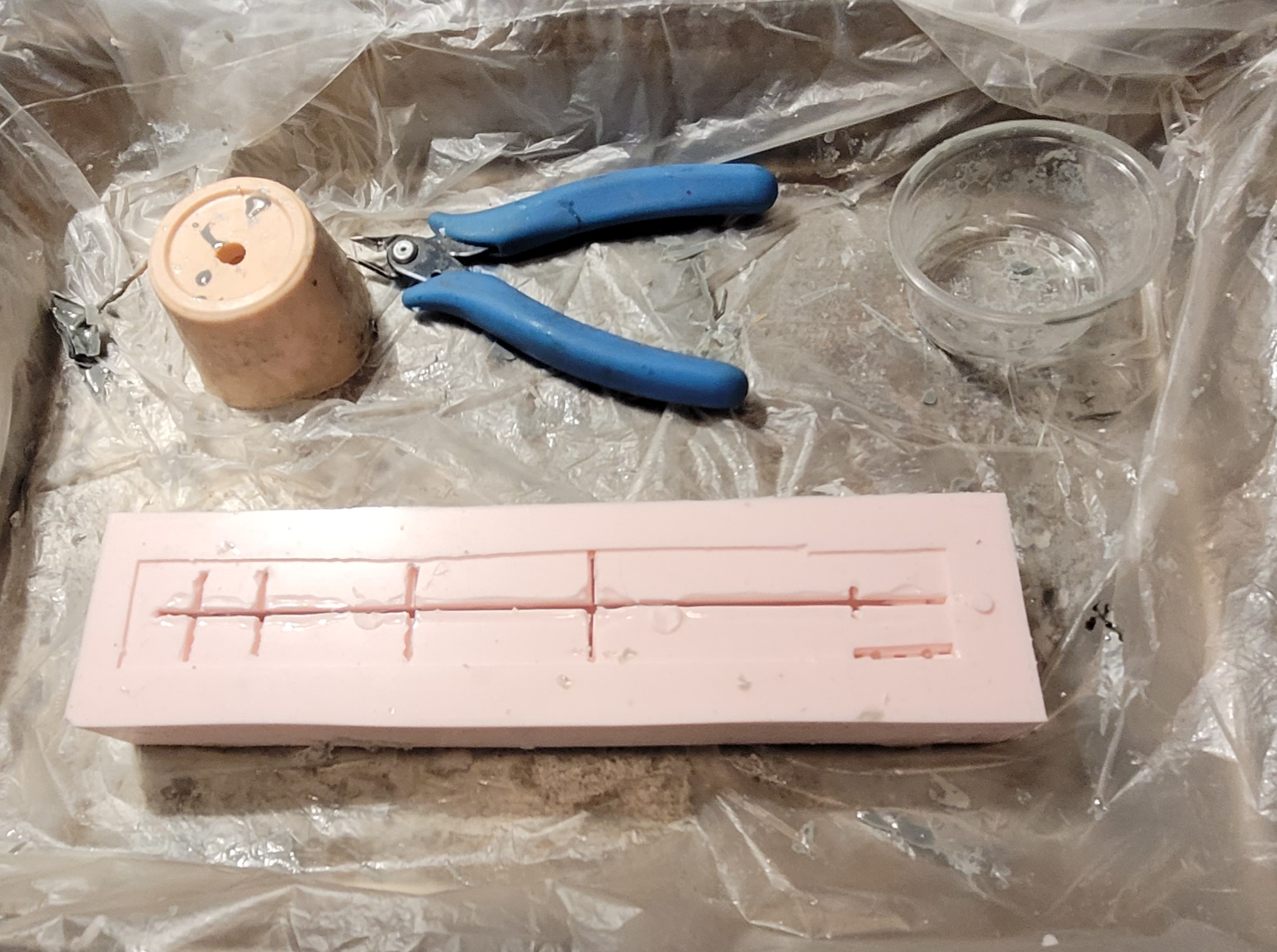

At 0500 today, the Big Cutter small parts mold was suspiciously soft & doughy. When I returned home from work, it had poofed. (RTV molding technical term) :frantic:
Something reacted with the RTV to create gas bubbles and poofing. :bang head
Old silicone material? :doh:
Activator contaminated by moisture? :stinker:
Too much mold release? :bm:
Nothing here is over 6 months old. :ph:
DA SCHITZT DEM HUND IM FEUERSZEUG!! :facepalm:
Job 1 is to try to rescue the Masters and clean them up. Teensie bits of pink, gooey (another technical term) RTV stuck to every detail and crevice.
Job 2: Clean and reset the mold box and Masters for the next attempt.
Job 3: Cut the Havarti-cheese lookin' mold into smaller pieces, so grandkids can harmlessly throw them at one another.
Job 4: Let myself off my petard, because not everything always goes how I expect it will.
"Do Over!" Not so unfamiliar in this business, such as it is these days.
