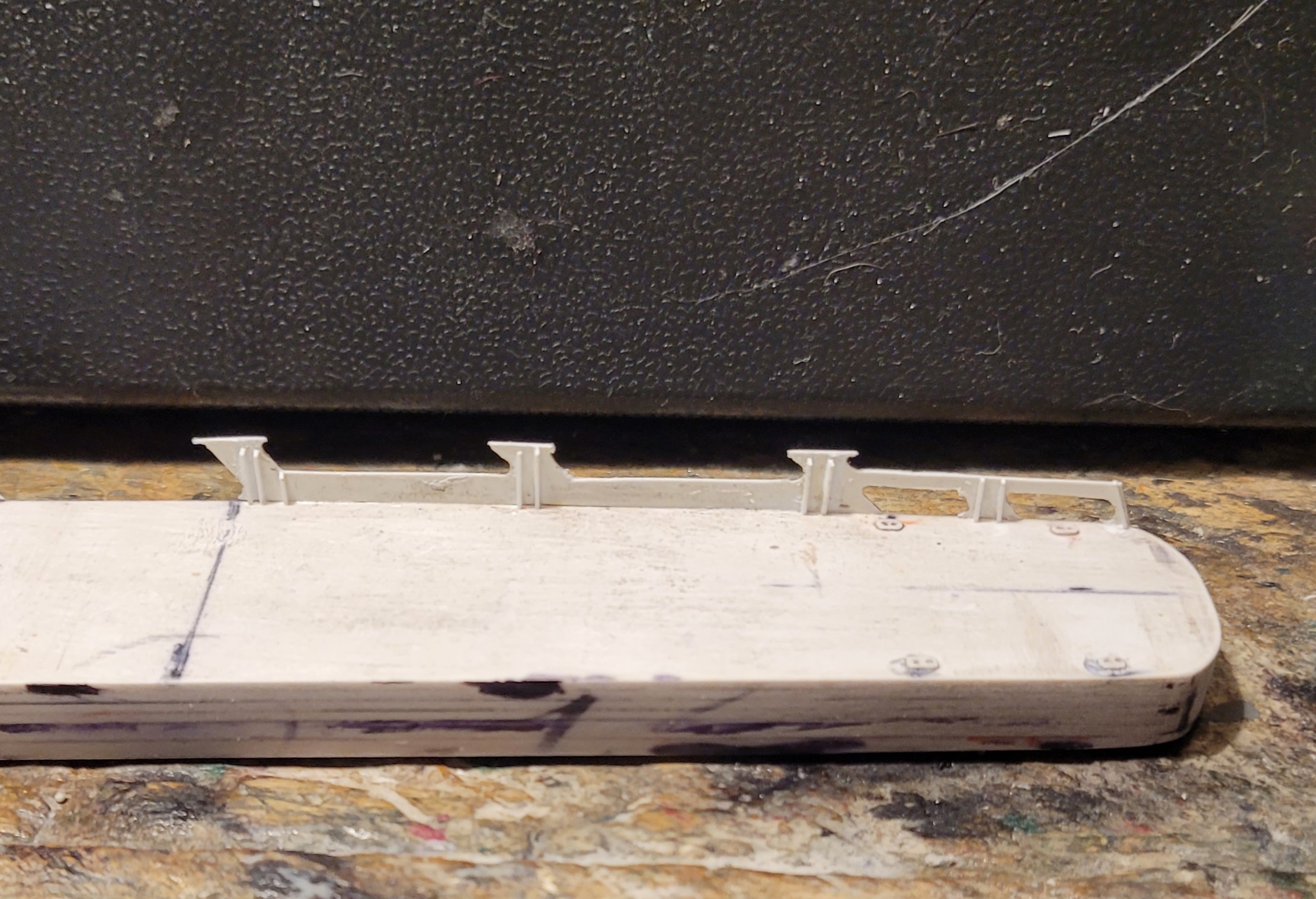

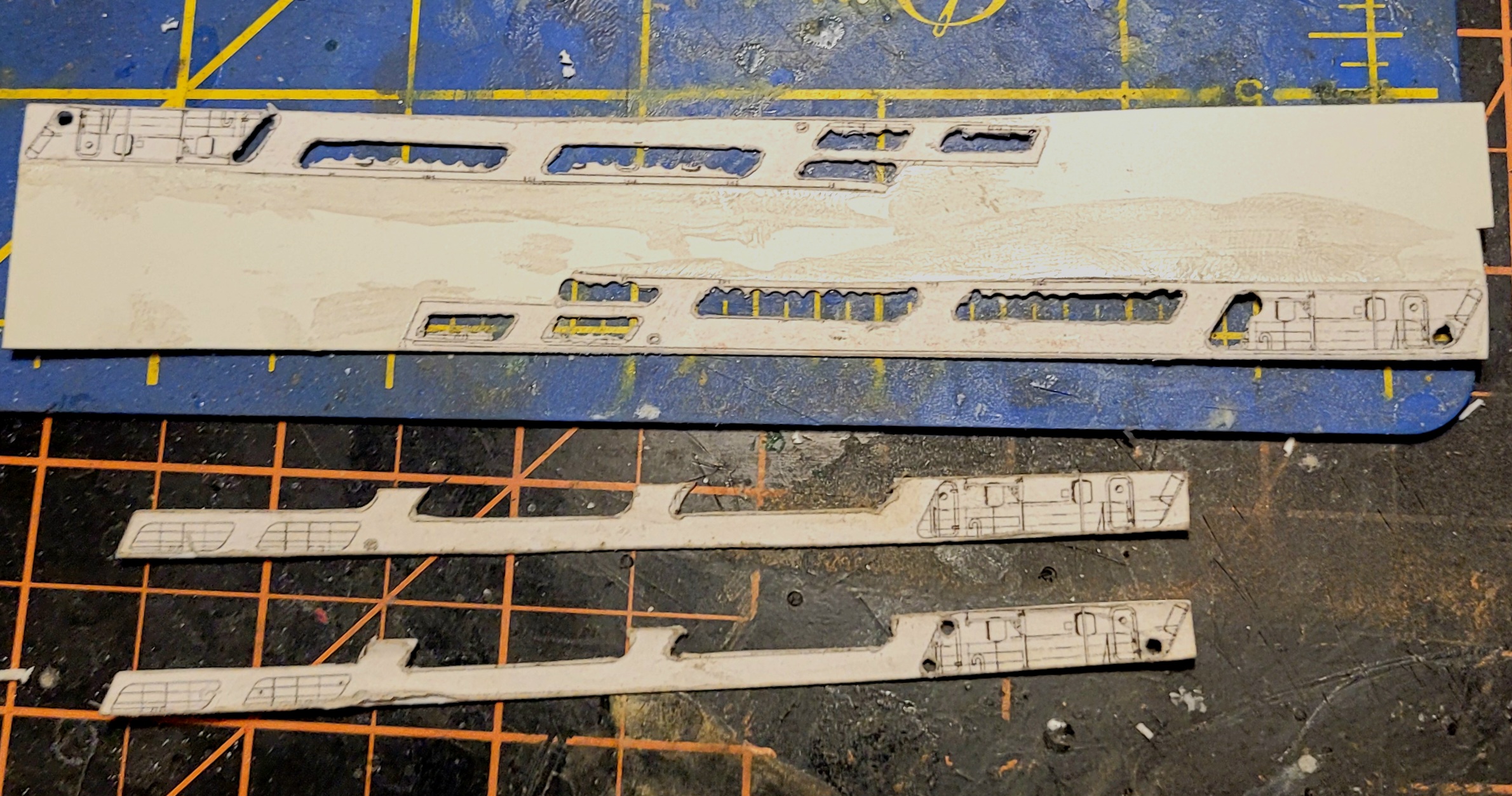

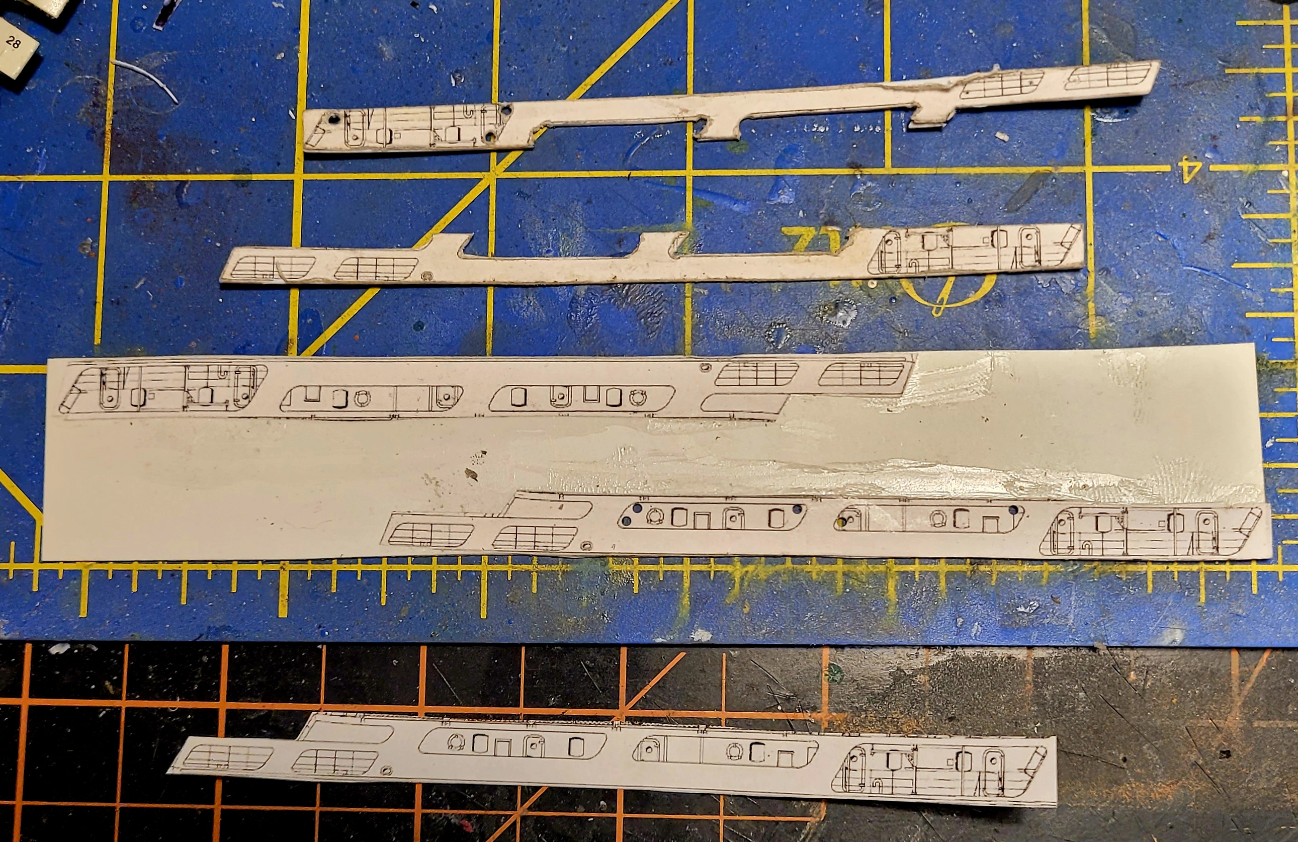

The clunky .030 plastic bulwarks for the after deck are too short after correcting the flight deck and foredeck heights. They would have been 10.5 inches thick, which isn't so bad, but there's no room for bulwark stiffeners or other details as they go aft. Parts of these thick, nekkid assemblies would have been visible from astern.
THIS SIMPLY WILL NOT DO.

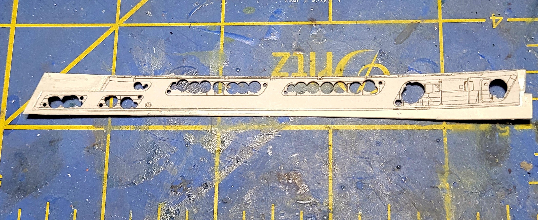

Laying out new printed scale drawings on .015 evergreen sheet will leave enough thickness left over for bracing frames and other details inside the aft bulwark. Some painstaking plastic-smithing will be required to get the height just so, but it will pay off in a REALLY neat model!!
Don't worry about the toothy-looking bits. They won't be there after the plastic surgery is finished. I will blank the aft deck-edge openings so they can be gently carved out after molding.
Don had a sub-miniature Waldron punch set on his desk. I "inherited" it along with the .015 plastic sheet, a ton of brass tubing and a box of hypodermic needles to make cannon/gun barrels, pitot tubes and AOA sensors.
Some good, quality time was spent punching and sanding the openings in the new plastic parts. These cannot be installed until I finish the foredeck capstans, chain guides, anchors and scuppers.

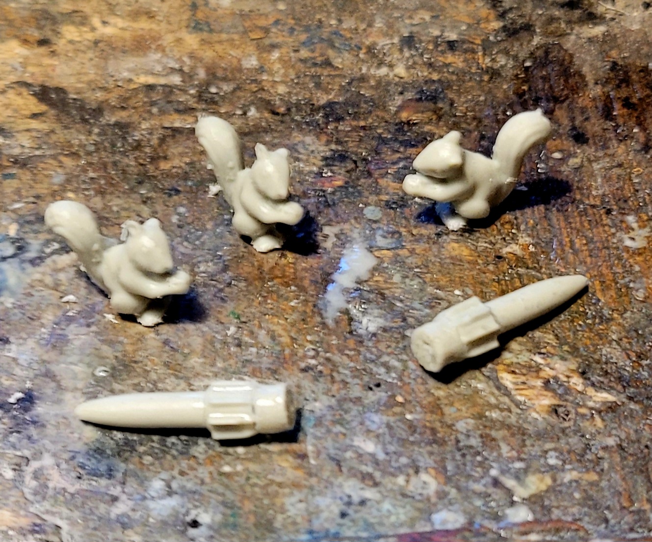

Resin casting ensued this day as well. More Bunny parts, freebies for my buddies, torpedo launchers for the 1/350 77-foot PT and Brandon's 1/350 boats. The "test shots" headed for Elijay, GA in the mail today.
I'm not sure how many friggin' 1/25 squirrels Ron Schultz wants, but I know how many I can cast!

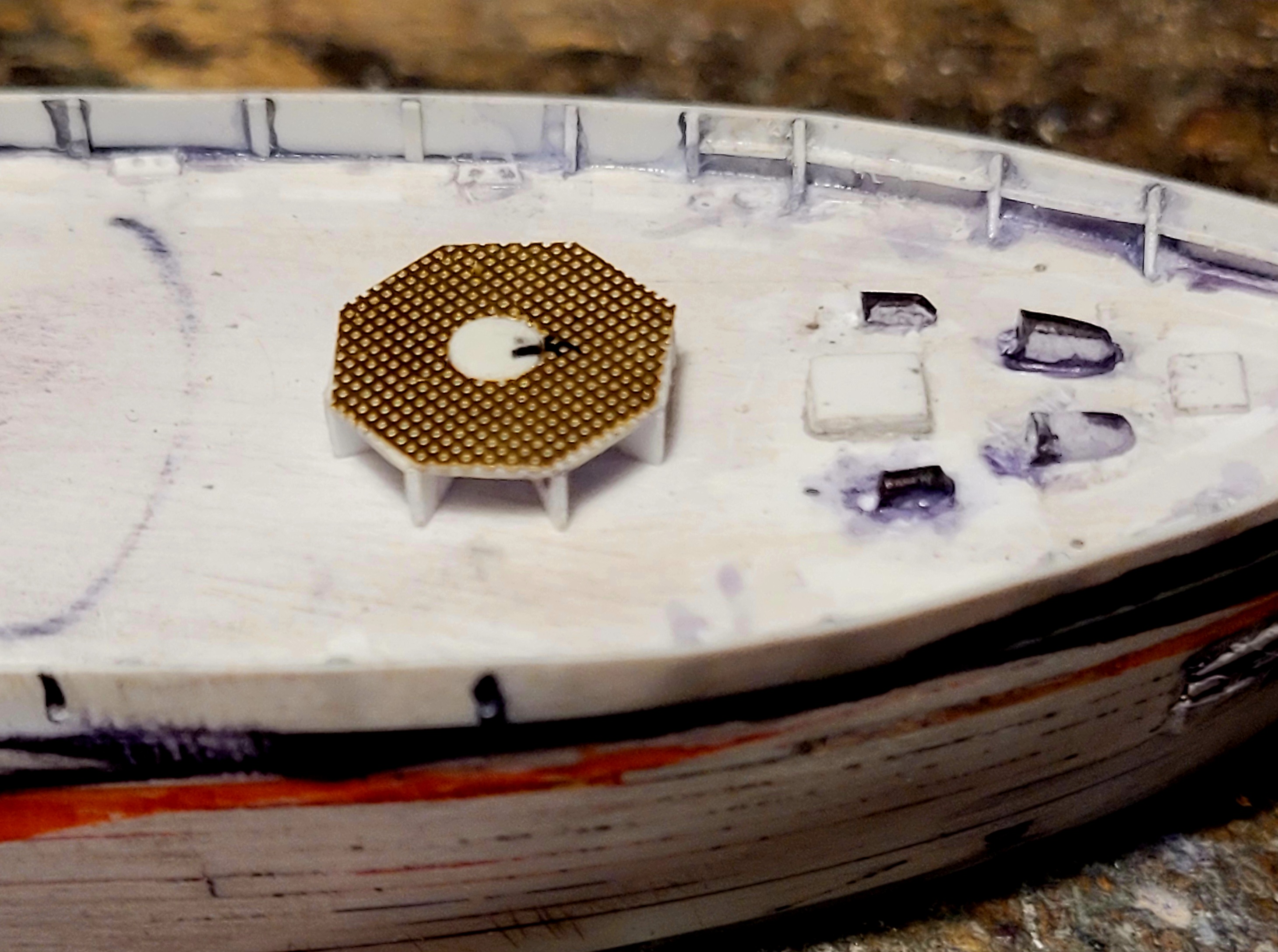

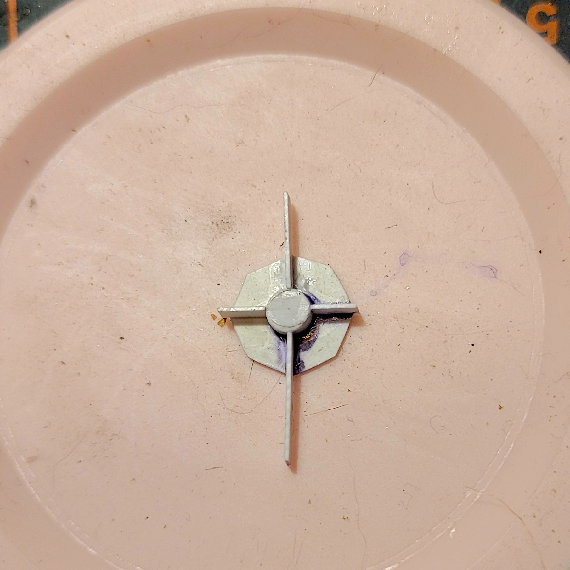

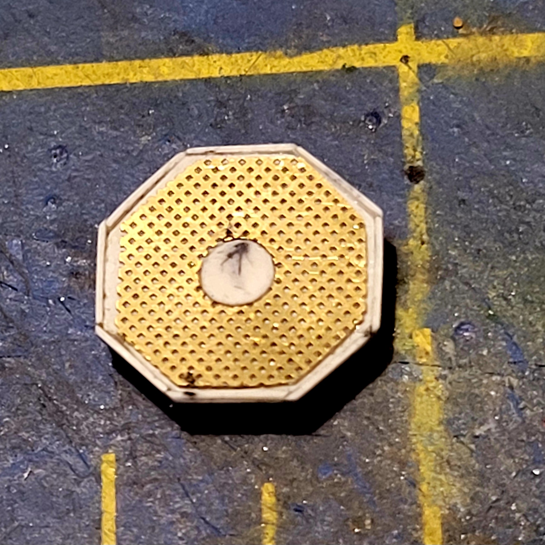

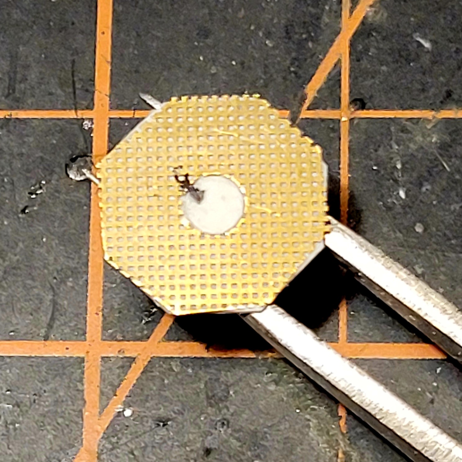

Gun Platform:
Double punch discs of .040. Attach to the underside of the platform. Attach the legs on my silicone gluing pad so mothing sticks where it shouldn't.
Punch a hole in the 1/144 p/e grating sheet I bought from Richard at White Ensign Models. Punch a disc of .010 and sand it a wee tad.
Fix the grating over the disc on the gun platform and trim it to fit.
Is the grating exactly accurate? No. No it is not. Is the gun mount disc exactly centered? No. No it is not.
It does look convincing! Throughout Her career, this class of Coast Guard cutter has had the same forward gun platform.
The next decision is whether it is a separate part, or should it be fixed to the main hull assembly?

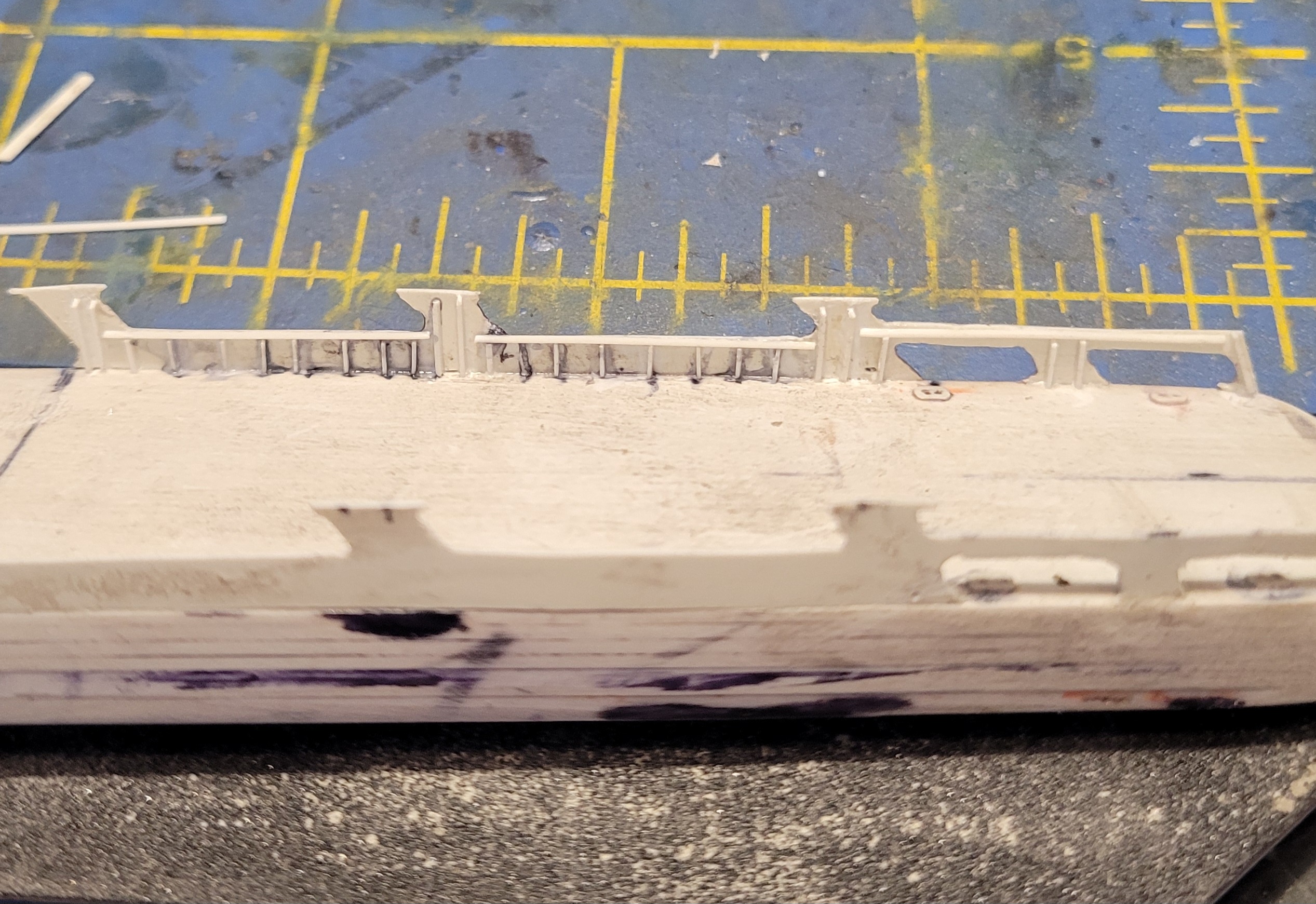

Fitting the starboard side bulwark and flight deck supports.

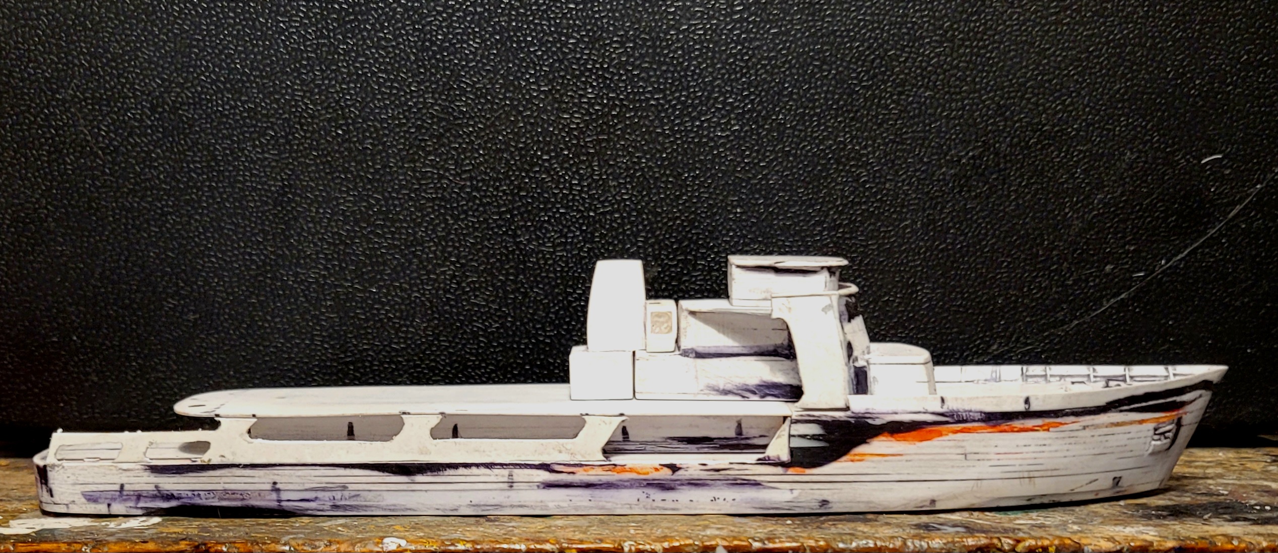

Major subassembly test fit. She's starting to look quite Cutter-ish.
Do over! I'm 1 for 2 on after bulwark fitting. Batting 500 would make me a superstar on a Baseball team, but here in the exacting TLAR workshop, I'm just a Mutt. It keeps a guy humble. I trimmed the first one the wrong way. :bash::bm:
Second bulwark went much better! Not much of the framework inside the bulwark will be visible once the after flight deck structure is fitted, but it's ALL in there. .015 X .030 for beams to support the flight deck. .010 X .020 for everything else. The after structure fits like a glove!
There is an element of intimacy that comes along with researching and Mastering a vessel. A Man comes to know Her quite well. Having the sub-assemblies fit in the way they are expected to brings a warm satisfaction. This part is FUN!
After having talked myself into making an attempt at such a complex kit, the hard part was figuring out how to make all the Cutter parts.
Putting on the brass details should be a blast!
After that, figuring out how to mold Her is the next hurdle.

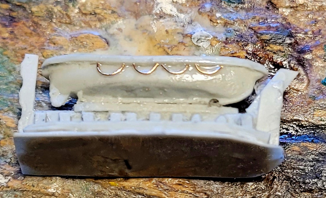

The stern railing is installed now too. I won't drill the stern for the cat-eye shaped openings. Blanking these for moldin would be a lot of trouble. P/E parts on the exterior will stand in for actual openings. The fairlead for the towing bitt will have an opening to pass lines through.

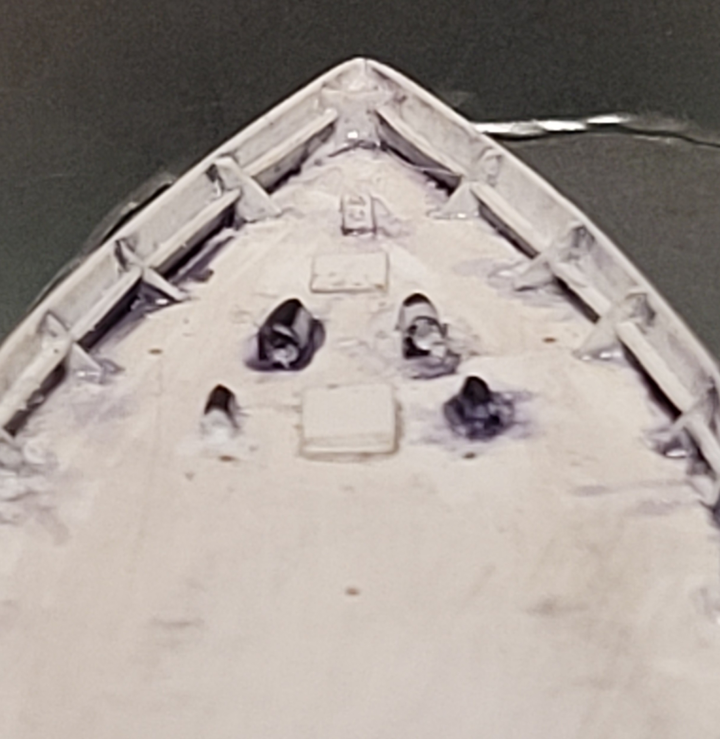

A little more work and the plastic on the main hull will be finished.

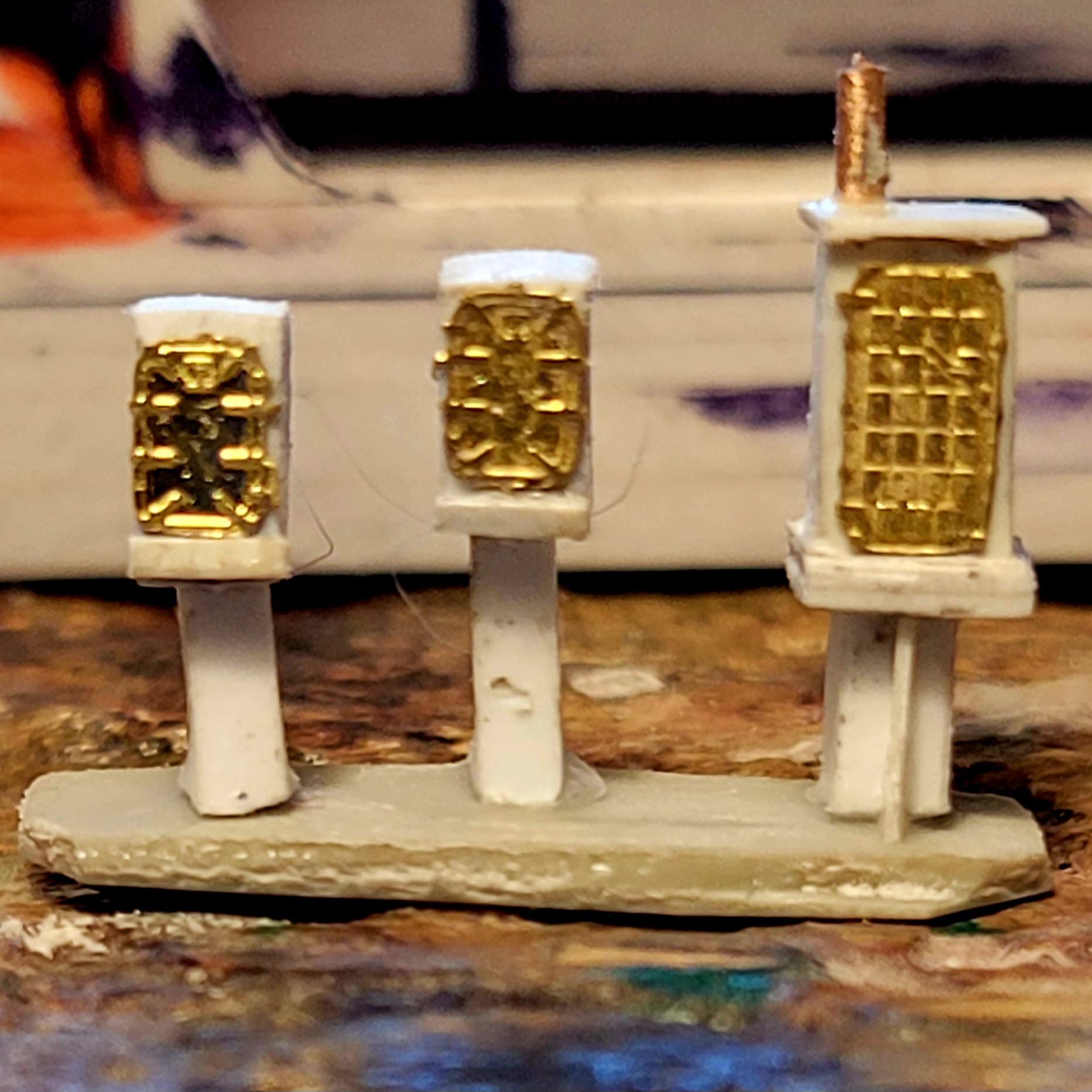

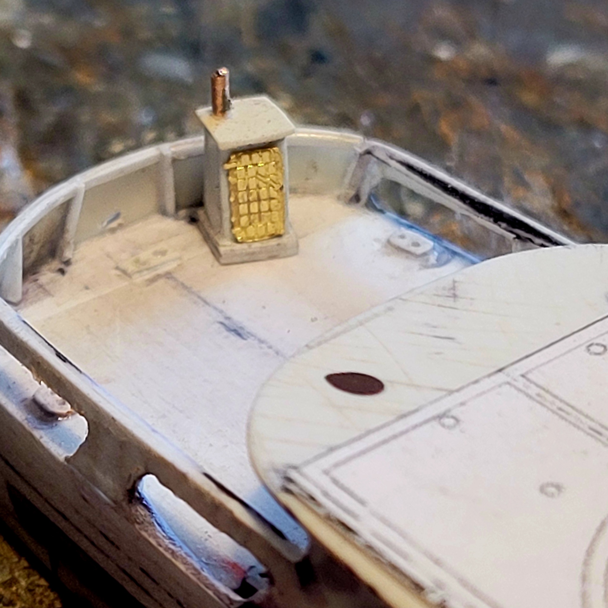

Porta-john, ready ammo lockers and forward gun platform. I decided the gun platform needed framework and room to put the railings on the finished product.

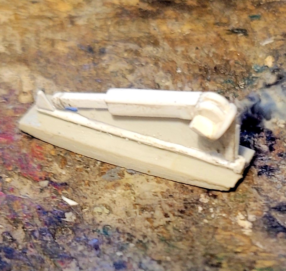

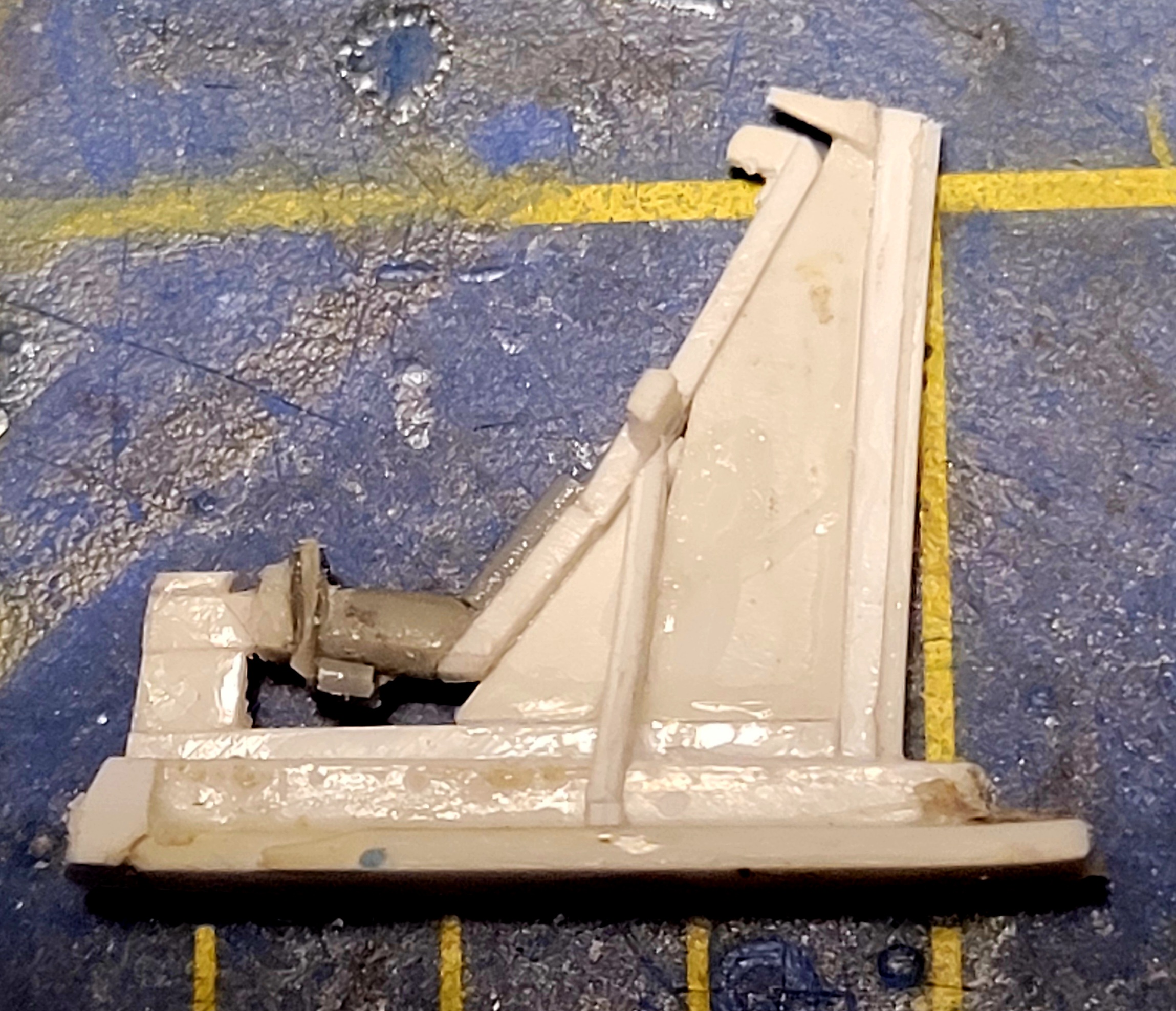

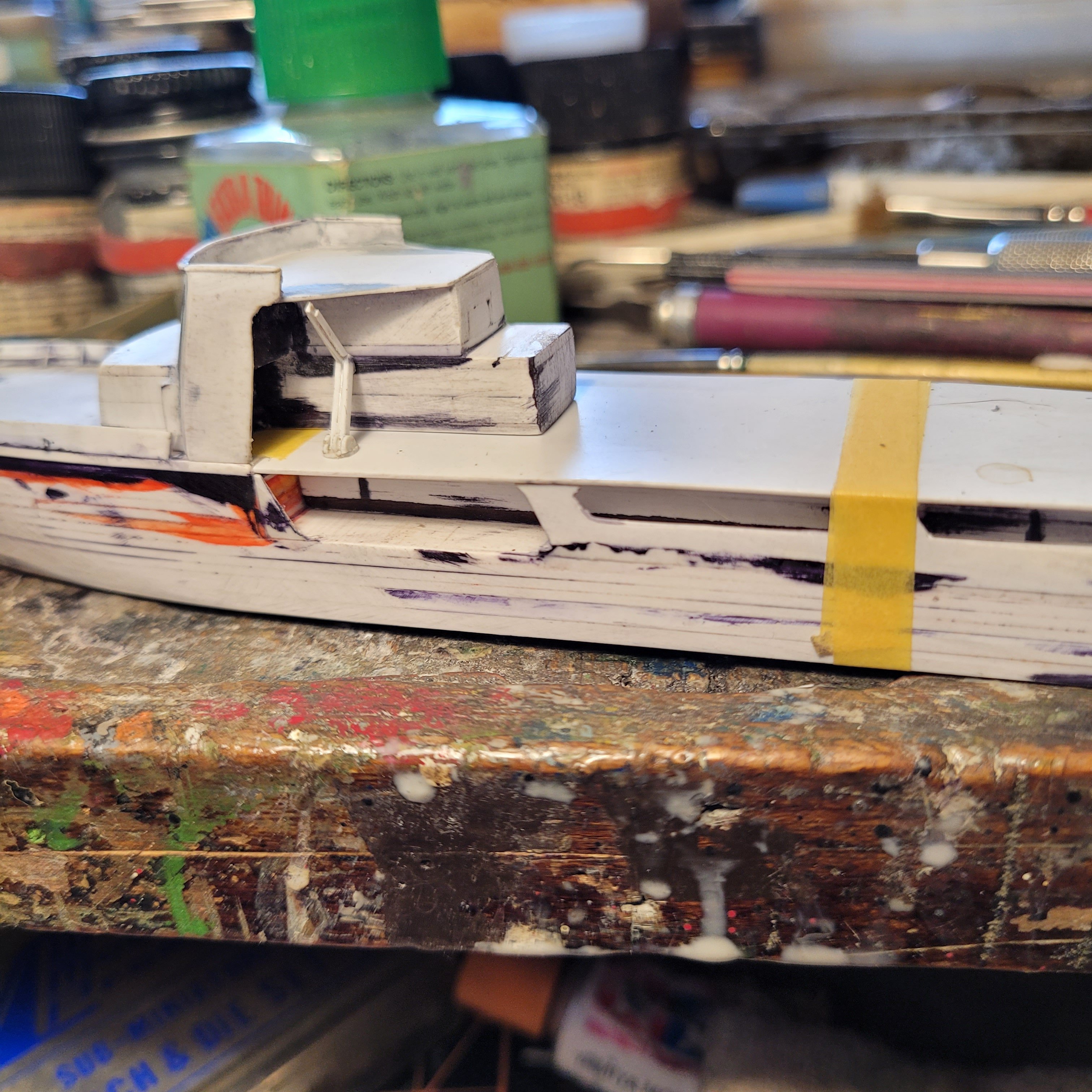

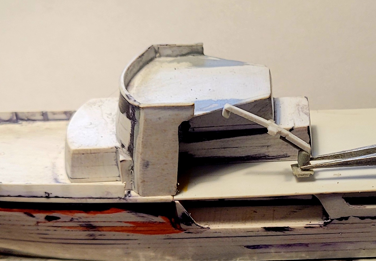

More parts! Early 210' boat davits/hoists have a beefy crane-like quality to them. Big-O hydraulic cylinders extend and retract the hoisting frames. I do not believe they are articulated. This one will be cast in a separate mold 4 times to go into the regular kit moldings so they are all exactly the same. Just like the torpedo launchers for the 1/350 77-foot Elco PT.
Later cutters had a crane for hoisting OTH boats. I made a cool extending crane, but it is WRONG! I will mold and cast it anyway. Perhaps it will work on an upcoming 1/350 Cutter Model. :hmm:

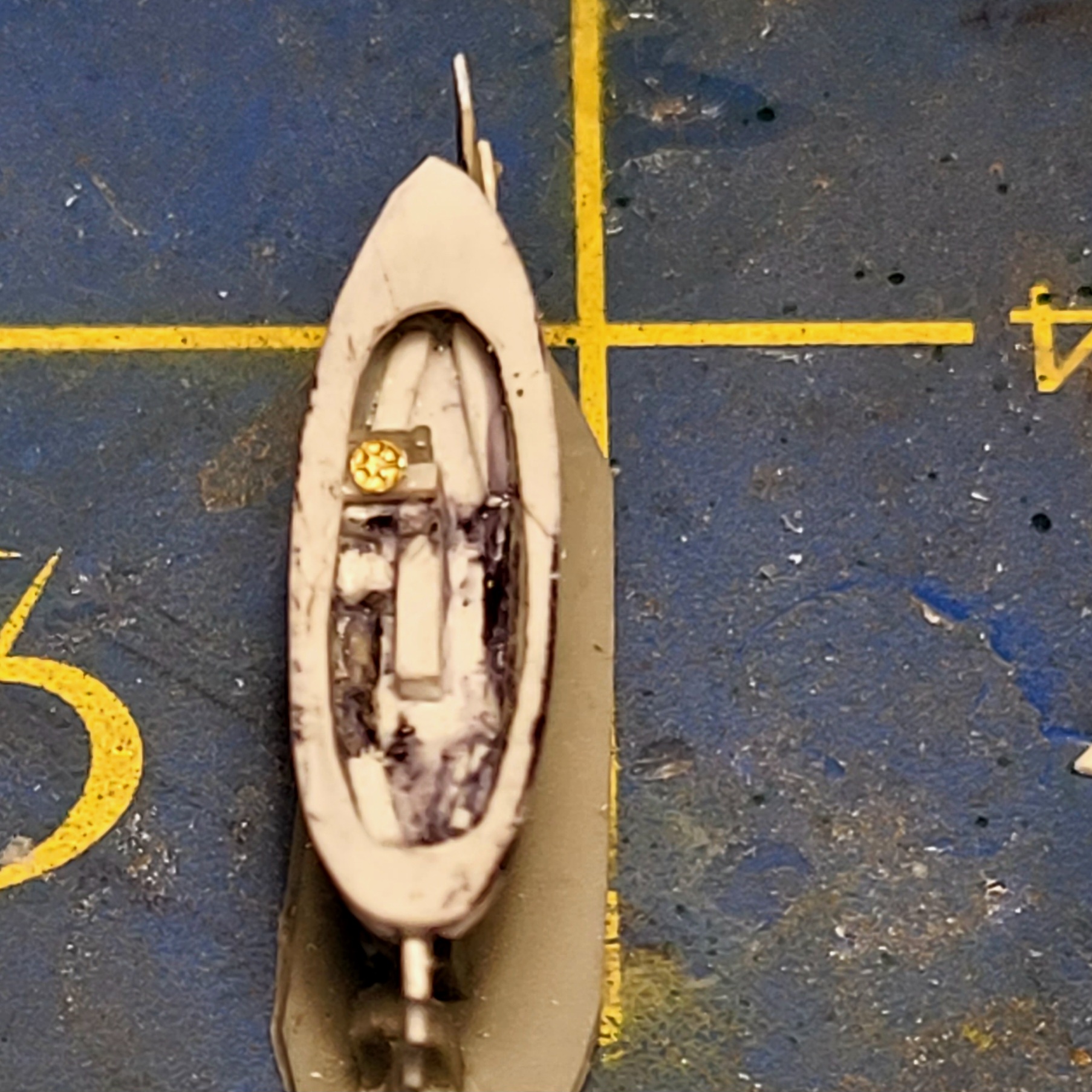

Helm installed on the 25' Motor Surf Boat. I put steering wheels on the OTH boats as well. These are 1/350 DKM depth charge caps. They make convincing steering wheels, do they not? The MSB is in the same mold with the boat lifting frames for the early Reliance class WMEC.
The best 2 MSB's will go in the regular kit mold.

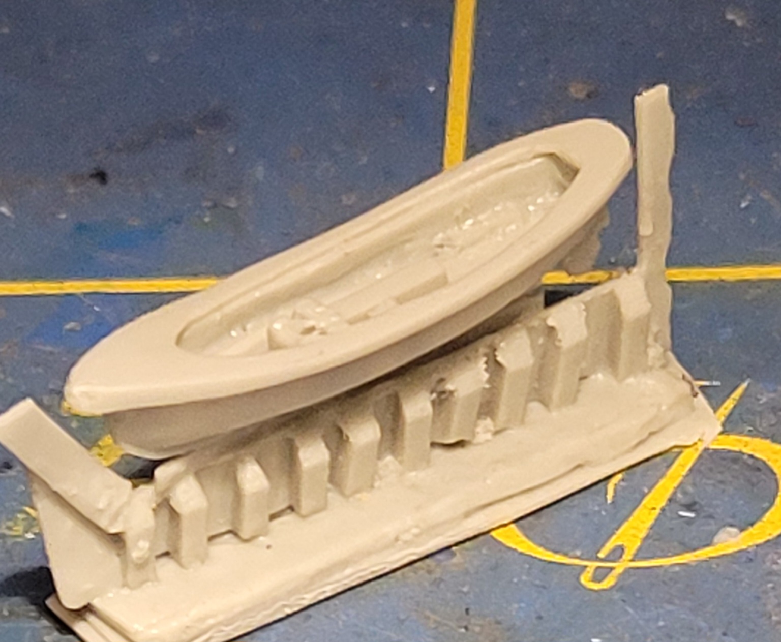

The 1/350 25-foot USCG Motor Surf Boat casting is excellent! All the undercuts, line reel and seats cast as I had hoped. The mold even picked up the steering wheel. 4 loops of lifeline will adorn the both sides of the hull for final kit casting.

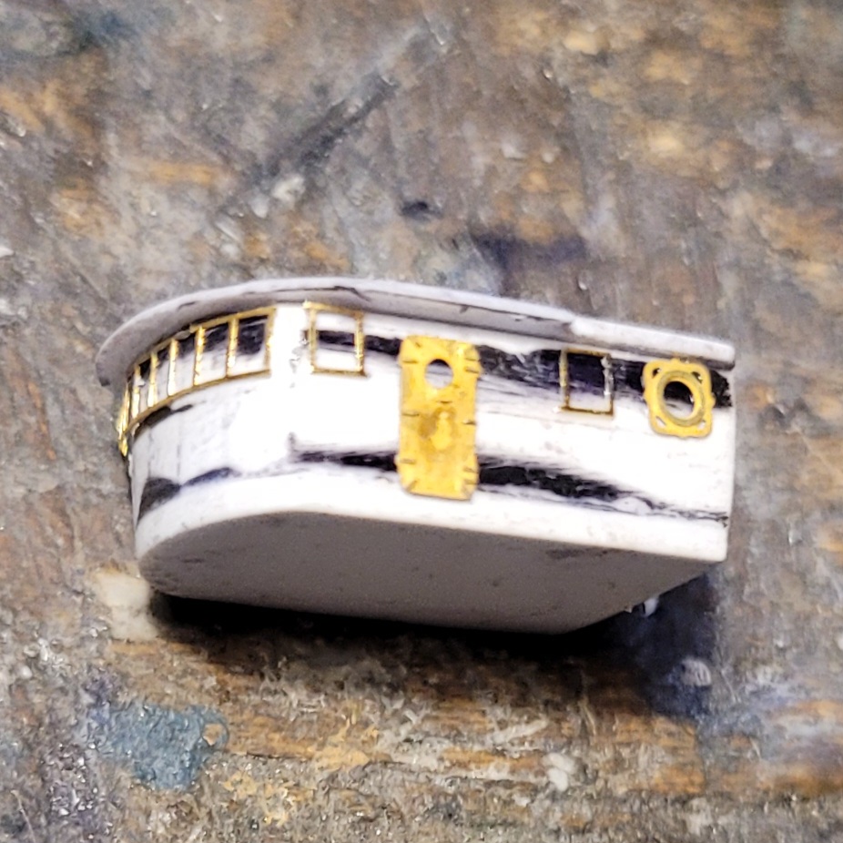

Bridge side windows get cut out 1 at a time. The process is tedious, but it pays off in the castings.

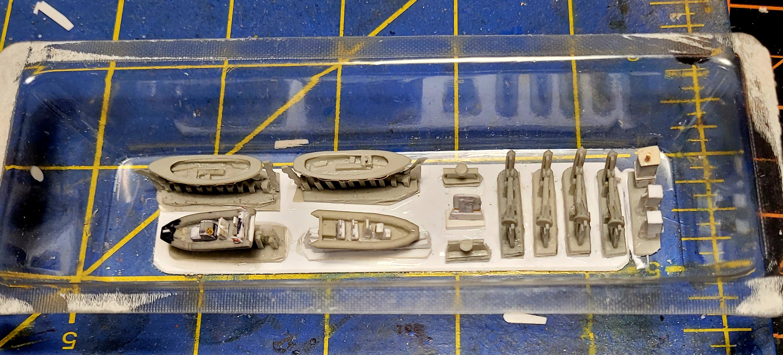

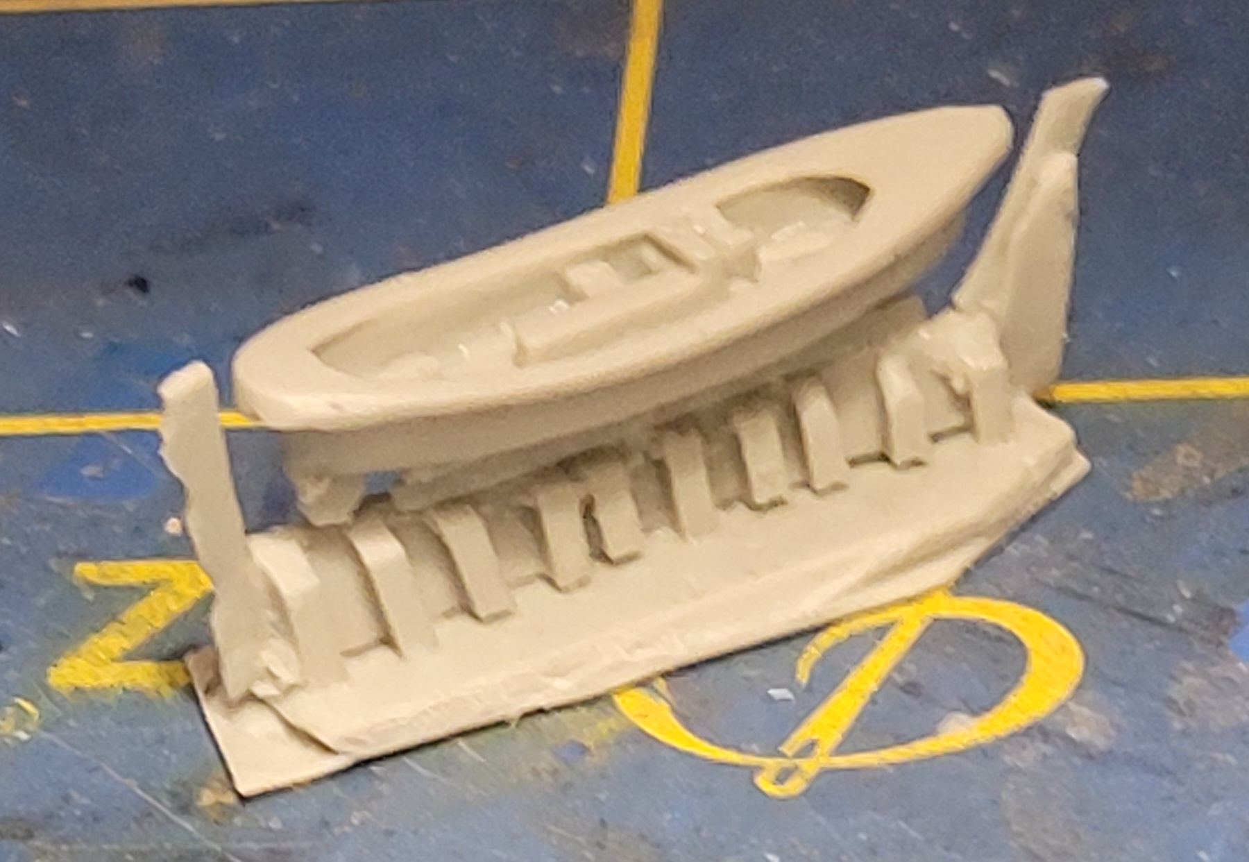

Boats Mold ready for RTV. 2 old-school 25' Motor Surf boats, Mk. II and Mk. III 26' over the horizon cutter boats, radar and light bars, 4 lifting frames for boat retrieval and deployment, and a set of ready ammo lockers and porta-pottie, so I can double up the fiberglass shithouse in the main hull mold.

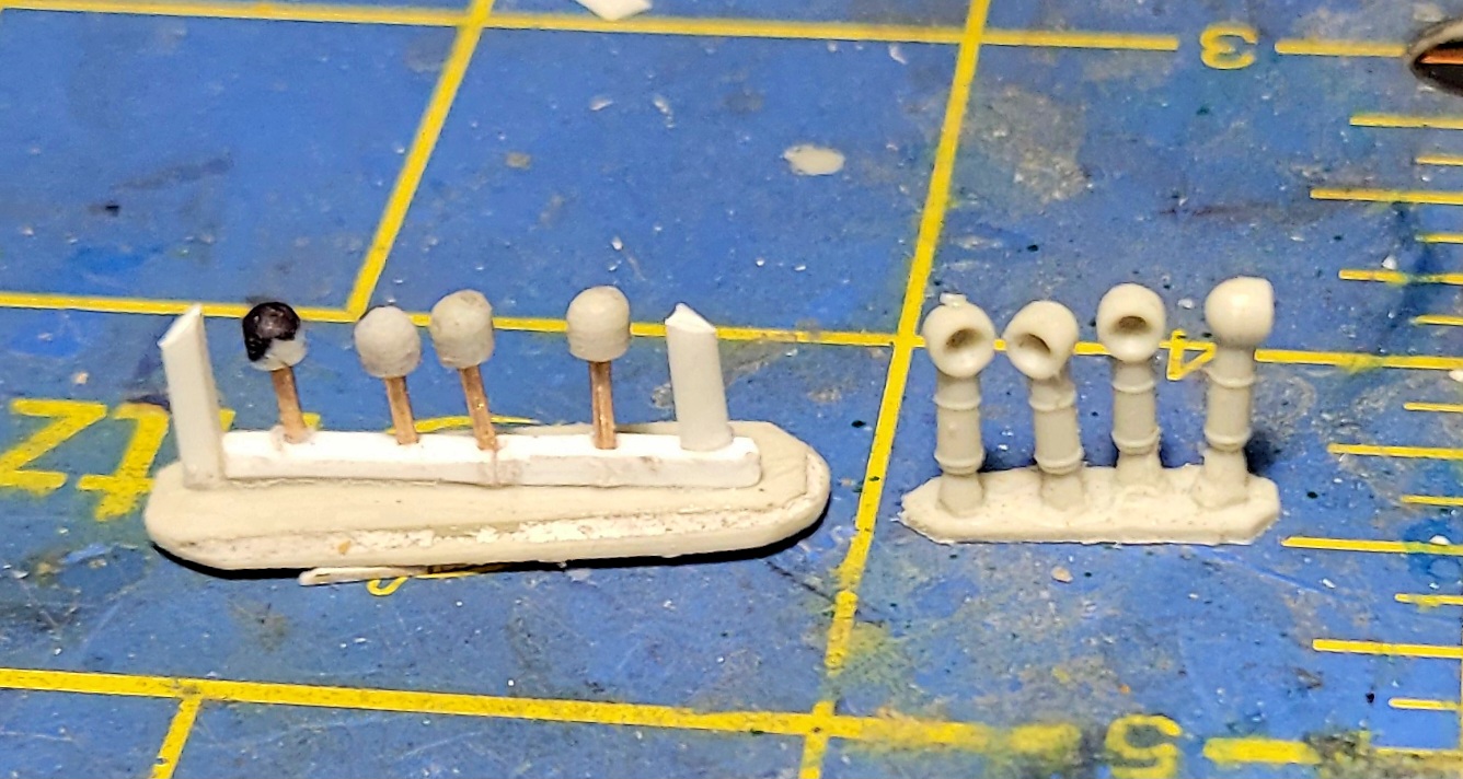

I converted old-school ventilators to a set of SAT/COM antennas. Waste not, want not!

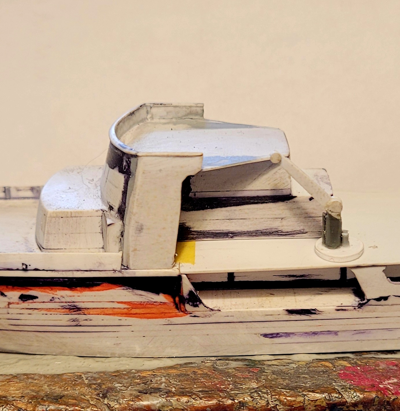

These will accompany other finished parts in the Bridge/Mast mold. The small Bridge is done. Work continues on the expanded bridge structure. Driven radar pedestals for the dual masthead nav radars are building.

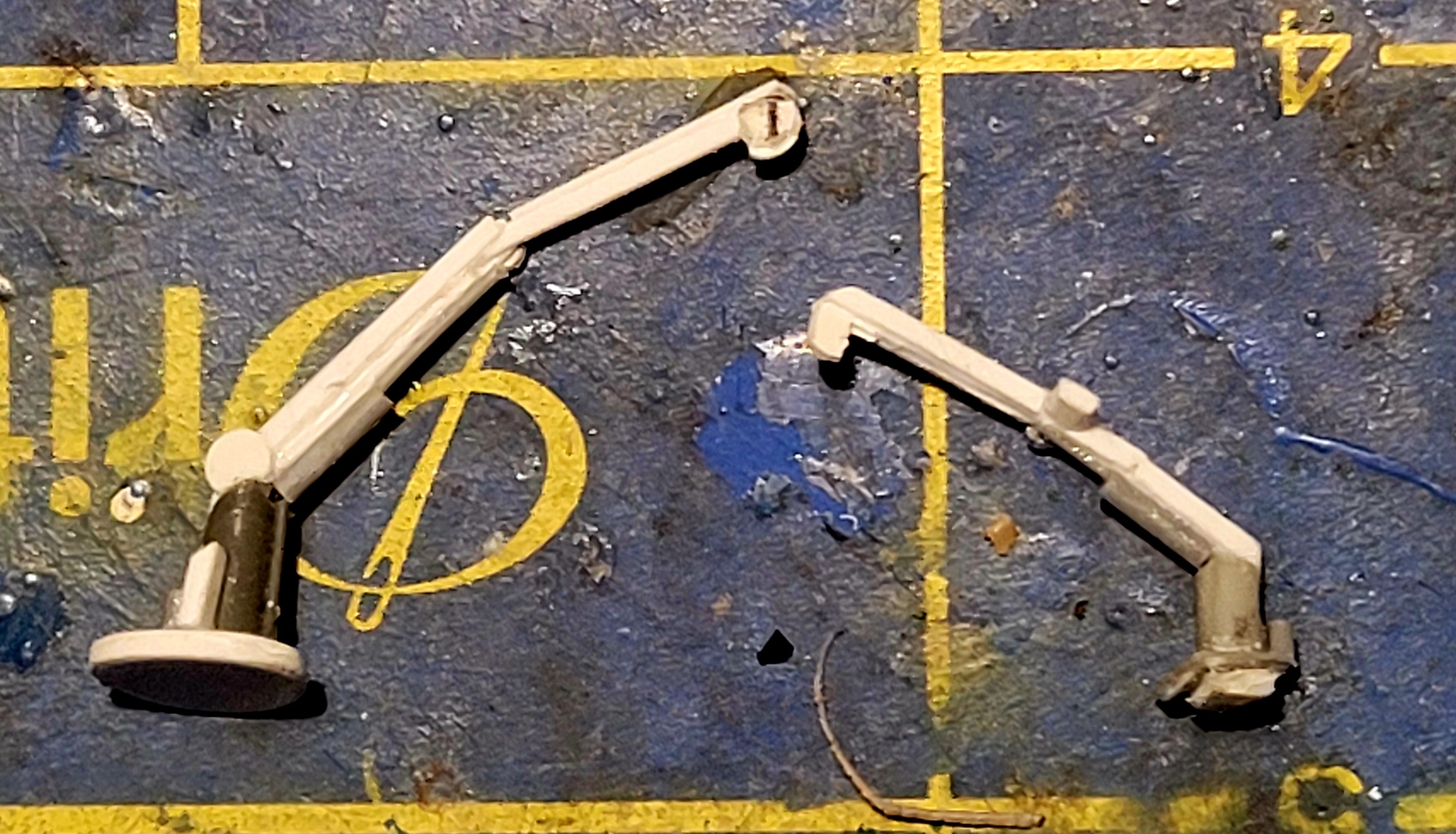

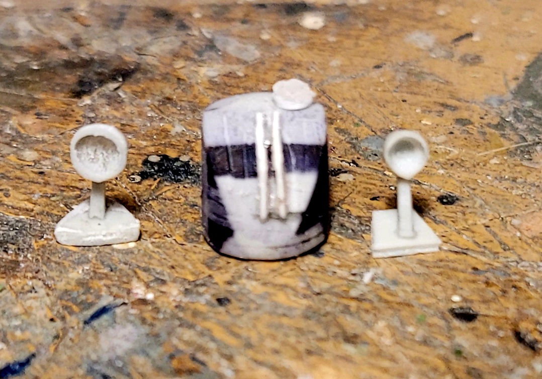

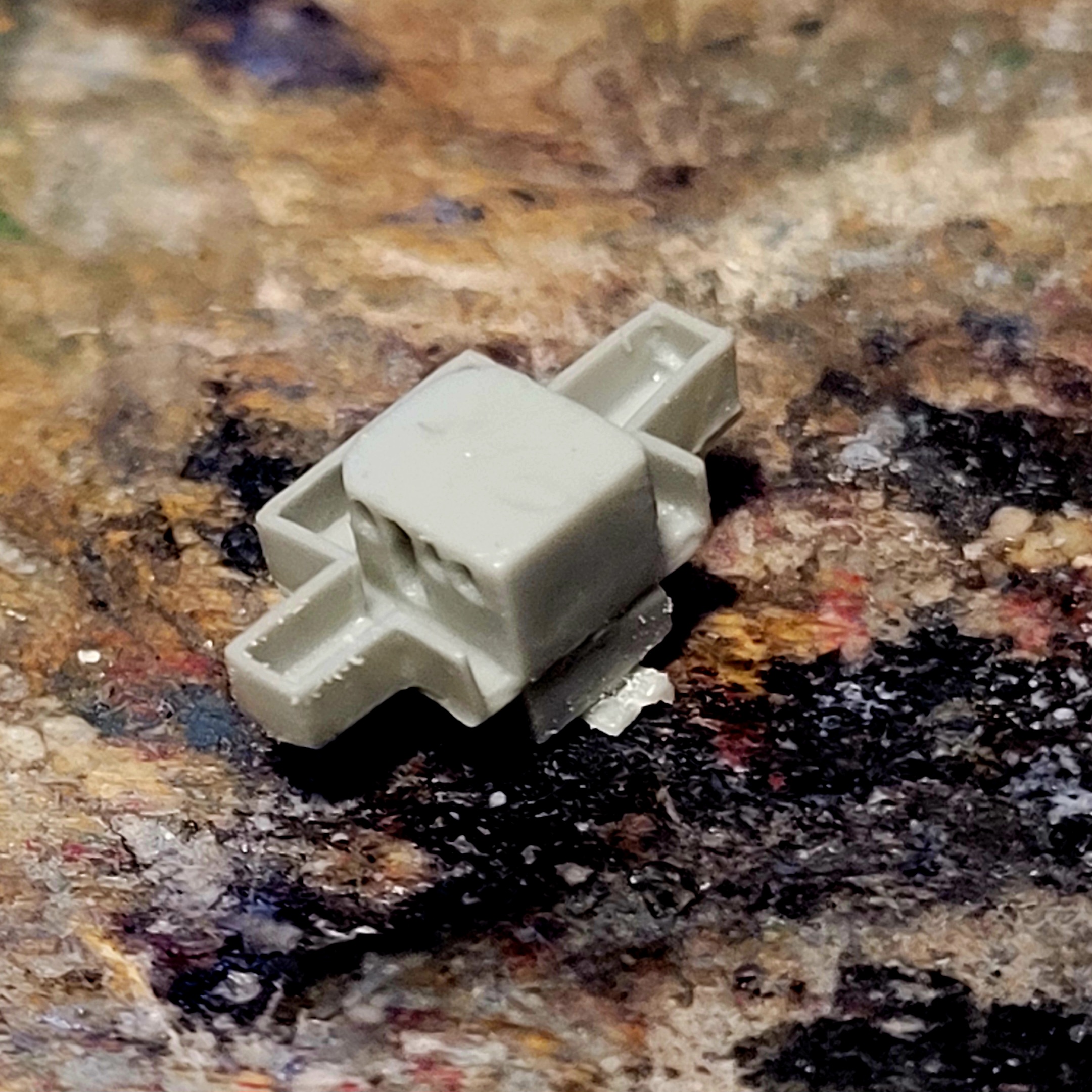

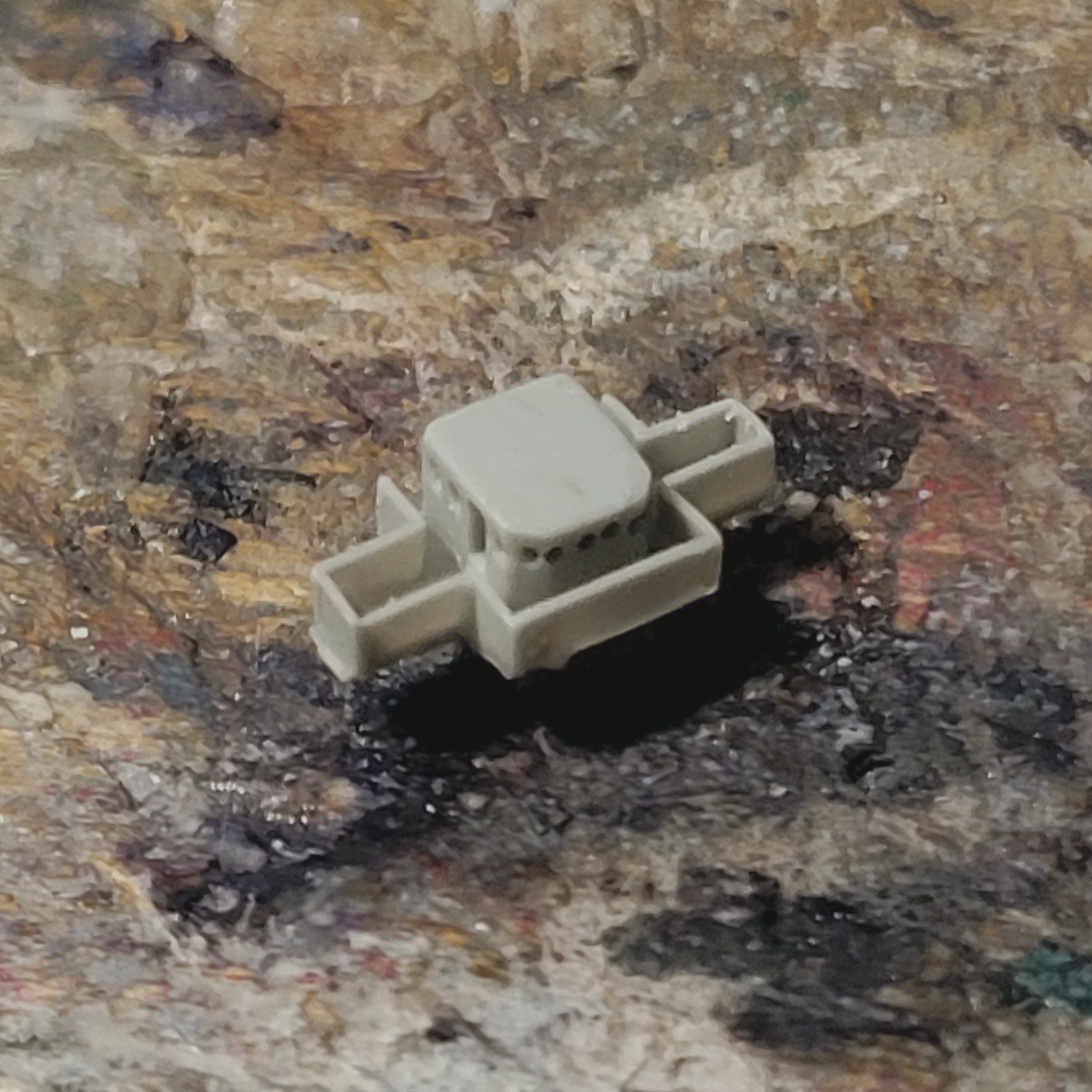

"1/700 Head" went out the window on the rescue boat crane. This 'un heyer is jus' plain ol' too big.
It started with a 1/700 smokestack from the Universal Hull kit and got out of hand from there. oops.
This looks a little more like a 1/350 Allied D5700CT. This one started with a casting stub from one of Ronnie Schultz' Cadillac taillights.
Hydraulic winch motor on one side and winch drum on the other.
"Crane, crane..............Take me on out of this town...................."
Framing the smaller crane for molding is done. I will probably mold the big one as well. Waste not, want not.
