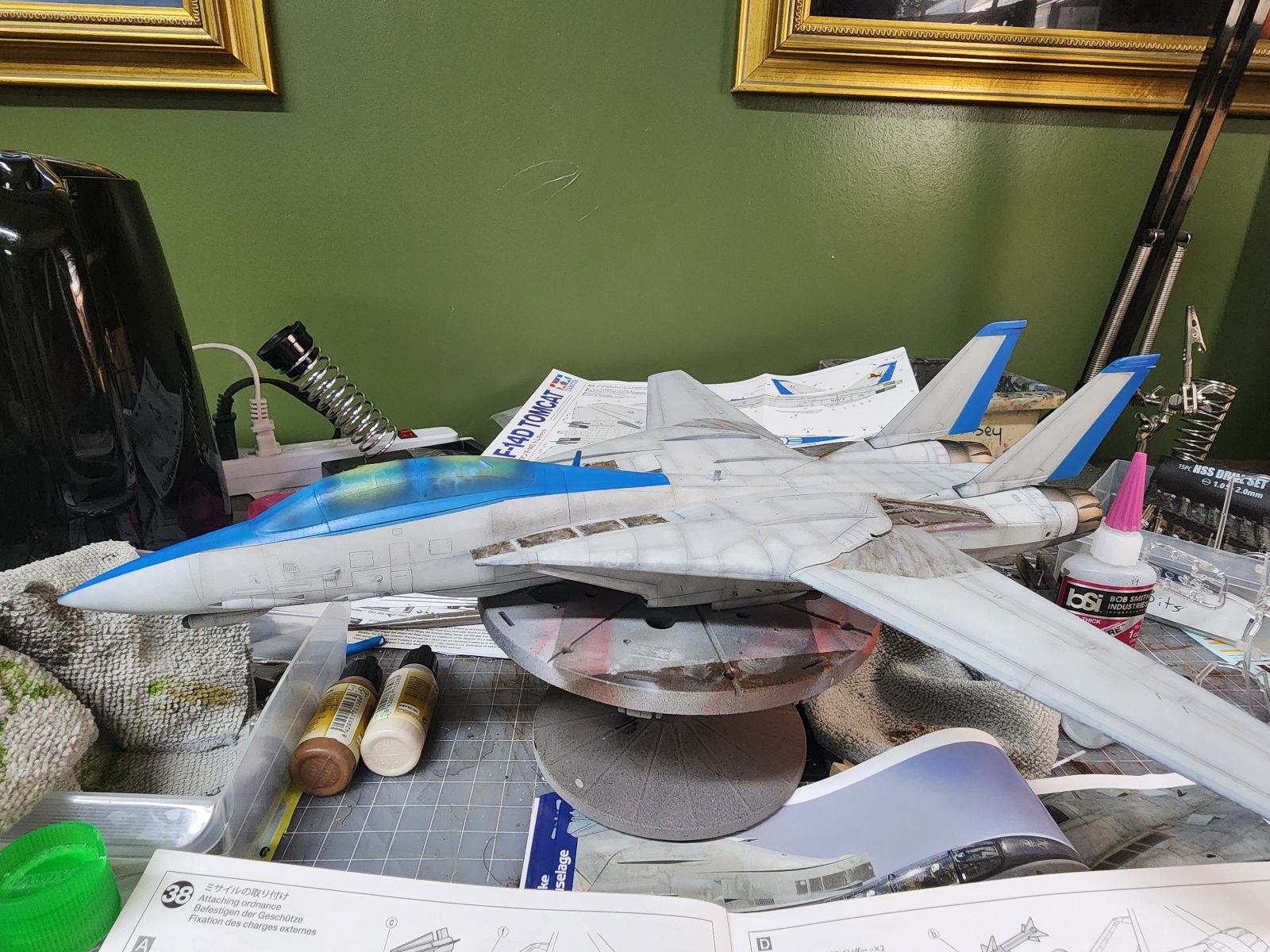

The kit comes with masks for the outside. I will make ones to mask the interior. Great idea, thanks!Ditto the cans. That's why you sent me that Gold color Alclad. I was wondering.

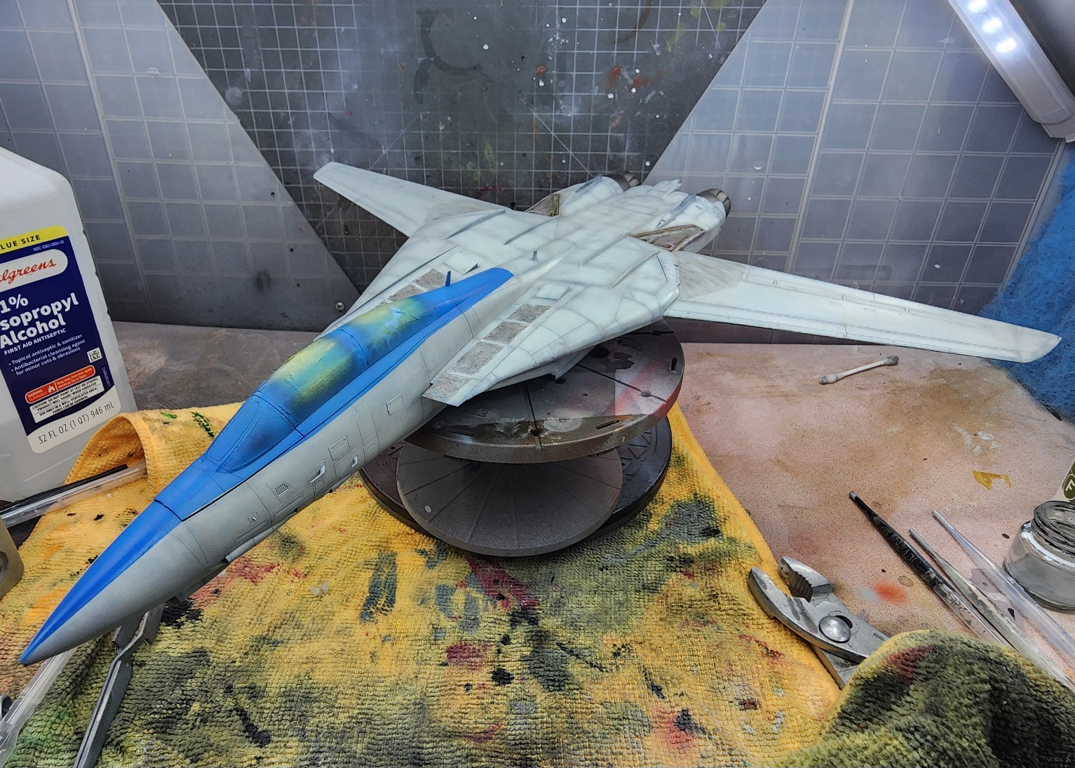

Might I suggest a double mask on the canopy? I'll see if I can find a photo of what I did way back. Not finding it. You tape up the inside of the canopy and using the panel lines on the outside you cut mask inside. then mask outside. Paint the inside black then the interior color, then the outside per normal. Really neat effect.

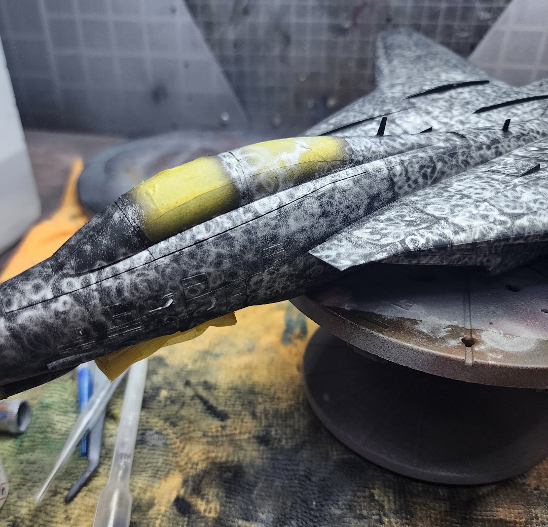

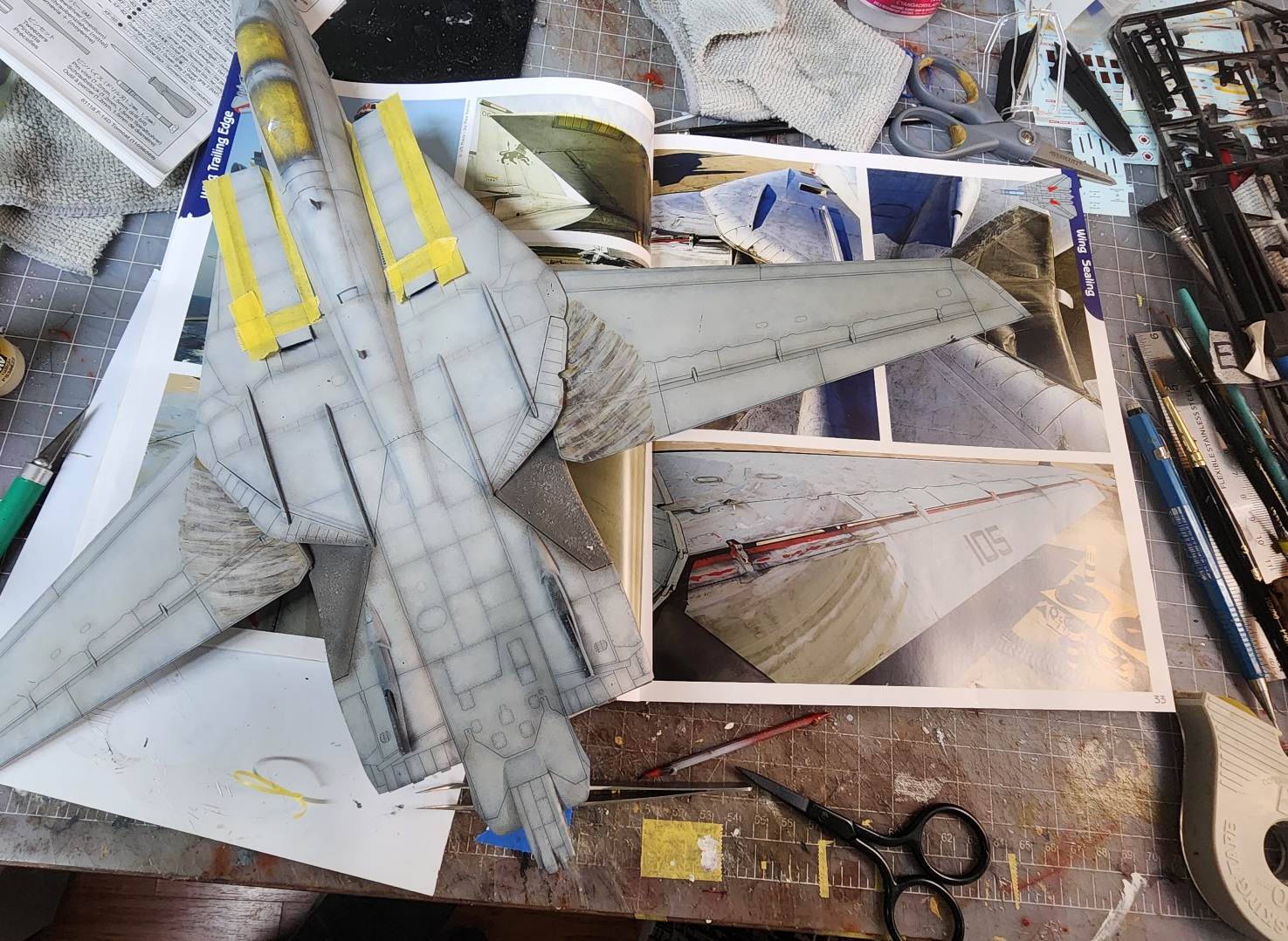

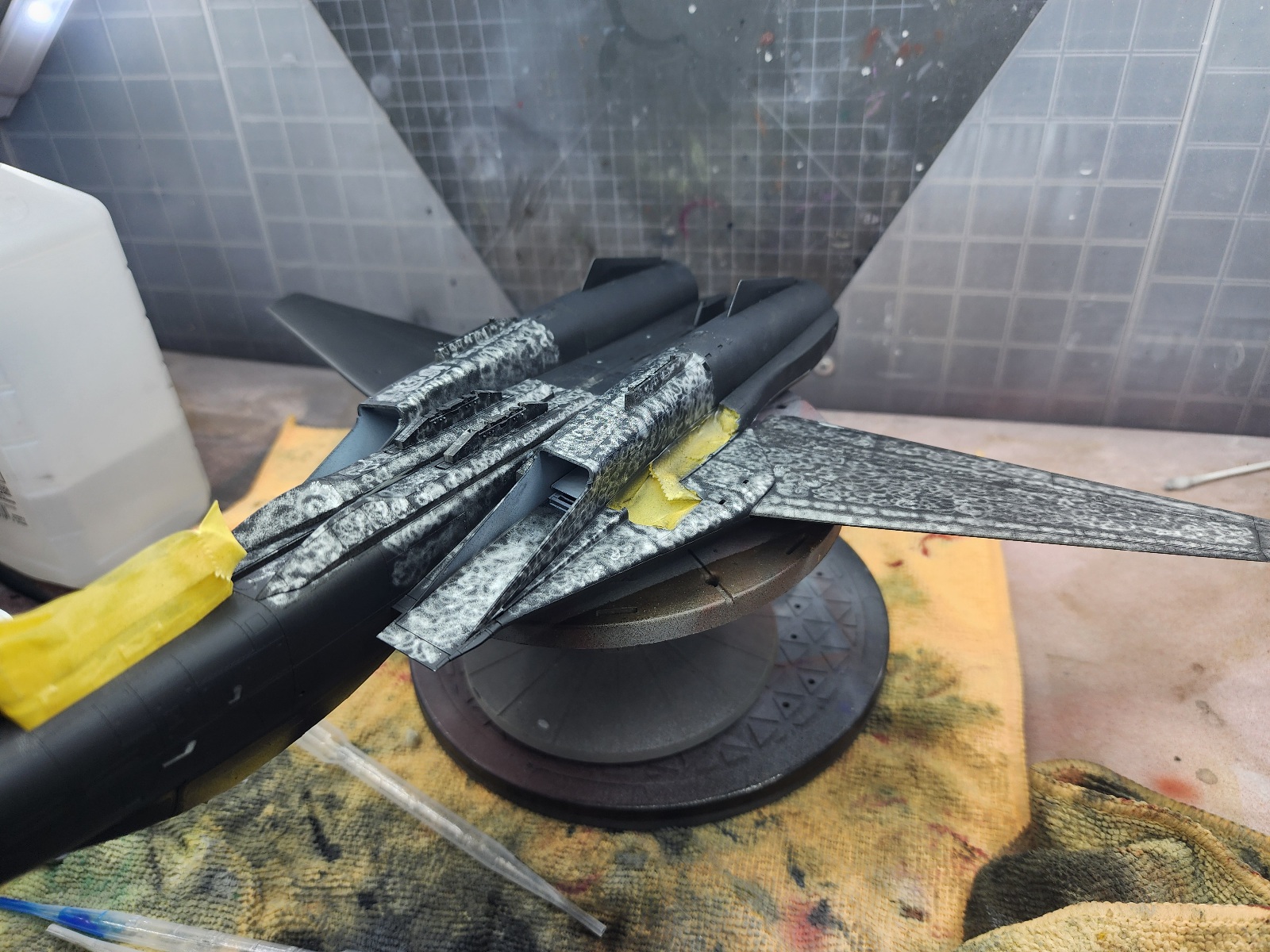

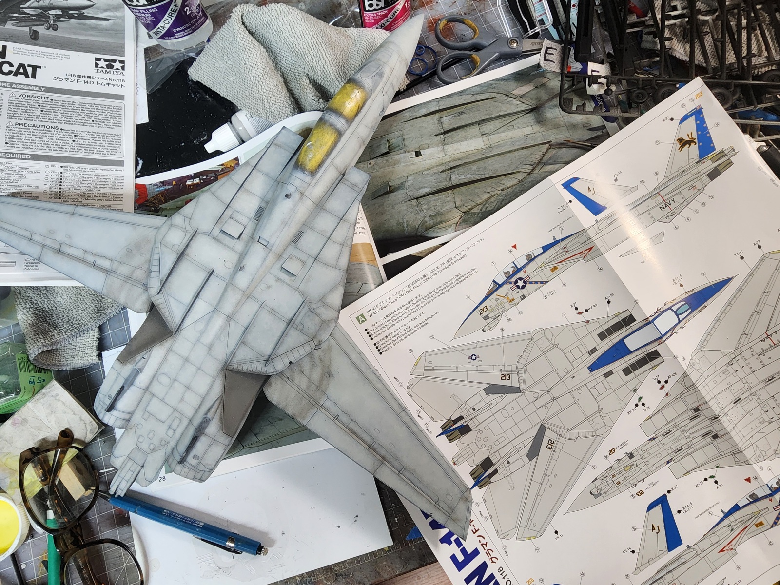

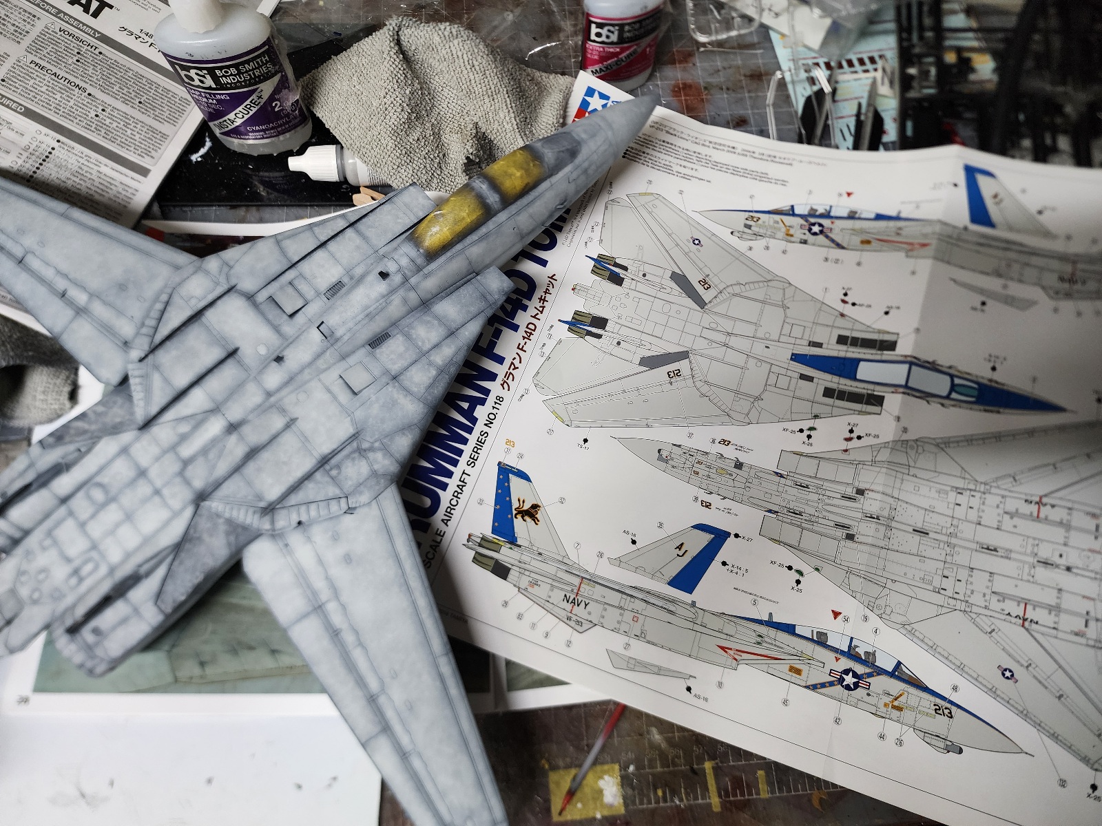

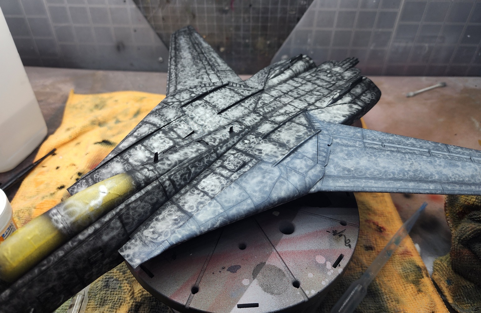

Yessir, high shine aluminum from alclad. Much has been done since those photos. Here are all of the colors used so far.Years ago it was modulation. Now we're marbling. This is fun stuff! Looks great, did I understand correctly that the marbling color is high shine aluminum?
Actually you are probably right...I think you mean trigger right down then pull back ?

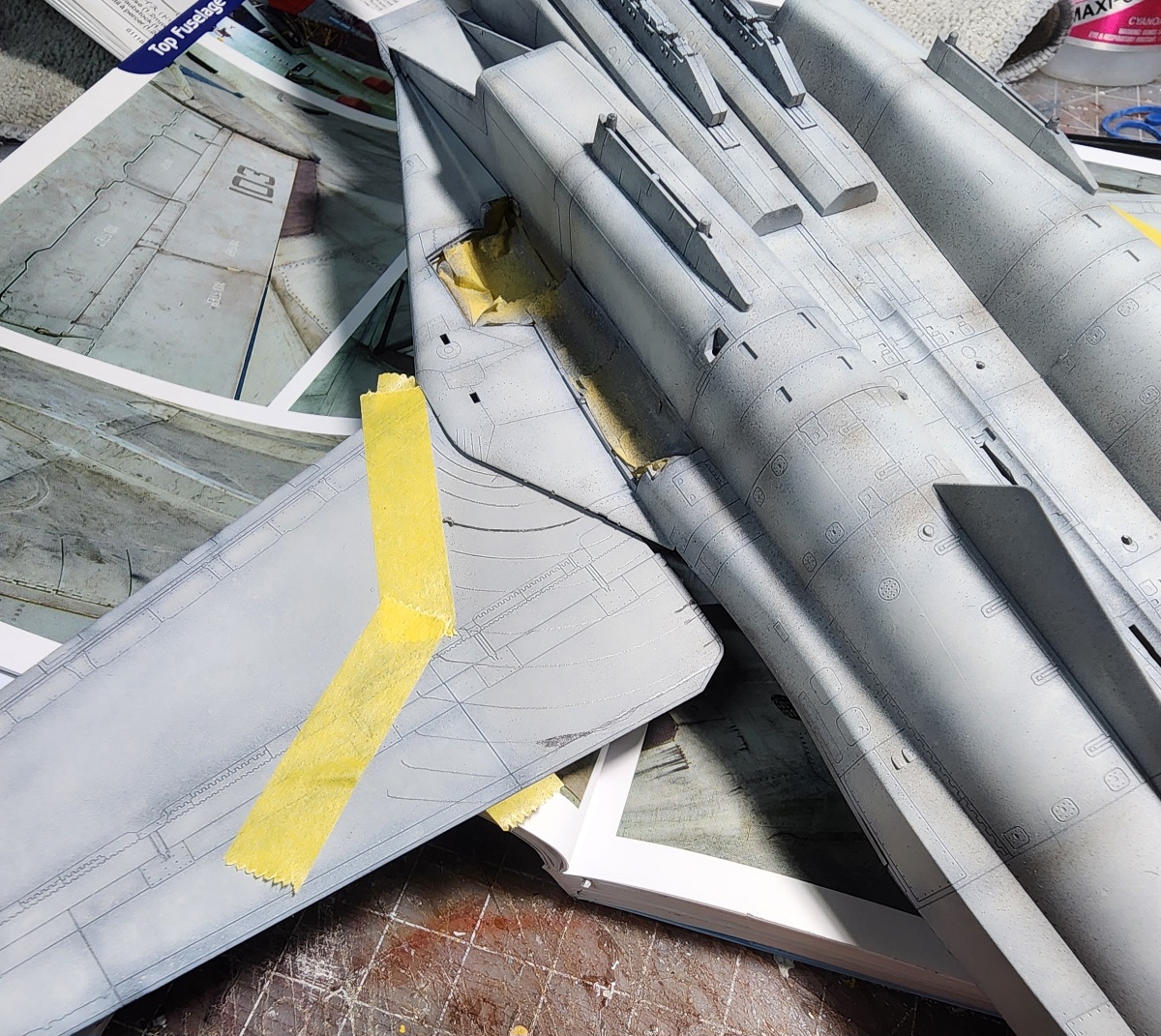

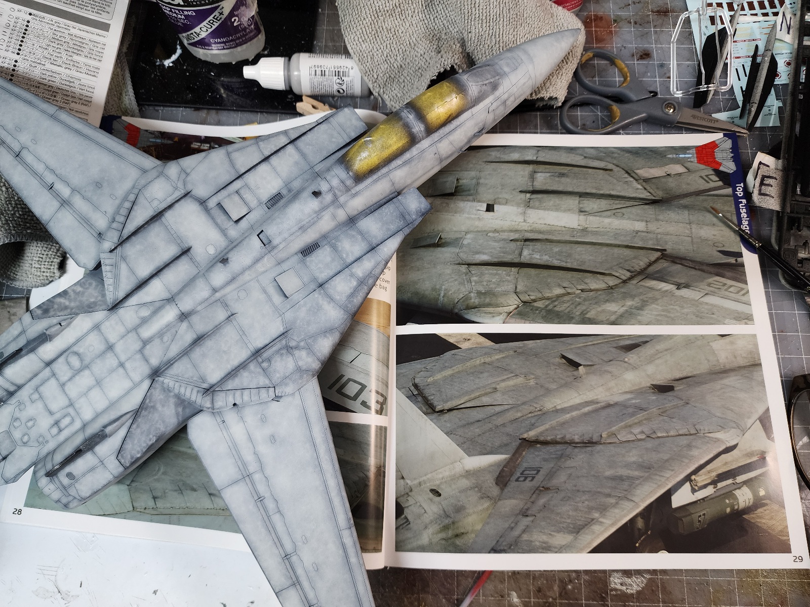

Go more subtle on any particular part that I have done?Not bad, go subtle...Funny, me saying subtle..![]()
