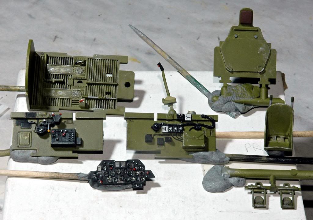

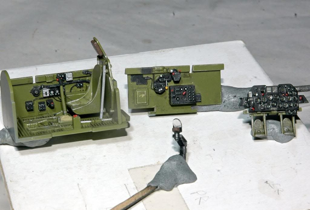

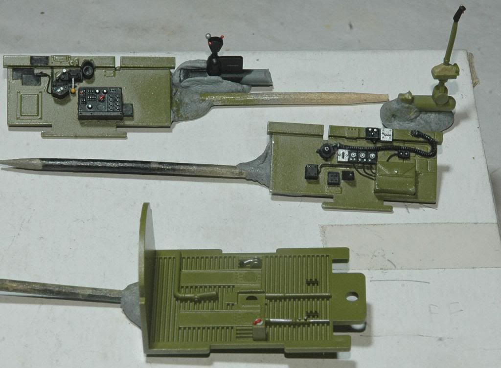

Finished the pit area, last open pics before I close it up.
I used Tamiya A/S12 silver as my base coat, scratched some interior green off, detail painted everything, used Mig dark wash sparingly, flatcoated, then drybrushed aluminum on certain area's.
IP - used Tamiya decal with Future under and over, let fully cure, then rolled tiny blu tac balls and covered each dial, flatcoated the IP, removed blu tac, detail painted the switches etc.
I got a very light lift on two small areas but can live with that.

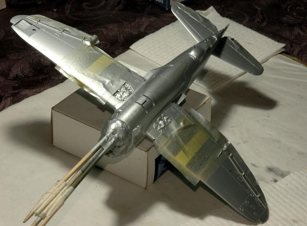

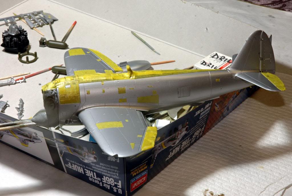

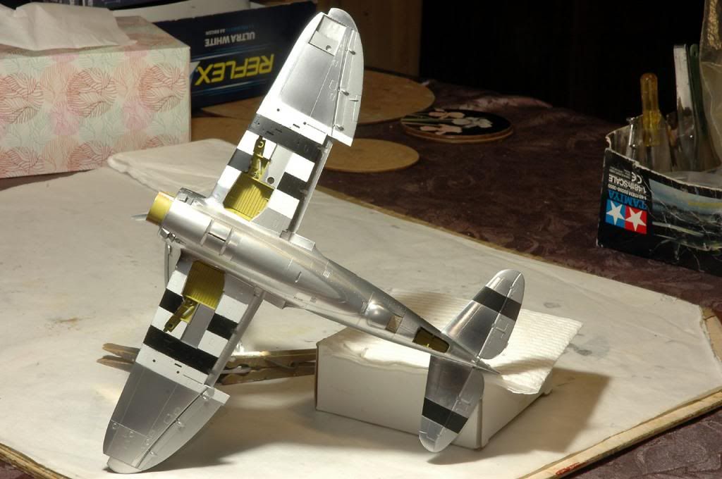

Long overdue update,
base silver, Tamiya rattle A/S 12 with selected areas masked, wing stripes done, will be using the decals for the fuselage ones cause I couldn't get the cockamamie angles and half moon curves right that go under the U.S. fuselage star.
DSC_1469a.jpg~original

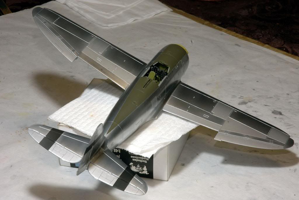

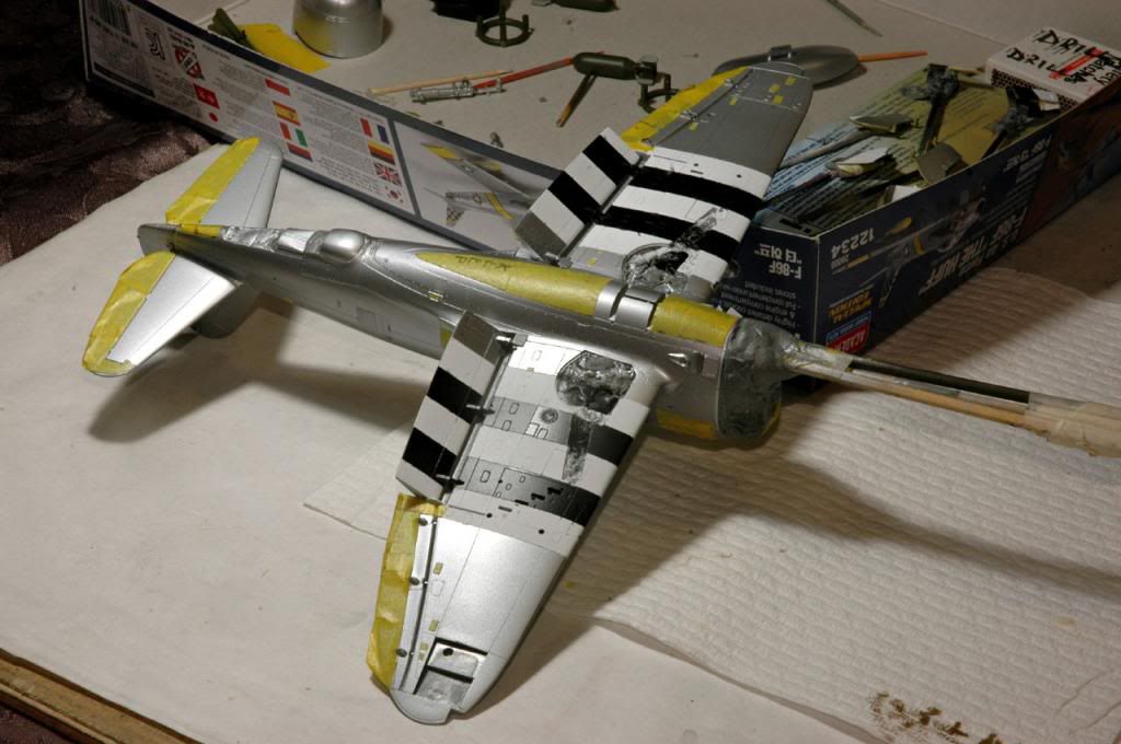

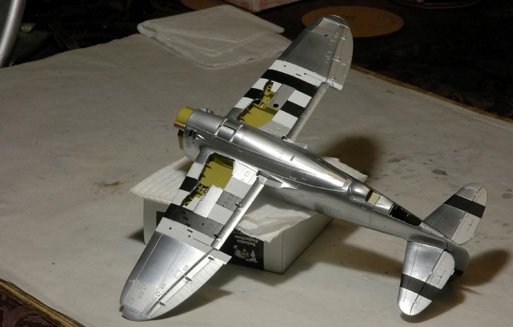

Anti glare strips done, and masked over.
DSC_1470a.jpg~original

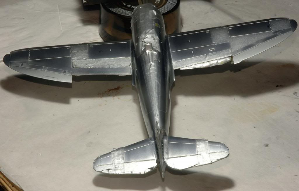

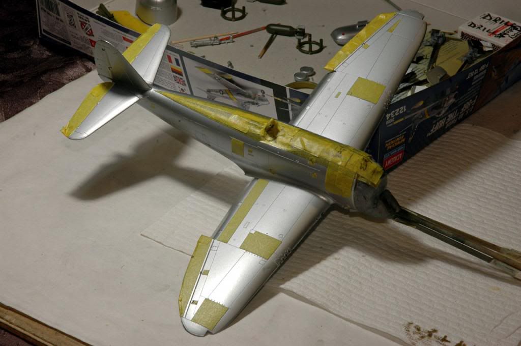

again selected panels and access points masked to retain the base A/S 12 bare metal silver
DSC_1473a.jpg~original

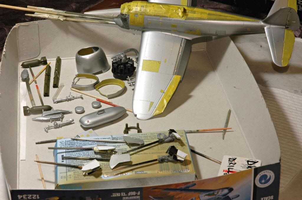

The box of bits
DSC_1475a.jpg~original

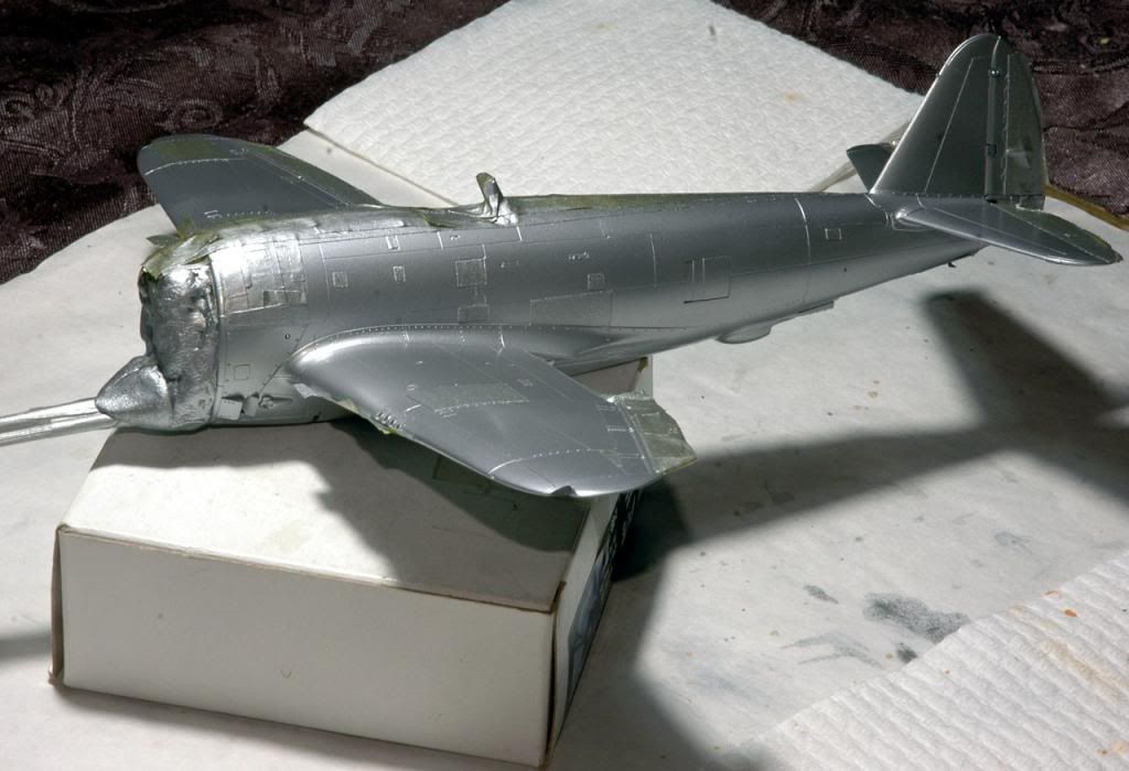

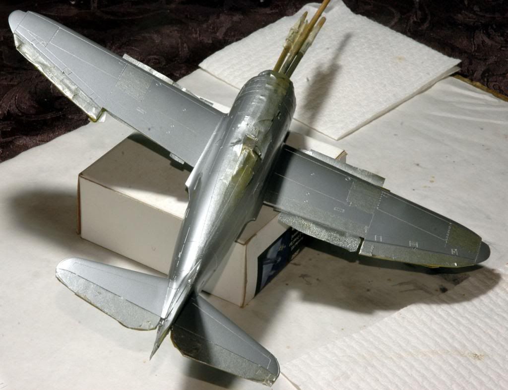

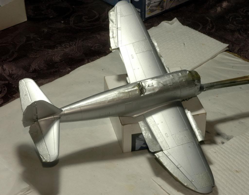

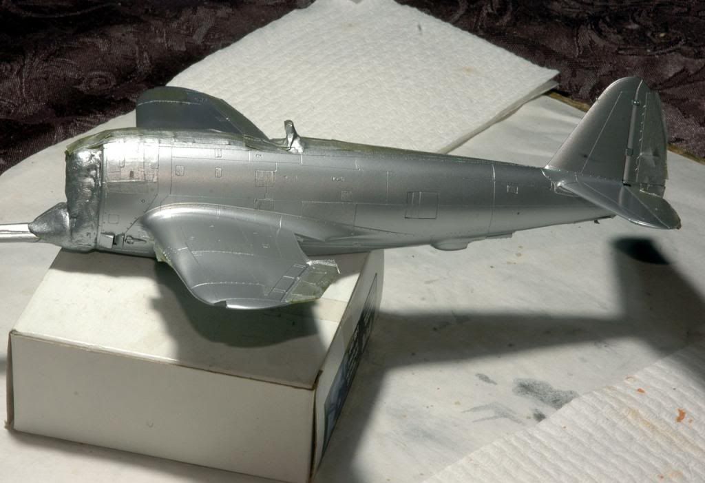

DSC_1481b.jpg~original

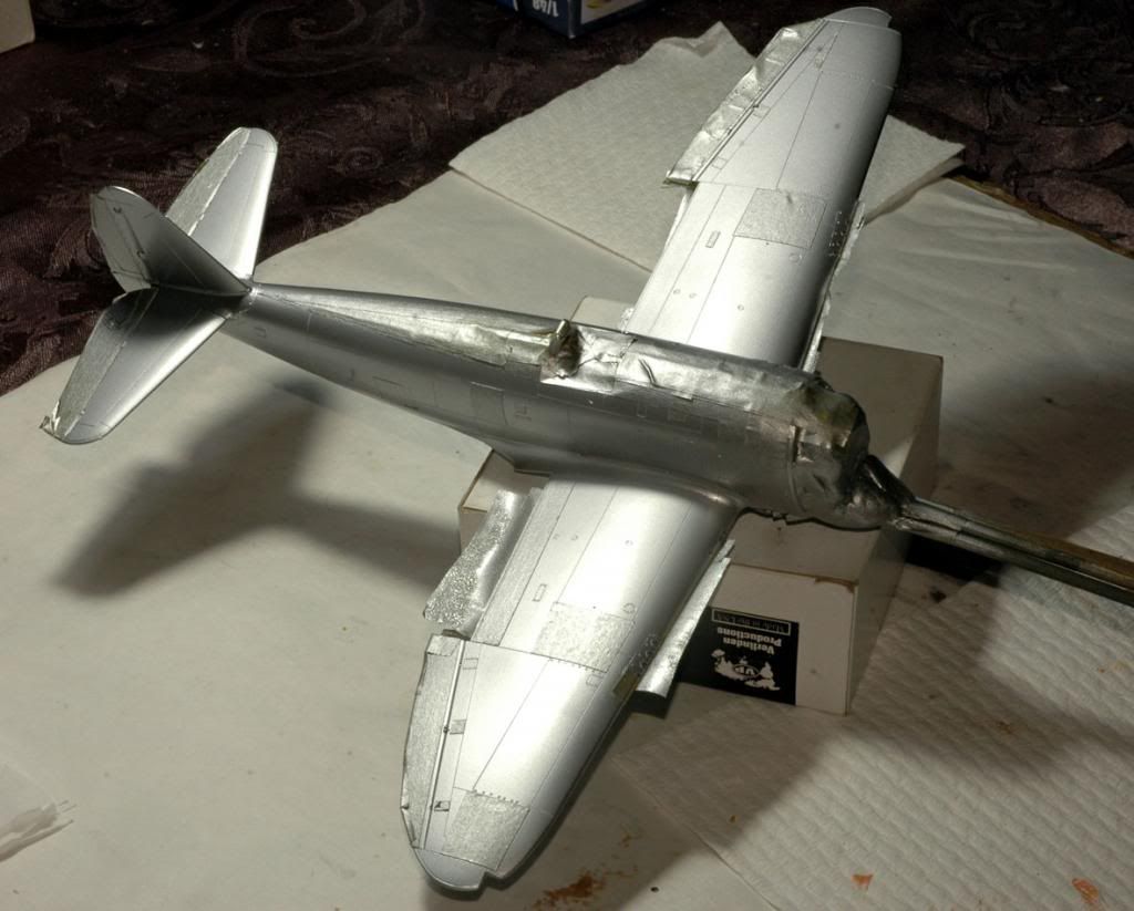

2nd round of silver Tamiya rattle T/S 17 gloss Aluminum
DSC_1480b.jpg~original
DSC_1478a.jpg~original
DSC_1482a.jpg~original
DSC_1483a.jpg~original
DSC_1484a.jpg~original
Will leave this alone for a good three days to let that Gloss T/S 17 fully dry and harden before more masking of more selected panels.
Next will be Mr Metal Aluminum

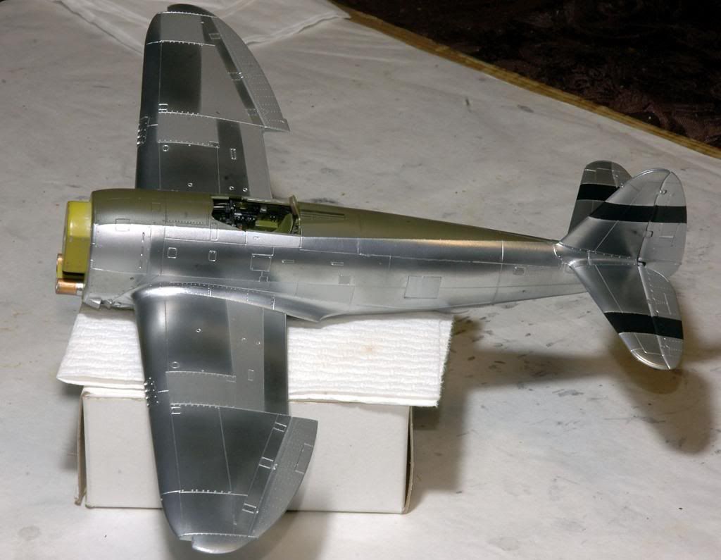

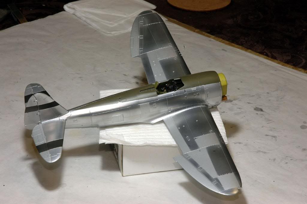

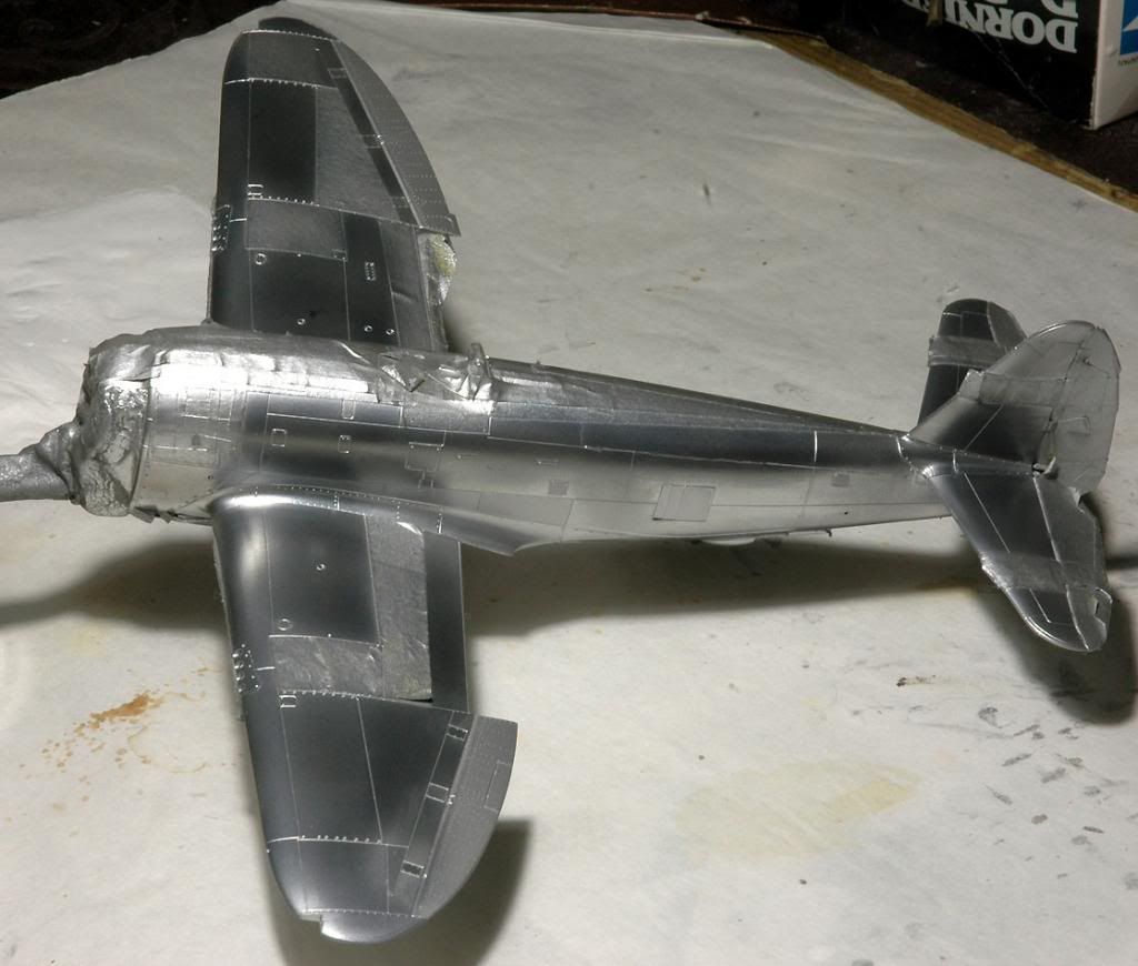

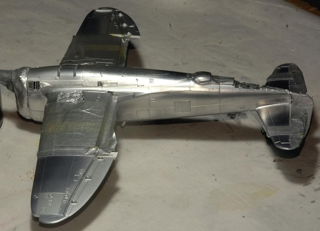

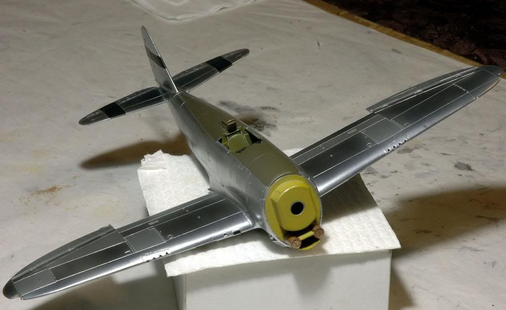

Mr Metal paint on polished and sealed, masks still on while the sealer hardens
DSC_1485x1a.jpg~original
DSC_1486x1a.jpg~original
DSC_1490x1a.jpg~original
Masks off
DSC_1492x1.jpg~original
DSC_1493x1.jpg~original
DSC_1495x1.jpg~original
DSC_1498x1.jpg~original
DSC_1500x1.jpg~original
DSC_1501x1.jpg~original
more a bit later.
