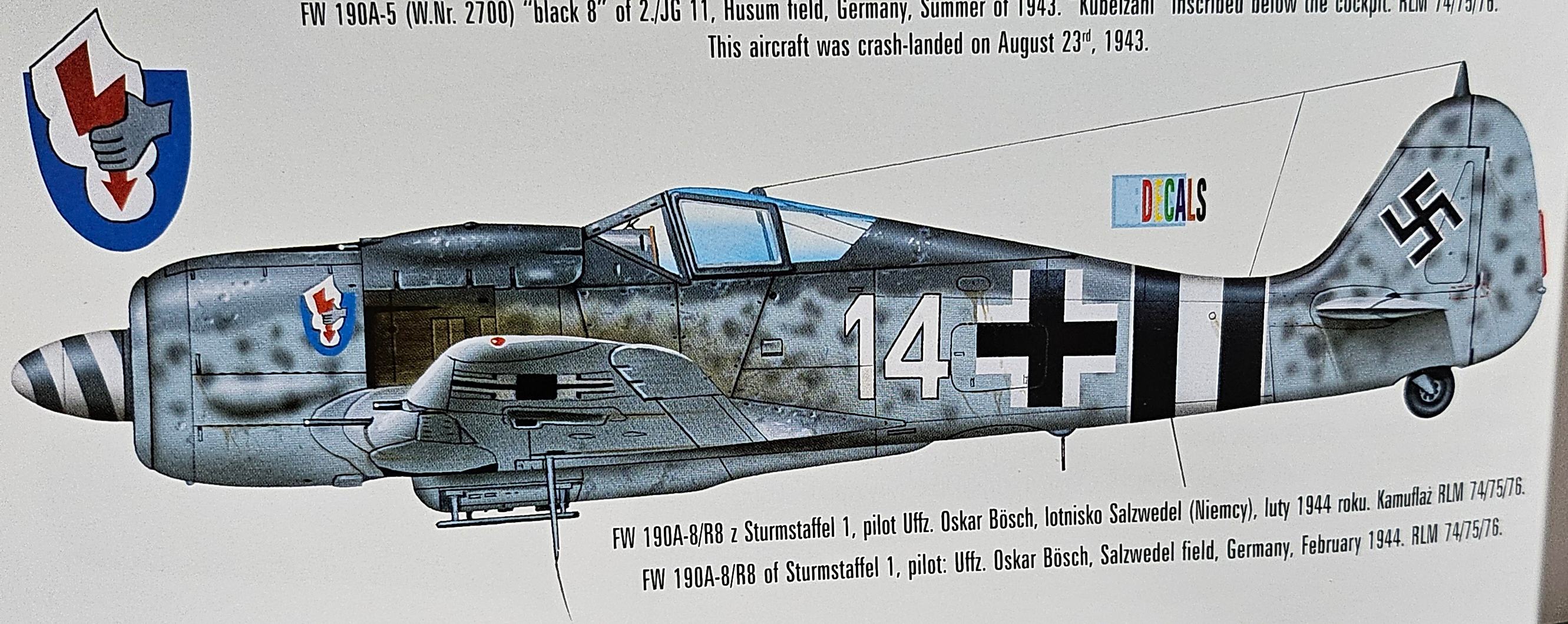

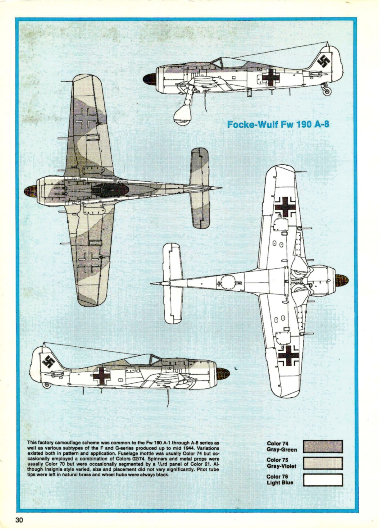

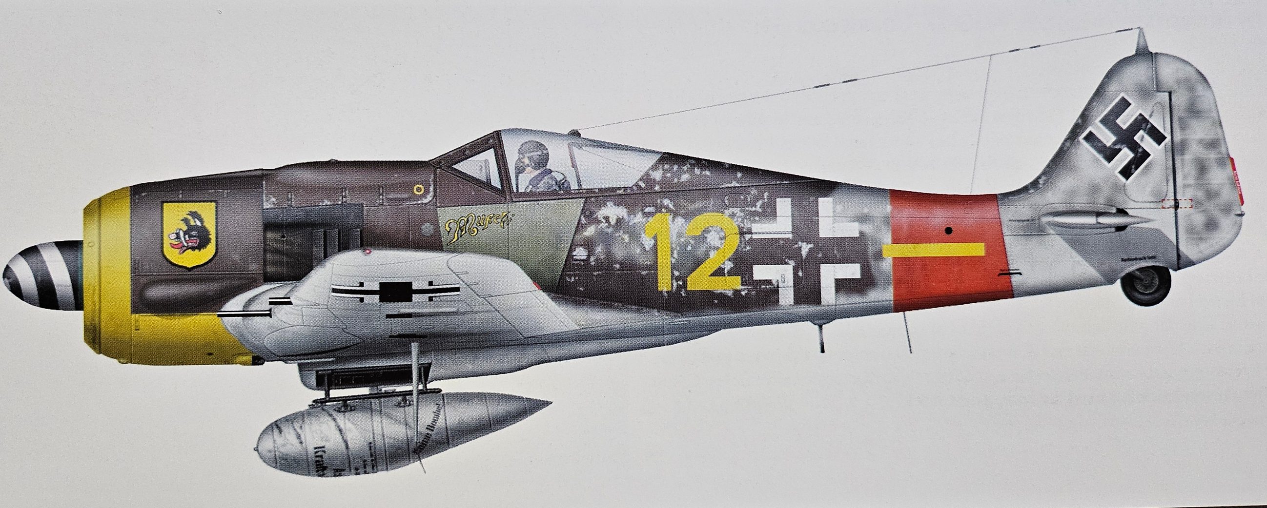

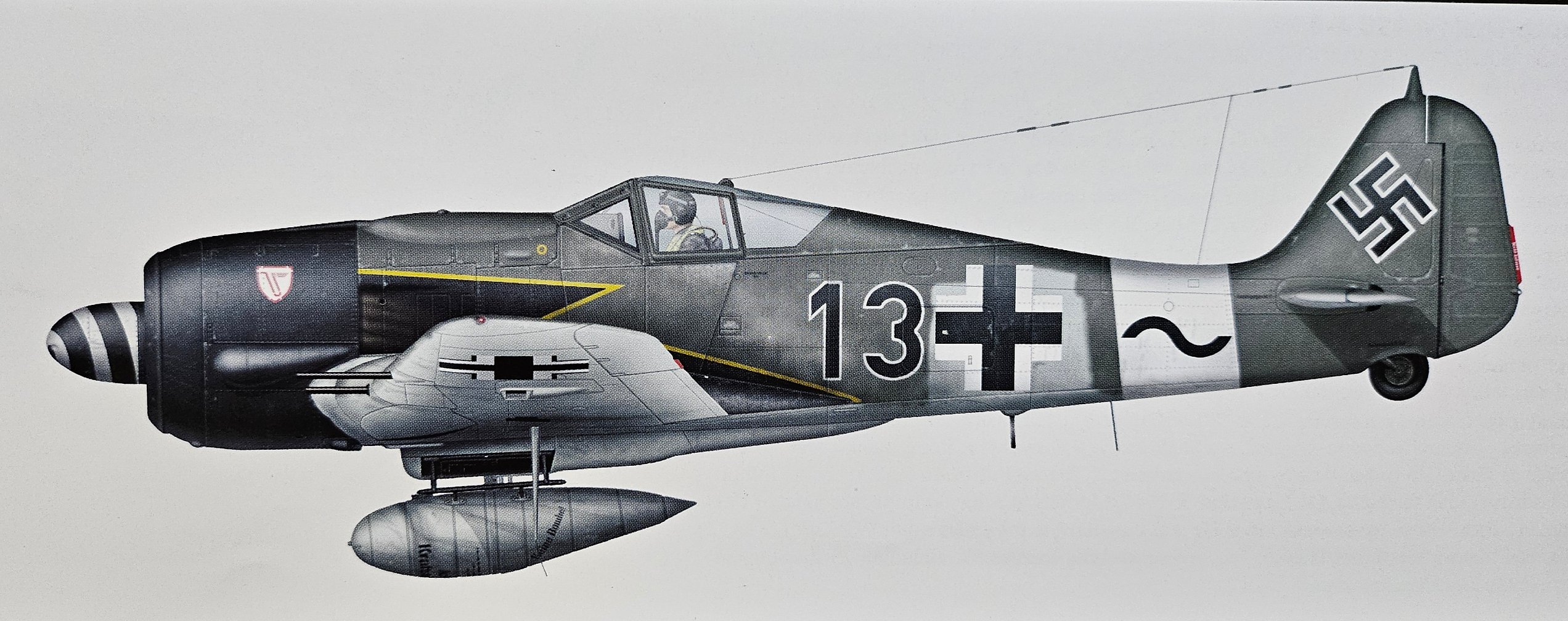

I got ya Paddy. These are from the official Monogram paint guide for German aircraft. These are from scanned sheets but give a good rendition.
The colors on the paint chips are resonably close so go for it. If anything they would be worn and faded a bit. Things to remember is that the aircraft paint early in the war was really good. I can't think of any photos I have seen where the paint was worn through or chipped like on American aircraft. Filthy, grungy, and dirty they very much were, and I am sure there were some worn spots, but NOT heavily chipped.

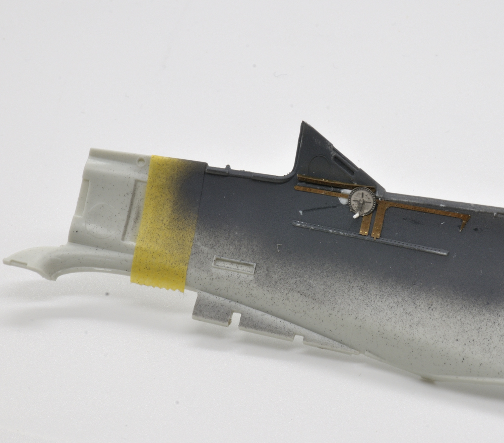

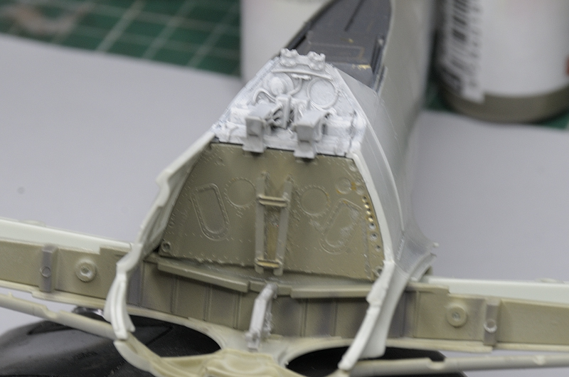

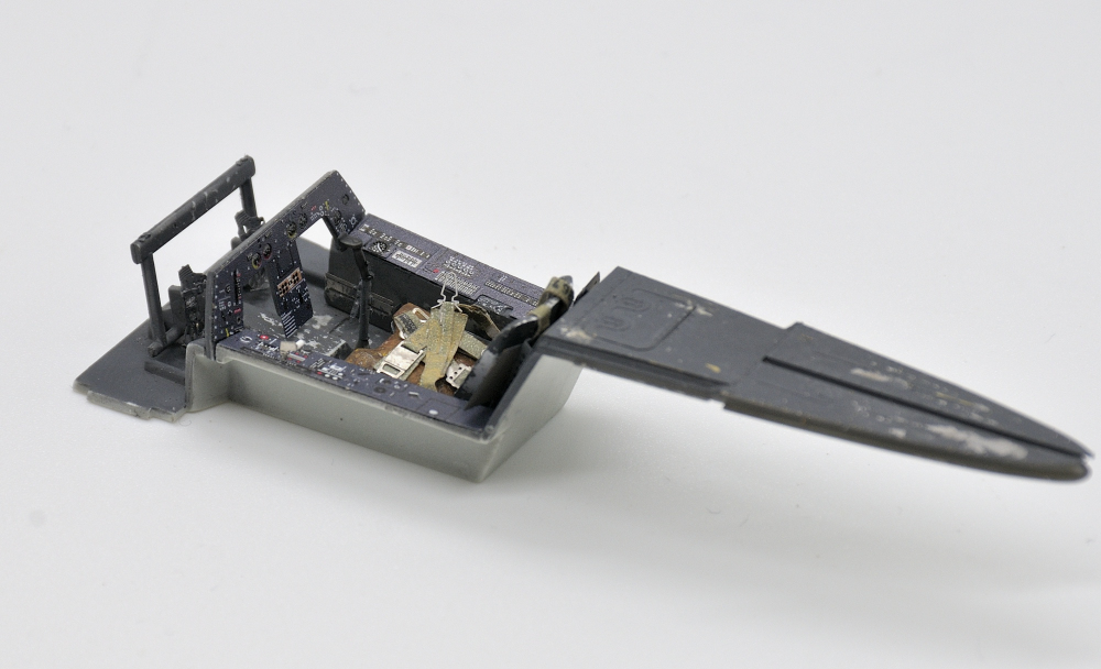

A bit of work on the pit and cockpit sides

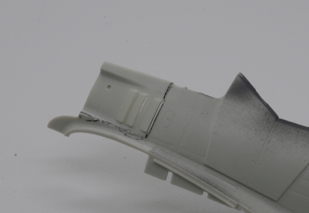

I think i will cut open another panel on one side at the front as a lot of the engine mount detail and ammo boxes will never be seen if i dont ?
cut about here maybe ?

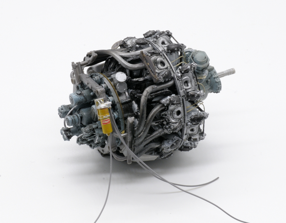

and one for Saul. I added this bottle but it has no plumbing in the instructions so i dont know what it is or where to run the pipes ?

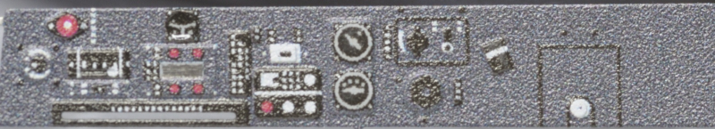

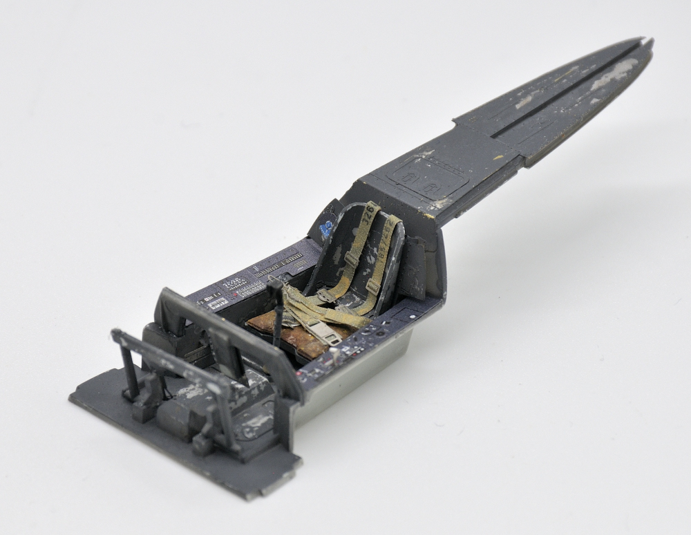

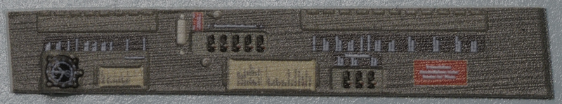

I went with the PE in the end but TBH i think the 3D would have been just as good, i might try and flat coat the PE, i dont like the semi gloss ink they use.

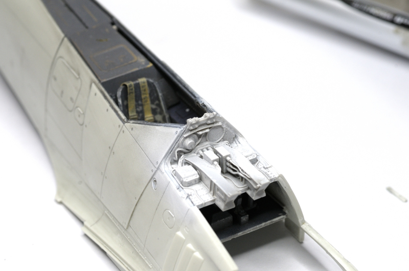

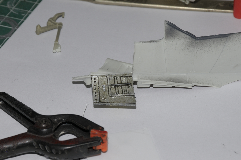

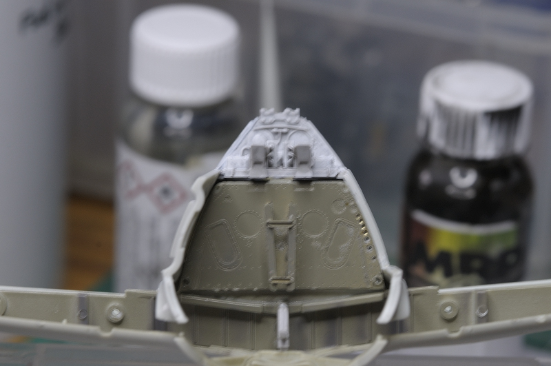

I decided to open the panel that would cover the ammo boxes. Not sure if it was a good idea at this stage but i have made a mock up replacement panel as the bit i cut out was not usable, way too thick and with no detail inside obviously. Not really sure what the inside of this panbel would look like so i have roughly based it on the resin panels from Eduard for the engine covers. With 3 staggered flaps.
If i can find a picture of the inside of the panel and it withing my capability i will make a better one.

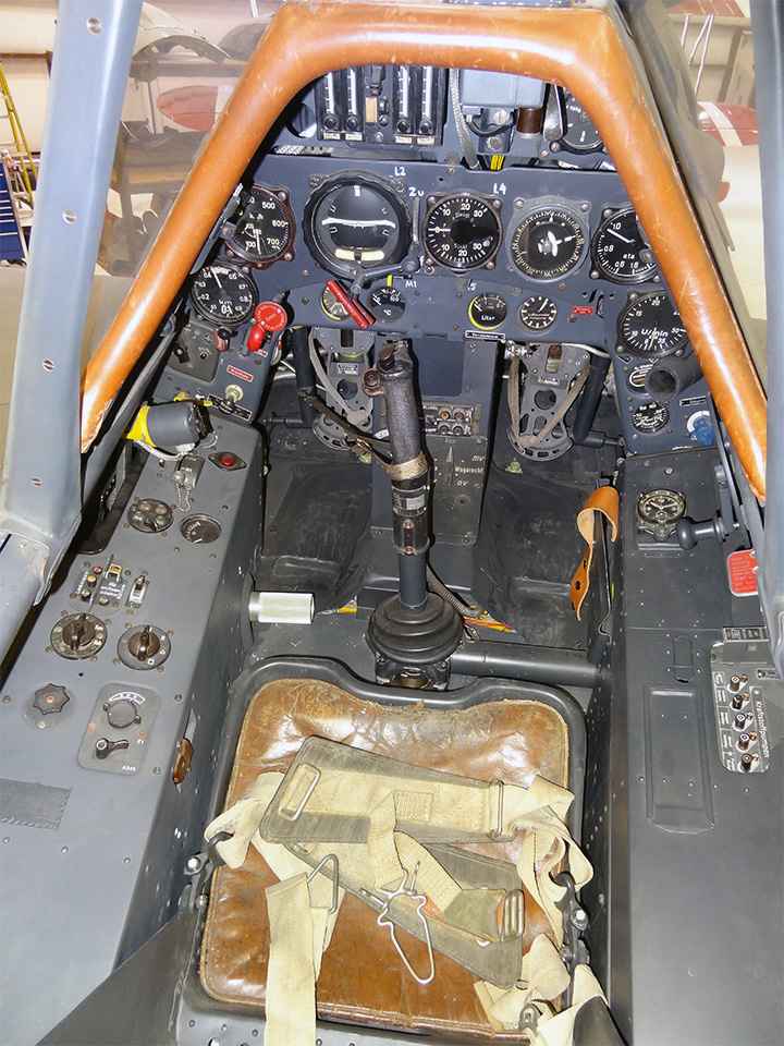

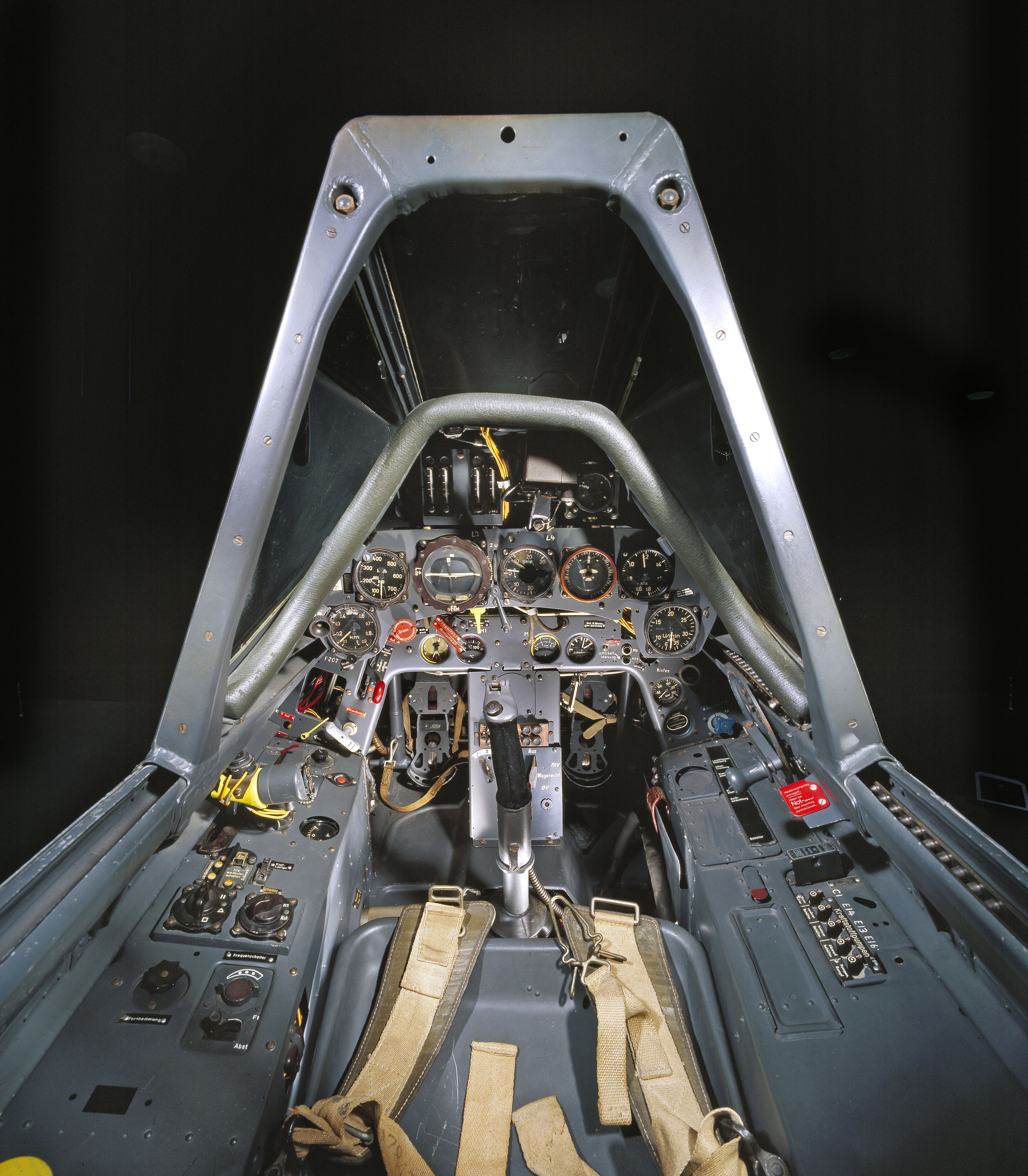

This is a picture of the A8 in the heritage hanger USA, a 1944 example. Note the RHS instrument console which is all but empty
and another
and this is the 3D and PE example
its hard to see these as the same panels as the actual machines above ?

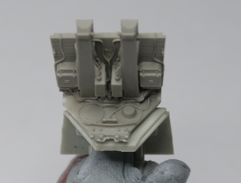

This is a picture of the Eduard gun platform back to back with the Revell one.
The bottom kit part fits like a glove, the much narrower Eduard part doesnt . you would need to narrow the cockpit floor to allow the fuselage sides to move in to match the Eduard part. I'm not moaning :) there are many examples of people making this fit on the web so it can be done.
I do wonder if to "detail up", you have to "accuracy down" by chopping correct parts to fit incorrect parts, whether its worth while ?

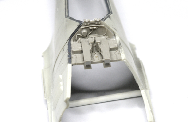

So what i have done is remove the cockpit and fitted the Eduard gun platform
this now fits. I have taken about1mm off the width of the cockpit floor and re fitted it
This looks like a fix but it will inevitably cause problems down the line, possibility of canopy/screen being too wide, wing fit/gap at wing root and this for starters
The fire wall needs to be narrowed to fit the slightly narrower cockpit EDIT...you cant narrow this part because it will remove the top engine mounts position so you will need to thin the fuselage sides....oh great :)
