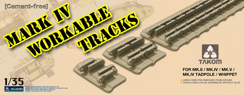

As I mentioned maybe the Mk IV or Mk V tracks would do. Fruil is ATL-160. Or you could try Takom like these
http://www.michtoy.com/item-TAO-2008X-Workable_Track_Link_Set_for_ALL_British_WWI_MK.IV_Heavy_Tanks.html
Look close and with mud you wont notice the litening holes not being there.
Let me know the size of track shoe and I will measure the Takom set for you.

Thanks James, think I'm going with plan A. Those tracks have a curved grip, the Cat ones have a very sharp blade, that's too much difference between them, especially if I'm going to be showing this thing.
