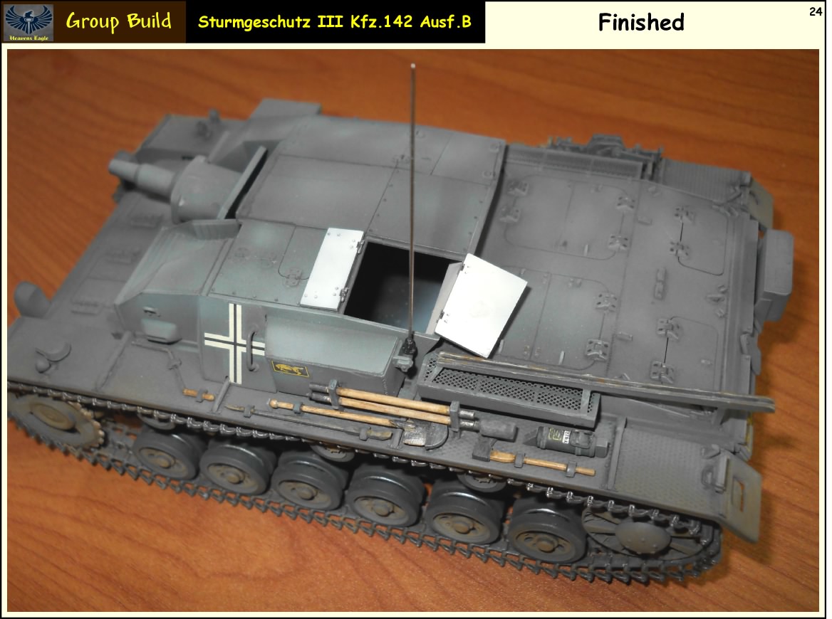

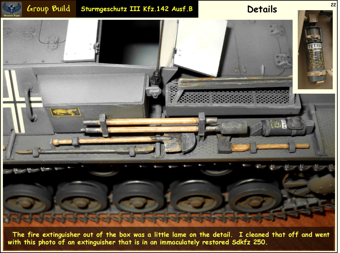

Here are some photos from my old Sturmgeshutz build.
Note I have since painted the interior of the doors panzer grey. The light blue tint on the roof is more from the camera than the model. They are actually a lighter tone of the grey that is on the rest of the tank.
