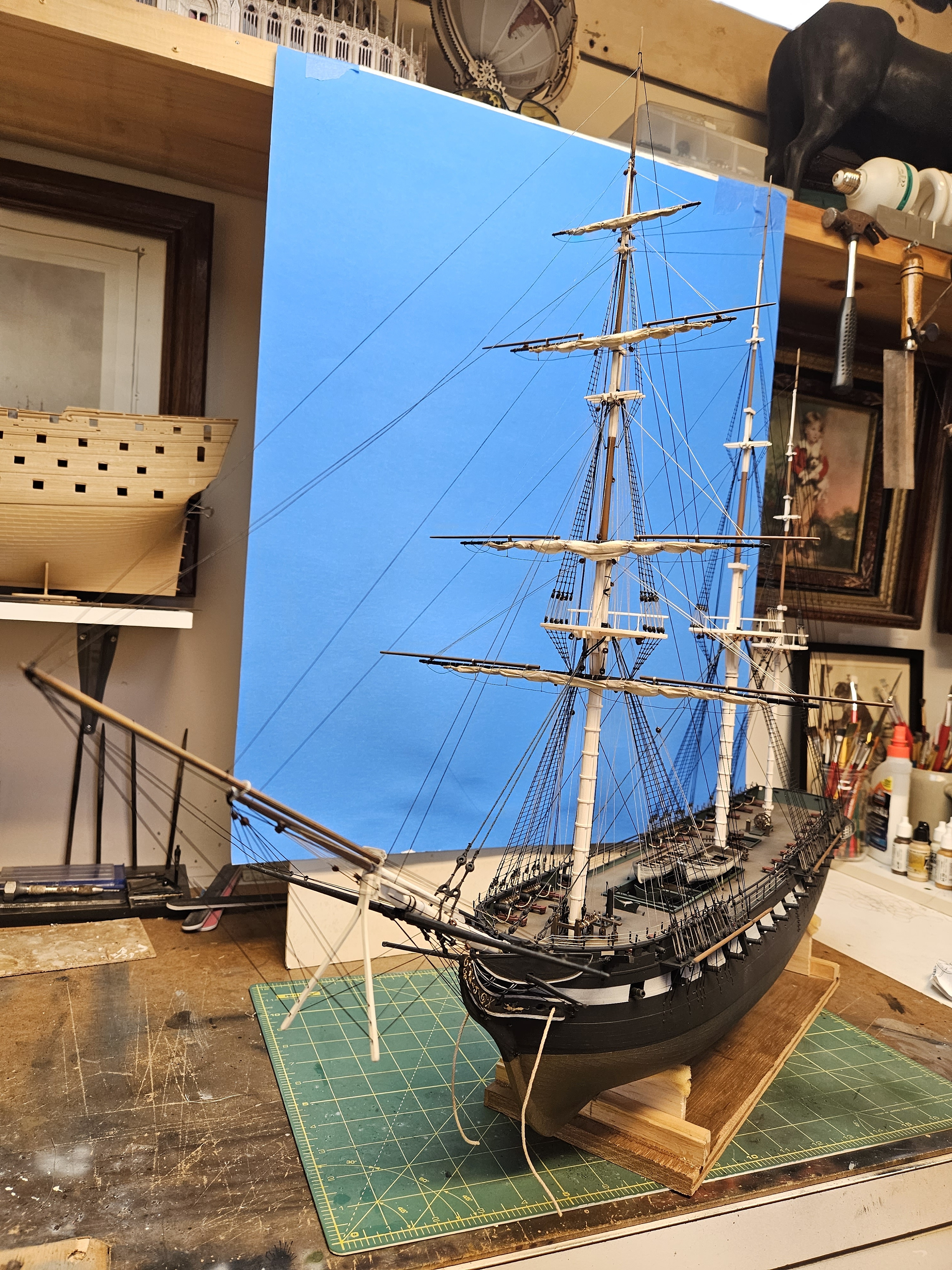

1/96 scale USS Constitution build.

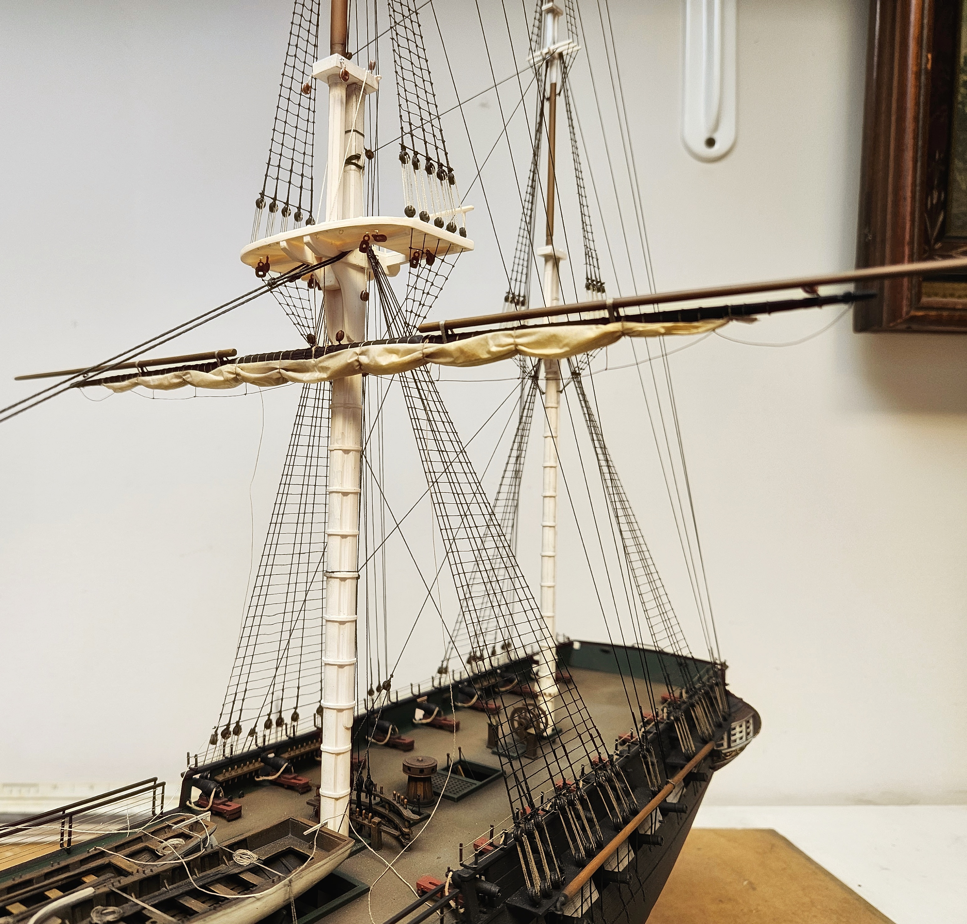

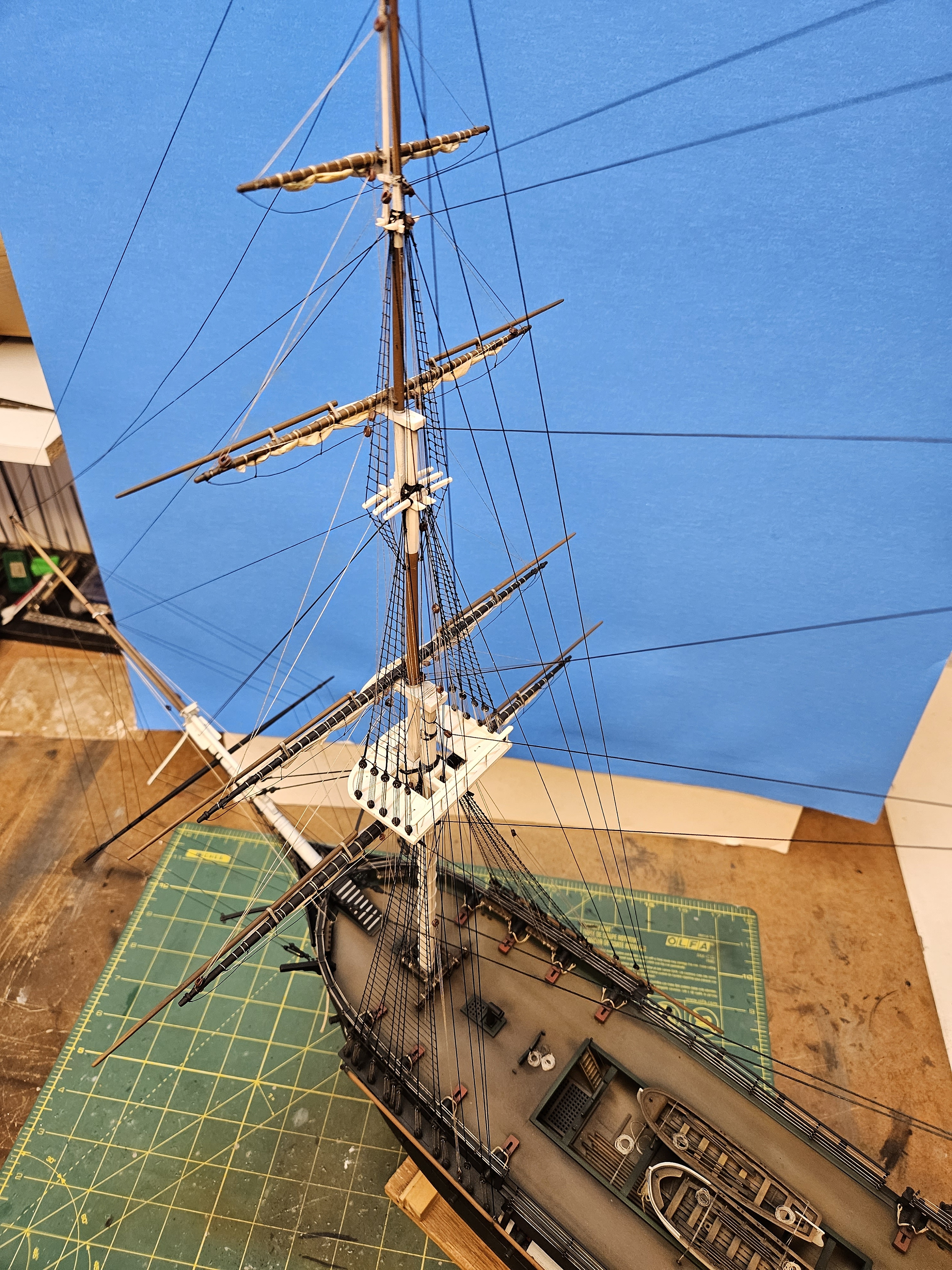

The fore mast is done. On to the main mast.

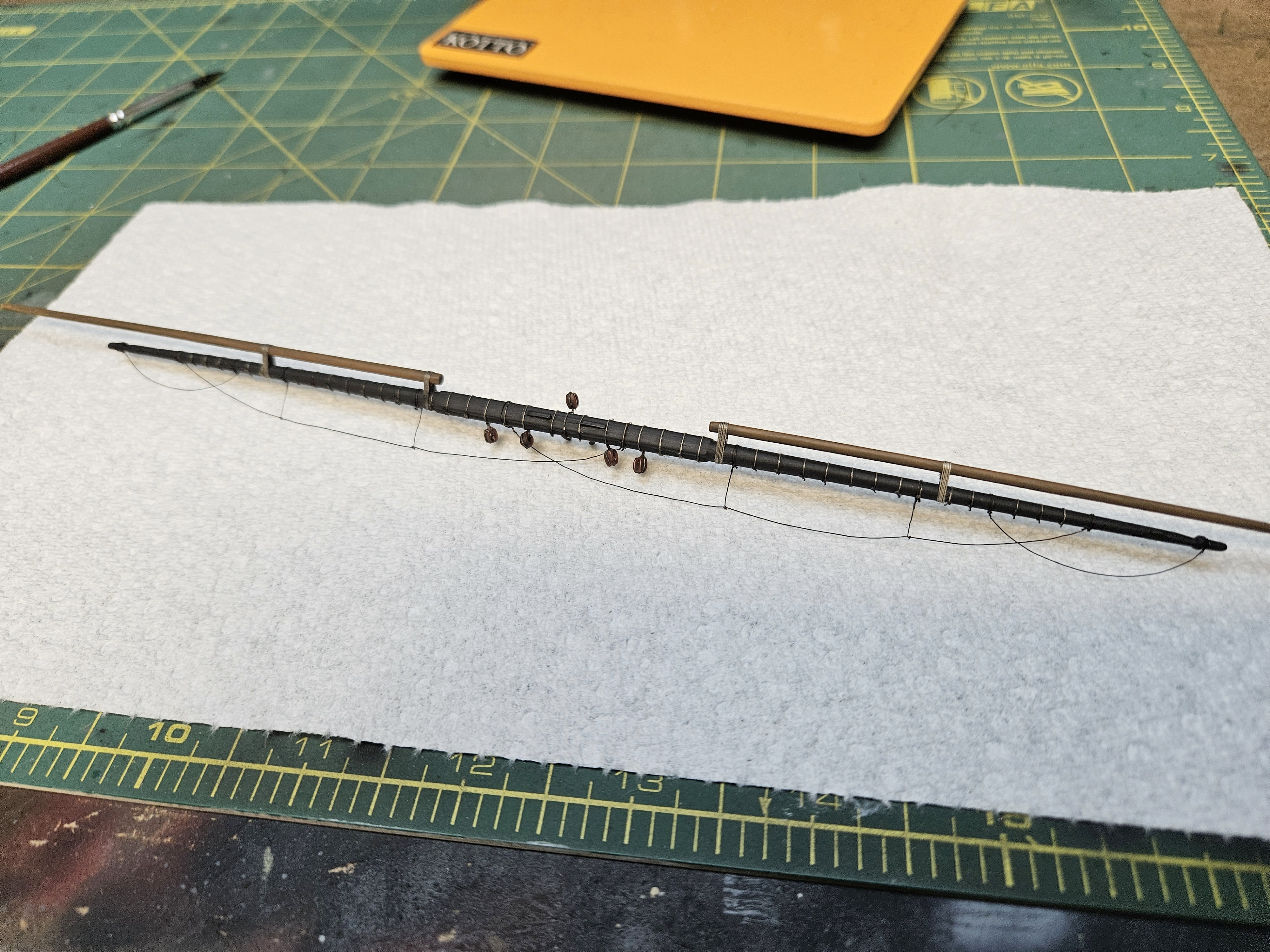

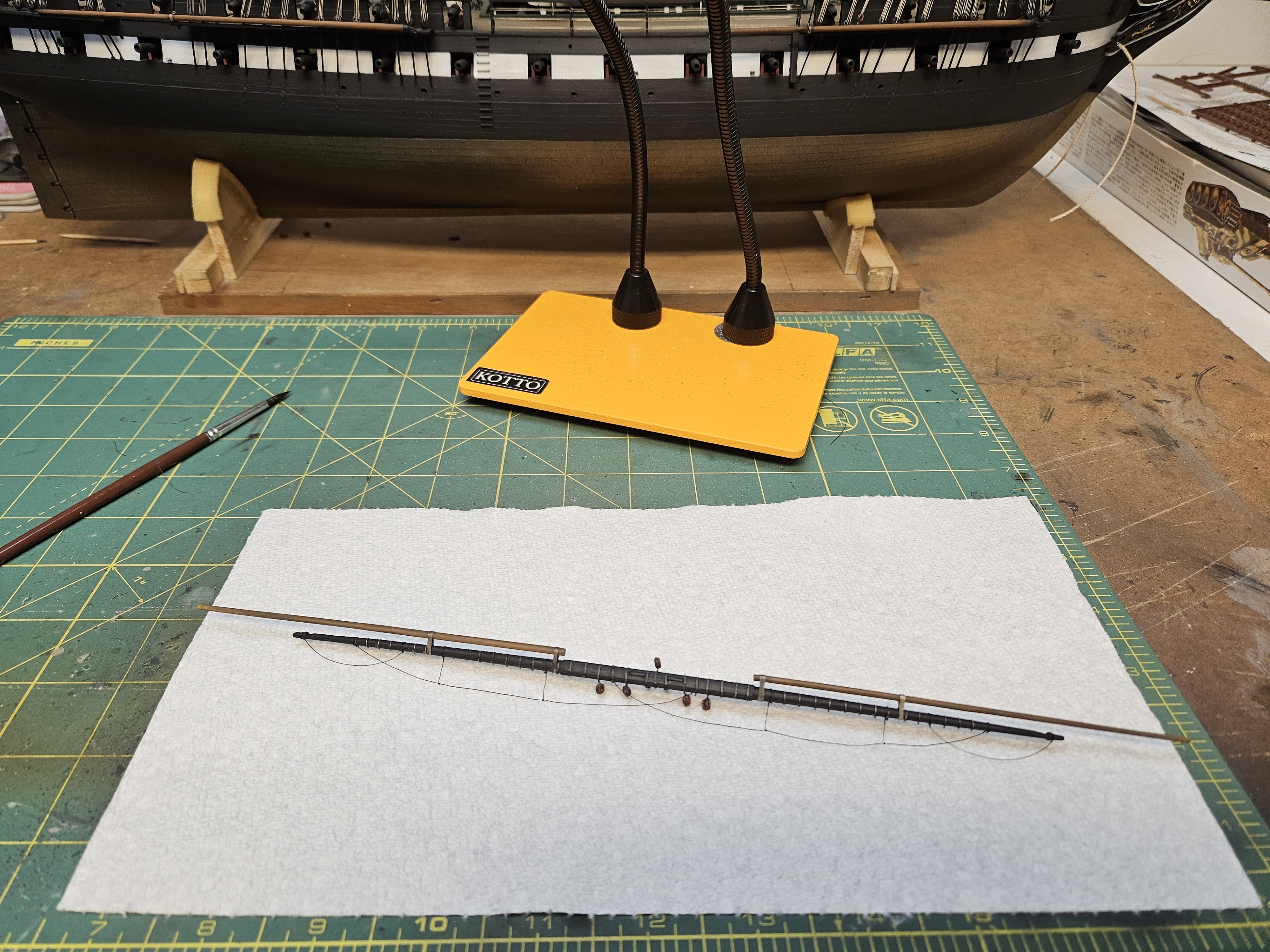

The main top yard ready for the furled sail to be added.
The foot ropes, the thin black lines hanging below the yard, are the hardest to model. Using actual thread line doesn't work well at this scale because the thread doesn't lay right and is way
over scale in thickness. I'm using very fine copper wire. Once on they're painted black. It's a very fiddly process.

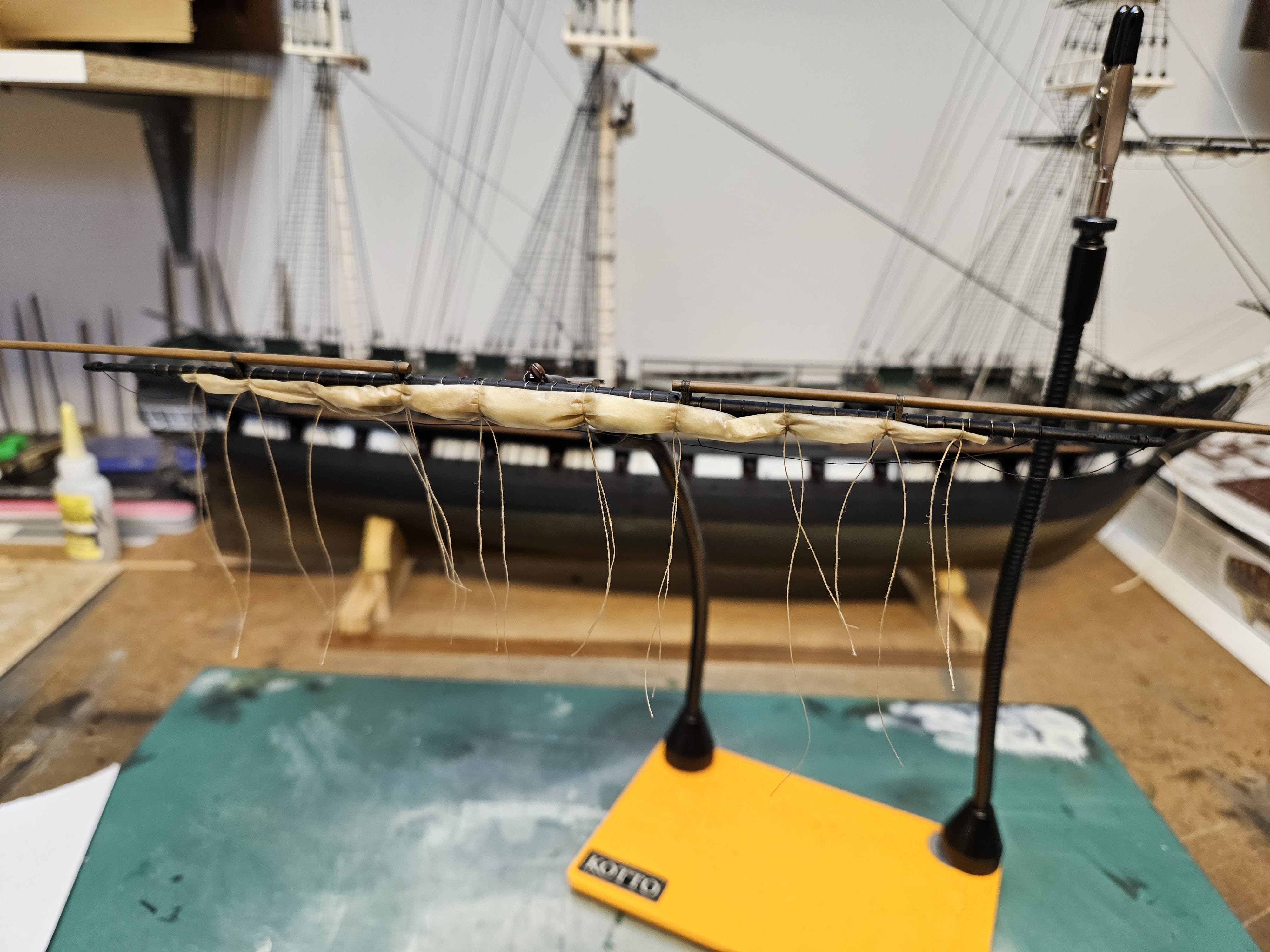

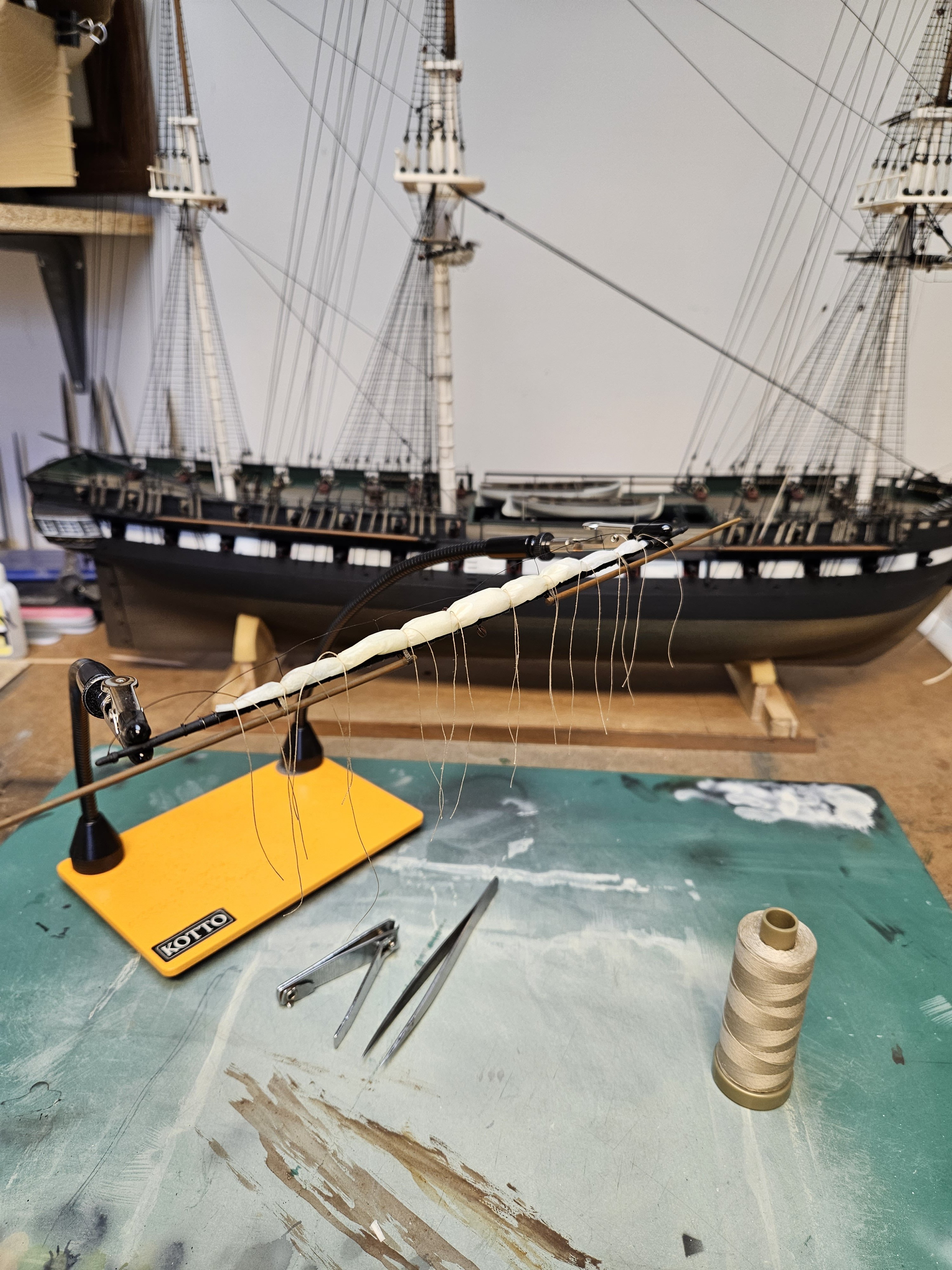

Letting the wetted silkspan dry after it's been tied to the upside down yard with the gasket ropes.

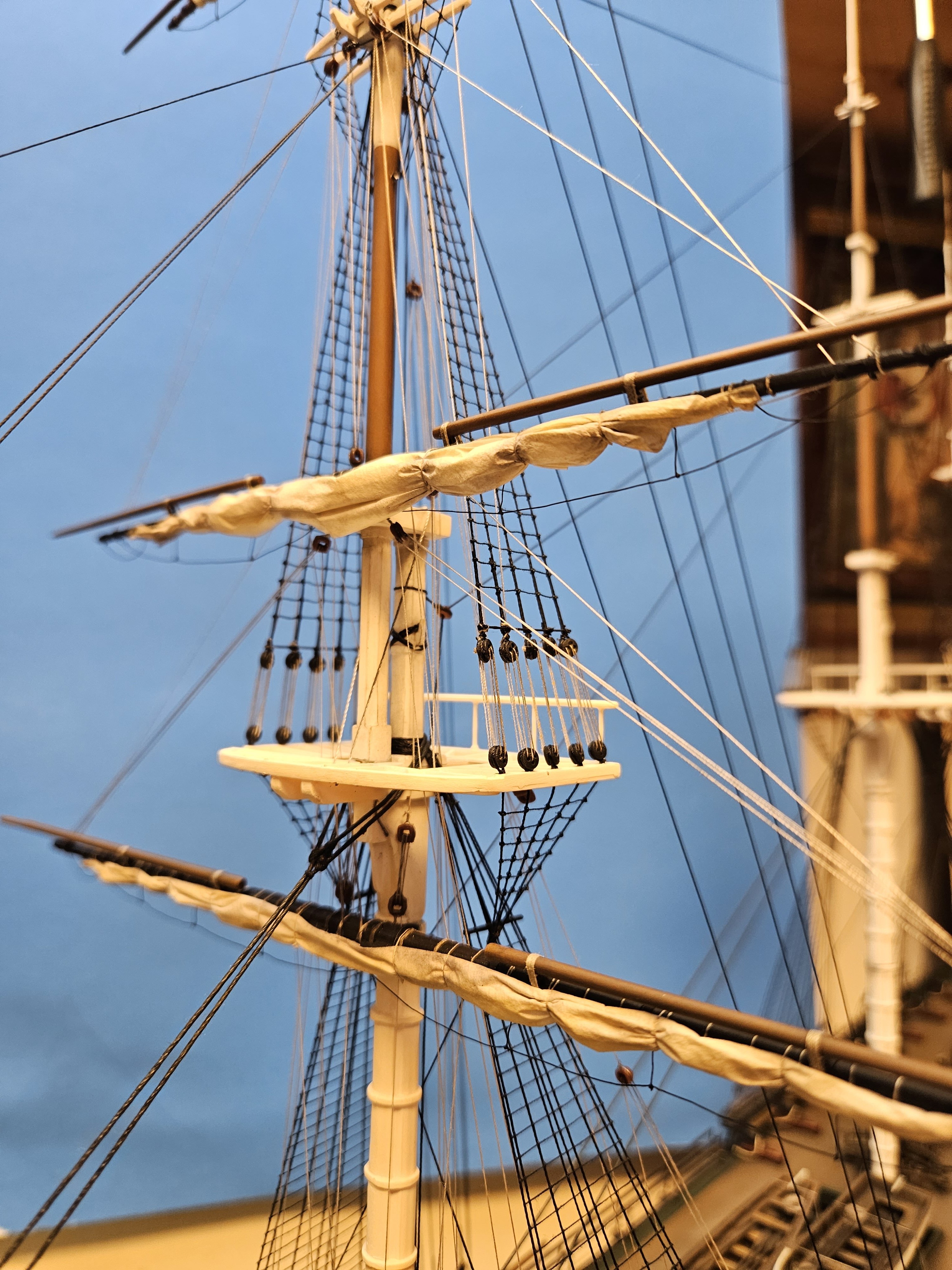

I'm weathering the sails using watered down ochre brown and MIG grime shader. Still wet so it'll tone down after drying.
