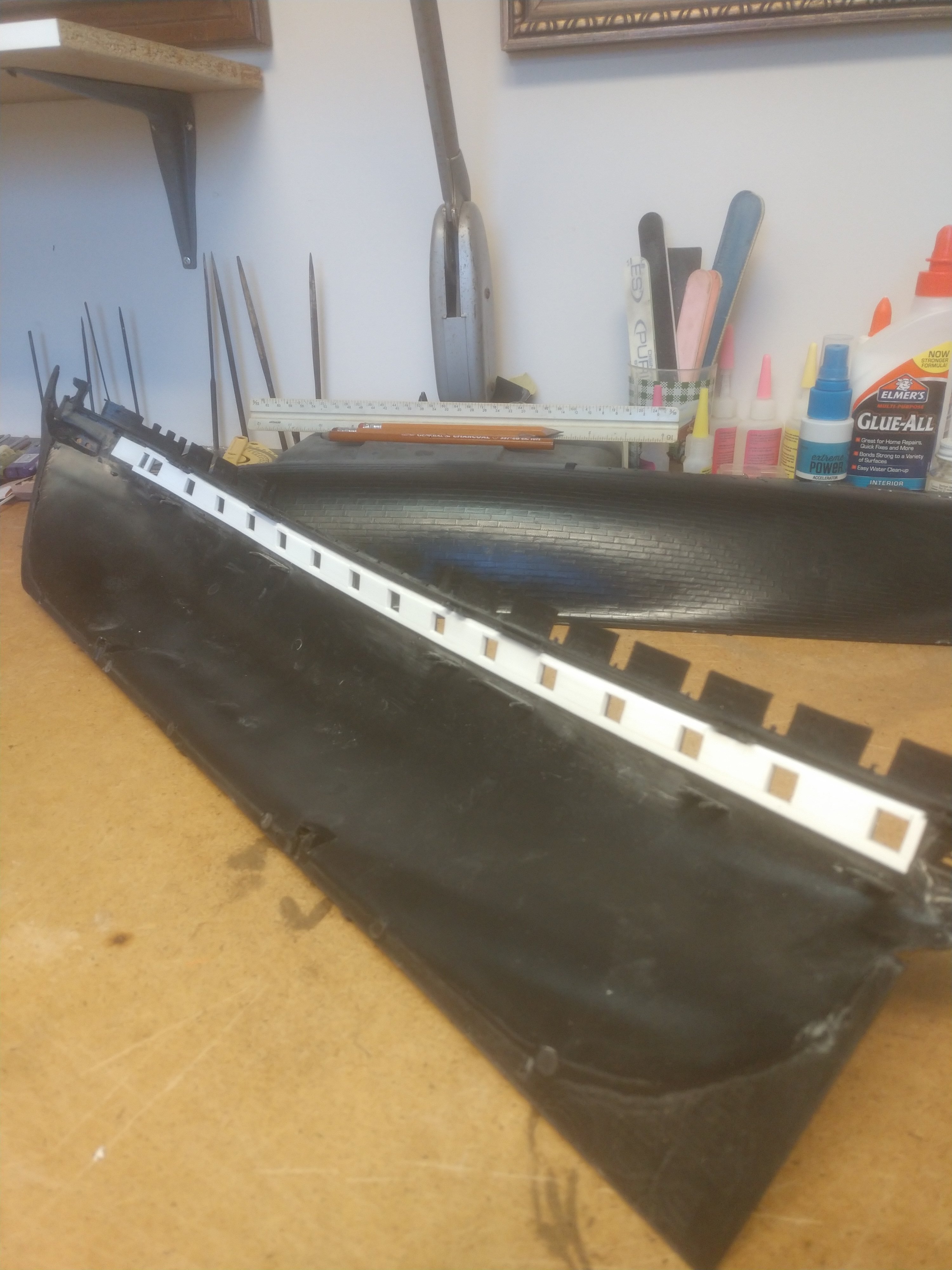

First things first. The hull is to thin for scale thickness. Which is noticable at the gun port openings. I added the thickness to the gun deck walls with styrene strip before glueing the hull halves together. Constitution's hull thickness here was/is almost two ft.
Some of the mods I'm doing on this build will never be noticed. The model will be a waterline display under full sail. with the studding sails I'm guessing the case will be at least a couple ft wide. Nobody will really be any closer than three ft when looking at it. So, the extra work won't be seen, but it will be there.

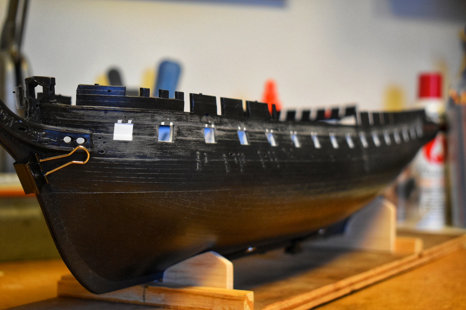

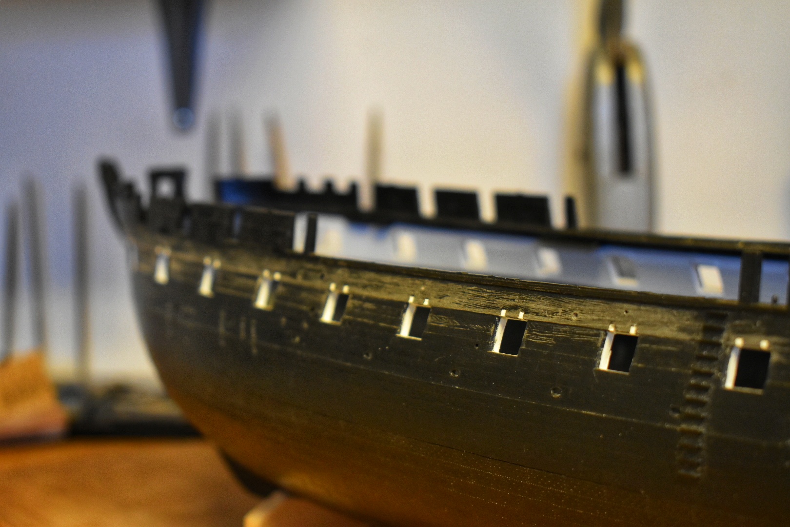

According to some reading the forward most cannon ports where added after the War Of 1812. Most experts say they were impractical to use, and the ports remained closed on them most of the time. I chose to bring it back to the 1812 period. I filled the ports in with styrene.
While on the gun ports. The kit has the hinged one piece port covers. Some say there were actually no hinged port covers on Constitution in the early years, using covers that were removed instead. Since it was common for these ships to cruise with the guns ran out most of the time the covers stayed stowed on deck. I used bits of styrene, and putty to fill the hinge points on the kit.

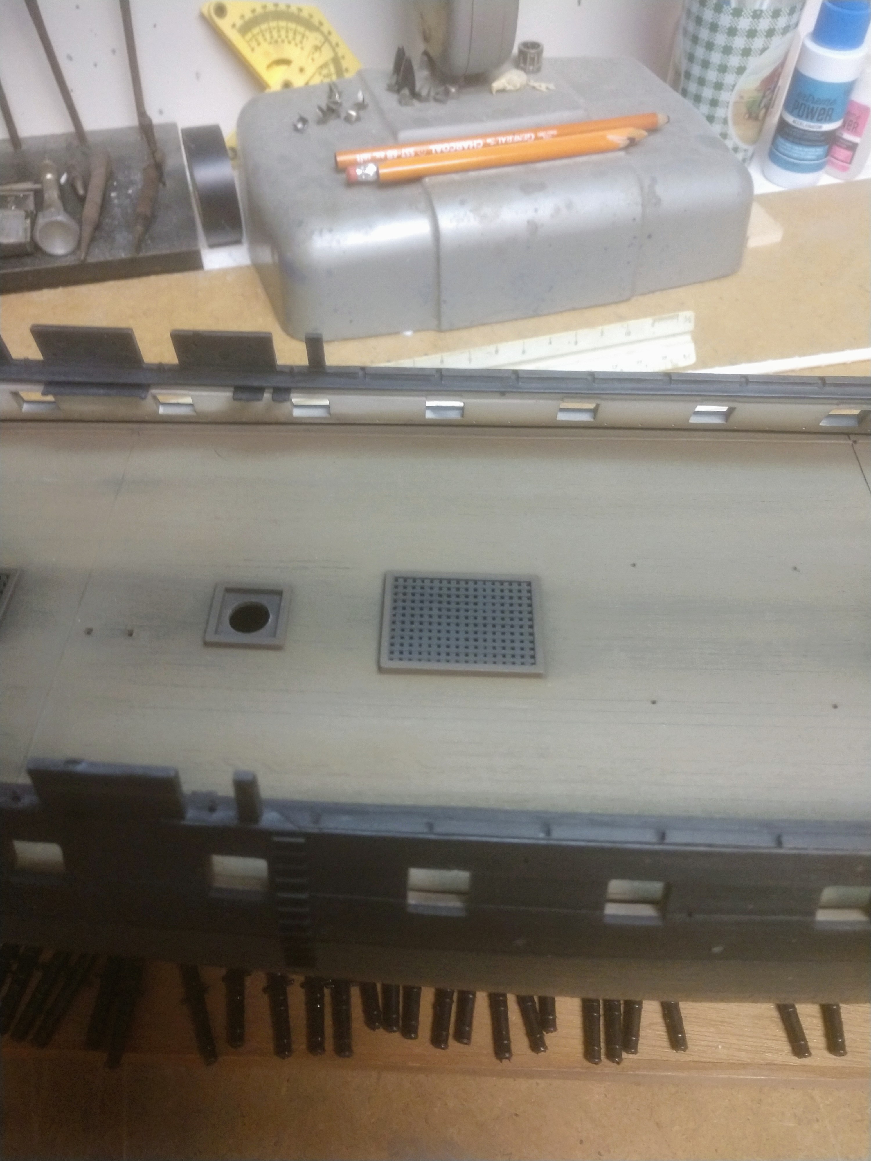

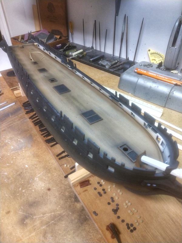

The hull haves could finally be glued up. Lots of sanding required to get the to halves to look like one. The only painting done so far is on the gun deck. I'll mask it when I paint the hull and inner gun deck walls. On the real ship the decks took a lot of abuse. I read that the decks were scrubbed daily with soft stones. This plank scrubbing was called "Holy stoning" it left the oak planks looking bleached out.
Not following the instructions steps in order. To keep the build interesting for me I'm going to be jumping around with the construction.

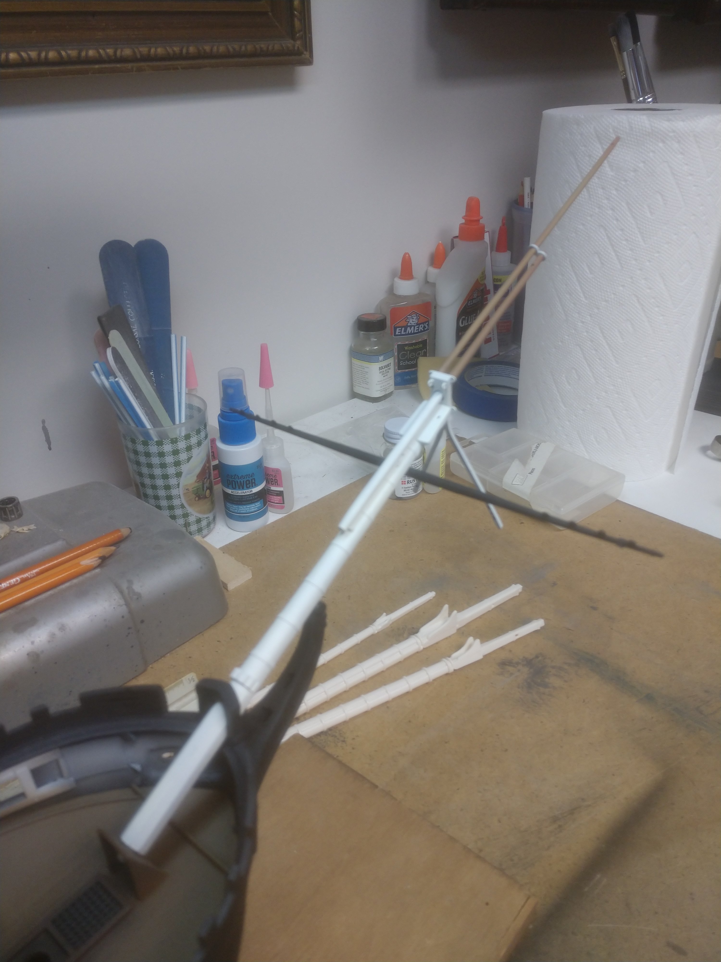

Here's the basic bowsprit with the jib boom, and flying jib boom. The kit supplied plastic jib boom, and flying jib boom are to flimsy. They will have tension from the rigging lines on them. I replaced the two booms with ones I made from bass wood. They're much stronger. Notice the flying jib boom is actually off set to the side of the jib boom.
