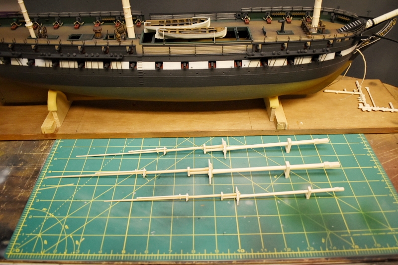

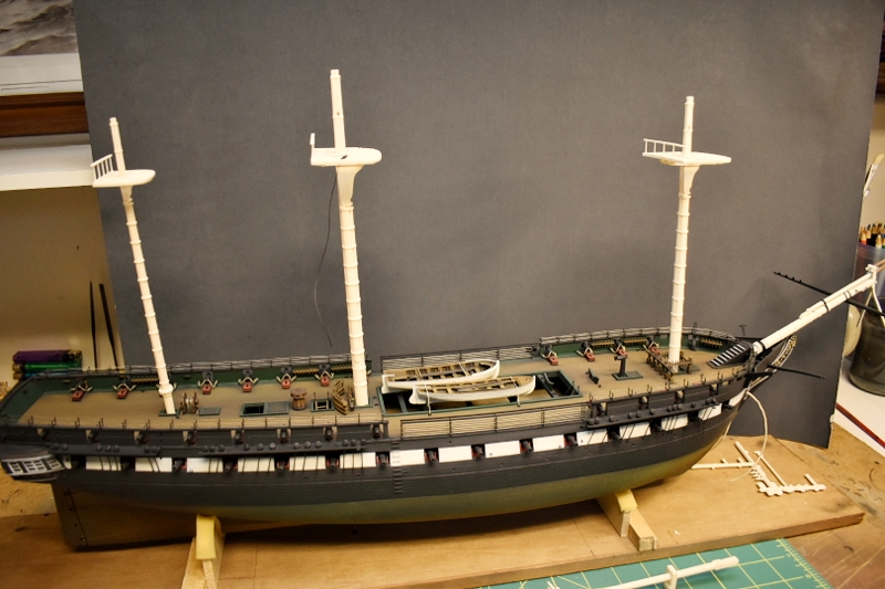

It was a big day for the build. I have all of the masts glued up and everything is straight. Because I'm not using the molded kit's shrouds I won't be following the instructions at this point. The lower mast's will be glued in place and the shrouds will be rigged. Then the upper mast's will be glued to the lowers.

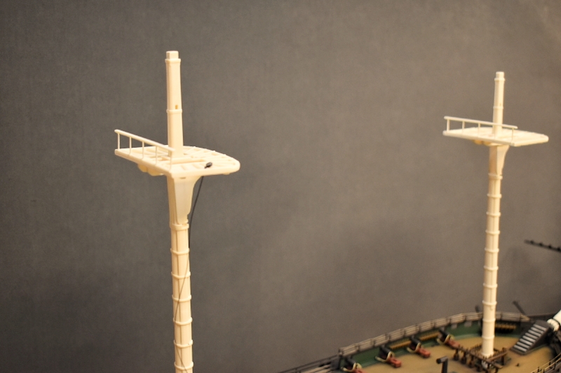

I spent a lot of time cleaning flash and thinning down the fighting top rails to make them look more in scale.
The key to success with this old kit is patience.

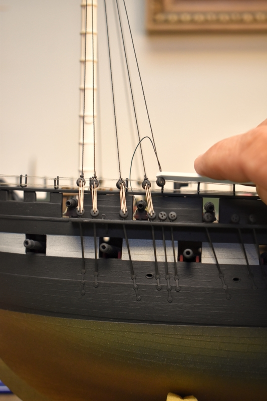

Using a piece of scrap styrene to get the mast shroud deadeyes at the same level with each other.
The styrene strip has a proper size hole drilled in it so as to keep enough tension on the shroud line threaded through it to hold the deadeye while it's slid up or down.

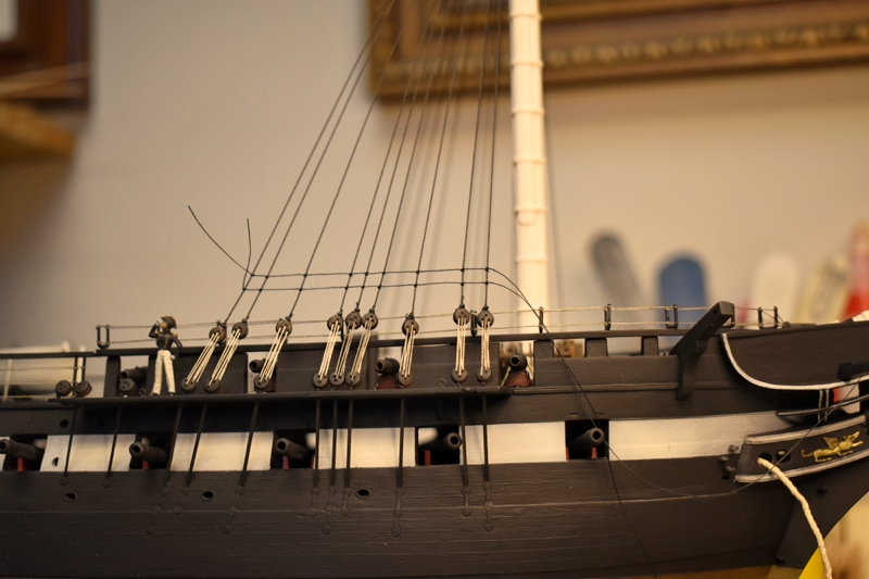

I did a couple of ratline runs on the shrouds to see what issues I might encounter with them. It's critical that these run straight. I'm using clove hitch knots and they seem to not be to out of scale so I'll go with that plan.
I'll remove these two practice runs and get serious with them now.
