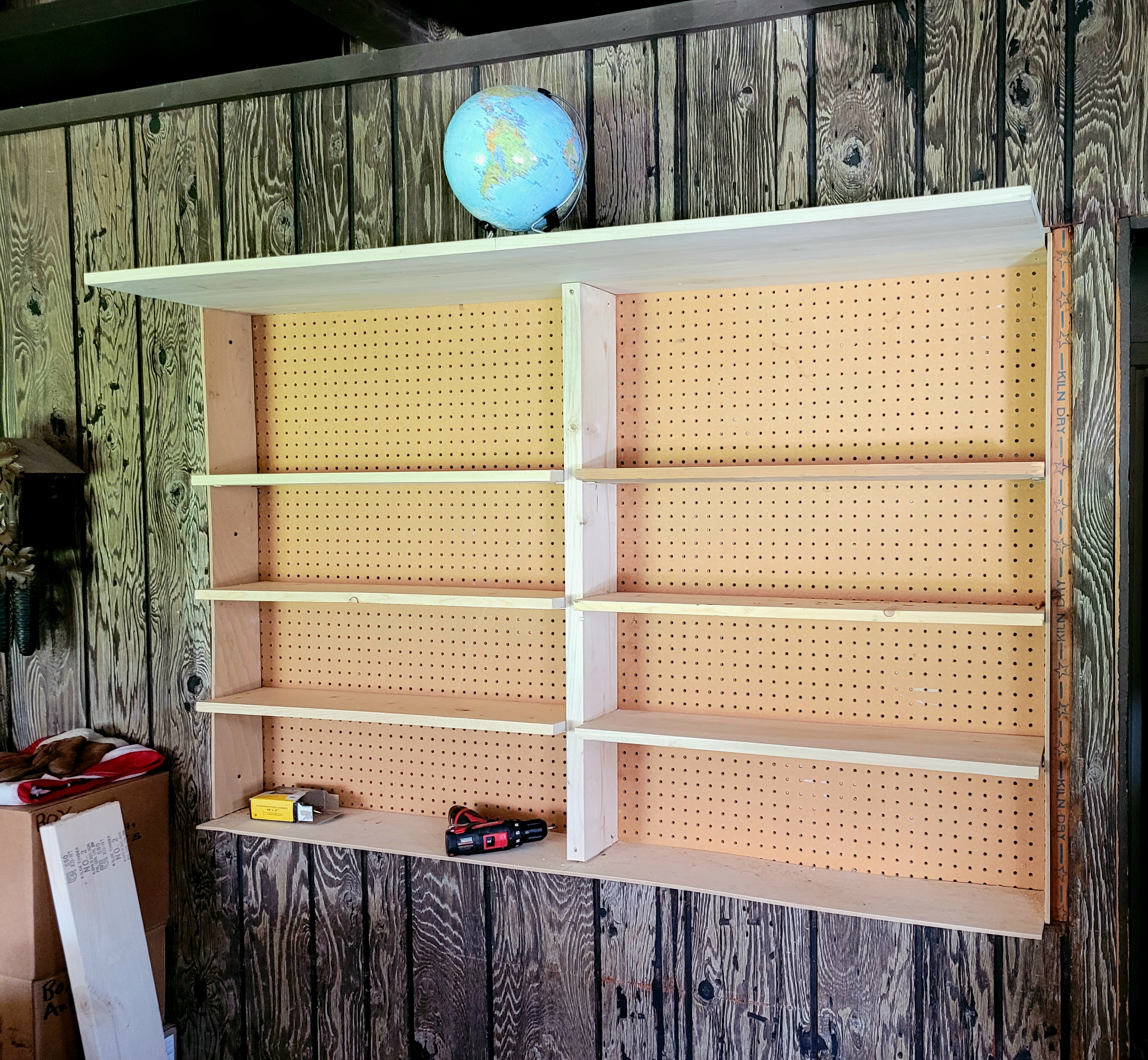

I KNOW the Monticello show is in 2 weeks. I hope to have CSS Arkansas and USS Carondelet ready to present. Arkansas' little boat was stuck to a bit of tape that I could not find, so I picked up my desk a little. I was happily modeling along, then I heard a sound. Several Sounds, in truth. Sawing, impact driver going. Hammering. I went to see what was going on in the off-season for Santa's workshop. My Sweetie was working on her DVD Shelf project. :facepalm:
As we make my former bachelor pad into "Our House" Teresa has LOTS of ideas.
Then This happened!! My old entertainment center is EMPTY! (notice my in-scale Death Star orbiting near the Earth?) Time to give it to another single guy!

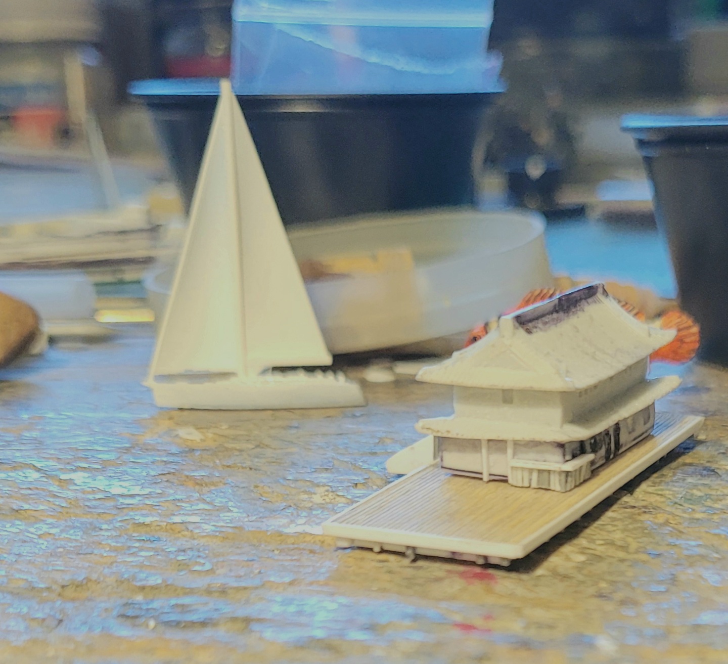

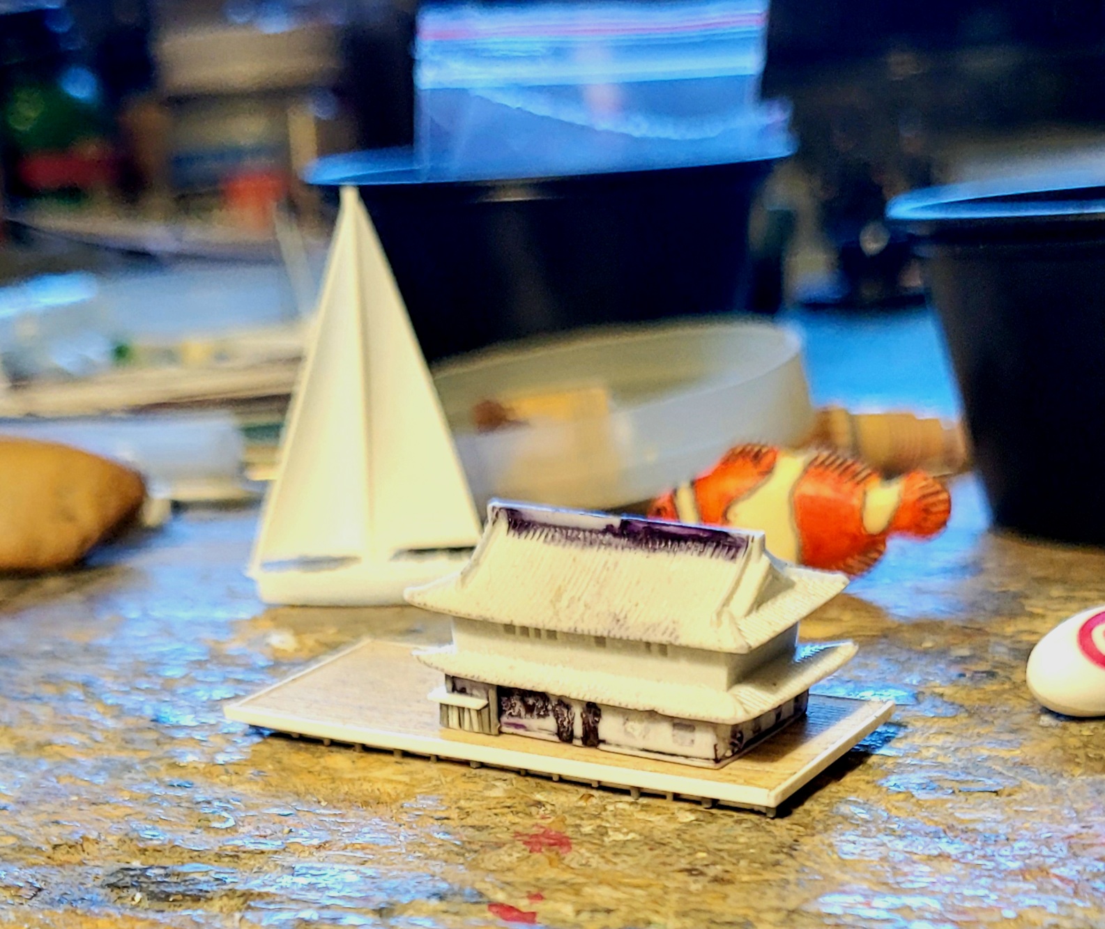

I digress, as usual. I never did find CSS Arkansas' boat today. I DID have another idea (ME?!?) and made Tiki-Bar 2.0.
A Japanese/Philippine "Comfort House". On pilings to avoid any storm surge that may occur. Classic staircase by the entrance. Generous sun deck, Tiki-bar with bamboo log texture outside. Guess what goes on upstairs? I do not wish for you Men to think I have any first hand experience in such an establishment! The "Asian House" is part of a set I bought from David Angelo. The deck, pilings, staircase and Tiki Bar are all mine. I do not think it appropriate to sell this modification of another Man's idea for profit. As if TLAR ever produced profit dollars!!:tomato:
I couldn't help myself!! I pray the Lord our God will forgive my creation of a Tiki Bar/Cat house on Easter Sunday.
At very least the 1/700 PEE Foam Party figures will have a comfy spot to play.
Save yourselves!! It may be too late for ME!!
Thanks for having a look-see!!

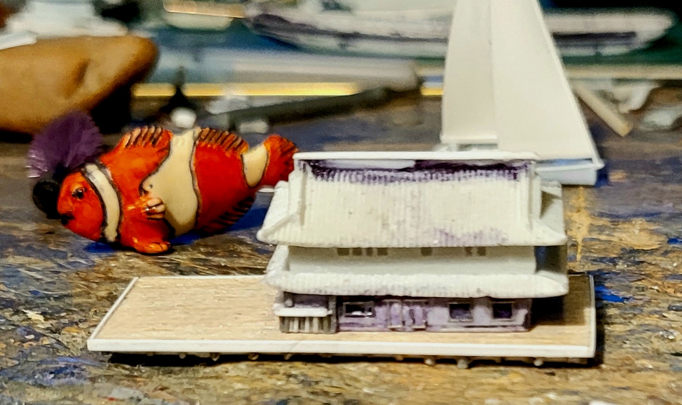

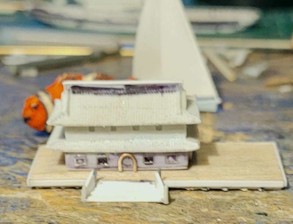

Having sanded off some of the Geisha House details, I cut PEE winders and doors and put them back on with Future as an adhesive. I plan to make a couple for my own use, then send the mold to David in the PI, since it is his "property".

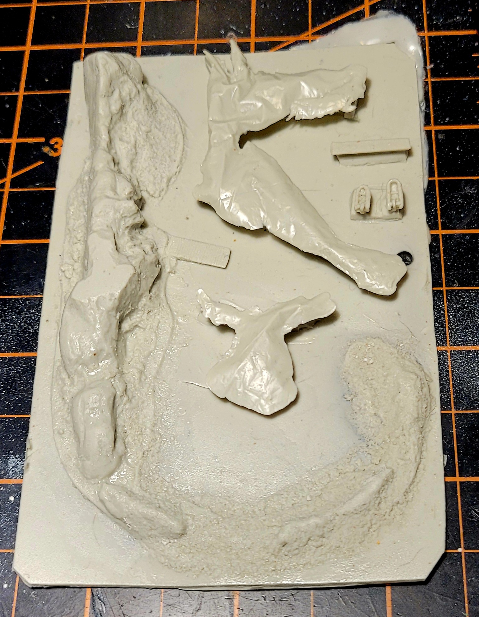

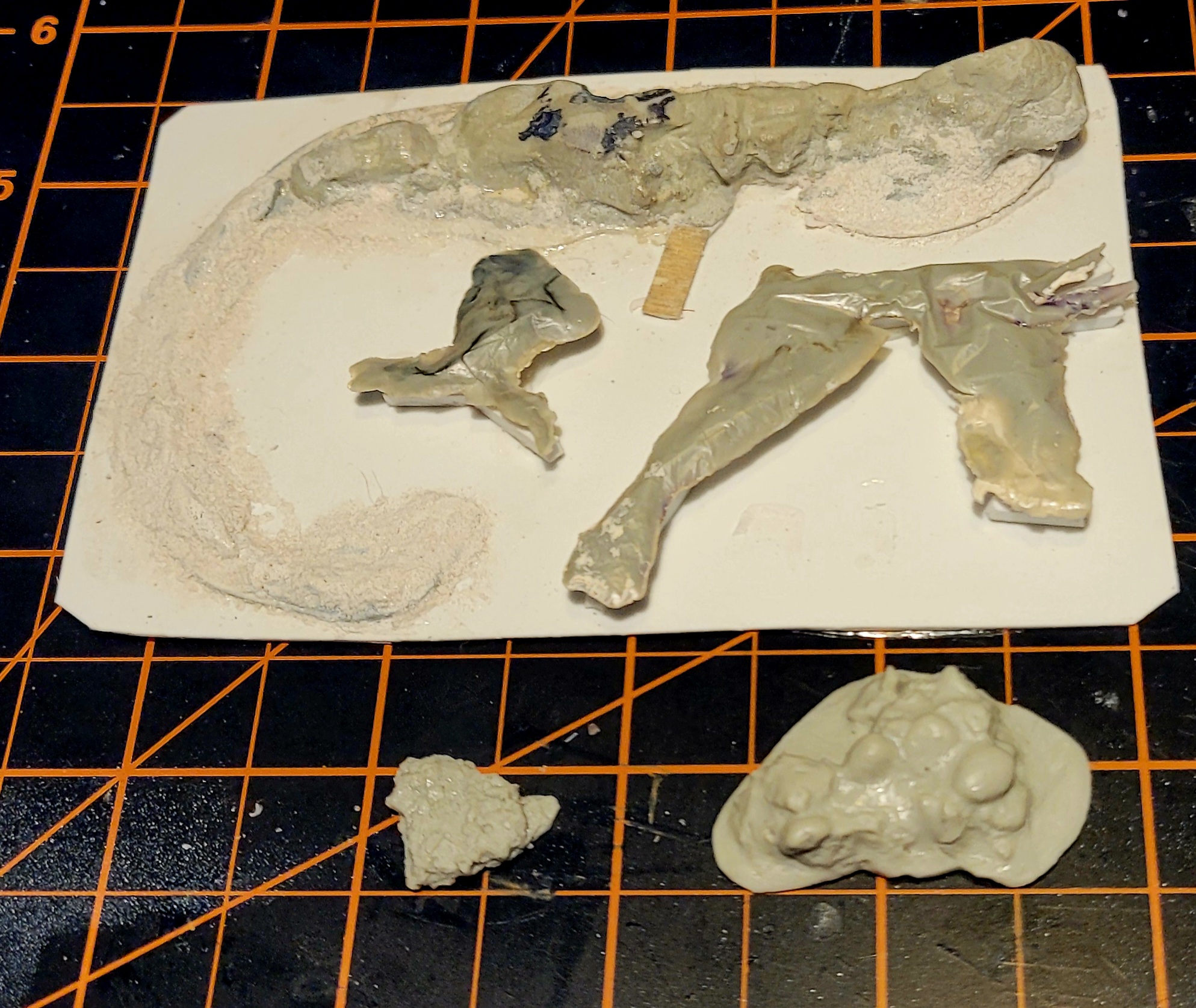

Every handful of pea-rock of chunk of crap I run across is material for modeling. Sometimes I spill resin while I pour castings and it runs into an interesting shape. I mold the more interesting ones. Sometime I actually make a new island on purpose!
These 5 new islands are additions to Kit #519. I am contacting every TLAR customer that bought this set to offer the "Expansion Pack" at no charge, once the new mold is cast. Such is the value added service I take pride in.

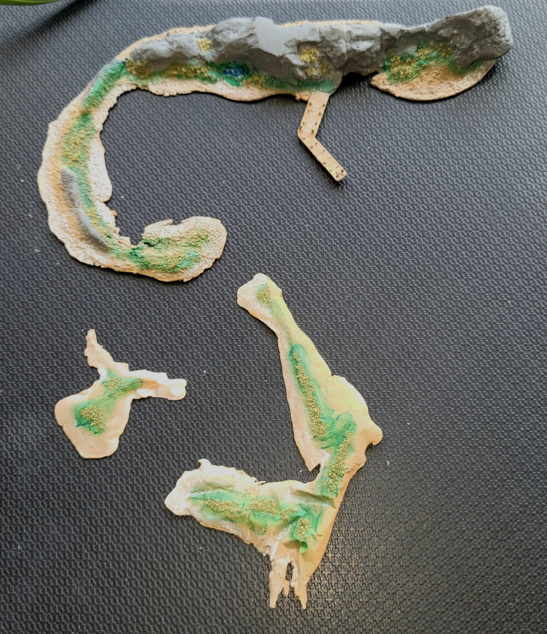

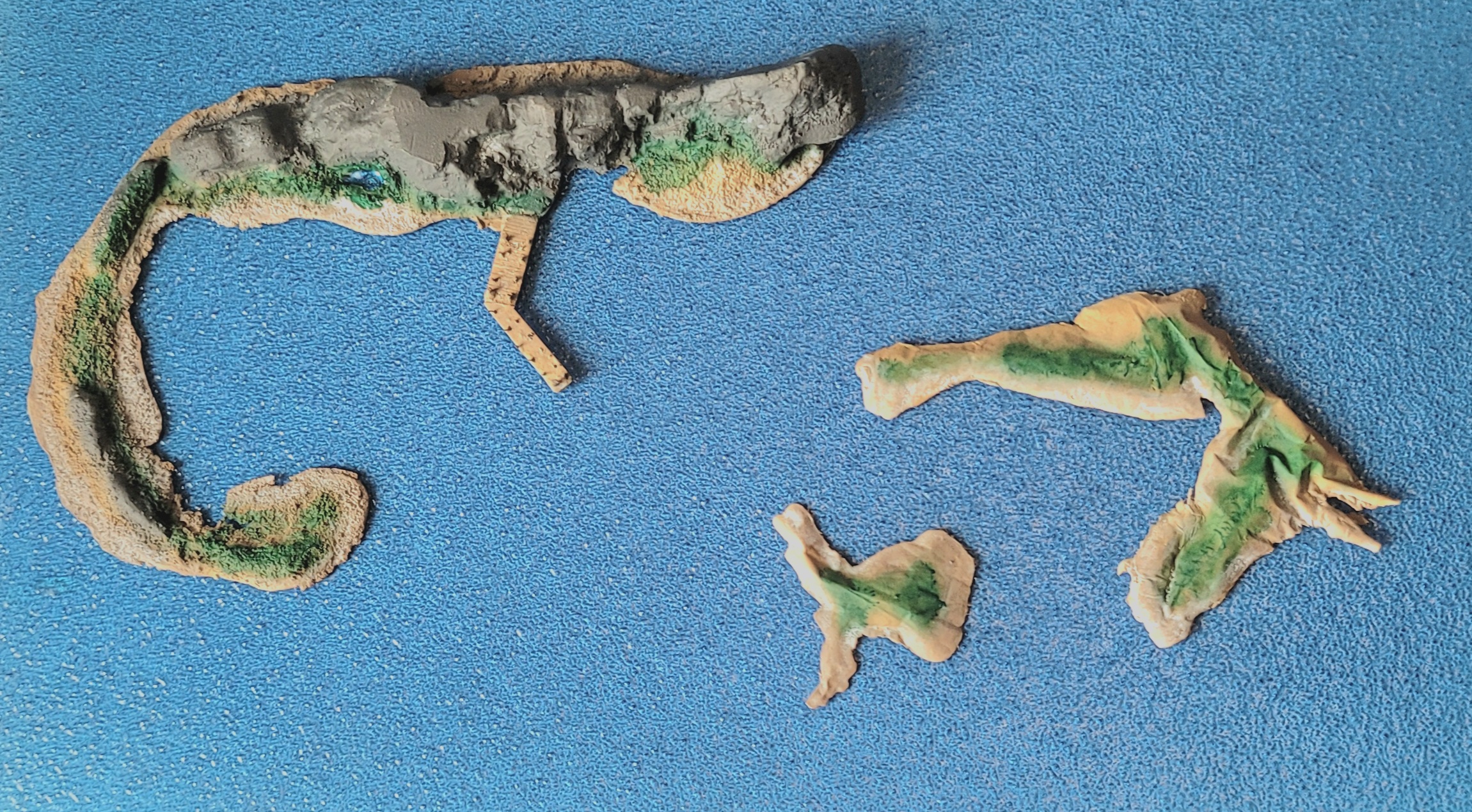

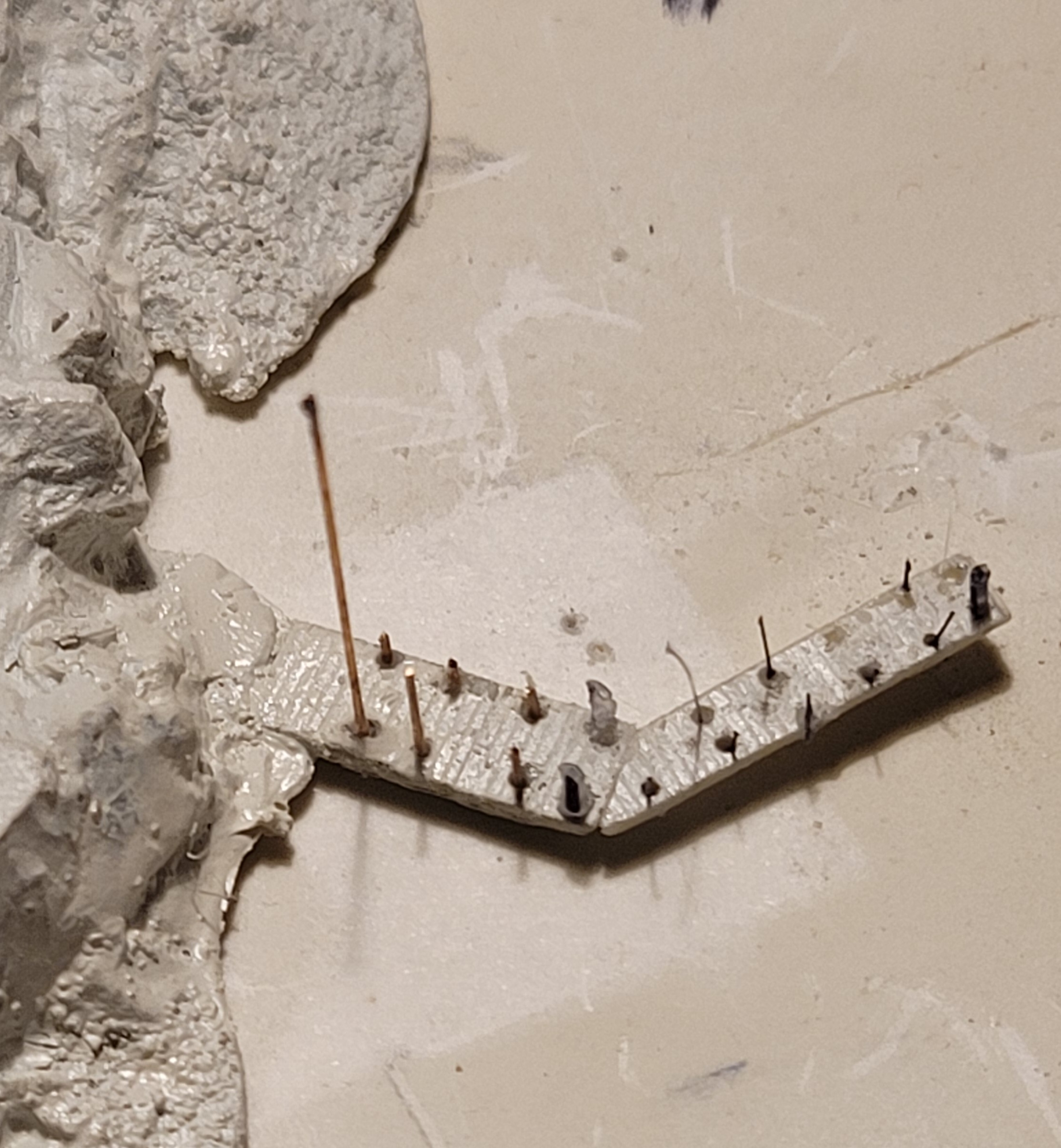

Assembling the dock on the hook island. The smaller pilings are invisible thread. Ray Powers uses fishing line for his 1/35 scale attachment loops. they paint up well and you won't break them off like wire, resin or stretched sprue. Bigger pilings are of copper rod.
New islands and dock, painted and ready for the updated box art picture. The 2 new Zodiac boats aren't pictured. There's a little fresh water pond on Seahorse Key (?) I haven't really settled on a name for the new larger island/atoll.

In the proper setting, the water in the lagoon will be shallow. pale. clear blue. I deal for goofing off in the sun. Dingys, flats fishing boats, LCPL's and zodiacs will be able to make the beach. Deeper water starts just before the dock and goes deep blue after that.

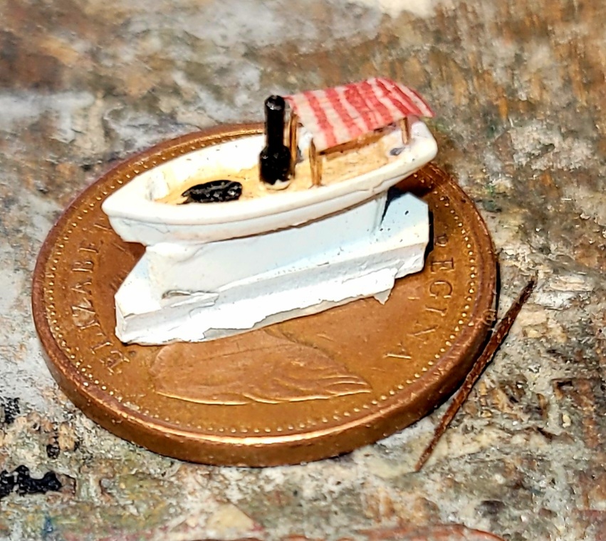

Drilling 4 #78 holes, bending copper wire and a dinky piece of sail material with fine red sharpie stripes, trimmed to fit finished The Queen.
She would not attack the German gunboat Princess Louise for a little while yet. Torpedoes can be included.
