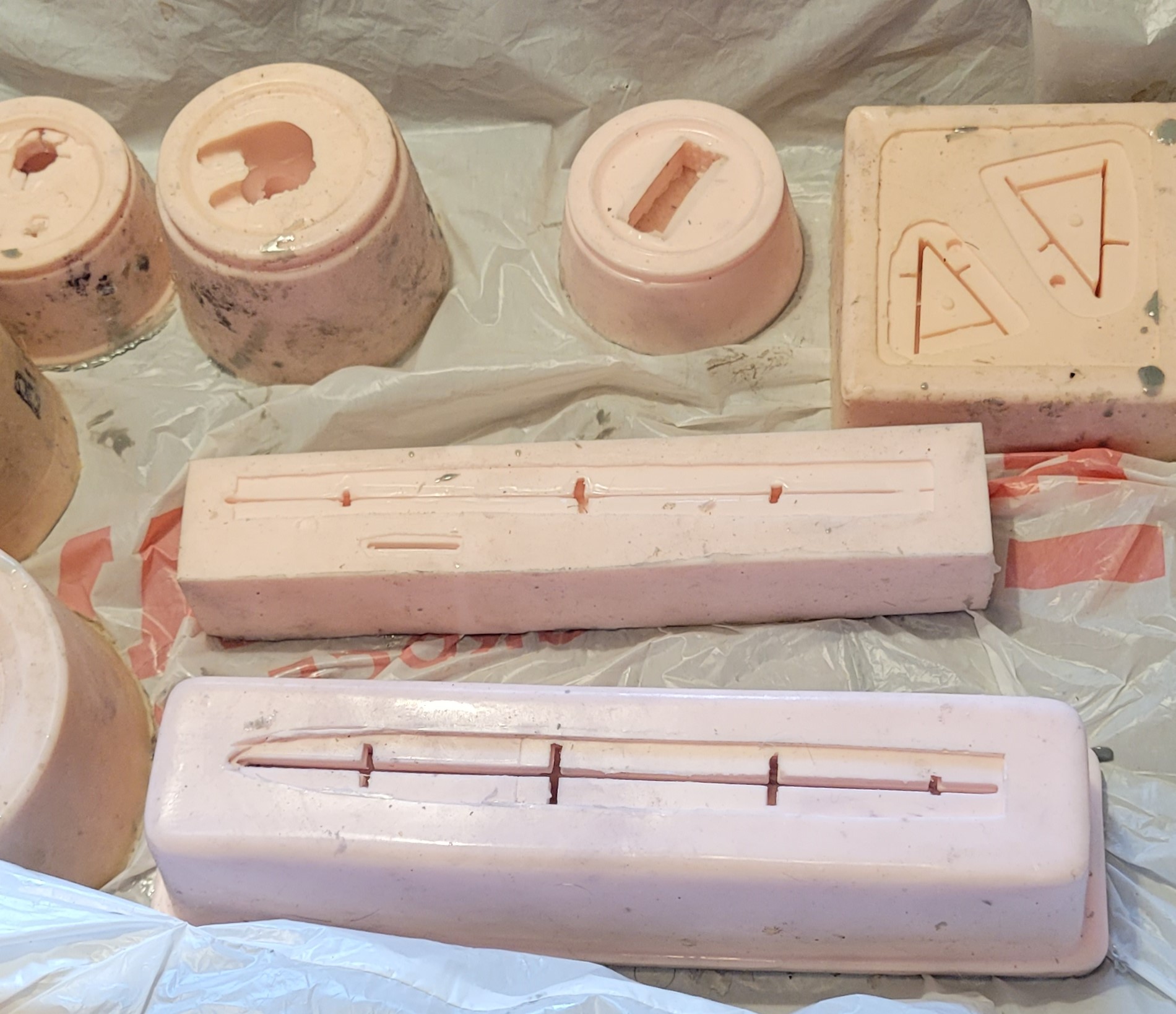

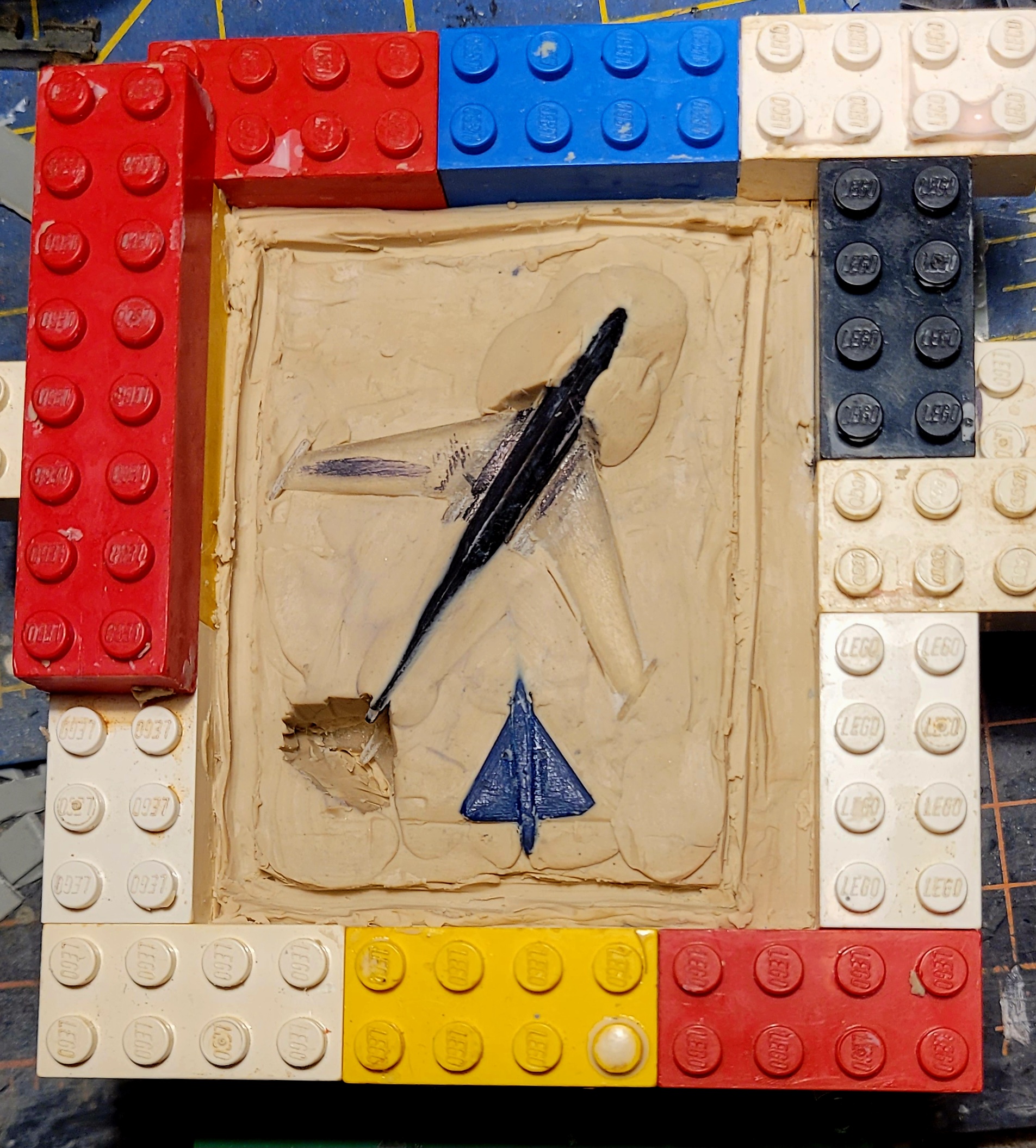

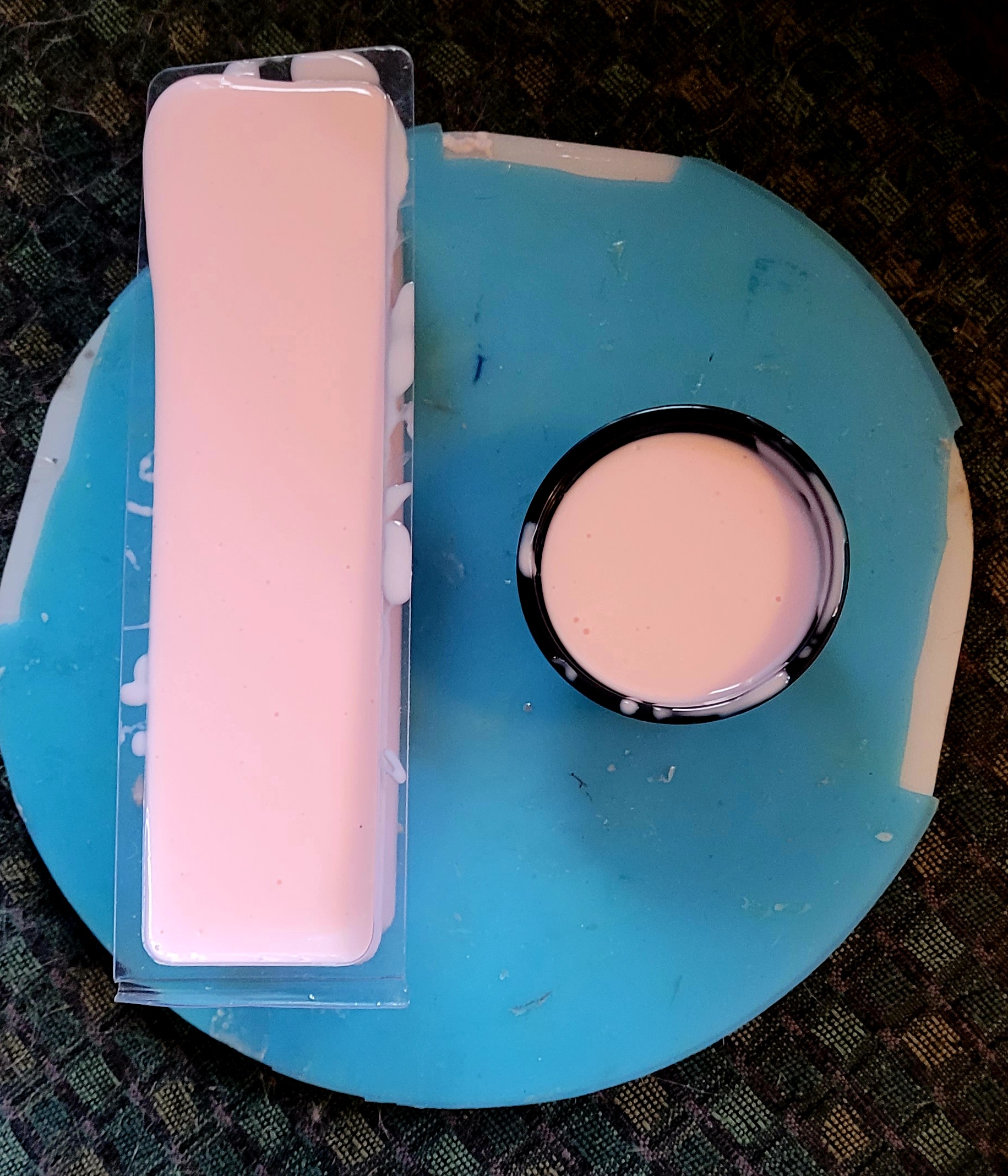

Wow, that is quite the muffin top! So weird that you had that kind of reaction. Some kind of contamination possibly???
Devin at Reynolds Materials says the RTV was made in 2024. I haven't sent the picture of Part B yet.
I did everything the same as I have done of every other mold. I did recover all the Masters.
USS Clamagore ventures into "The Pink" using leftovers from a know good batch of Moldmax 10.
The round test mold for the suspect Moldmax 10 RTV contains an inconsequential Master. Results will be known 0600 tomorrow.
Test and USS Clamagore and Entemedor molds have been cast with brand new LPP resin. The castings always tell the tale. (insert Jeopardy theme music here.)
LET'S GET READY TO BUBBLE!!!!!!!!!!!!! Captain, there be submarines.
The Asian house pulled little chunks out of the suspect MoldMax 10 test mold. What's left of this package of RTV is going in the burn trash. The GUPPY III mold from old Moldmax10 worked like it always has in the past. Something changed and I won't risk all my hard work making Masters on unreliable RTV. My next order for silicone RTV mold material may well come from AeroMarine. From pink molds to purple ones.

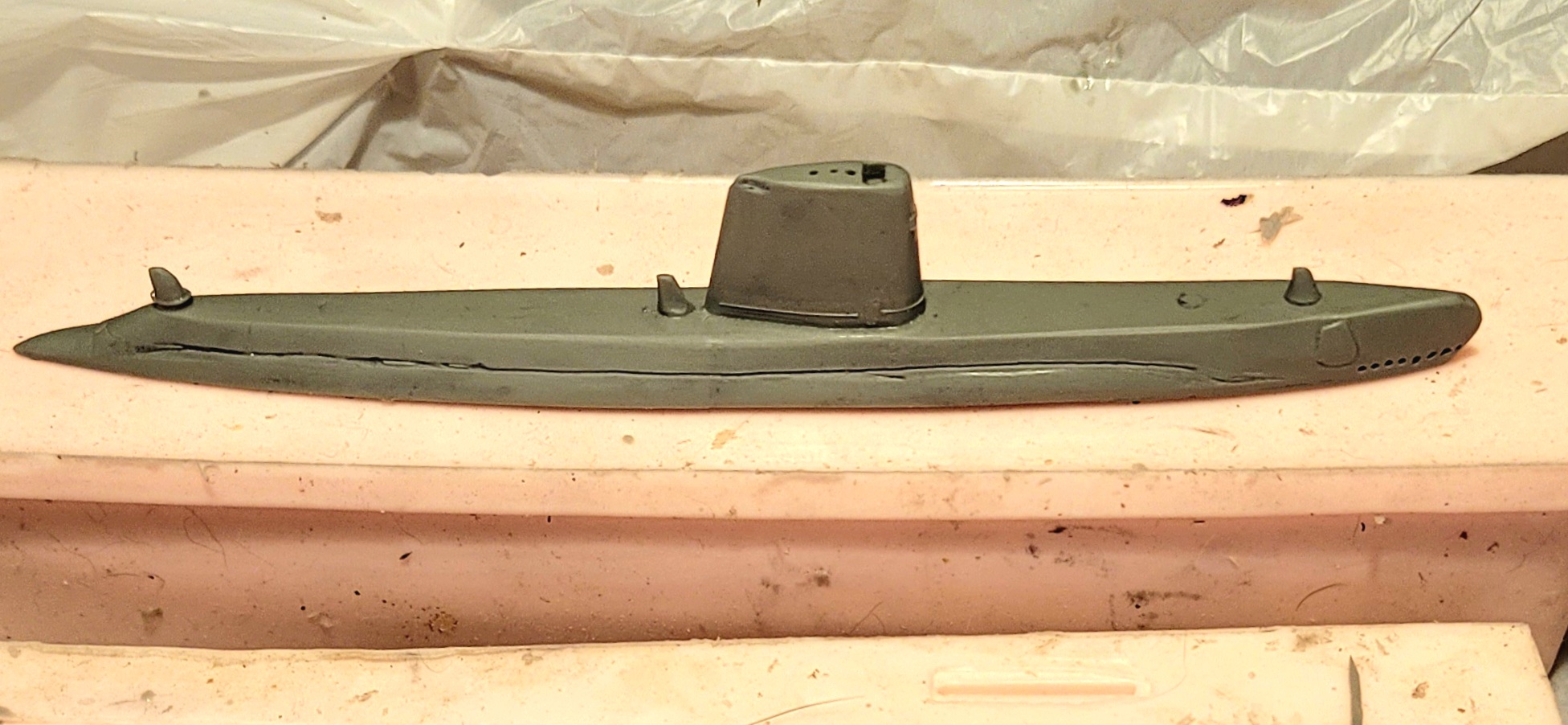

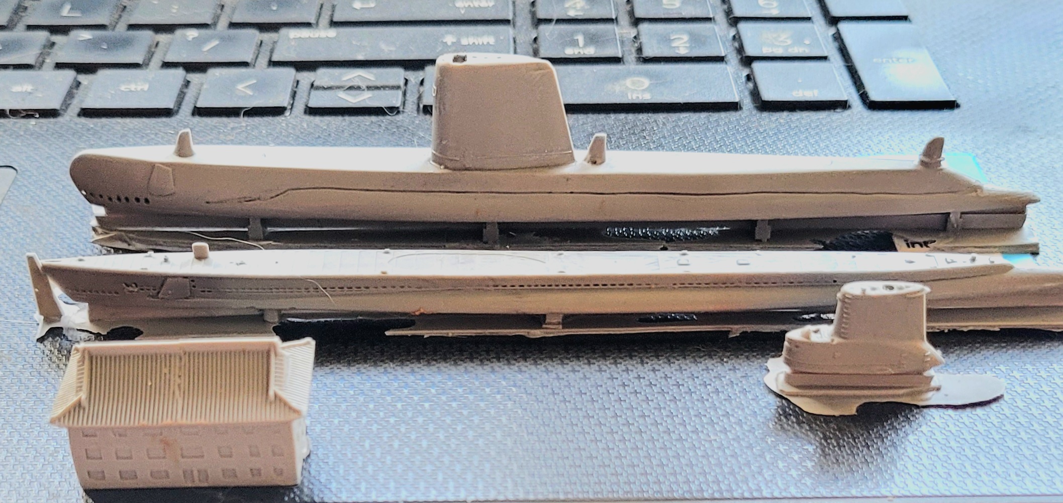

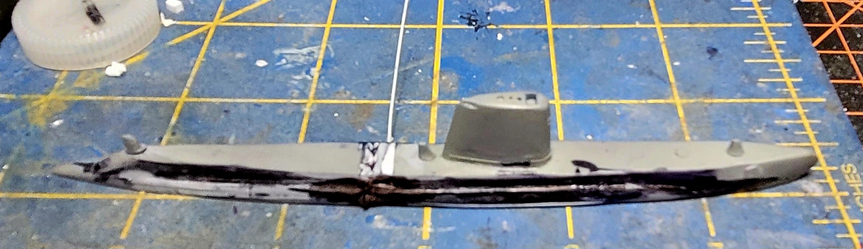

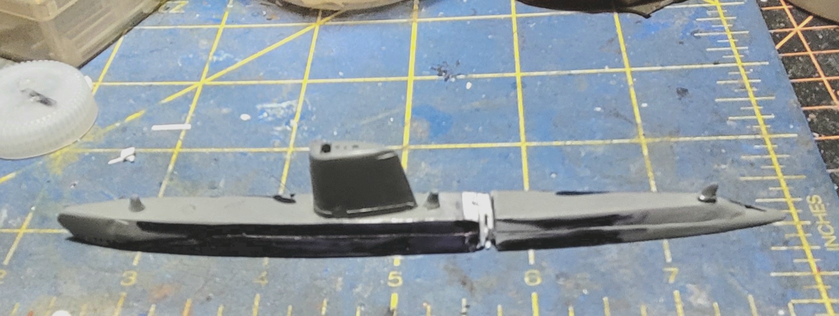

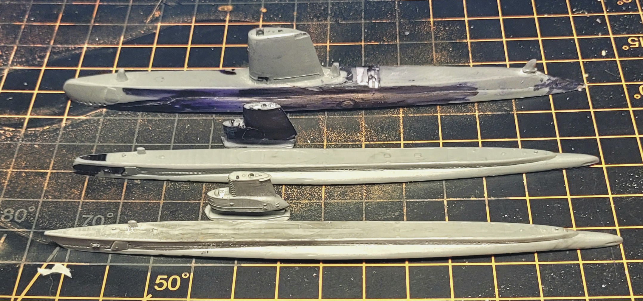

Research shows the US Navy GUPPY III boat was 17 feet (.29 inches in 1/700) longer than her previous sisters. 328 feet LOA over the standard Gato/Balao/Tench class submarine length of 311 feet. As you can see, chopping ensued and a plug was inserted in USS Clamagore amidships to get the proper length over all. Careful manicuring of Clamagore's hull is ongoing. She's "The Gray Ghost of the Florida Coast" and I've actually been aboard her at the Patriot's Point Naval Museum in Charleston harbor. She MUST be "just so".
"Strike From The Sea" research also finds there were 7 GUPPY variants. From this set, 5 can be built, using Fujimi's excellent 1/700 Balao class model kit, to make 2 "Fleet Snorkel" 1950's Hunter-killer models with 1 of each Electric Boat or Portsmouth sails. A set of 3 PUFFS sonar antennas will also be mastered, molded and cast.
What you see here so far are 3 in-progress Masters of 4 GUPPY submarines. I often wish I had the ability to choose a "stopping point". I plainly just do not. Sometimes, I just hate myself.

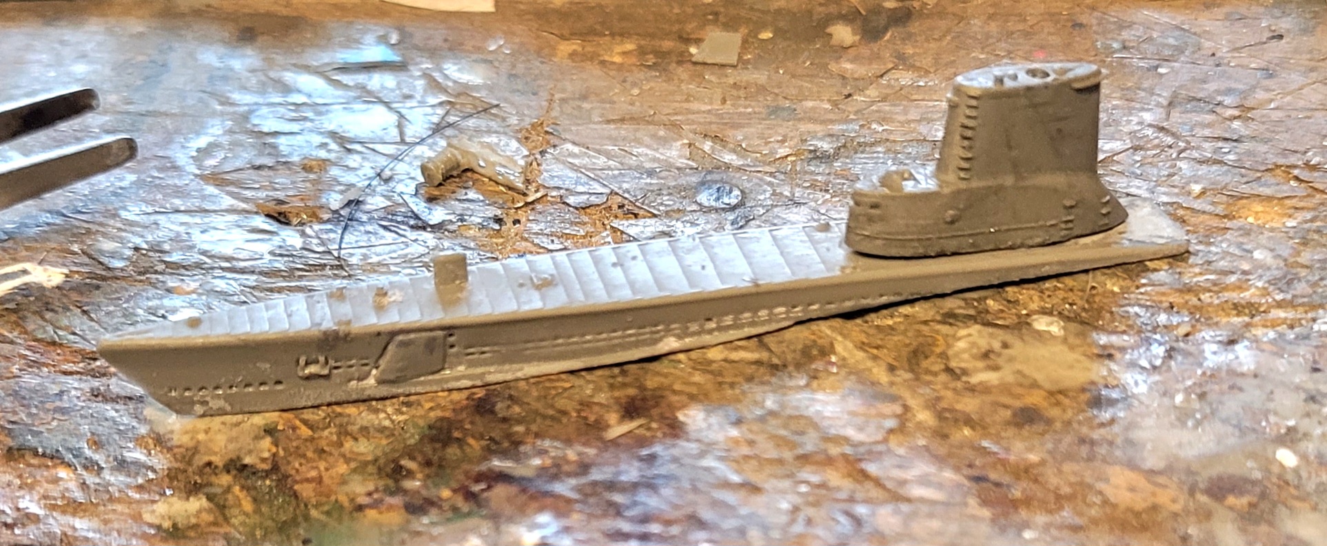

A short resin pour produced a surfacing 1/700 GUPPY I Submarine model the other day. Not much goes to waste around here.
Unless you count the sacrificial molds made to produce most of these resin masters.

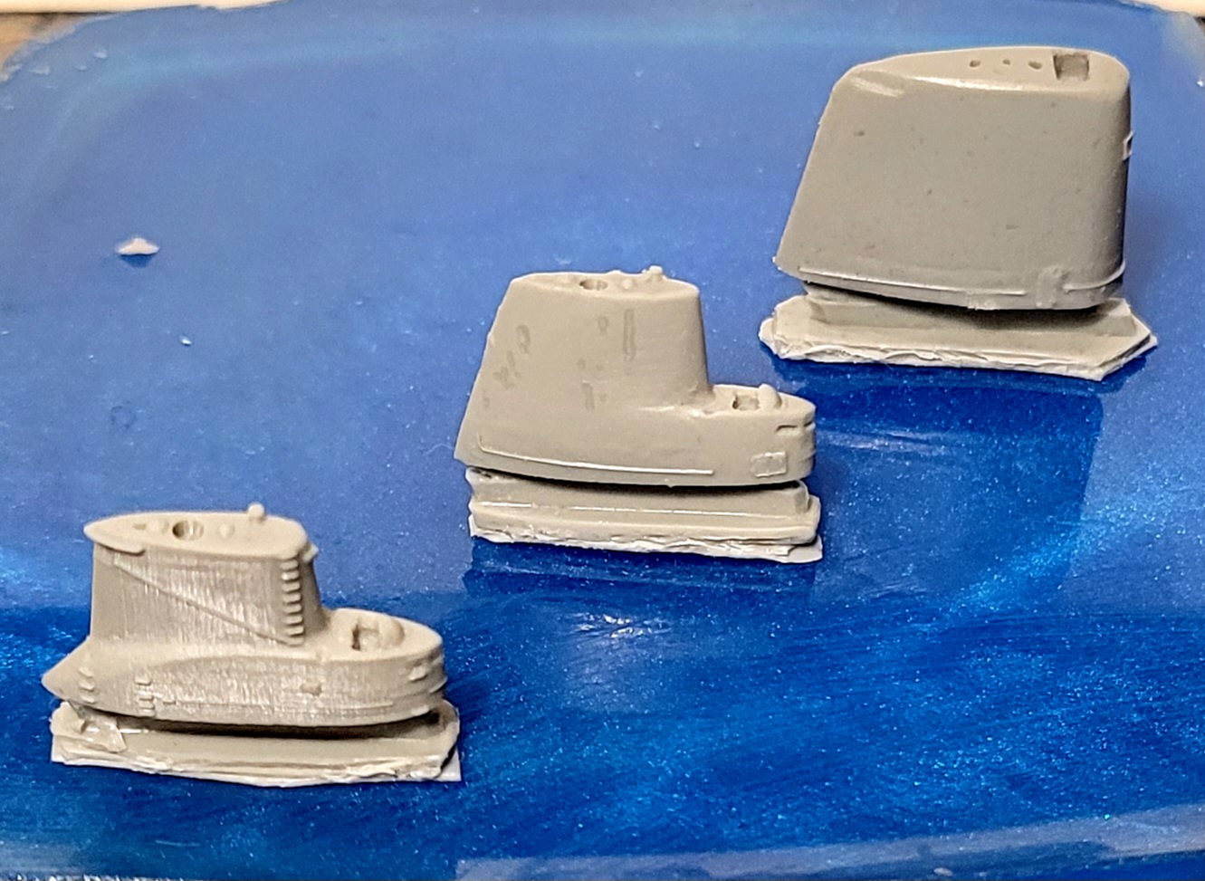

So, You're a US Navy 1/700 submarine enthusiast. You've built all the World War II boats, waterline and full-hull. Every other Sub kit is 1/350 or bigger and very expensive, these days. What about the Balao-class Fleet Snorkel boats of the 1950's and '60's?

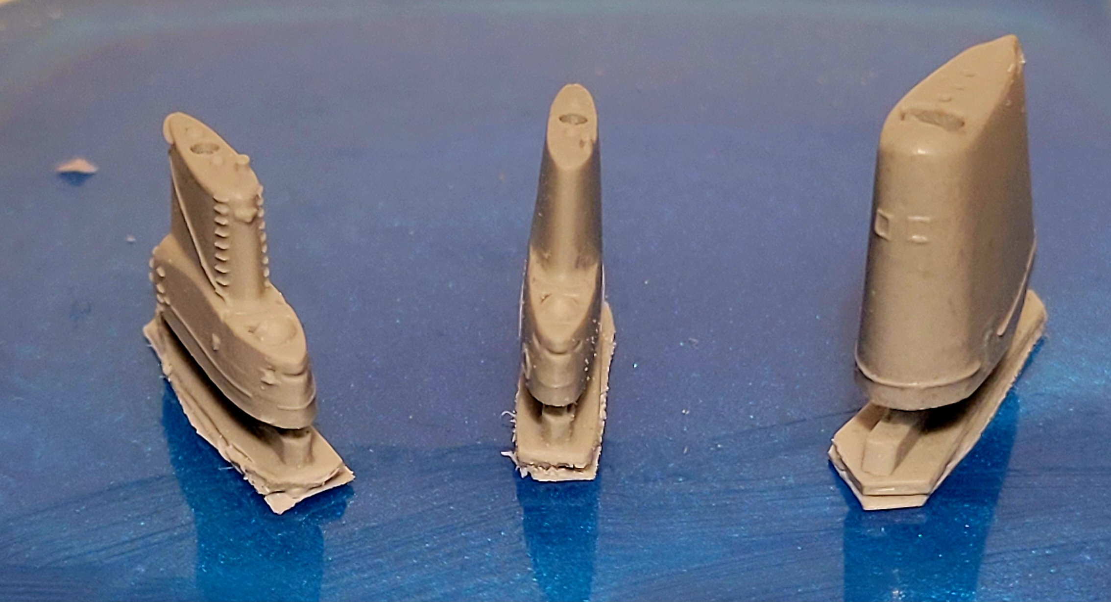

Now I don't want you to think of this as a conversion set. It isn't. It's one Portsmouth style sail, Like USS Torsk, in Baltimore, and one North Atlantic/ GUPPY I/Ia style sail and one Electric Boat style sail like USS Requin's in Pittsburgh.
Snorkel mast, periscopes and radar masts will have to fabricated. You still have to sure about what fit your chosen boat model is, but this is a dandy starting place for a largely overlooked era of US Navy submarine history in 1/700 scale.
The intention is to give your 1/700 World War II 1/700 Gato and Balao class US Navy submarine models a fine Cold War facelift!
I recommend Fujimi's 1/700 Balao class Submarine kit. These Fleet Snorkel boats retained their original 311 foot length so you can still use the lower hull and be historically accurate. Active and passive SONAR arrays and transducers may vary from Snorkel to Snorkel boat.

I planned to include 2 Sea Darts in this 2-part SeaMaster mold, but only one fit in comfortably.
Whaddyagonnado? :silly:

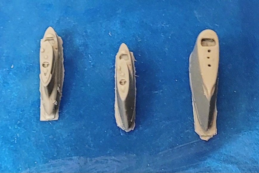

USS Torsk is a Fleet Schnorkel Boat. That is to say, she has her modified sail, but without the increased battery capacity ot higher submerged speed of an actual GUPPY boat. Think of Torsk as a Super-Tench class WWII US Navy submarine. The only of her class to see combat in WWII.

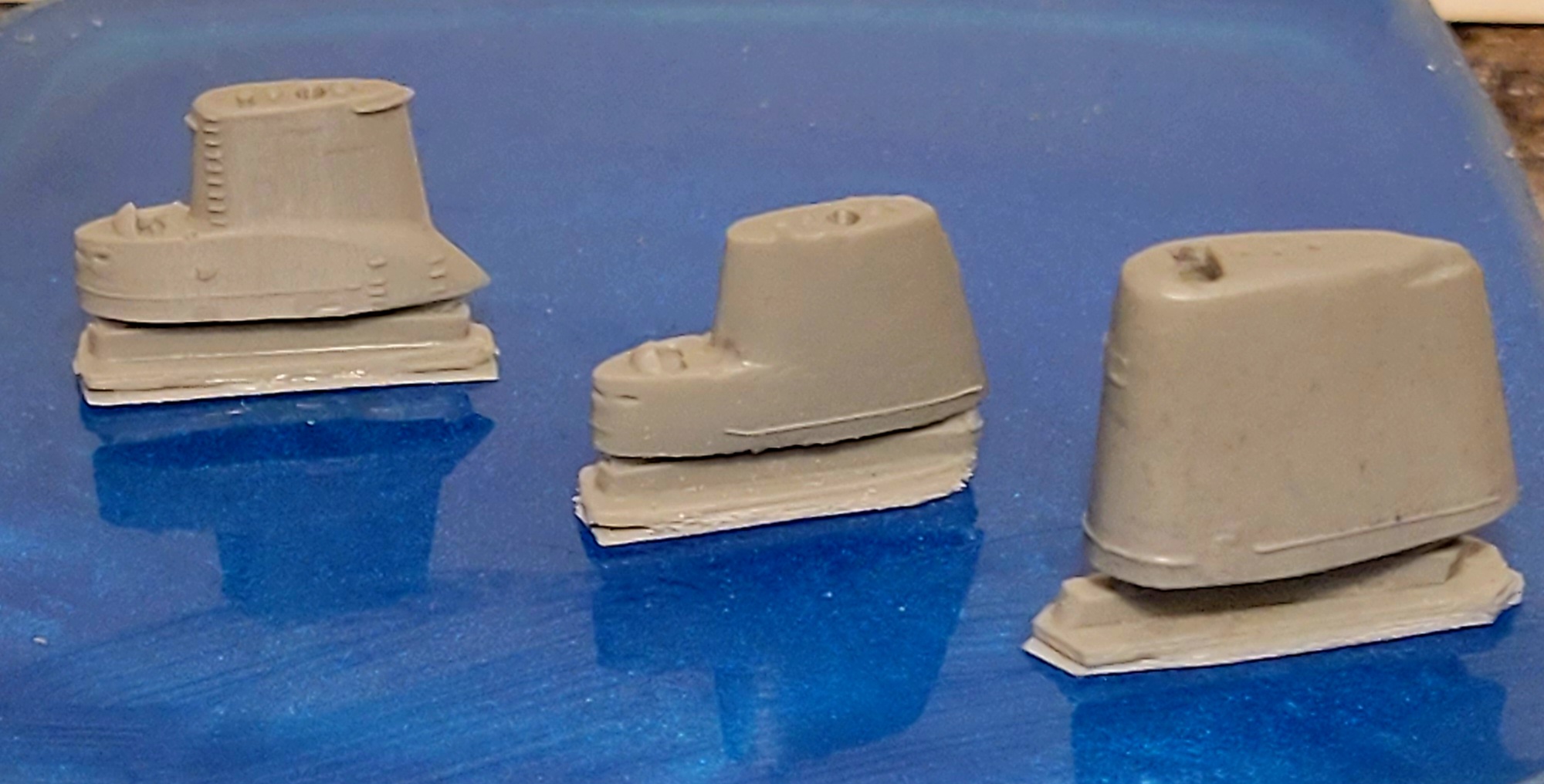

I make a Fleet Schnorkel sail set to convert your 1/700 Balao or Gato class submarine model to Fleet Schnorkel configuration.
I recommend the Fujimi Balao kit.
