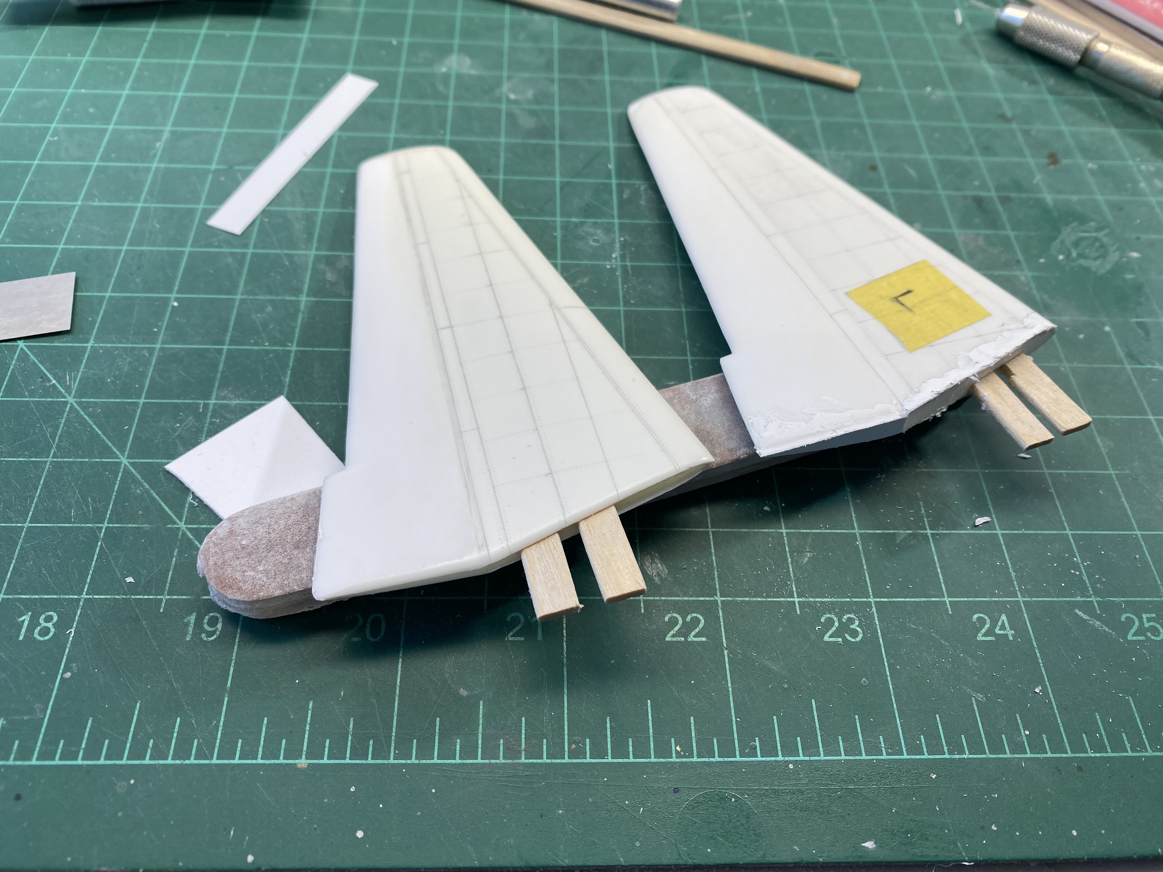

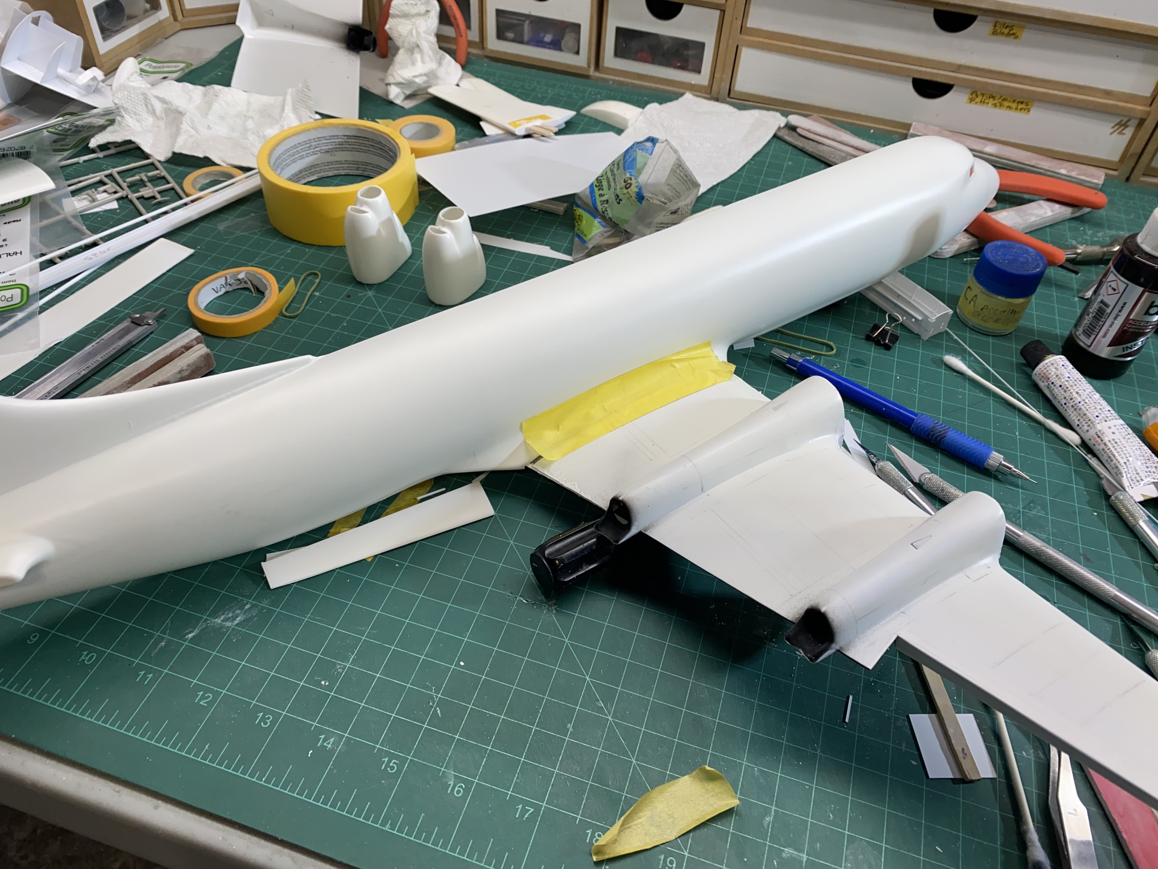

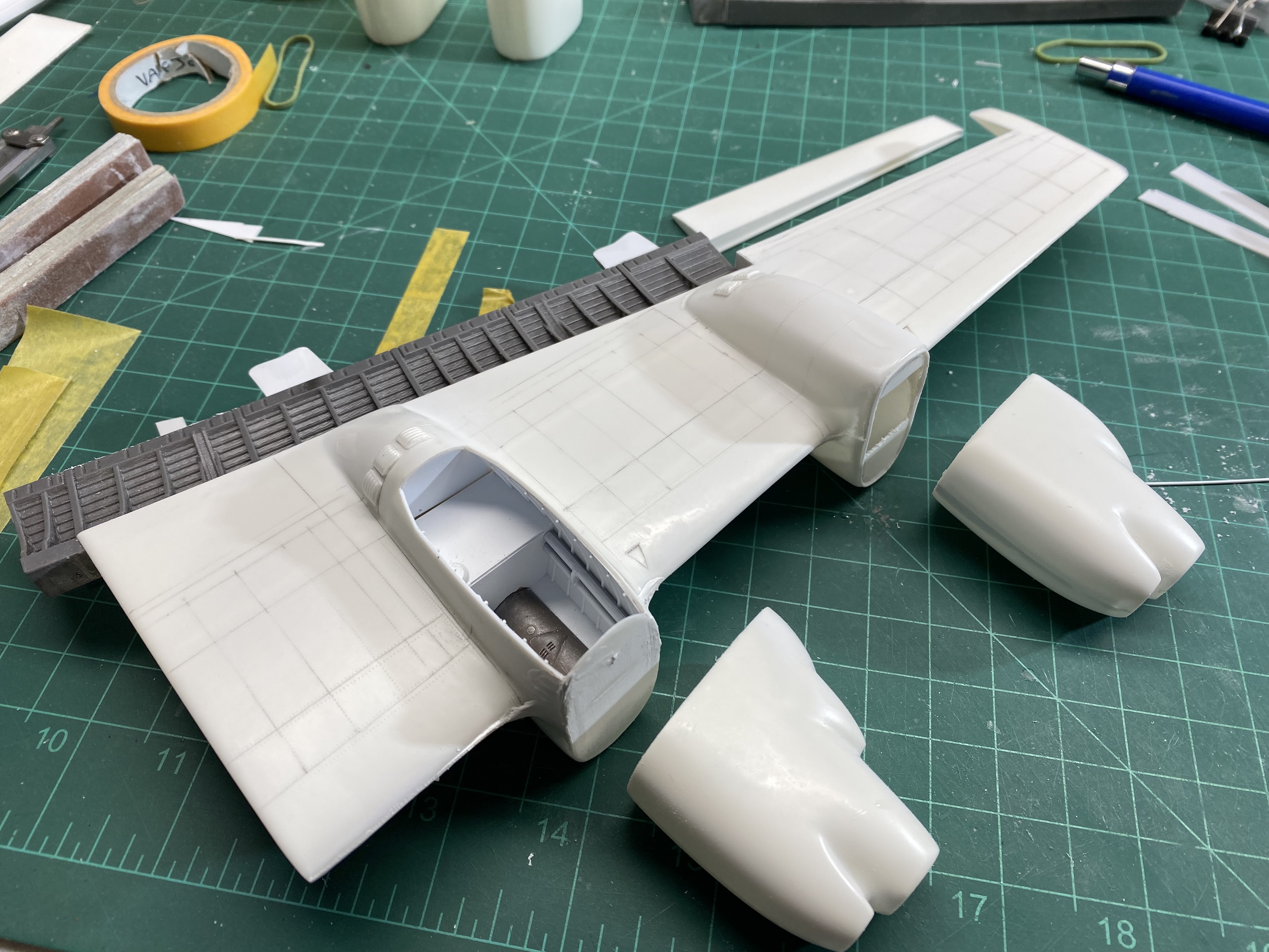

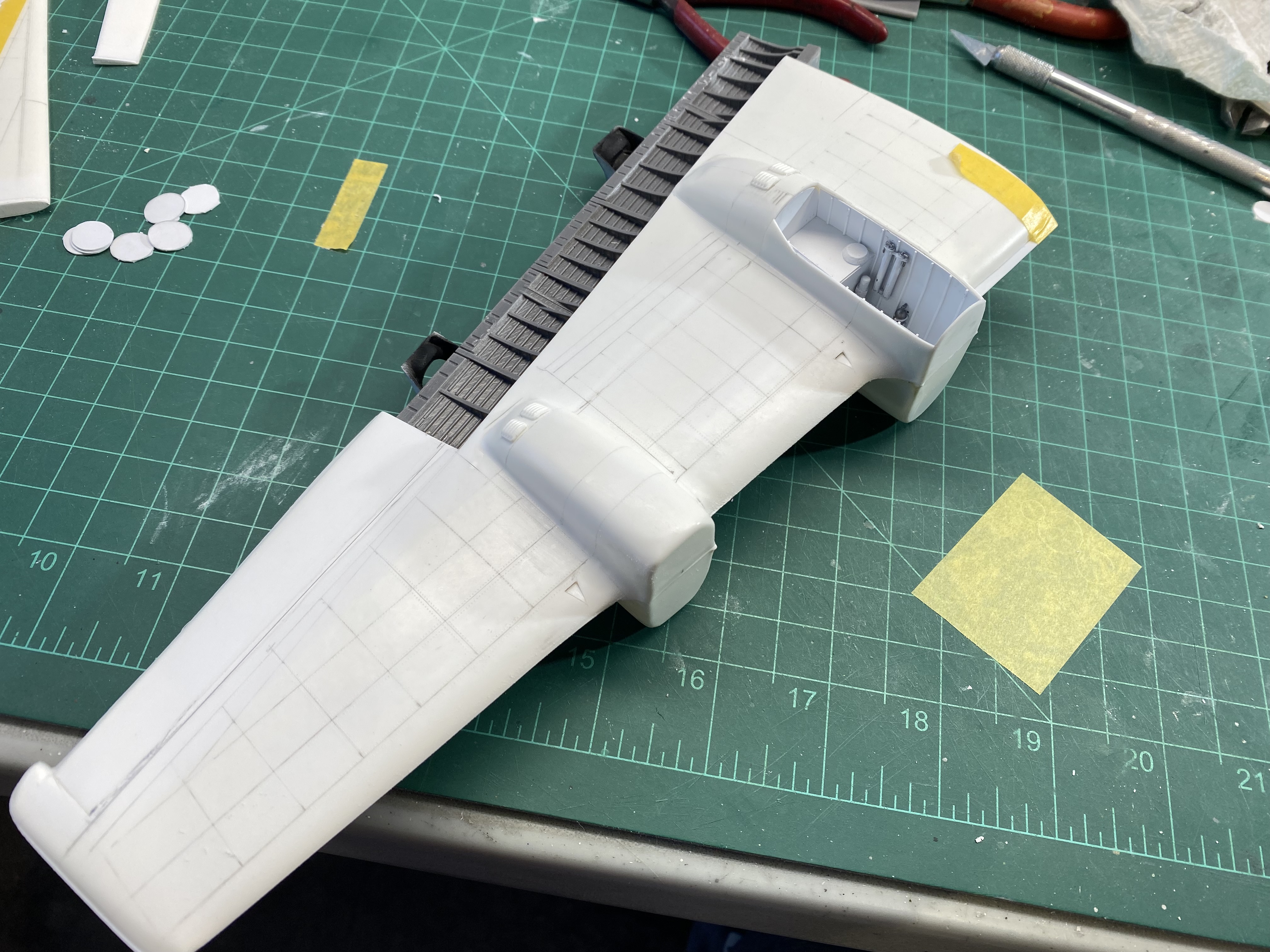

work has begun on assembly...well one part anyway. I've got one wing underway, gear bay glued in, flap track and, an aileron cut out for a bit of a defection angle. There's a mismatch at the wing tip but I plan on cutting off the wing tip and build the squared off lumpy sensory loaded things.
So, here's the one I'm working on now;
Thanks for looking

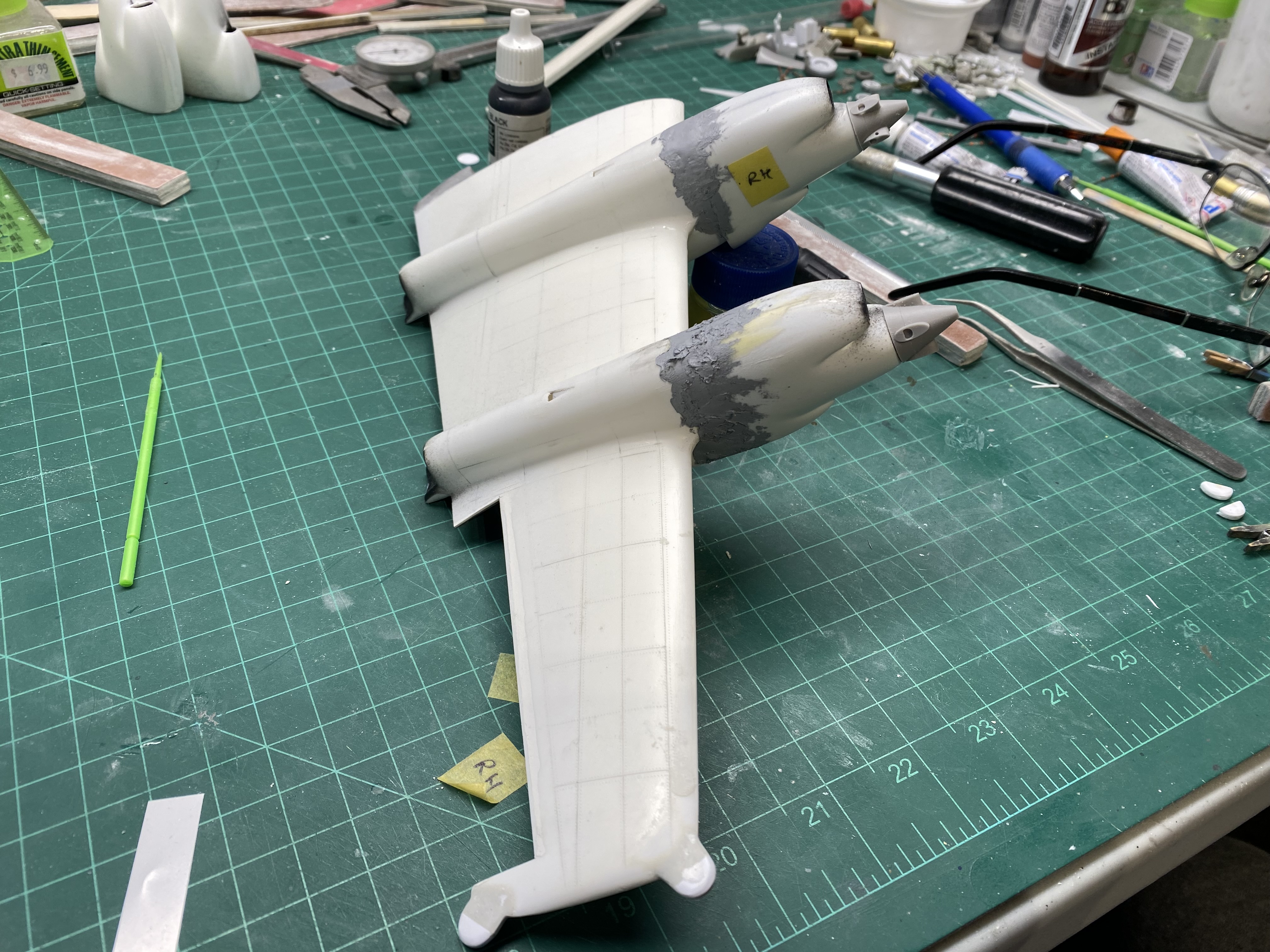

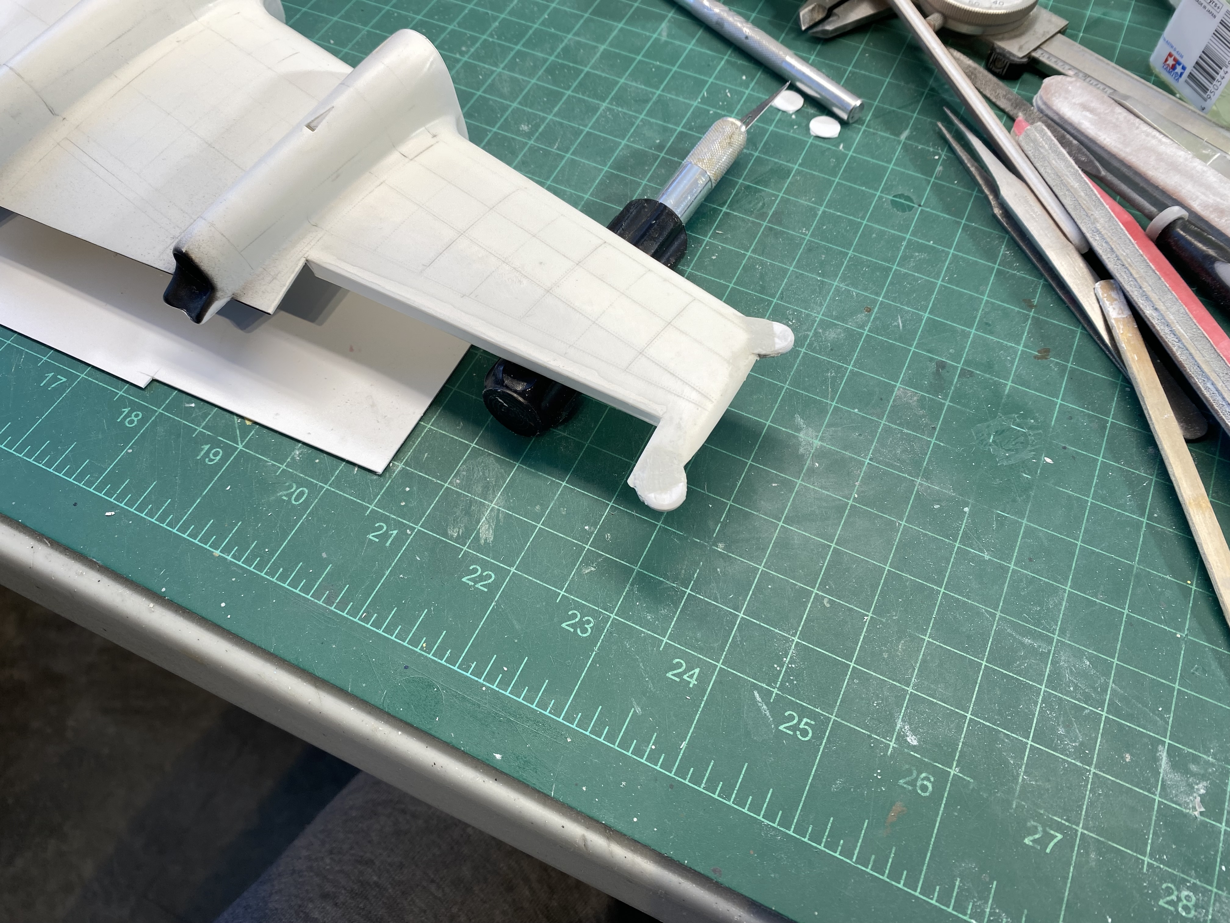

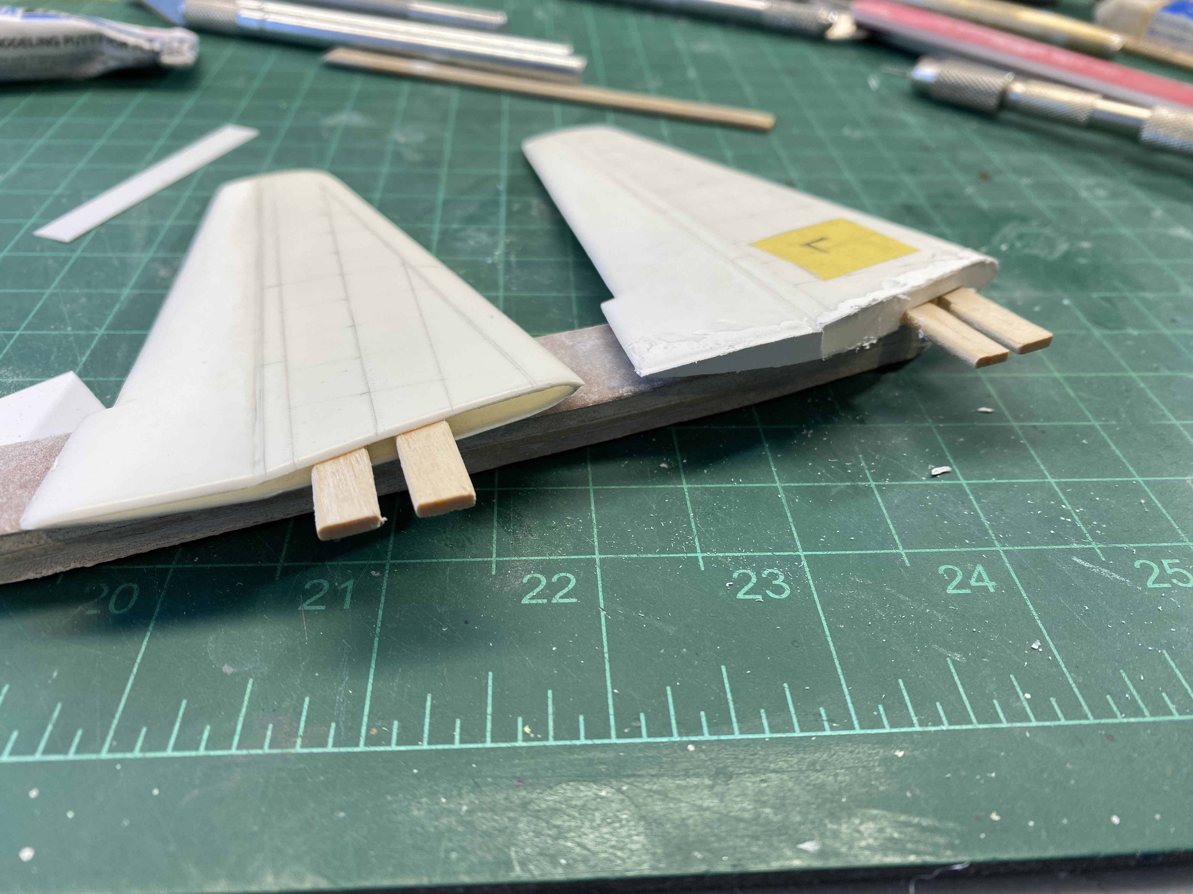

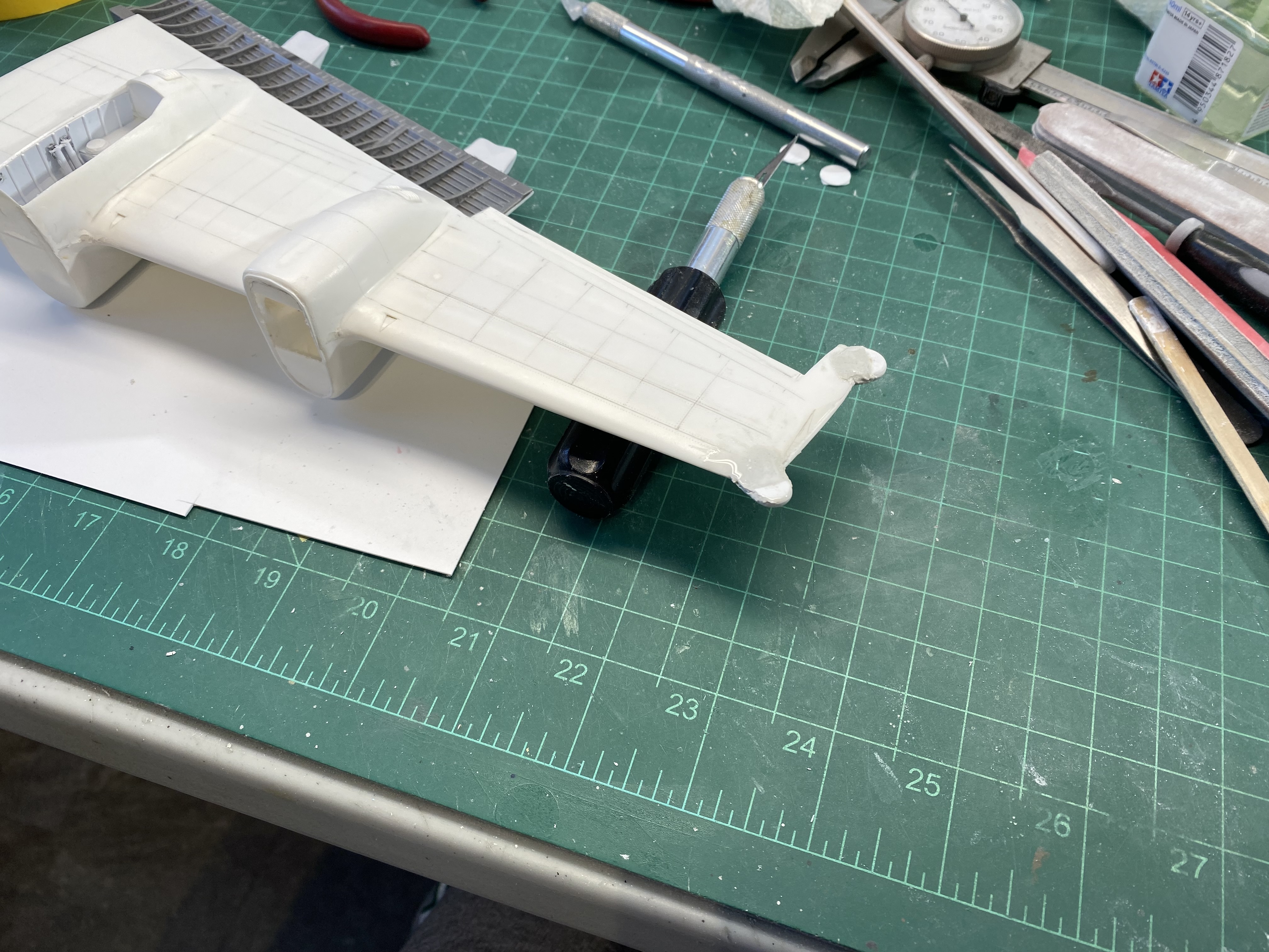

I'm still puttering away on the wings, both are joined upper and lower now. The left wing is undergoing sanding and filling on the seams while the right wing is getting some knobs added. I cut circles with a compass cutter, cut the circles in half and made the sensors to the wing tip, I glued the semi circles to the wing tips with a short section of I beam and filled the gap with "Apoxie Sculpt"...much sanding shall ensue.
Don't look for accuracy here, merely a representation (as good as I can do) of those sensors
Thanks for looking

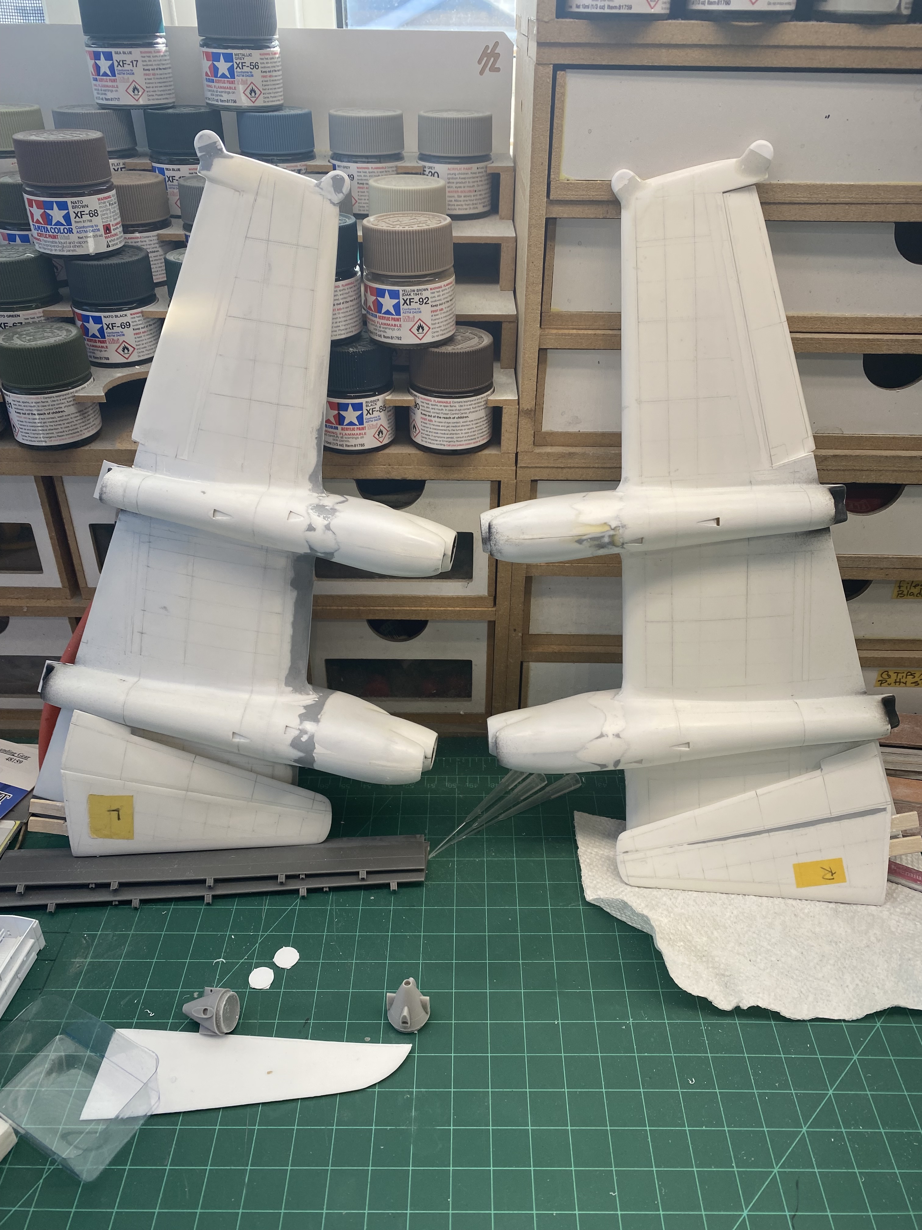

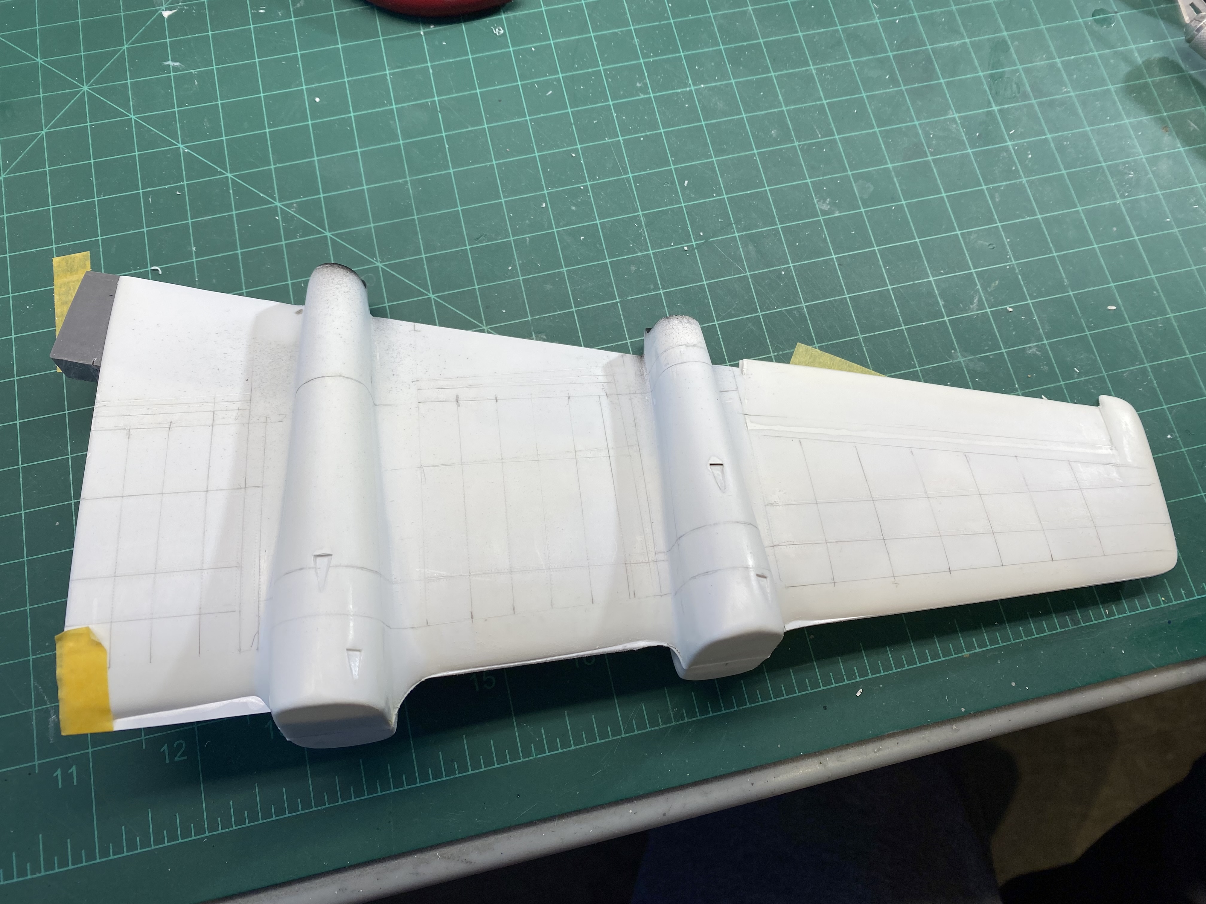

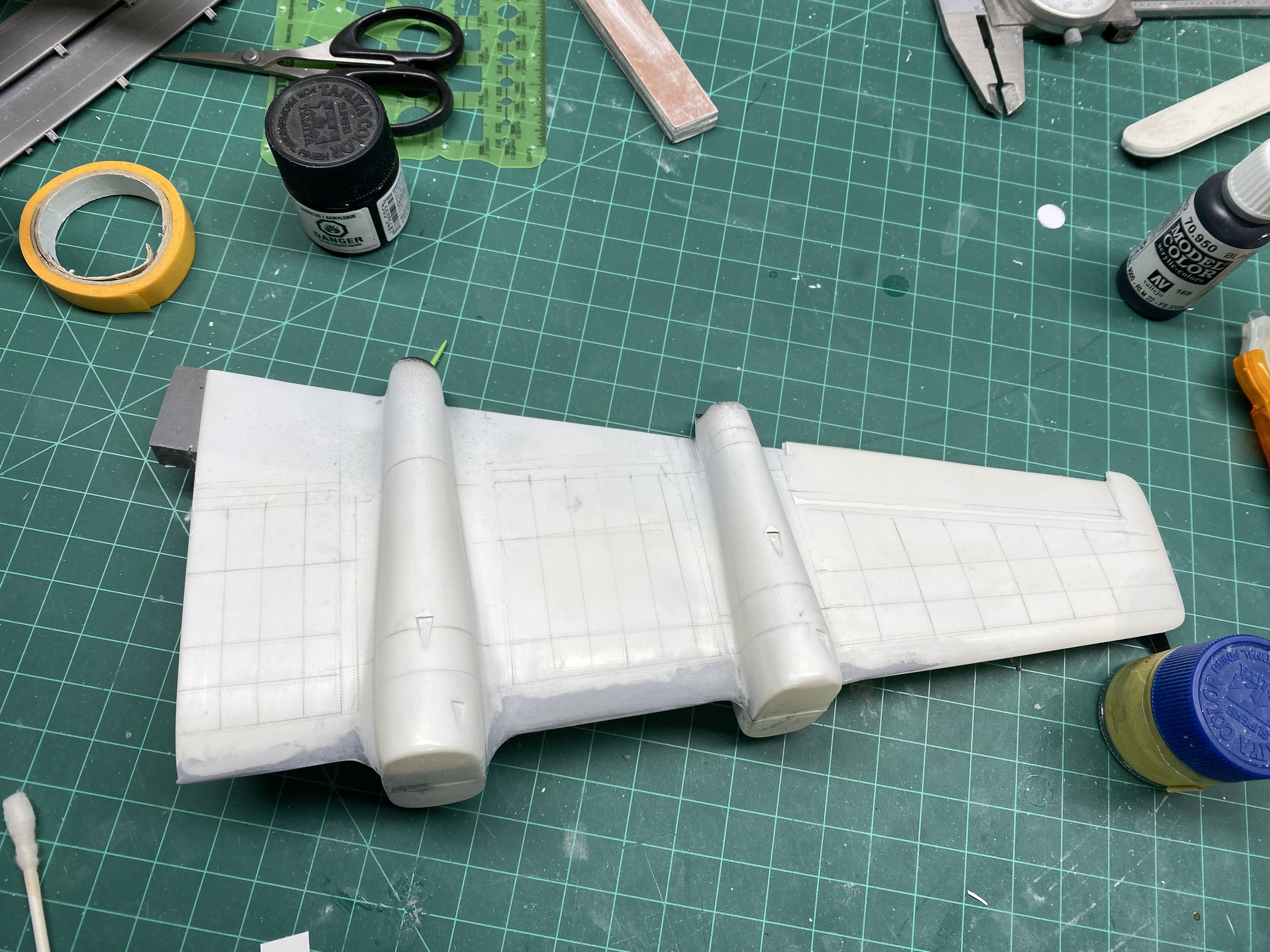

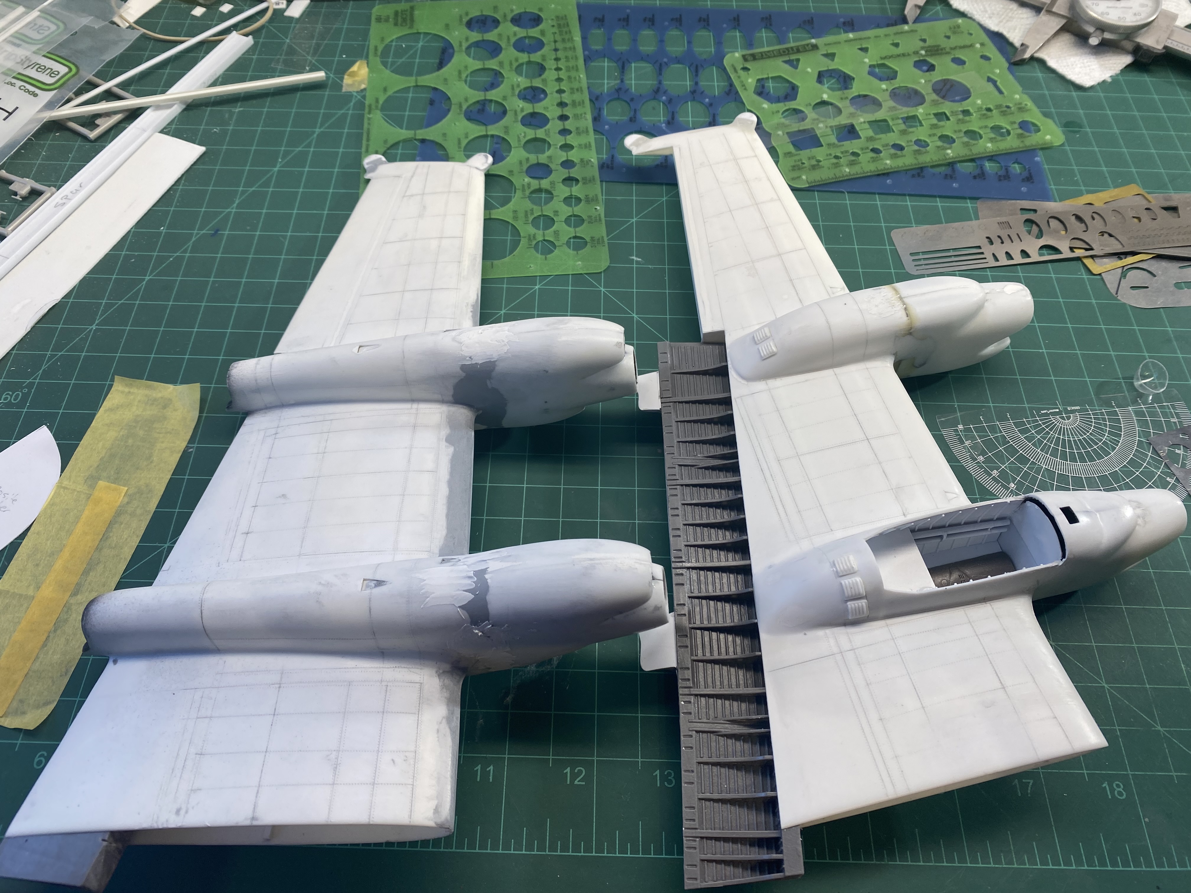

The left wing top half had sunken areas between the engines both on the top and on the leading edge, I glued a strip of .010 between the upper and lower halves as a straight edge to fill/ sculpt to. I used Tamiya gray putty here.
the straight edge can be seen here
The bottom half was better;
filled and worked on;

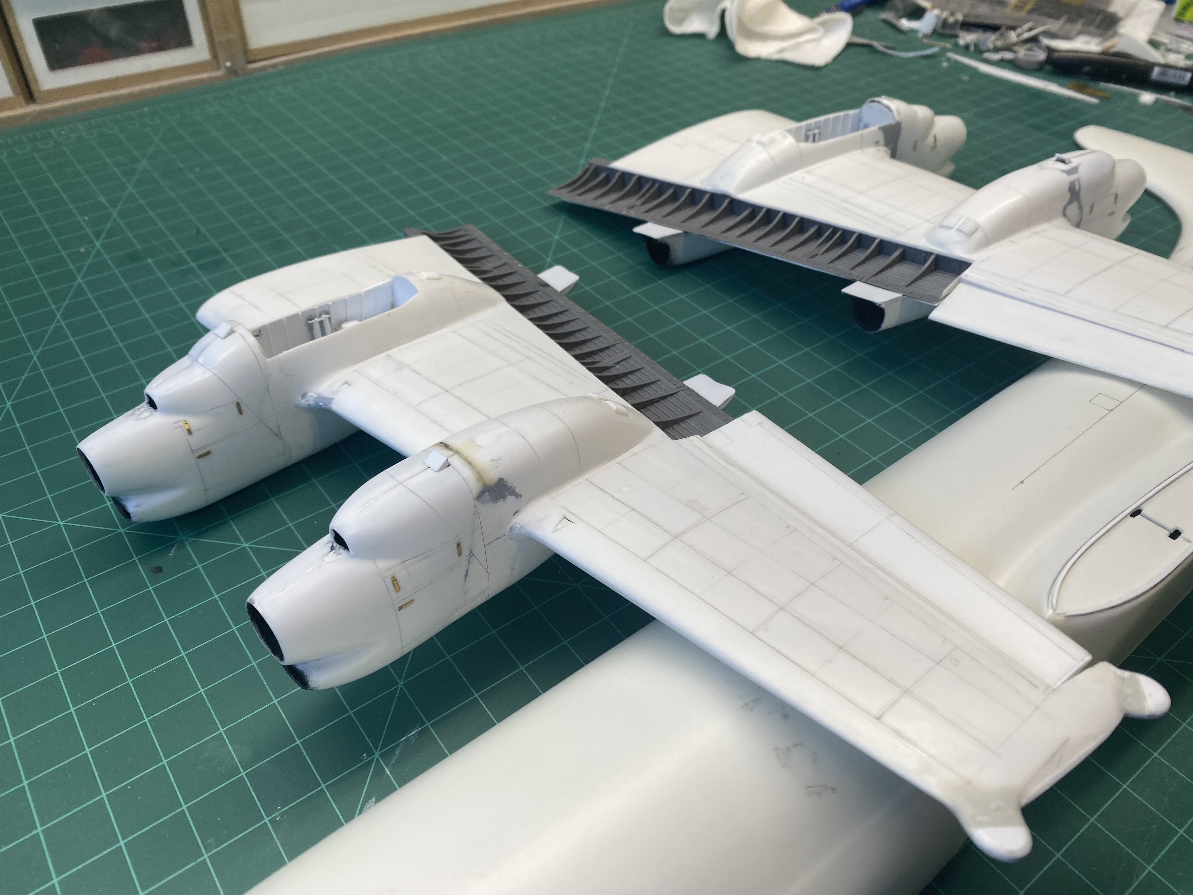

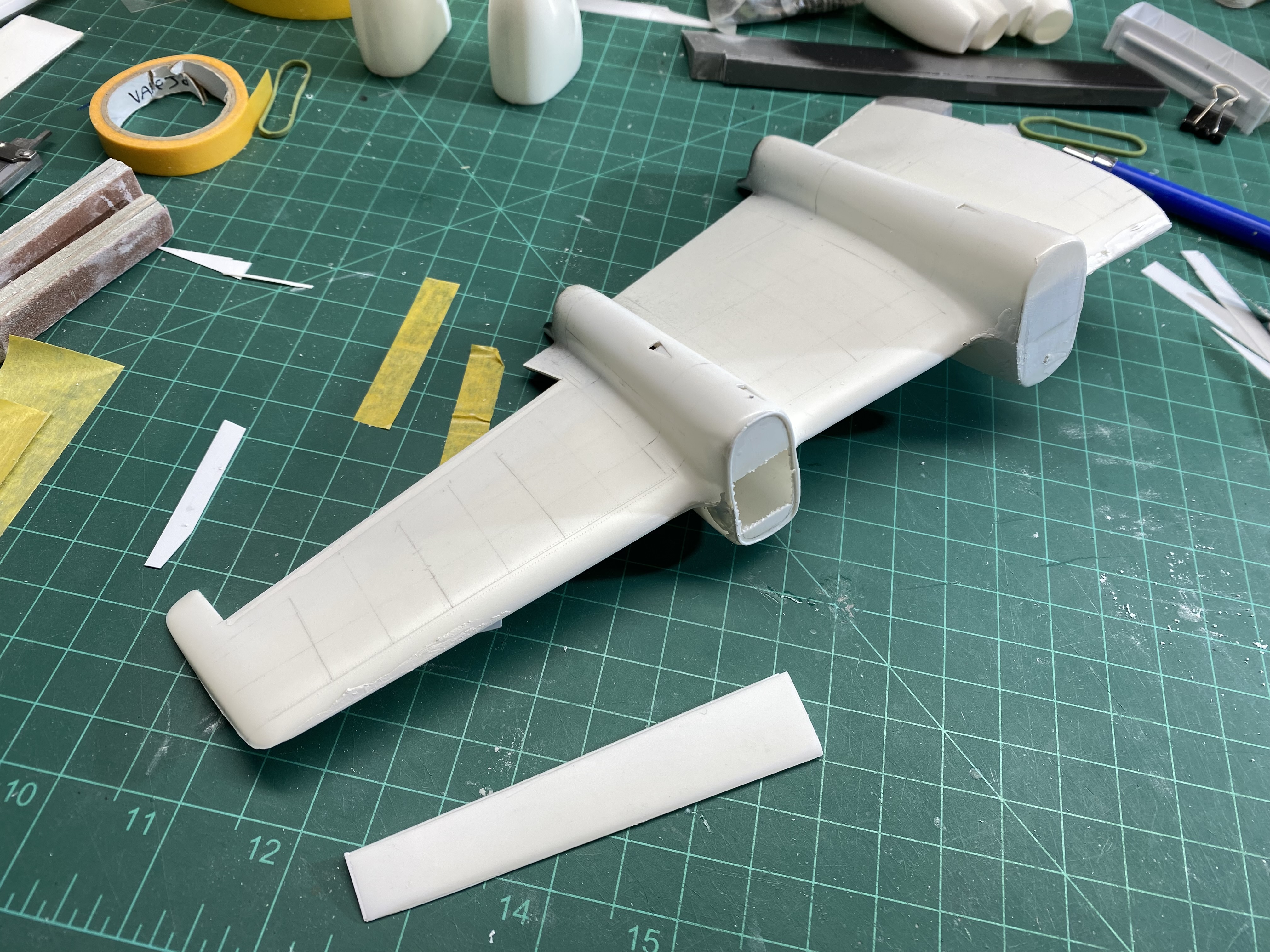

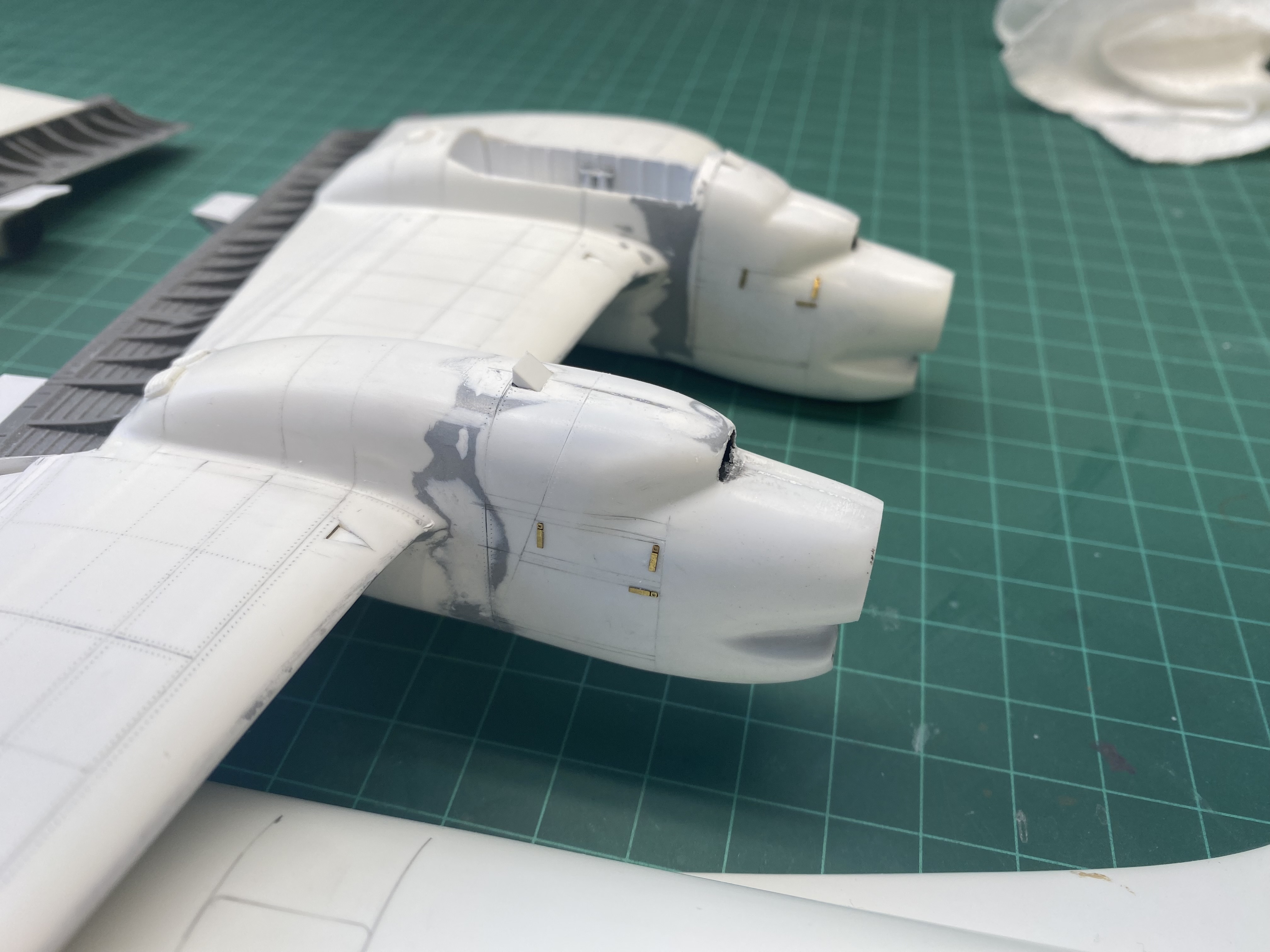

and the other wing, progressing a little faster, now has nacelles glued on, still much putty/sand to do
Thanks for looking

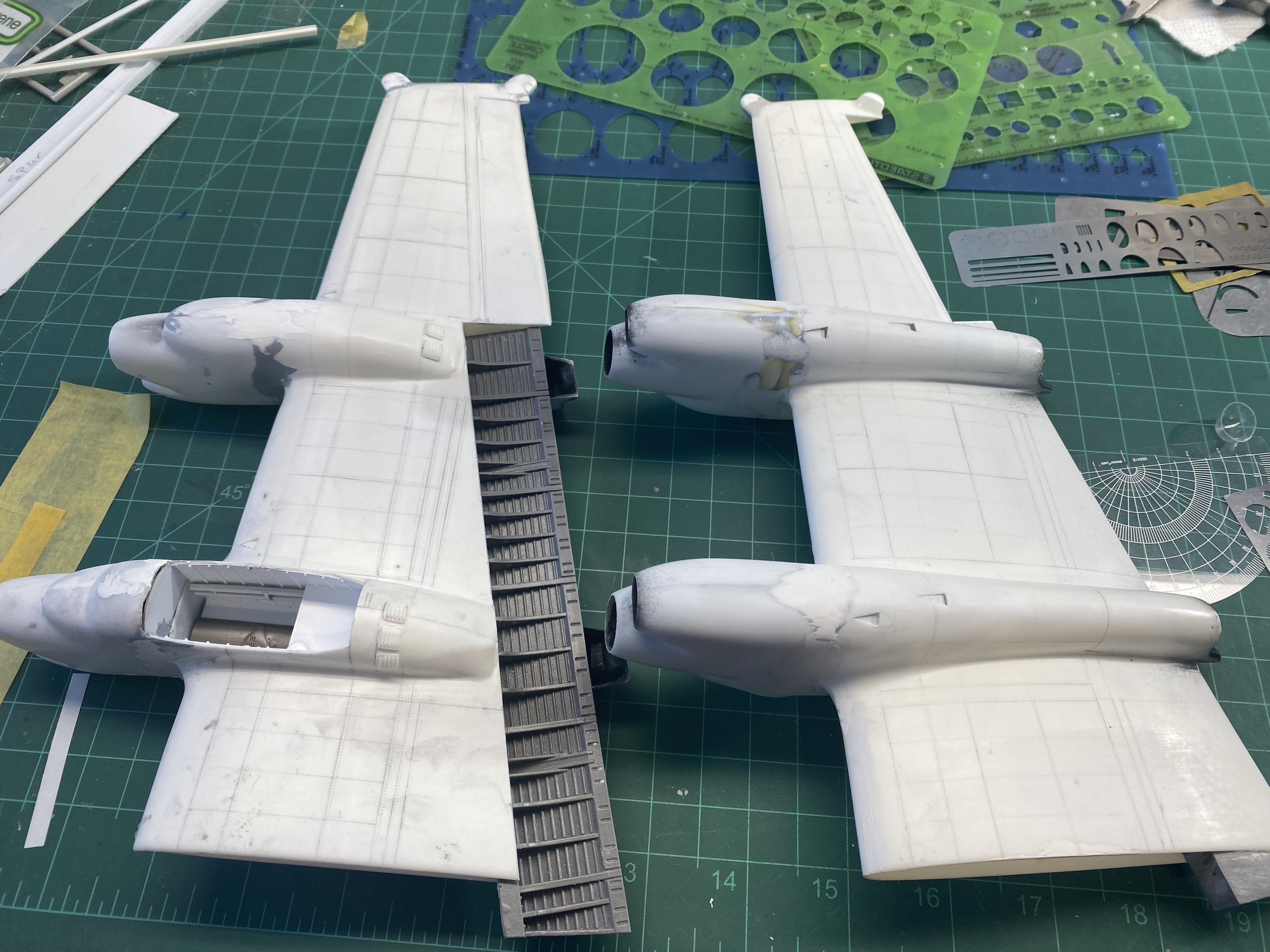

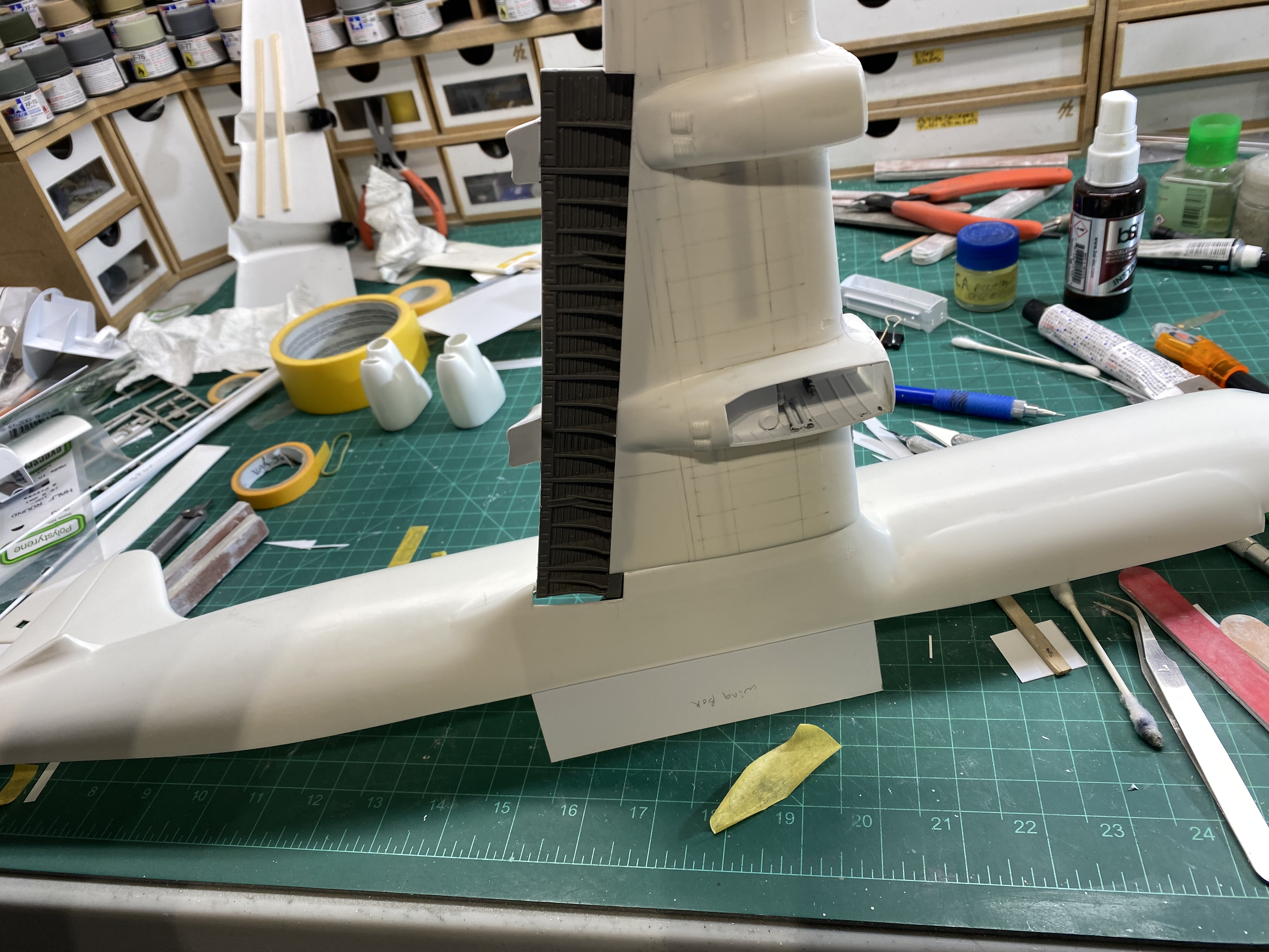

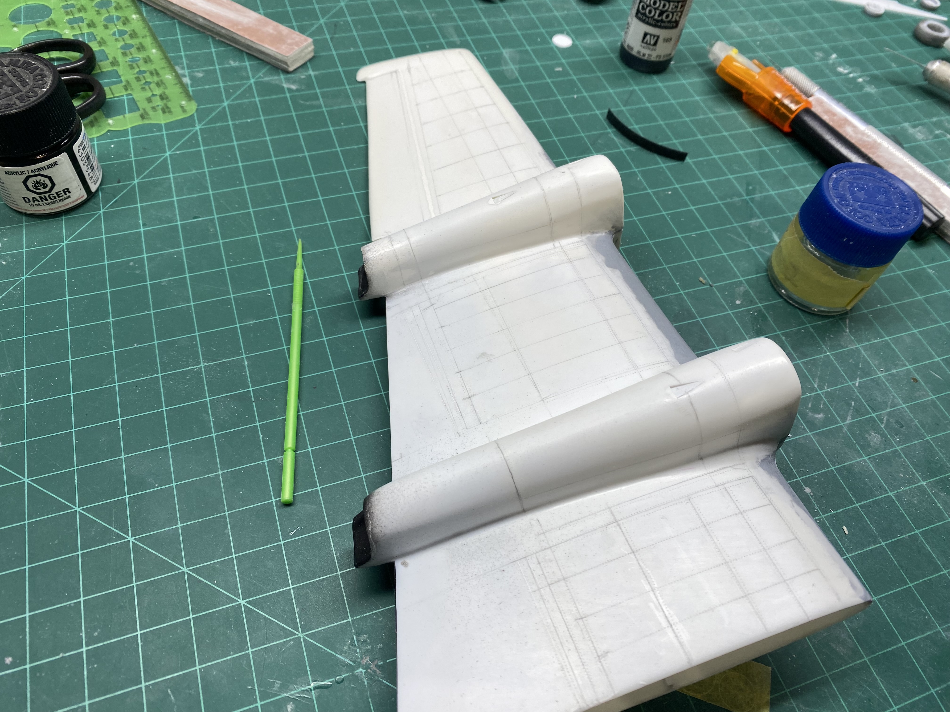

So, almost a full tube, total quantity all in (1/2 tube white- 1/2 tube of gray) the engines are attached and faired in. scribing and rivets should now be added

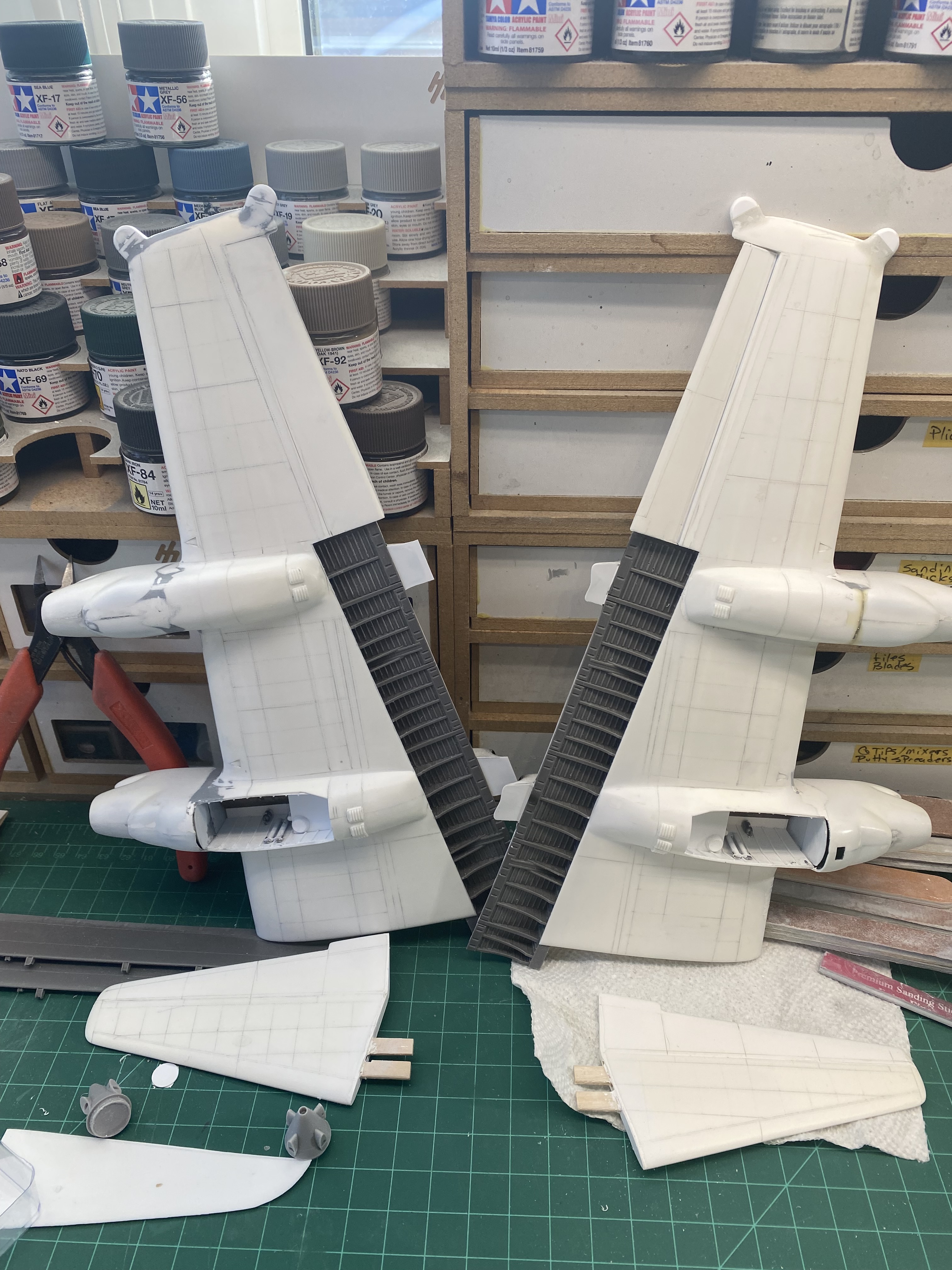

sanding mostly completed, now have a full set of wings;

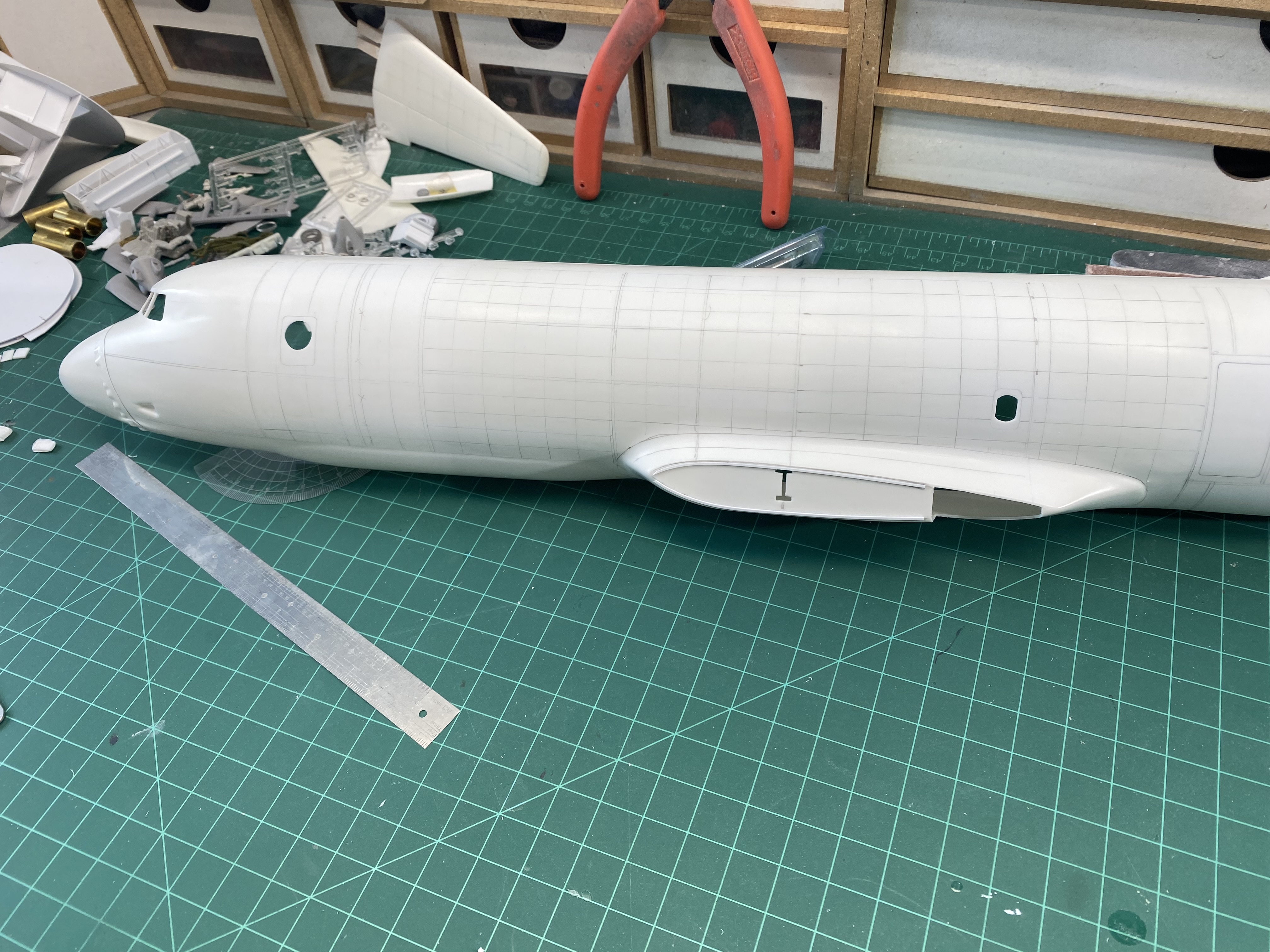

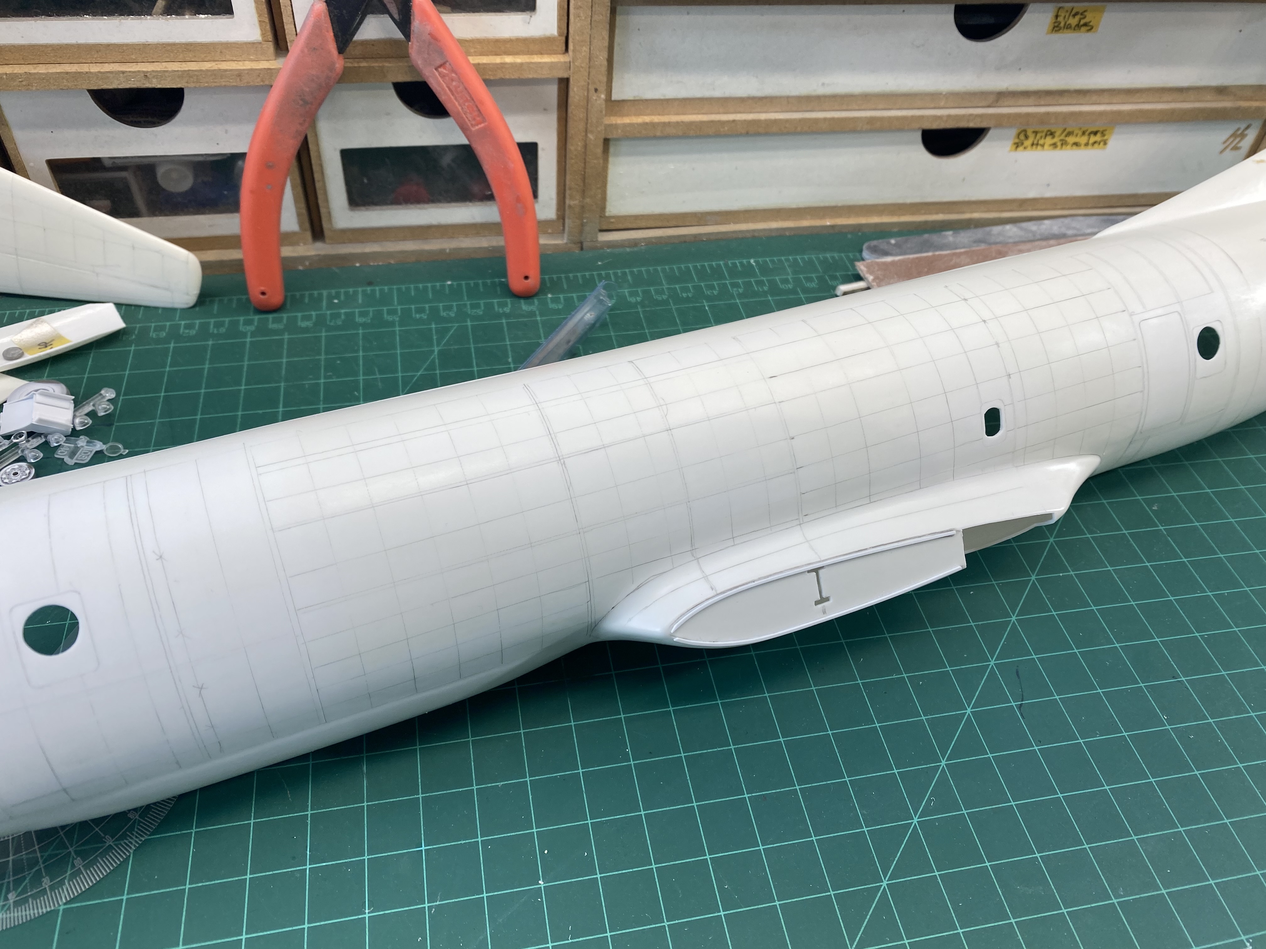

Marking out for scribing riveting the fuselage;
work/ play continues

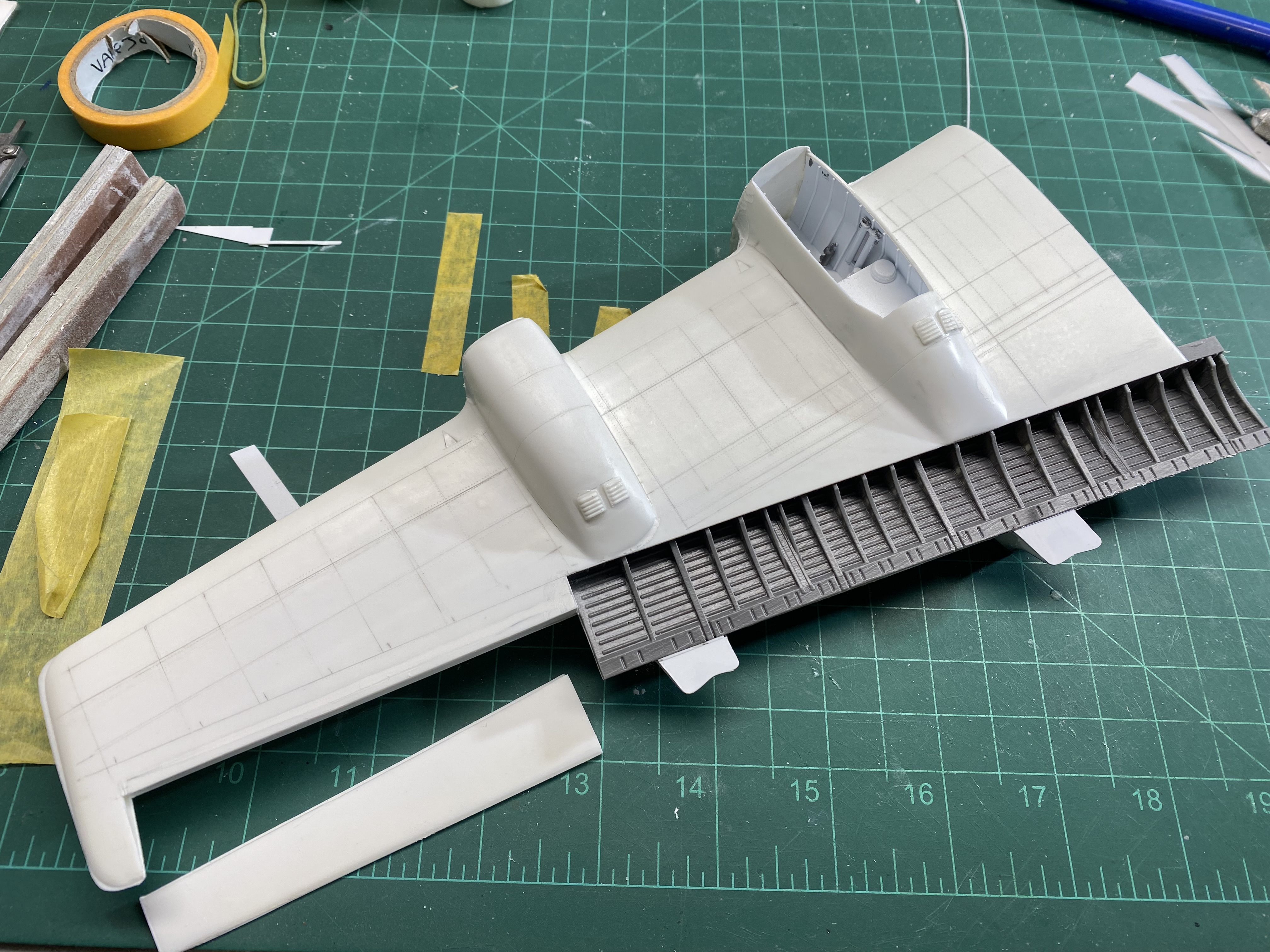

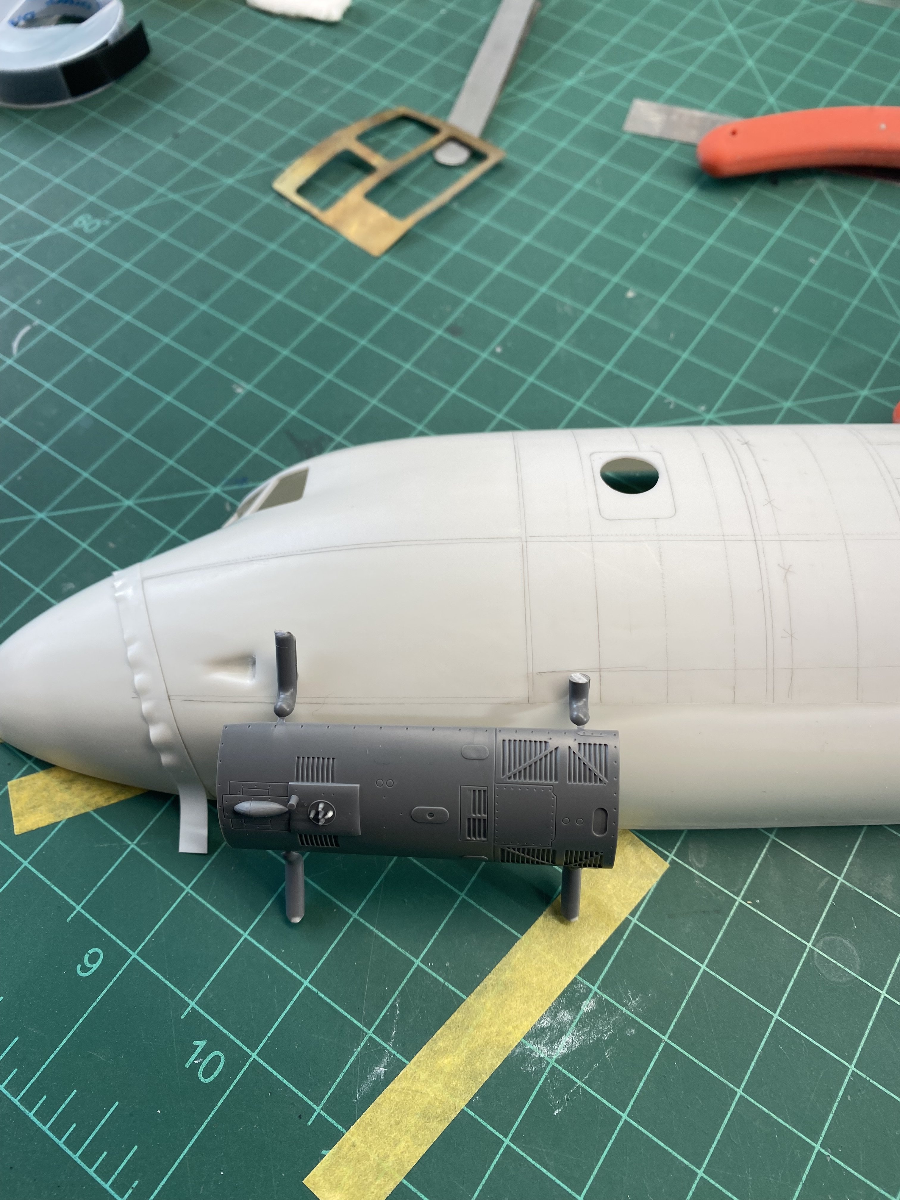

still plugging away, I've added some scribed lines, rivets and clasps (pure fiction) to the engines;
and begun opening holes for little round windows, the openings aren't to scale merely to the size of the dome windows (from the spares supply)

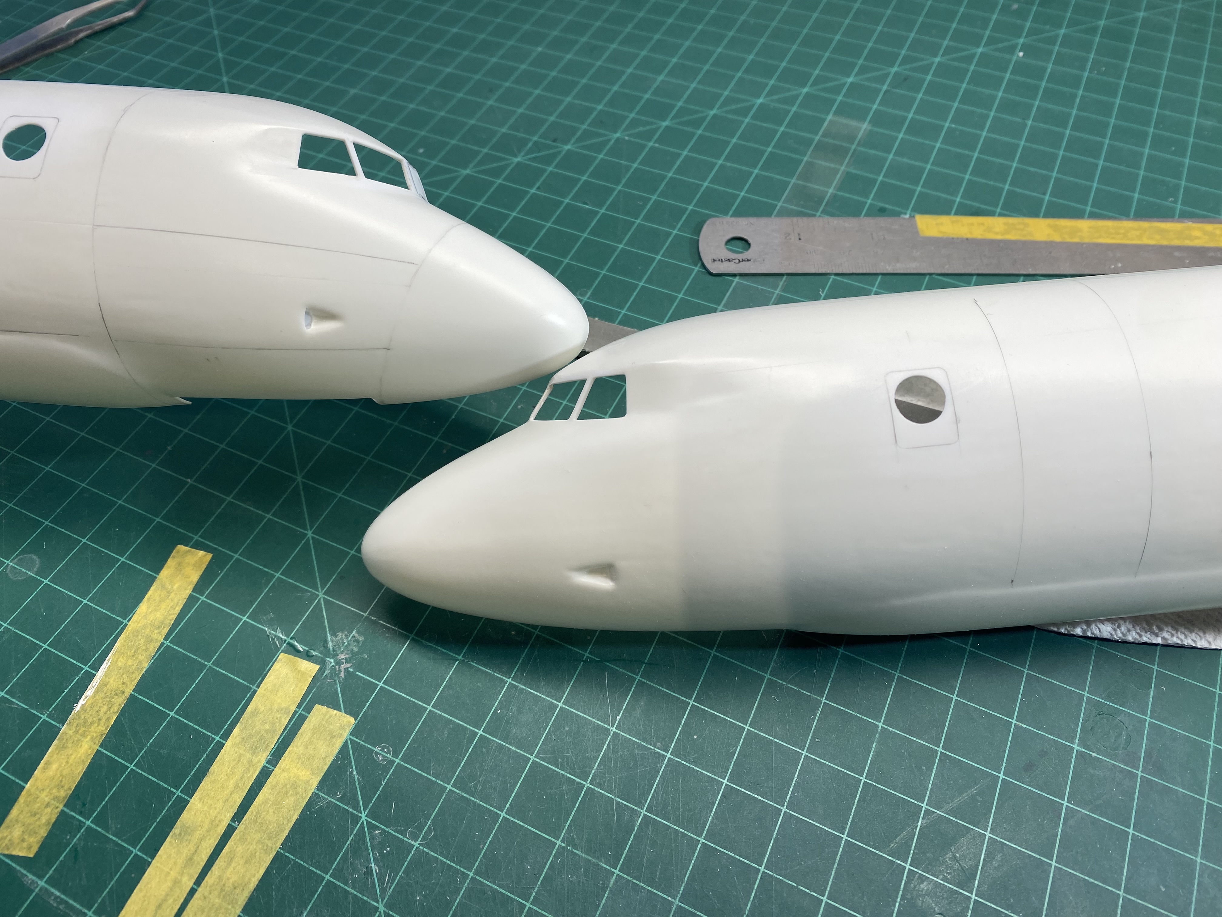

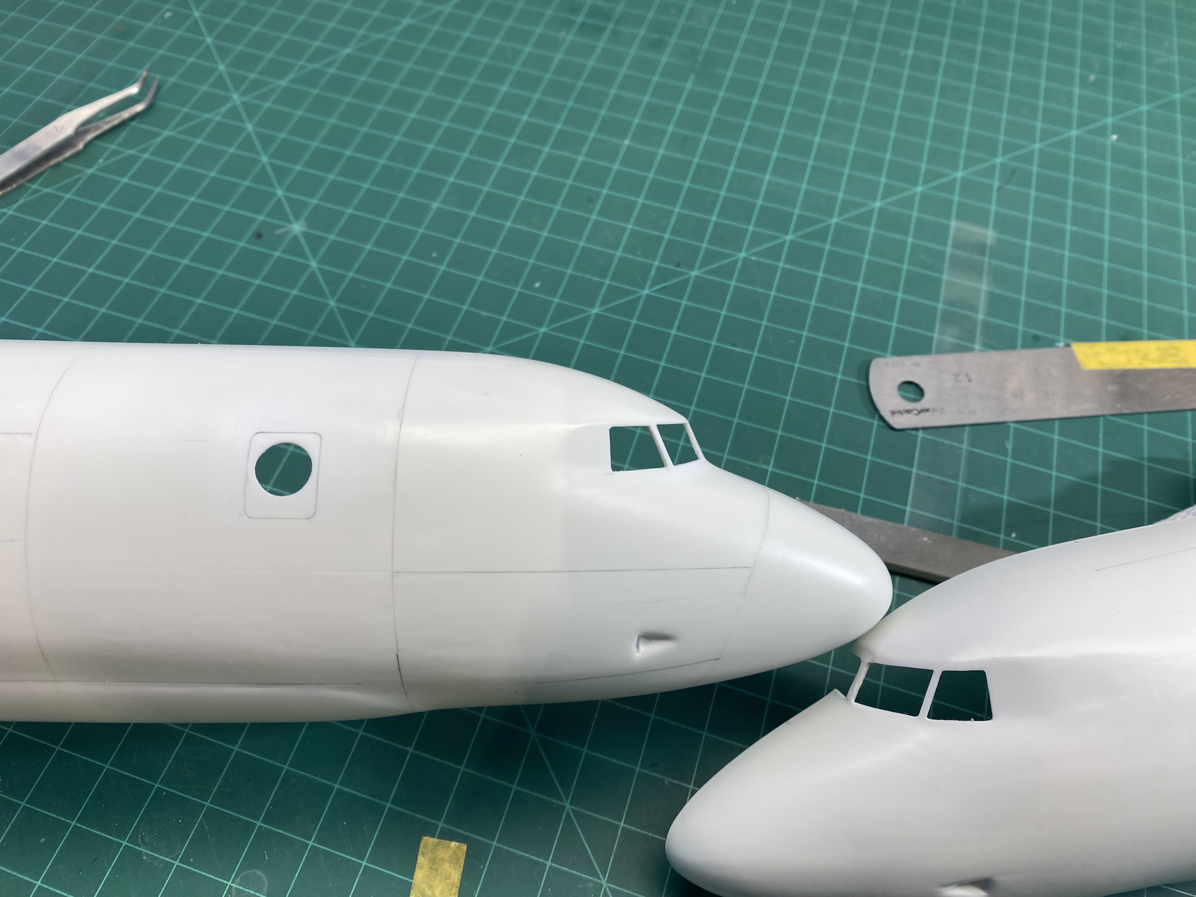

I've screwed up my courage and cut the windshield pillars and re-profiled to a "better" shaped appearance. The right side has been scribed for panel lines and the left is undergoing that same treatment tonight.
The improved left side;
and the untouched right side;

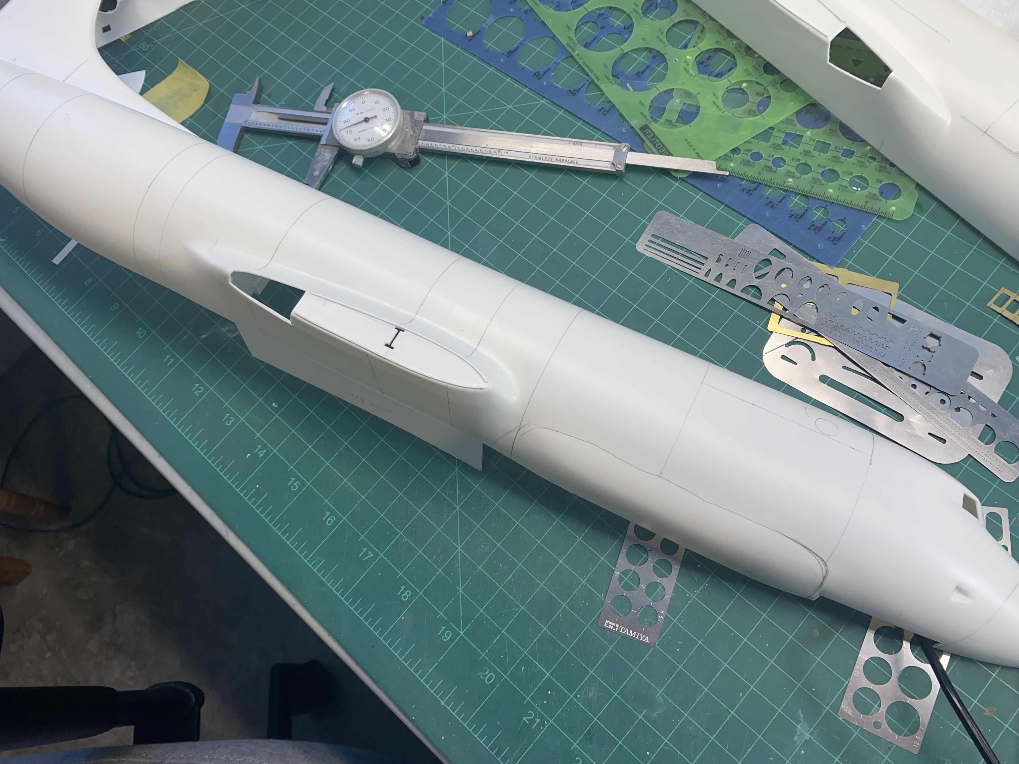

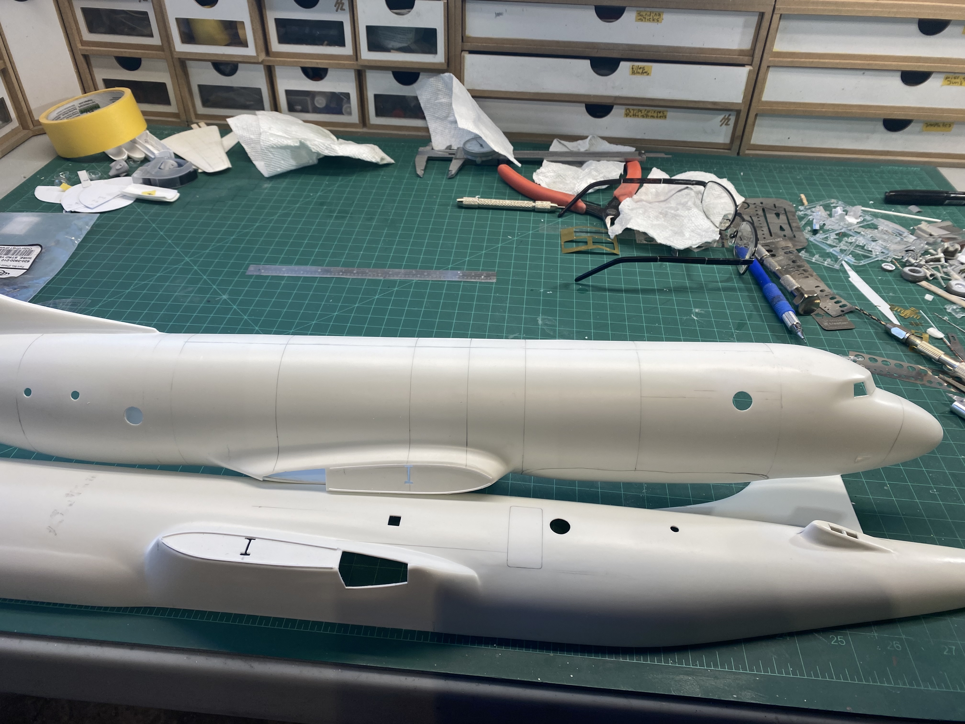

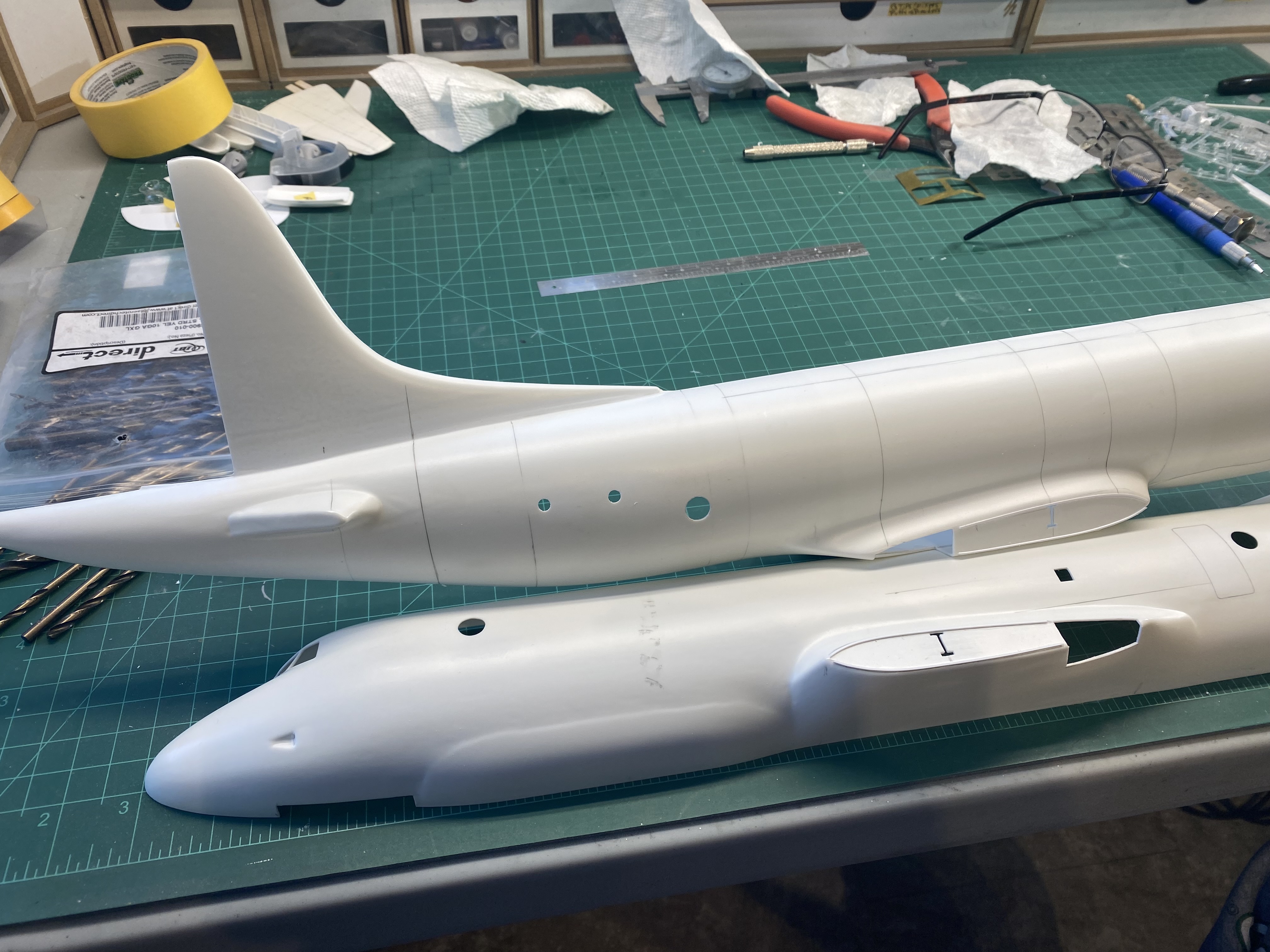

Still plugging away trying to make the model look less like a vac. kit

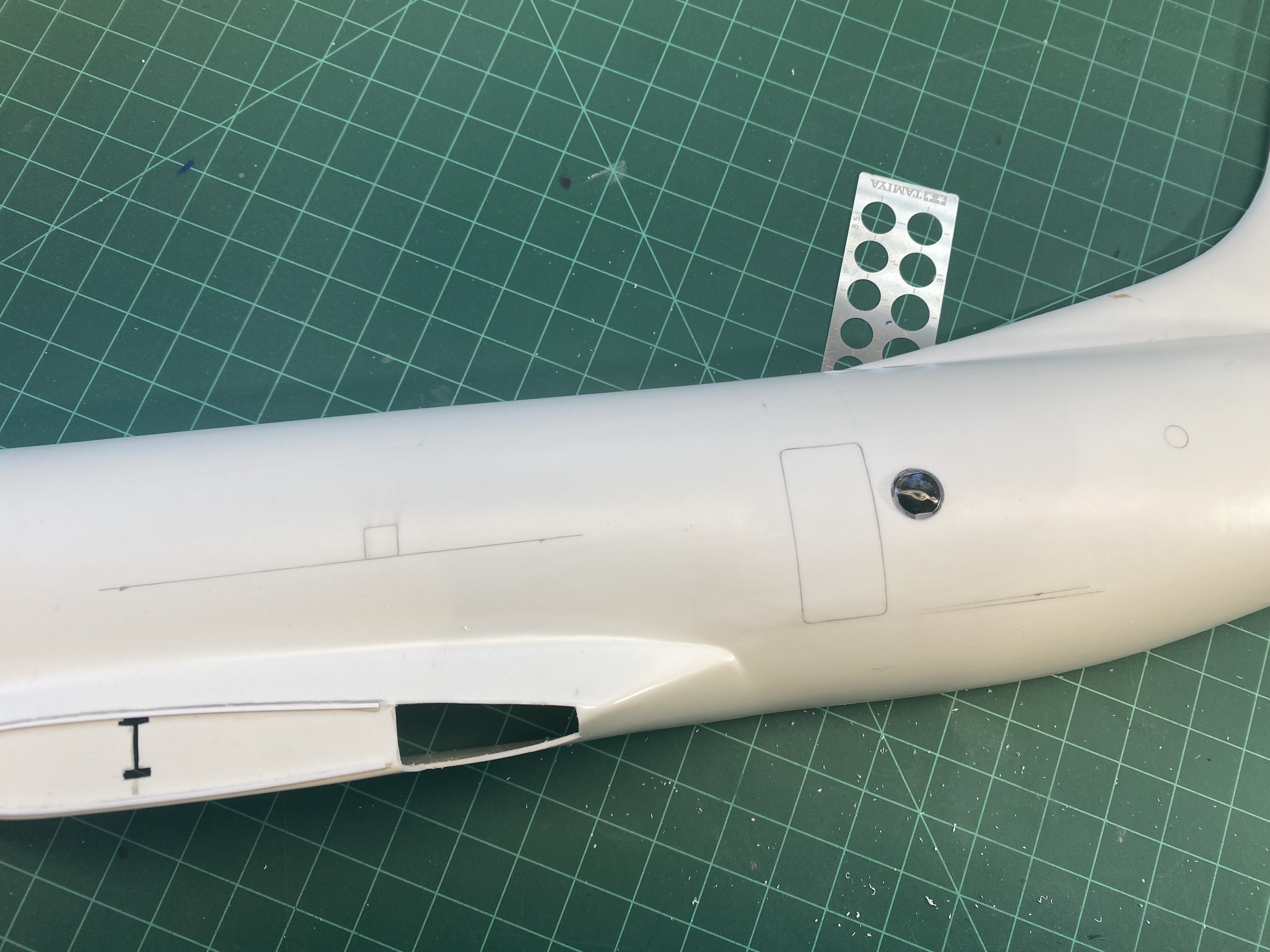

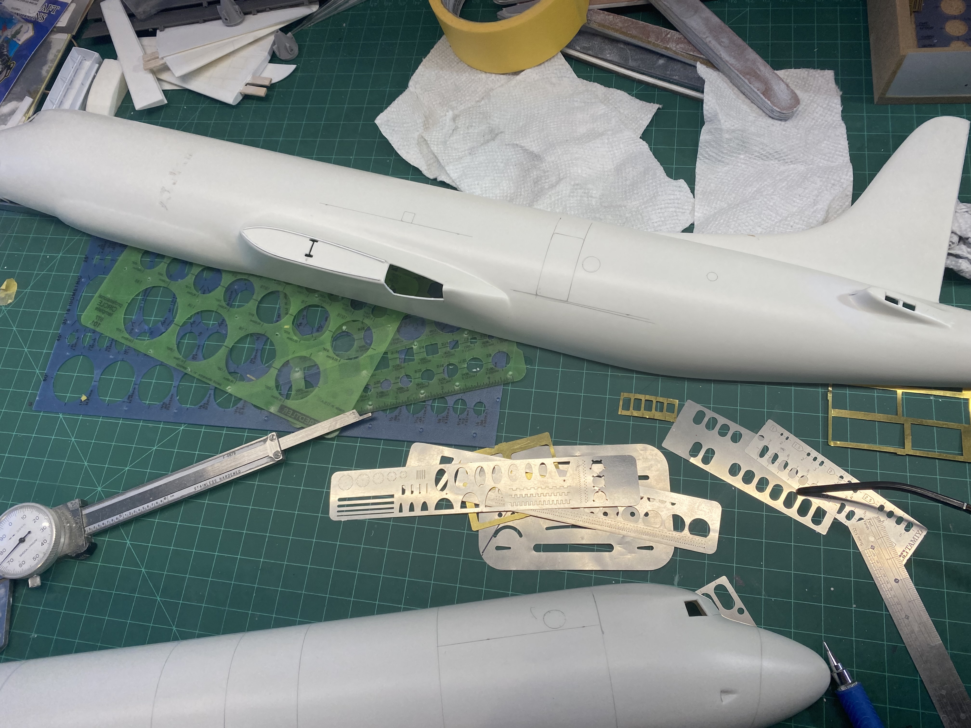

I've used a combination of riveters and scribers on the fuselage half shown here. I'm not going to the top or bottom seam as I expect a variety of mismatches filling sanding will obliterate any detail I may add, soooo later for that.
and there are vents low down forward on the fuselage...that looked kind of familiar...I took a dig through a couple of Hornet kits and settled on a vent from the Academy 1/32 F/A 18 D I am currently awaiting adhesive to set up in order to cast this part for it's vents.
