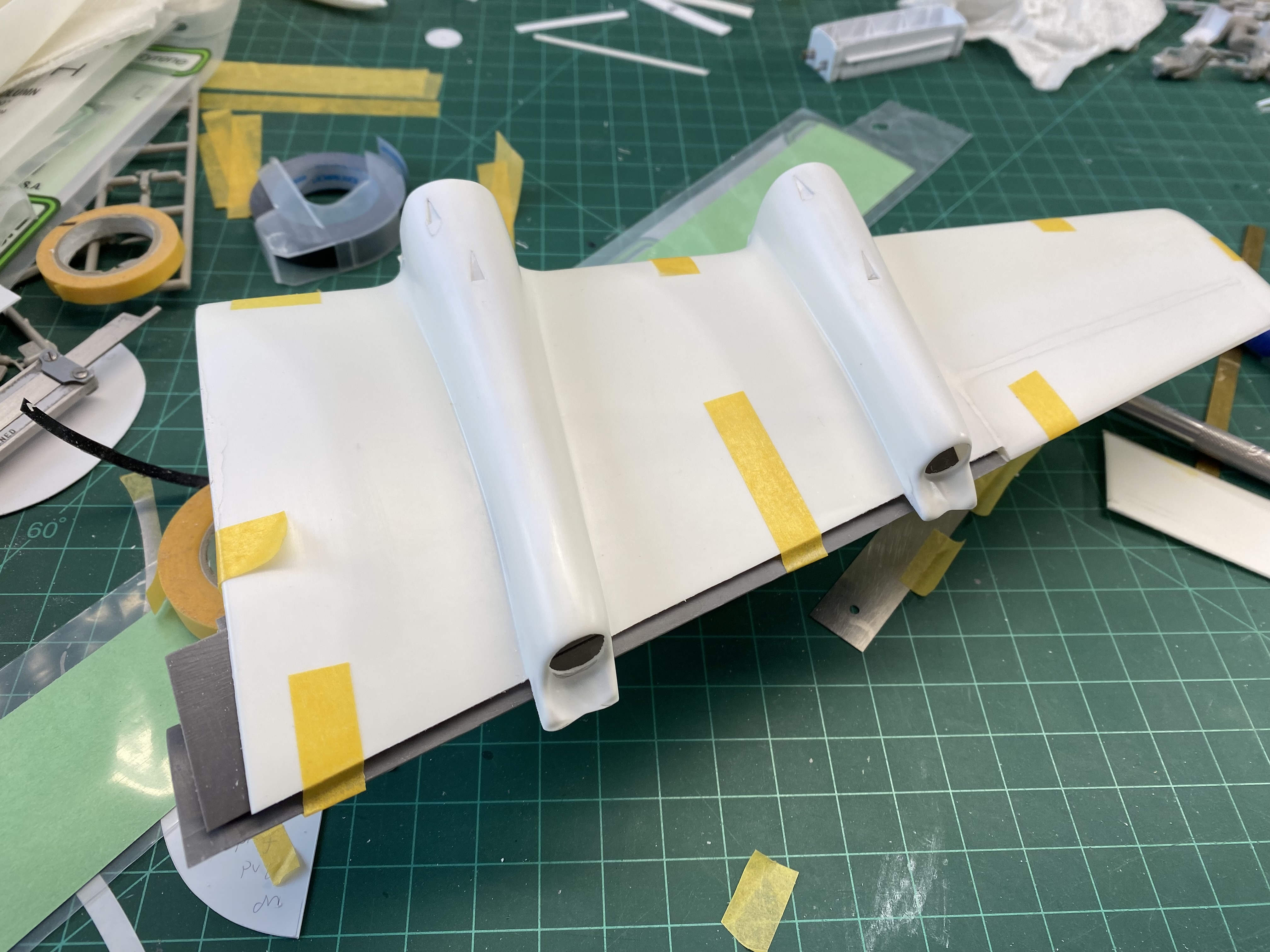

Whilst building main gear bays and trying to duplicate cuts for both bays from one set of measurements I've found that the right wing engines are further outboard on the wing than the left, the inboard engine is larger in diameter width and length so none of the parts fitted to the right wing will fit the left.
Please don't expect this to be anywhere near a perfect or, even a great build, I'll do the most I can (or want) to fill seams, fix major issues and add what details I can. This kit has no landing gear of any kind, no flight deck, a malformed clear part (basically unusable) bubble side windows more akin to half an Eggplant than a dome and instructions consist of a line drawing of a P-3.
I'm aware there is a resin 3d kit available but I'm not interested in that kit or in buying parts for it to upgrade this kit. If it comes to that I'll death stomp this kit and toss it out.

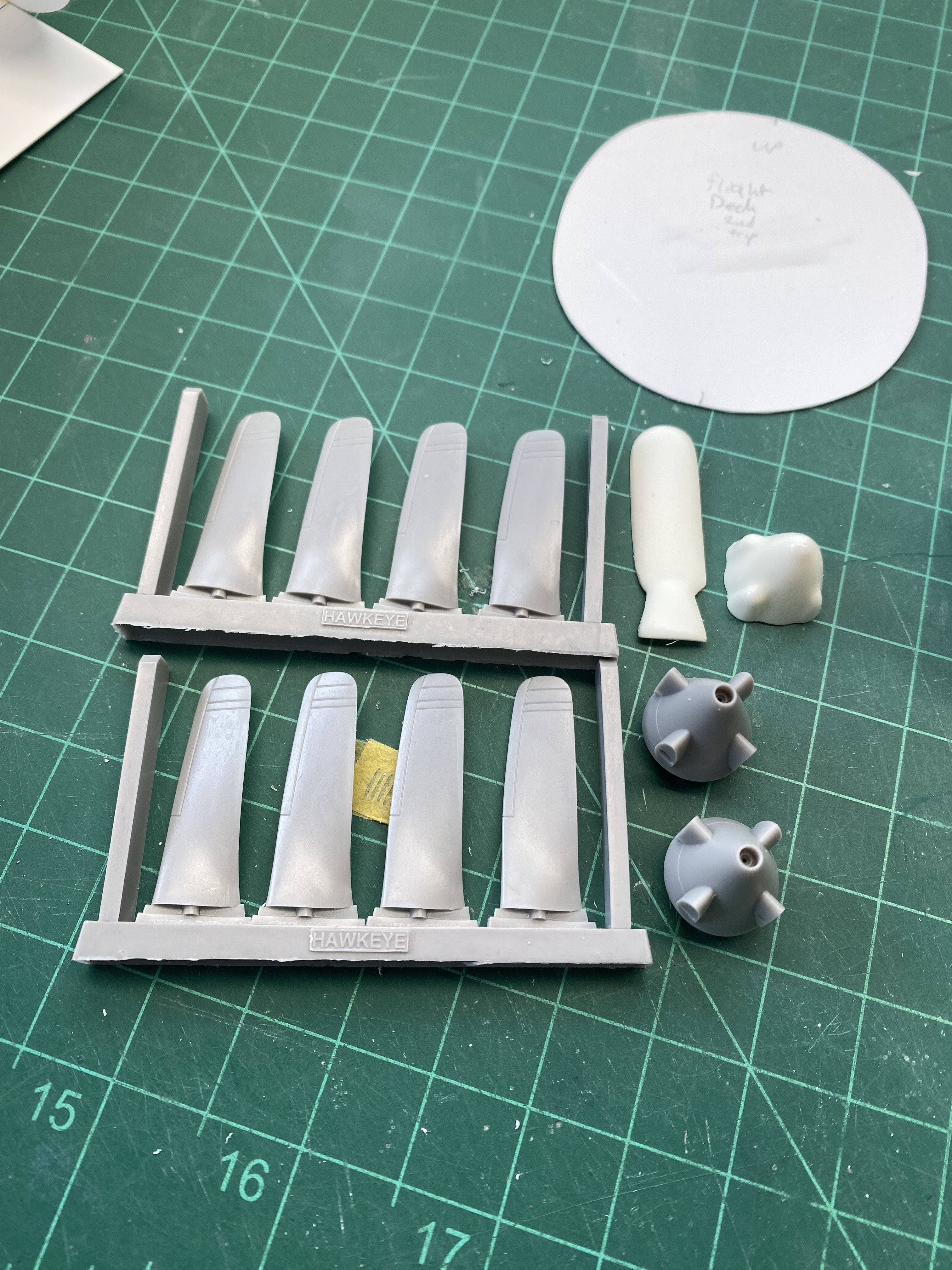

The first few bits from Hannants have shown up in the mail today, props/ spinners quite nice compared to what is in the "kit" for propulsion

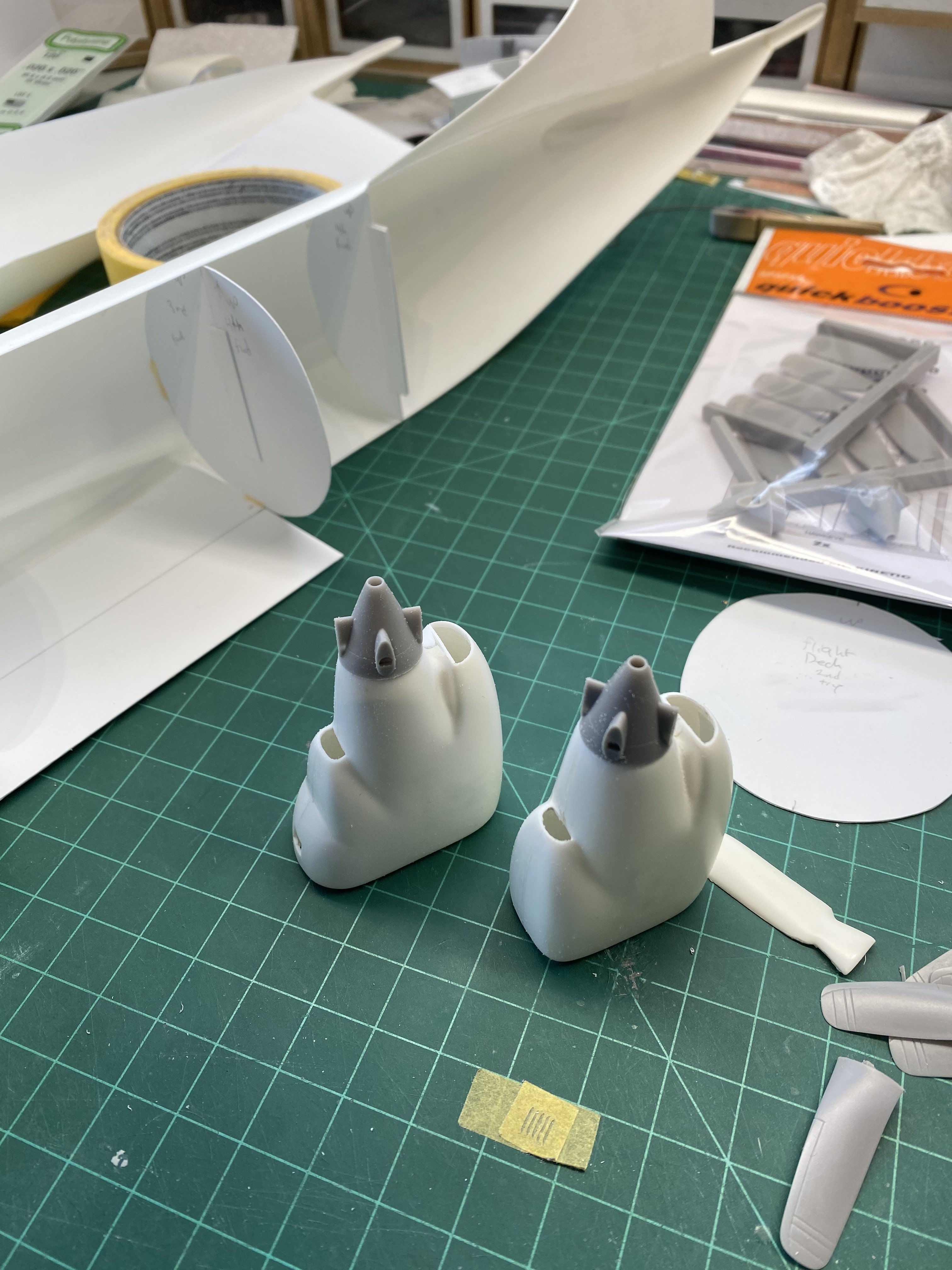

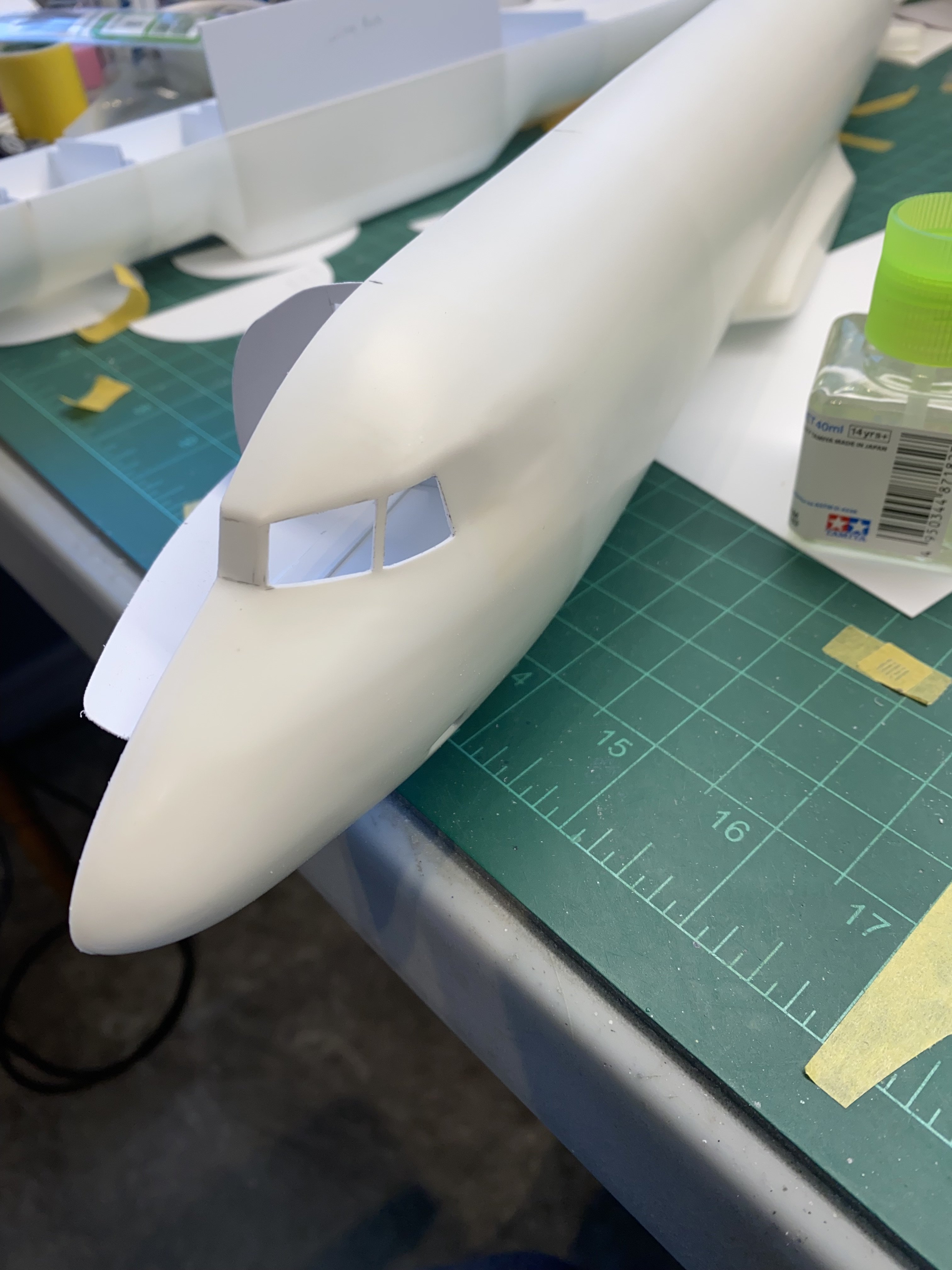

A little progress, nothing too great and certainly nothing to brag about but, I am quite happy with the fit of the quickboost props to the kit engines;

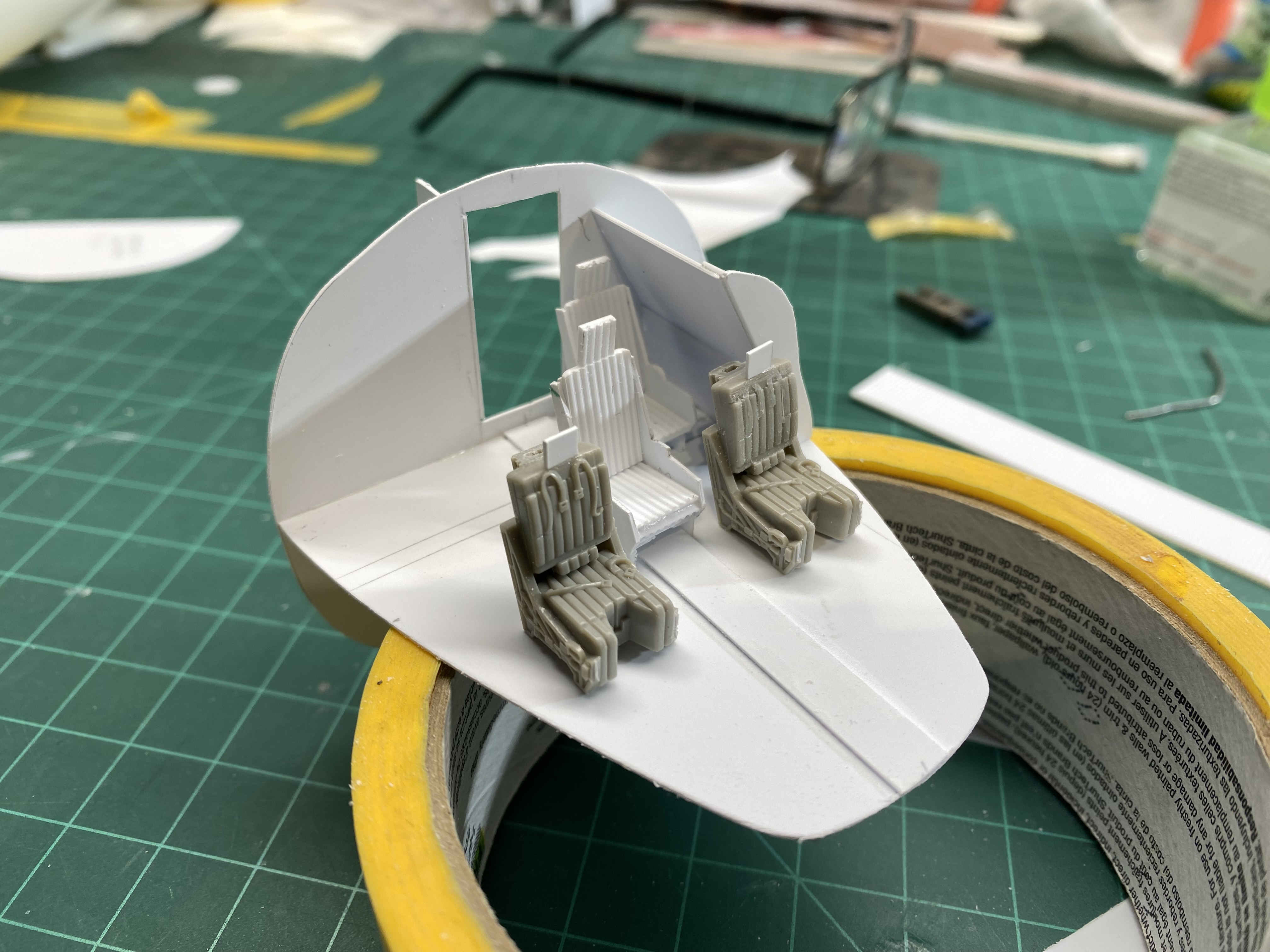

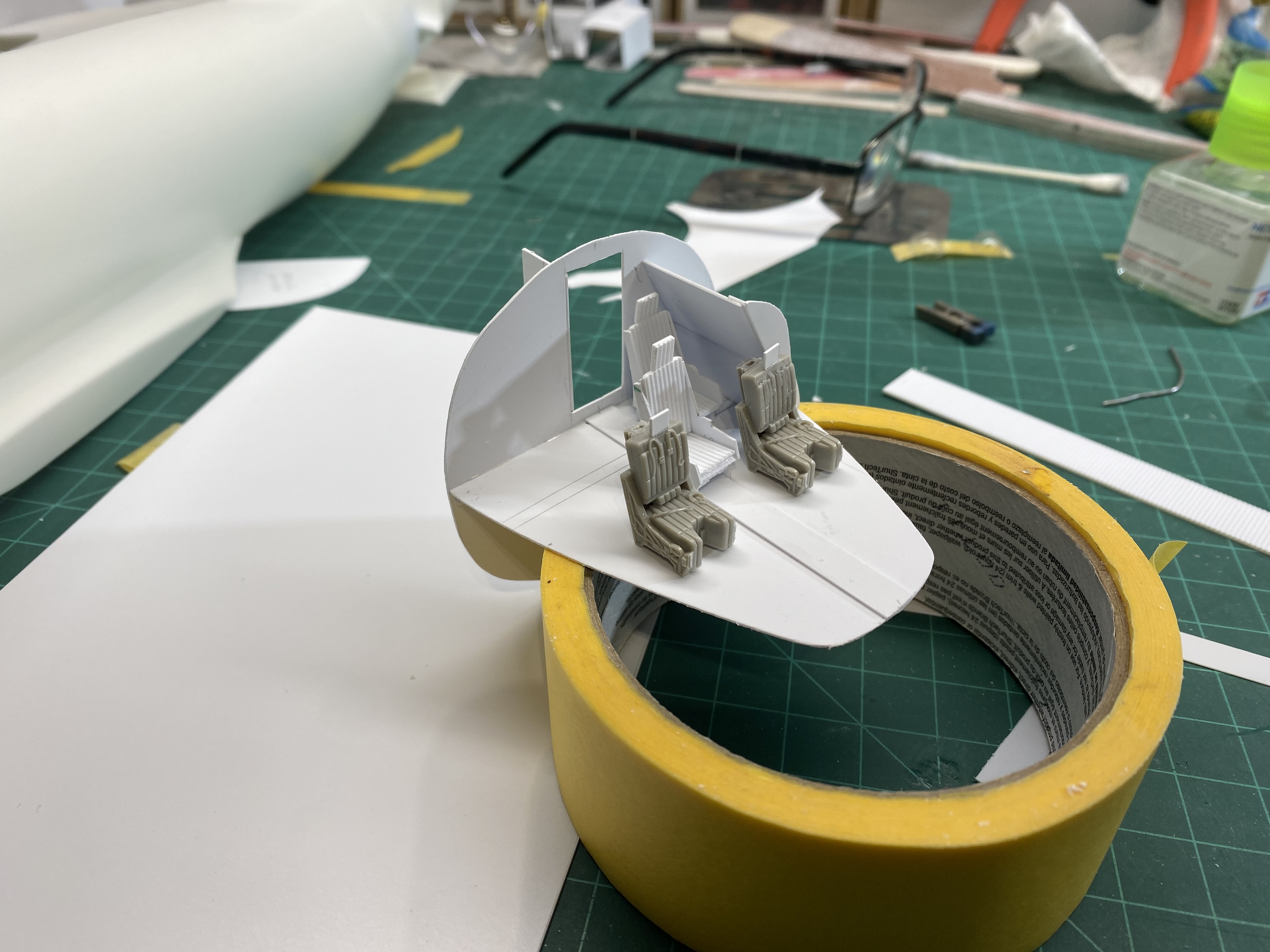

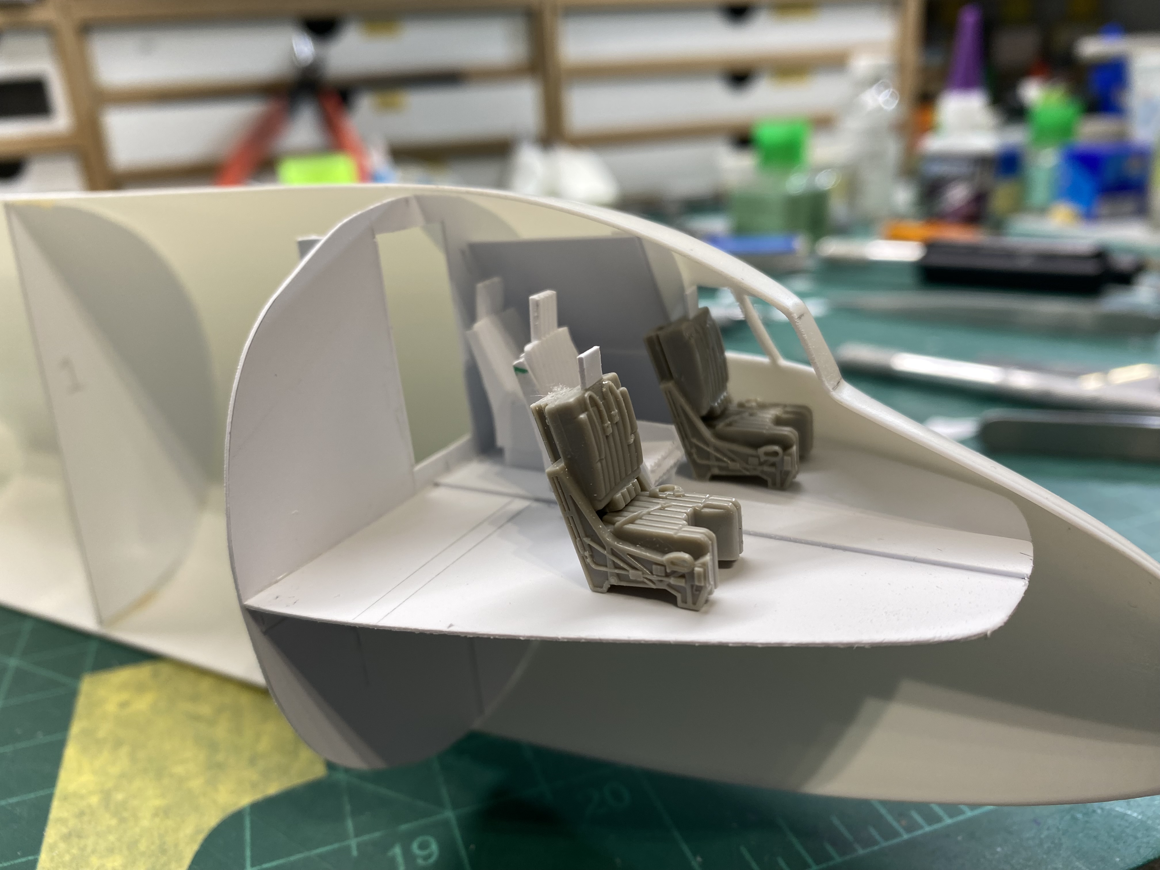

and moving ahead on building the flight deck, adding windows;
construction of the cabin floor/nose gear bay roof;
spare seats from...a Hasegawa? fighter jet of some kind? and copies of them and beginning panels from stock.
test fitting constantly to ensure it still slots into place;
Thanks for looking
ANY progress on a vacuum-formed kit is something to brag about! About the spinners, nice when things work out!

Looking good. Just one thing if you want, there is no seat or console on the back left of the flight deck. Where that console is there is a small door or hatch. There is also one above the FE seat. On the right side there is a circuit breaker panel and a shelf with a removable panel at what was called the FELC. If you do the rest of the interior we did not have the same set up as every one else did and the right side was taken up with the MELC wile the left was the TAC compartment. The rear section should be the same as others though. This might help some. At the start thy are by the door facing forward.
James
Thanks. I was using images of...god knows what it was. The subject was listed as a P-3 Orion but that's the hazard of using the internet for reference pictures. Lots of pictures of the instrument panel, very few of the flight deck from the I.P. looking rearward. I went to Scalemates and used a download of the 1/72 Hasegawa P-3 instructions as a reference to the flight deck. This won't be perfect, never expect perfection, accuracy or even decency from my builds. but it is a work in progress;

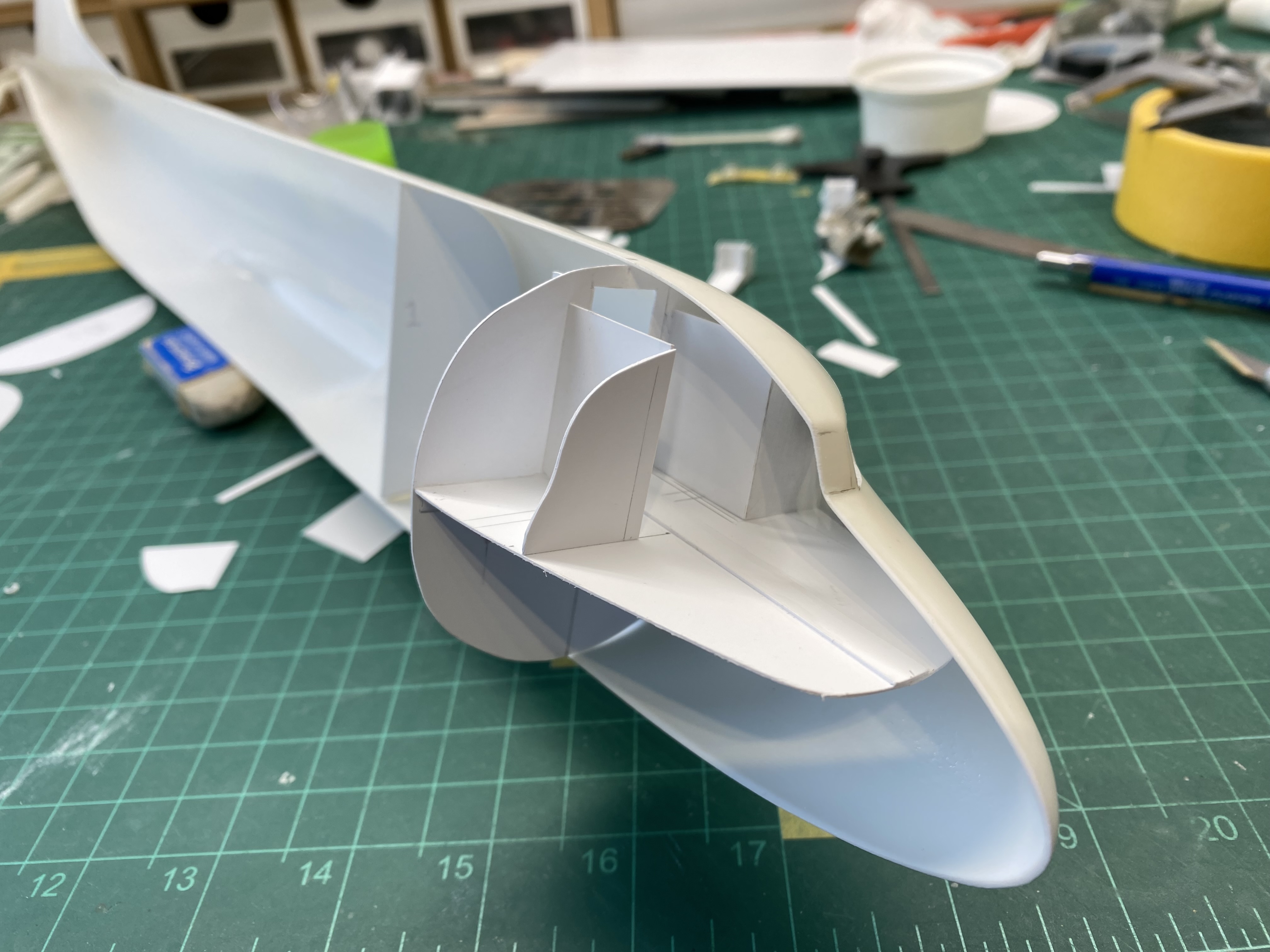

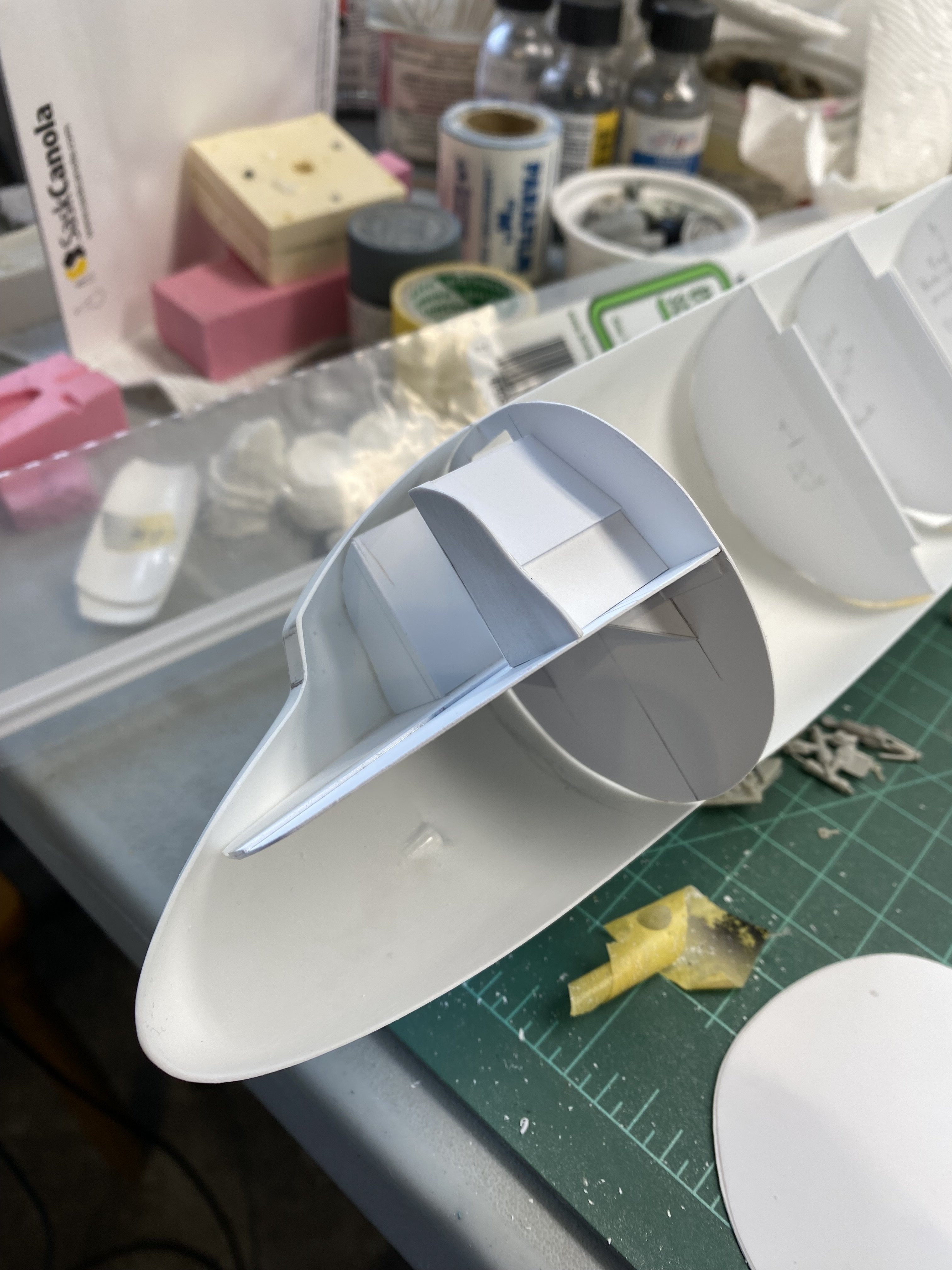

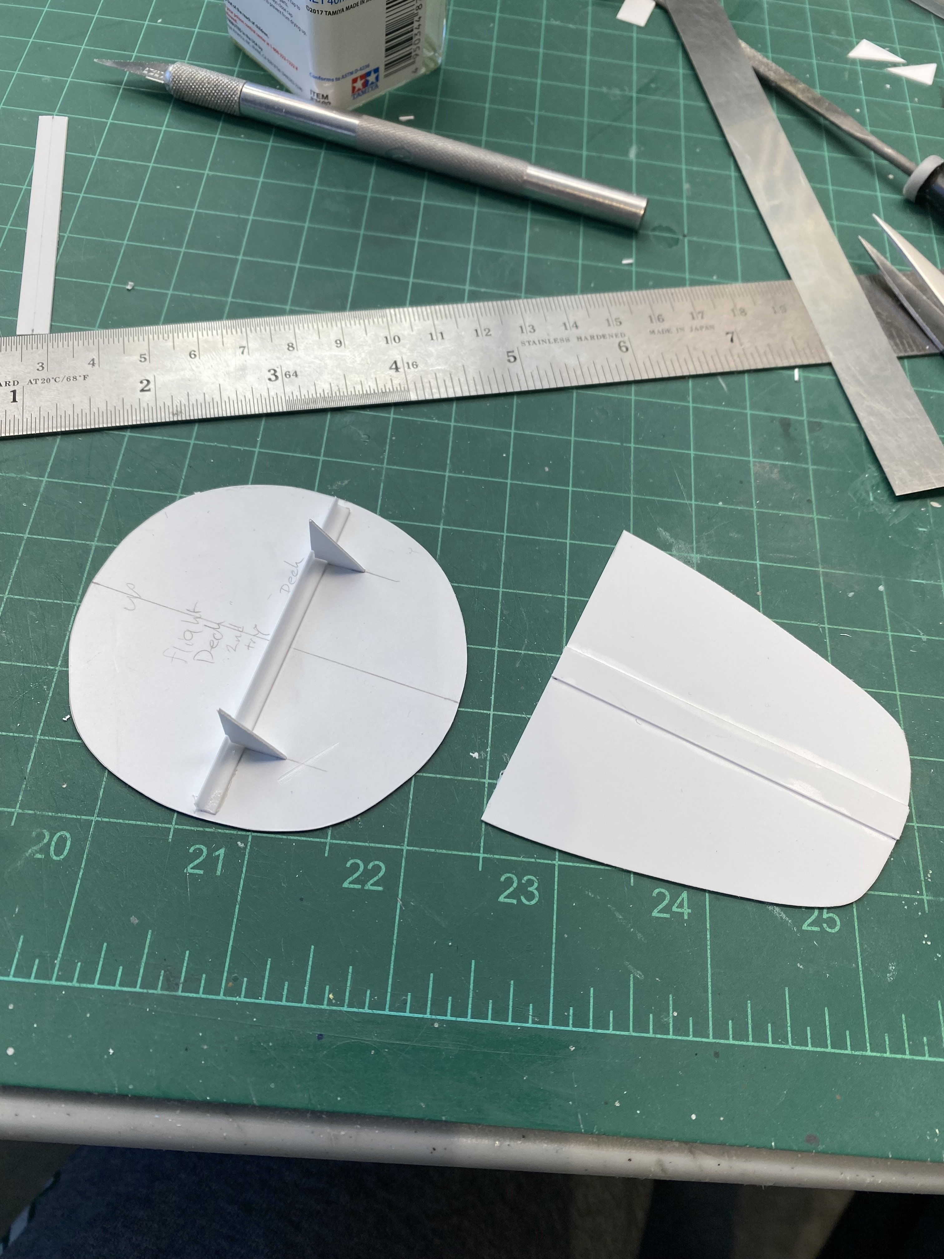

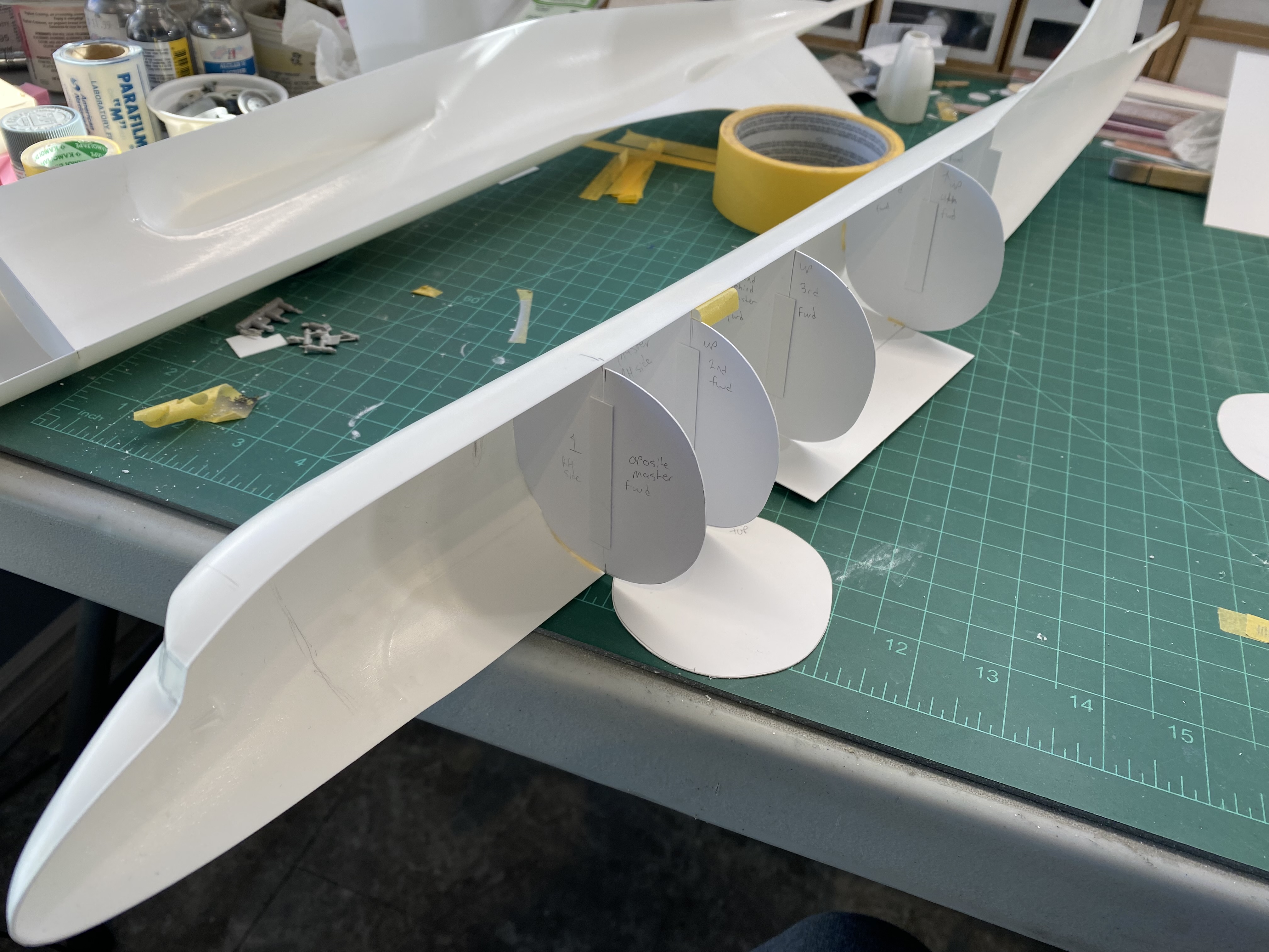

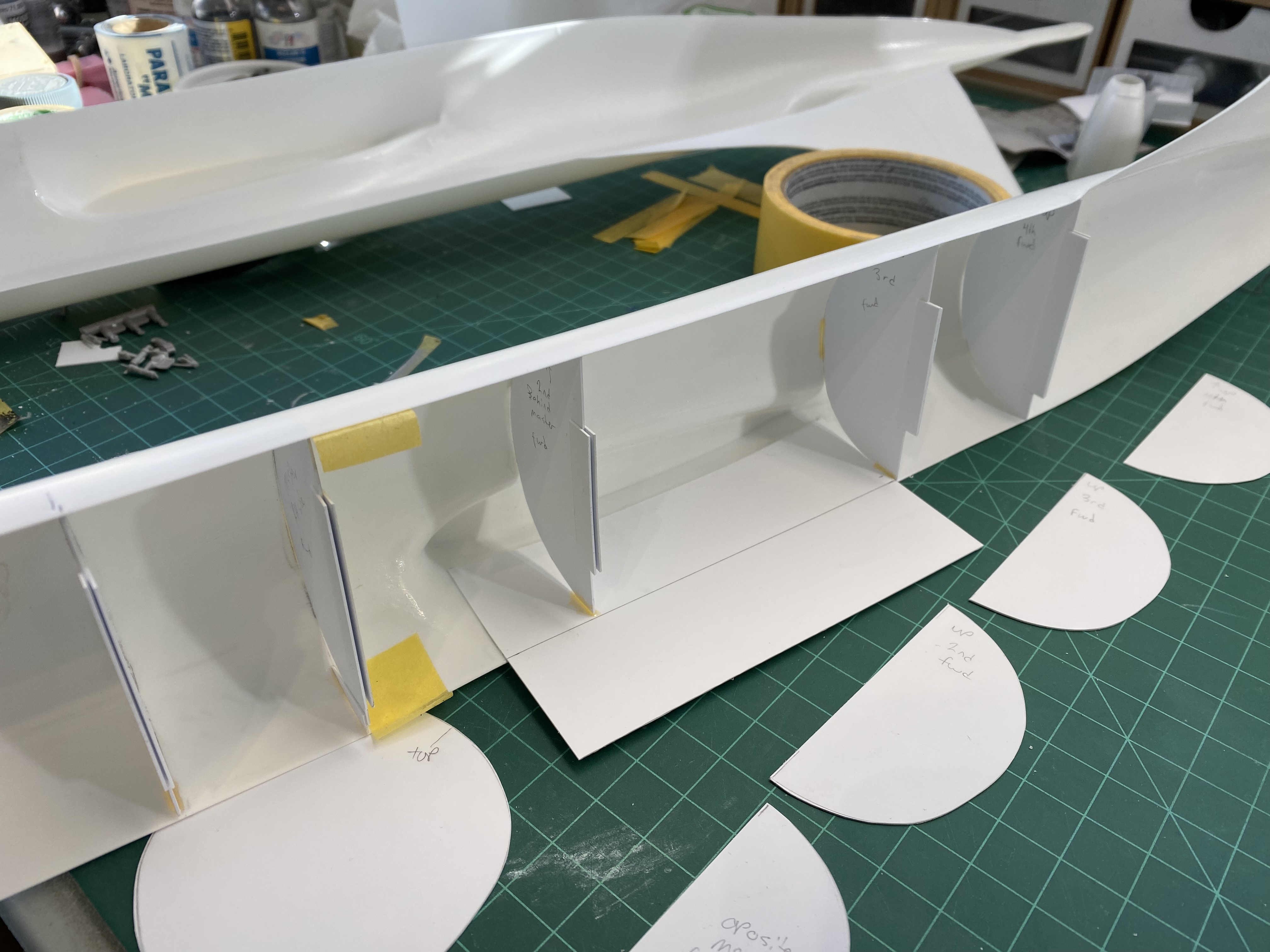

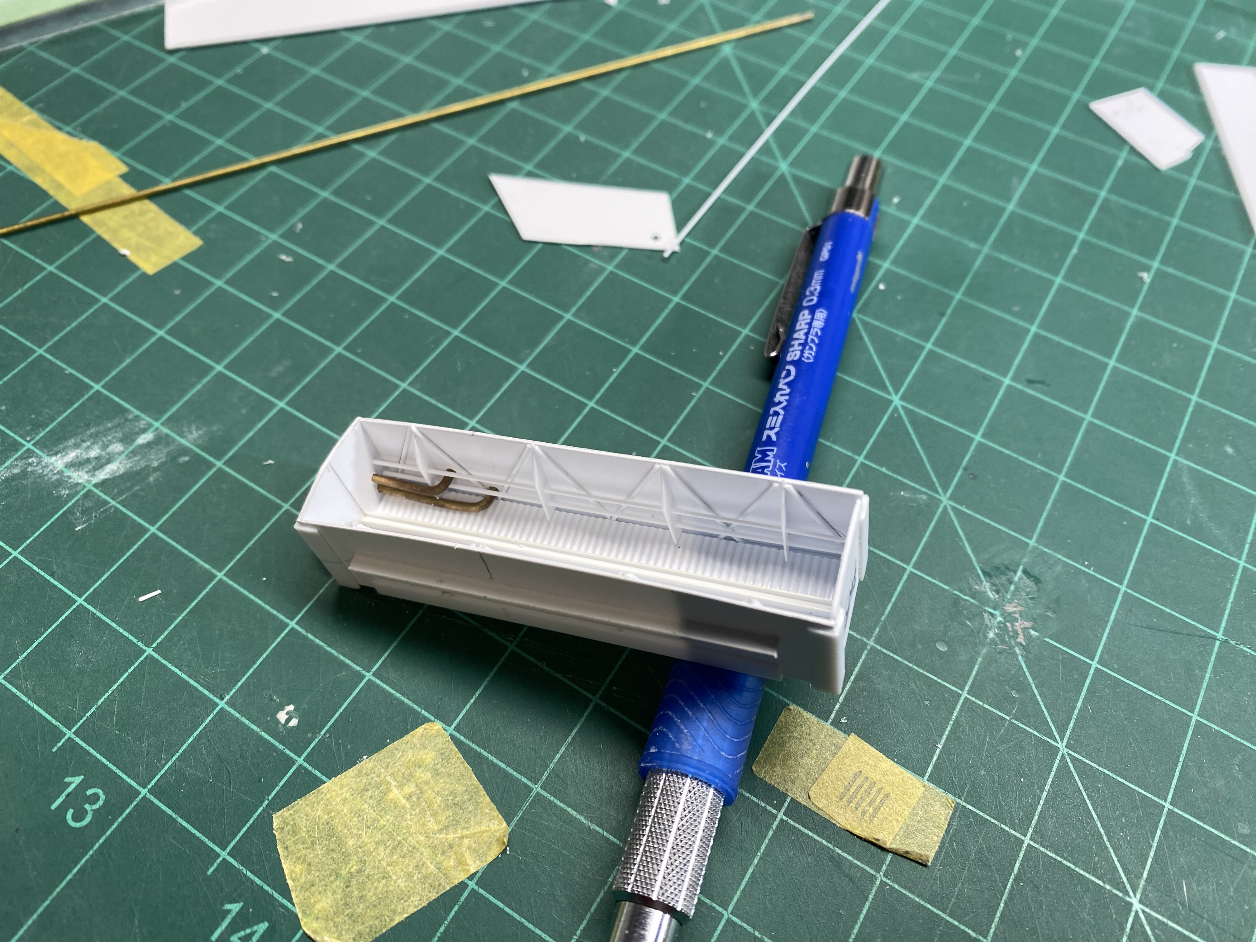

A bit of progress since I was here last. Other than turning plastic into shavings and dust. I've measured up (ok kind of roughly) and began building the nose gear bay. The all important disclaimer now, this isn't accurate just my rendition of some of the structure I could see from images. I've tripled the thickness of the bay roof with 3 pieces of .020 sheet planning ahead to strength for adding weight to counter balance the model.

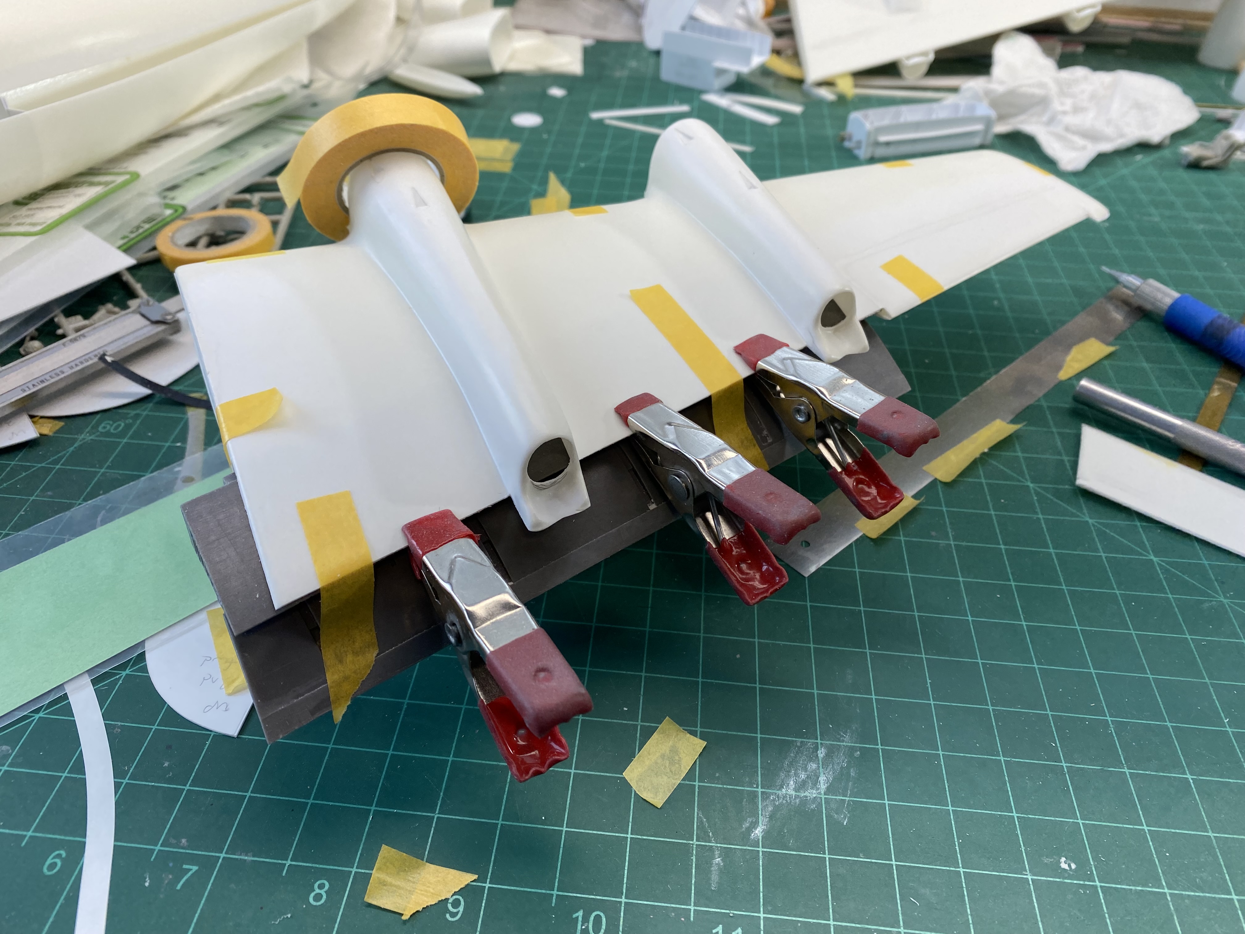

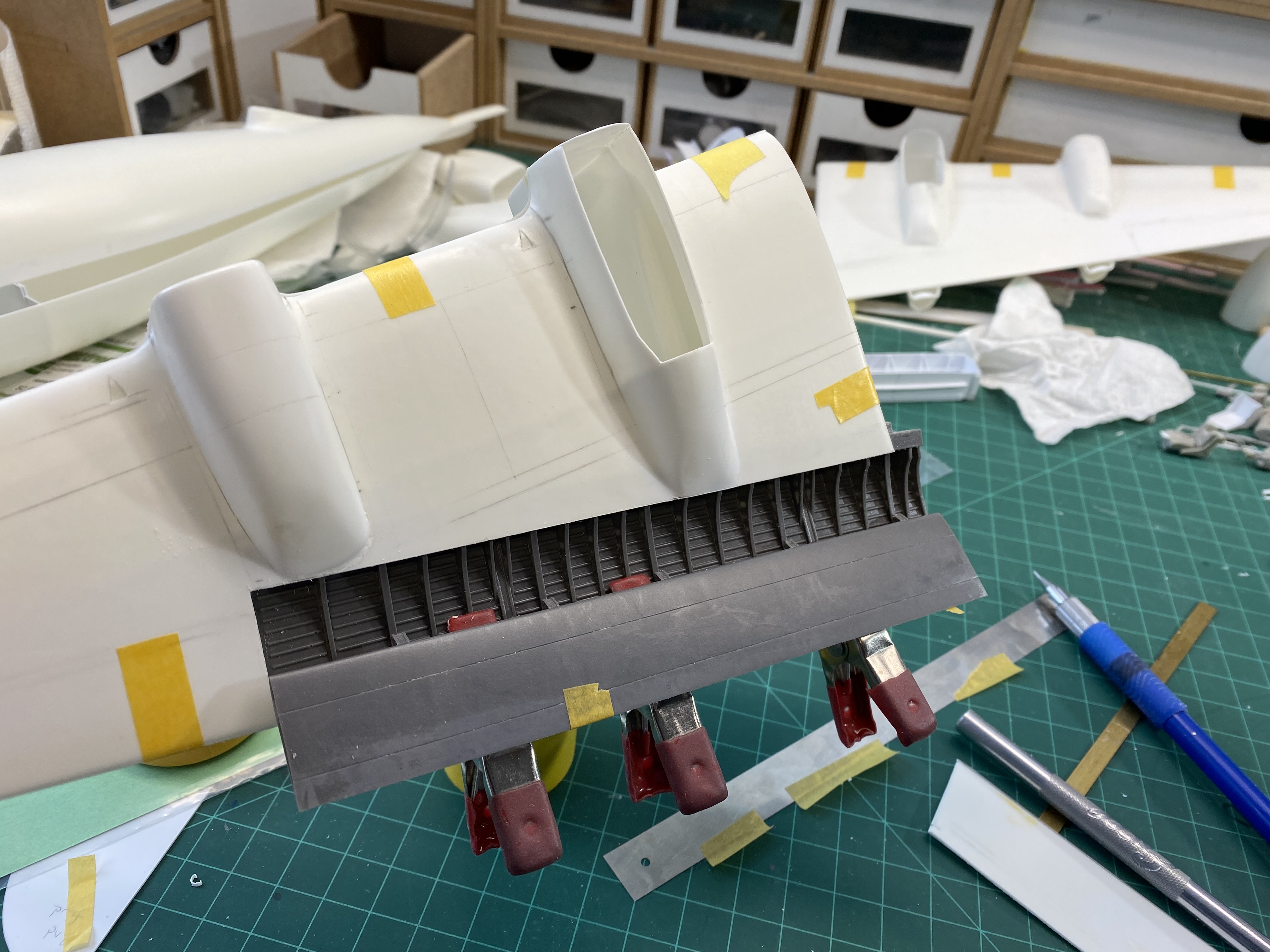

Now being the maniac I think I am...I've begun adding internal wing structure for "flaps down" The flaps are not designed for this kit but look close enough to me.
Top view;
Bottom view;
flaps up (not for this project);
Thanks for looking
