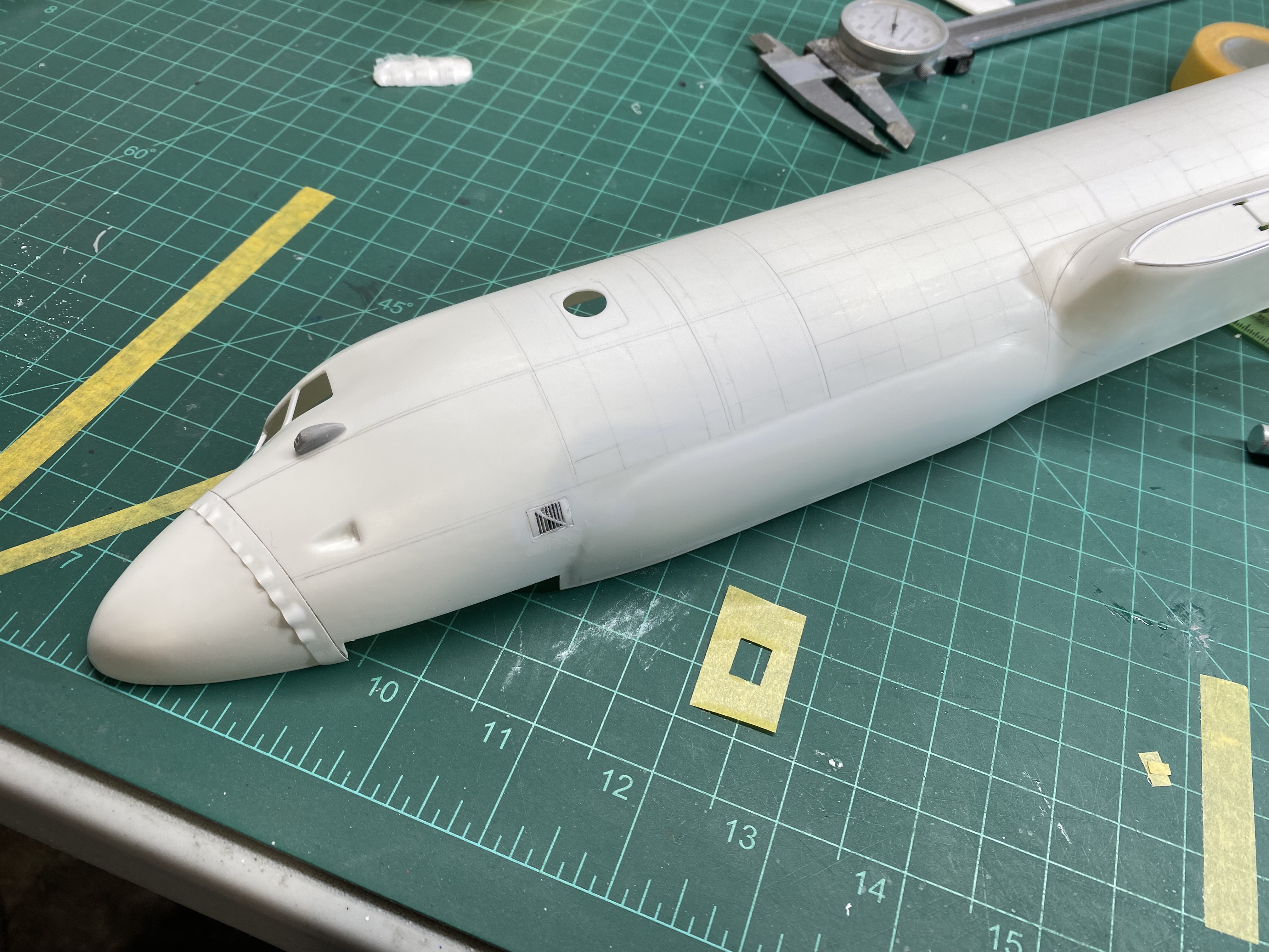

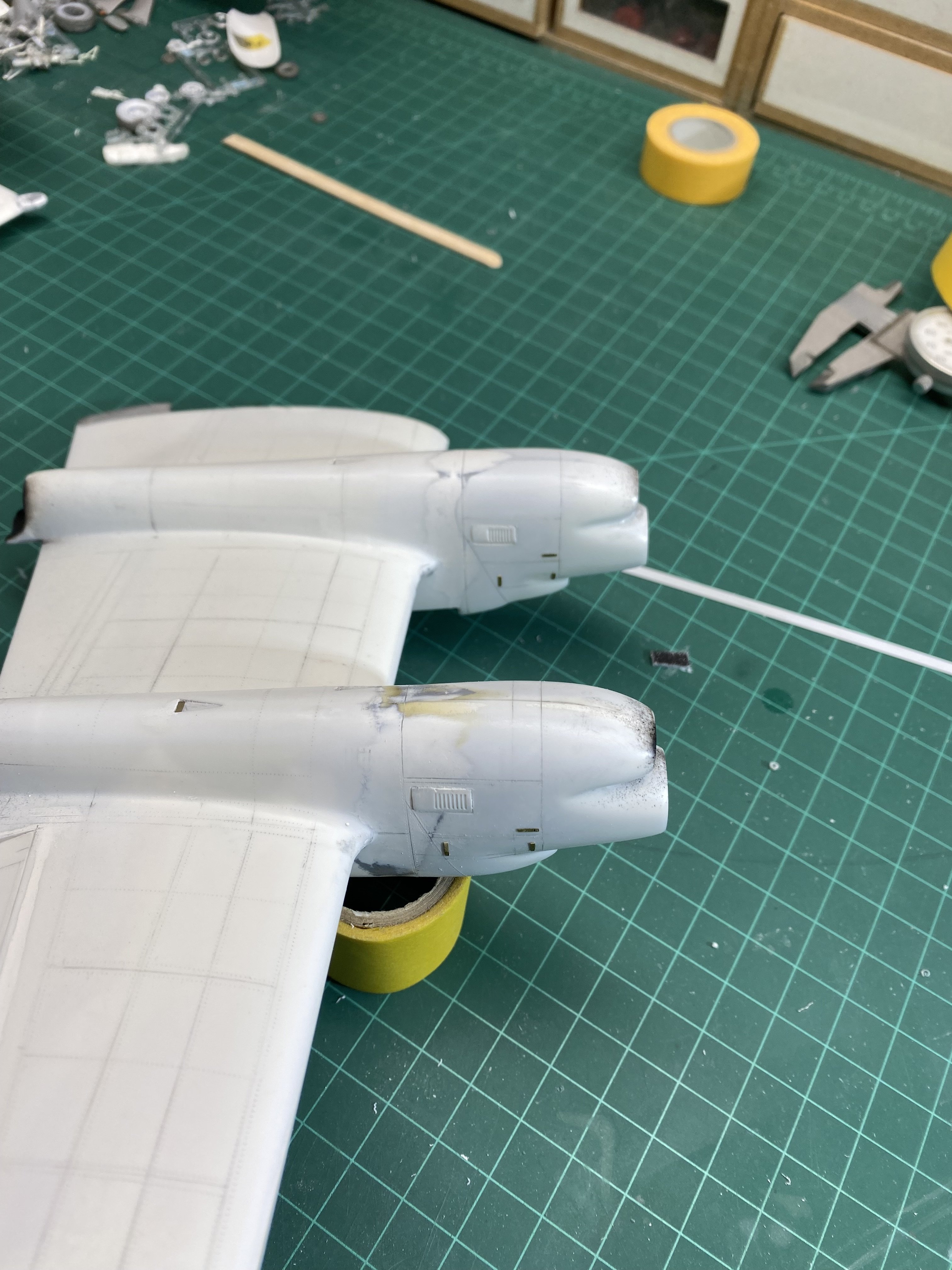

I've made some resin copies of the vents from the F-18, sawed them up and fitted them to the CP-140
Thanks for looking

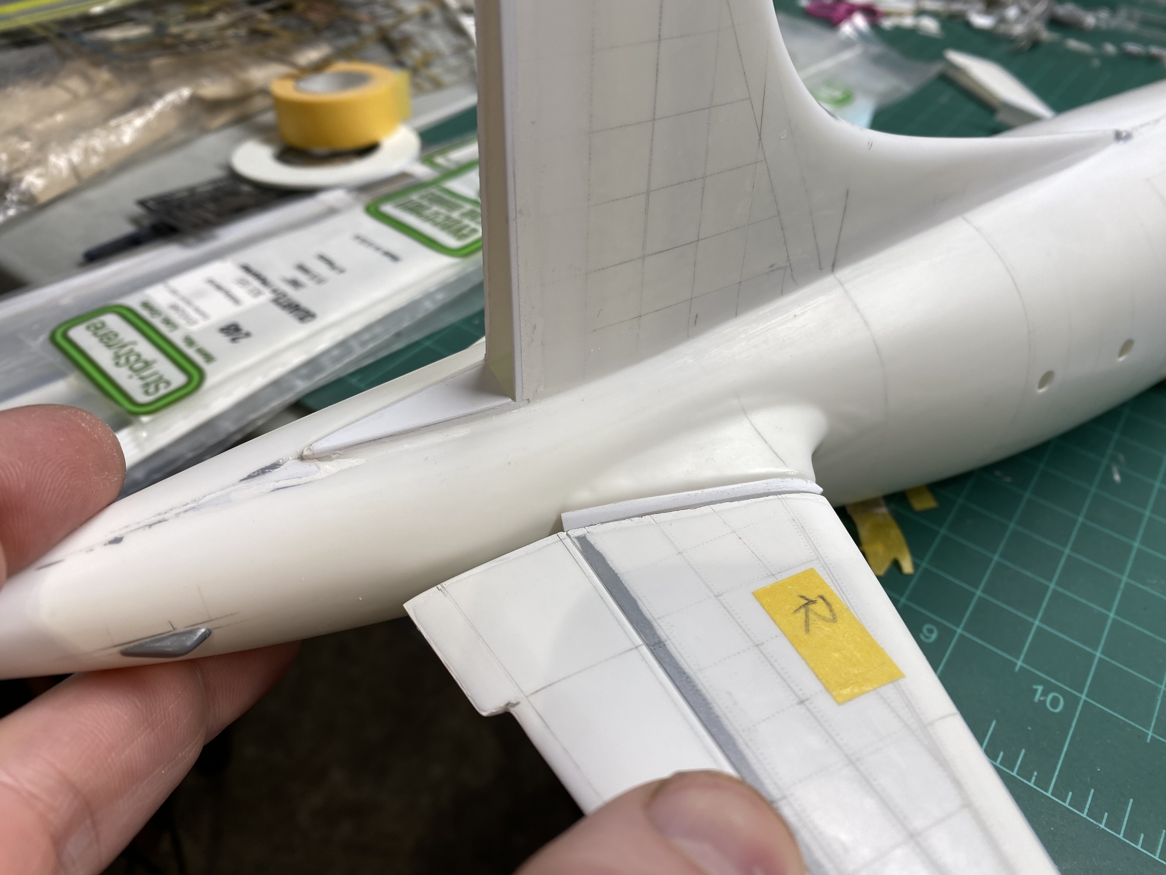

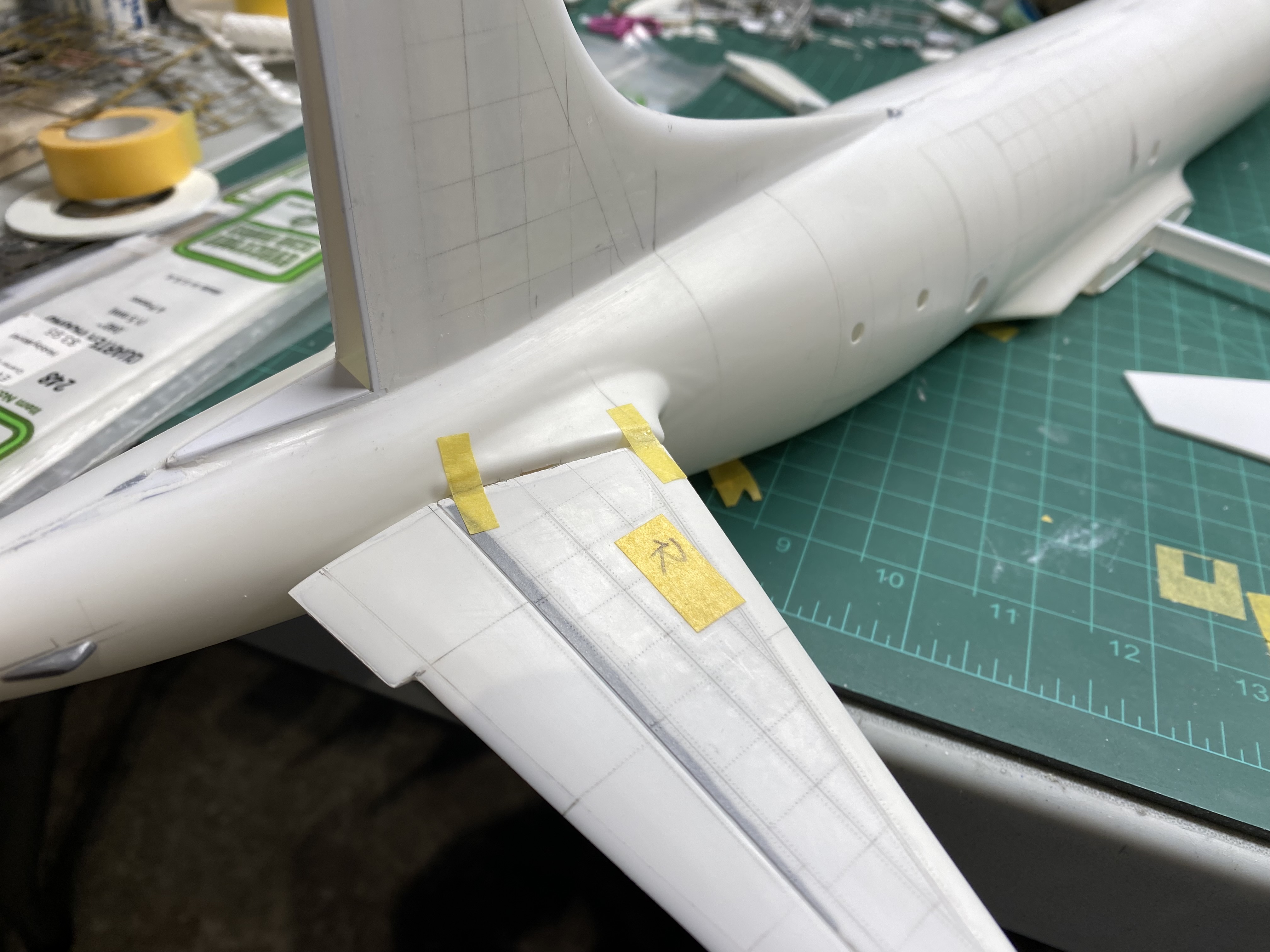

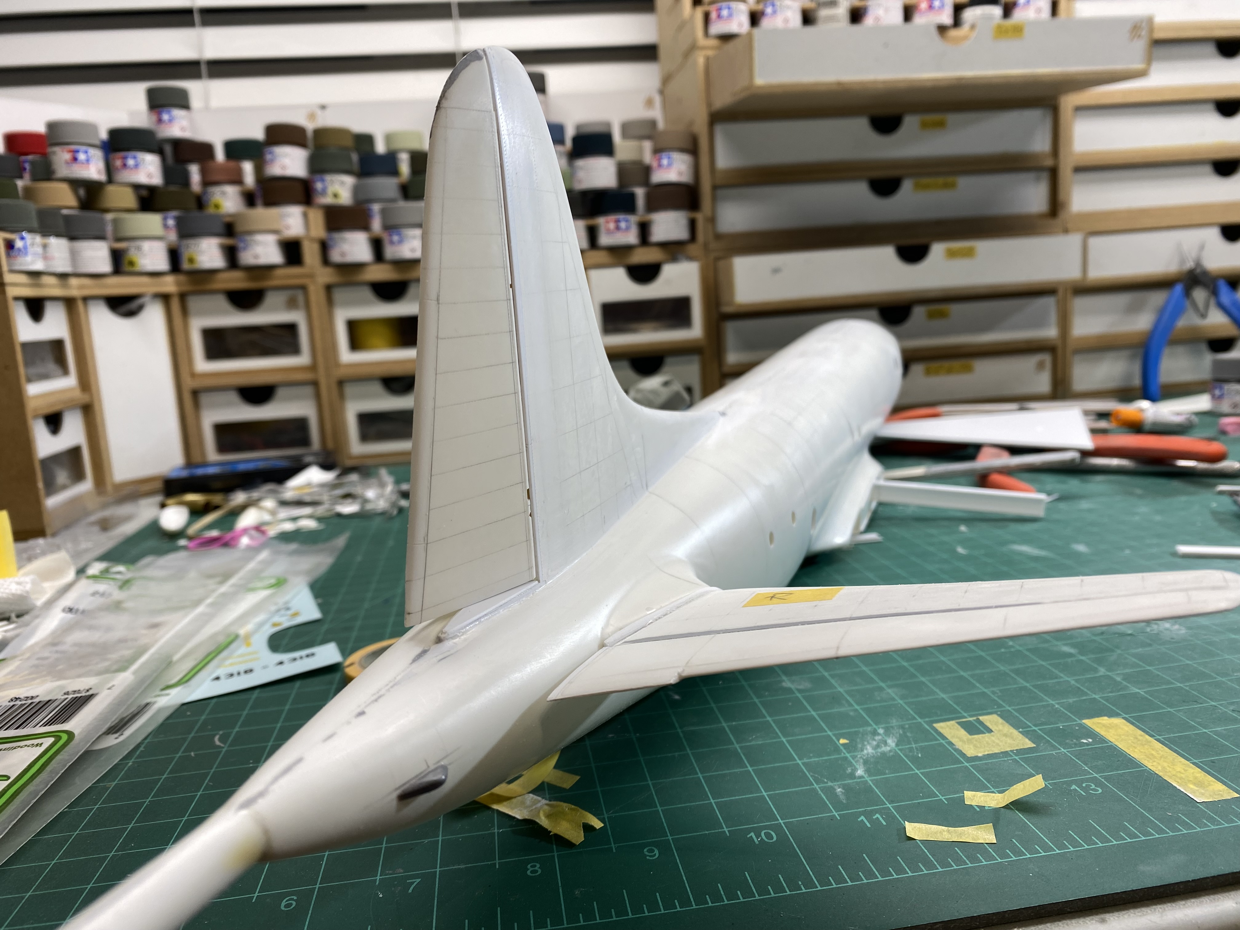

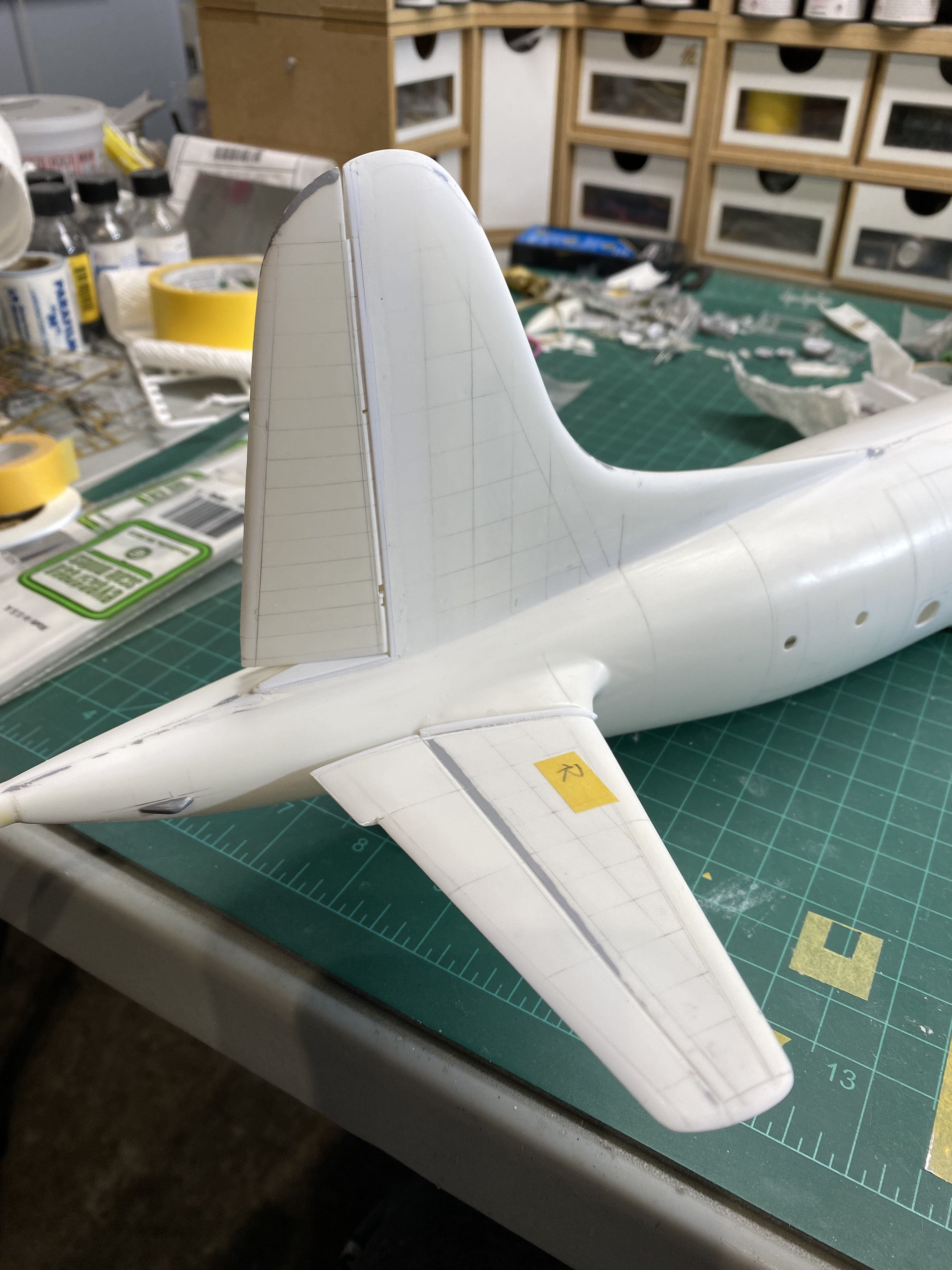

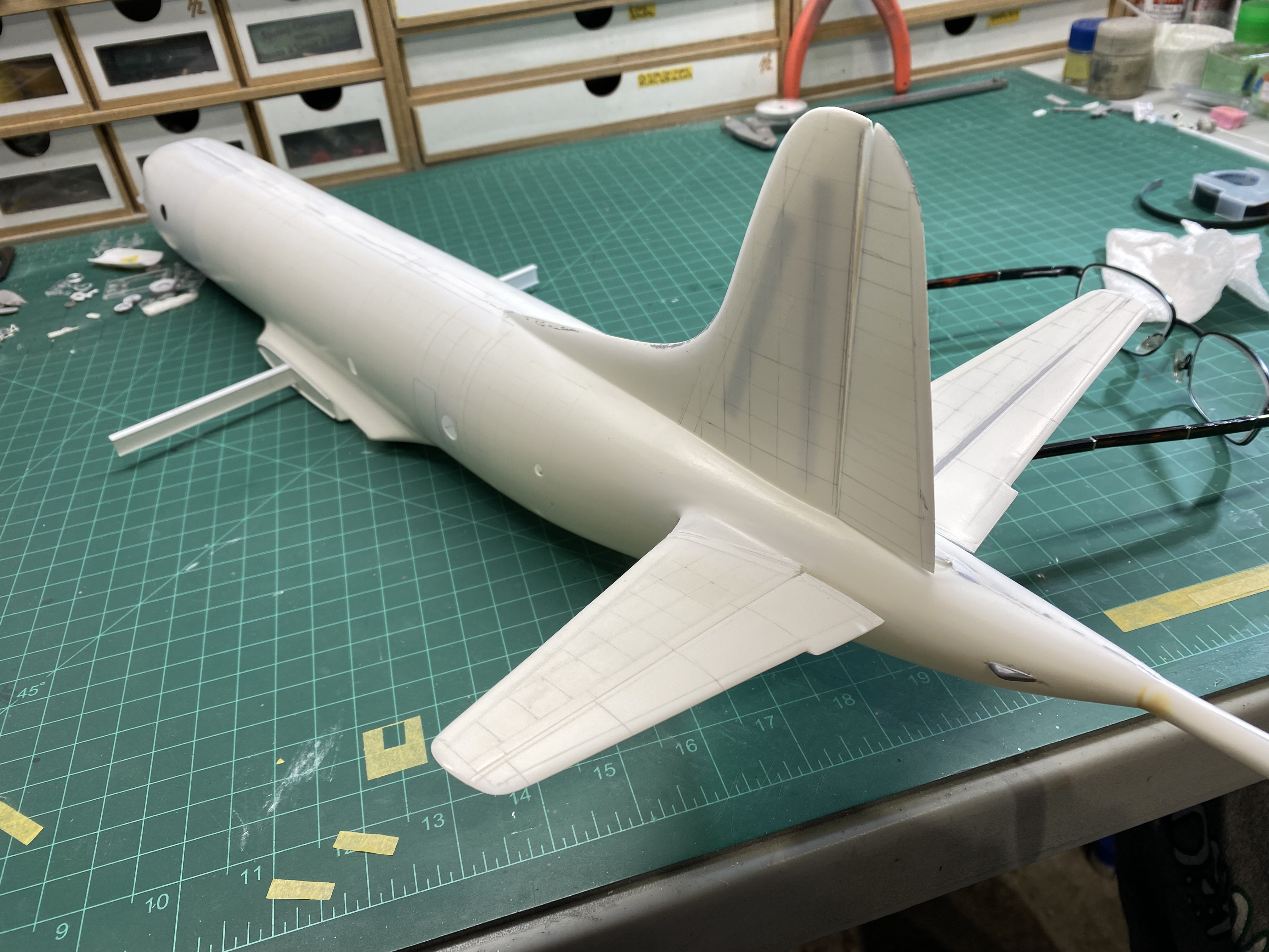

I’ve begun fitting the “empennage“ this required either sanding the root fairings to an acceptable thickness or increasing the thickness of the horizontal stabilizer about 25% I knew the issue existed earlier and packed the insides of the root fairings with material so I’d be able to sand them thinner. In the end I took an entirely different path, I made a filler to go between the root fairings and the stabilizer out of a shim of .080” thick sheet tapered it and glued it between the fuselage and the stabizer.
here’s the stab. placed against the root
the filler being worked on
glued in place and filler added
much more to do but it’s progress(ish)
thanks for looking

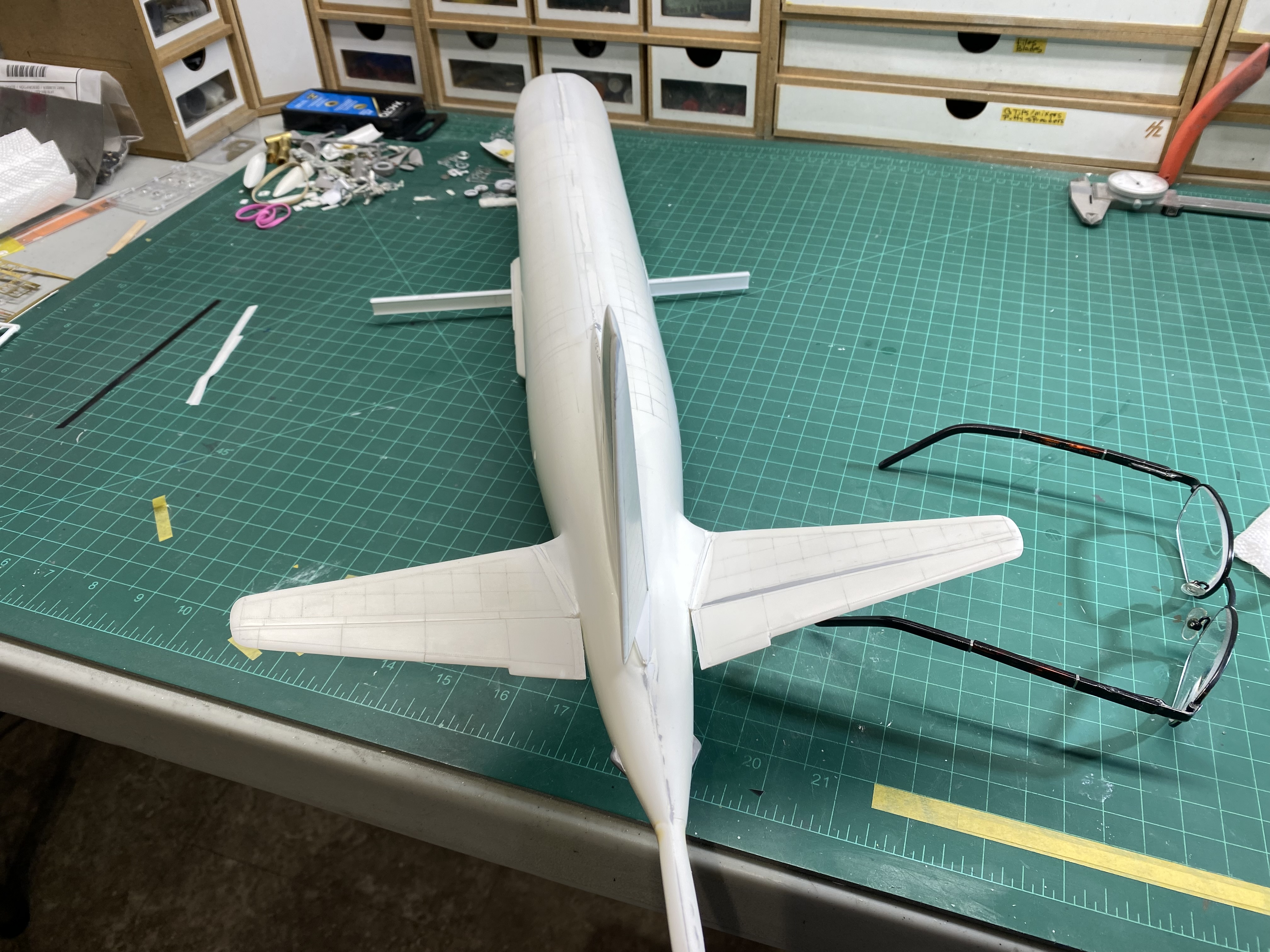

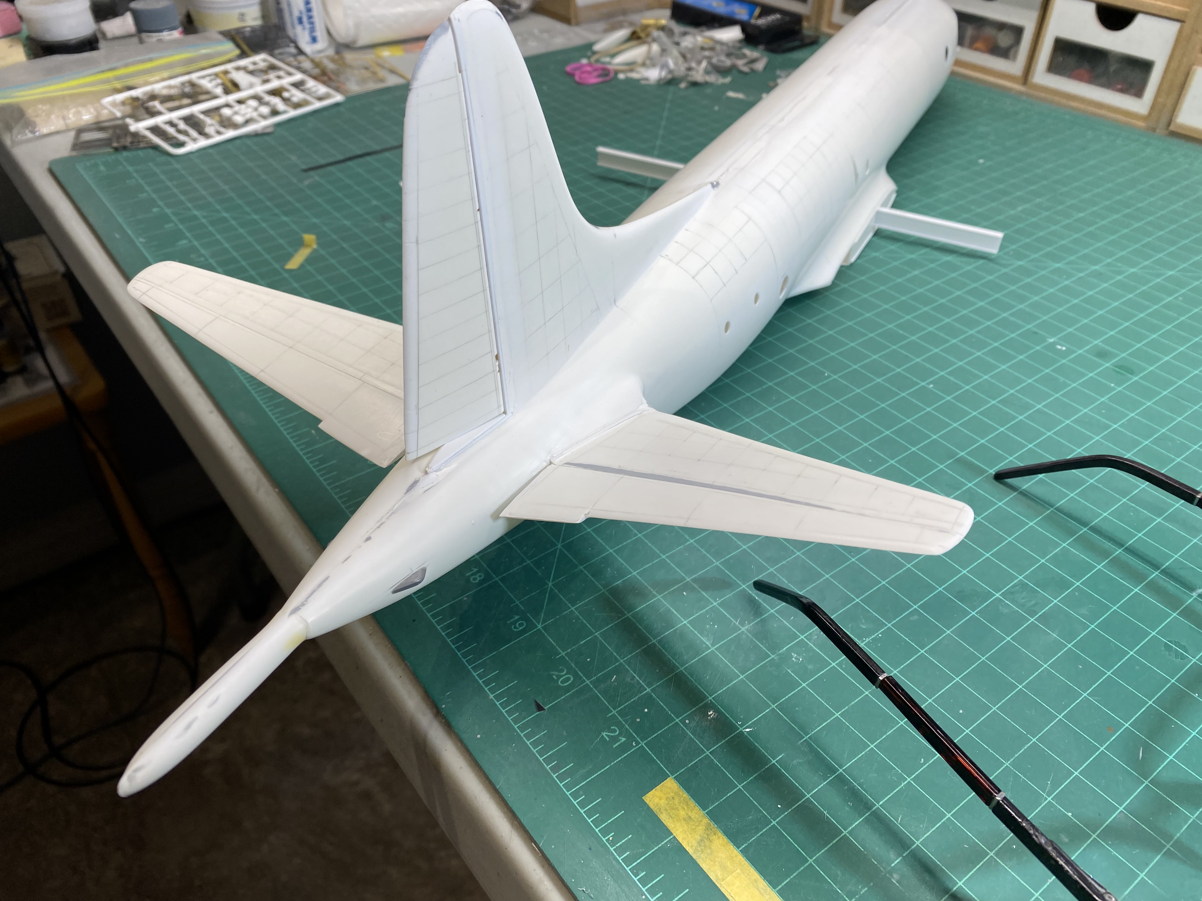

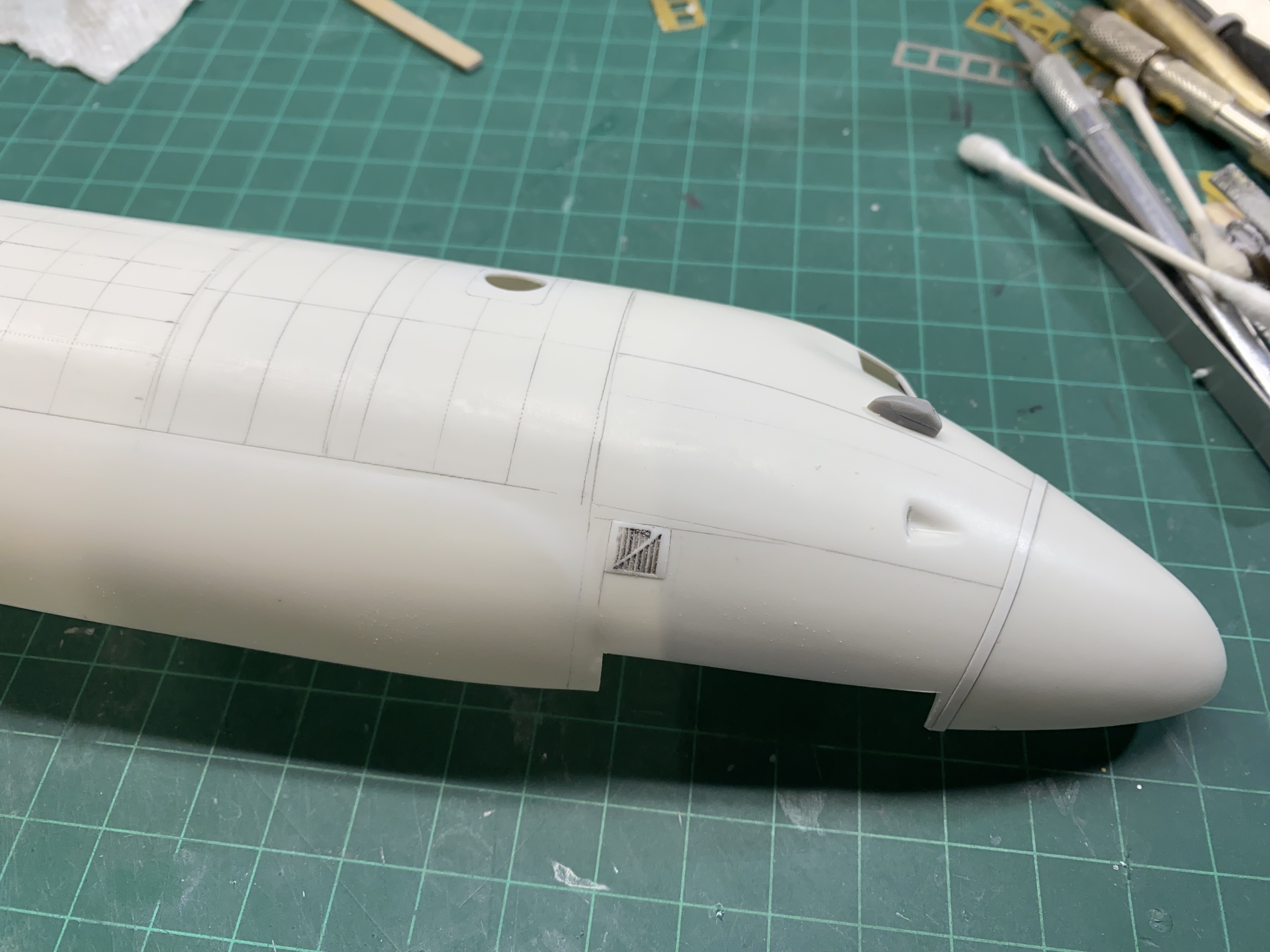

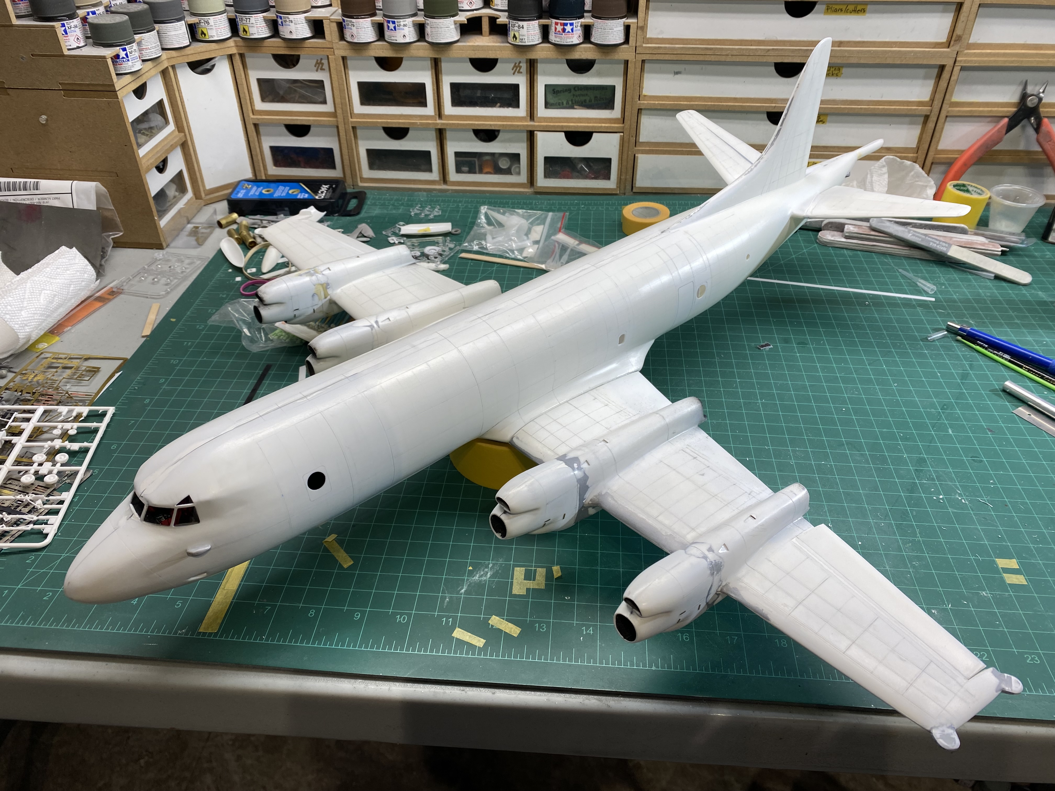

I do appreciate the "somewhat misplaced" confidence in my modelling. I have in fact managed to fair in the tail feathers. I have also at this time drilled the lower fuselage for the sonobuoy launch tubes, not sure yet weather I'll add tubes to them or just leave the holes and paint them black

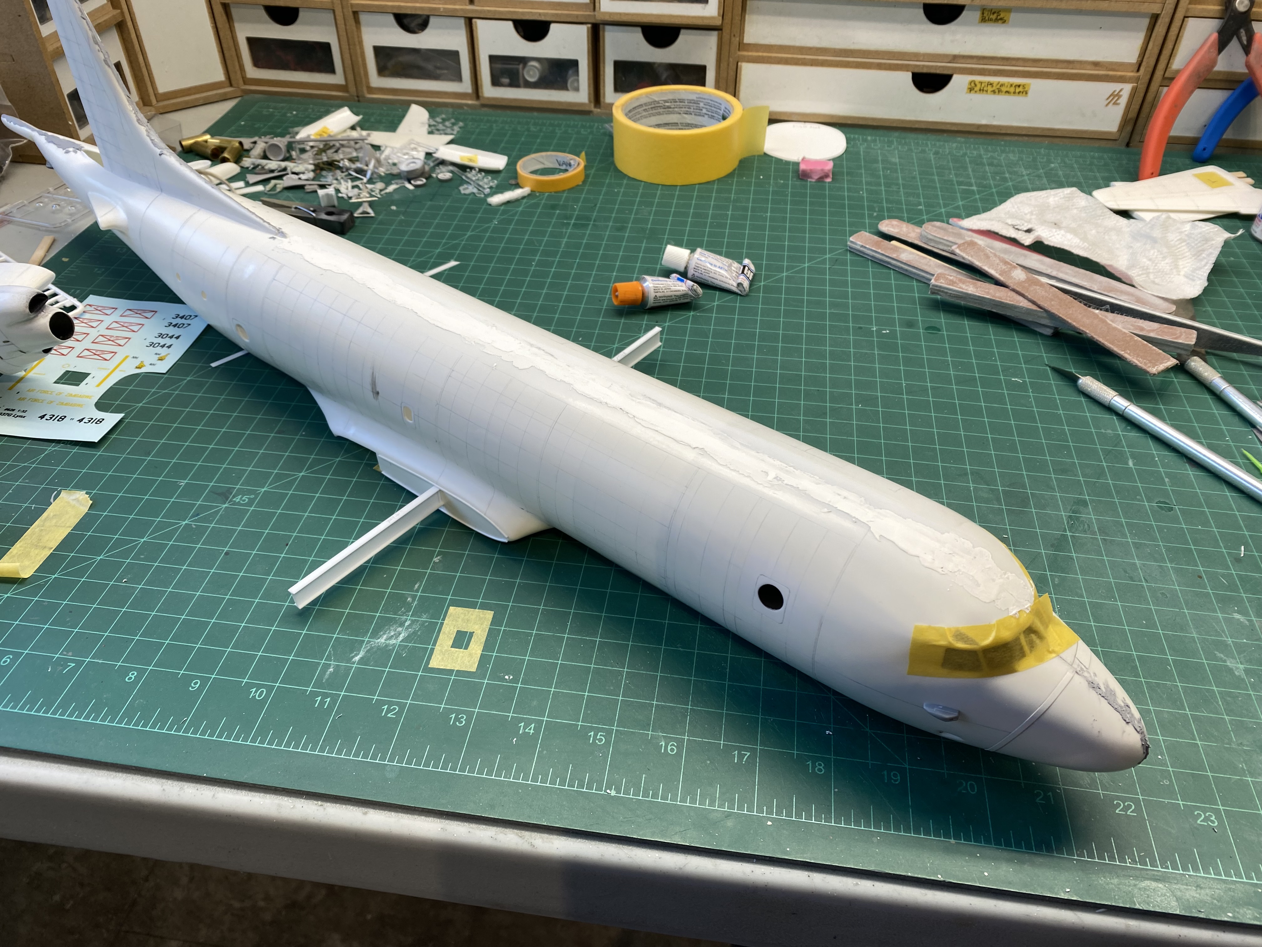

A couple of pics of the project as it stands at quitting time tonight;
Thats all for now
Thanks for looking

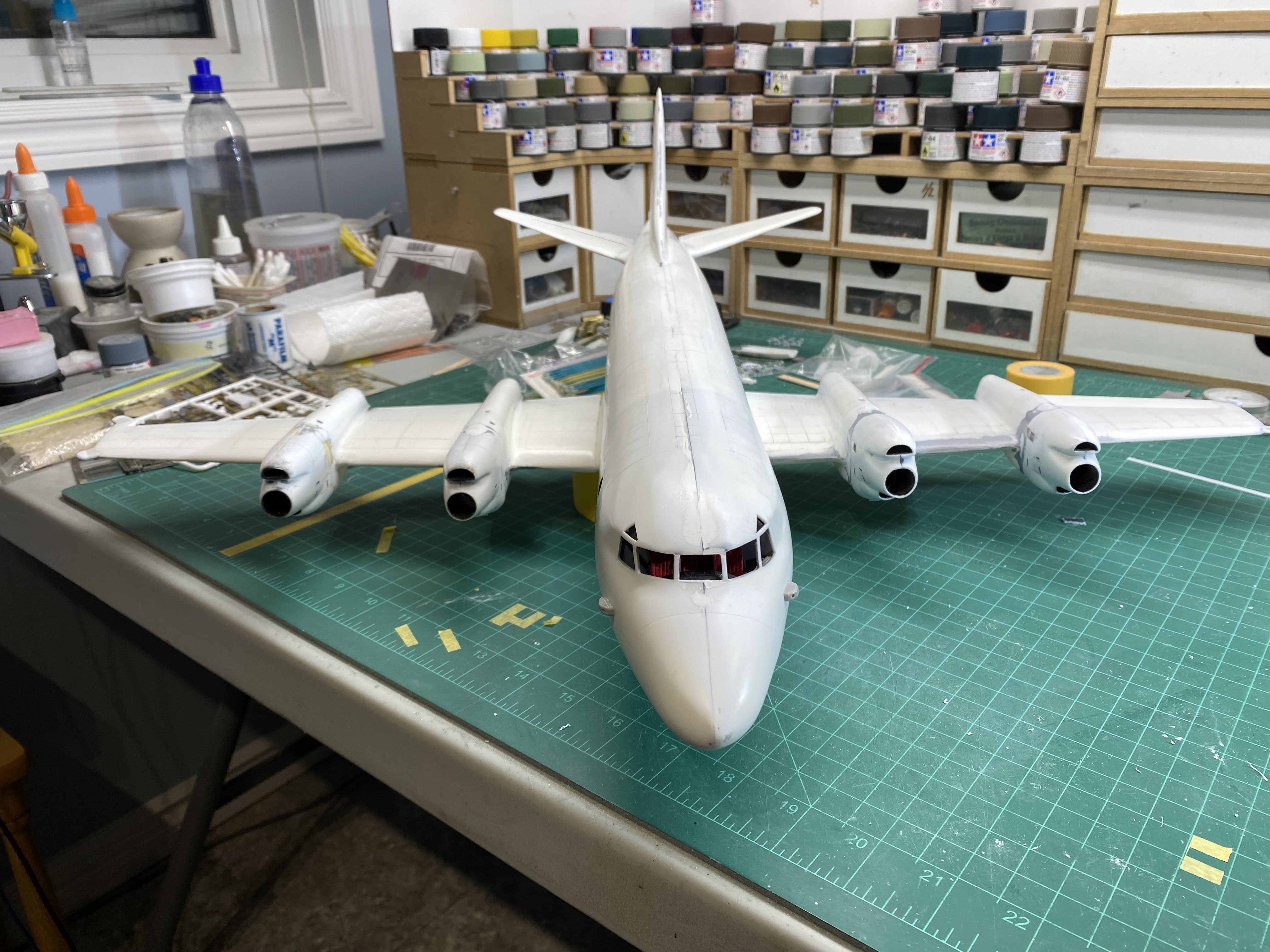

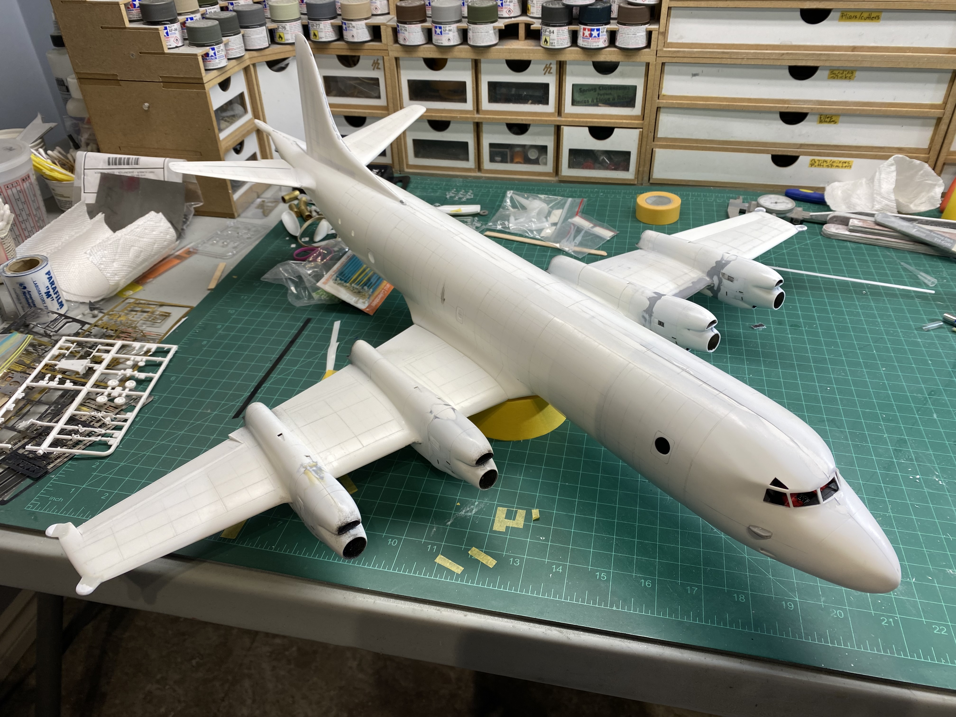

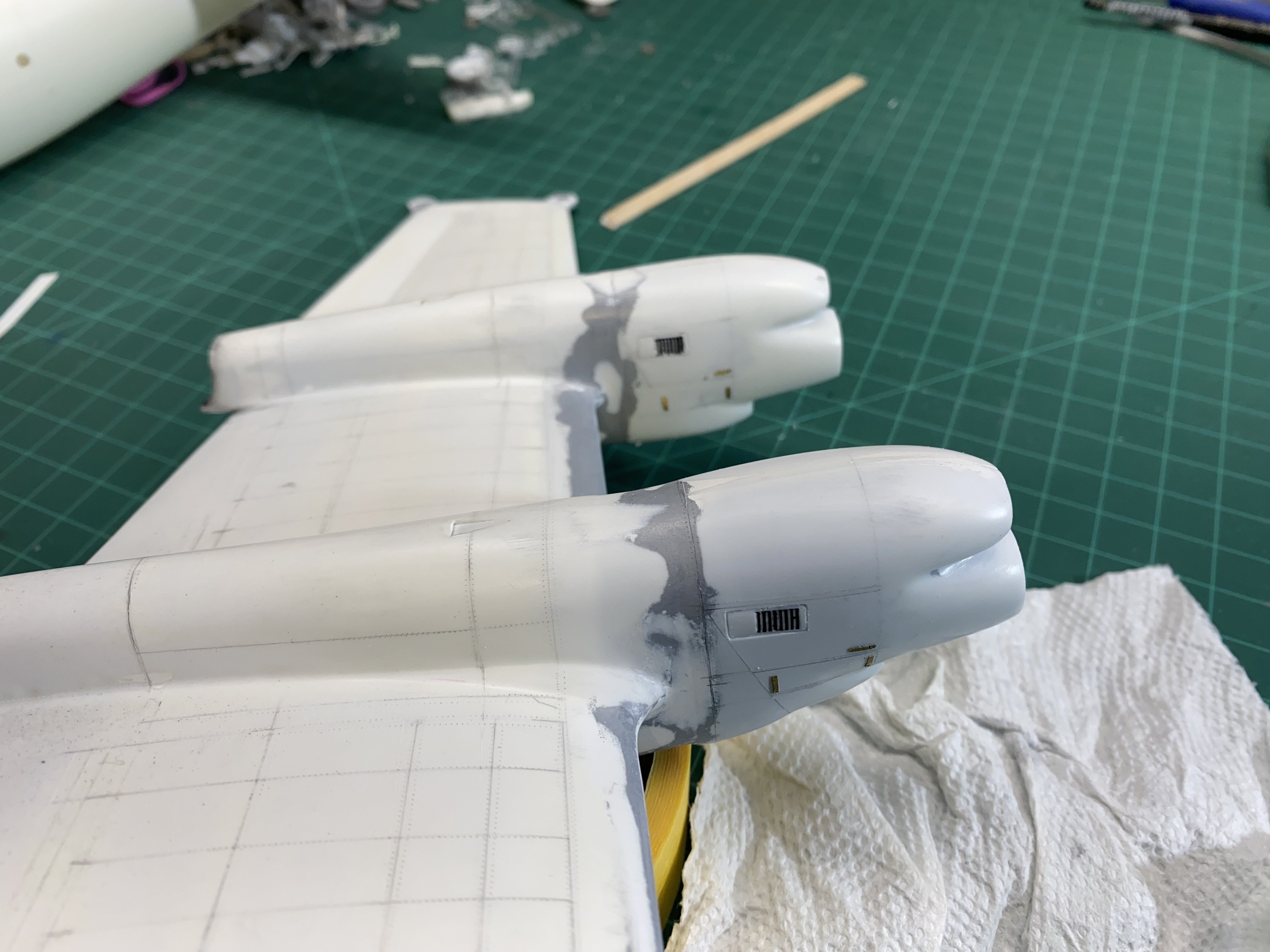

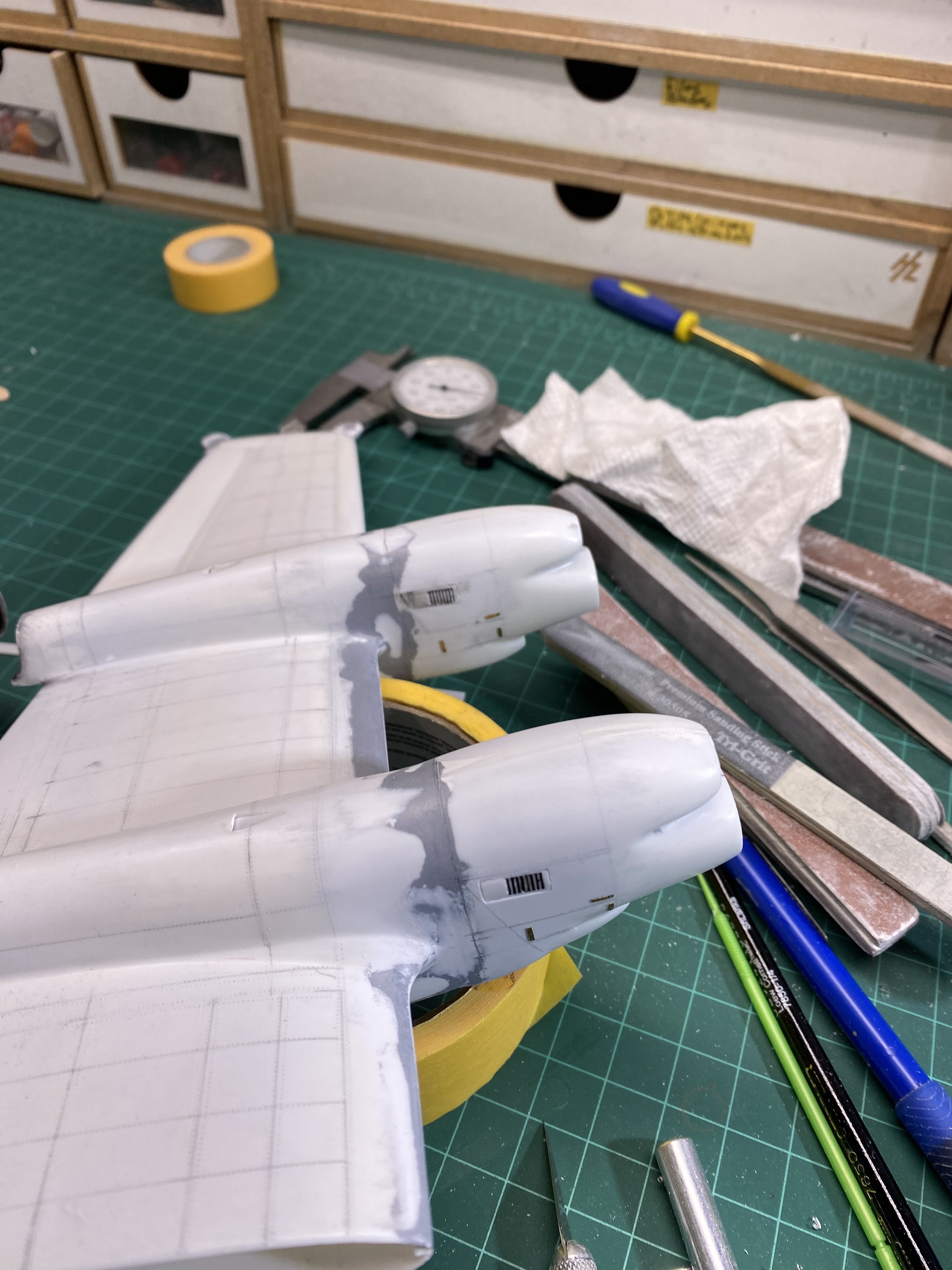

I made a decision to add some vents to the engines, not true to scale but approximately right(ish)
and now the happy (for me anyway) news...she's an assembly;
going to need some filler on the roots but for the most part it's a good fit
Thanks for looking
