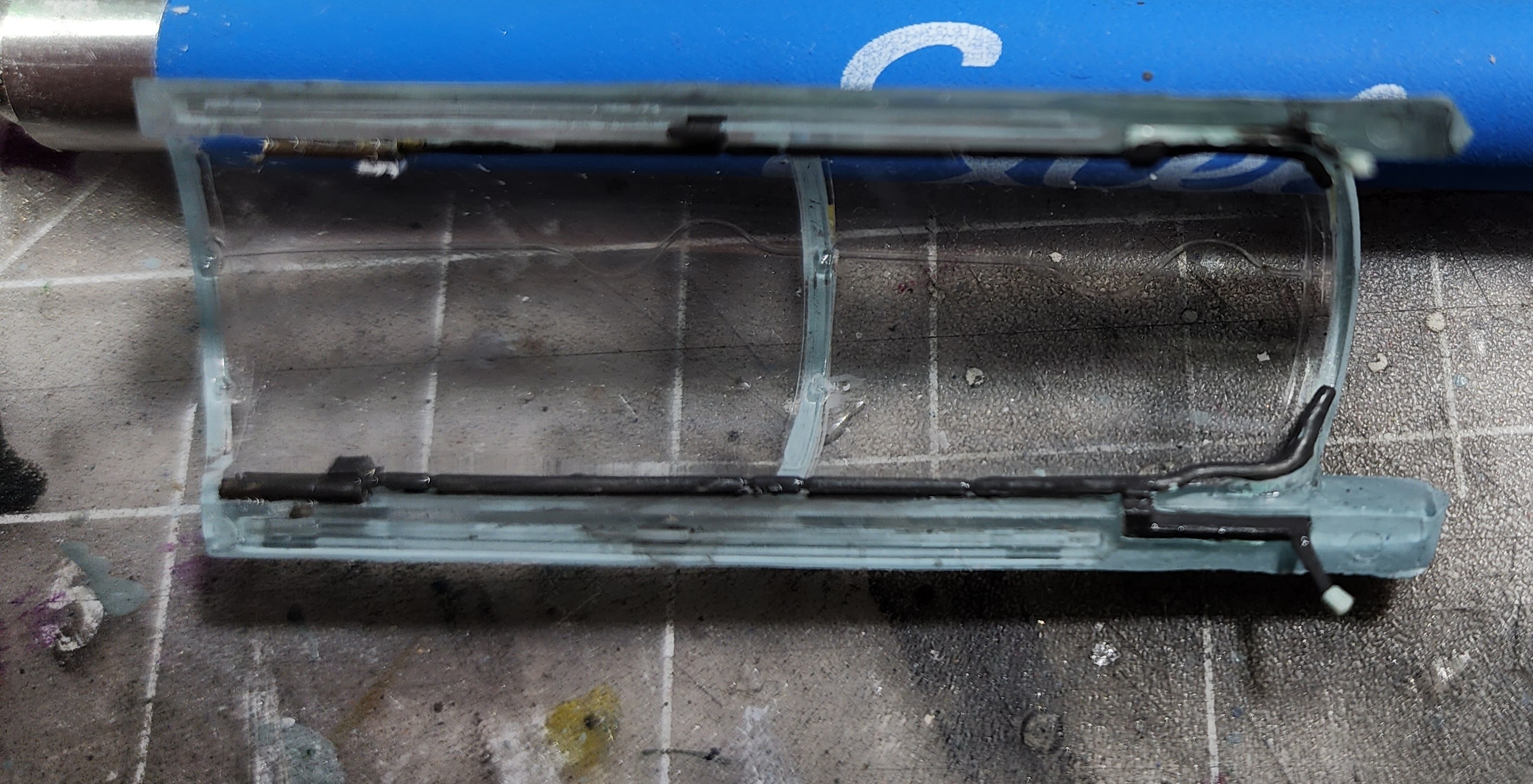

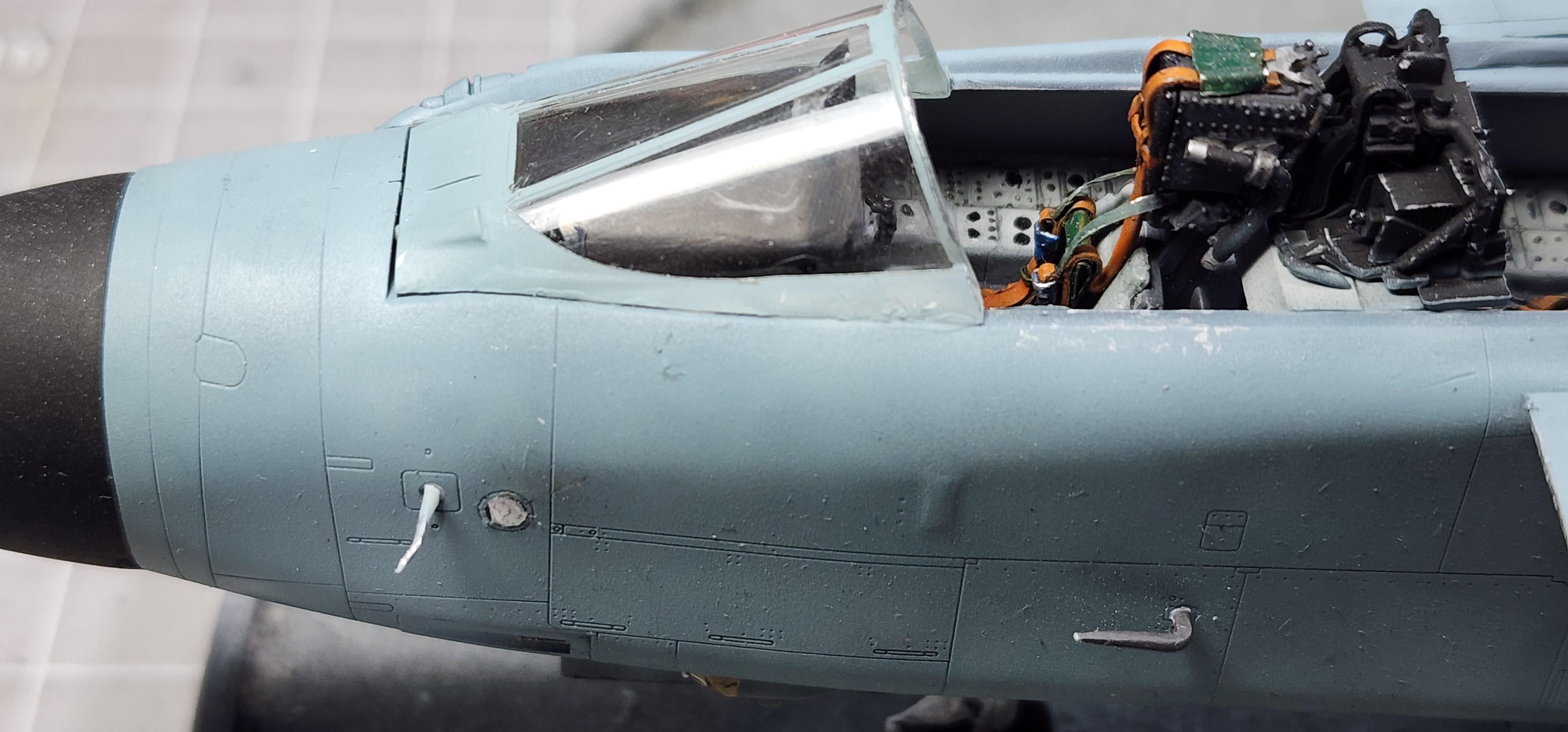

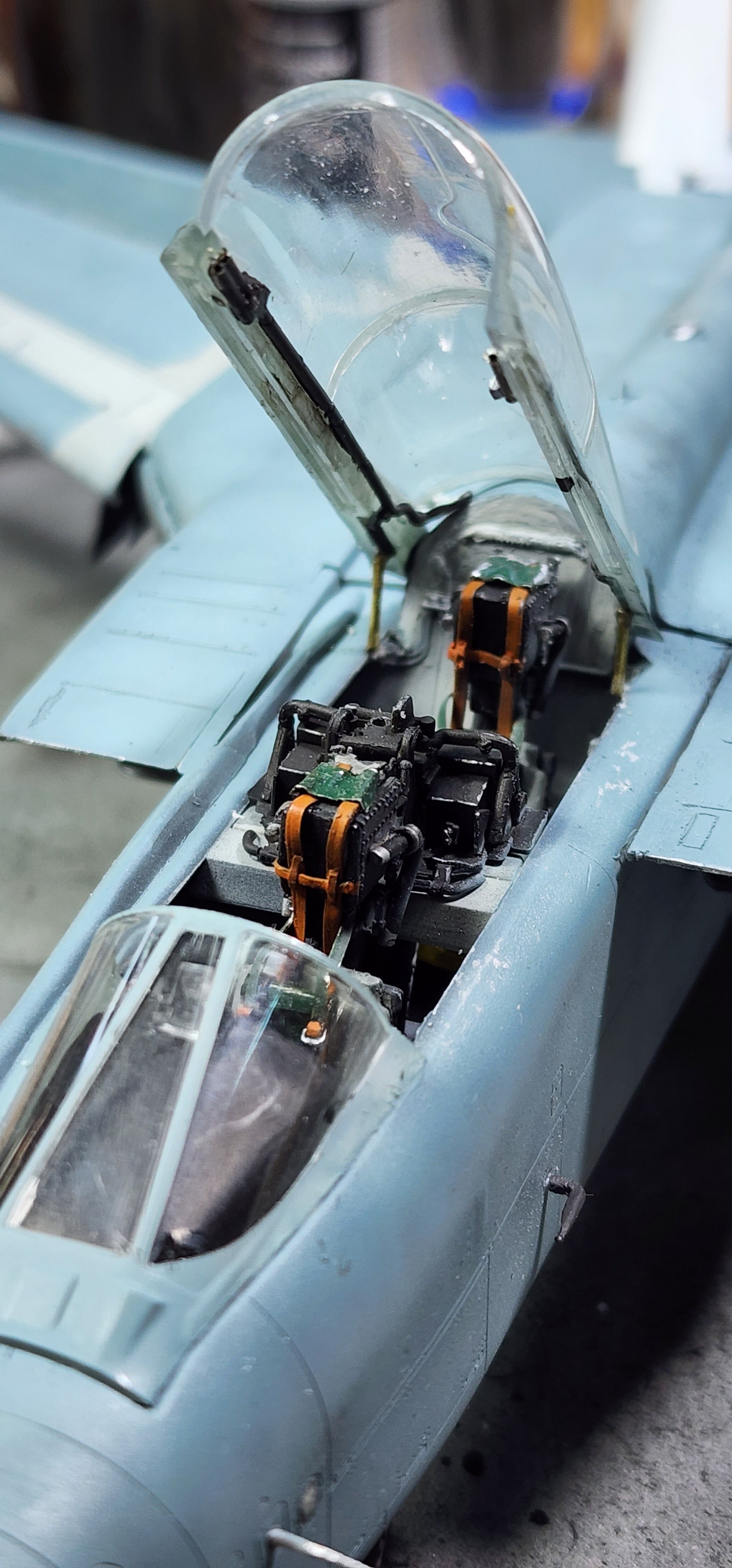

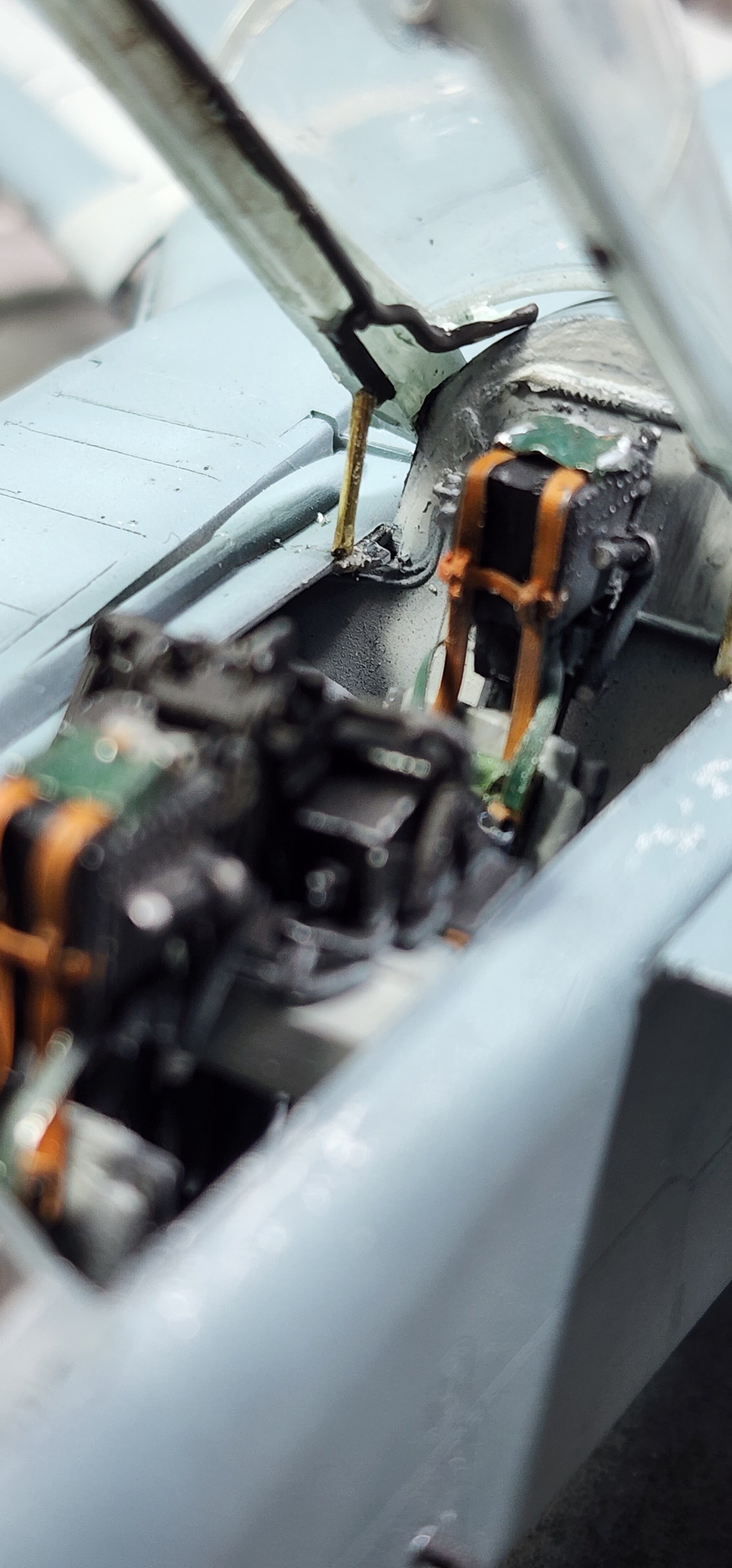

I usually use .5mm bore tube on cars and i keep some .5mm piano wire, both available in my model shop and then if i wanted to fit a part like your lift rod i just cut the rod to length then cut a bit of piano wire 2-3 mm longer to go inside the tube. then you can pre drill .5mm holes on the canopy and cockpit and it just takes the strain off the glue as all you need is a smallest amount on the piano wire protruding and not on the brass. it also makes it a lot stronger
