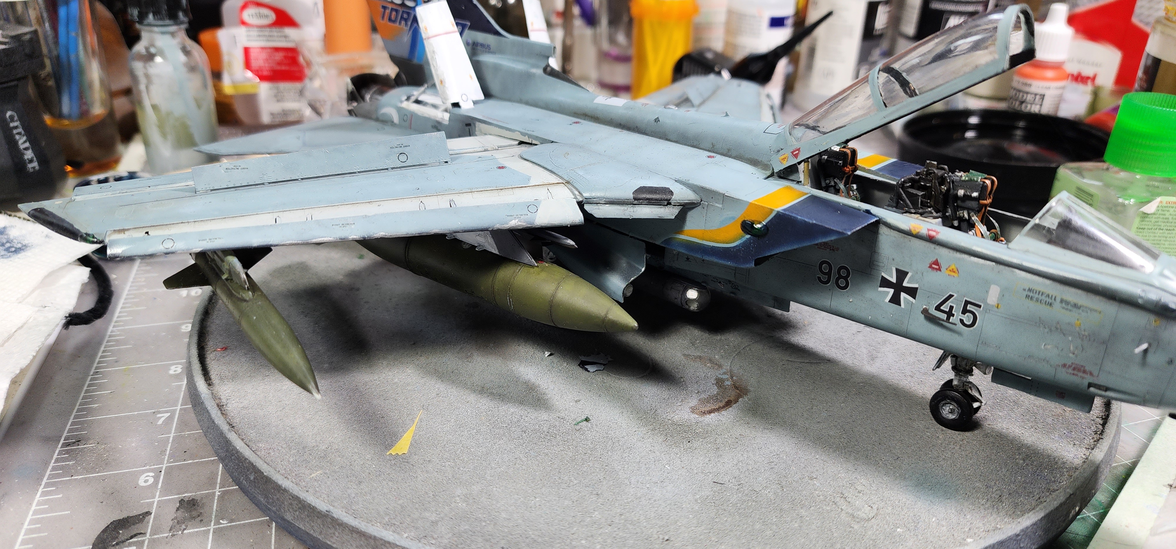

Tornado ASSTA 3.1, Revell 1:48

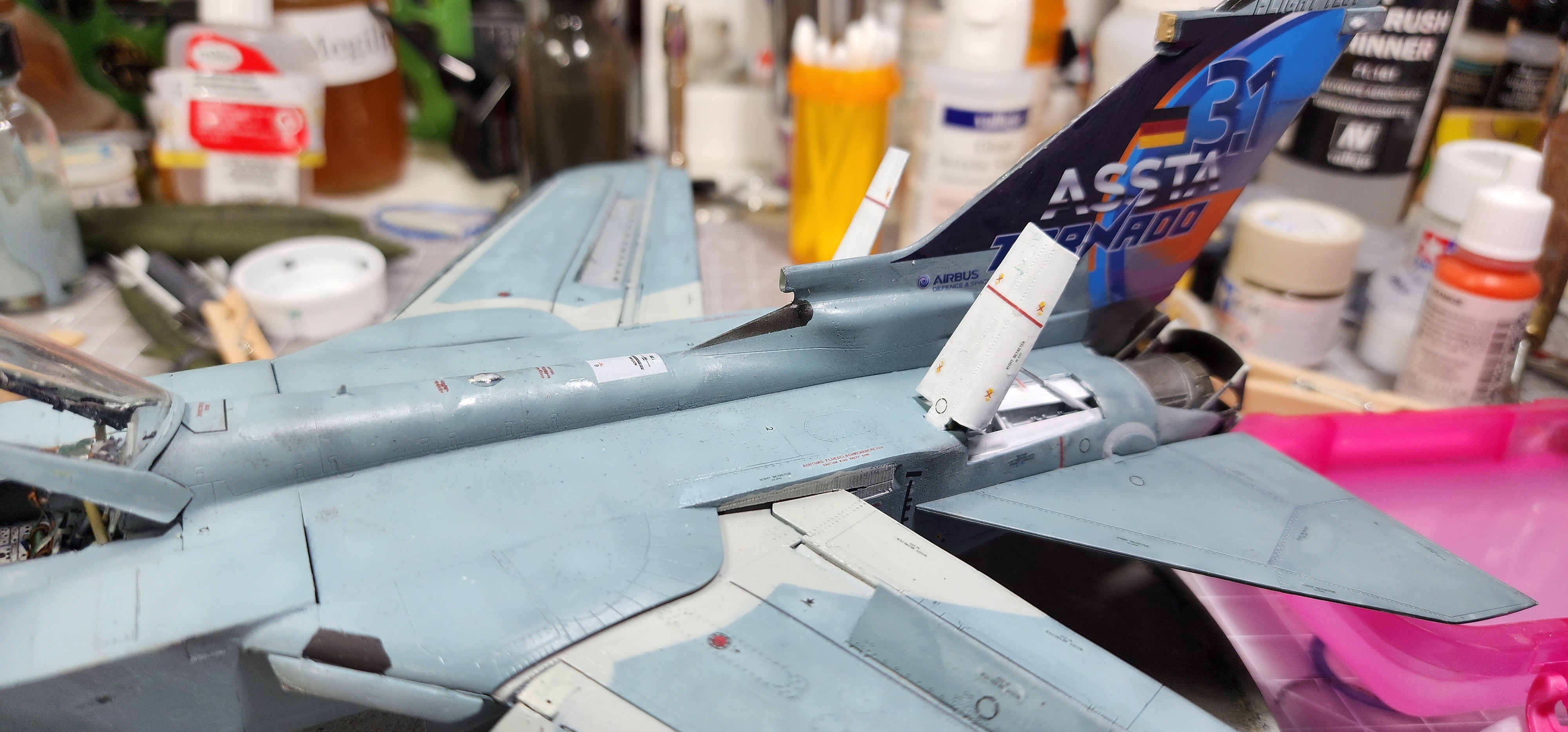

Y'all, this tail art is what led me choose this version over the other. So cool!

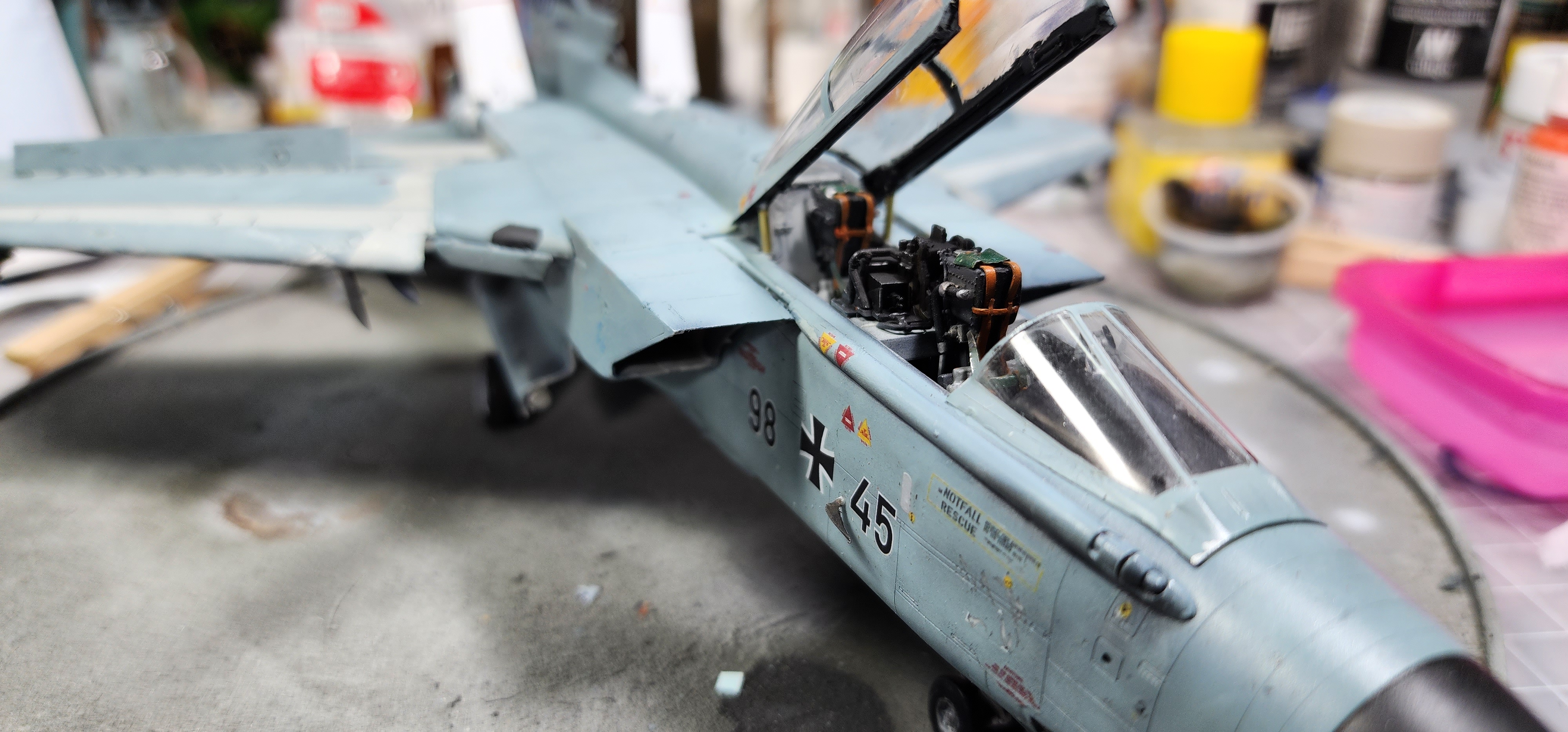

Another thing to thnk about is painting the edges of the canopy, I've even did a double mask on one that was open to get the inside frames painted. Got it all masked out then painted it black, then then interior color on the inside and exterior on the outside...gives a lot of depth.

Bob, inside the canopy the edges are black. Easy peasy I think. I am pretty sure I can freehad that.🙃

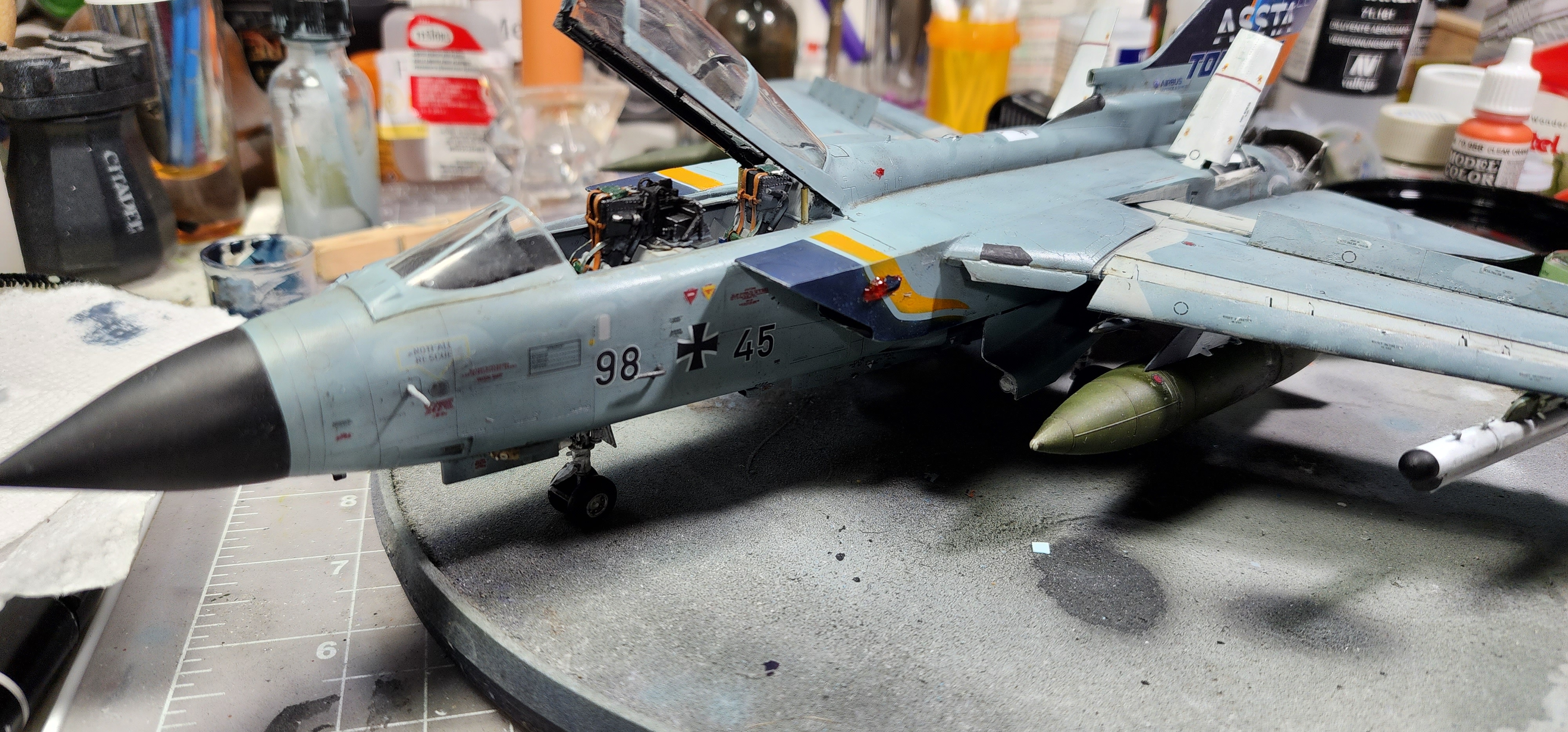

Decals are the bane of my existance! %@%$&! I messed up two of them so badly because they went over two lights which protruded from the side. It did not occur to me to take the lights off and put them back after decaling. I removed the decals (and lights) and taped off the area then spraypainted after working to match the colors. That was fine intil I got to the circle logo. It looked like a child painted it. So I took all of that off again and will look for a solution to make the circle logo. It may be a good time to try out my circle cutter. I also need two more German crosses since the plane takes 4 and the sticker sheet has two. (insert face palm here). I need to get with an expert and learn to do decals!
I didn't have any piano wire at the house where I build my models; it is at the store. Instead, I used styrene rod instead. I drilled out small holes for the rod and it works GREAT! Thanks @paddy for that great tip.

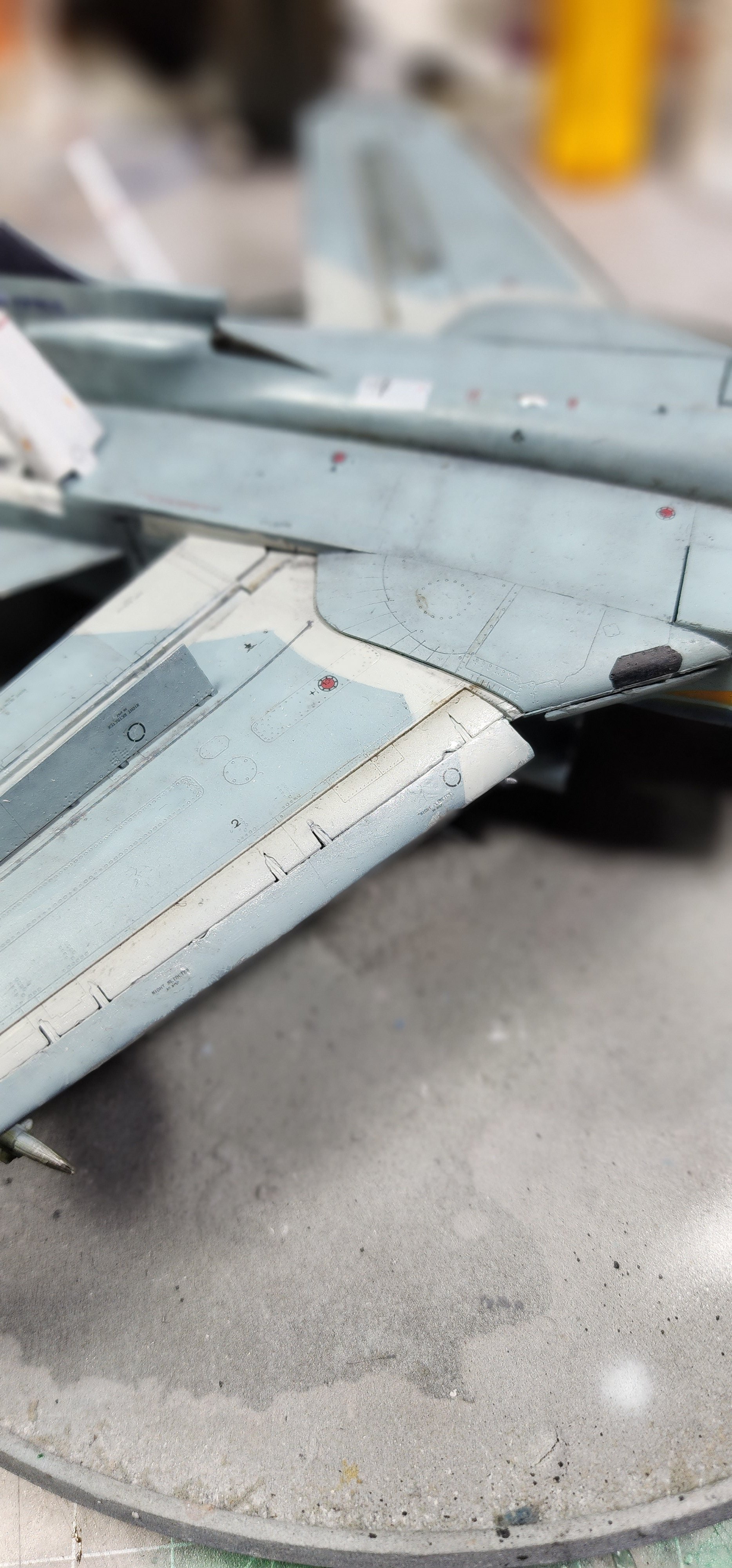

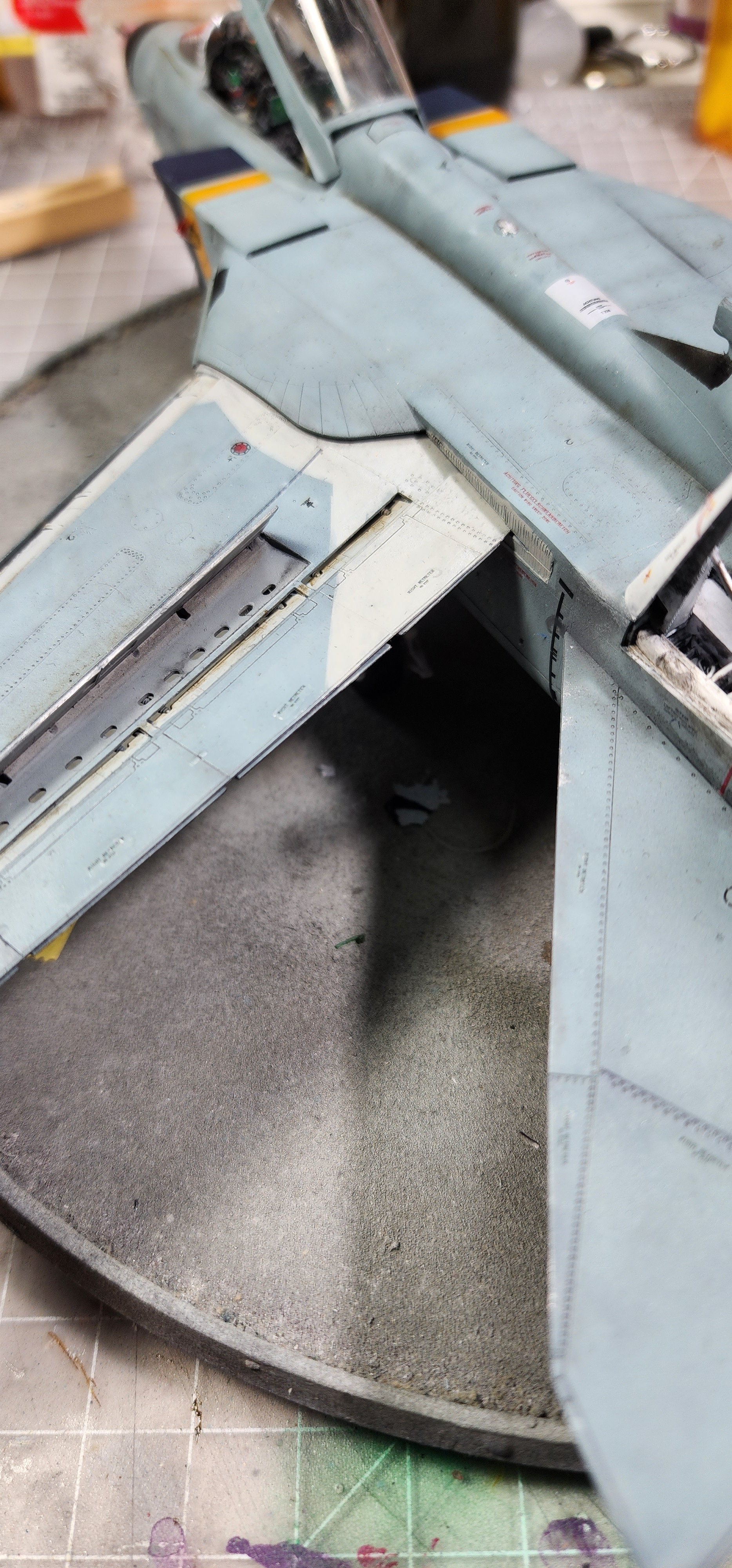

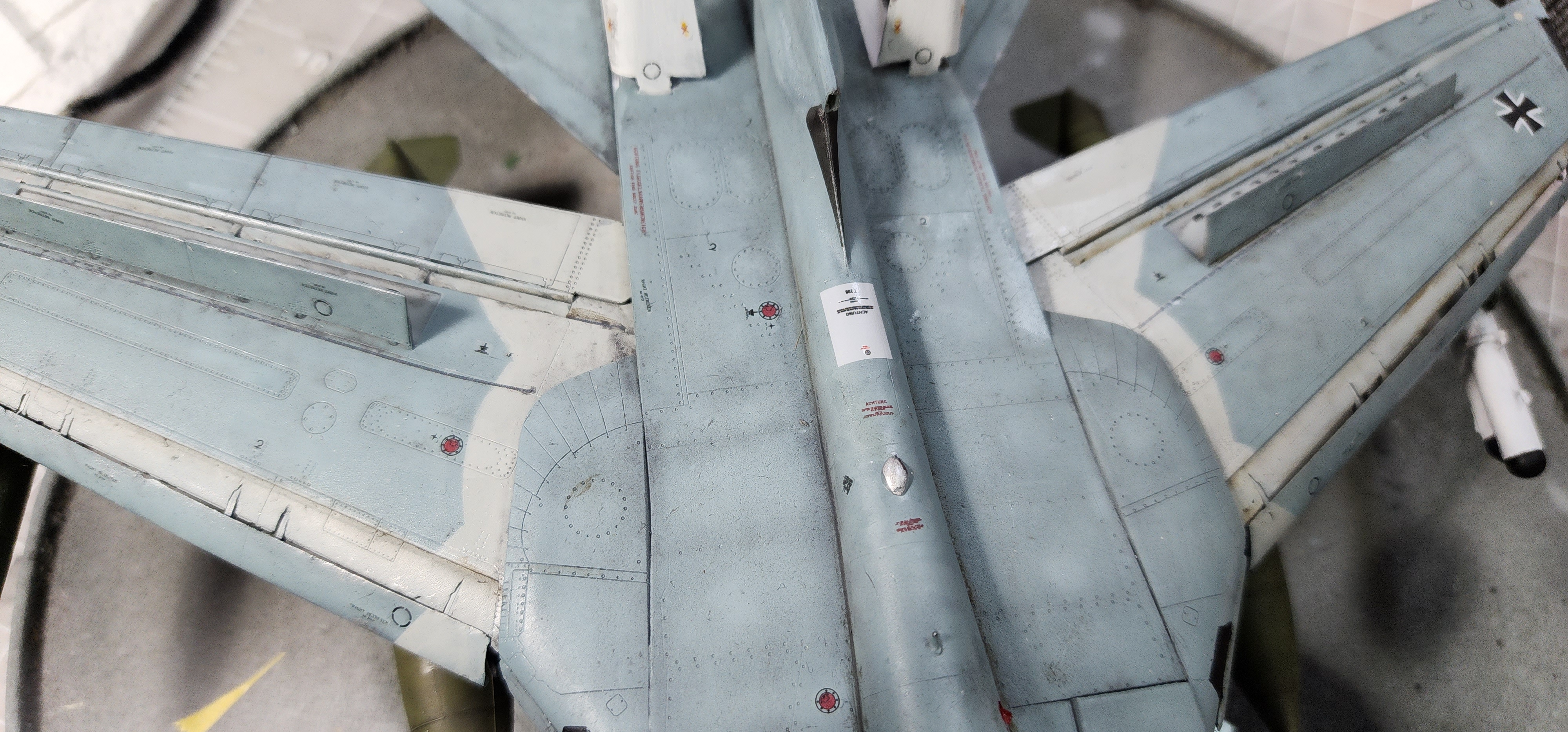

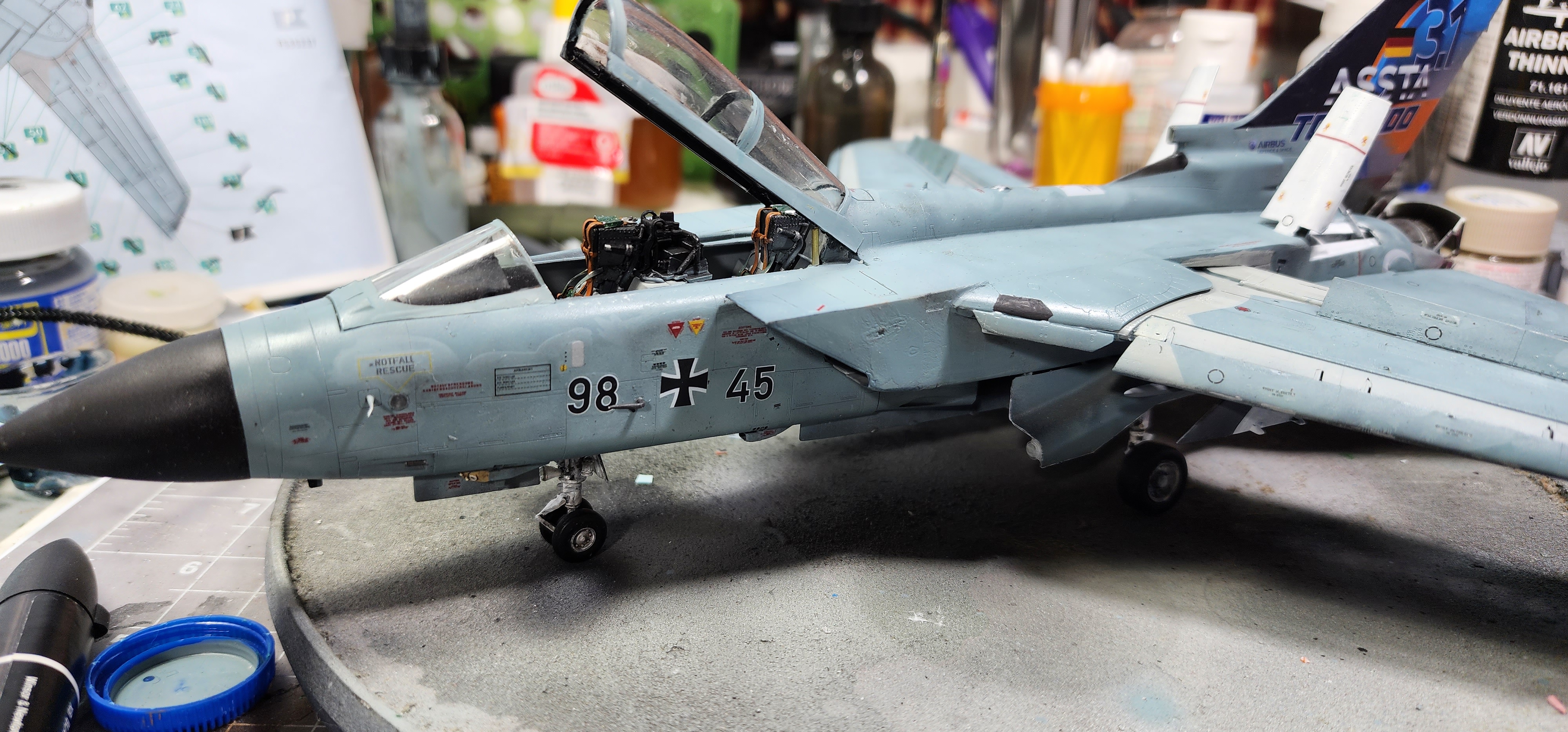

It is finished except for the matte varnish but it needs to dry for a couple of days. I kept the contrast to a minimum and I like the way it looks. First I coated a small area with mineral spirits, then with a fine brush I painted thinned down oil paint blend of blue-gray and black into the lines. I let that dry for a minute then used a sable hair flat brush barely dampened with spirits and raked away the excess in the direction of airflow. I then went into the angles and crevasses with raw umber on a mostly dry, very small flat brush and scrubbed it into the corners.
