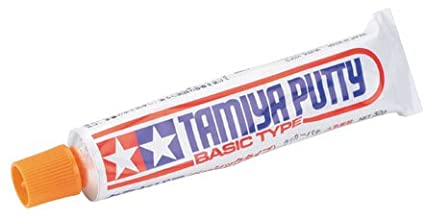

Mr Surfacer is a good choice, but it's a lacquer and has a strong smell. I like Tamiya Basic Putty pretty well.

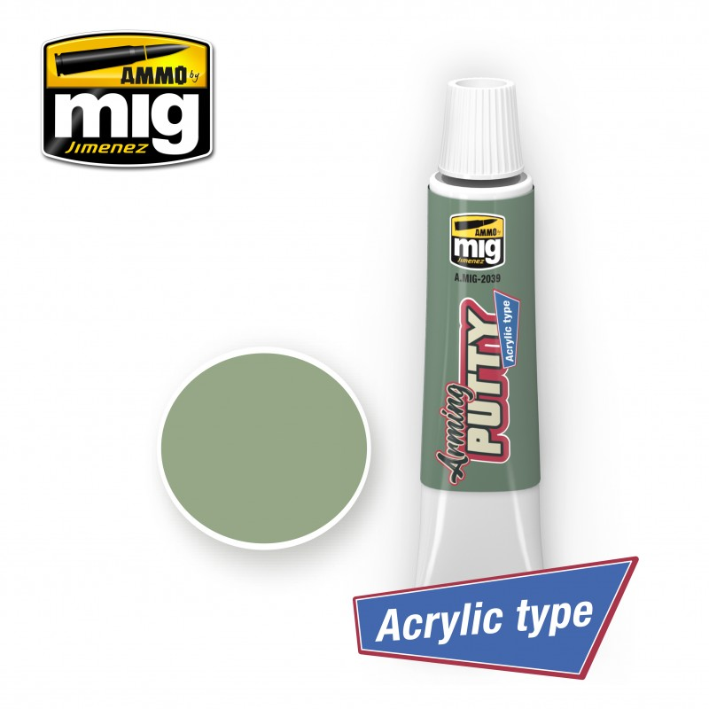

This is some good stuff, acrylic made by AMMO. I like it very much.

I use Tamiya Putty as well for the small to medium sized seams. This can also be smoothed out with a wet Q-tip or fingertip before it dries. Afterward, it sands smooth and feathers as well as Mr. Surfacer.

I've used the hot stuff for years, didn't know about the acrylic flavors. Guess I'll be looking for it at the show tomorrow.
I'm usually using the Tamiya Basic (grey), unless I want to fill a gap, but leave a "panel" line, in which case I'll use Mr. Surfacer 1000. This is assuming the gap is small enough that I'm not using some styrene strips to fill, in which case they almost always have a bit of Tamiya over the top.
