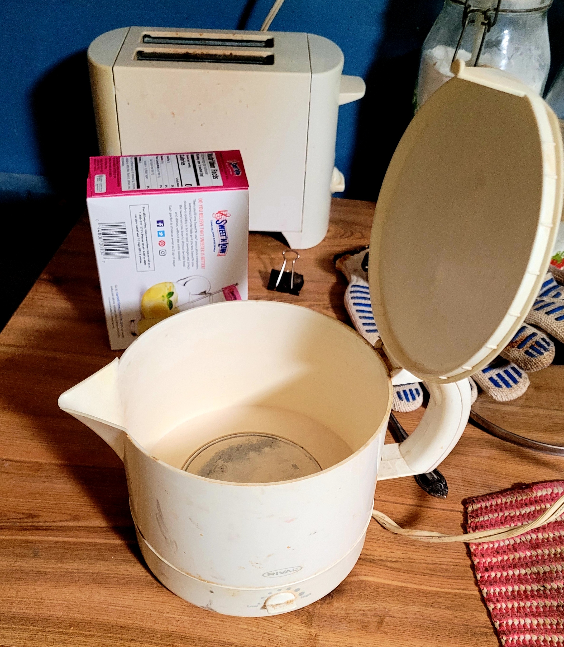

If you must warm up lots of water for large decals, this is Rival's 1-quart Hot Pot. Not only will it hold variable temperatures from tepid to boiling hot, but when snack time comes you can make macaroni & cheese or rice in it. Before my Sweetie moved in, (and brought a modicum of civilization to my BOQ) I used it to raise winter humidity levels. I've even used it to steam an ancient fur-felt hat I brought back from Australia 2/3rds of a lifetime ago. I advise against making Mac & Cheese and soaking your decals at the same time.
