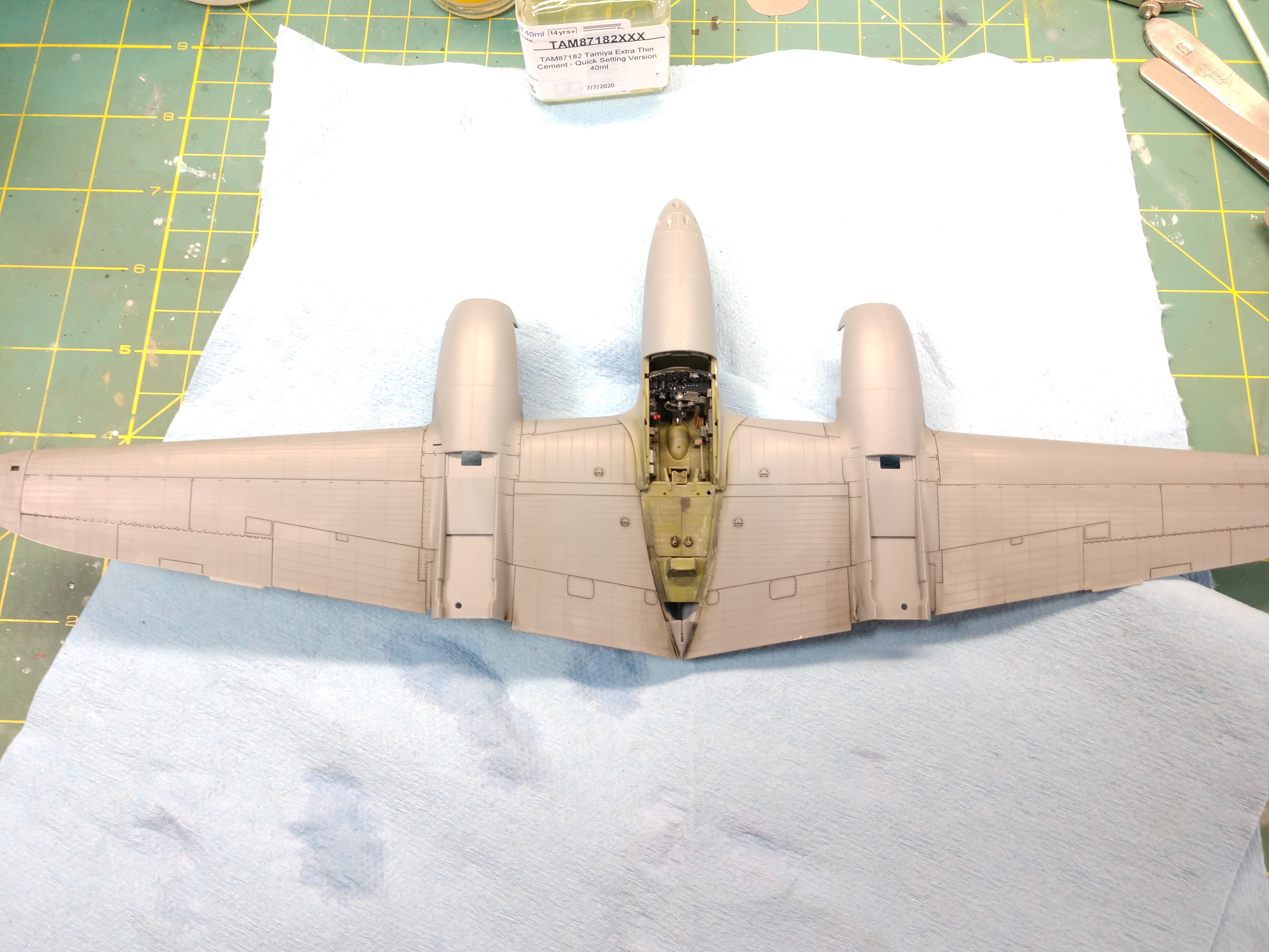

Wait, I missed something. Where did the film with rivets come from?
I did something similar with a 109 a couple of years ago. Can't remember who made it.

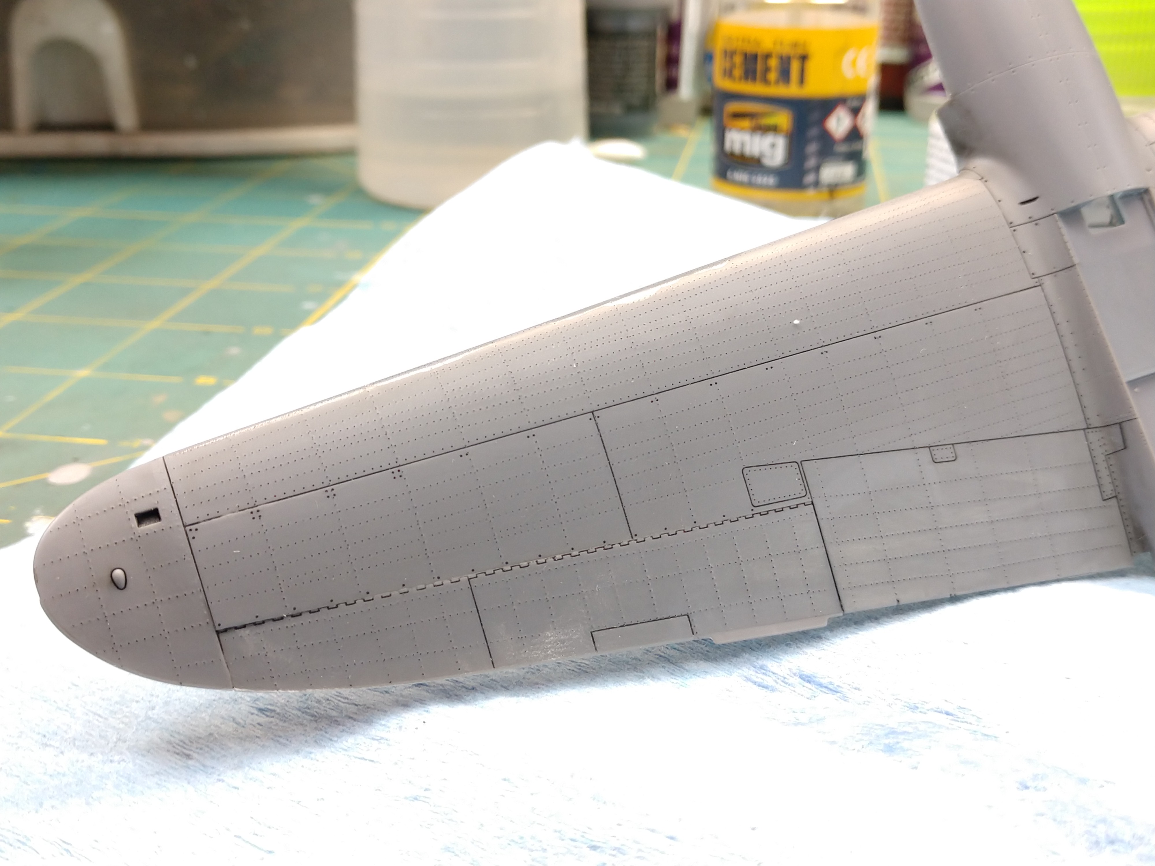

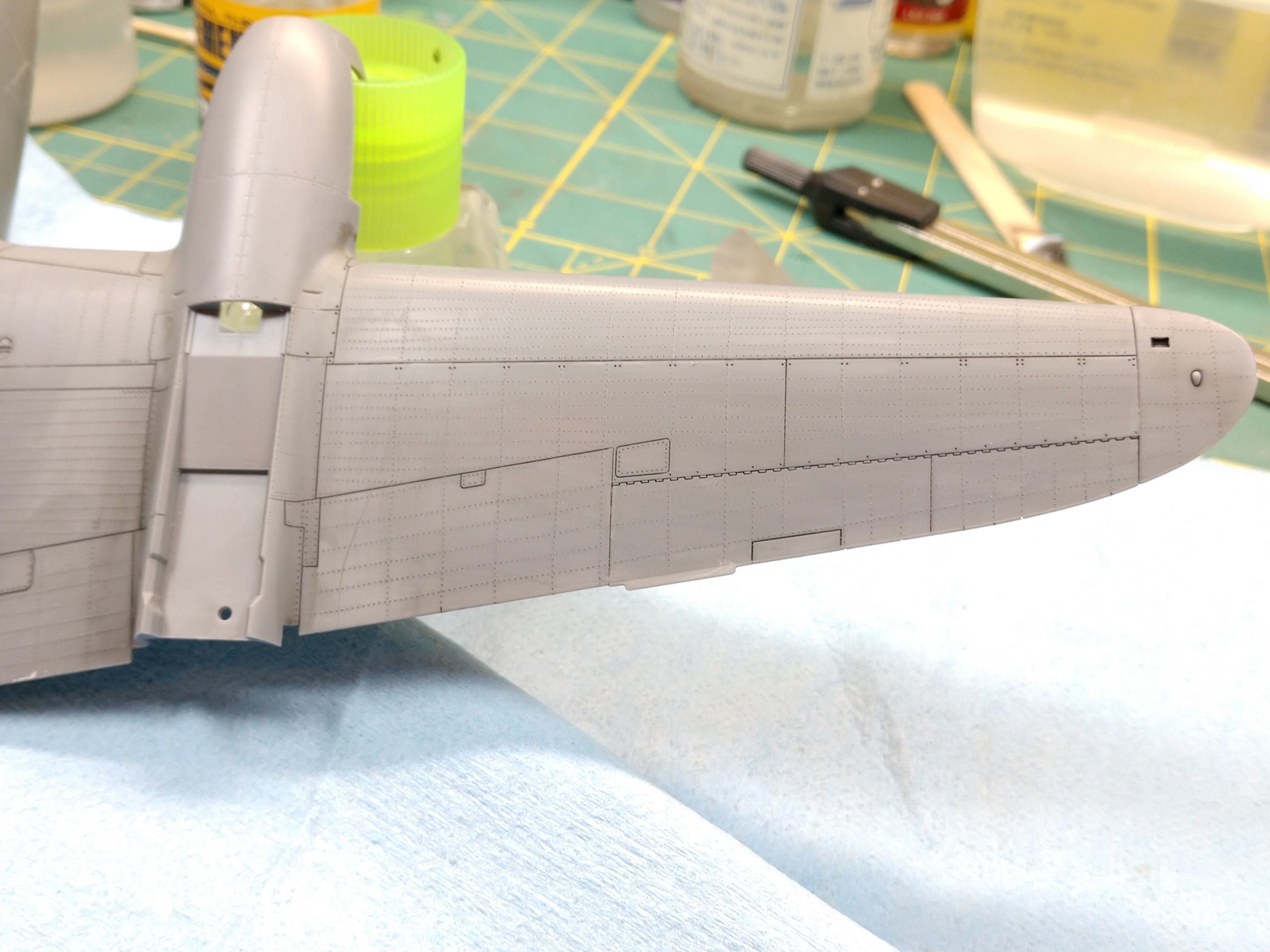

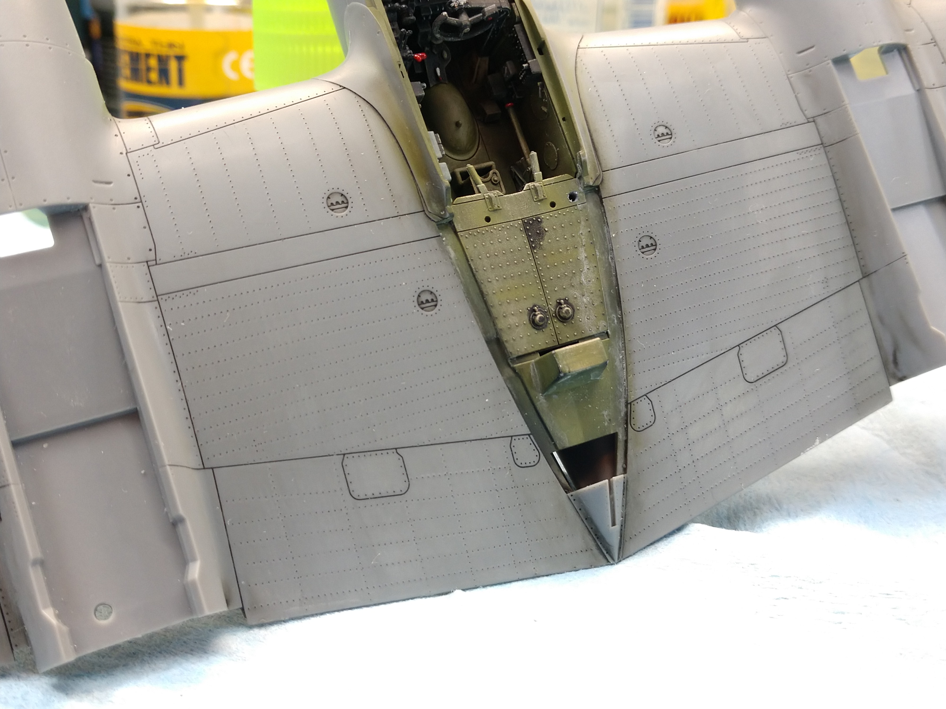

Since Paul's plans were already scaled to size, I imported them into Photoshop so I could work with section individually.
After that, I would open the sections in the Cameo software and trace all the rivet lines.
I then cut the design onto vinyl I use to make my mask. Transfer to the proper section and trace the cut lines for the rivet pattern.
Here is a quick video showing what I am doing. Basically every red line will be cut by the cutter and that will be my rivet line.

Ah, this is it.
HGW Models. It was an interesting build, not sure I ever actually finished it. But if you can do it yourself why buy?
Lol, got the main wing done and Bob, next time I'm buying. This is a lot of work and I doubt I will do it again
Just because you buy them don't make it easier.
Found the build I used these on. Also has the PE canopy for the Bf109 that I always wanted to do.

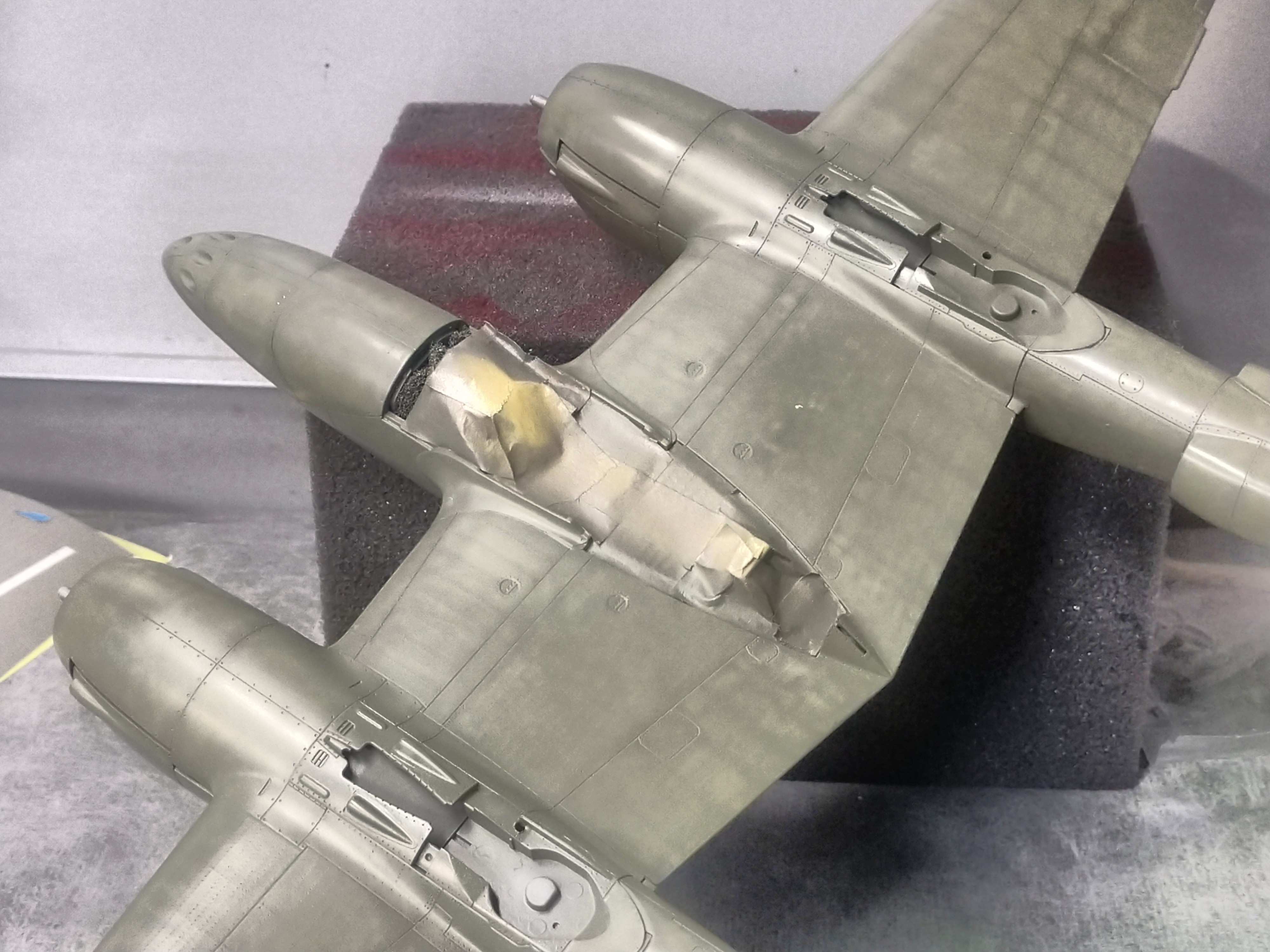

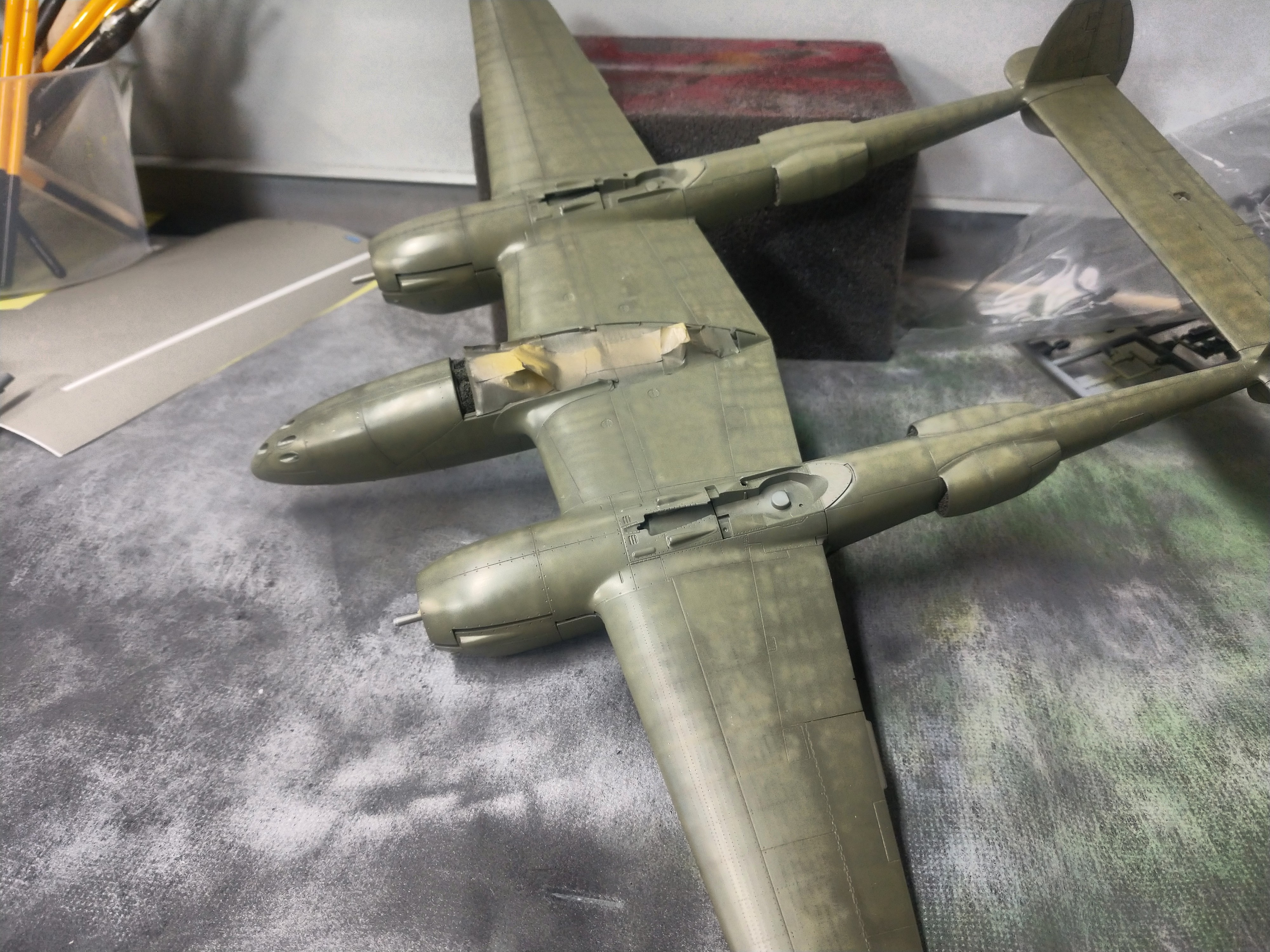

I lost the rivets in some places mostly because my heavy handed painting.

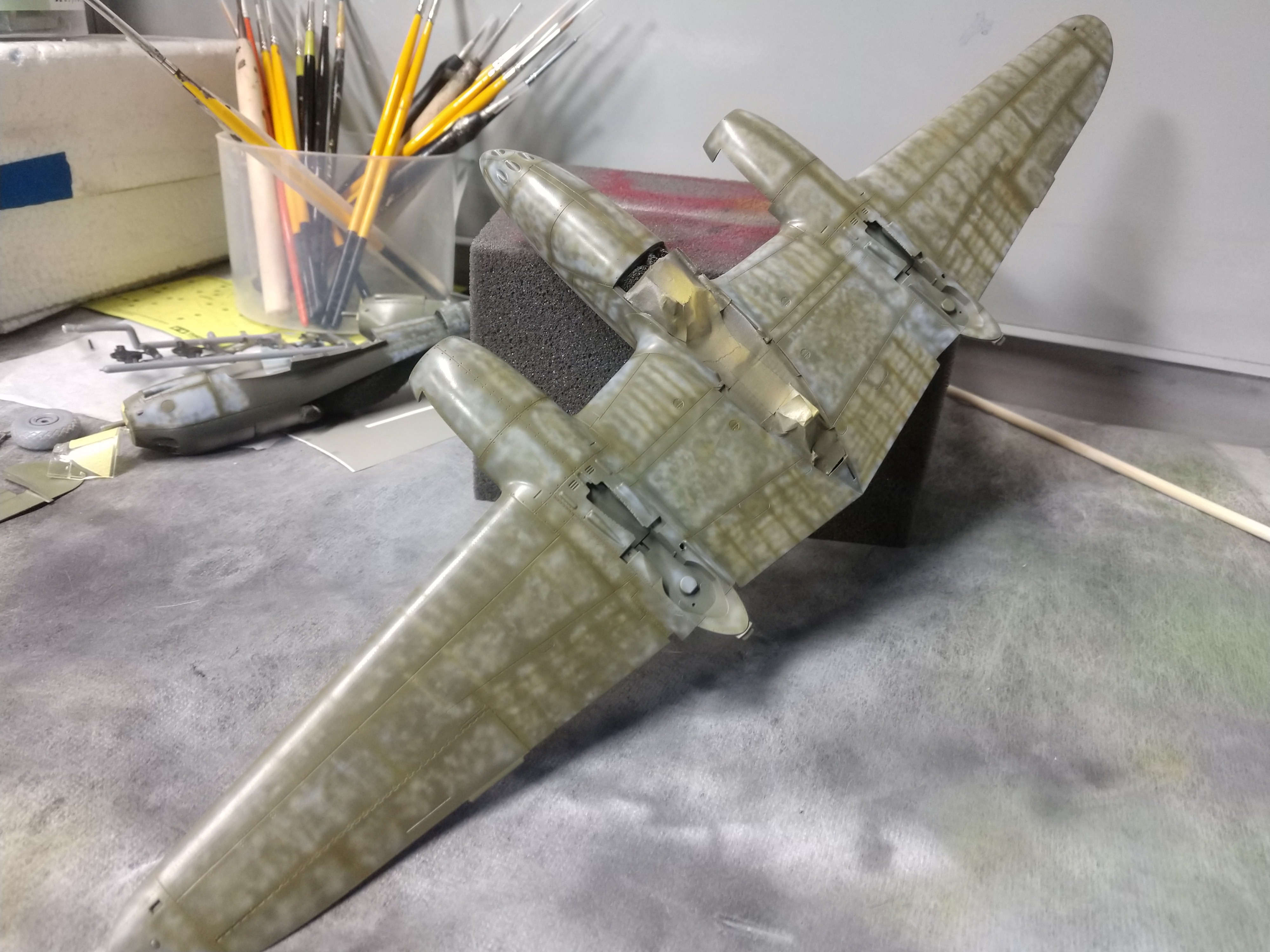

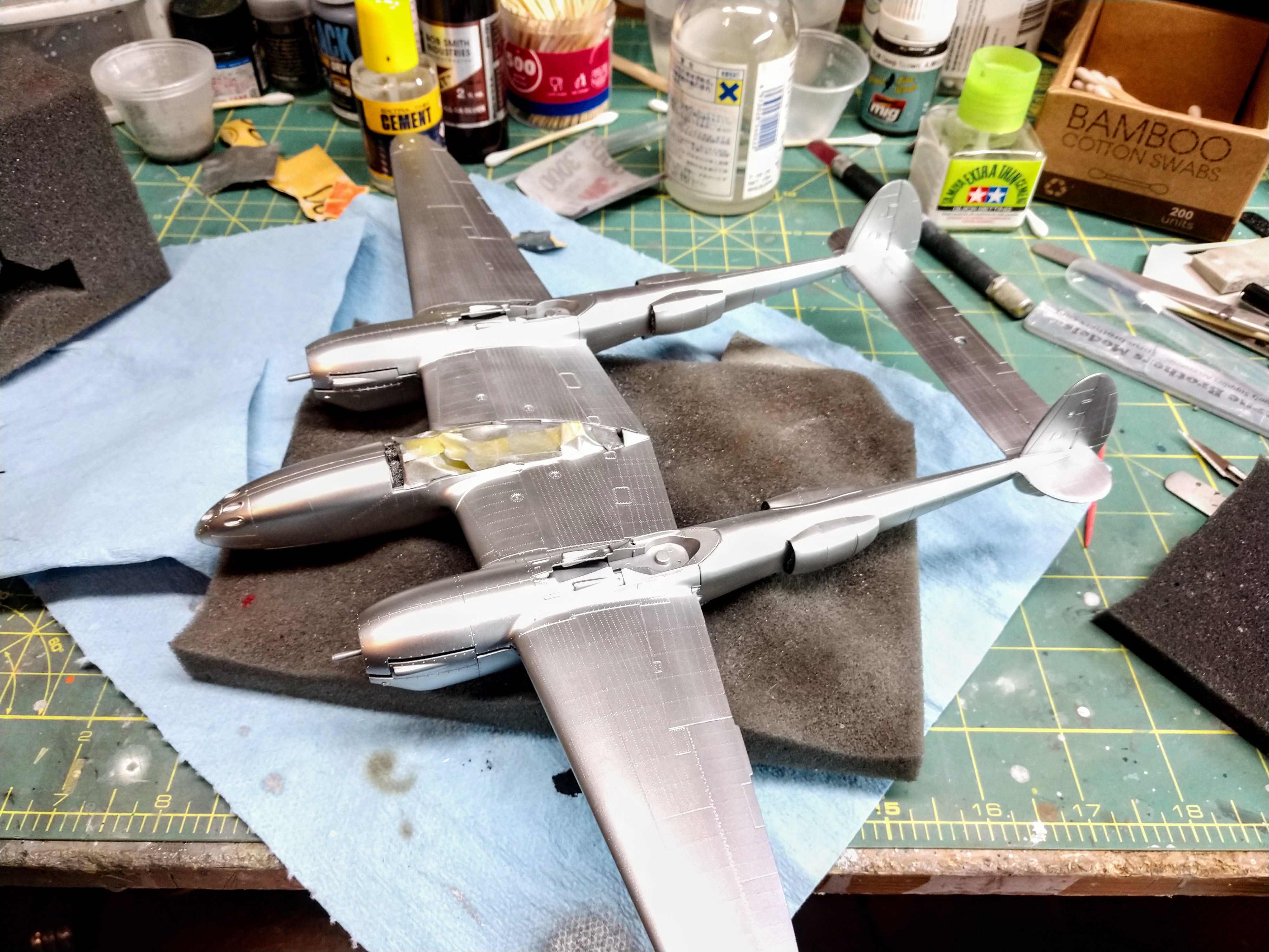

I've done all the riveting that i am going to do and have the base NMF on. Plan on doing a little chipping here and there.

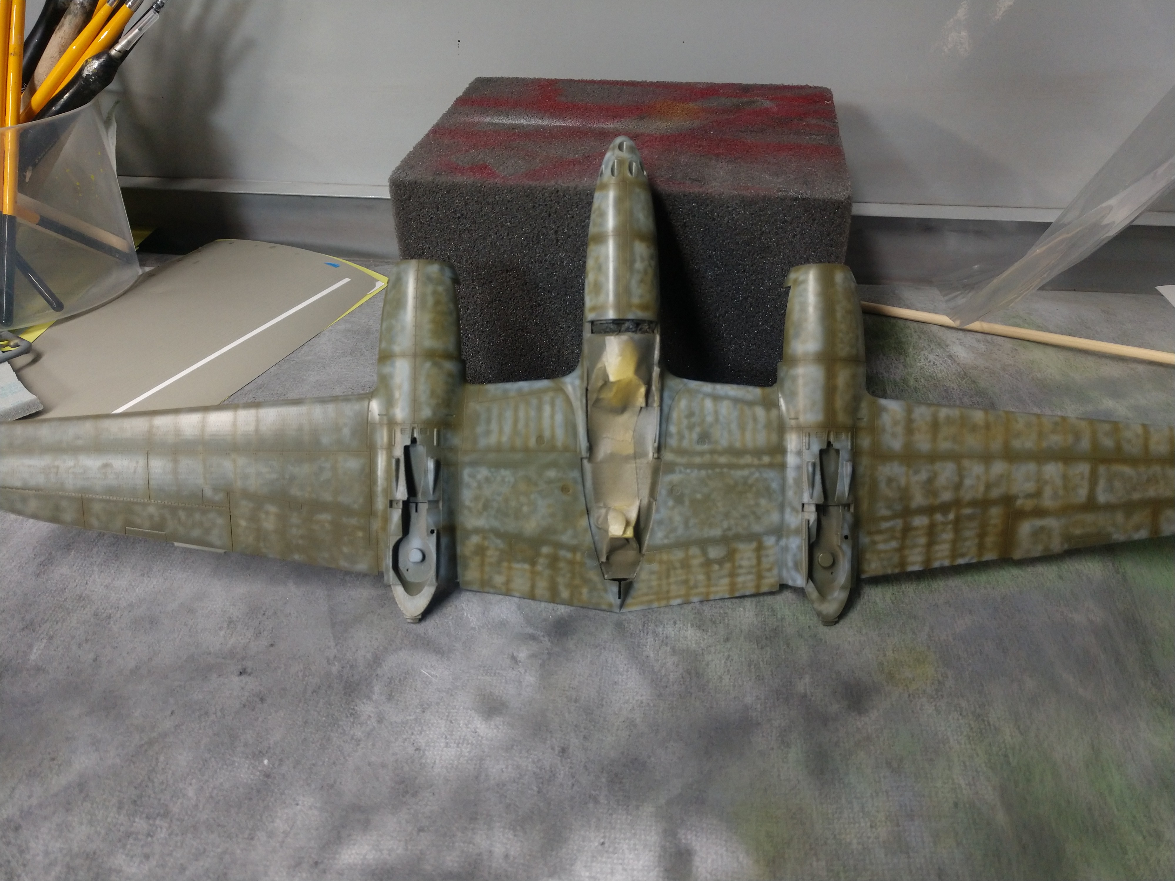

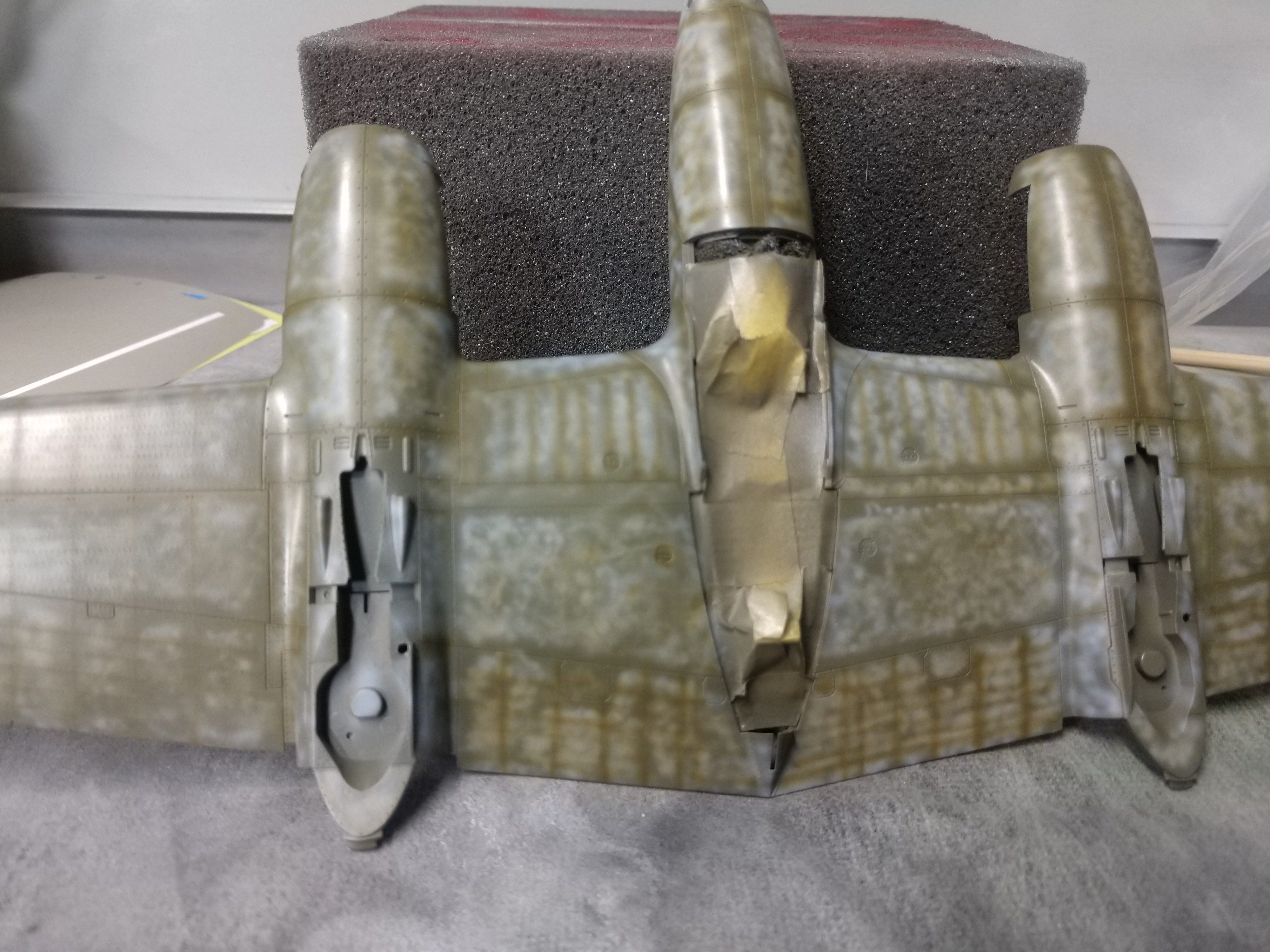

Love that dirty preshade mess y do! :notworthy
