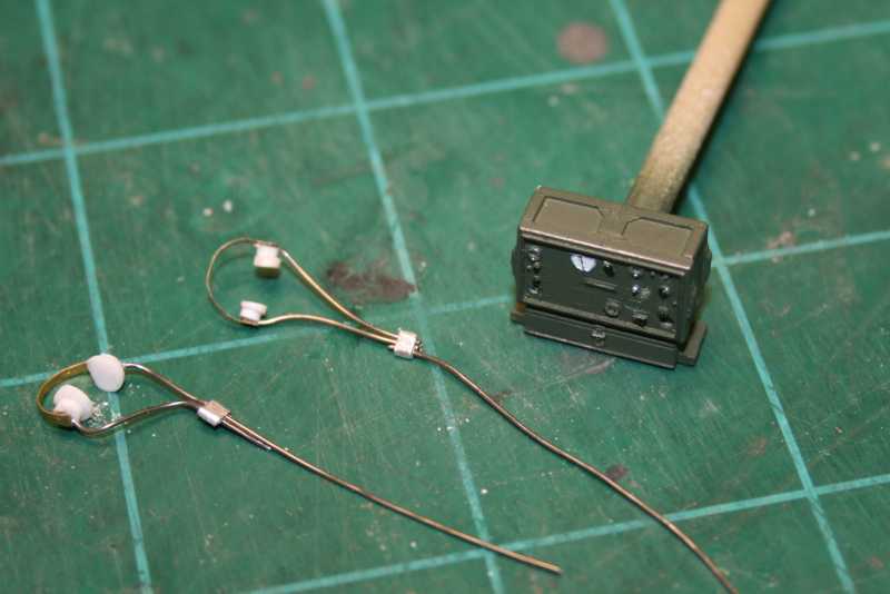

Thank you, my friends! Moving forward after a few days of feeling pretty lousy, I have added some details to my Ariete. Expanding on a tutorial from the past, I made a couple radio head sets from scrap PE brass frets, punched some styrene discs and silver solder. The first set I bent the head strap first, not a real good idea, although I got it to work. Second go, I got smart and laid it all out flat and then bent the head strap. :eek:hyeah
I found a spare radio set leftover from another build and detail painted it, along with the headsets.

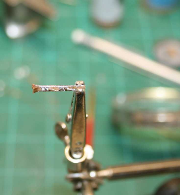

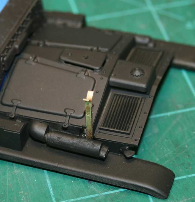

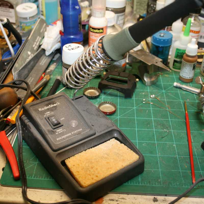

Next up, I made the antenna support Tamiya left out. Breaking out the old soldering iron and some brass strip.
I bent the brass strips and then clamped them back to back in the ol' helping hands.
Making sure I got it soldered so the seam doesn't show, then hit it with the file to remove the excess silver solder.

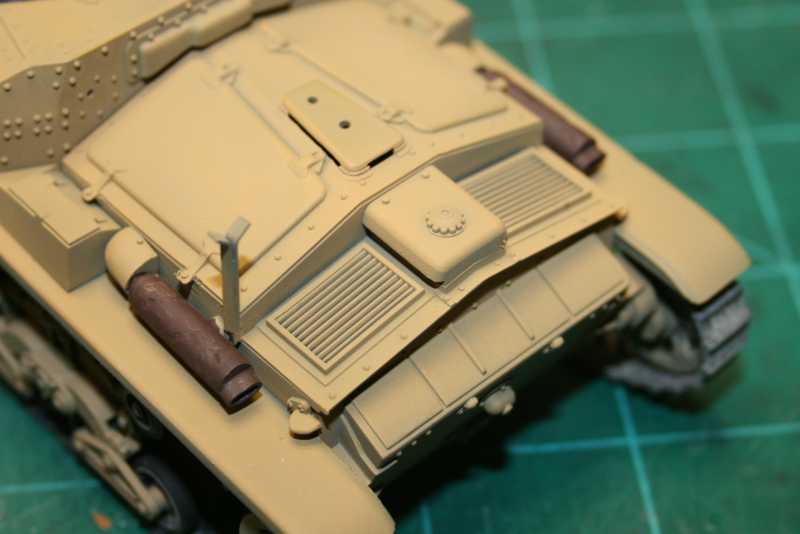

Bracket attached, ready for primer.
Moving on to colorizing the headsets.

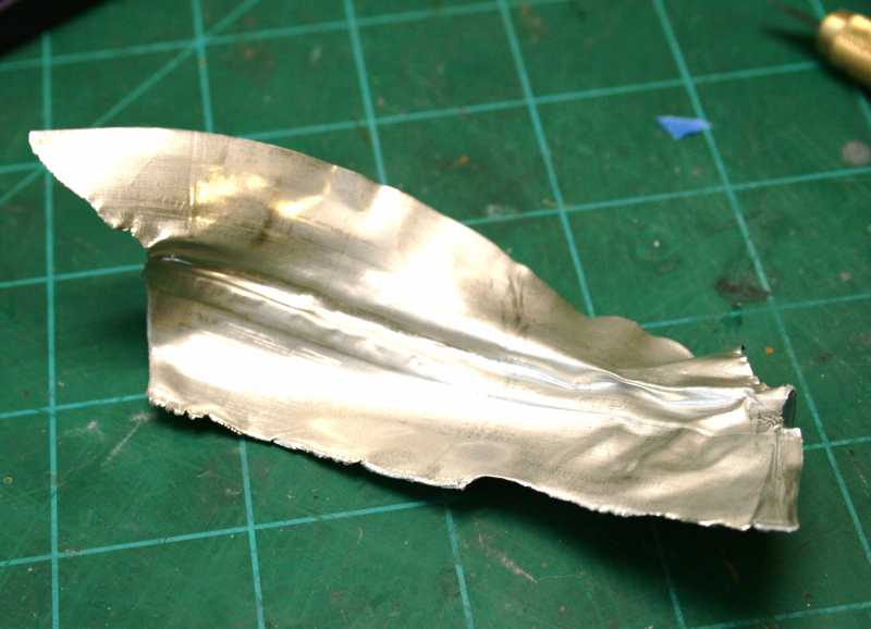

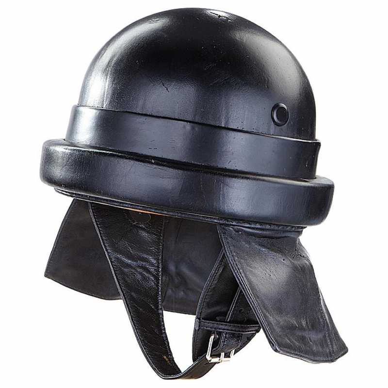

I like details, especially things that make a build look lived in. Tamiya included a tanker helmet with the newer version of this kit that I did not use when I built my first one, so I dug it up and plan to install it somewhere on the model. These helmets were funky leather bowler hats with a leather "skirt" that protected the neck. No skirt included with the Tamiya piece, so here goes!
I save stuff that might be useful for just such an occasion, this is lead foil from a bottle of Buffalo Trace bourbon.
I took a piece of Tamiya tape, laid the helmet on the tape and made a template.
Then I moved the tape to the foil and cut out my shape. The helmet will be displayed right side up instead of upside down, as there is no liner and I don't want to gin one up.
Looks pretty good for a first attempt, I think.

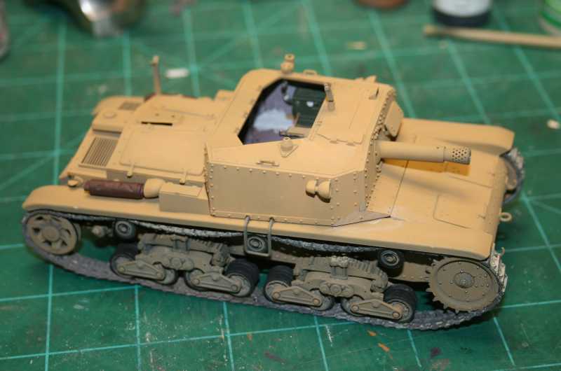

Thanks my friends! That Mussolini had him some tailor, huh? :laugh: I spent the day wrapping up small details that you may never see again and I installed them without taking photos. :facepalm Here's where I am as the day ends.
I'll have to set up some different light to get photos of the radio gear and the interior. :frantic
More to come as I mess with the final painting and start the weathering process. Thanks for coming by.
