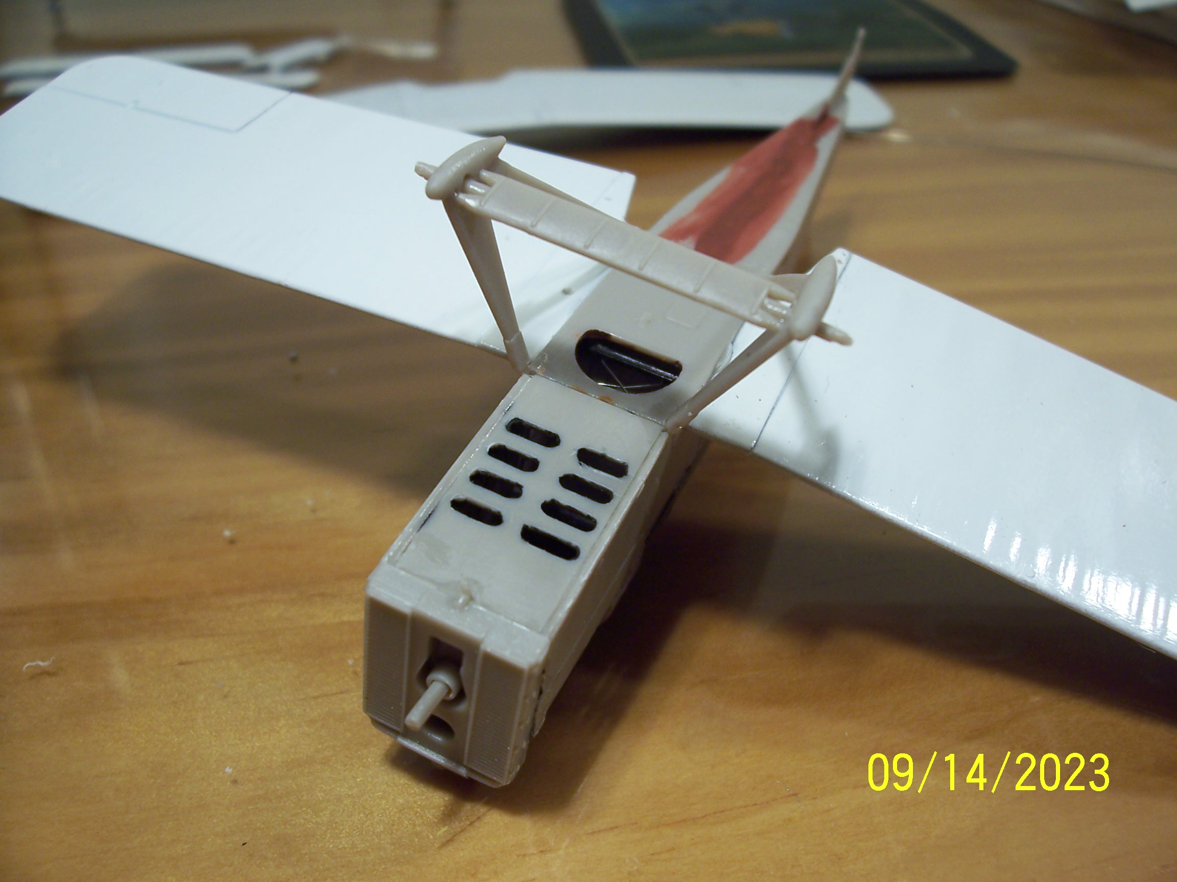

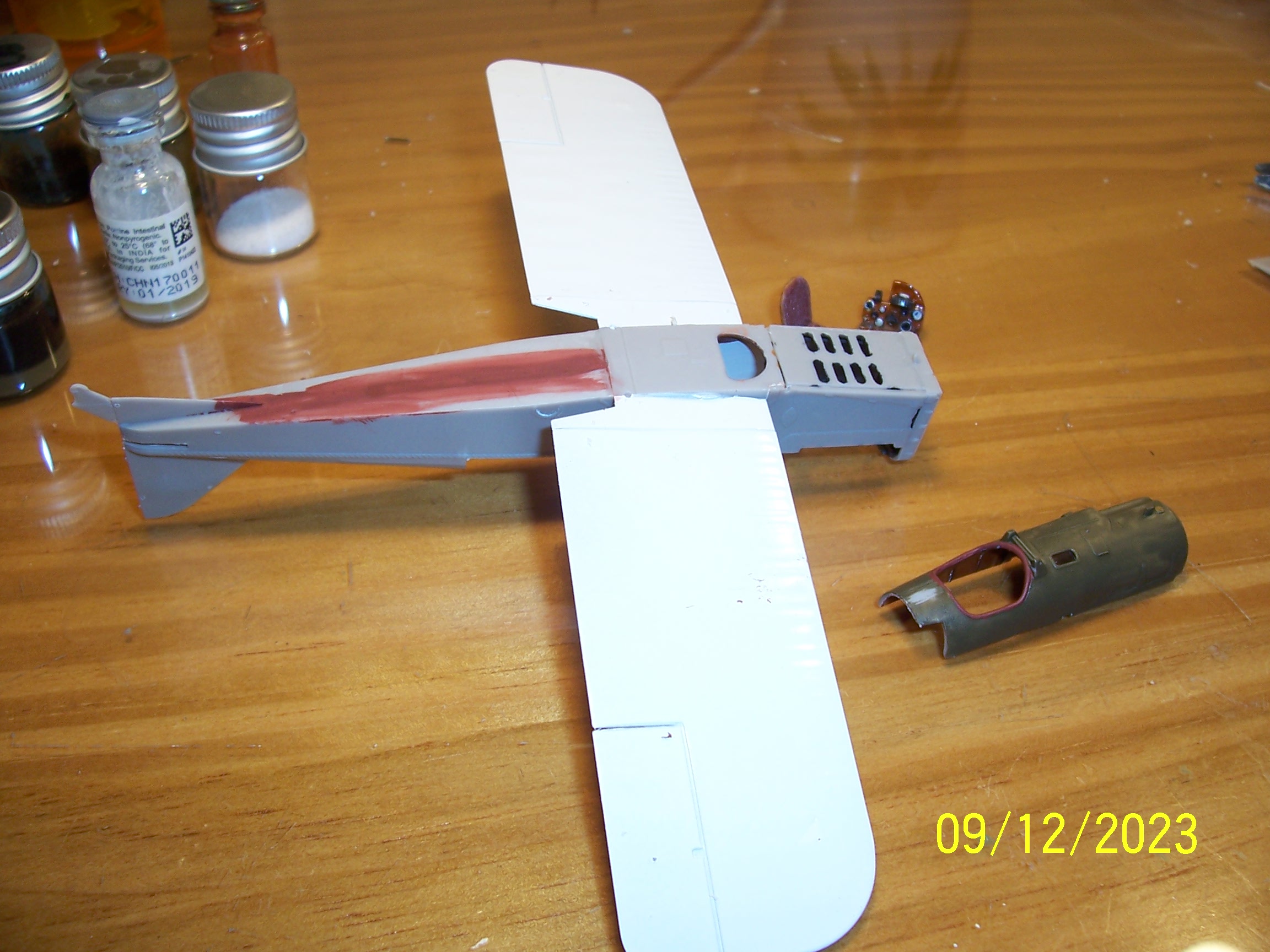

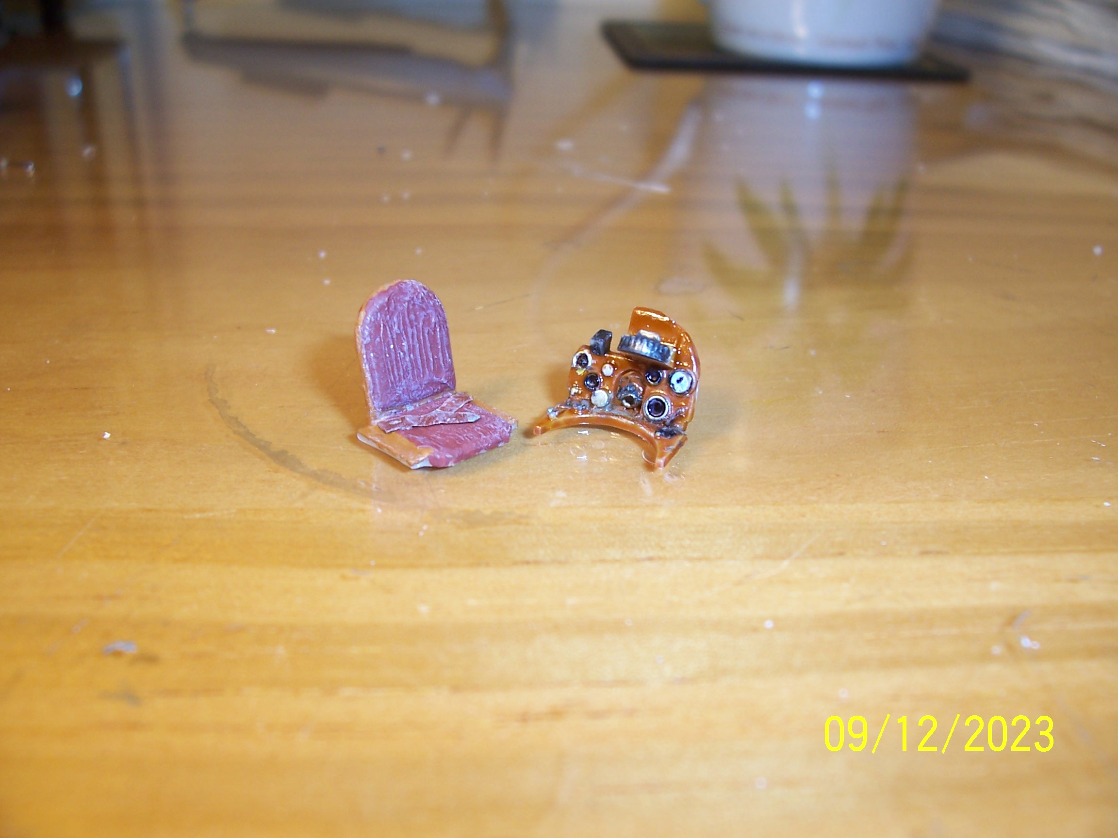

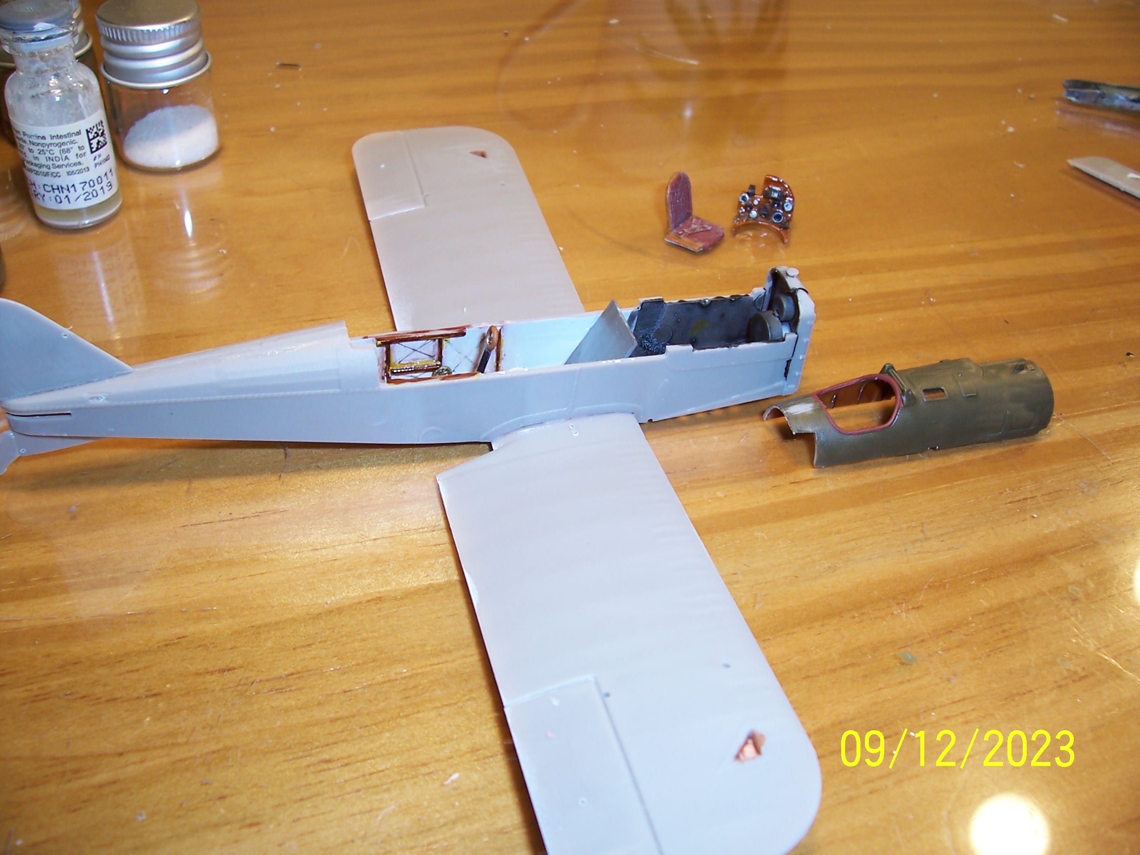

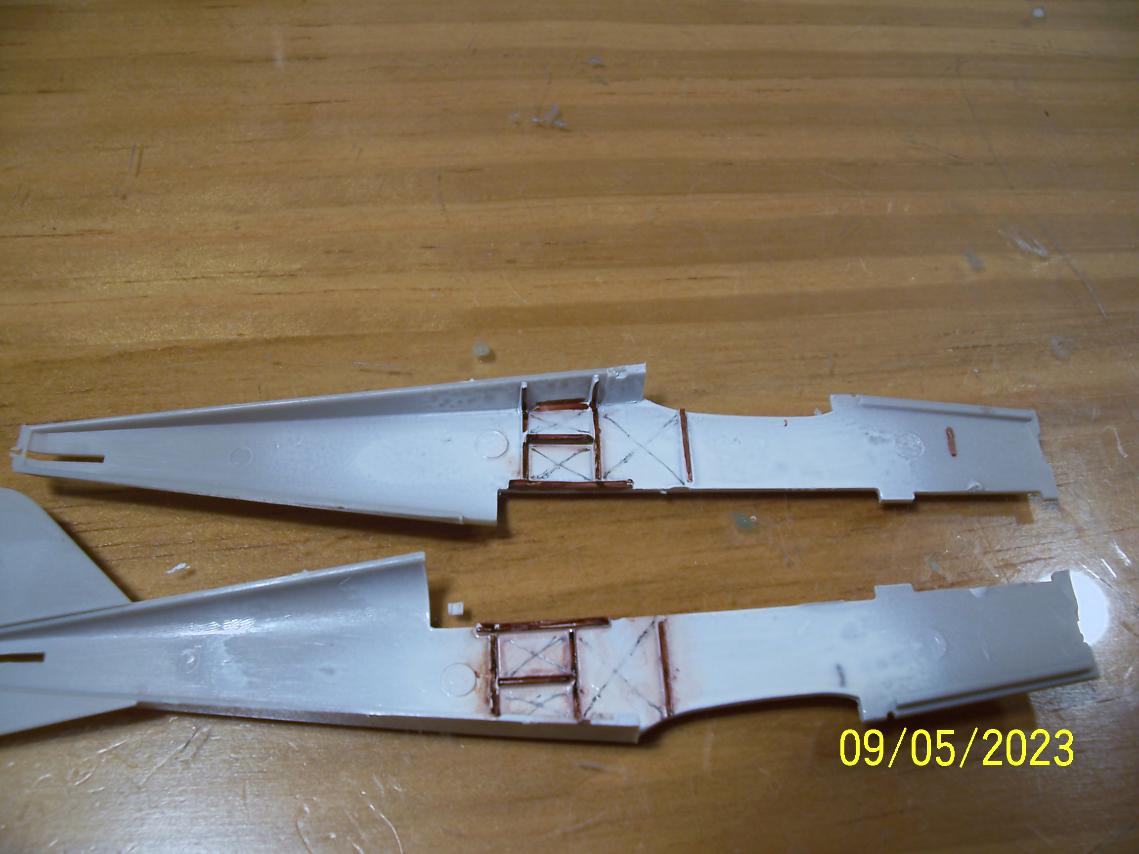

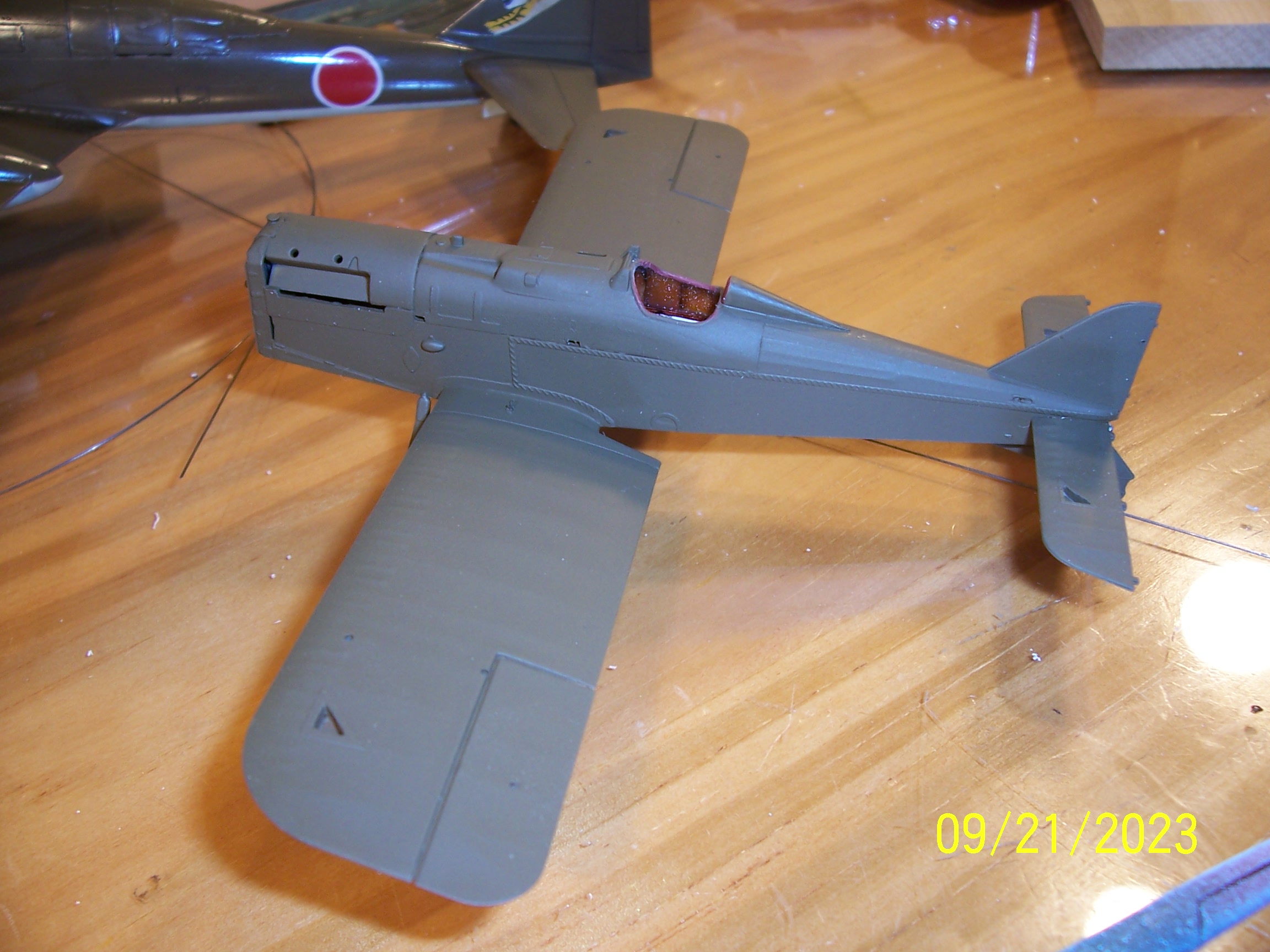

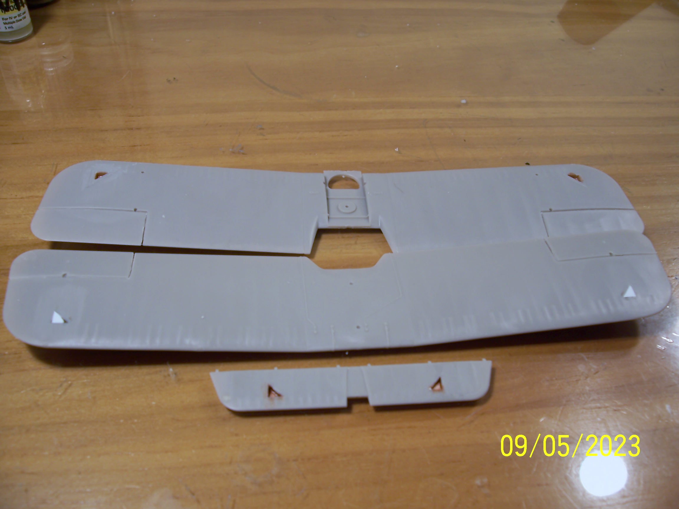

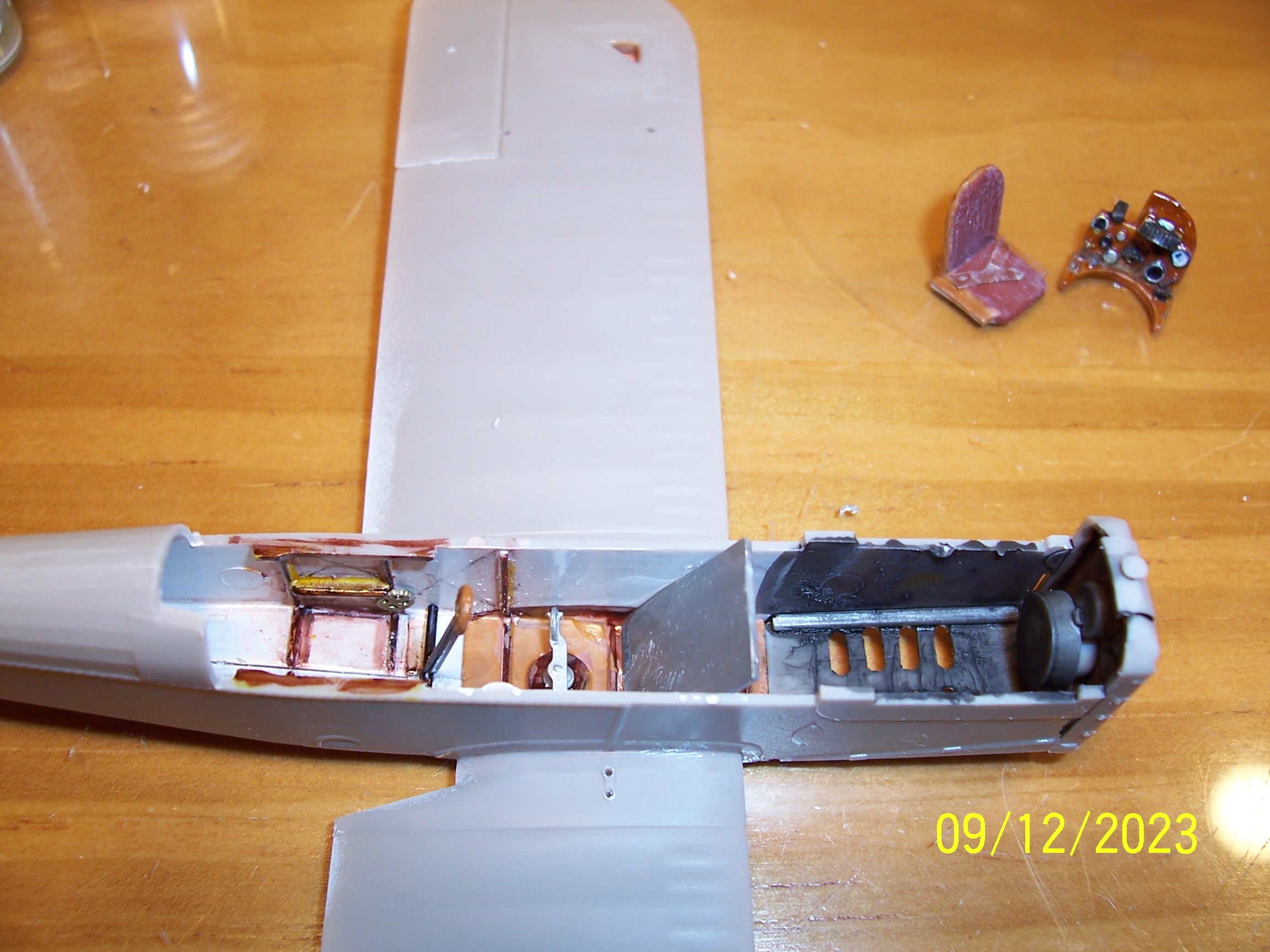

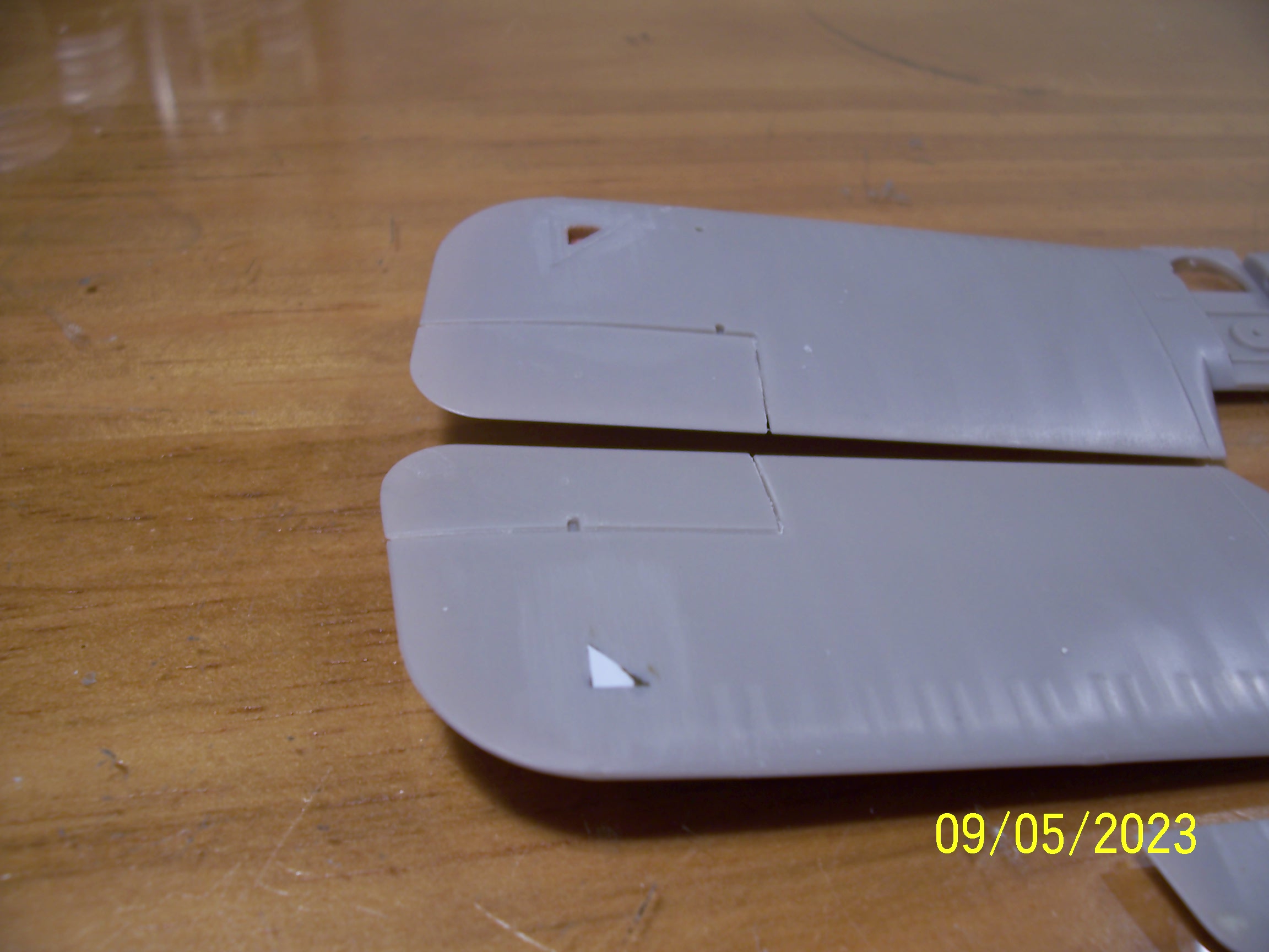

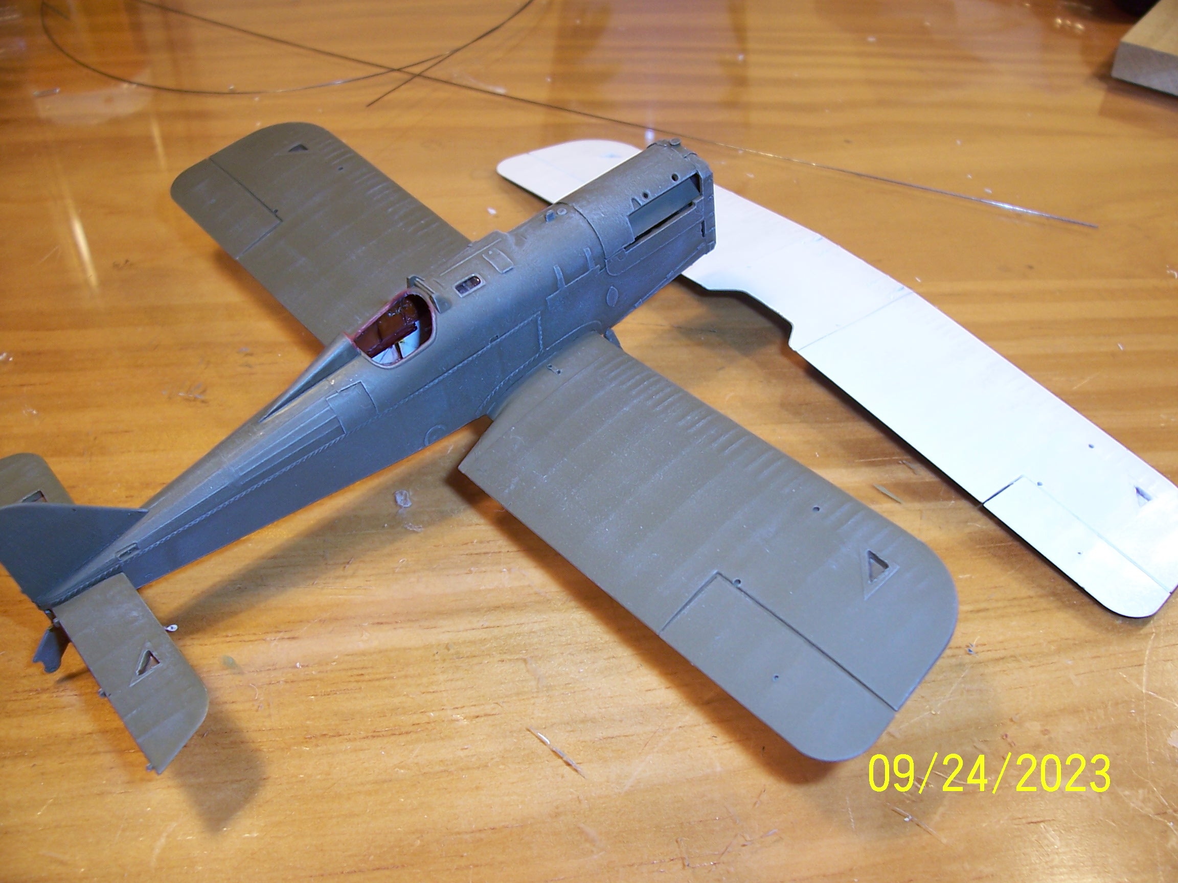

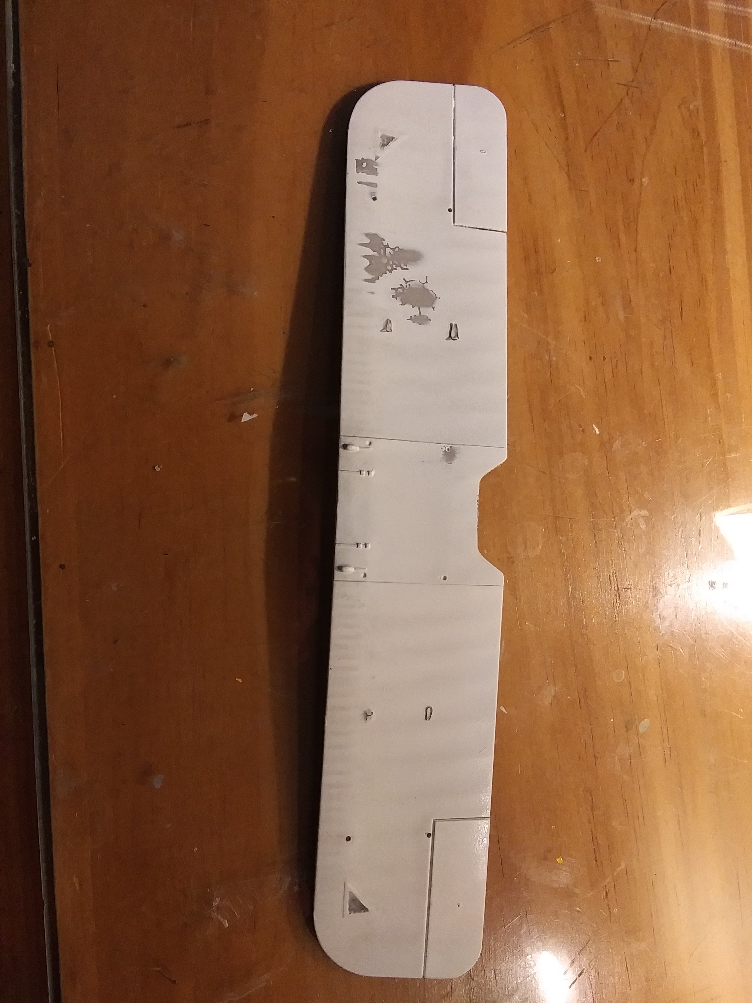

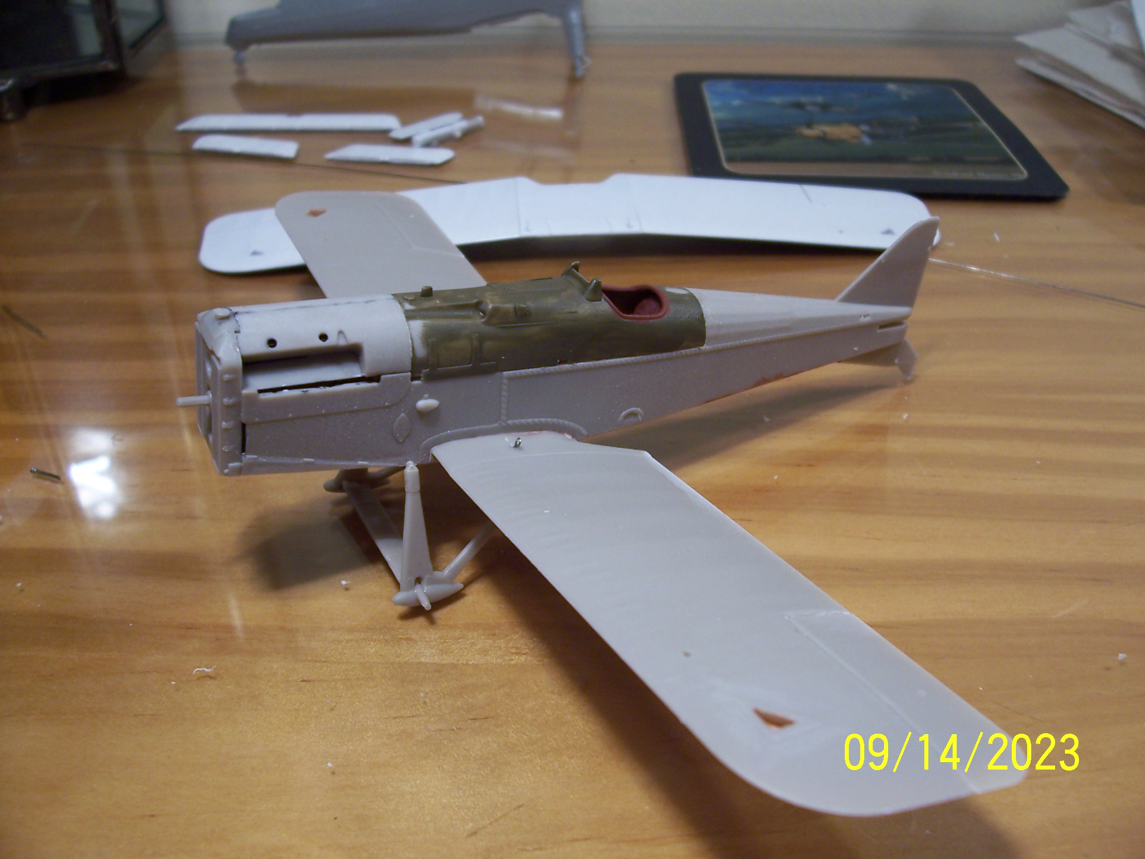

This is Rodan's Se5a kit. Not bad detail. One thing that needed attention was the small triangle windows for the control pulleys on the wings and tail. The kit supplied decals and looked a bit cheesy. So I drilled and cut out the triangles and glued small pieces of sheet plastic on the opposite side of the windows. The pulleys will be added later after painting then covered with clear decals. The interior was painted off white, a brown sharpie was used for the wood frame and pencil for the bracing wires. White glue was used to make a cushion for the seat and foil for the seat belts. The instrument panel was nicely detailed and painted. It's location in the fuselage was tricky though. The piece for the lower engine panel was thinned and drilled out. Except for the lower fuselage and upper cowling halves the fit is pretty good. It's just about ready for painting. The underside of the wings and tail were painted Blossom white by Rustoleum. Gary S.

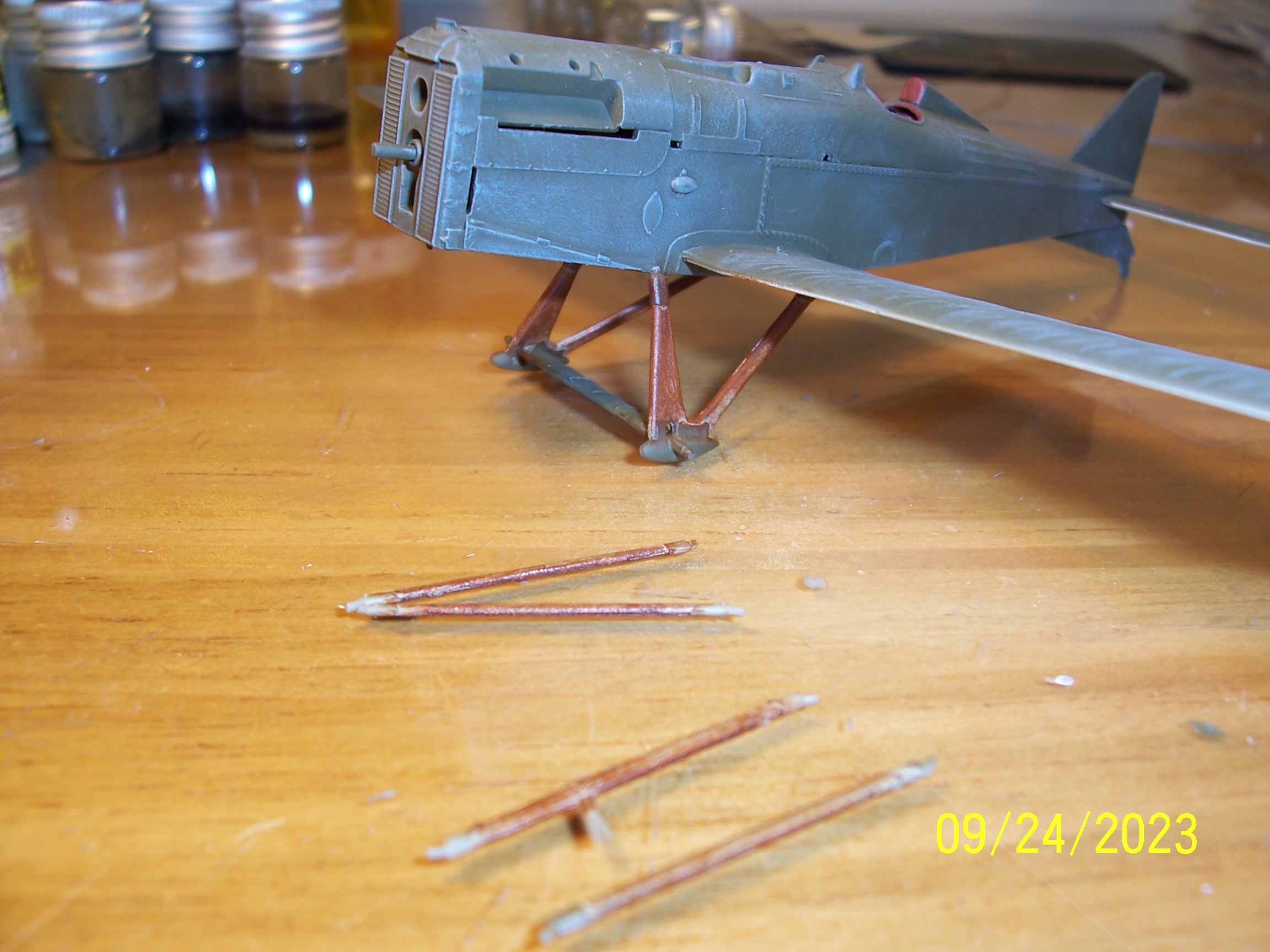

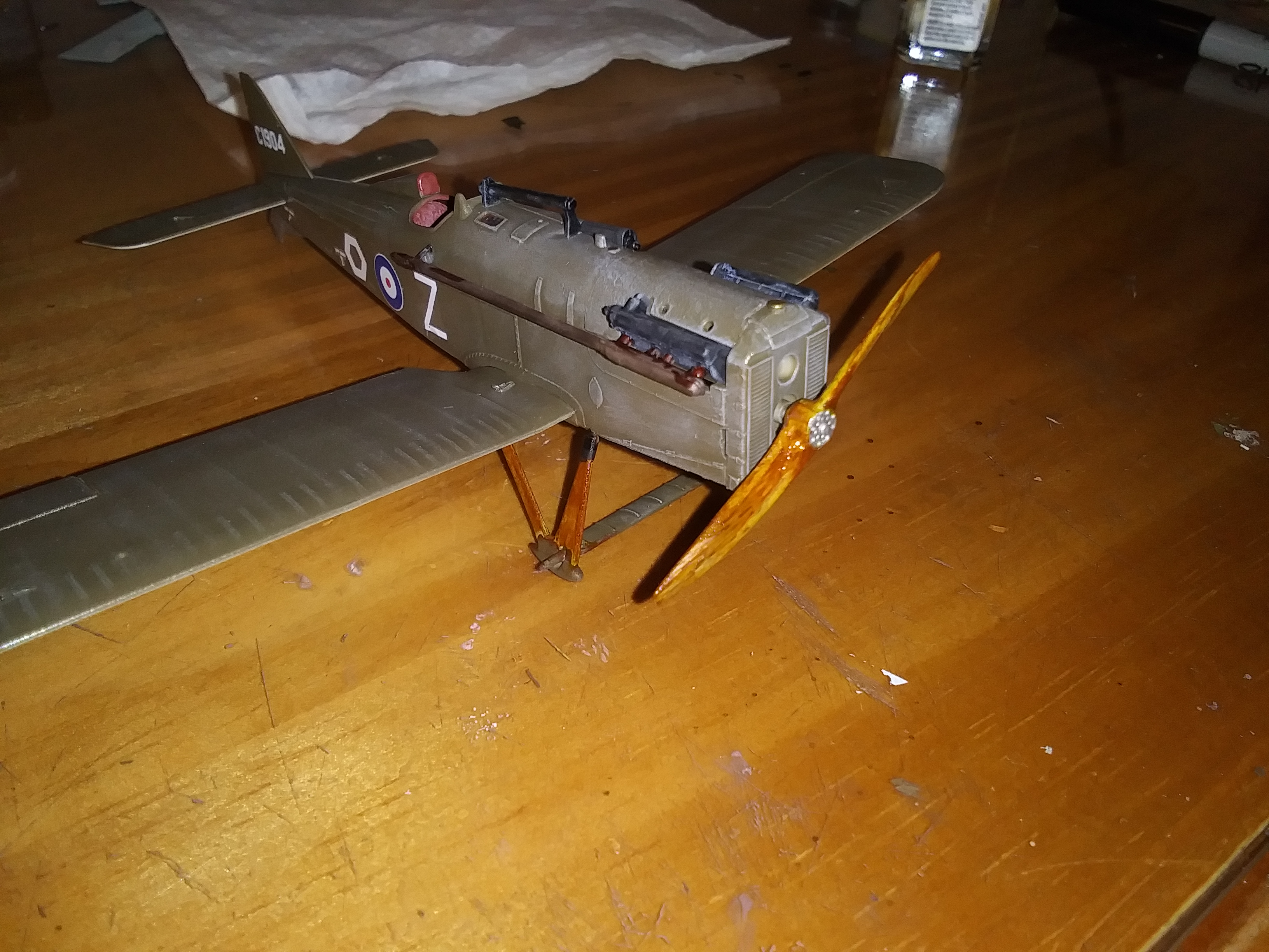

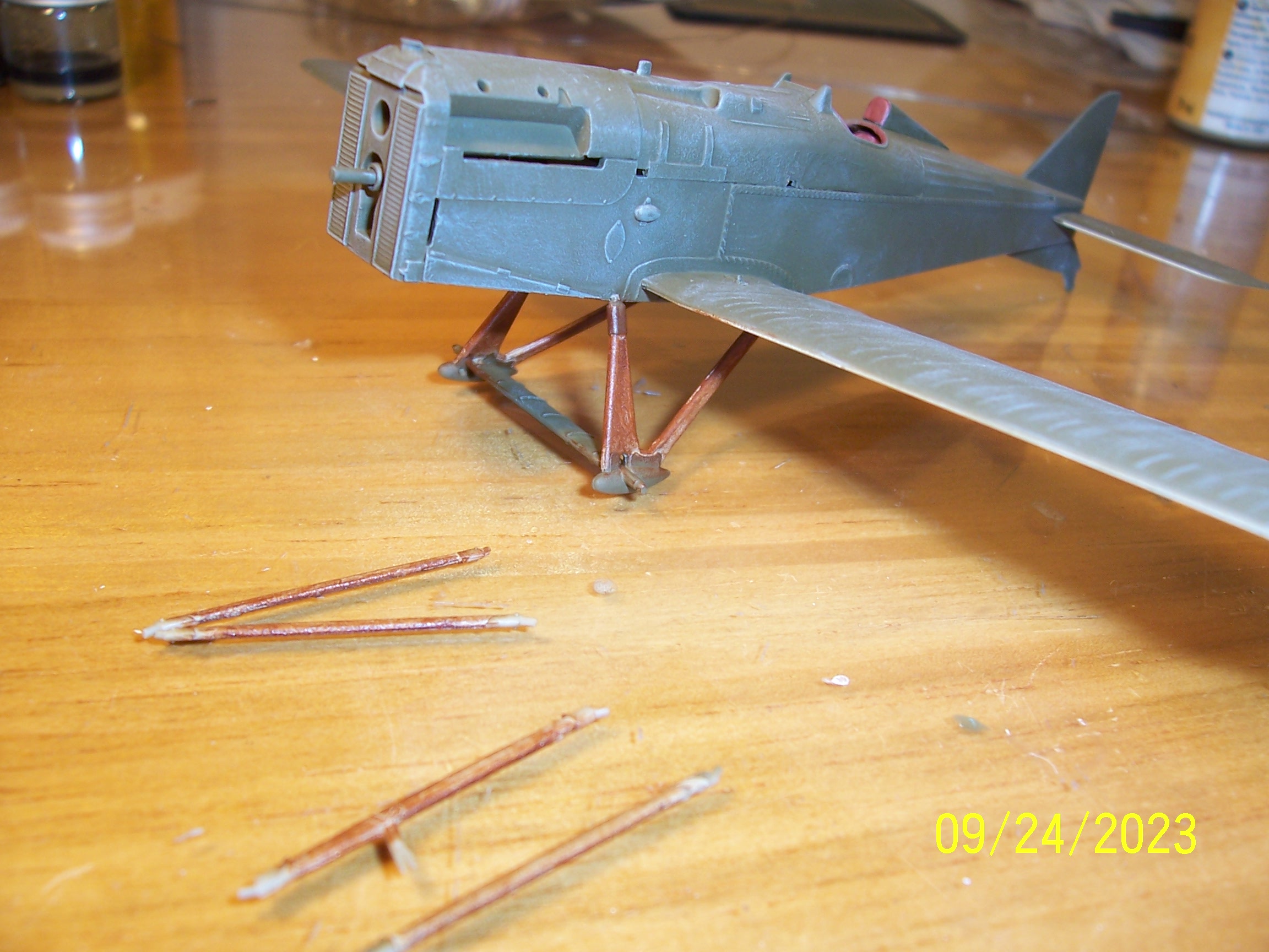

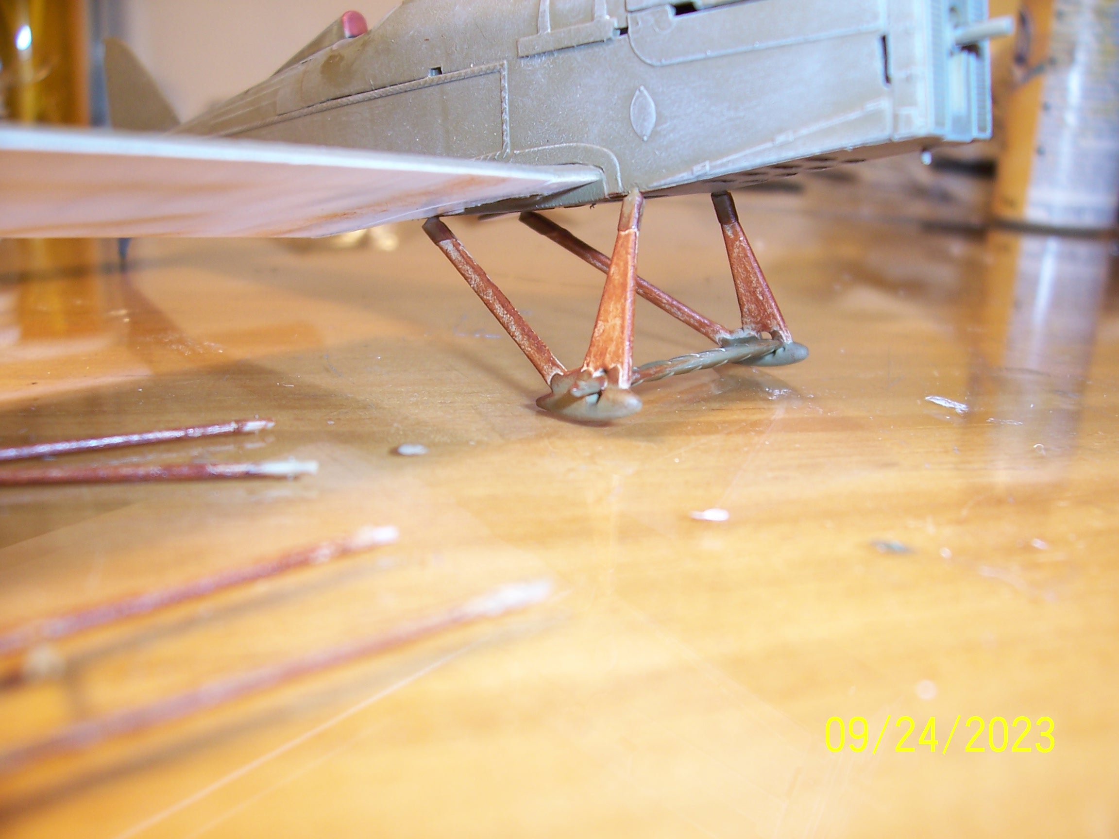

Did some dry brushing with white oil paint and when it dried did a coat of future. This AM I did the decals for Billie Bishops aircraft. I have already built his Ni-17 as a salute to our Canadian friends. The landing struts were also painted wood in a 4 part process. First a coat of enamel, then my mix of panzer yellow acrylic, followed by a dry brush of burnt sienna oils and lastly a coat of Tamiya's clear yellow. I did the for the prop too. Then the cuffs were painted black. Thanks, Gary S.

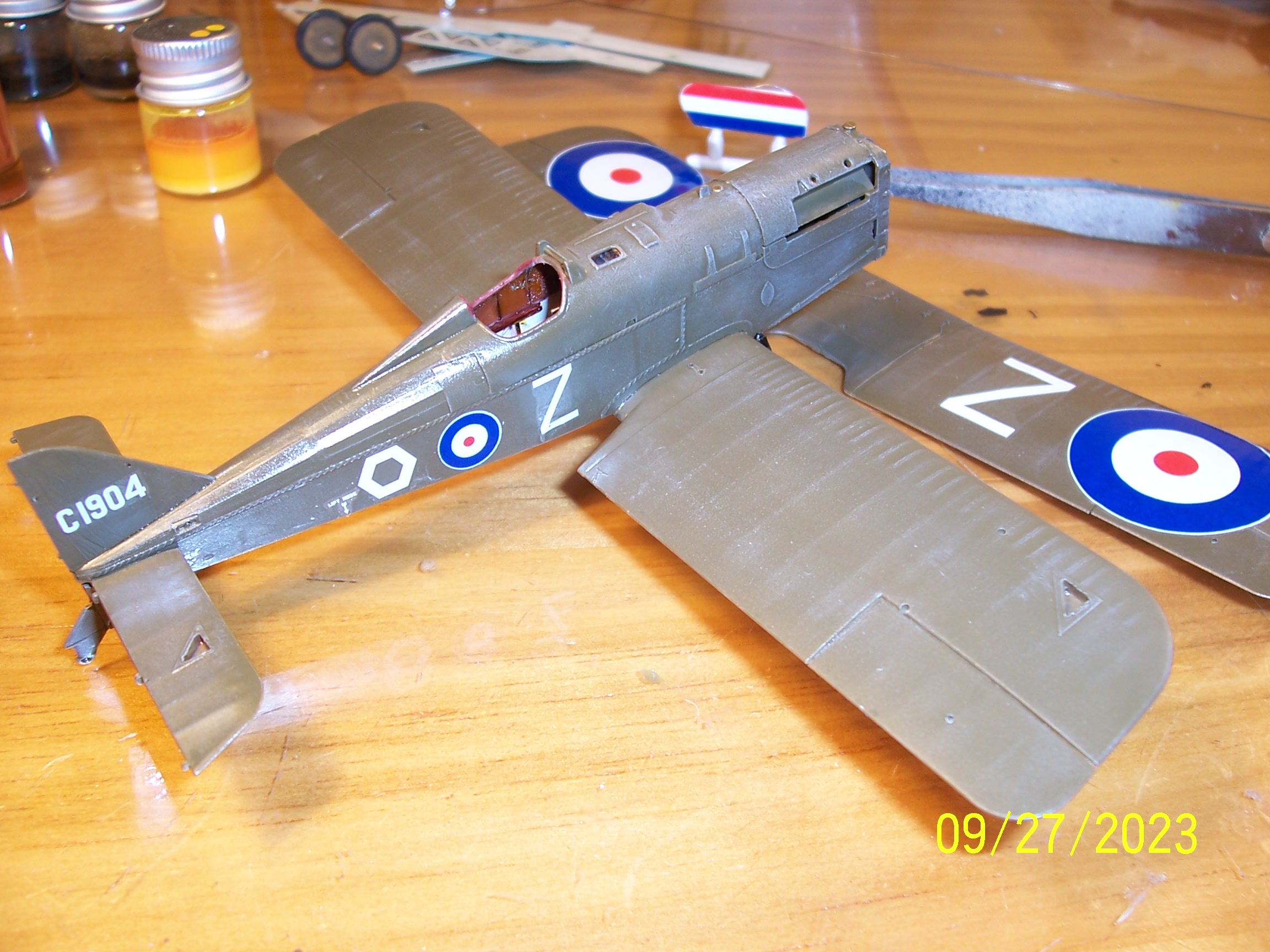

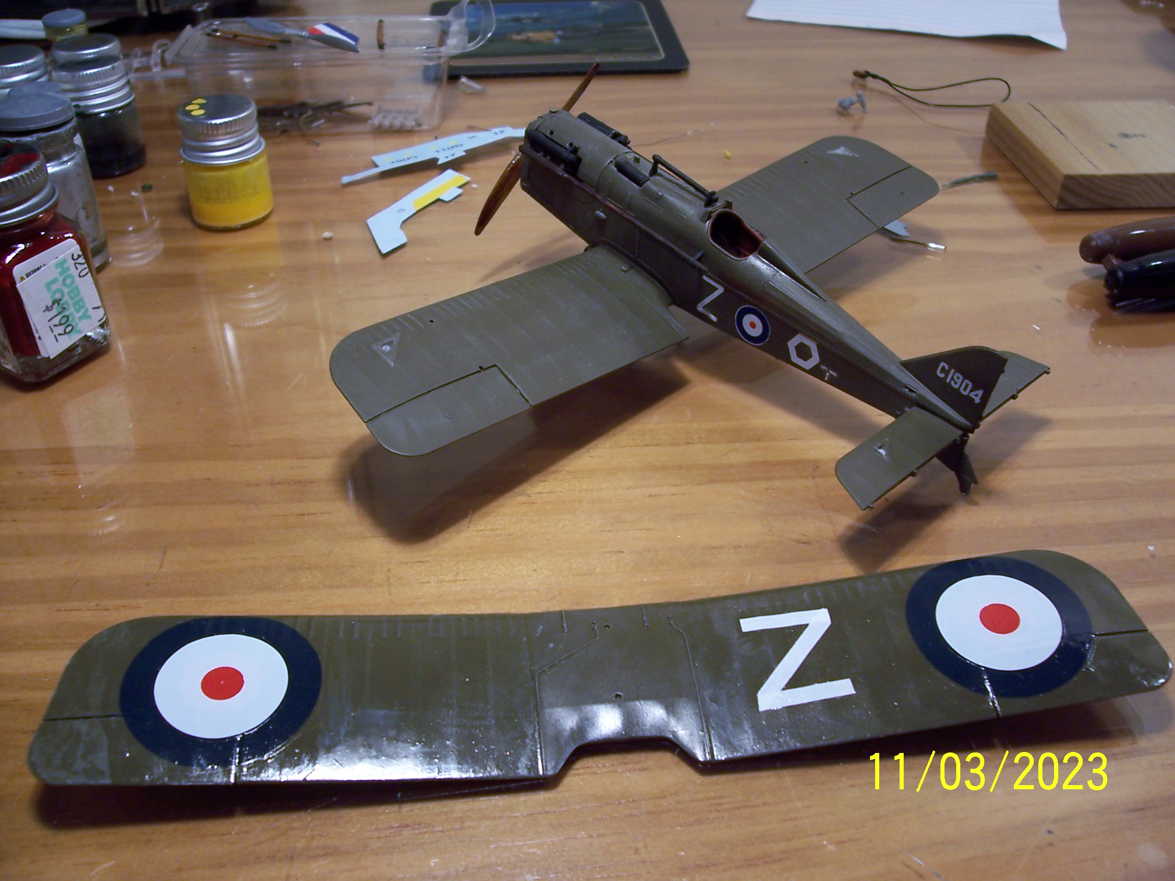

Major screw up!!! Yesterday I sprayed the lacquer flat coat and it puddles wrinkling the base coat. So I sanded it down and applied low tack tape to the upside which pulled off the decals. All is not lost though. A while ago I made a copy of the rounders. They are a little underside as are the rub on transfer for the letter Z, but oh well. To top things off I also broke off and lost the tail wheel on the Stearman.

A good compass and some tape and you could make your own roundels and spray on if the size is too small on the rub ons. Bummer about the paint issue and tape. I'm sure you'll get it all fixed up though. As for the tail wheel, that sucks. Hope you can find it. Maybe sacrifice a part from a donor kit to the carpet monster and it will spit the tail wheel back out to you. All the best.

Thanks!! I found the tail wheel on the garage floor today. Yea!! I'm not building a contest bird. l think the decals will do just fine I hope. Gary S.

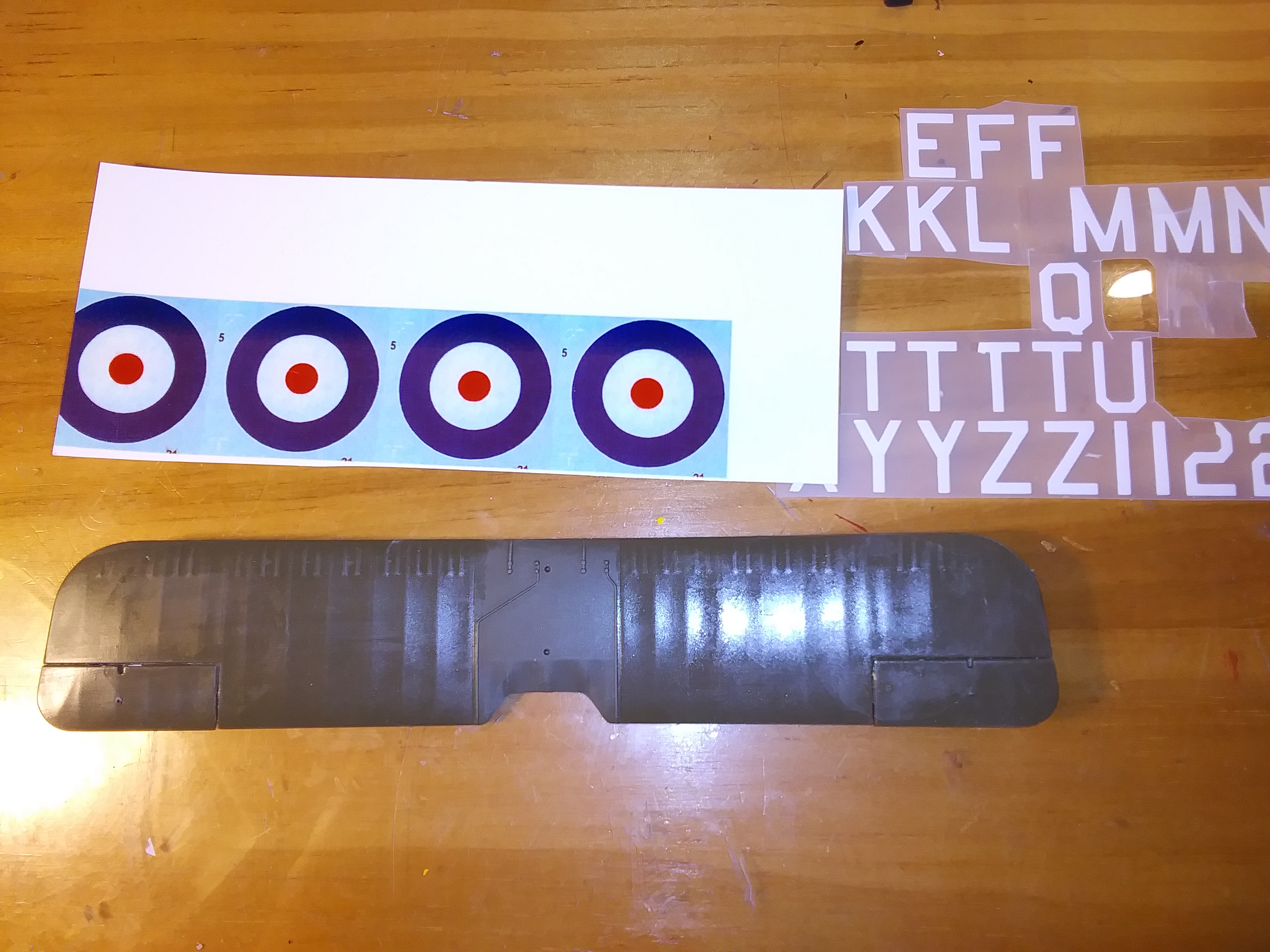

Jubilation!!! The decals shown above didn't work out. I didn't realize it was printed on clear film, only to learn that after getting them wet. By the time I clear prayed on and cut out white back decals they wrinkled beyond use. What to do. Went back to the decal stash and found a white decal disc of the perfect size and 56" scale RAF WWII roundels plus the red dots. The RAF decals broke up into many pieces, but I managed to get the blue parts back together. After they dried and sealed with Future the white disc and red dots went on with no problem. A bigger Z was made by cutting up a N decal. Now to get in gear and finish it. Thanks, Gary S.
