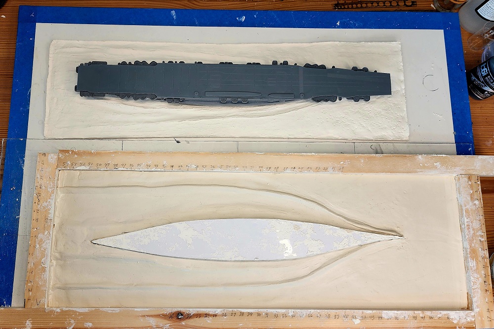

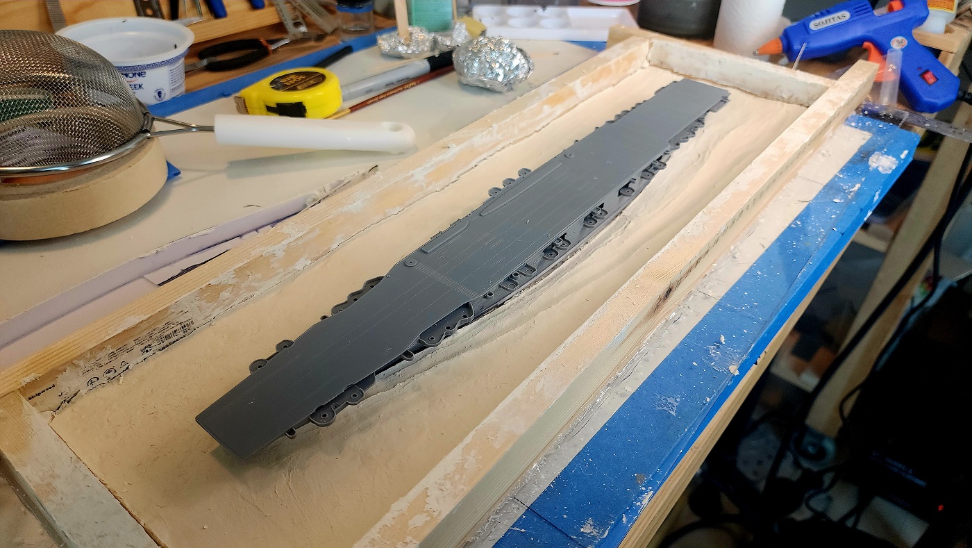

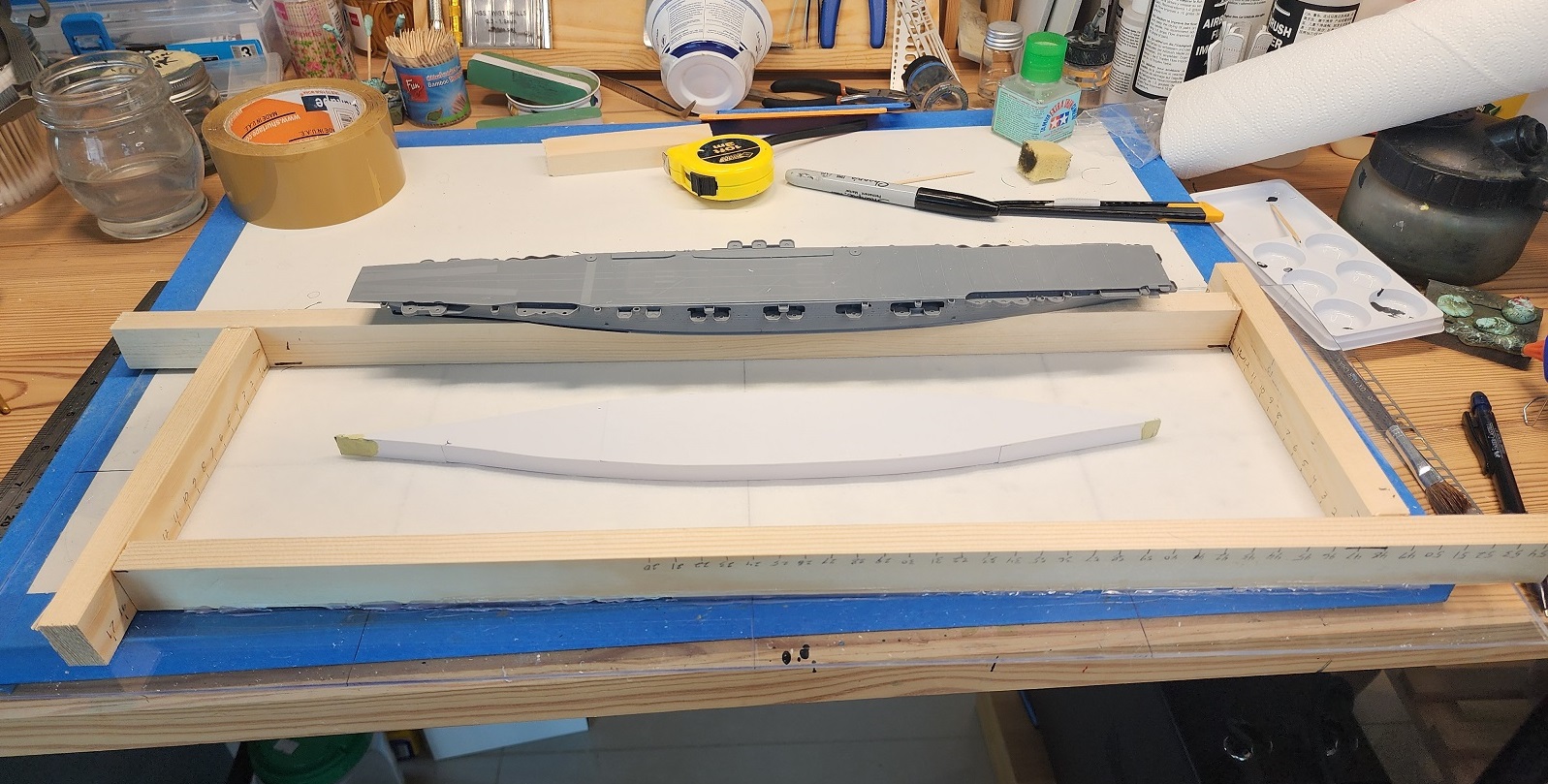

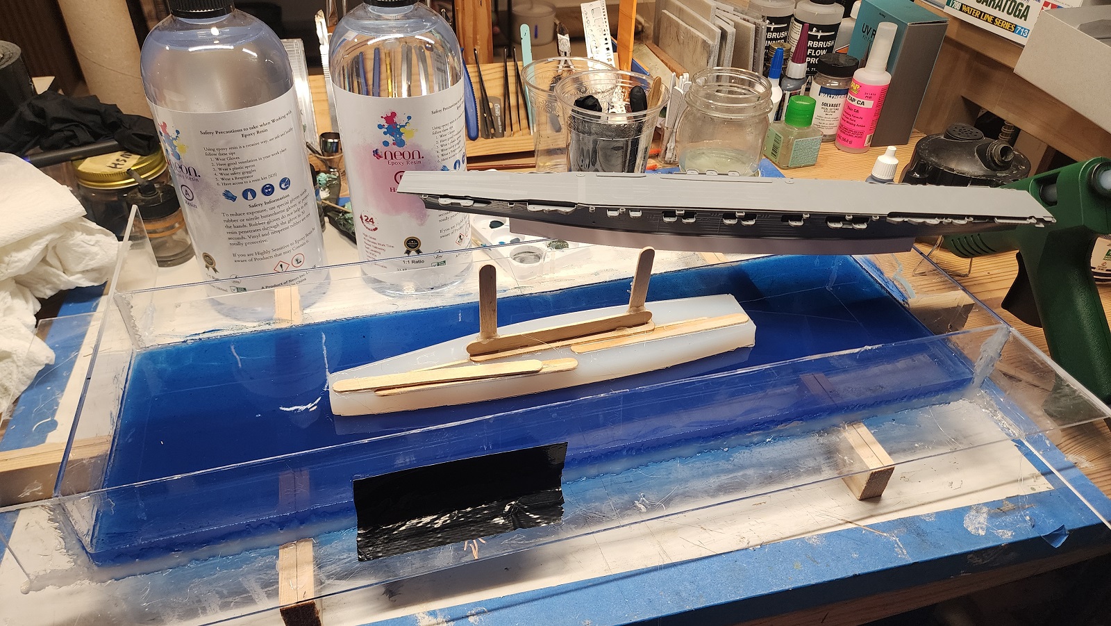

This is something I've been thinking of for a while. I'm going to try doing a resin ocean for my 1/700 USS Saratoga. I'll be trying a technique I saw on YouTube, doing the water shape in clay, making a silicon mold of it, then using it to pour the resin. This will be my first time pouring resin for anything other than a simple block or doing anything at all with clay. A level pour and adding effects won't do it because I want a more dynamic shape to the water. This will be Sara really whistling up the steam.
There's quite a curve along the hull, enough that I'll have to extend the water line model down a bit.
Anyways, here goes nothin'.

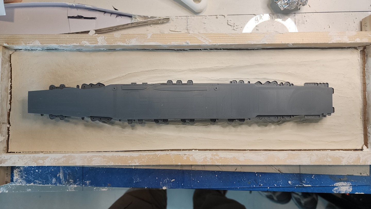

Yes, Puget Sound, doing full-power tests after her first 1945 refit. I'm going to try the same waveform but with planes on the deck. I know she probably wouldn't be doing flank speed for launch/recovery because she'd out-run her escorts, but c'mon, it looks so cool!

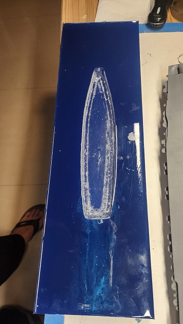

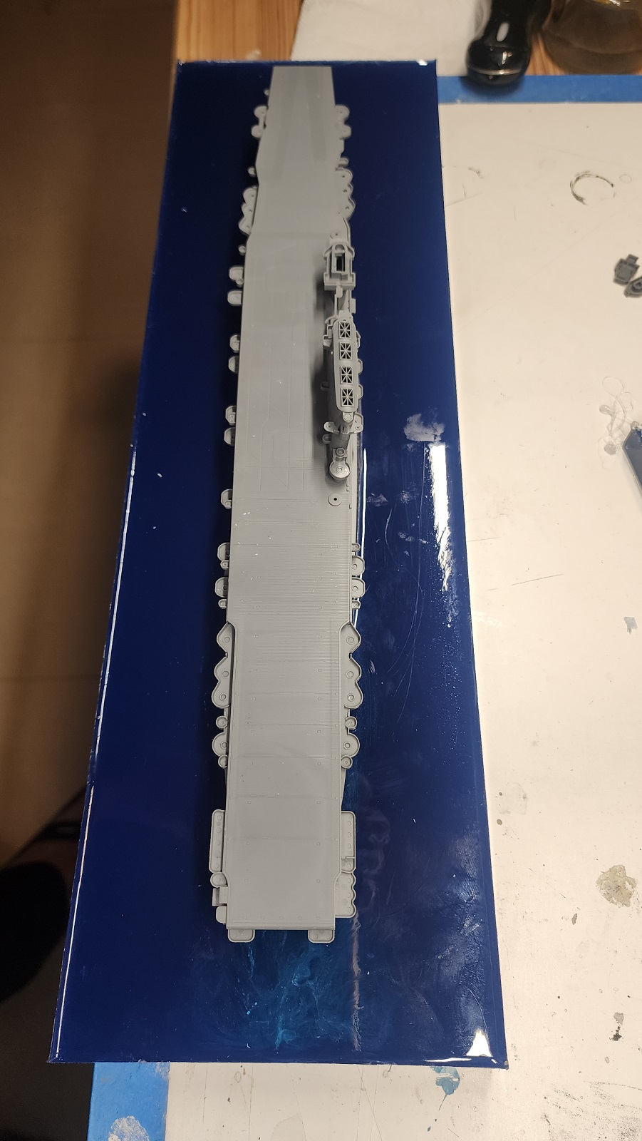

Yesterday I spent a few hours trying to sculpt the basic shape. I tried different ways to imprint a water texture into it but it just wasn't working. I'll probably do that after I pour the resin using AK Interactive Water Effect. I didn't expect the clay to contract so much as it dried, but I don't think it will be a big problem.
On a windless day, flight ops may very well have been conducted at full speed. You're on the right track. Less is more with water texture.

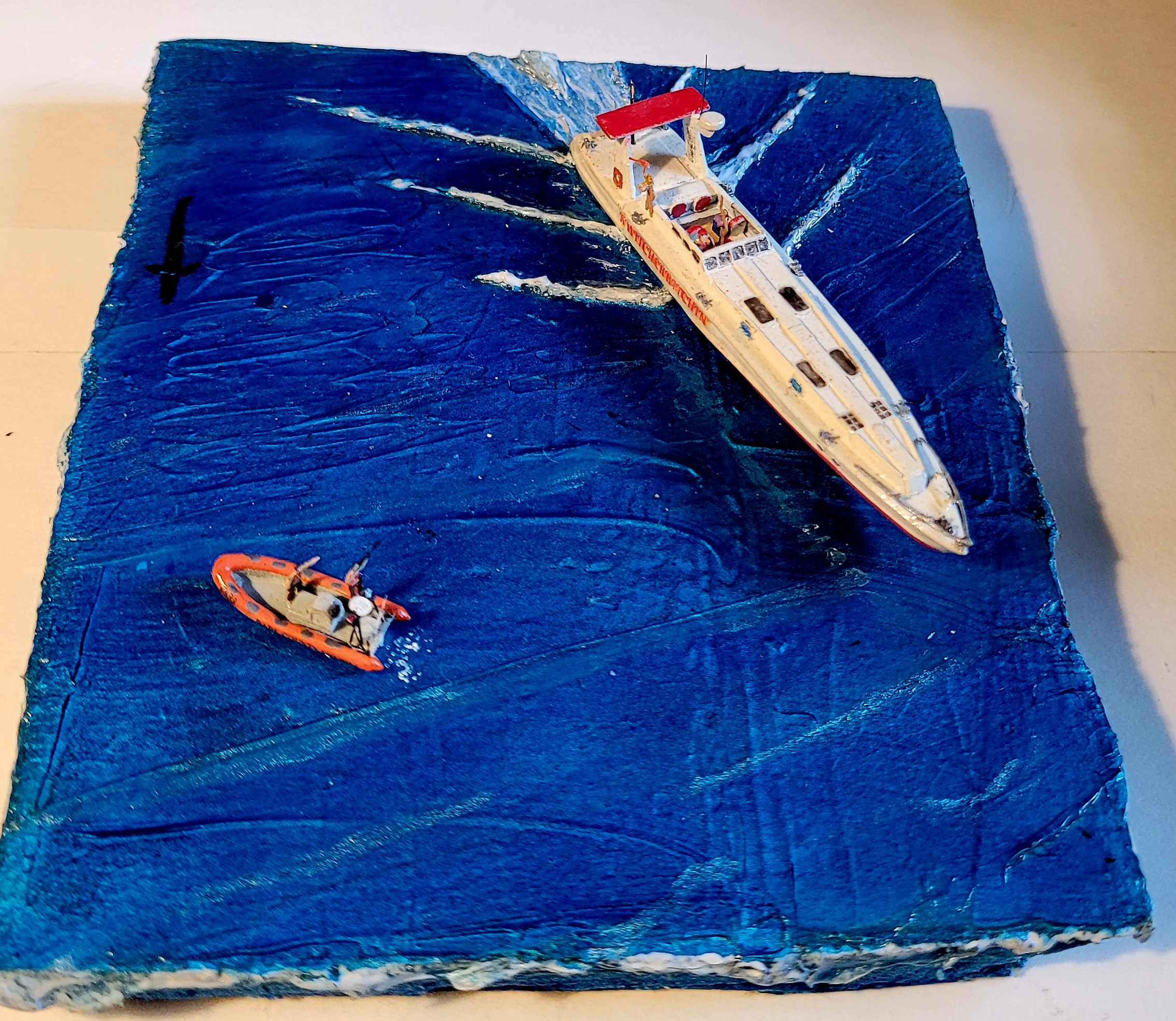

People overthink it. If the clay shrinks, saw it off. Start with a coat of silver and build up the base from there with grays and Tamiya clear blue. Gloss white for wakes and bubble streams, Future clear coat, Robert's your Uncle. Fannie's your Aunt, your ship is underway! Al has an advantage. There is almost no wind to consider in his picture.

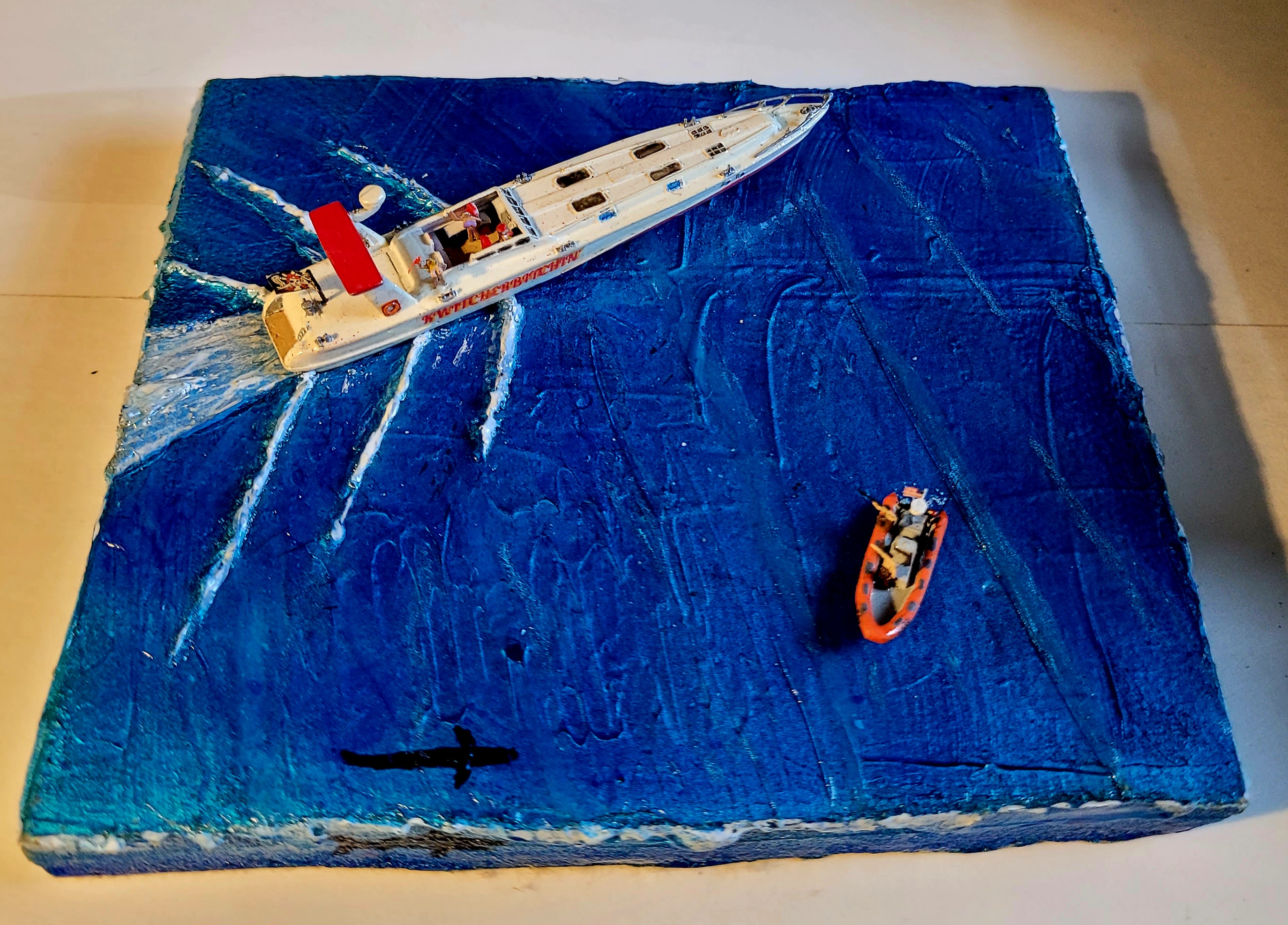

In this case, the Nut that made this, built the powerboat model to be posed on-the-step and high speed on a base made from a flat piece of foam shower board.
That being said, He is quite the eccentric.

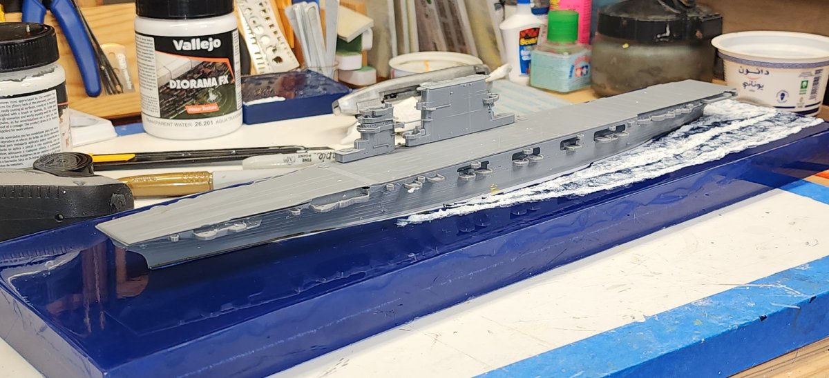

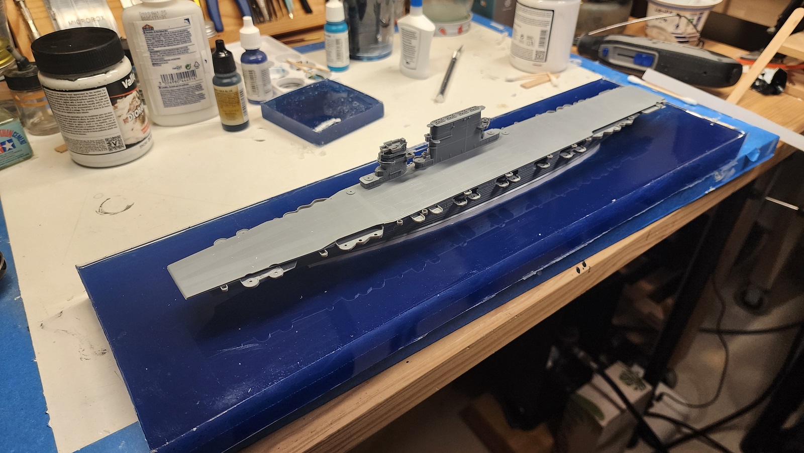

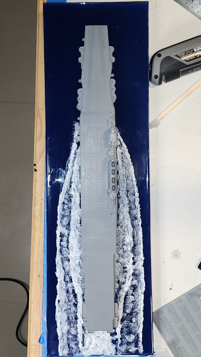

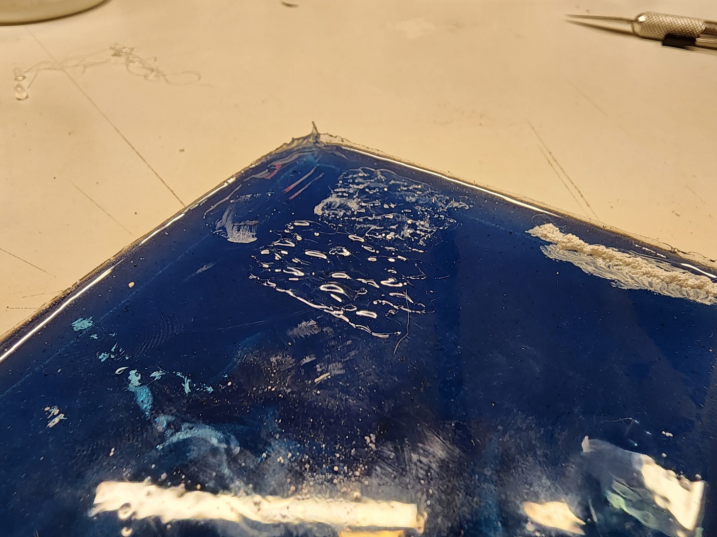

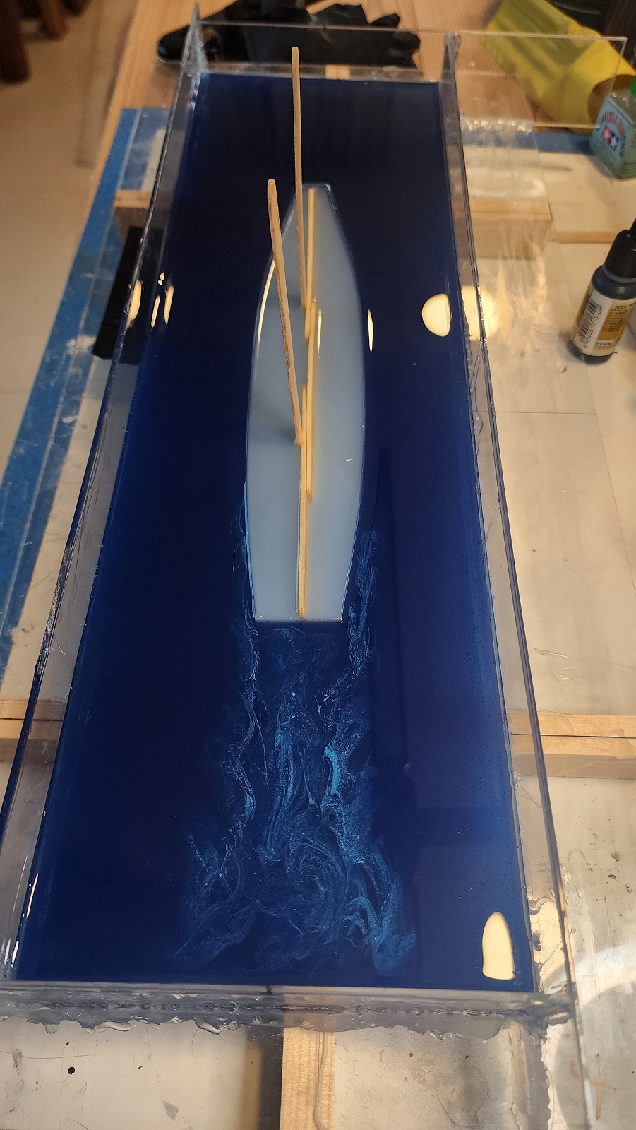

2nd shot. The more I looked at the 1st one the more I saw what I could do better. This picture from the Tennessee helped a bit too, since it's right down the length of the ship.
I'm a lot happier with this one. It also took less time and I made a lot less of a mess doing it.
