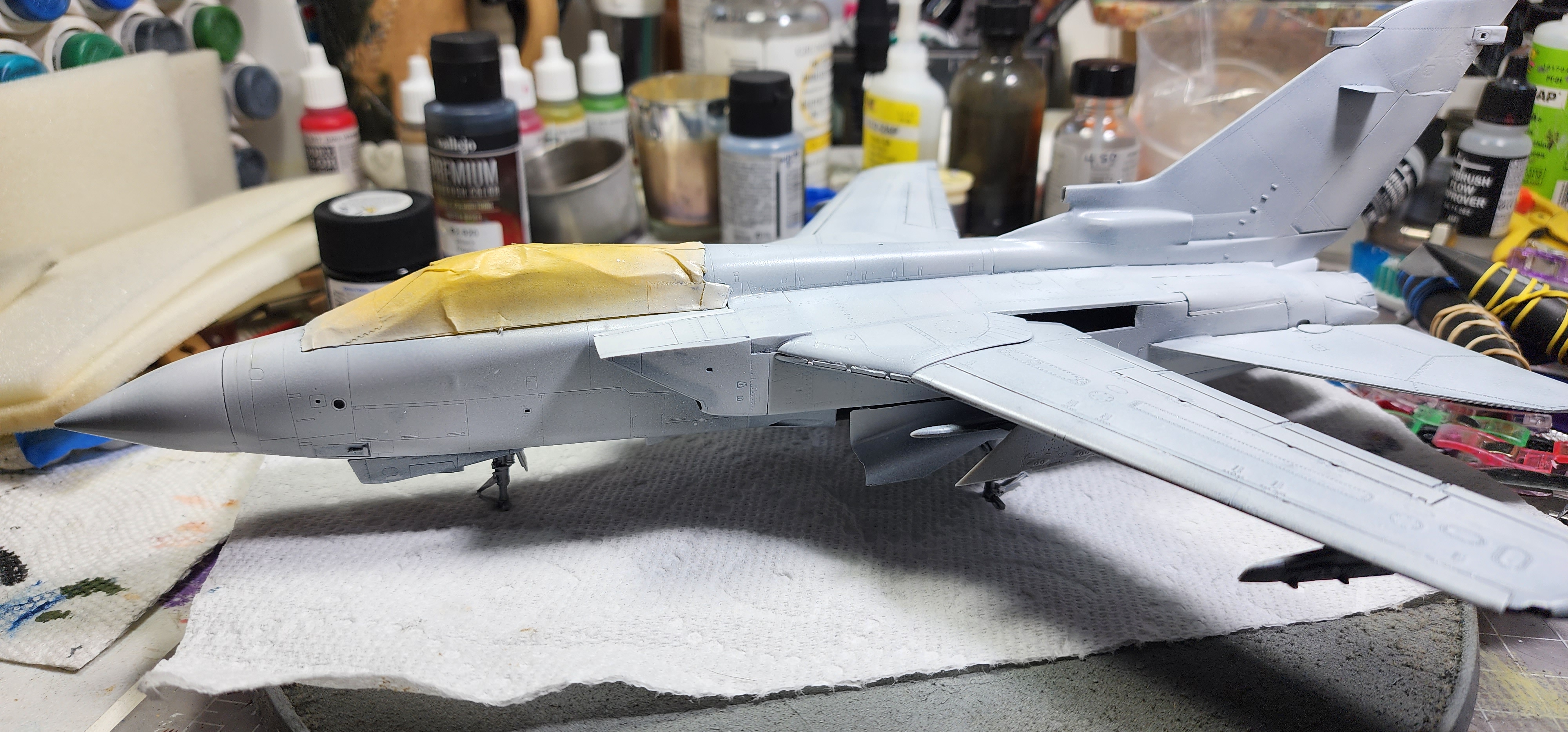

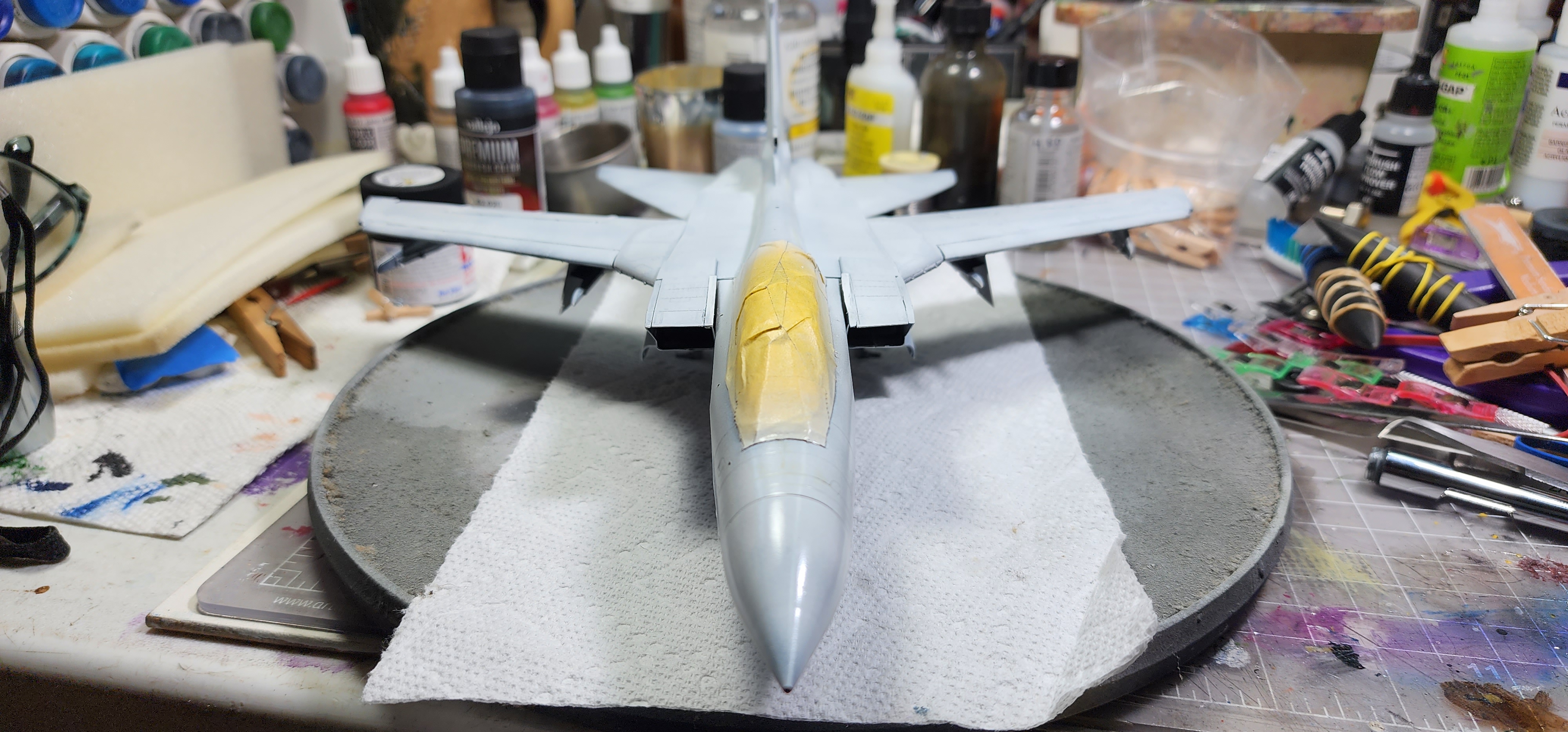

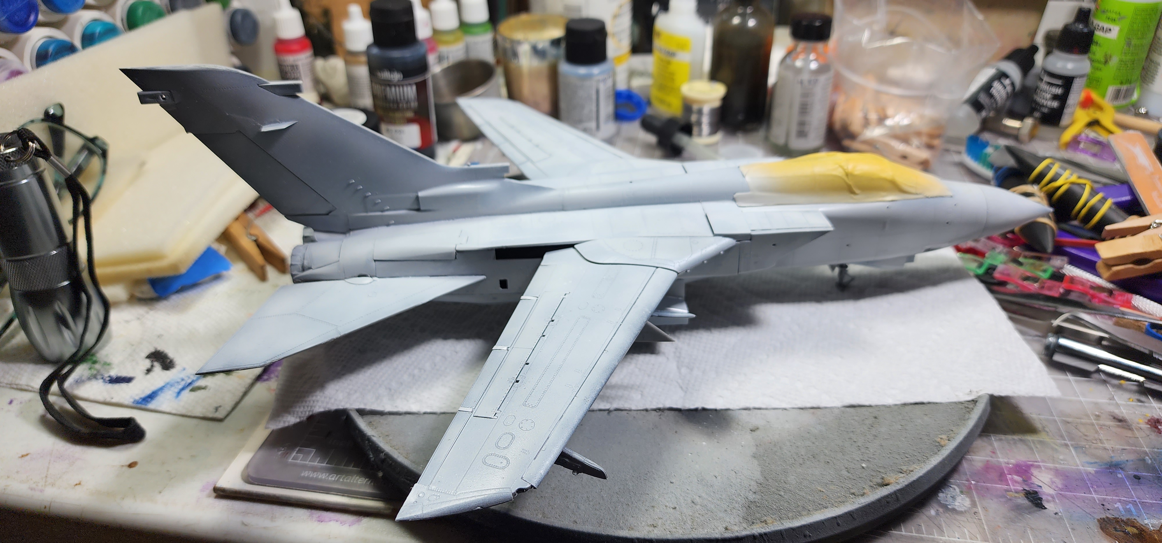

I have the plane body together. It was definitely a challenging build and I learned a lot along the way.
I have it primed in white at the moment just to get a solid color on it so I can see what needs to be attended to.
My workspace continues to shrink. I definitely have to do something about that LOL.
No pictures (I know, it didn't happen LOL). I filled in several gaps with sprue goo (does anyone else make and use sprue goo? This is my first experience with it). Everything looks much better. I actually took off the rocket mounts from the bottom of the wings since their rotating feature didn't work. Evidently the connecting rod inside the wing that makes them rotate came out of the slots. I will glue them in a fixed position, along with the wings. I sprayed Tamiya Flat Black mixed thinly with alcohol over everything to get a better idea if anything else need attention. I see one spot that needs some putty. I am relatively happy otherwise. I have really enjoyed this airplane. My best friend Ray was in the first Bush's Iraqi war. He was wounded (several times...he is a badass!) and was finally on his third and final wound medivac'd out to be "force" retired. He said while waiting for his flight, the Tornado's would land and take off and were the loudest things he ever heard. He said the F15's, 16s, and other US jets have a "sound", but the Tornado sounds like an Hell has opened up. Cool story. I love hearing his stories when he is willing to tell them. It is one of my greatest honors to be his friend. He was a tank commander and I build his tank with a figure that looked just like him as a Christmas present. Tangent story, his worst wounds came when he had to leave his tank, and was literally lying in the middle of a street on his back and the bullets were flying past overhead and he could hear them zinging. He was like "Well shit. Now what?" After a while he got up and ran to cover and was hit three times, but the badass that he is, he kept fighting. They finally made him get attention, but he said it took several of them to make him stop fighting. Man, can you imagine?! I was researching his tank and read that during WWII the tanks would come back and they would literally hose out the blood from the wounded and dead, then fill it with idiots and send it back out. I was talking to Ray about it and I said, "My God, can you imagine that?". He got quiet for a minute, and said, "I don't have to imagine it". I nearly cried. Ray is my hero. Literally.
I have stretched sprue, placed it in a gap or flaw, dabbed it with MEK and schmooshed it into the flaw with a putty shaper before.
It works well. My friend Frank keeps a bottle of dissolving plastic trees. Waste not, want not. His results cannot be disputed.

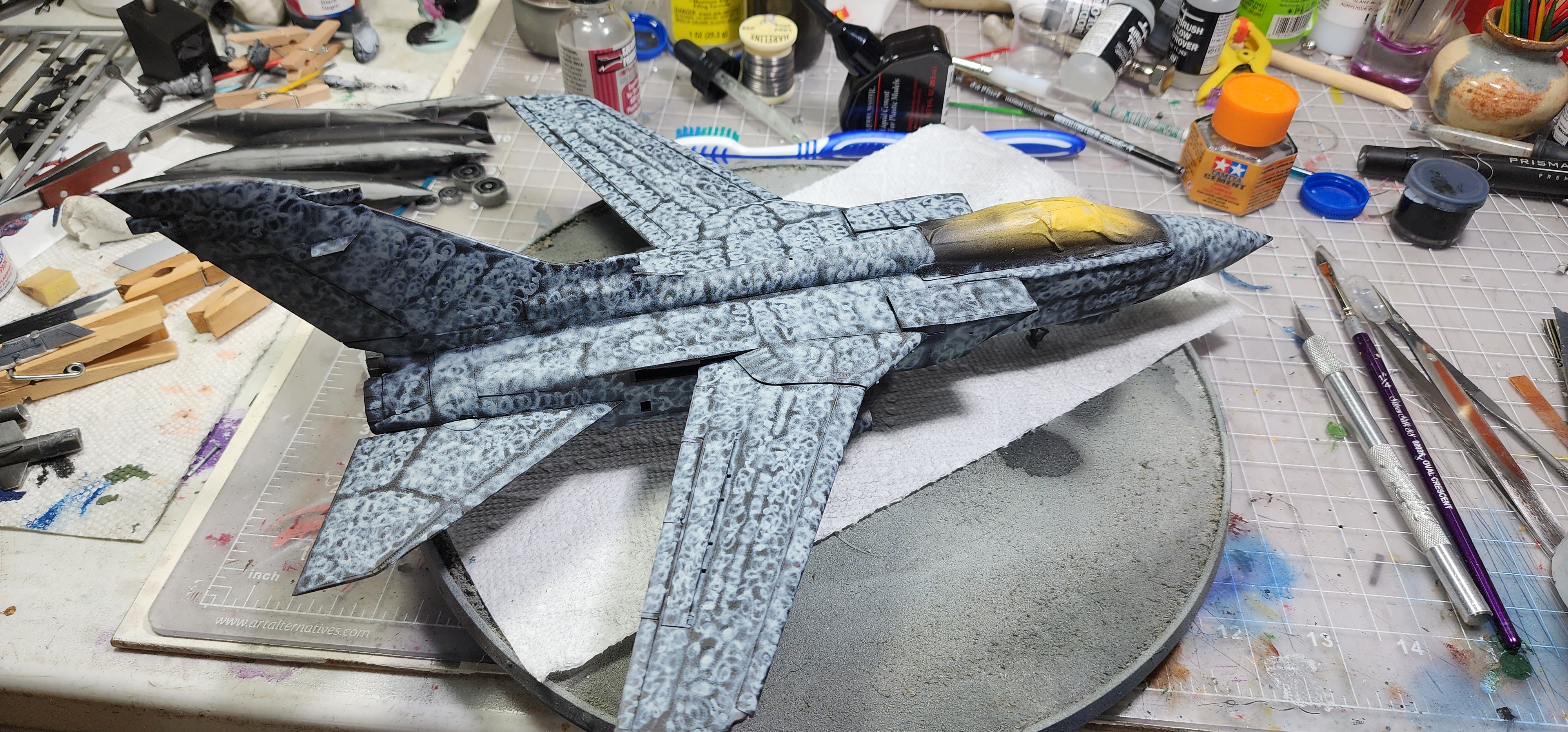

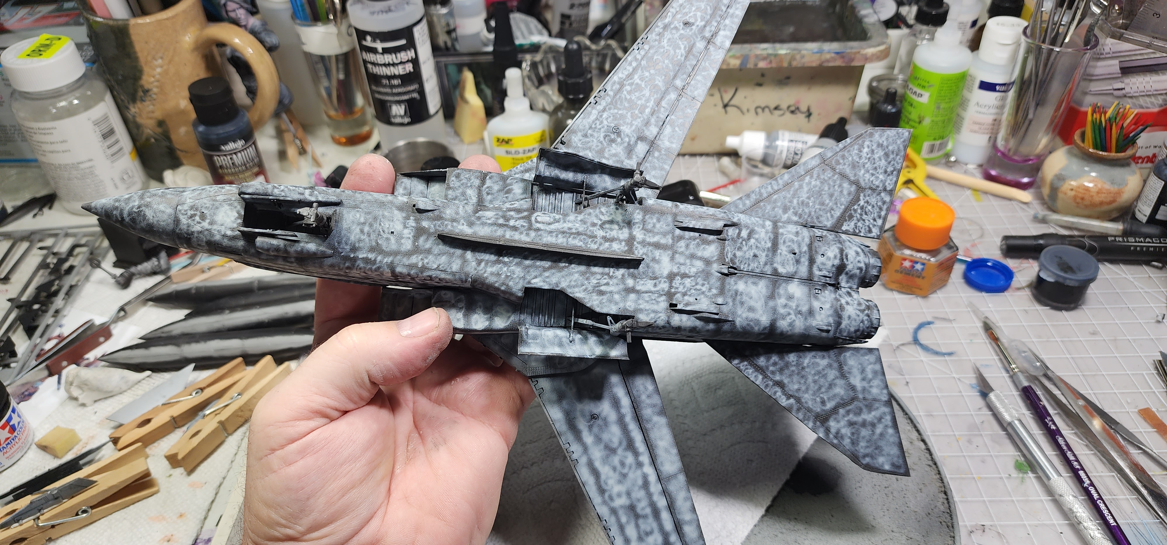

Marbelizing done. I hope this is the right way to do this. I primed with Tamiya Flat Black thinned 50/50. To marbelize the panels I used Tamiya Royal Light Grey mixed 40/60 paint/alcohol. I turned the pressure down to about 13psi, took off the needle guard, and got in close to make the smallest lines I could. Now to spray Tamiya RAF Medium Sea Grey overall in thin, light coats.

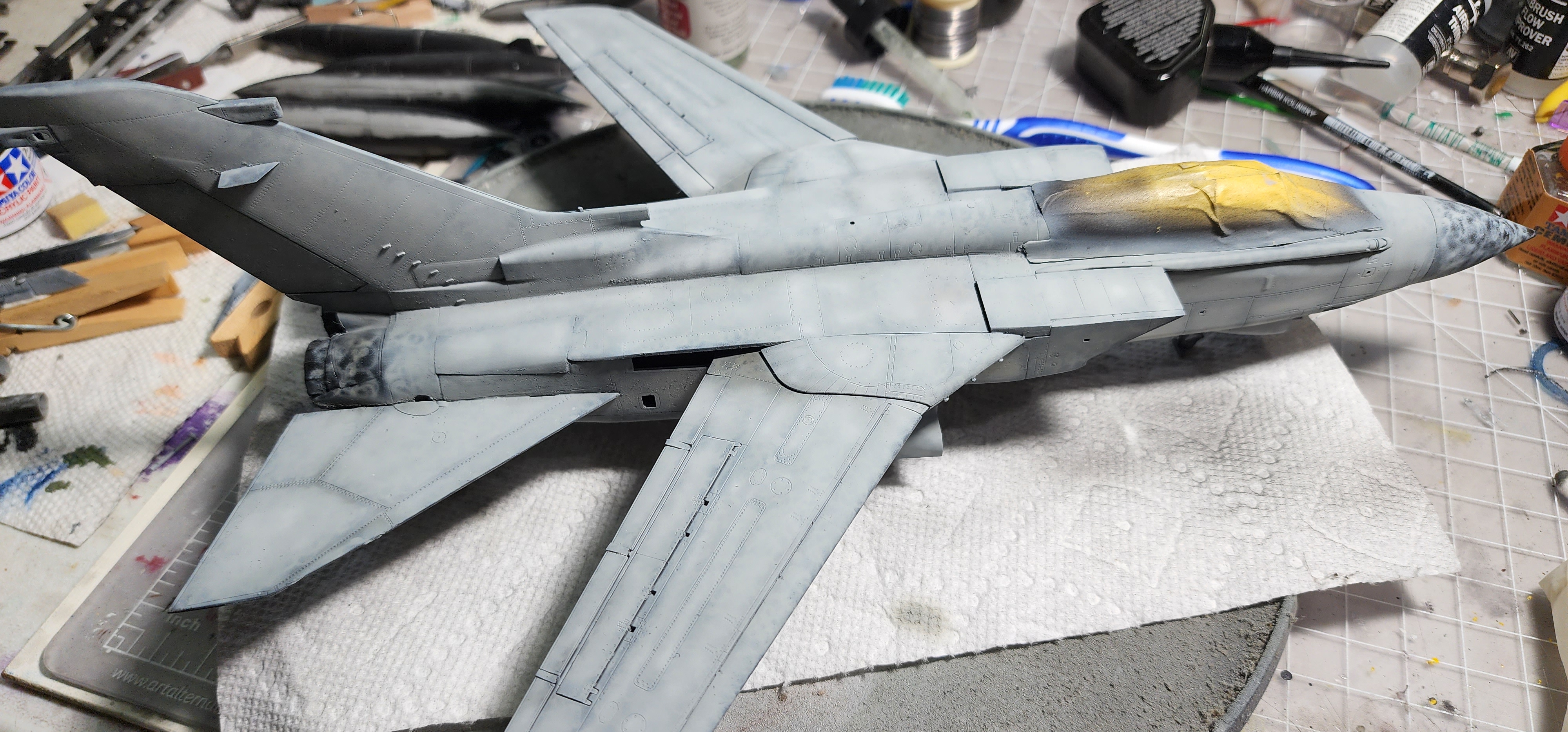

I sprayed Medium Sea Grey 2(RAF) over the whole plane, concentrating on the panel centers as much as I could see them. Next, and I probably didn't need to, I mixed Tamiya Smoke and alcohol to dirty up a few plaves and pick out some panel lines. I went back to the Tam Royal Light Grey mixed a little more thinly and tried to hit the centers to even out any over-splotchyness (yep, I made that word up) and it is coming together.
I have a major boo boo I hope I can address. If you look behind the swept wing you will notice a large opening. I always thought that was odd. Well, I completely missed a step inserting the pieces that go there, only realizing it when I went back through the instructions looking for paint color instructions. DOH!!! Since this is a trial run for my next one which is going to be amazeballs cool, I may or may not try to put the pieces in. I don't think it will be possible but may see what I can do.
ANYWAY! Next for the paint job I will paint the tail color decorations and exhaust metallics. Then the fun part... weathering!
You could get some alignment tabs from outside in, maybe? like put some plasticard on the inside of the opening then clean up the missing part to insert it from the outside, if you follow me.

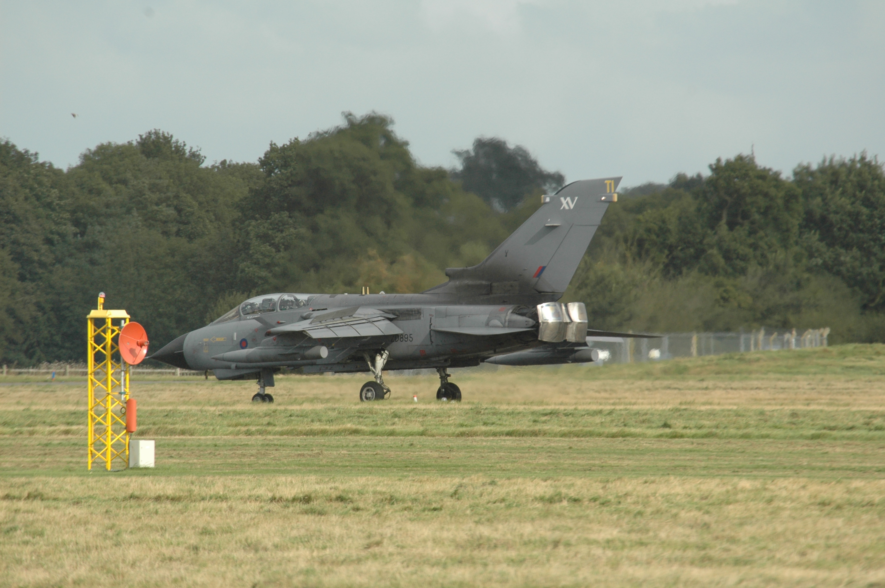

RAF Tonka's could land on a very short runway, they had reverse thrust buckets, thats why the tails were always dirty. Quite uncanny to watch, they would touch down and just stop
That one is actually on Tarmac, never really sure about field type landings, i saw an RAF Typhoon ( modern) set a field on fire with an afterburner take off once.

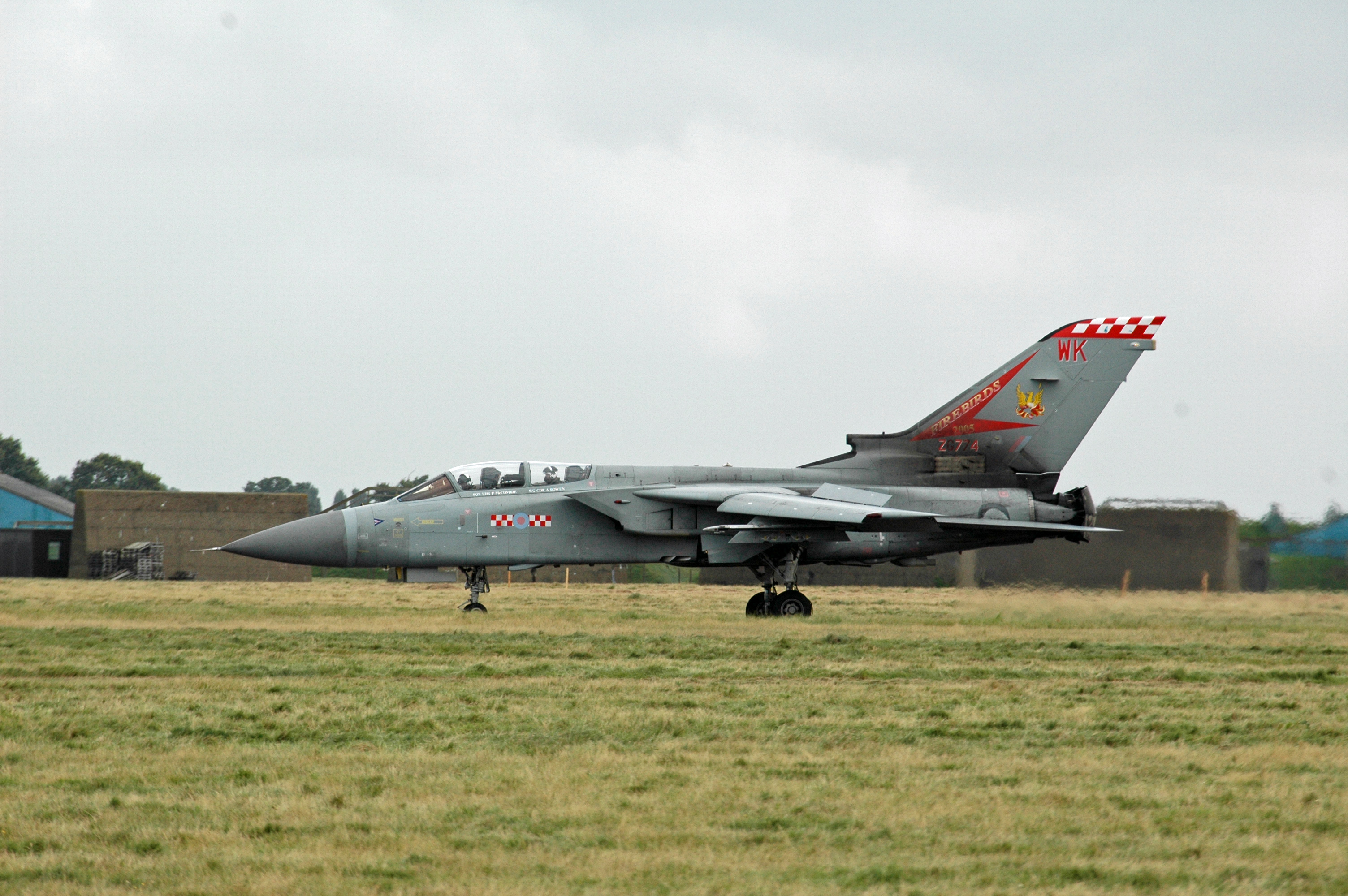

I dont want to hijack you build thread but it may interest others. this is a fighter version as Rich B says it has a longer nose.
again with buckets out. Pretty sure i took these at RAF Colitishall in about 2006 , The F3 variant seen here was retired in 2011 and replaced by the Typhoon as the UK primary interceptor.

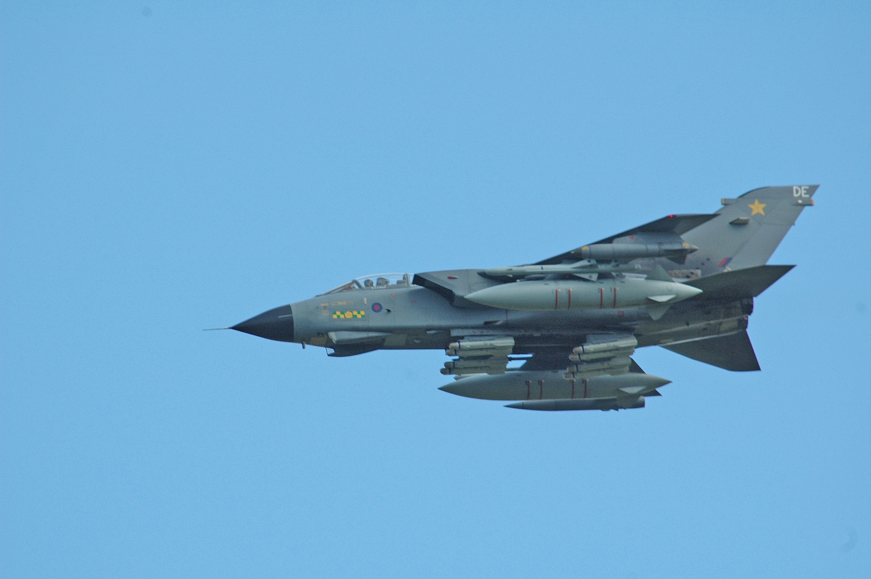

A pretty heavy load out on a GR4 , would make a good competition to identify what its carrying. this was probably at Coltishall as well at about the same time as above (Coltishall shut in 2006 as it was the Jaguar base and they were fazed out in 2007).
