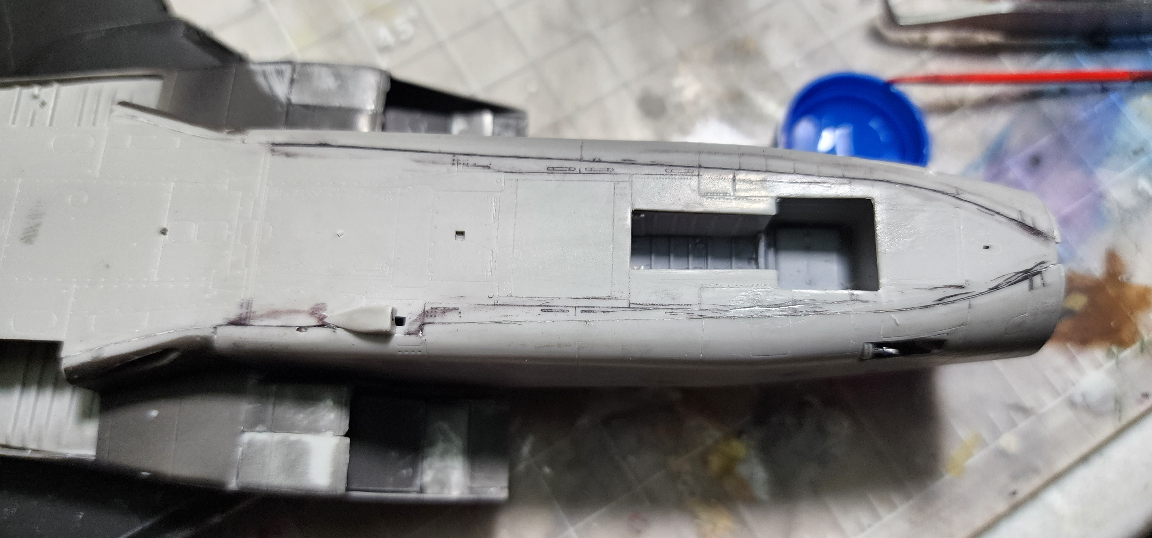

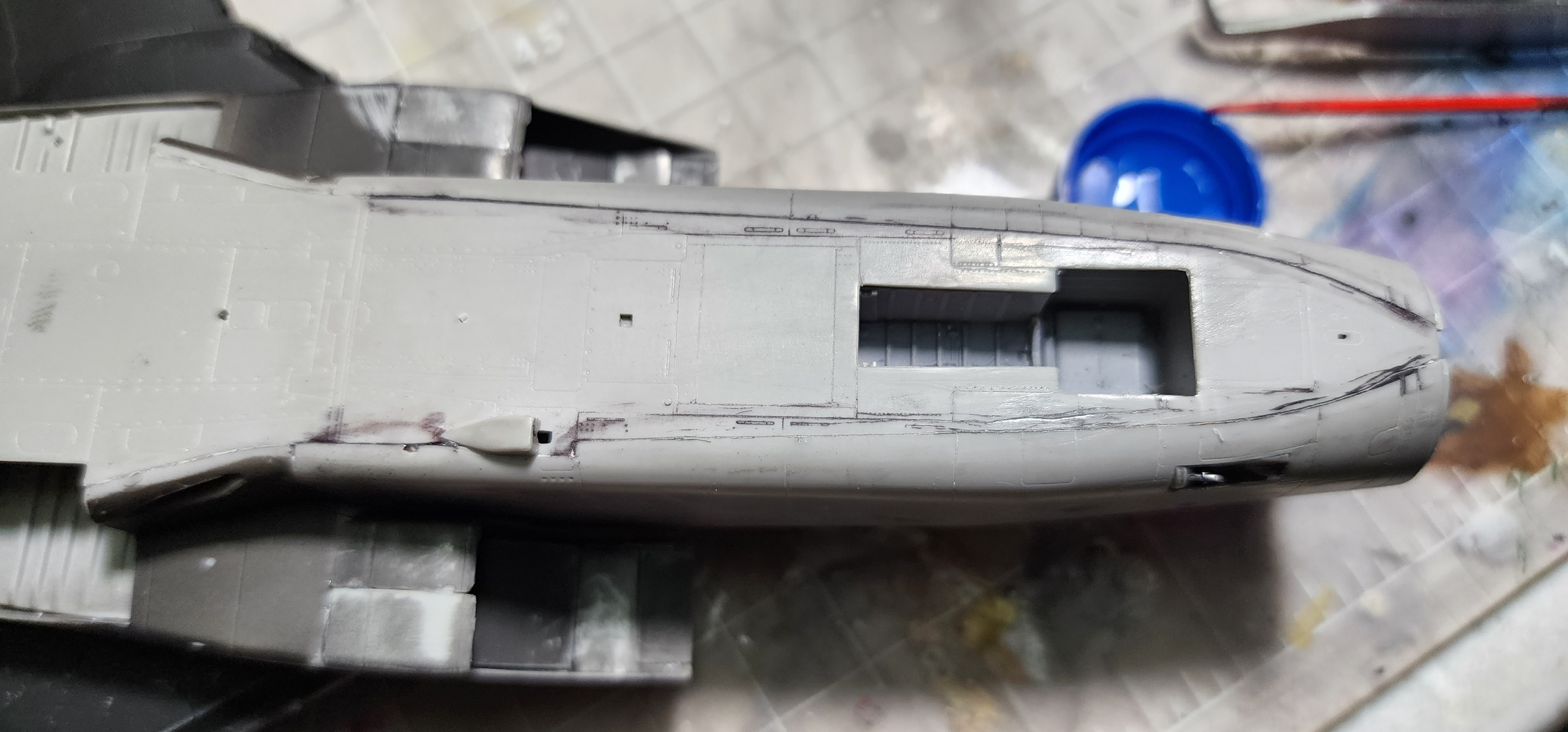

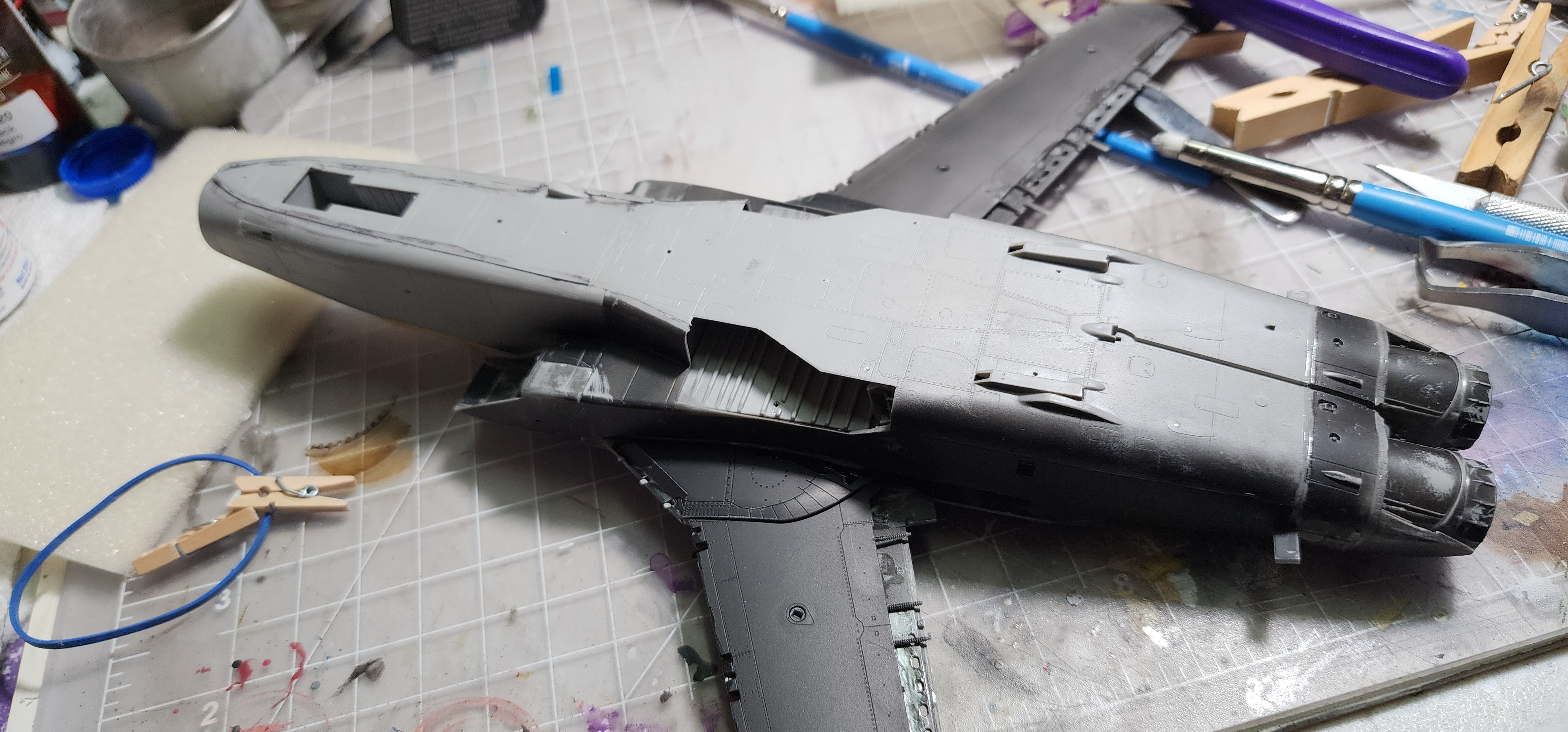

Still looks like some gnarly seams to seal up.
YepStill looks like some gnarly seams to seal up.![]()

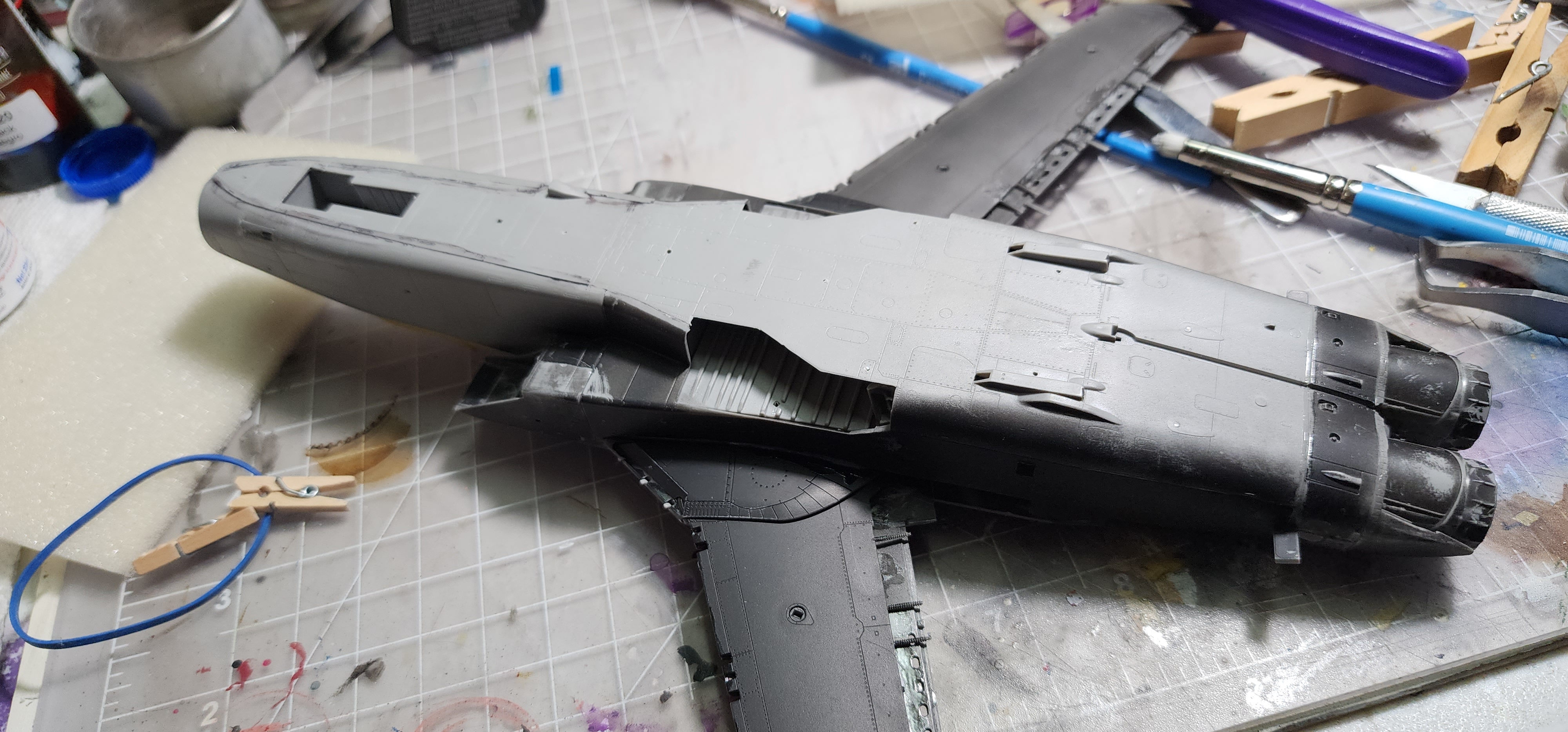

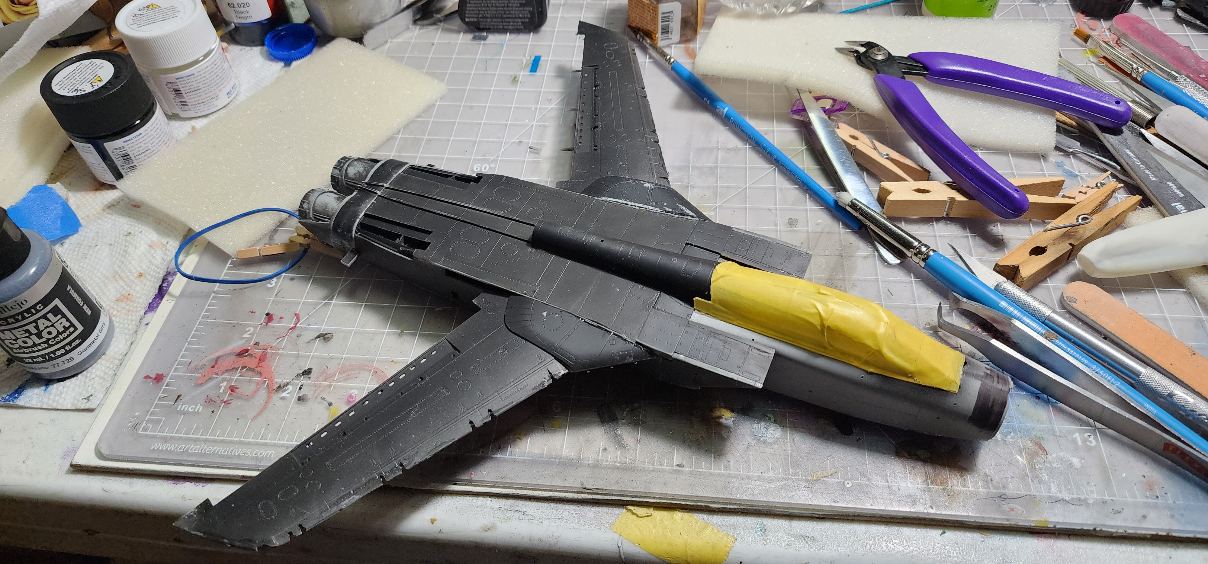

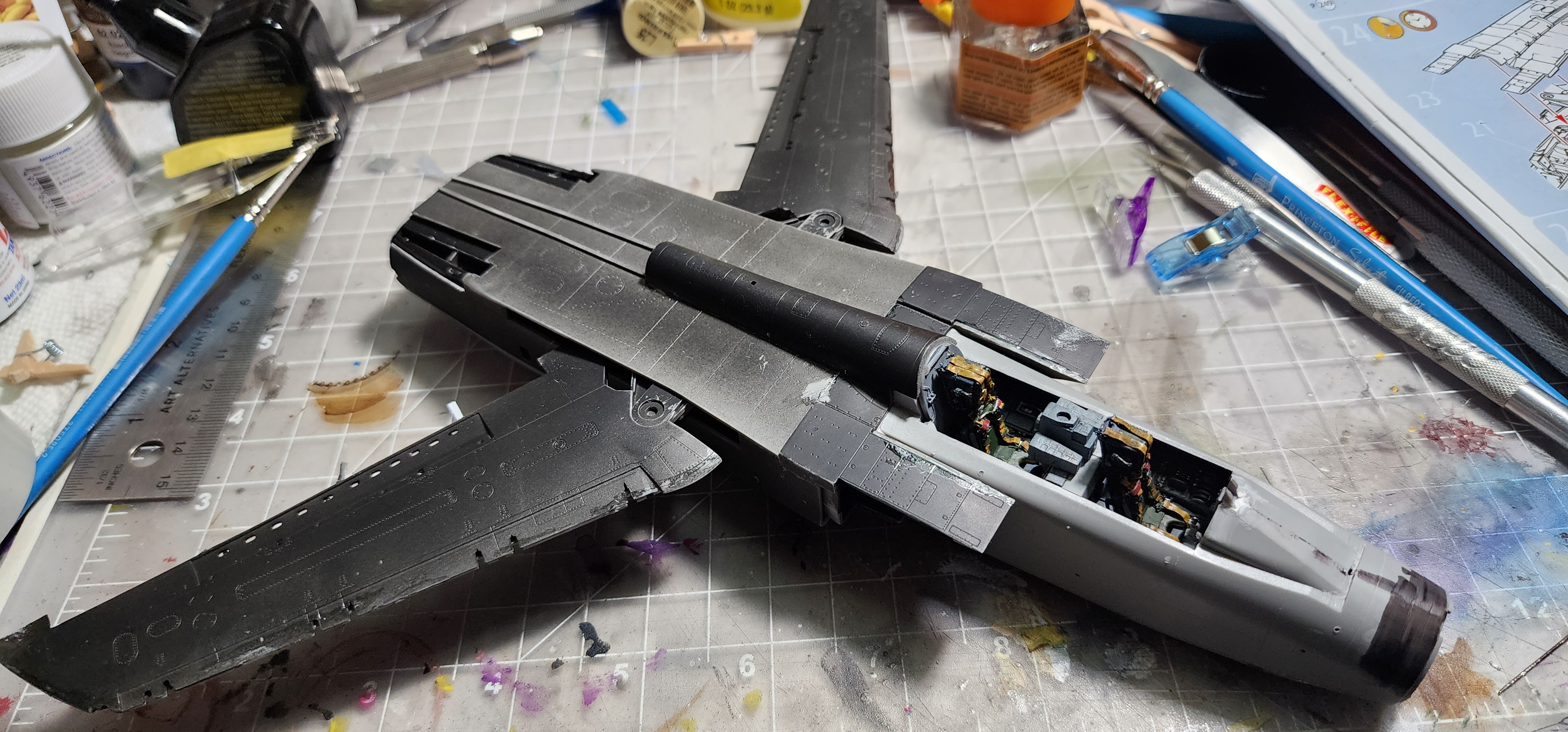

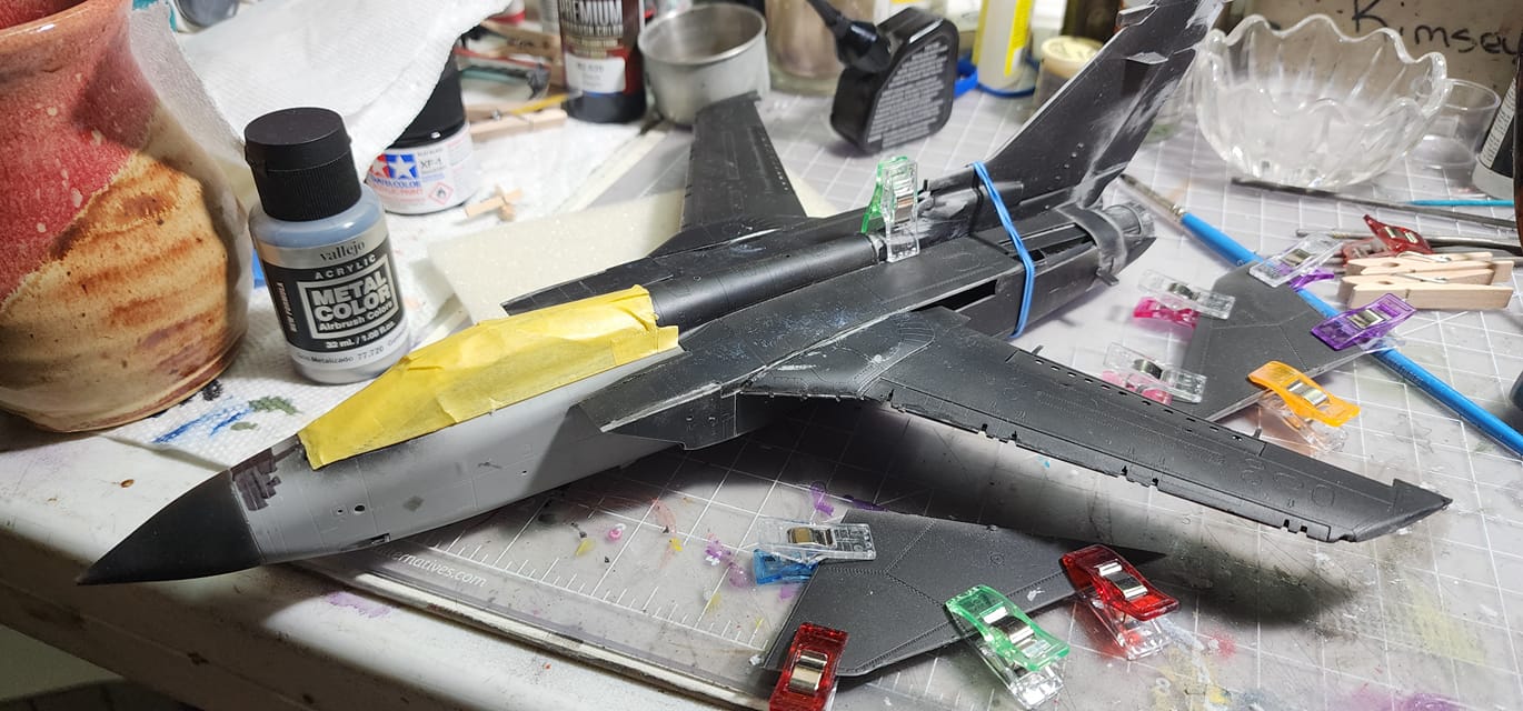

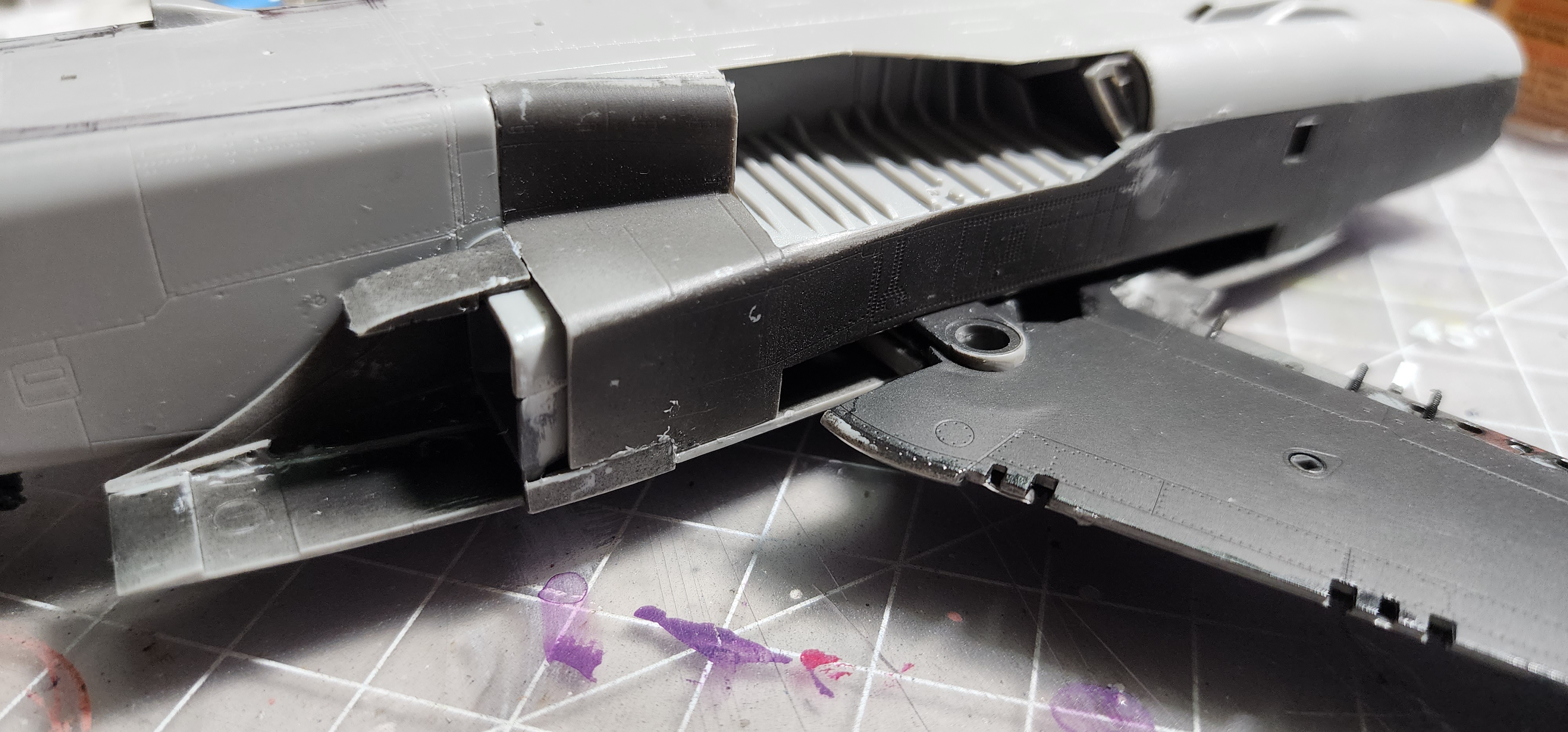

Good to know!! I will def do that next time, although this all sanded down easily enough. A lot has happened as far as progress. It is all very slow with lots of test fitting and adjusting. This is BY FAR the most complex model I have ever built, and there are definitely going to be some areas that show I may have been over my head a little. A LOT of seams just butt up to each other. How the f#@& do you hold a three inch section of seam together and straight at the same time?! Anyway, I will shiw some shotsbof where I am with it.I like to mask both sides of the gap being filled to make sure the filler doesn't slobber all over. My gaps usually get filled with dots of super glue but my usual model is quite a bit smaller than your Tornado.
Looking good so far!![]()
Very slowly. Only work one inch at a time, or a half an inch. Lots of tape! Don't try to get the entire seam in one swoop.How the f#@& do you hold a three inch section of seam together and straight at the same time?!
Excellent! Good to know. Saving that for next time. Thank you!Very slowly. Only work one inch at a time, or a half an inch. Lots of tape! Don't try to get the entire seam in one swoop.
Are you wet or dry sanding?Good to know!! I will def do that next time, although this all sanded down easily enough. A lot has happened as far as progress. It is all very slow with lots of test fitting and adjusting. This is BY FAR the most complex model I have ever built, and there are definitely going to be some areas that show I may have been over my head a little. A LOT of seams just butt up to each other. How the f#@& do you hold a three inch section of seam together and straight at the same time?! Anyway, I will shiw some shotsbof where I am with it.
I have a feeling that I will learning how to scribe a lot of new lines after all the sanding is done!
Both. Mostly dry.Are you wet or dry sanding?
Brilliant! I only have the Squadron brand putty in my store. I will get Tamiya also.I've found Perfect Putty is handy for filling small gaps and clean up w/ an alcohol dipped cotton swab before it fully sets. I prefer the grey Tamiya putty if there is any blending involved though as it seems like the solids are more finely ground than the PP.
No wonder! Wet sanding helps flow off the removed material without clogging the abrasive you are using. I sometimes wash my sanding sticks with soap and warm water to rinse out the stuck stuff. Wet sanding allow you to take a smaller "bite" while you remove and smooth. DO NOT RUSH the sanding. It can be very therapeutic to sand-wipe-look-cuss-mix a drink, repeat.Both. Mostly dry.
If you repeat "the process" enough times and find your eyes don't focus and you just giggle a lot, take a break!I guess I was concerned that if I got too much water in the cockpit that the work I did there would be messed up, so I just dipped my sanding stick in water to get it wet. There was a lot of dry sanding also with the flexi-file over the rounded parts. Don't worry about underestimating my skill set LOL. What I DO know wouldn't fill a thimble half full. Thank you for the info! I honestly appreciate it very much!!No wonder! Wet sanding helps flow off the removed material without clogging the abrasive you are using. I sometimes wash my sanding sticks with soap and warm water to rinse out the stuck stuff. Wet sanding allow you to take a smaller "bite" while you remove and smooth. DO NOT RUSH the sanding. It can be very therapeutic to sand-wipe-look-cuss-mix a drink, repeat.If you repeat "the process" enough times and find your eyes don't focus and you just giggle a lot, take a break!
Now! I don't want you to think I underestimate your model skillset. I do not wish to sound overly simplistic. I am NOT an expert. I have made almost every model-mistake there is to make. These tips and tricks work for me. You can choose your favorites for your very own model making.
