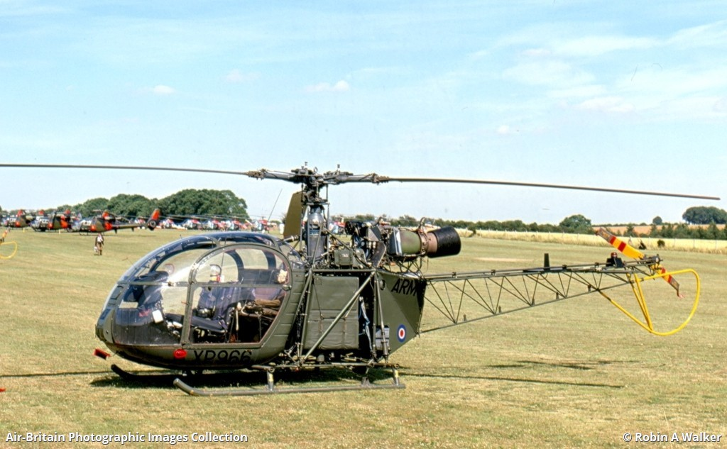

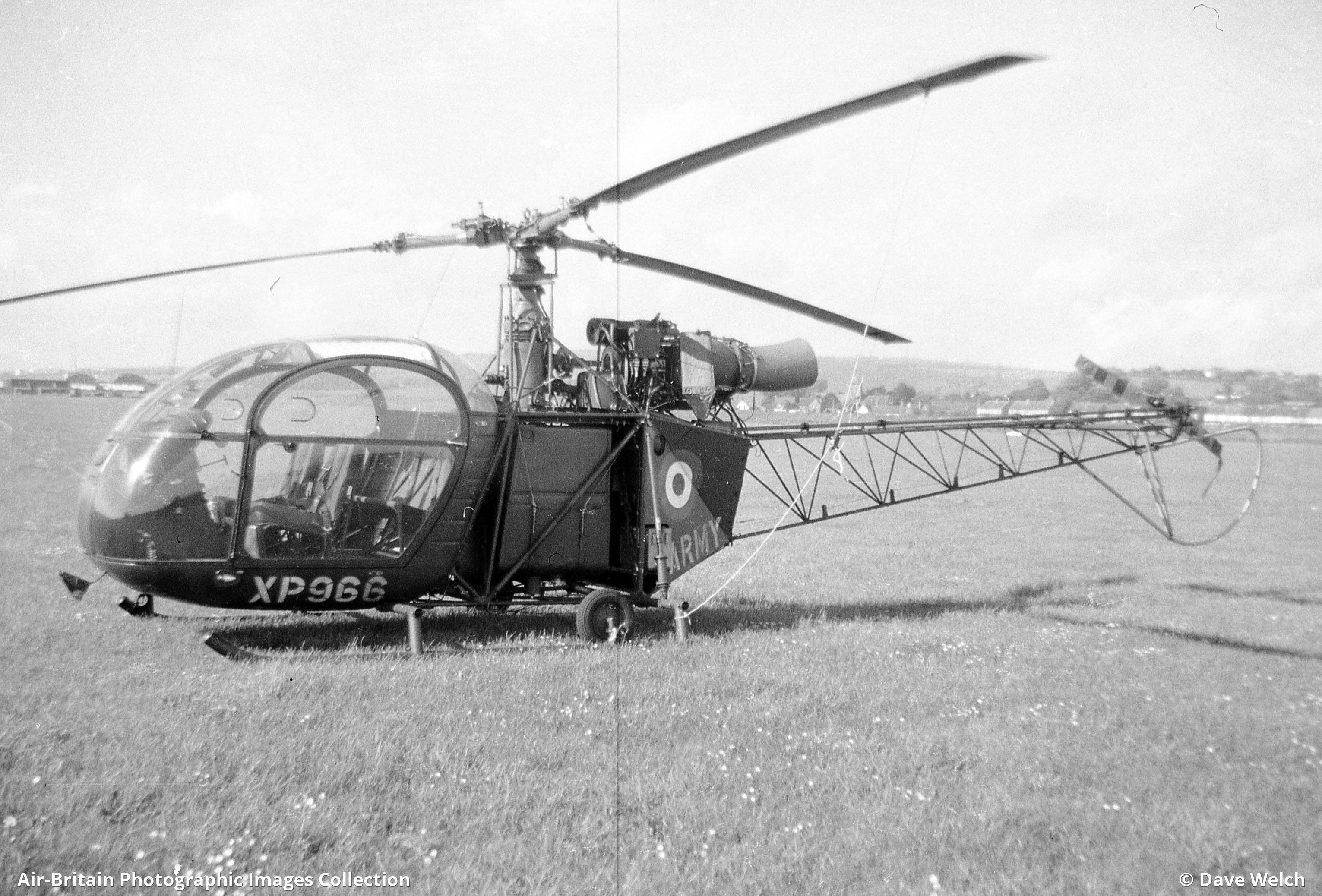

XP966 in 1964 and 1976

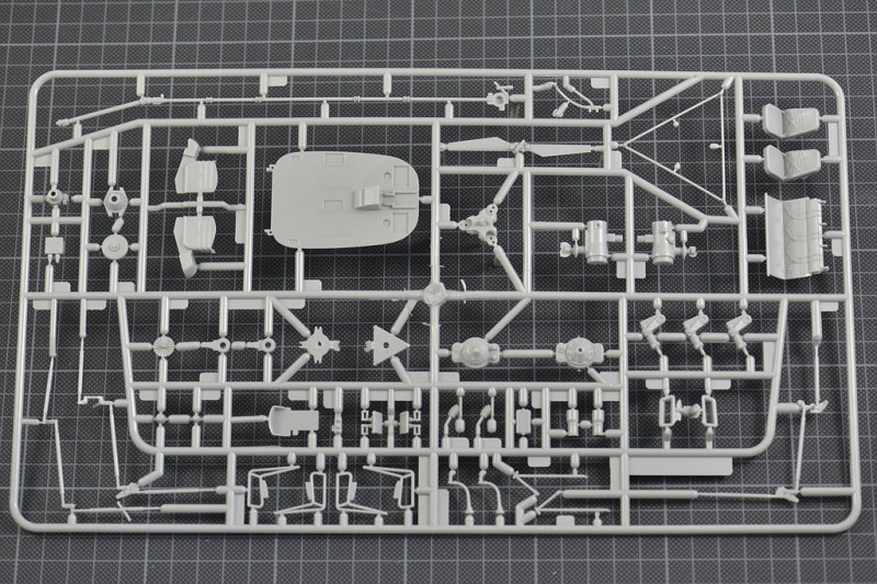

This is Revells 1/32 Aerospatiale Alouette II From 1996 . A quick look at Britmodeler for advice, (I got chucked of that site so I can only look) shows about 7 build blogs over 11 years and all of them stop halfway through, in other words, hardly anyone has finished one ( or they carry a curse, and no one survived long enough to finish one ?).
Warnings are plentiful about the glazed cockpit, the impossibility of getting the doors to open and shut and the general fit of parts……we shall see .
On a brighter note, 😊I don’t remember buying this, it’s a very early (very squashed) boxing dated 1996 and inside are a couple of bits of eduard PE…. And some yellowed decals. This version of the model is no longer available now so well done me for buying when I did and forgetting about it for 20+ years. A bit of research shows the British Army did actually buy 16 of these in 1959 as a stop gap because of delays in the British Westland Scout entering service , some of those 16 flew on till they retired in 1988 and were replaced by the Gazelle. One original still fly’s with the Army air corps historic flight over here but there are still dozens flying on the Civilian register in Europe.
DSC_0735.JPG 14332-248385.jpg 14332-248384.jpg 14332-248383.jpg s-14332-248386.jpg
The kit option is for German markings but as i say the decals are toast anyway so i am sure i can find something to represent the British army.

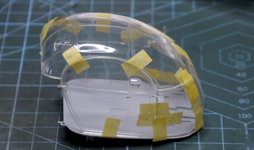

First thing was to mock up the canopy as this seems to be the issue won other builds. Maybe i am lucky or maybe my early model is better than the later re issues but while i can see its not going to be easy, i dont see anything insurmountable at thisn stage
There is actually 8 pieces to this and no location tabs on anything so i can see each part needs the previous part to be positioned correctly and you wont know that till you fit the 2nd 3rd 4th part etc. You could get 6 parts fitted and working then find the 7th part needs everything to move back .5mm :)..forewarned is forearmed as they say :)
With such a large canopy and an exposed engine and rotor head i can see this thing will be as good as you make it. The kit itself just supplies the basics, rest is up to the builder.

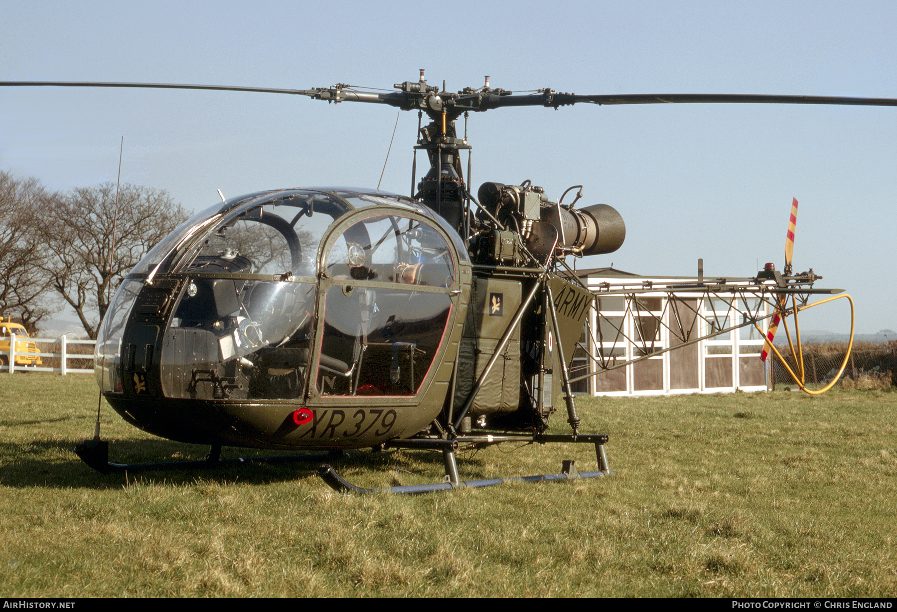

Alouette colours are odd. they range from RAF Green to olive drab and even 3 diferent greens. I
in fairness the army/RAF were always changing base colours over the decades so i will go with this which is a picture from 1971 as can be seen by the old Bedford truck behind :) as this is an in service picture, not a restoration.
just got to work out what colour this actually is ? Olive drab maybe ?
@paddy, your approach, handling the clear parts first, is the way since all fit issues can be handled working on the more flexible opaque plastic. I learned this on my Dragon (DML) OH-6 kits.

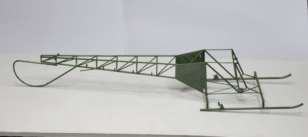

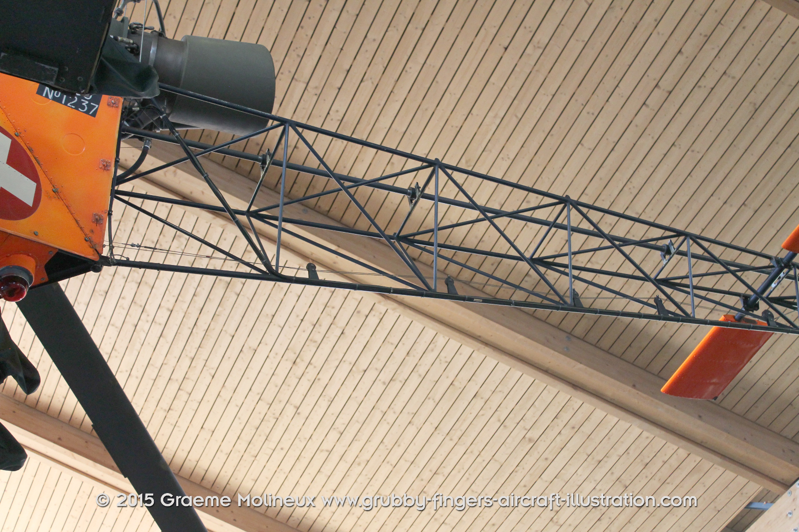

Not sure why the guy went for a brass tail unless he was correcting a fault but by going for 1mm ands 0.9mm i think he created a fault.
The kit is 1.4mm and 1mm which is proportionately nearer the differential in size of the main frame v the bracings'
To scale the original plastic would be 44mm which 1.3/4" which is quite believable ? I have seen 1/48 choppers where the tail boom is way to thick but this seems fine to me in 1/32.........there is a challenge. What were the true dimensions ?.
