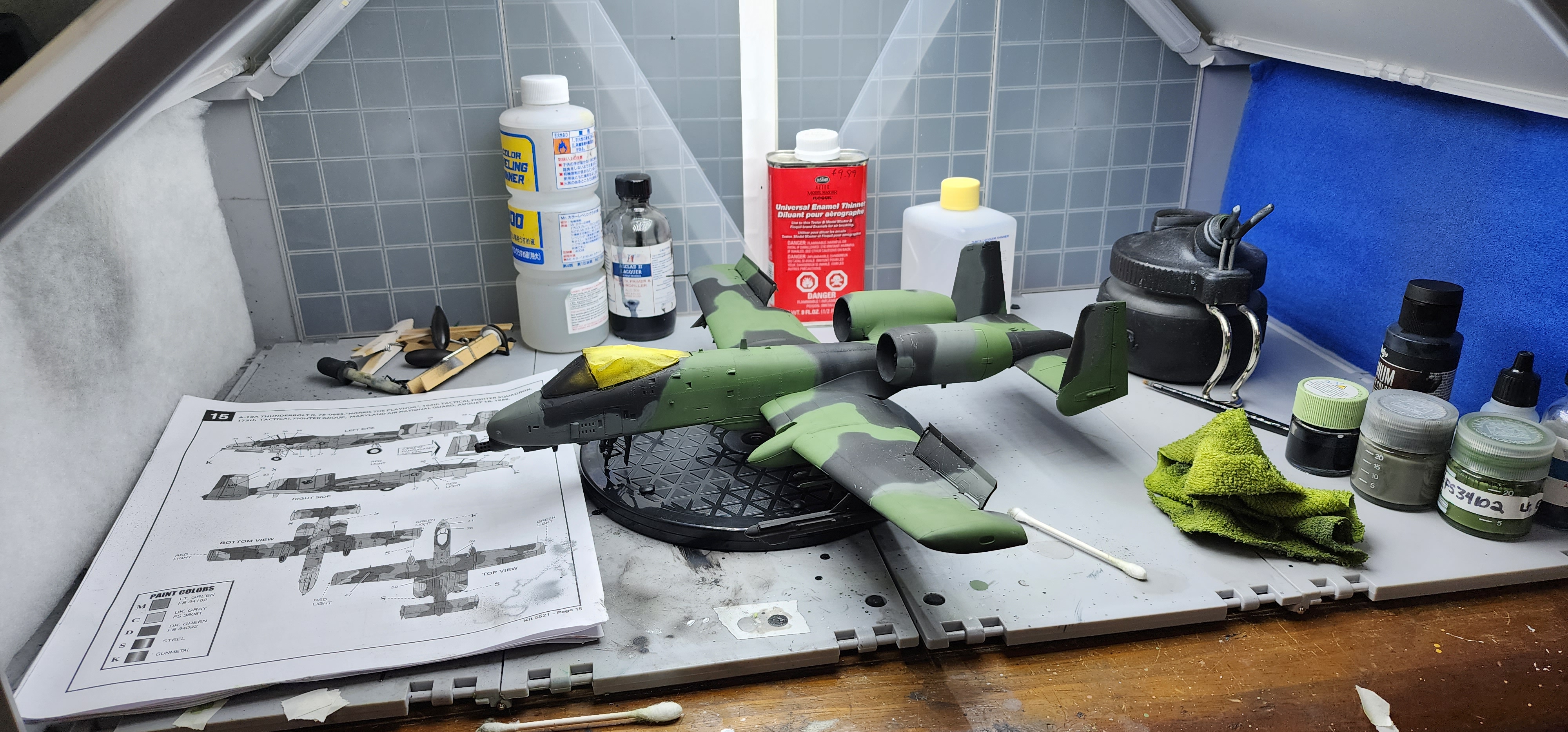

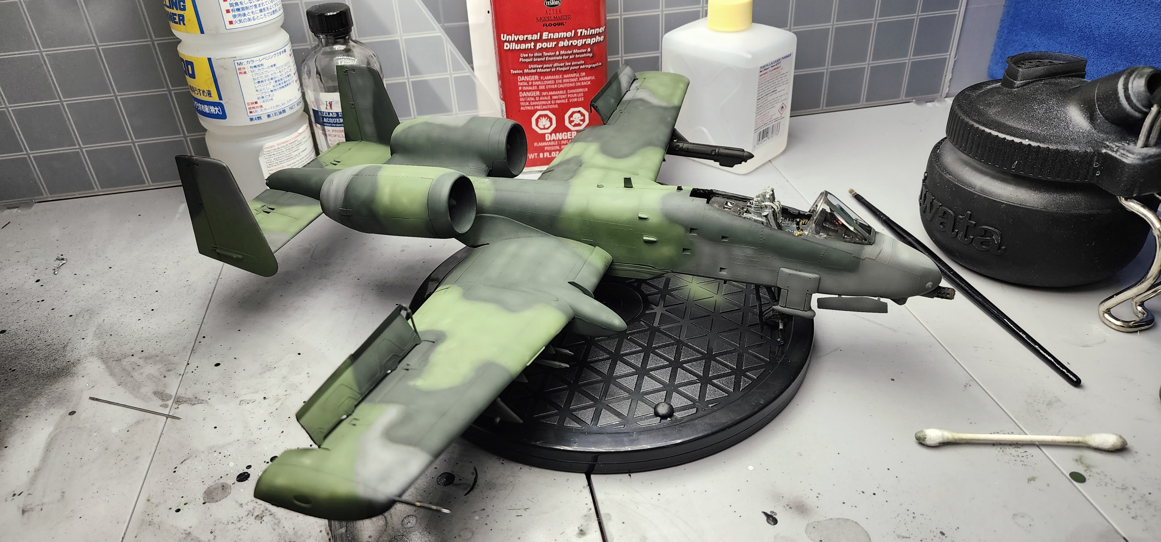

Here she is in the hanger bay with two colors based in:
We will see if I get to work on her tomorrow. Happily, the new parts for the airbrush have it behaving beautifully. I knew there would be extensive spraying so I gave Gail's sensitive nose a break by thinning with alcohol. Although, the activated carbon filters I put in the spray booth seemed to have done the trick collecting odors, I knew lots of overspray would not be filtered.

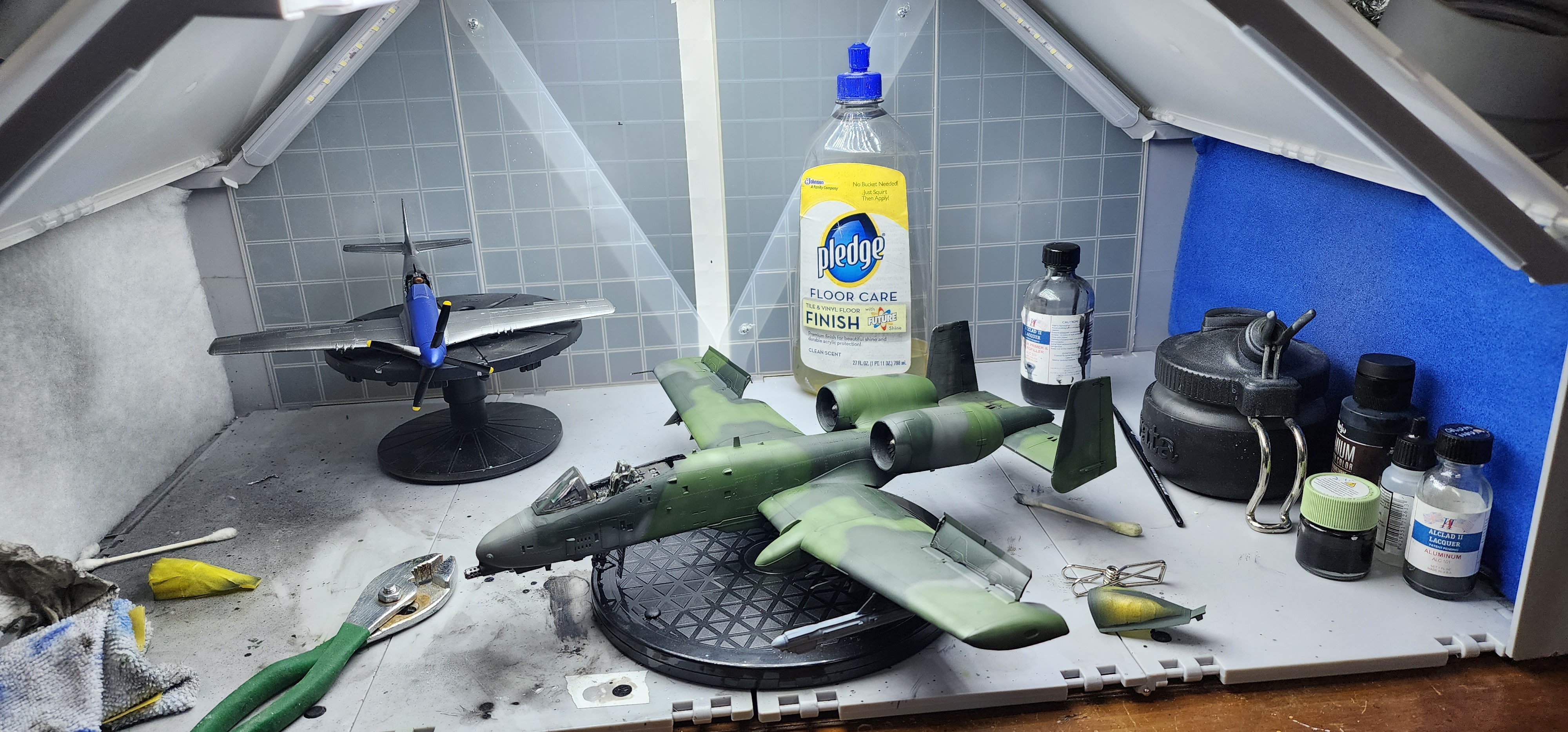

I got the third color on, but actually mixed it a bit darker than the formula said. Also, using this reference, I mottled the colors quite a lot.

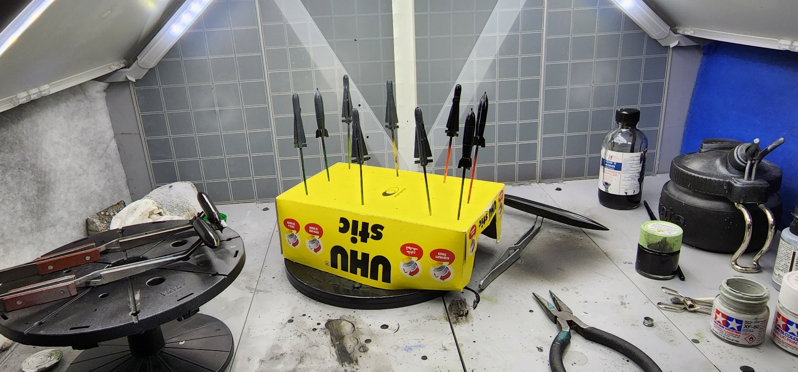

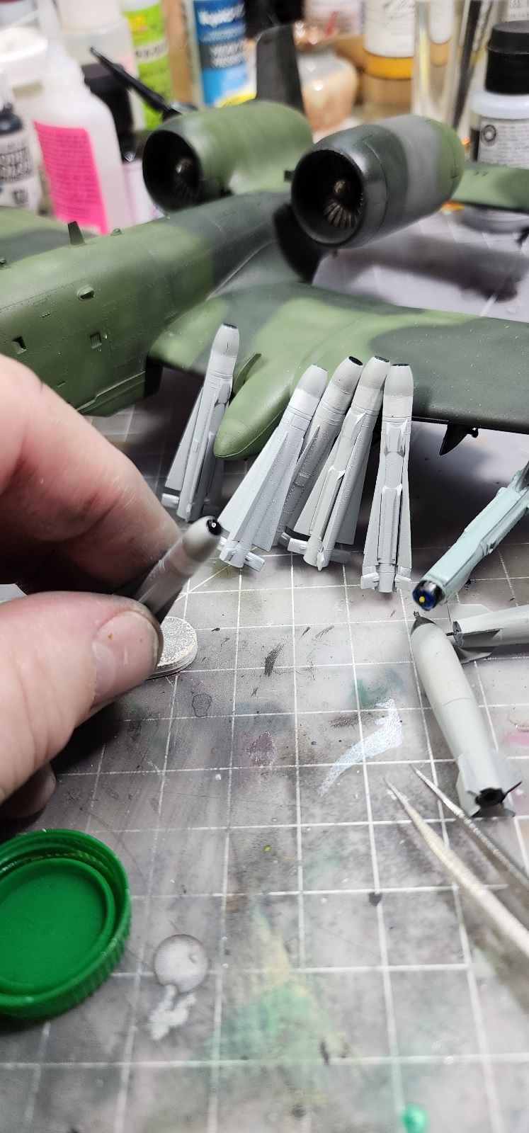

So, yesterday did not turn out like I expected. Rather than a decal decathlon I got all of the bombs, missiles, and whatnot ready for decals. I still have an issue sanding the seams, and always make a flat area on a round object. They look OK though. I stuck tooth picks up their butts and made a little holder for them out of an old box. I then painted and painted and painted in the airbrush booth.

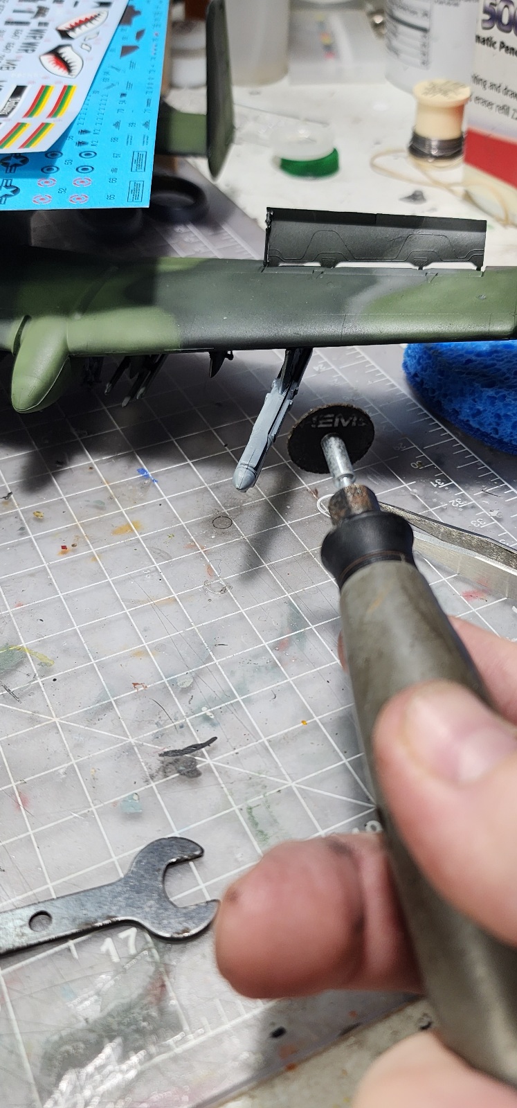

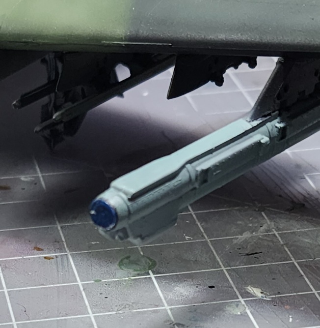

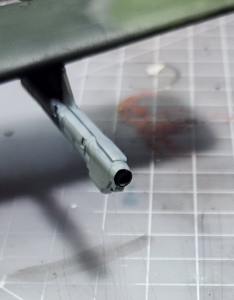

I was looking at my references and thought that the jammer under the port wing was supposed to have a glass front, so I cut off the front tip.

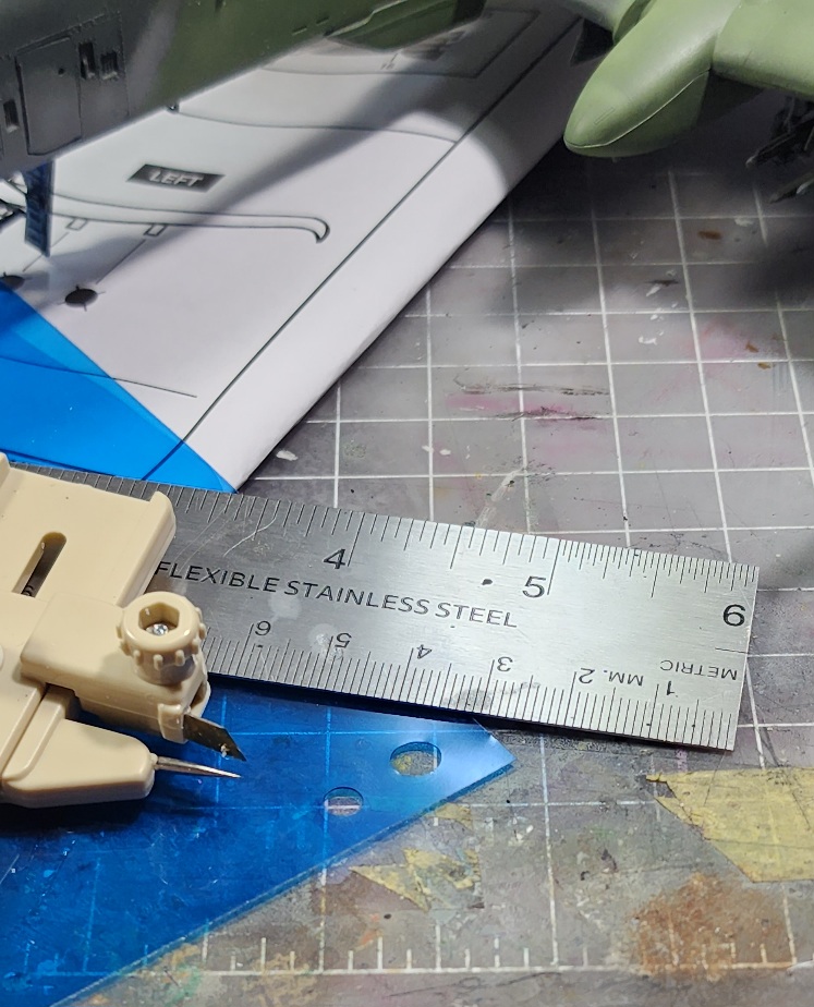

I painted the plastic after sanding. I then cut a tiny circle out of a colored film with my dandy little circle cutter.
I glued that to the front, then used my fly tying resin and made a bubble of "glass".
It turned out that I was looking at the Maverick missiles. So, the jammer has a glass front. No biggie. So I did the same to the actual Mavericks.
Anyway, the bombs and whatnot are all prepped and ready for decals and distressing.
