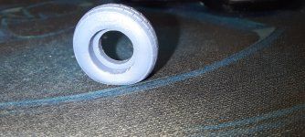

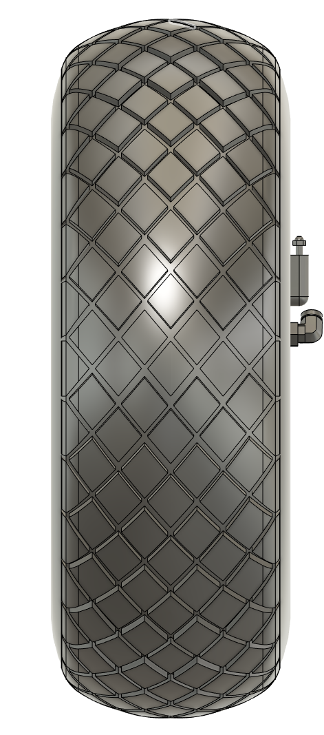

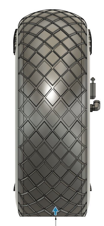

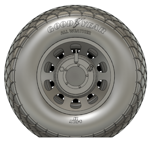

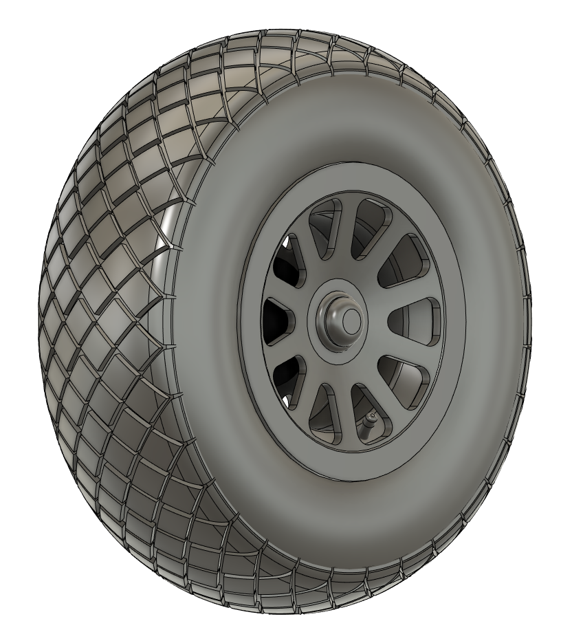

Still struggling with this tire tread profile, it has proven more difficult than I thought. But I think Im happy with this one. Maybe once I get more familiar with the way the program works I will revisit it.

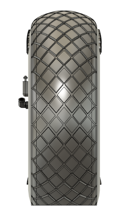

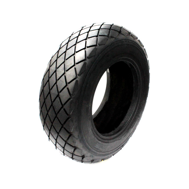

This is a new mustang tire in current times....did the 1940s version look like this...After consulting all my books, Id say it does. For the diamond tread. I'm having problems getting the very outer diamond to contour to the tire. So I made a compromise. I made a profile to shave the outer edges to give it a wear look. I may give the edges a slightly more wear look. But I need to see how this prints first.

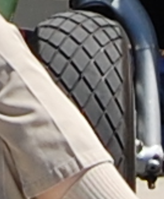

This pic is a tire after some use.
I kinda tired of getting hung up on this particular tread pattern. I have a few more treads that were common to the mustang to do. And Im getting itchy to build a mustang with my parts.

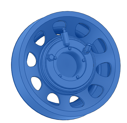

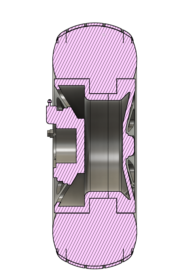

And for those interested, here is a cut away of the assembly. The hub is two pieces, for ease of painting. When assembled in the tire it will look like a solid hub. I hope!

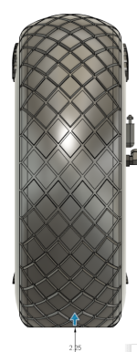

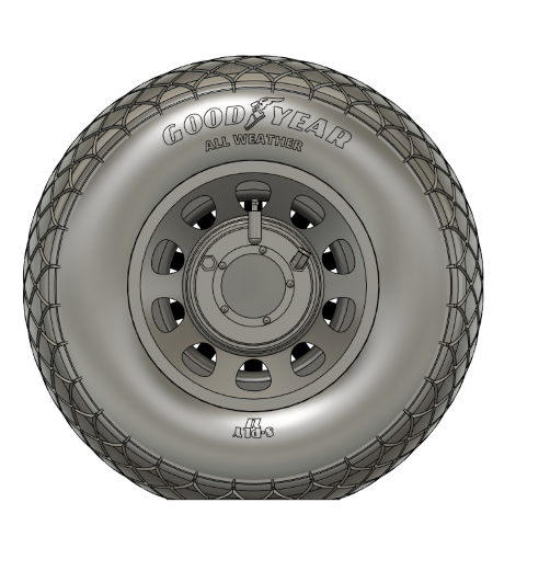

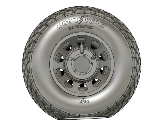

Need some input, Here I have worked on cutting the bottom of the tire to give flatness. It starts at 2.25mm removed, up to 2.75mm. I can go more or less. Also added logos and such.
2.25endresize.PNG2.25resize.PNG2.50endresize.PNG2.50mmbottomcutresize.PNG2.75resize.PNG2.75sideresize.PNG
Information Overload
Staff member
It all depends on the weight of the aircraft. Less removed if the aircraft hasn't been fueled or armed (example, returned from a sortie) or more removed from the bottom if displayed as fully fueled and/or armed.
In other words, go by photographs.

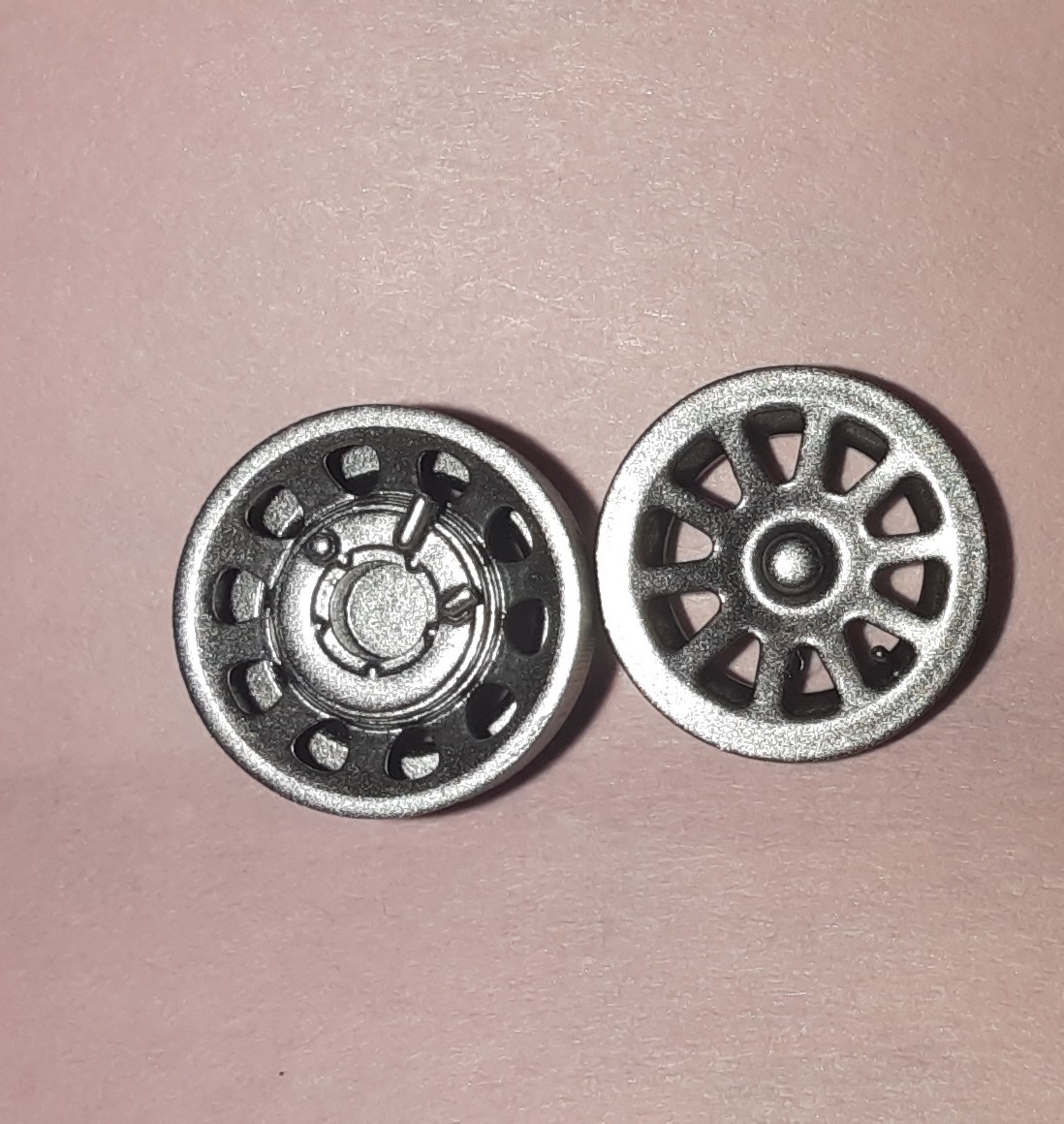

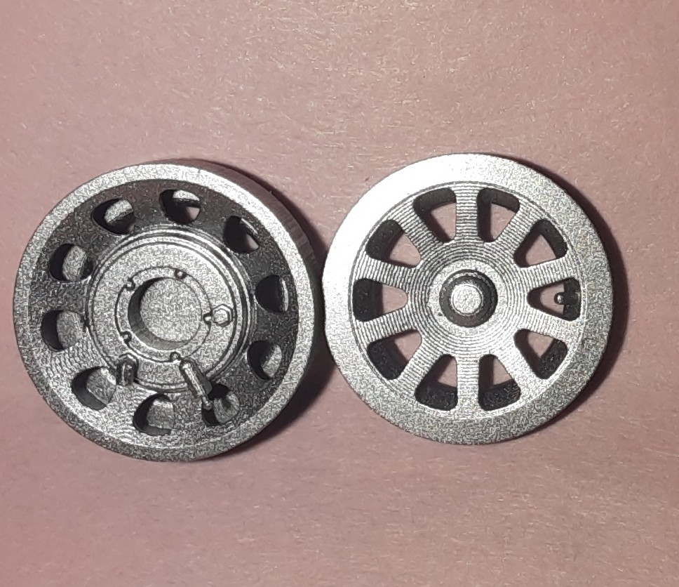

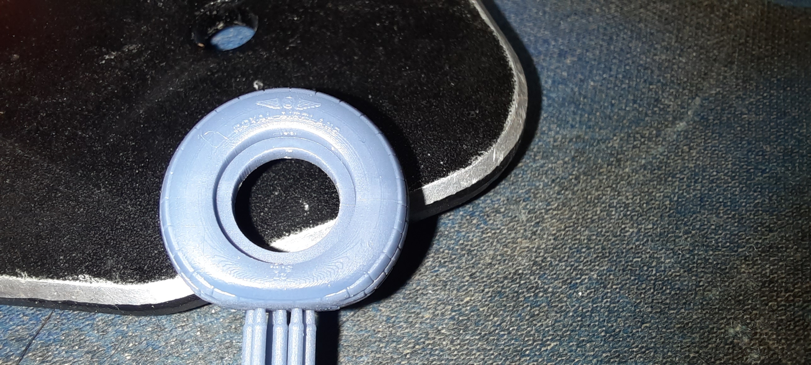

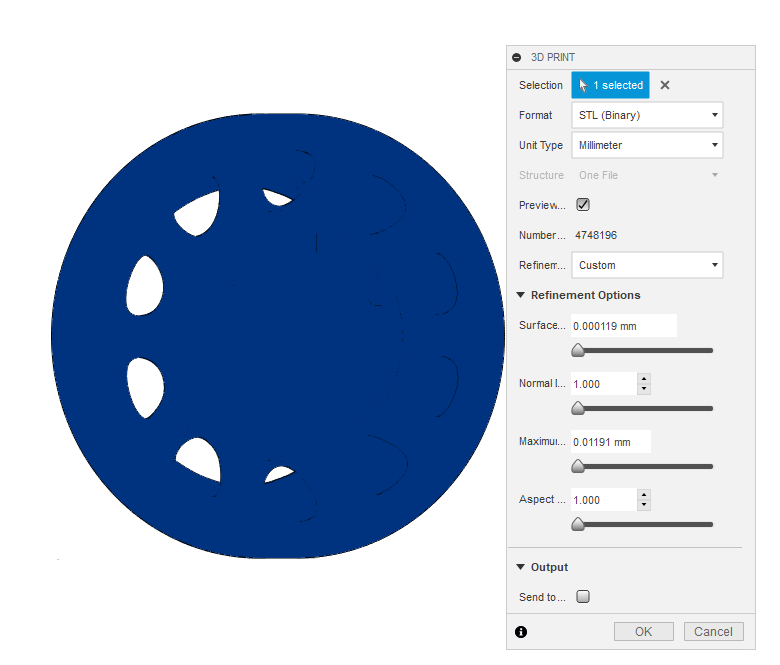

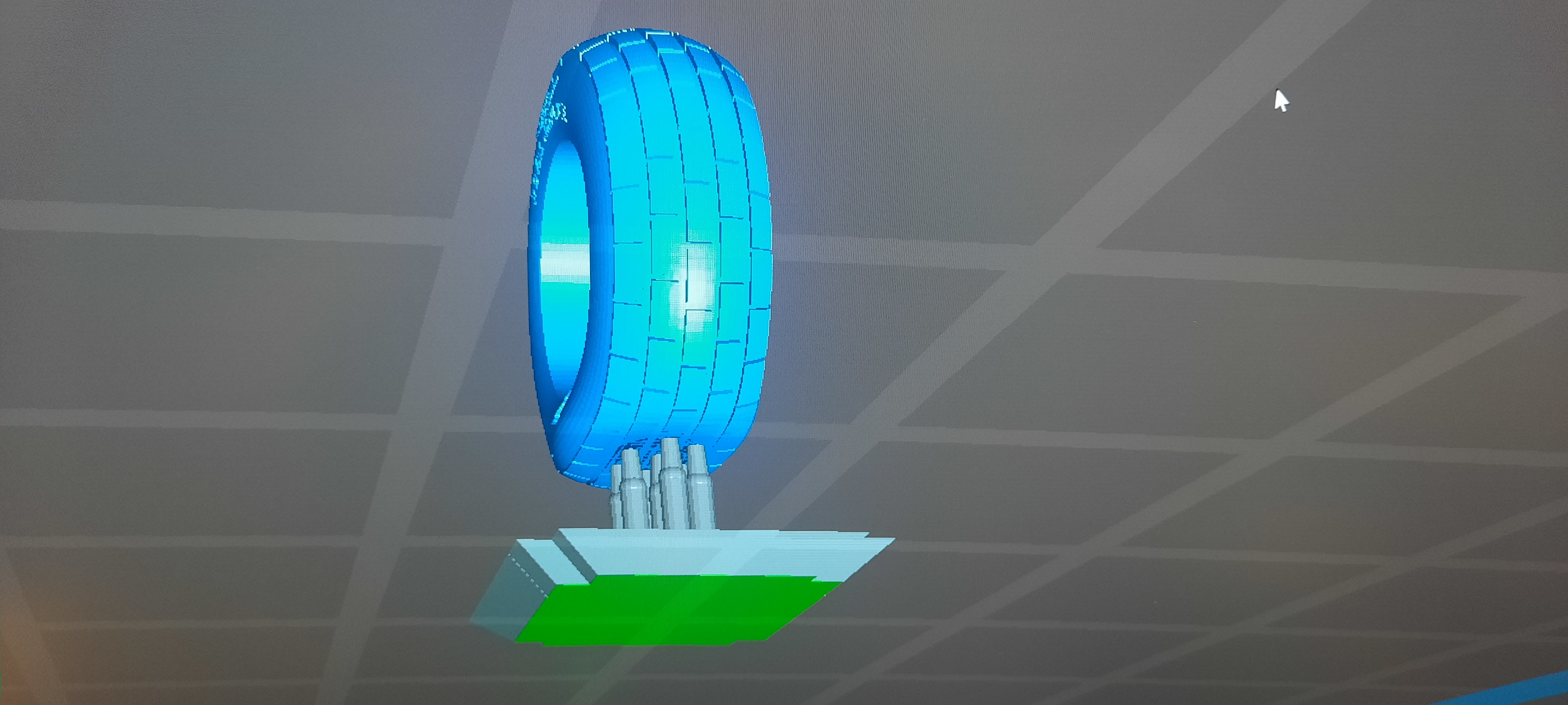

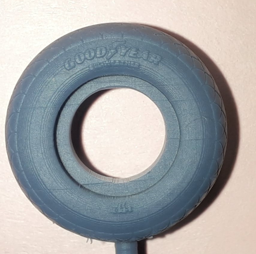

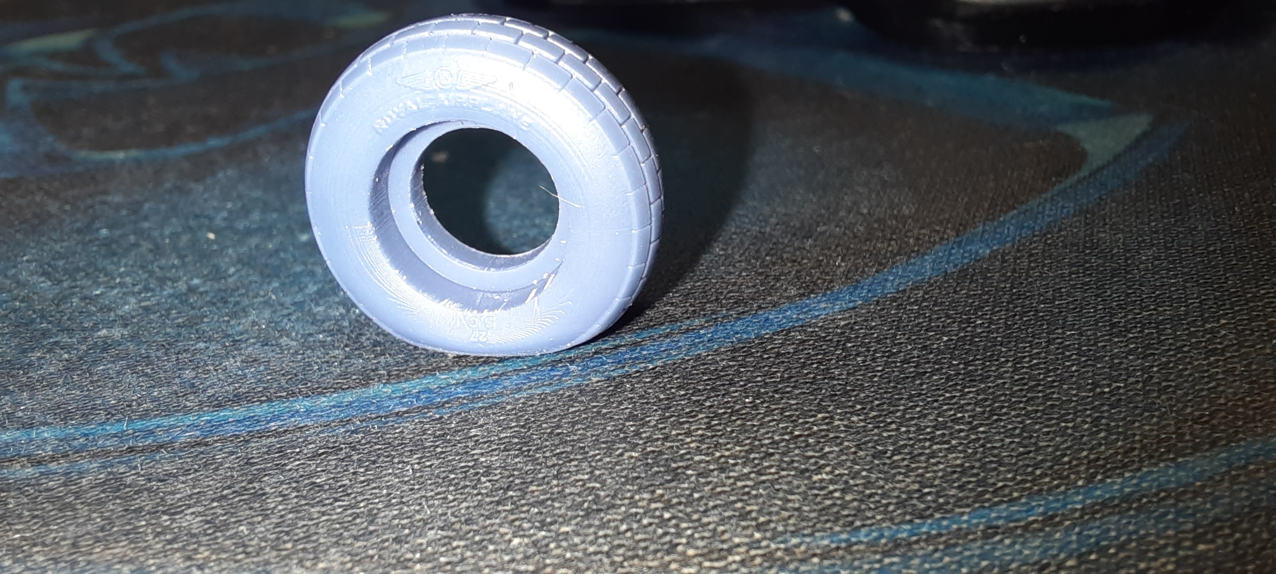

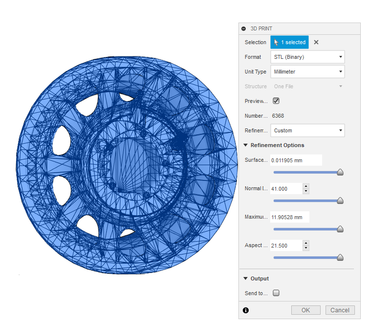

I'll try and explain this best I can. Once you design something and get ready to print, you have to convert that into an stl file. Stl is a mesh of your design. Thousands and millions of triangle converted to your shape. This is one number of mesh that I jotted down while experimenting. 4748196. That's for one of the wheel hubs I'm working on. Now you can change this number by refining some options inside fusion360. That number above is the max for that object. You can go lower but the quality of the print will suffer. I MUST note that this will heavily tax your PC. If your pc is not up to par I can see it locking up. I have a very robust system and still had some crashes here and there.
After that I reran all I have done through the stl mesh converter and reprinted. Now these were taken with my phone with the Maco option. Yes you can see the print layers but to the naked eye I can't see a single layer line. Now I still have a problem with the print itself. What I really think is going on is 1 of 2 things. My VAT screen,which I did change,but the quality is not very good. Or the resin is just to cold. The next thing I will order is a VAT tank heater. I didn't notice these problem until I went with this other brand because the quality Phozen brand is OOS where I got it. I will have to get it from overseas.

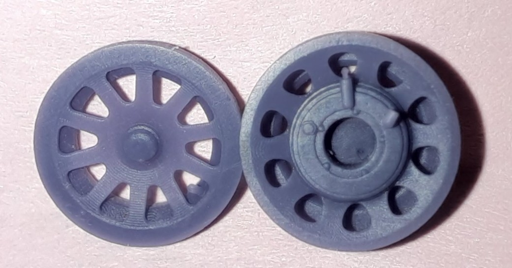

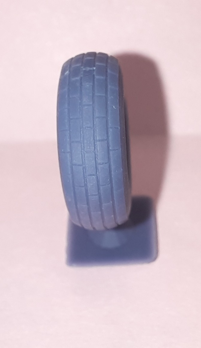

I took the printed hubs and painted them after remeshing. The first is just one coat of silver paint. The other is a black gloss base and the same silver paint. The other pics are the new tread design with the lettering. And the block tread that was common as well. Still working on the logo for that one.
There are other options in the slicer program that will help the quality of the print. These options are anywhere from Anti-aliasing, grey level and image blur. The free versions of these software only let you do so much. You have to buy them or a monthly subscription. I'm exploring which one I want to buy now. The only downside to experimenting is how long it takes to print to see if the changes you made are good. It's easy to loose track of all this..so I got a note pad and document all to help keep track.

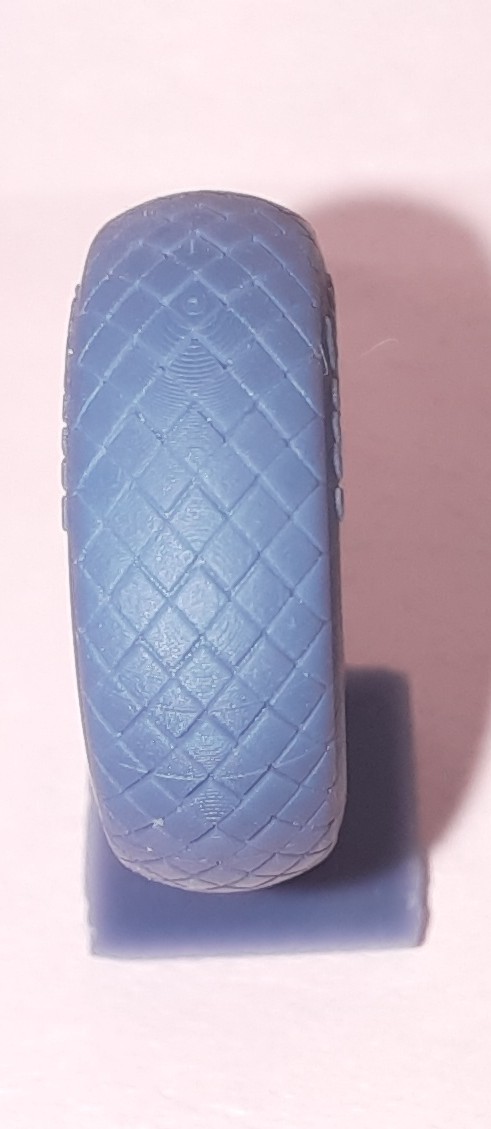

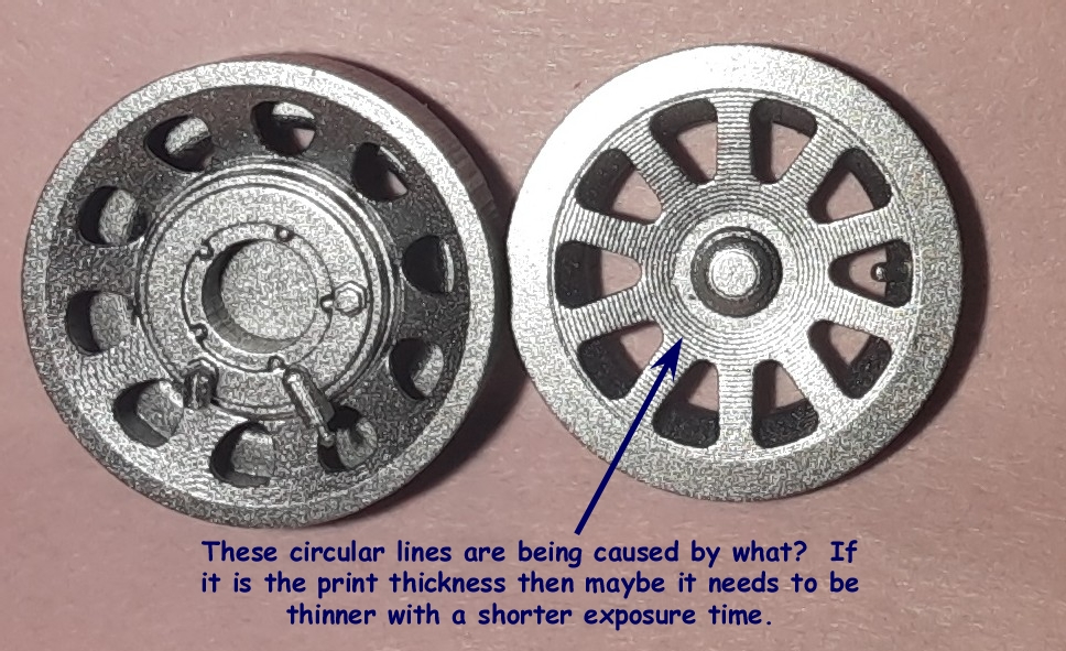

What is the resolution of your printer Mo?
Mo_
I have the Phrozen sonic mini8k and is this what your talking about? 22 µm and 1152 PPI XY resolution
Heavens Eagle

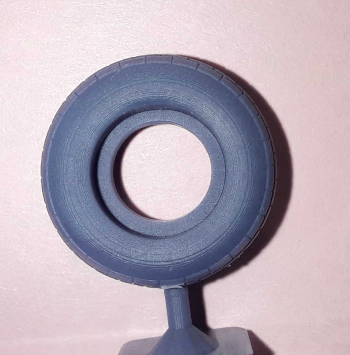

Yes it is Mo. With that high a resolution you shouldn't be seeing some of the lines on the sides of the parts unless they are quite small. I am wondering where the steps on the sides of the wheel and tire are coming from as the resolution is less than .001 of an inch. I understand about the steps from the printing process and that isn't really an issue though it seems I have read you can change the print layer thickness to really thin. Of course that increases the print times, but can give a smoother finish.

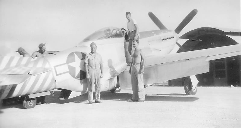

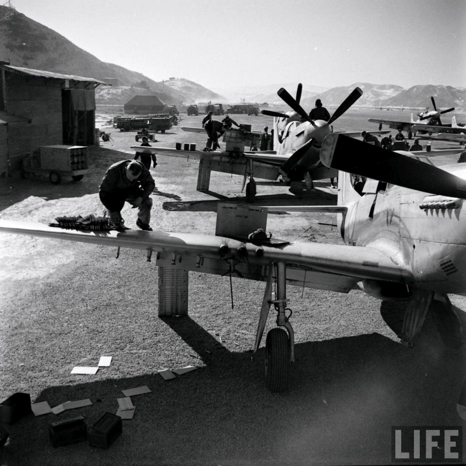

@Mo_, please work from photos as the tire appears deflated. The sidewalls were quite sturdy on them. I hope that these photographs help. John Eaton has a page with excellent photos and I believe he also worked on aircraft (I did during high school and a few years after as a volunteer before work prevented me. Once married, working for free (volunteering) didn't happen).
Note that this is under the weight of three ground crew, yet no evident bulge:
more to show little bulging:
