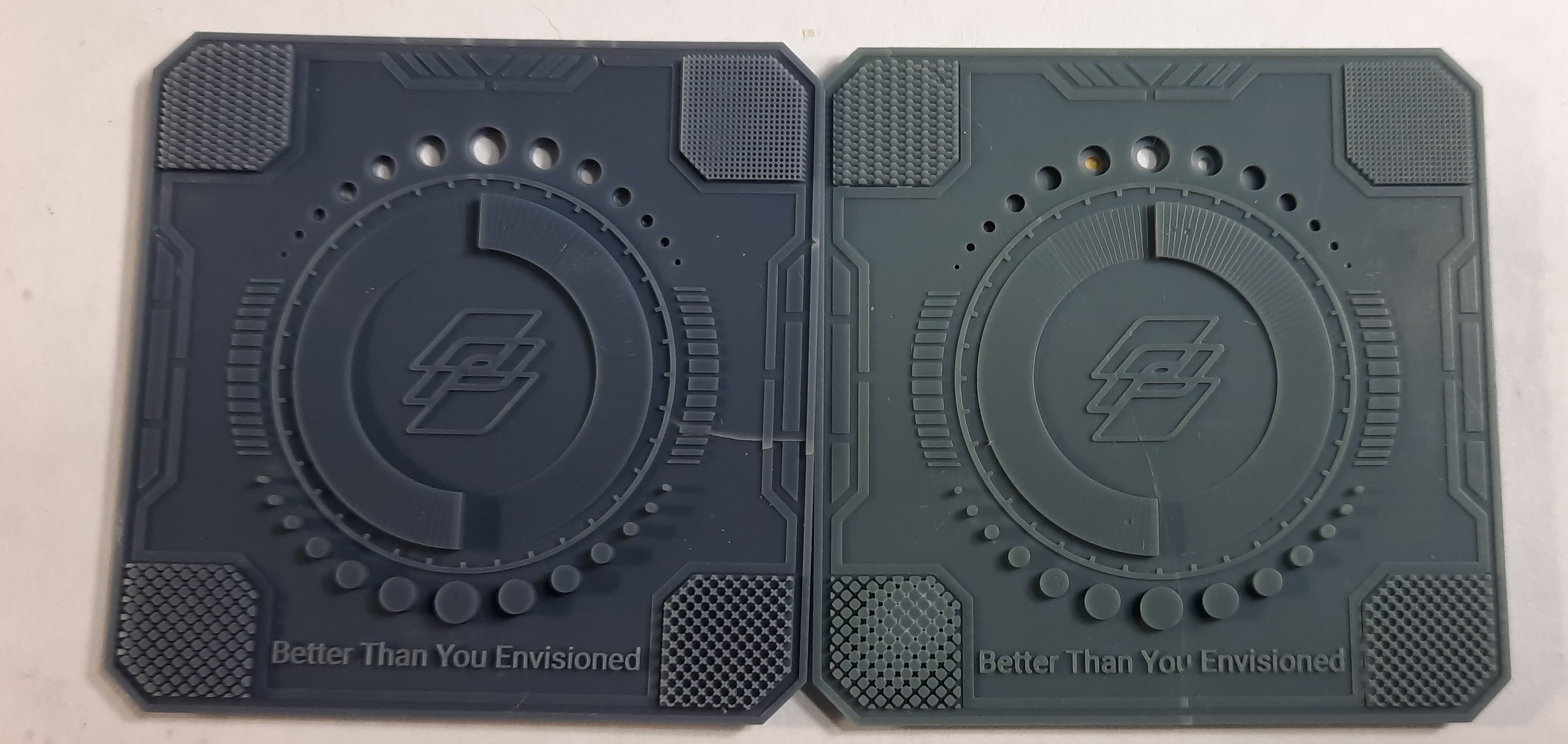

After some half failed prints, I was really scratching my head. I won't bore with the nity gritty details unless folks really want to know.
While I'm absolutely new to this game...I do know the quality of components can make a big difference. And things aren't always right from the factory.
I was starting to get some compression problems. You can see it in what is called an Exposure test. The right test bottom left shows this really well. The left test is great. They only difference between the 2 is the mods I made and changing resin.
I'd have to do another test print with the first resin that I was using to see if the mods made a difference...or its just the resin.

More testing will have to be done to be sure what I'm doing is working. But right now it looks promising. Or I'm just high on resin and alcohol fumes.
If you change resin just make sure you get the companies suggested curing time for your machine and use as the starting point. Sirya tech is here:

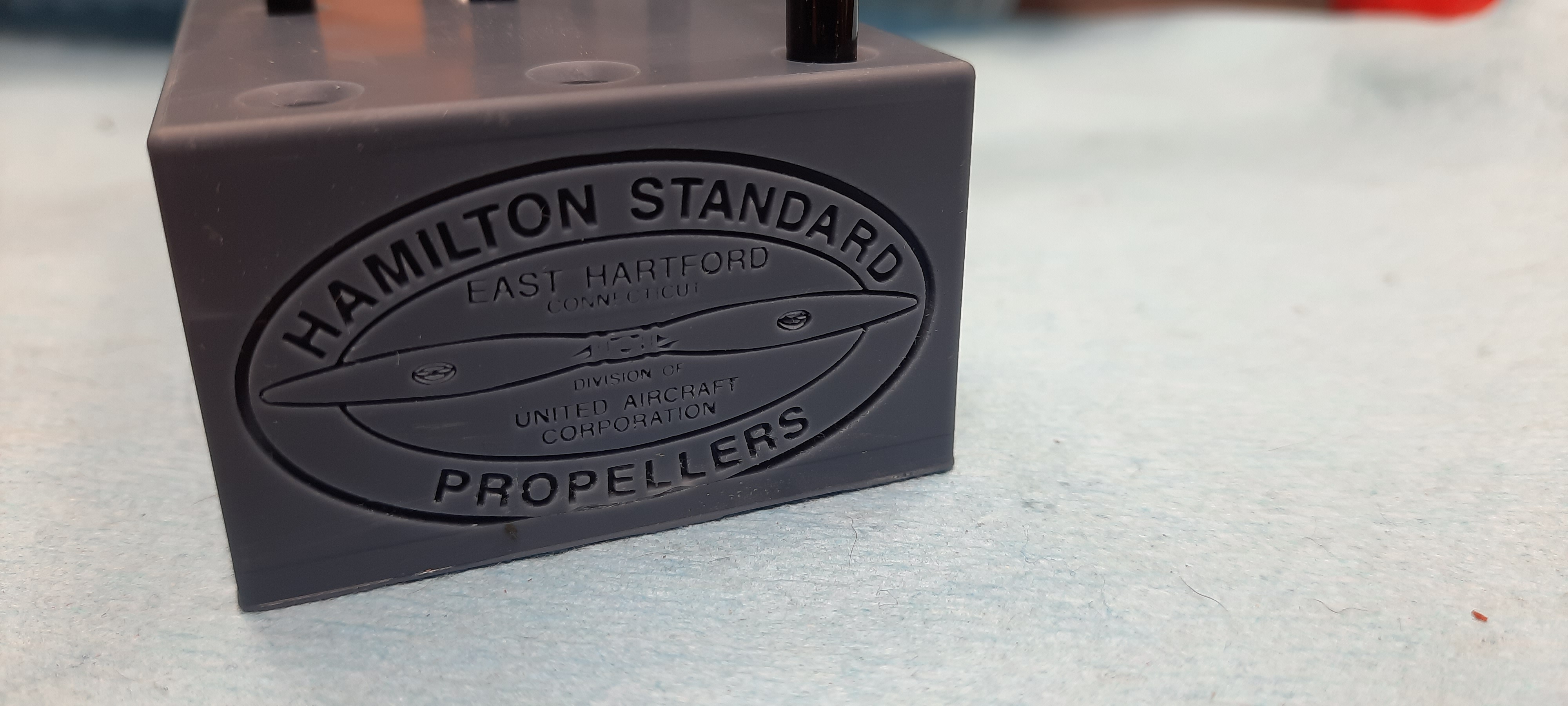

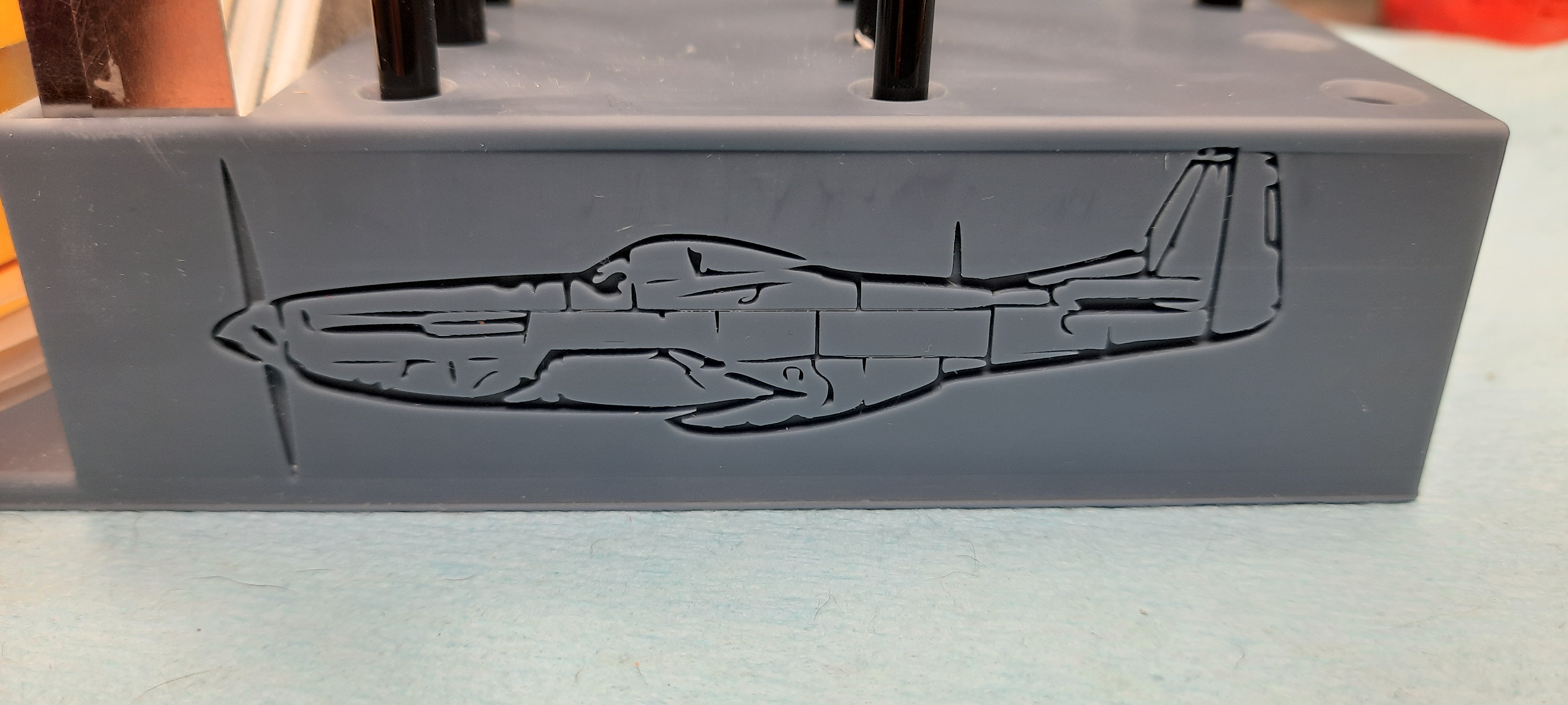

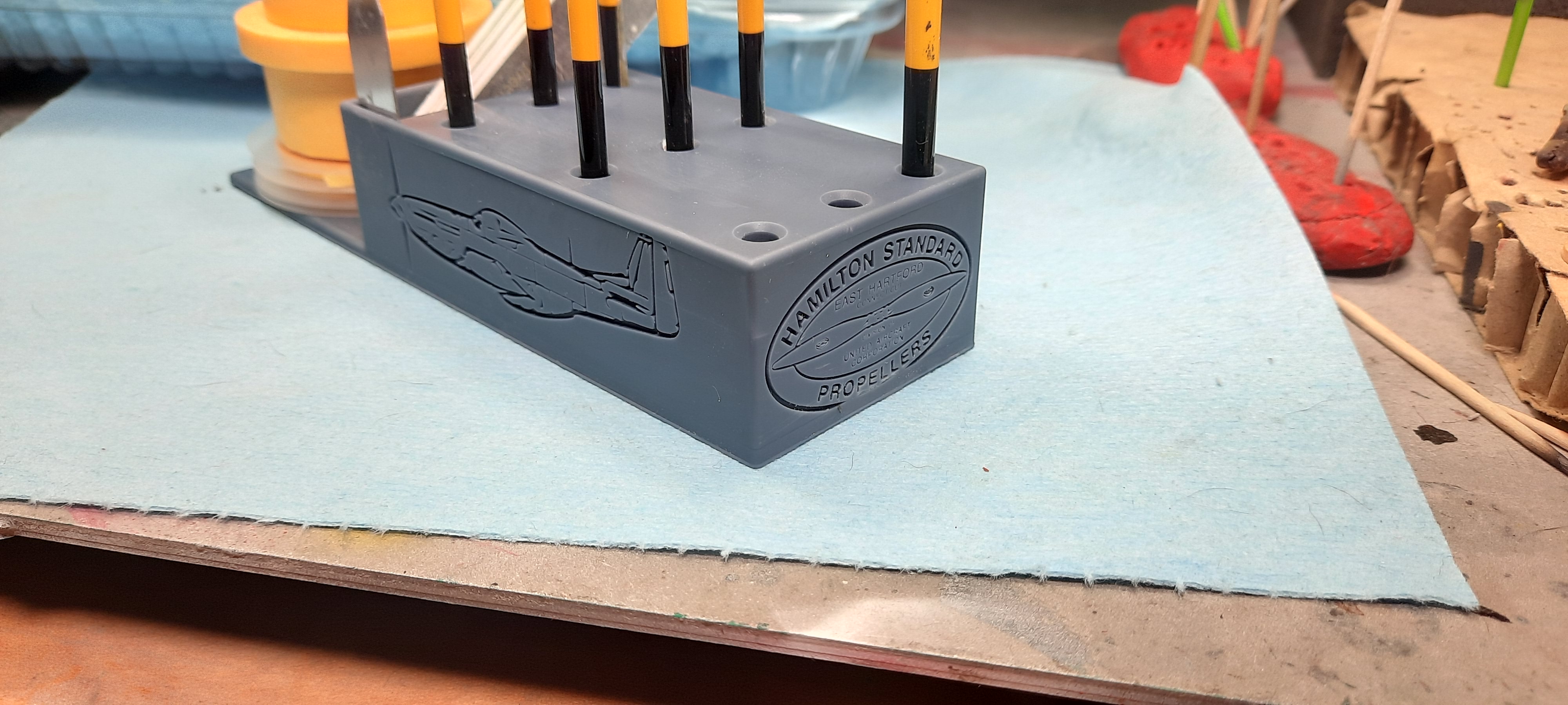

Finally printed off a tool holder I've been working on here and there. While it looks simple it was actually quite challenging. I was using a home brew holder that was doing the job. It came out ok...more me not fully understanding how a design translates into a file for the printer.
That is kind of cool. I need to work harder at making my tool ideas come out. Is it hollow or solid? If hollow dont forget to either leave holes for the resin inside to expand or to allow you to cure inside. I made a simple little box and 3mm UV LED to cure inside my hollow stuff.
James
Yes it hollow, except for tubes to keep the brushes vertical. And I forgot about the drain holes...fu$*$*$#* engineer that designed this thing...LOL I made some holes and let it drain then put it outside for the day in the sun.. seems ok now.

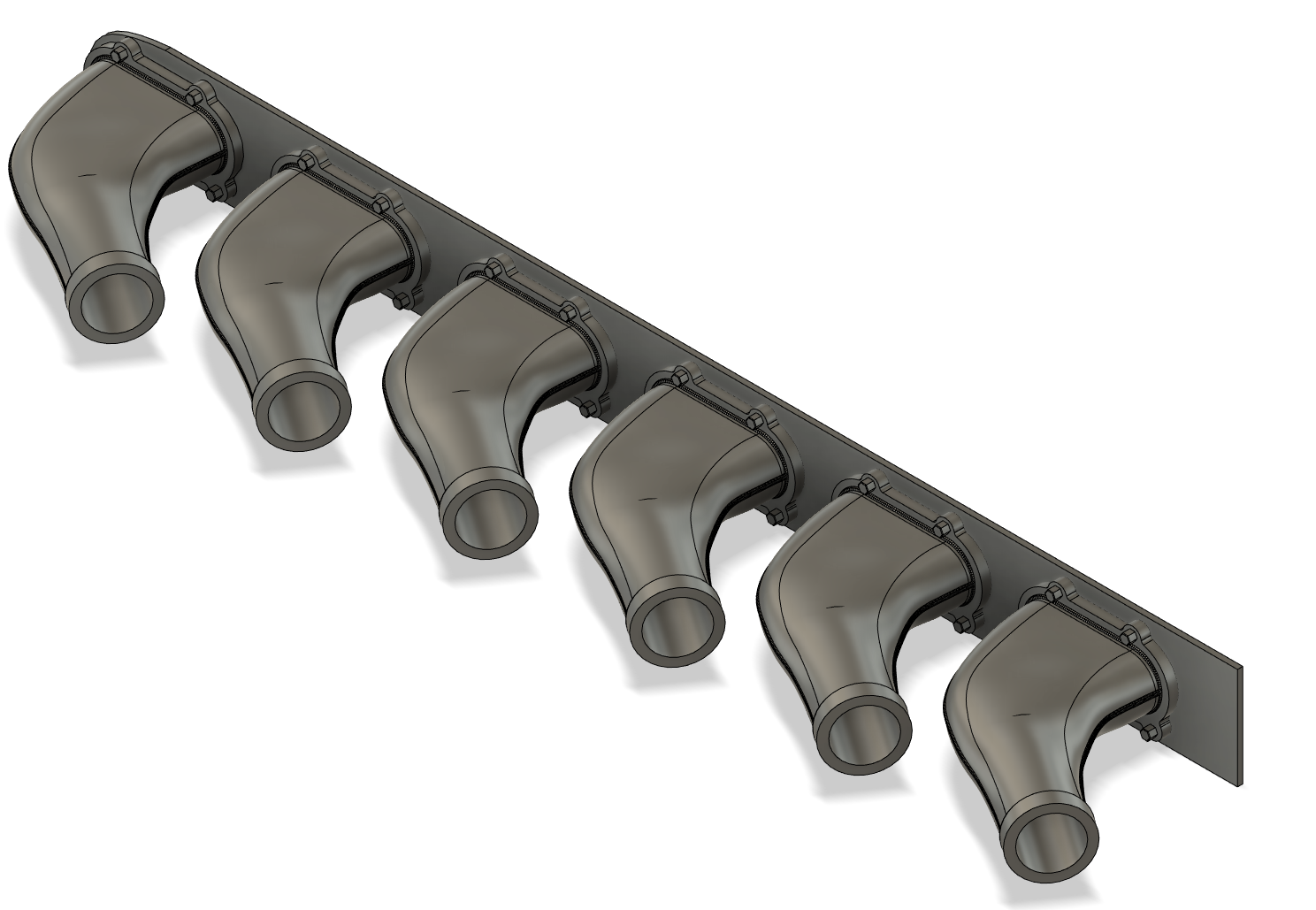

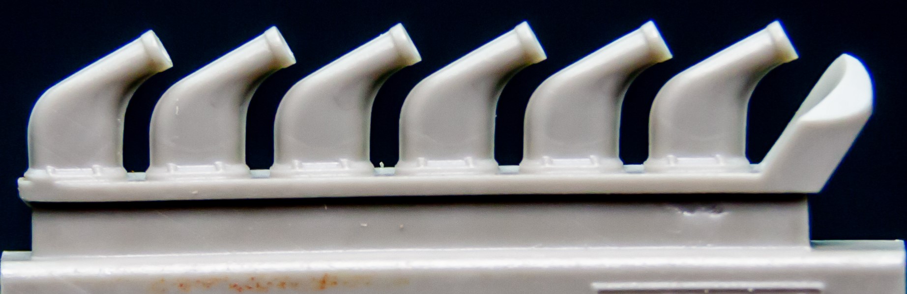

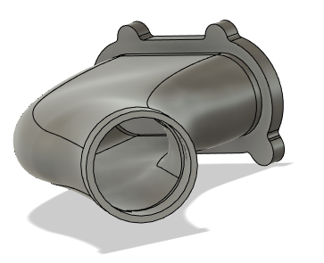

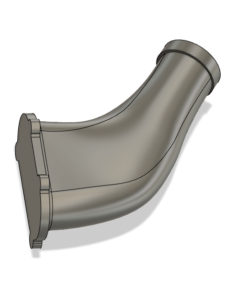

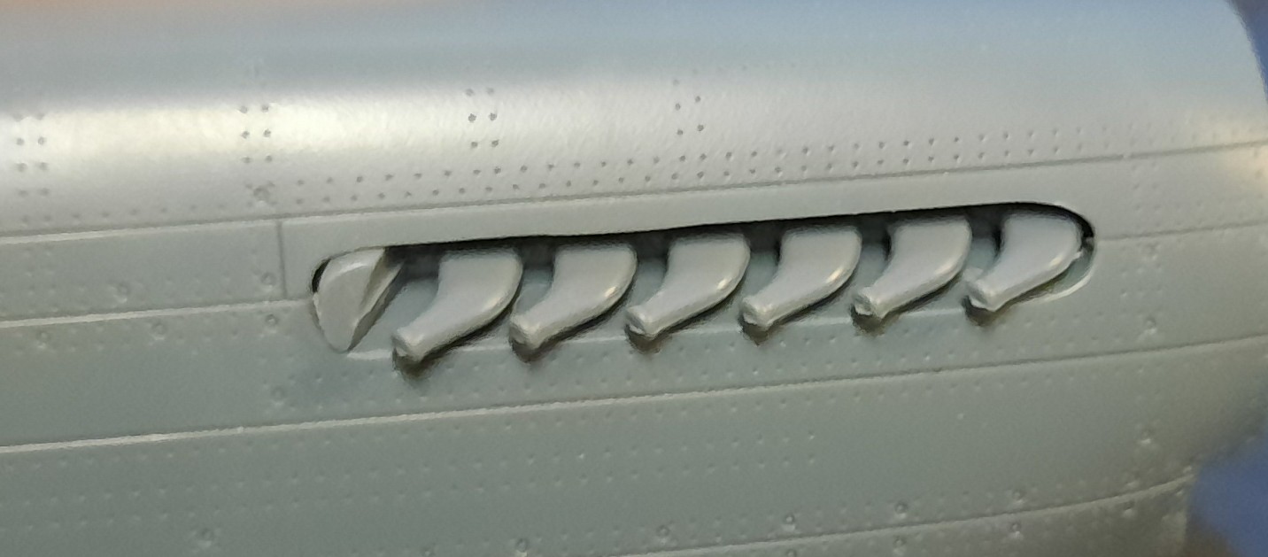

I'm working around the eduard 1/48 mustang, but really should work with any mustang with some mods. I did subscribe to an online database that has TONS of blueprints. I have to scratch my head why eduard did the exhaust the way they did after looking at multi blueprints. The back half that is giving me problems ATM is completely wrong.
What program are you using Mo?
Fusion360.
