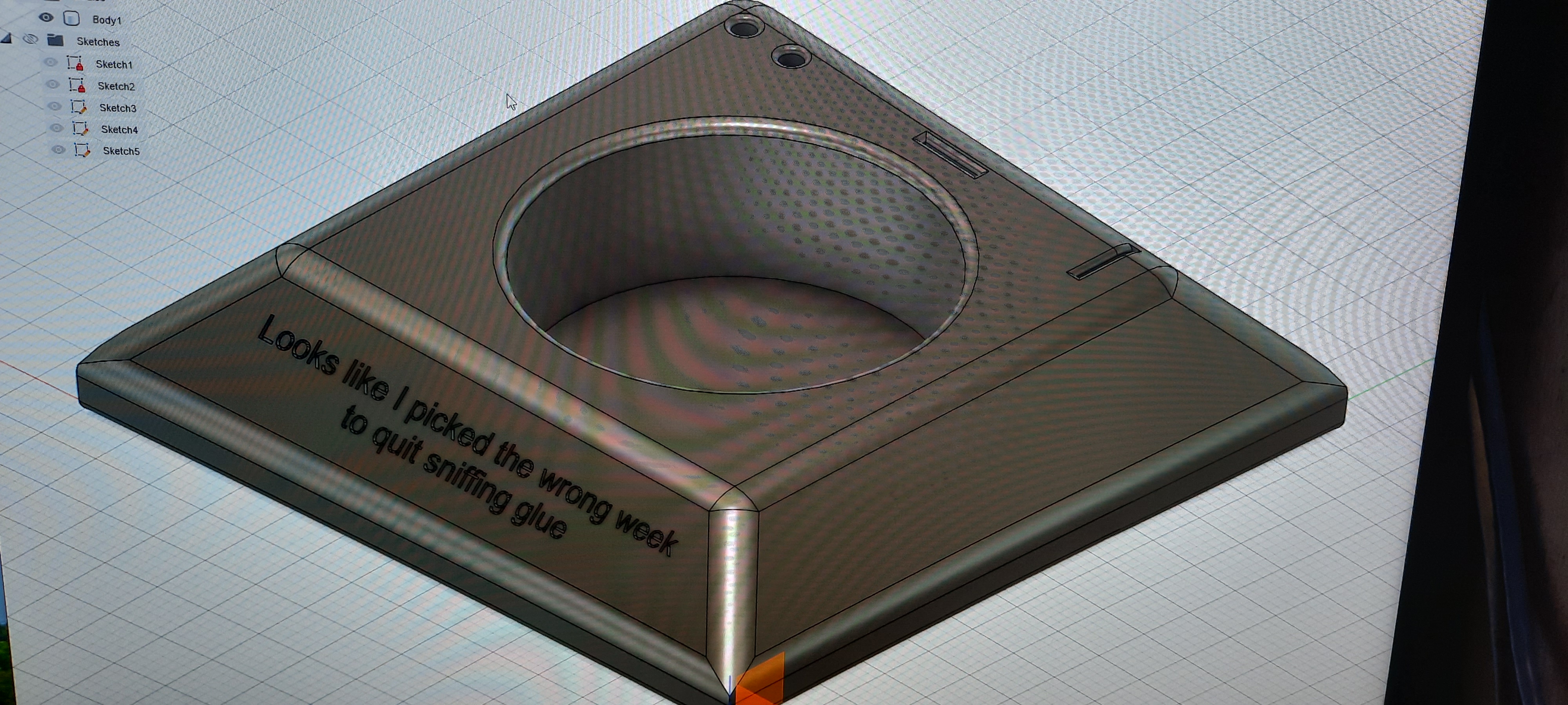

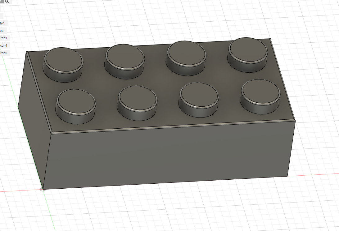

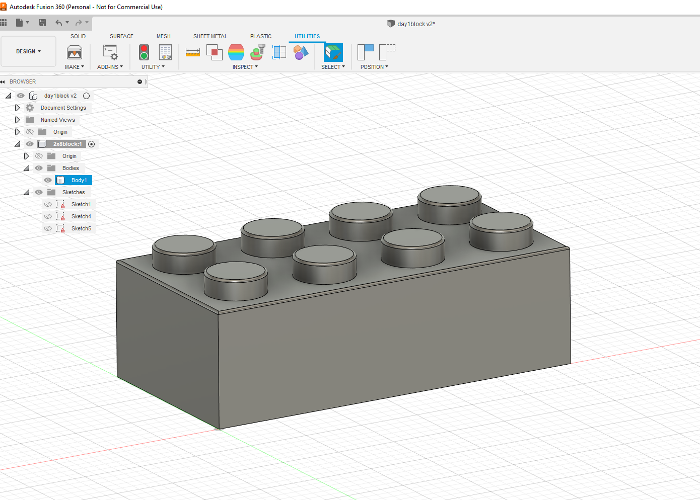

While I wait for my 3d resin printer to arrive, I need to learn all that goes with it. Right now I'm using fusion360. There are many 3d software out there. Some are big bucks to get the most out of them. I'm trying fusion360 first because there are some good videos on you tube. I followed along a video just to build this. This is just scratching the surface! Ive got a lot to learn. One 3d software that seems popular is Rino3d, Its 1000$ for it. LOL.

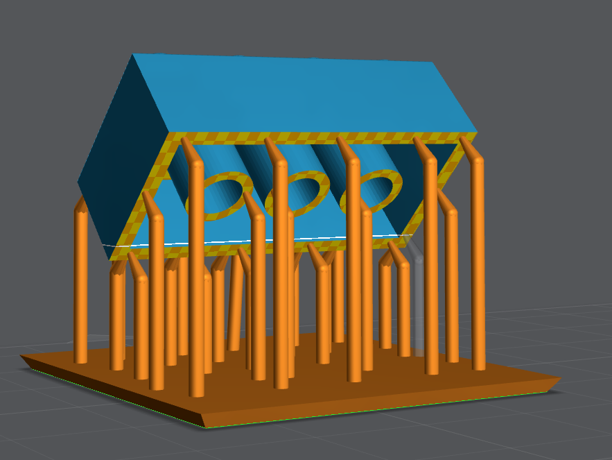

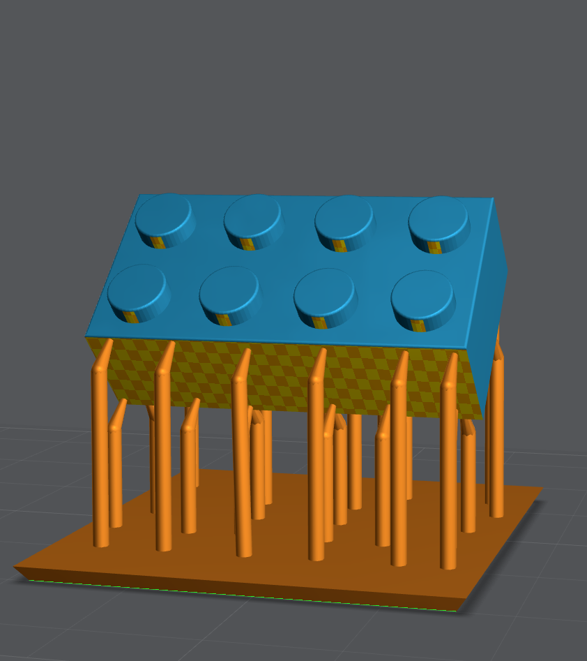

After you design something you have to import it into what is called a slicer software. I'm using LycheeSlicer. Here you can orientate the object and add the supports. This is all going to be a lot of trial and error.
The cavity needs to go up or you will have liquid resin trapped inside. Remember the liquid resin needs to be able to drain out.

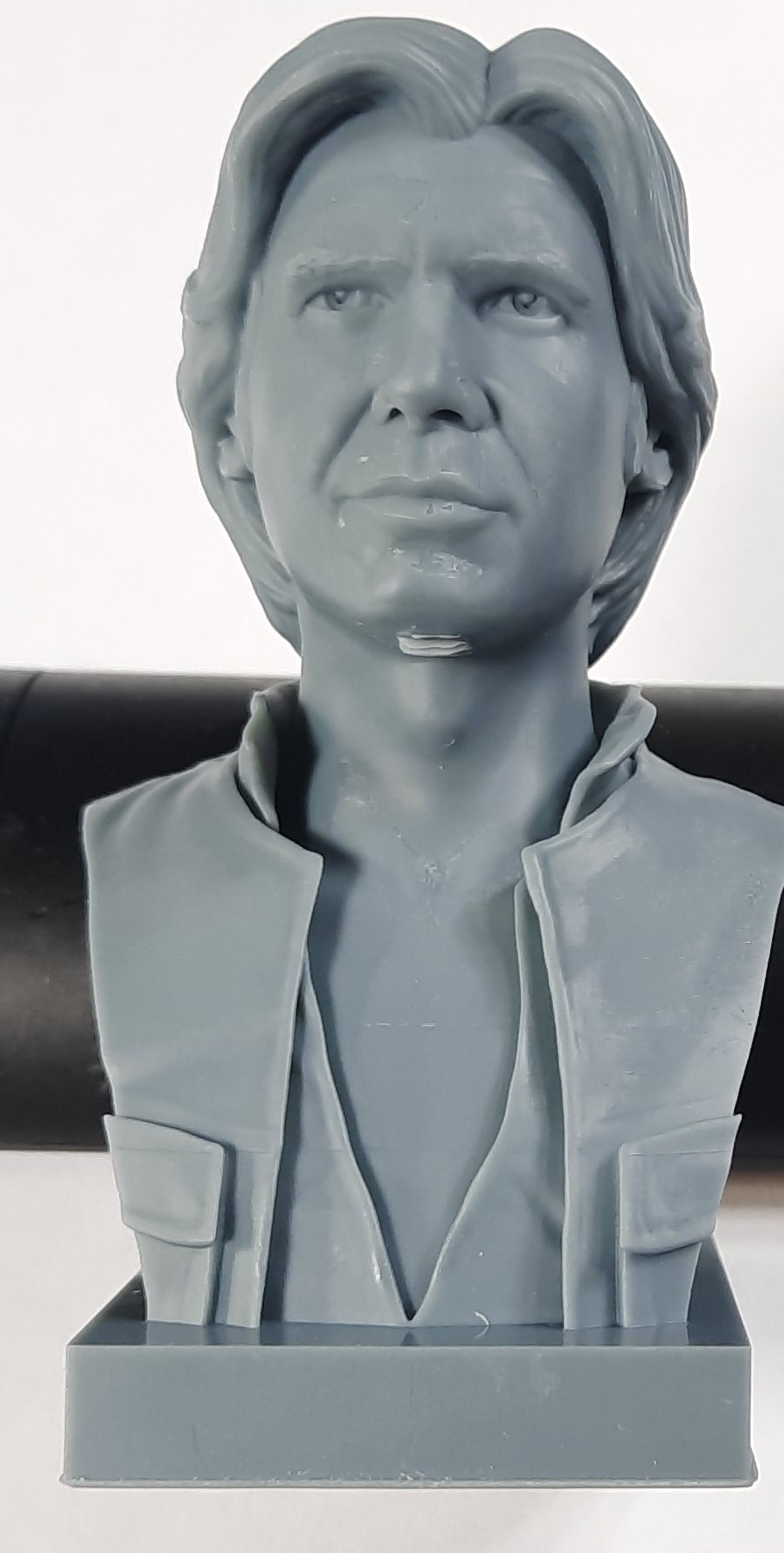

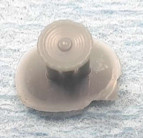

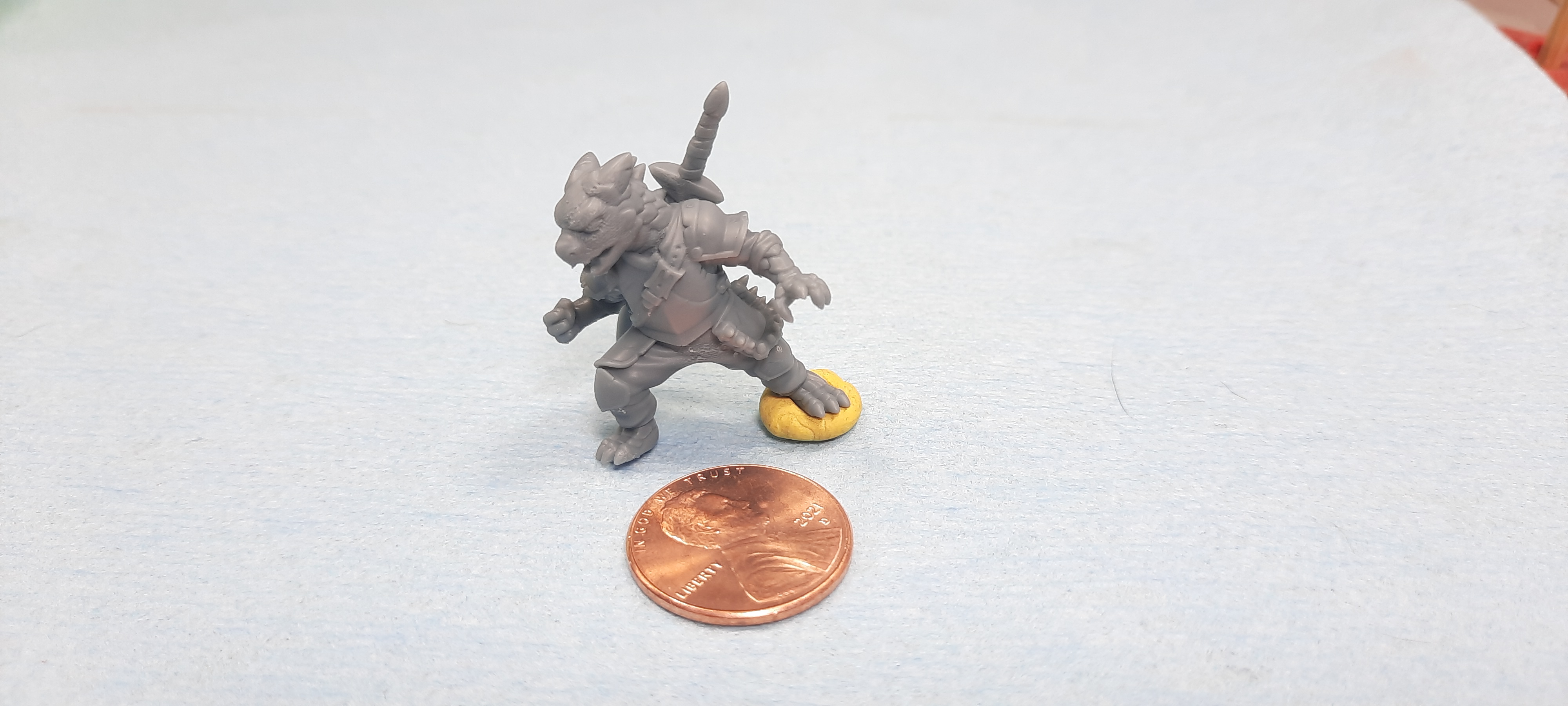

It had a long thin layer, and when the printer pulled away, that layer was not strong enough to lay flat. Usually in this case there should be a support added to the bottom of the chin, though you would probably be better off with a little putty and sanding in this spot.
It looks like it took 3 or 4 layers before it settled back down.

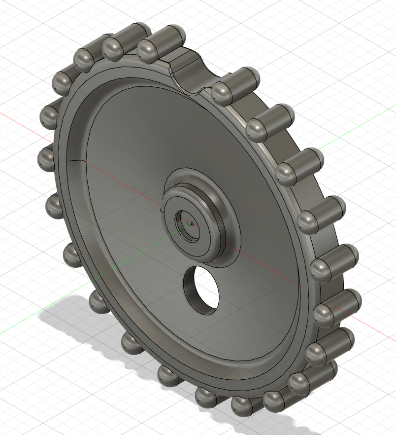

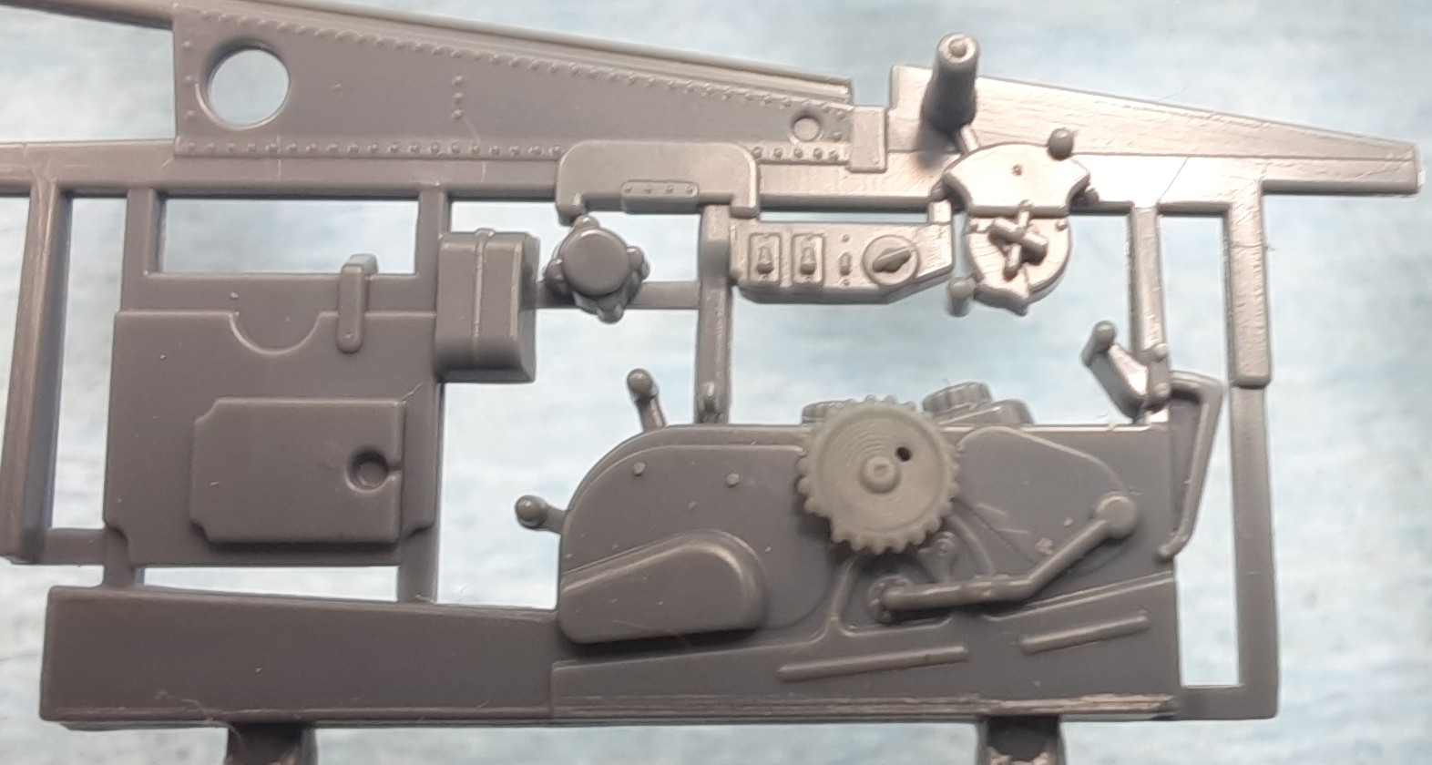

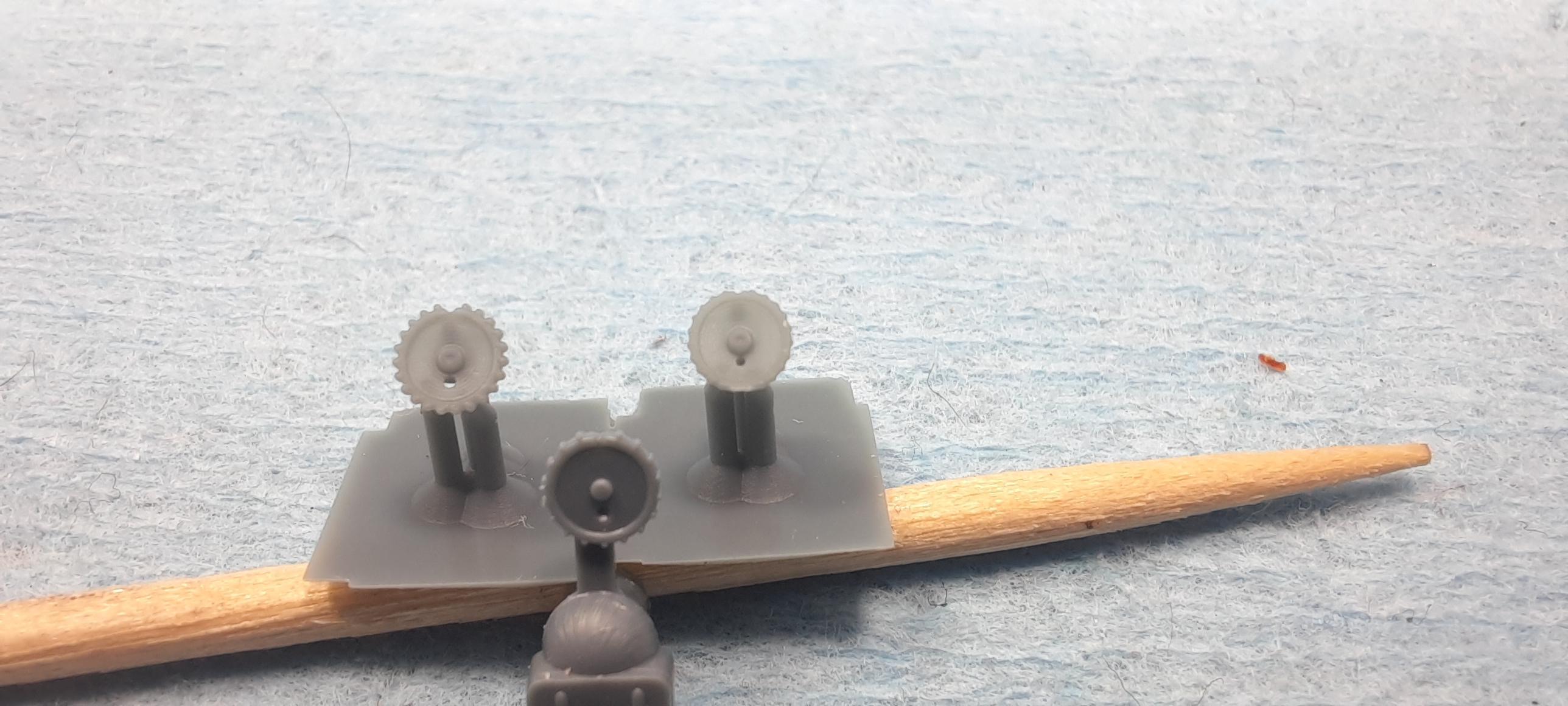

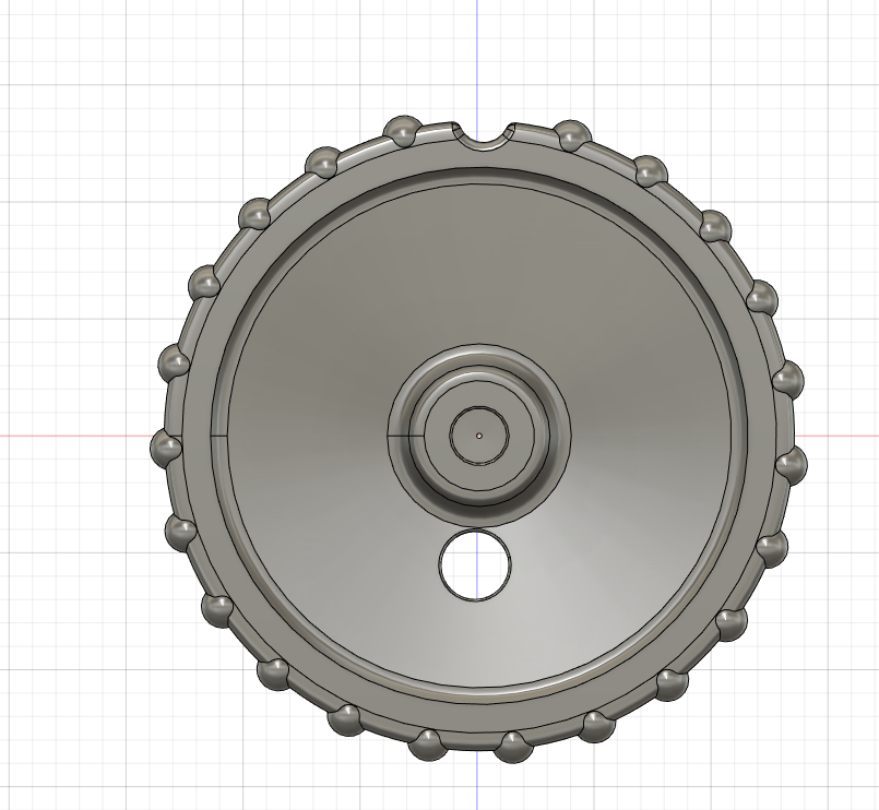

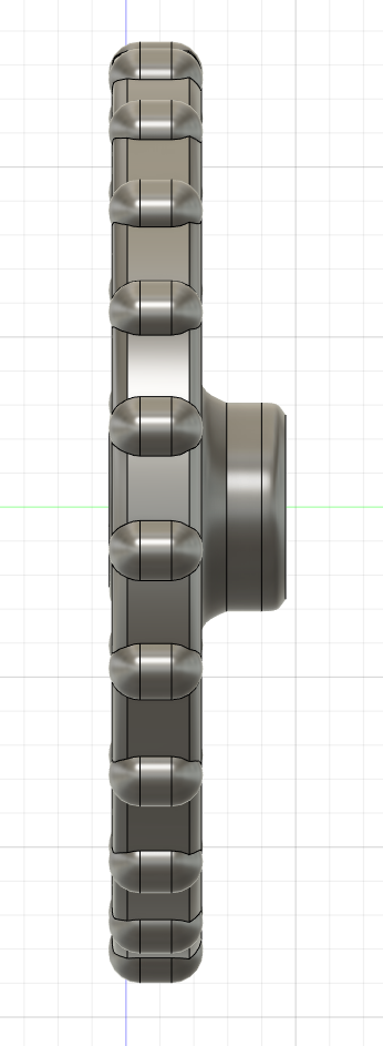

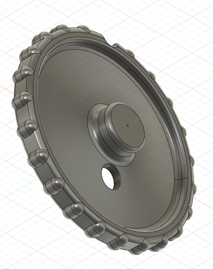

My first aircraft related part. Its a trim wheel for a p-51mustang. Why you might ask....because I lost one out of one of my kits and had to rob Peter to pay Paul. So I needed a replacement. While it far from perfect, it does look like a trim wheel! It will need some refinement. Its 1/48 scale. I have read where the really small stuff you have to over exaggerate the details some...working on that now. This design was following a scale drawing as best I could with what I now know with the Fusion360 software. As i learn more I can go back and make it better.
I made some changes to the first design. That one is on the left, the fist design is on the right. The kit part is in the center. All in all after everything is closed up it will play the part. I also included a pic of what it looks like where it supposed to go...case anyone didn't know.
