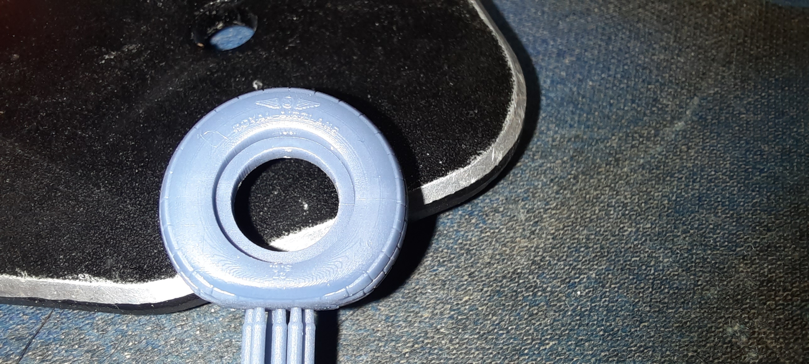

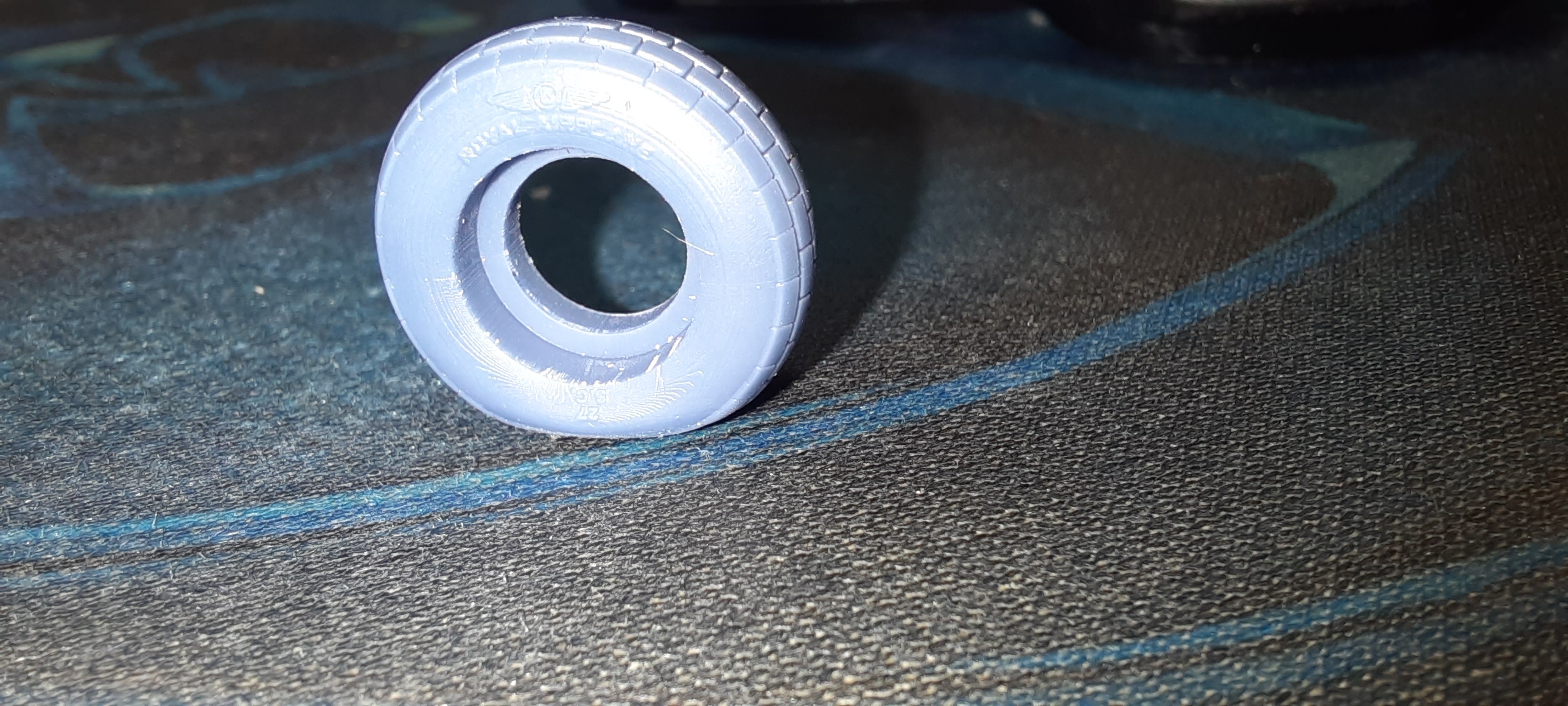

My foray into the world of 3d printing.
what would you call those. Those tires almost look deflated as you would say

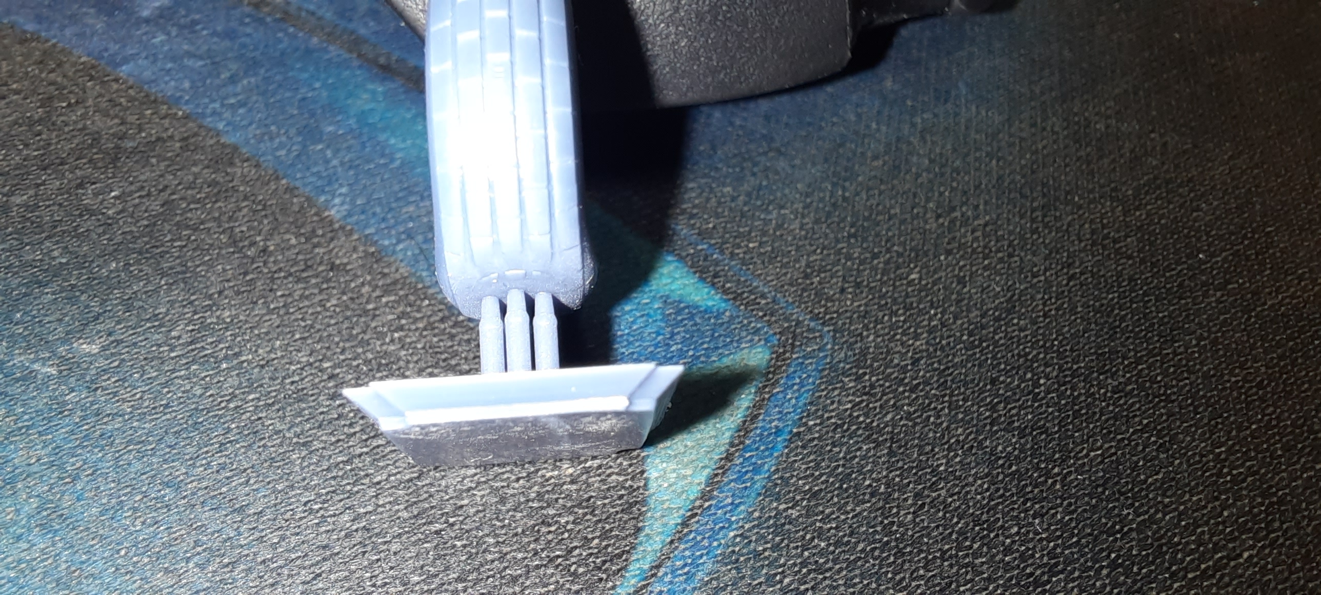

Different tread and worked on making it flat and with a bulge......also installed a VAT heater that keeps the resin above 90 degrees.
This looks to be a really good print! smooth with no big step lines. The bulge does look to be about 50% too much. I look at car tires a lot. Today I saw a van with a very low tire. The rear tire on the right was like looking at a square cross section. Minimal sidewall bulge on it. The left tire was just looking forward to being flat. It was really weird looking in that you still had the square cross section that was a little lower. Sidewalls were still fairly flat but right at the ground the sidewall made a very pronounced bump dXb like this.
Thats the one I have been researching. It works well? Very gets nice and warm. It comes with a stick on celsius gage. Its kinda hard to read. I'm going to order a different one from amazon.
