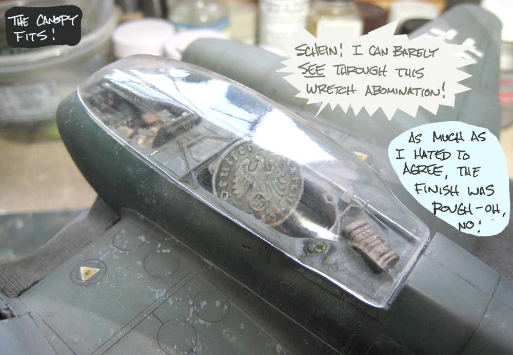

So, I've been doing lots and lots- and even a little modeling! I think I've pushed this build over the hump- and for a screen saver of Hannah and Fritzi see my blog: here

Whew! Thanks, everybody! Sometimes I think this thing is never gonna get done- but I an't quittin'! Let's see- start masking the canopy with the Eduard masks, modifying them as I go to fit my canopy, add the PE to the cockpit, detail up the rear gun controls, add the 4 gun sights, Detail the inners of the two hatches- heck, it'll be a breeze. Oh, then fit the thing on and blend it in- I think I'll use furnace tape for that. Easy! :blink

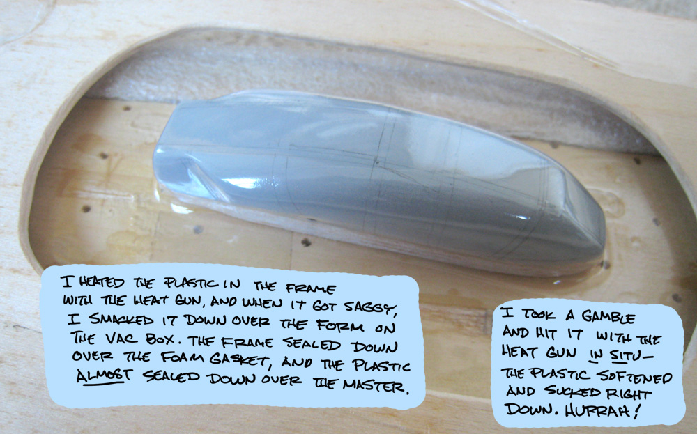

A brief but pithy update- I tried an old balsa trick with styrene- and it worked!
