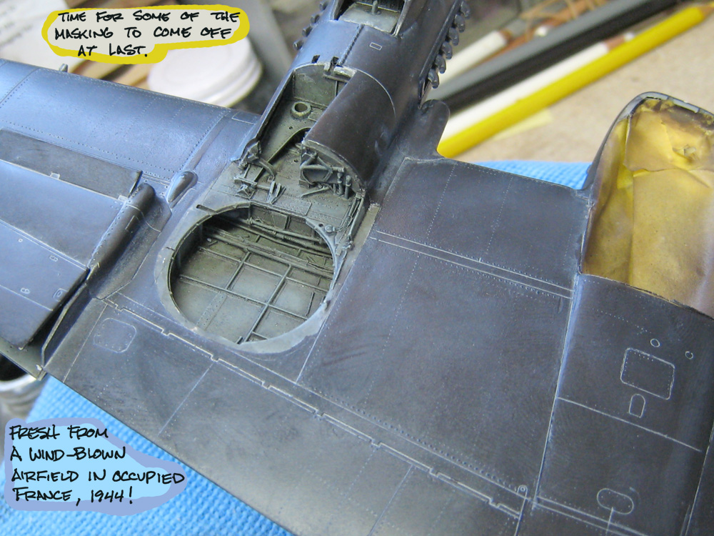

aaaaaaaaaah ... paint! wonderful! the camo looks great and the postshading is masterly!
too bad about the canopy but you'll overcome that problem!

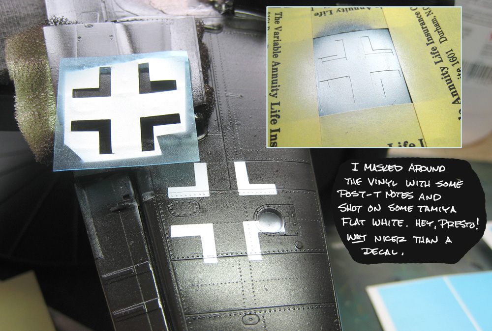

Nothing makes you feel like you're making progress like adding the insignia and markings, right, Fritzi?
I may never decal an insignia again. Yeah those instructions look way cool, may be worth getting the stencils.
Thanks Chuck, made staying up late worth it agian :mpup
Looking awesome Chuck. I started using Montex masks a while back and paint is way way better than decals. I even went and bought a plotter, just have to get used to it and learn how to draw and I'll be set. Look forward to even more.

Fantastic work Fritzi and Hannah , it is really starting to look airworthy :)
I love the use of masks instead of decals too .
