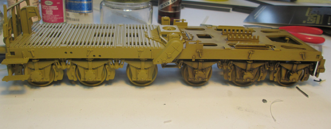

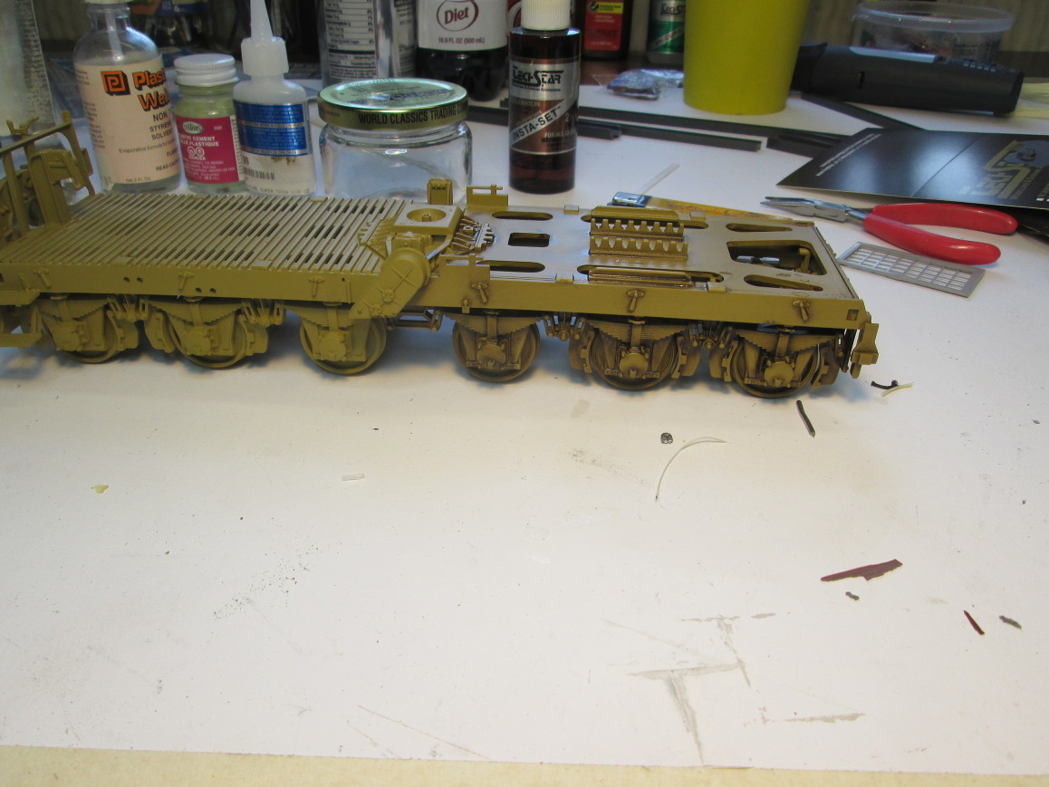

Guess I'm on bump detail again, looking awesome Mr L.!I've began to weather the K5 E Railway gun. I base coated it five years ago, so the finish is about as hard as it is gonna get! Iron Mike, (Mike Trent), had built a Panzer 3 in dunkelgelb and I liked the finish a lot! So, I asked him what colors he used to weather it. He gave them to me and so I'm using them plus a few more. I still weather with old school methods because,...... well, I'm old school!
I started with the two trucks, front and rear, on which the massive gun is carried from place to place pulled by a locomotive or one of the small diesels the Germans used for lighter jobs. I began with my old raw umber artists oil and rectified turpentine wash. It is a process, especially on a yellow base coat, in which you have to close your eyes, grit your teeth and just do it. It never ceases to put the fear of God in you. It goes on and looks just terrible. But, have faith and pull up all the patience you can manage and here we go.

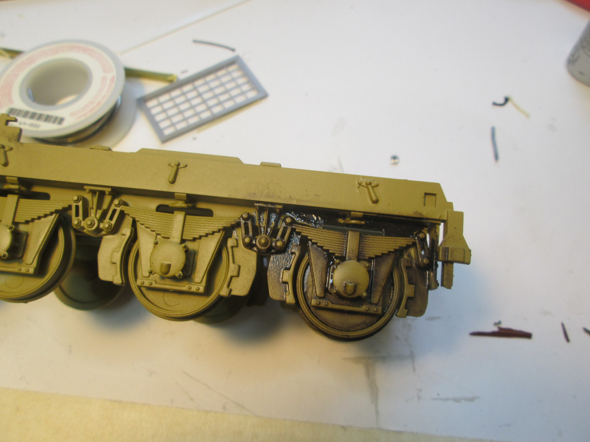

Then I place on a coated sheet of cardboard, (If not coated, the liquid will soak into the cardboard and dry very quickly), . a strip of the paint about an inch long and then, using a wide filbert brush, (a number 8 or 10, I mix it on the cardboard pallet thoroughly until it is the consistency of whole milk. Then, using that brush, paint it on an area about 2 inches square, more or less, at a time. That's the scary part. It will look like you just painted it an ugly brown color that is not even translucent.
Here it is a bit closer.

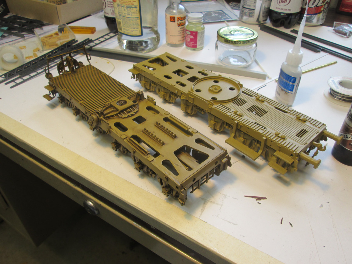

Then, using a clean T-shirt, I begin blotting, (Not rubbing), the raw umber mixture until it only remains in the recesses. The raised parts will be a bit darker yellow, but, after a few hours, it will lighten as well as flatten out, leaving a much more pleasing contrast between the raised and recessed areas.

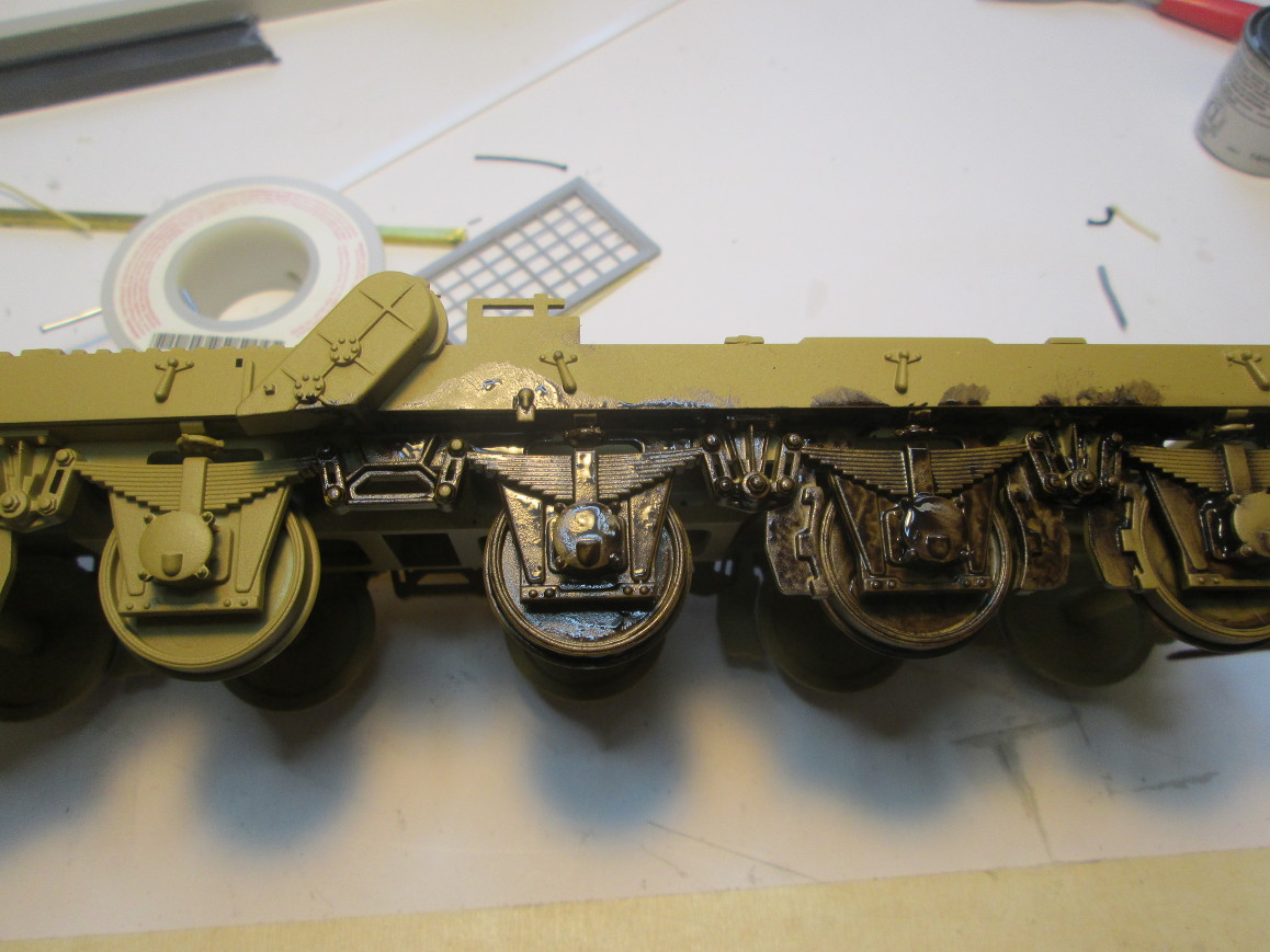

Here I have done three of the wheels and housings. As I said, looks scary, doesn't it?

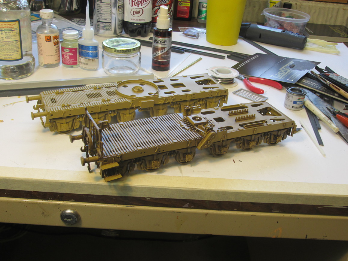

Here I have washed and finished the entire rear half of the truck. I get all I can using my finger underneath the cloth, changing places frequently, as I blot, then after It is mostly blotted so there is a thin coat of the raw umber mixture left, I use a Q-tip under the cloth to get at the more recessed areas. Using it alone will leave unwanted lint.

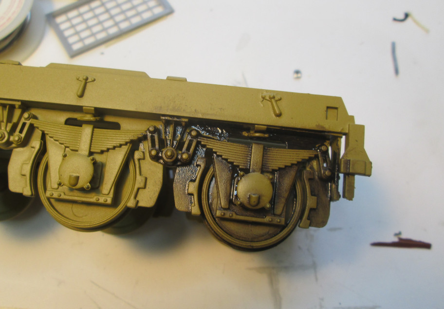

But, after the T-shirt is finished with it, it doesn't look so bad, and, it will look even better left overnight to fry.
Another view.

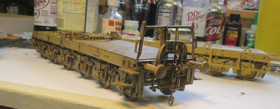

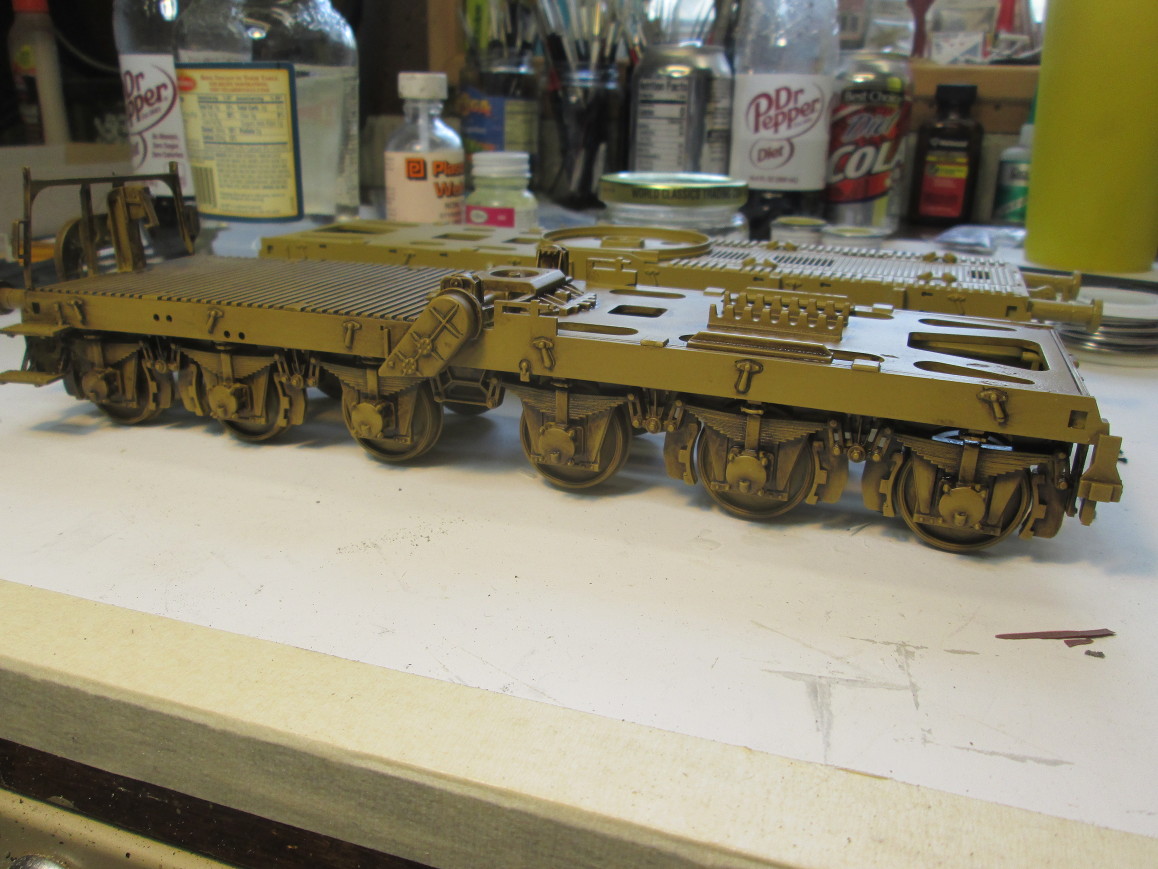

Then, I finished the entire truck.
The other side.
Compared to the unwashed truck. You can see the washed one is several shades darker. That's the object!
Another view.
