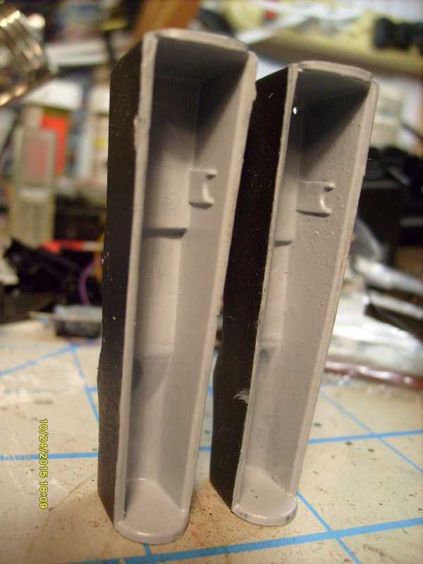

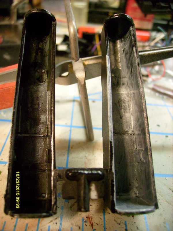

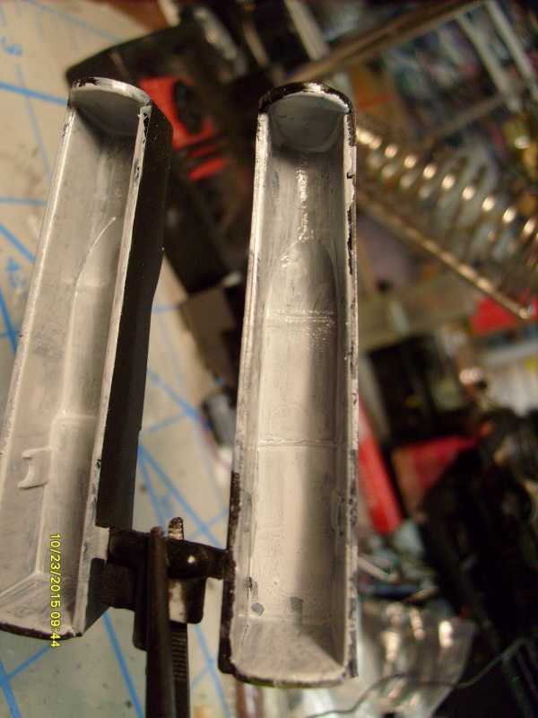

Well the federalizes didn't make it Friday, and they took Saturday off. I'm still waiting for that pit, meanwhile back at the Ranch, we started fixin the wheel well color.
1st sprayed flat black, then I used a coat of grey primer, still needs more grey, but that's coming

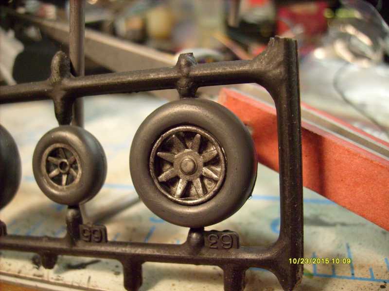

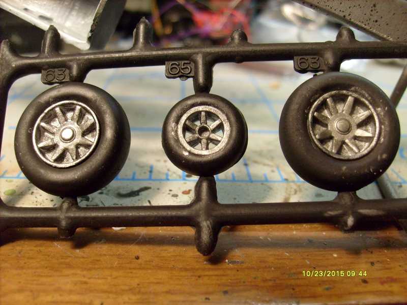

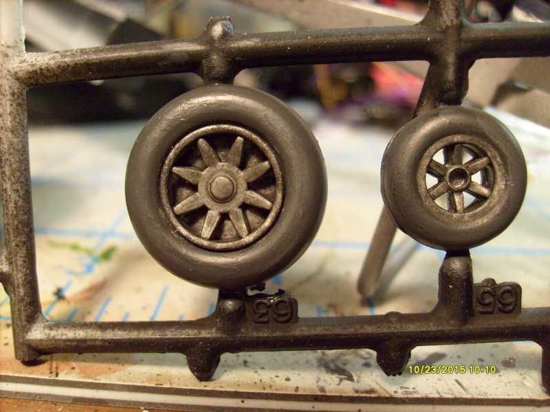

Then I went ahead and worked on the wheels, 1st I brushed some Alclad Chrome, then hit the wheel centers with some Nulin Oil.
Then I used some Vallejo dark rubber.

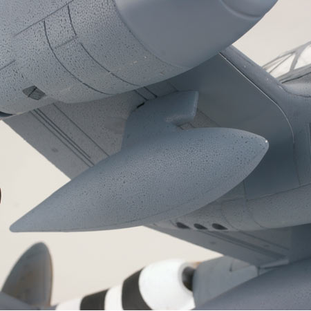

Now on this next shot I found is very interesting, note the notch in the drop tank, Rich is this the way it should look?

If i'm not mistaken, that notch was for the gun camera.
On the late J and the L models the gun camera was moved from the nose to an extended fairing on the left wing pylon. Both pylons had the fairing but only the left had the internal fittings for the camera installation.

Ok would that have been the same for the Recon Lightning, as what I've been finding had lots of differences, from gunship.
The F-5's came off the production line as a standard P-38J/L before being transferred to a mod facility to be converted from fighters to the reconnaissance role. They would have had the standard pylons of the J/L model but I don't know if they would have the gun camera installed.

Ok that answers my question, It's good to have a modelers alliance, in operation, The kit has the wrong or right wing pylon's, I'll do some looking on a web-site I found to see, thanks Rich, I'll let you know what I found. Oh and in my research I found they were converted at Love Field, Dallas, Texas.

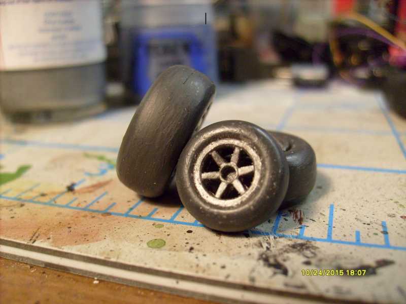

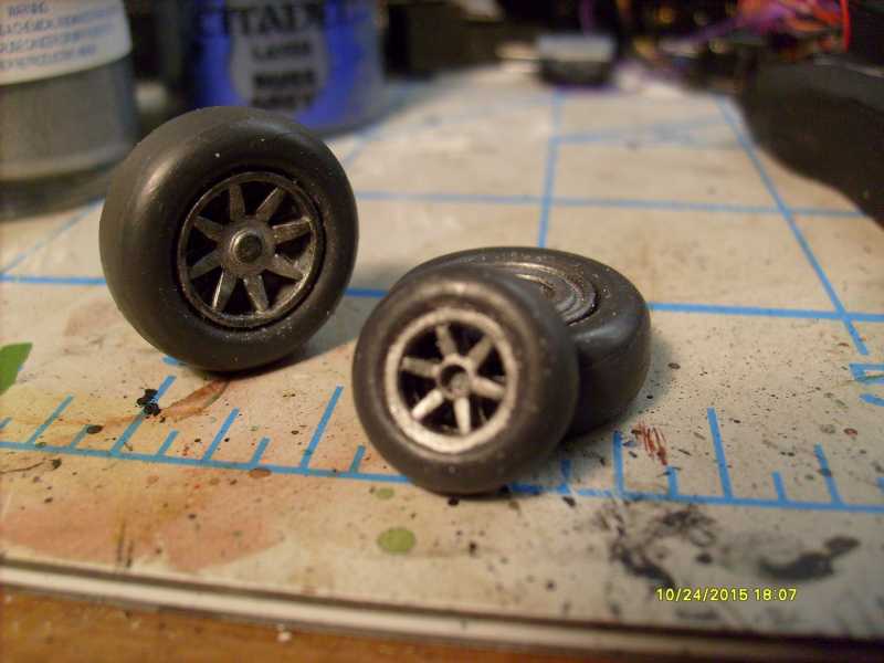

Here's the wheels Done finished. thinking about going out to check the new drill press & grooving these.
now Rich I hope these look the part, this is only MM grey primer, it was a little light so I added a drop of sea blue, made it turn a good neutral gray, I think they are about right.
Looks good Gerry. Gonna regroove them tires ay? Ya oughta try doing that on an 11R22.5 tire... :gogo :eek:hyeah :drinks
Thanks Guys, on re-grooving the front tire is a diamond shape-tread & the mains are ribbed, I guess the front tire is different for traction while turning, man o man I keep building ghosts. :pilot
