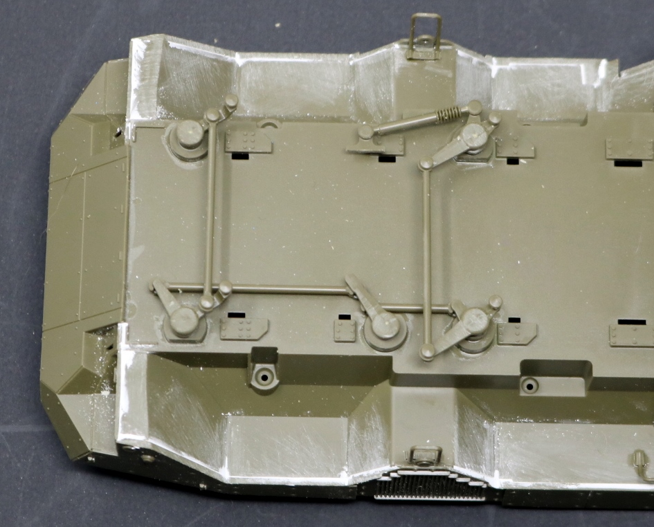

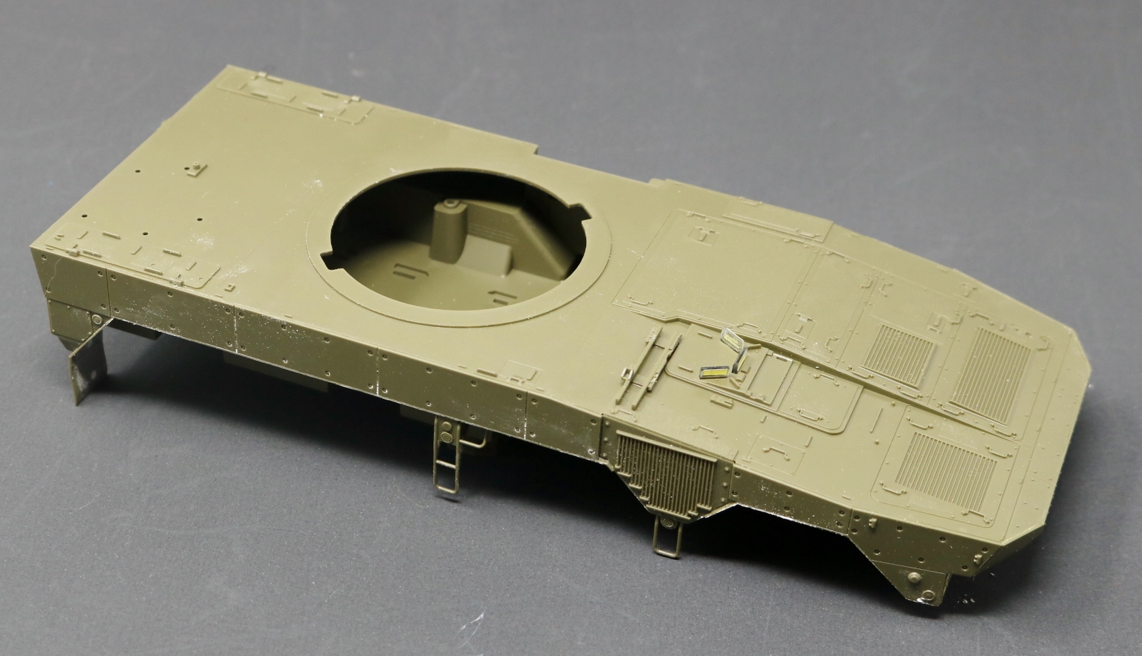

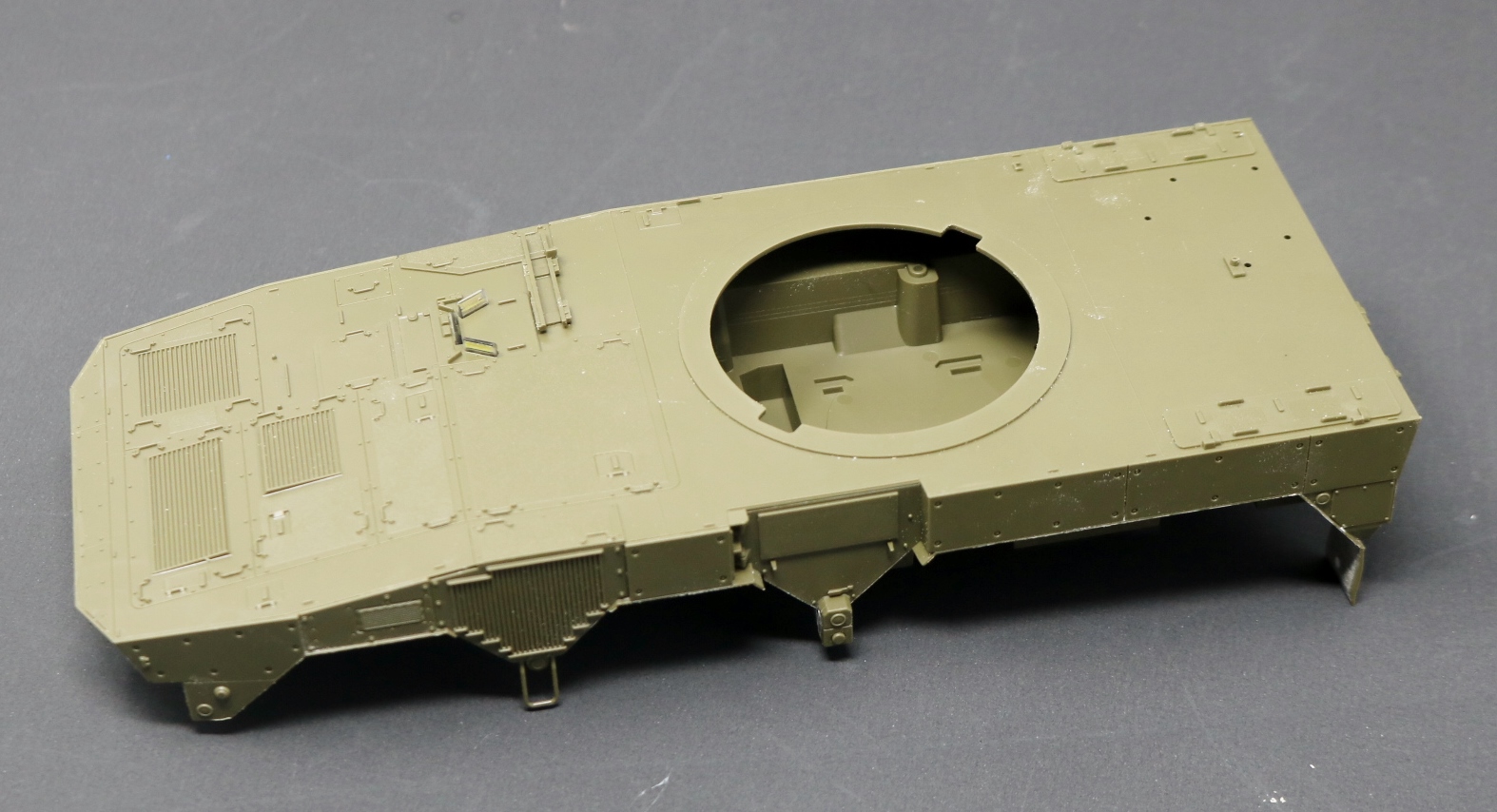

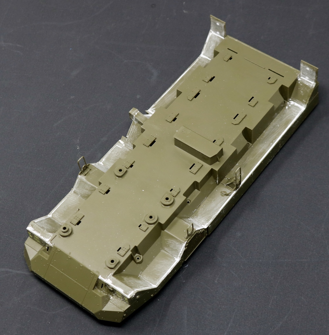

After a couple of hours work, the lower hull is built up. It is a bit unconventional in assembly, consisting of 6 pieces. Don't fear, you don't have to be an octopus to hold and glue the parts together, The upper deck and floor pan are held together by spacers allowing the front and rear panels to be installed, followed by the sides. I applied a little filler were the floor pan and sides met. The clear headlights, tailights and driver vision blocks were inserted from the inside and painted silver. The masks were cutout and applied the protect them.
Next up, the suspension system.

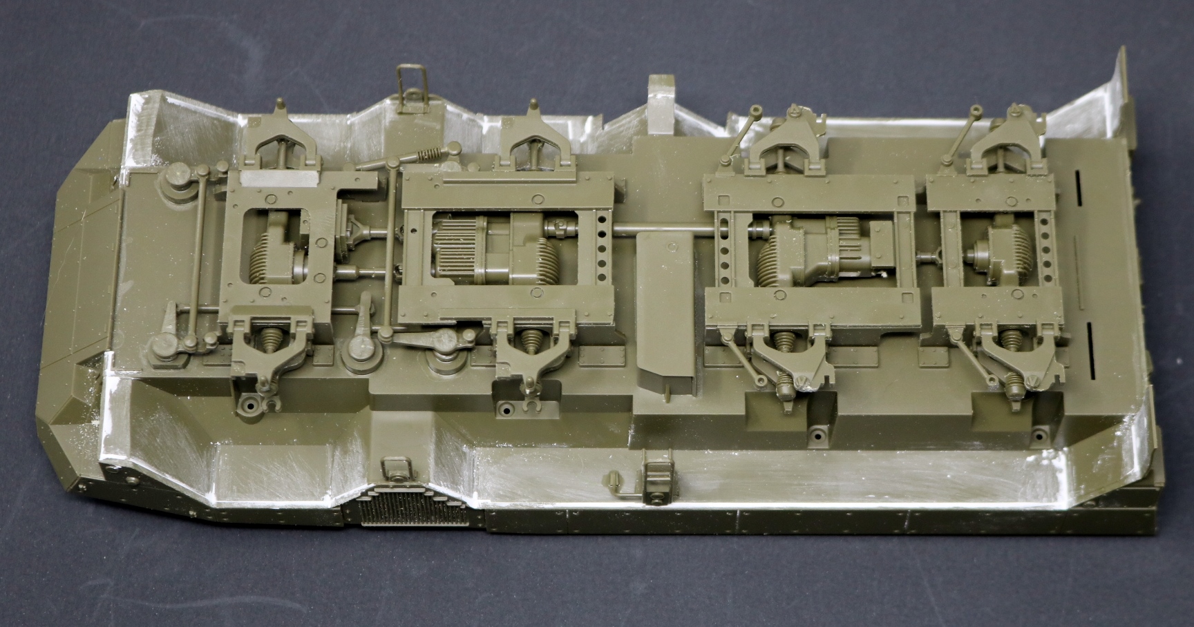

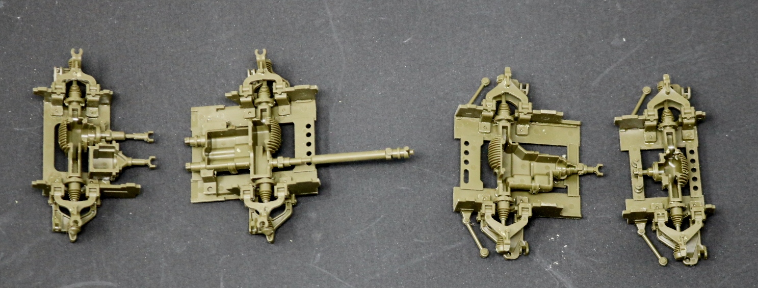

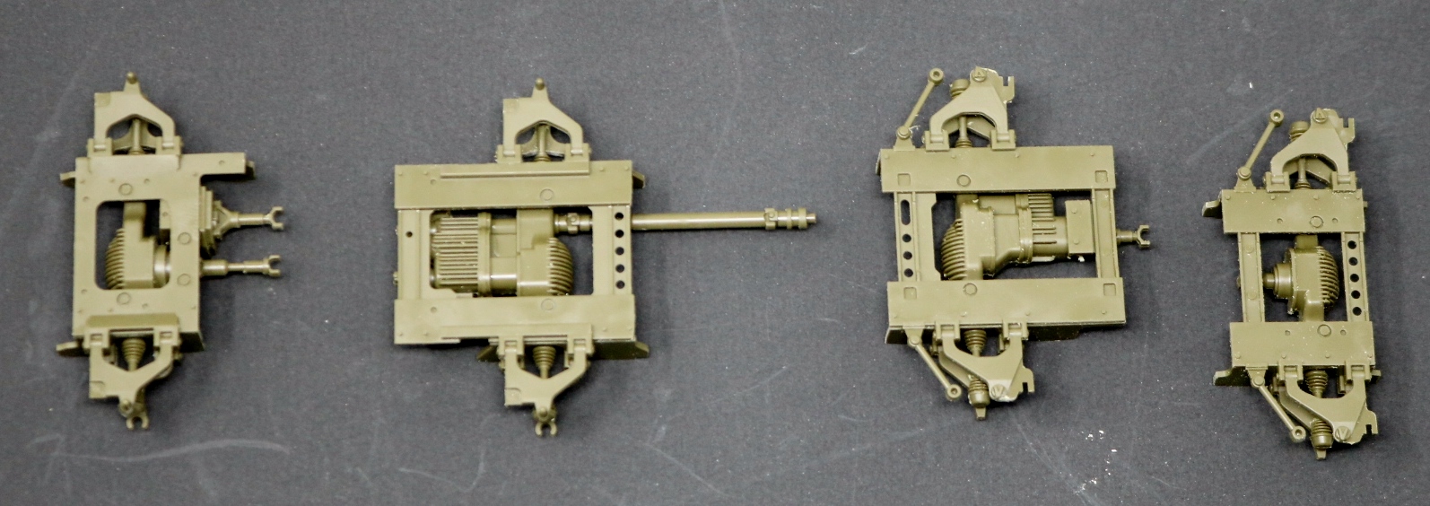

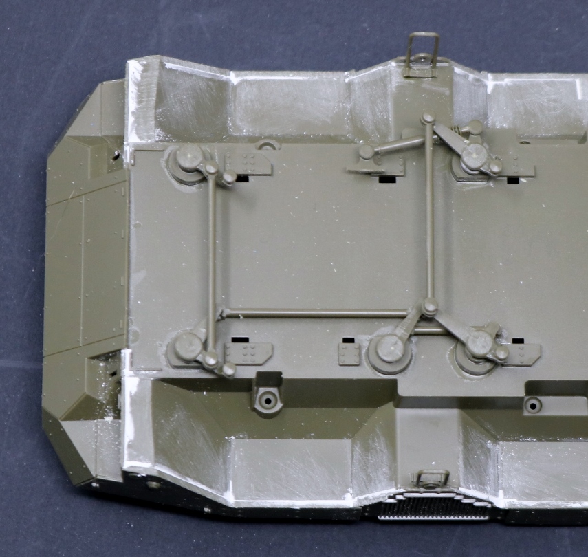

The main suspension system components have been built up.
The front 4 wheels are steerable. Hopefully they will stay that way once paint is applied.
This system trial fitted.
Before everything is fixed in place, the suspension sub-assemblies and the hull underside will need some paint to get into all the nooks and crannies. Will have to look ahead and see what other hull components can be installed and maybe the whole lower hull can be painted.
Cheers,
Rich

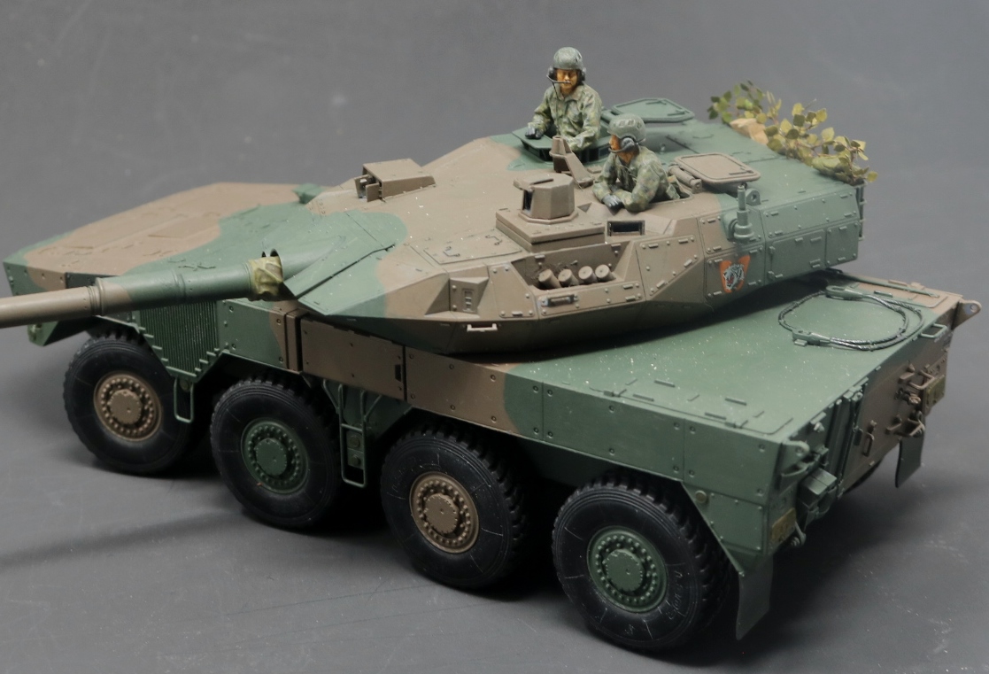

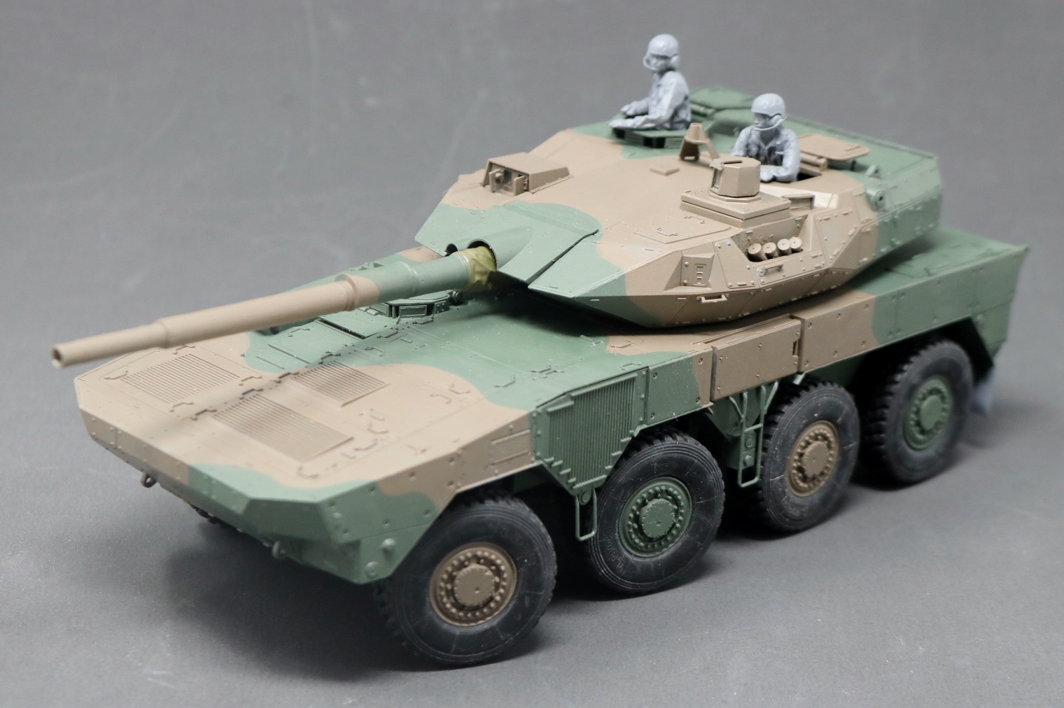

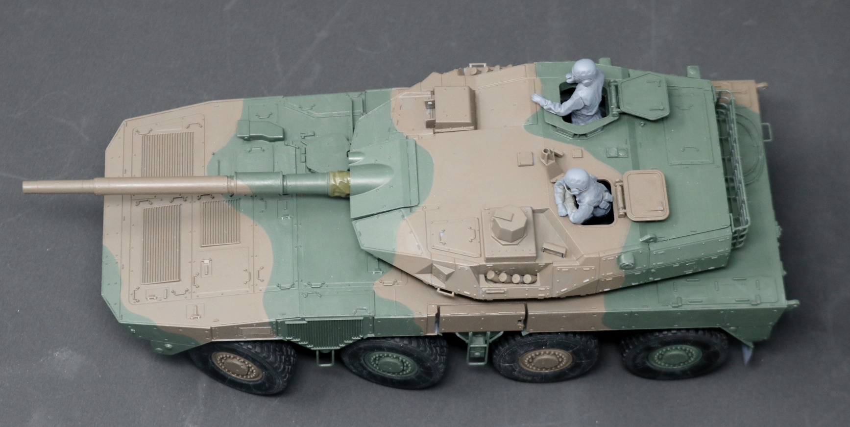

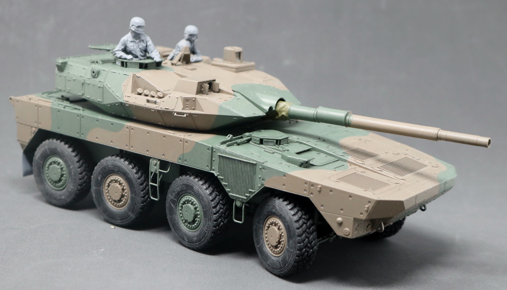

DE/DG camouflage scheme on. Details and touch ups still to be done. Added interior latch handles to commander and gunner hatches. The crew came with the kit, just added the helmet microphone and wiring. The kit doesn't include the rear view mirrors or windscreens often seen attached when cruising highways and city streets. I have some AK Interactive Mimetic Camouflage Net (aka Barracuda) on its way. And the steering linkages all still work.
Cheers,
Rich

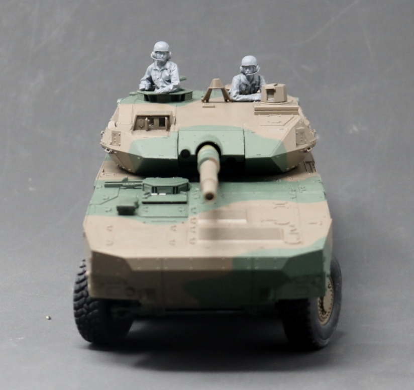

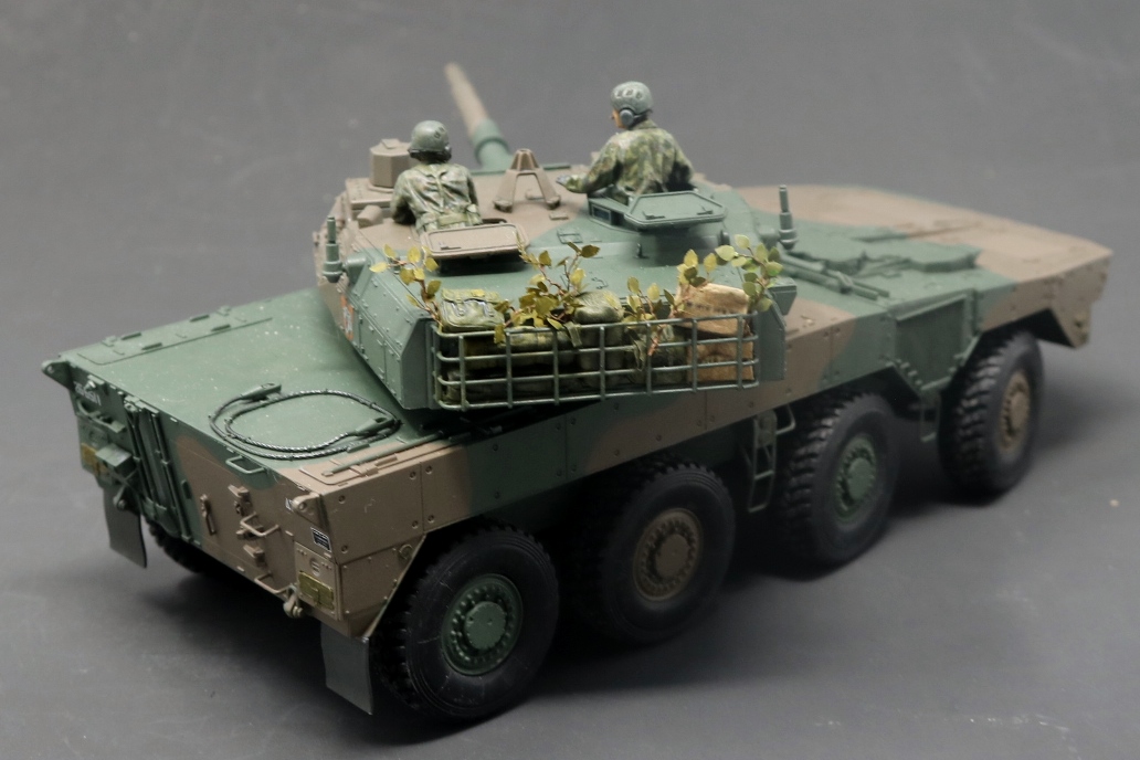

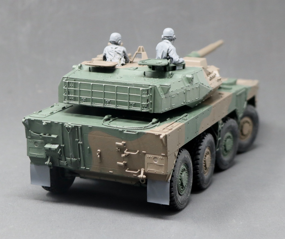

With a new found ability to make tree branches, the Type 16 will be getting some additional camouflage, after I get some weathering done. The turret basket has added stowage from the spares box, epoxy putty rolls and duffel bag and printable boxes. The Commander and Gunner are ready to take their stations.
Cheers,
Rich
