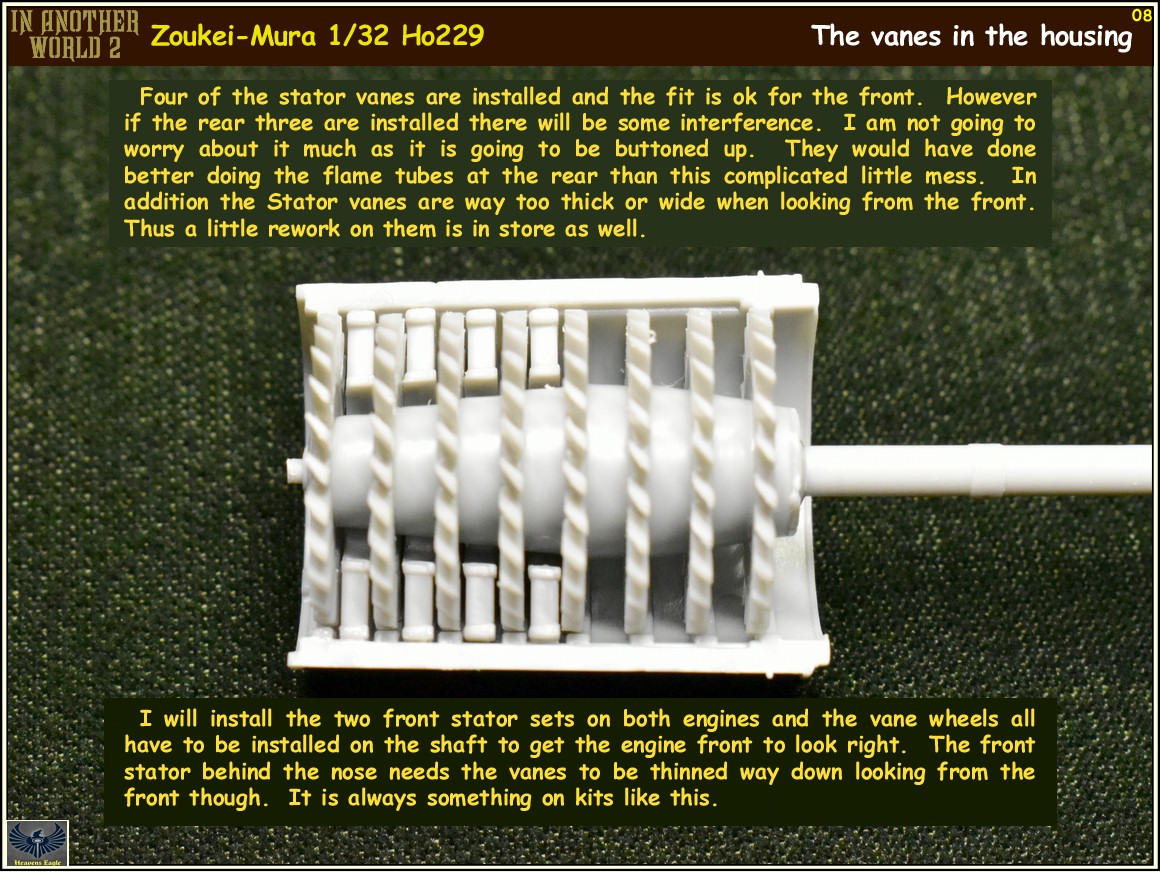

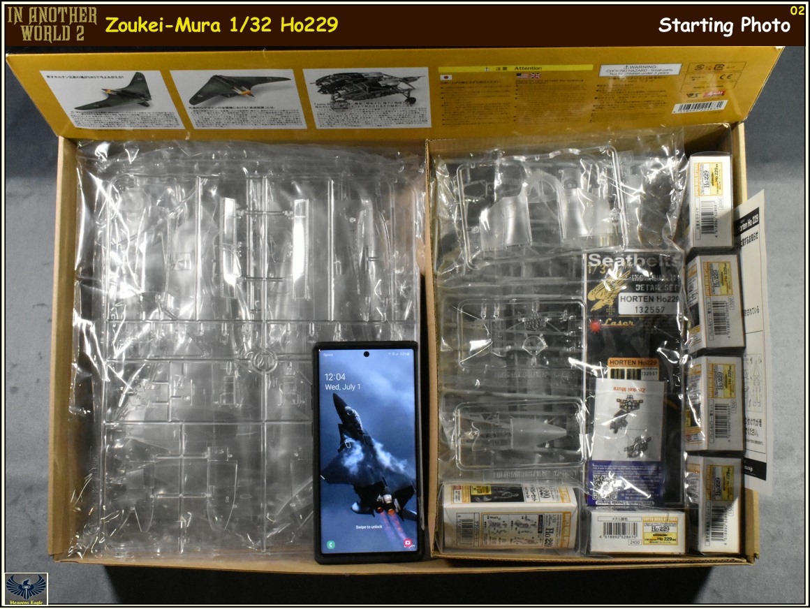

I had some things taking extra time with the Von Werra build so it was time to actually start on this. It is one of the more interesting aircraft and models that has been in my stash and I have been looking at the box every day since the decision was made to build it. It was a bit of a cringe to start one of these. (Not as bad as a WNW build will be) but I finally bit the bullet and cut plastic.

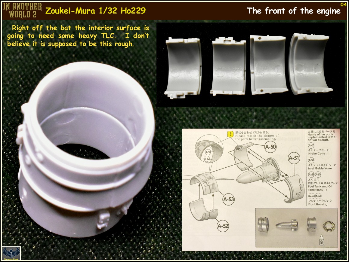

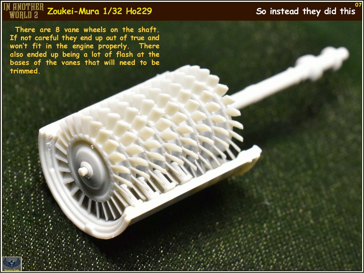

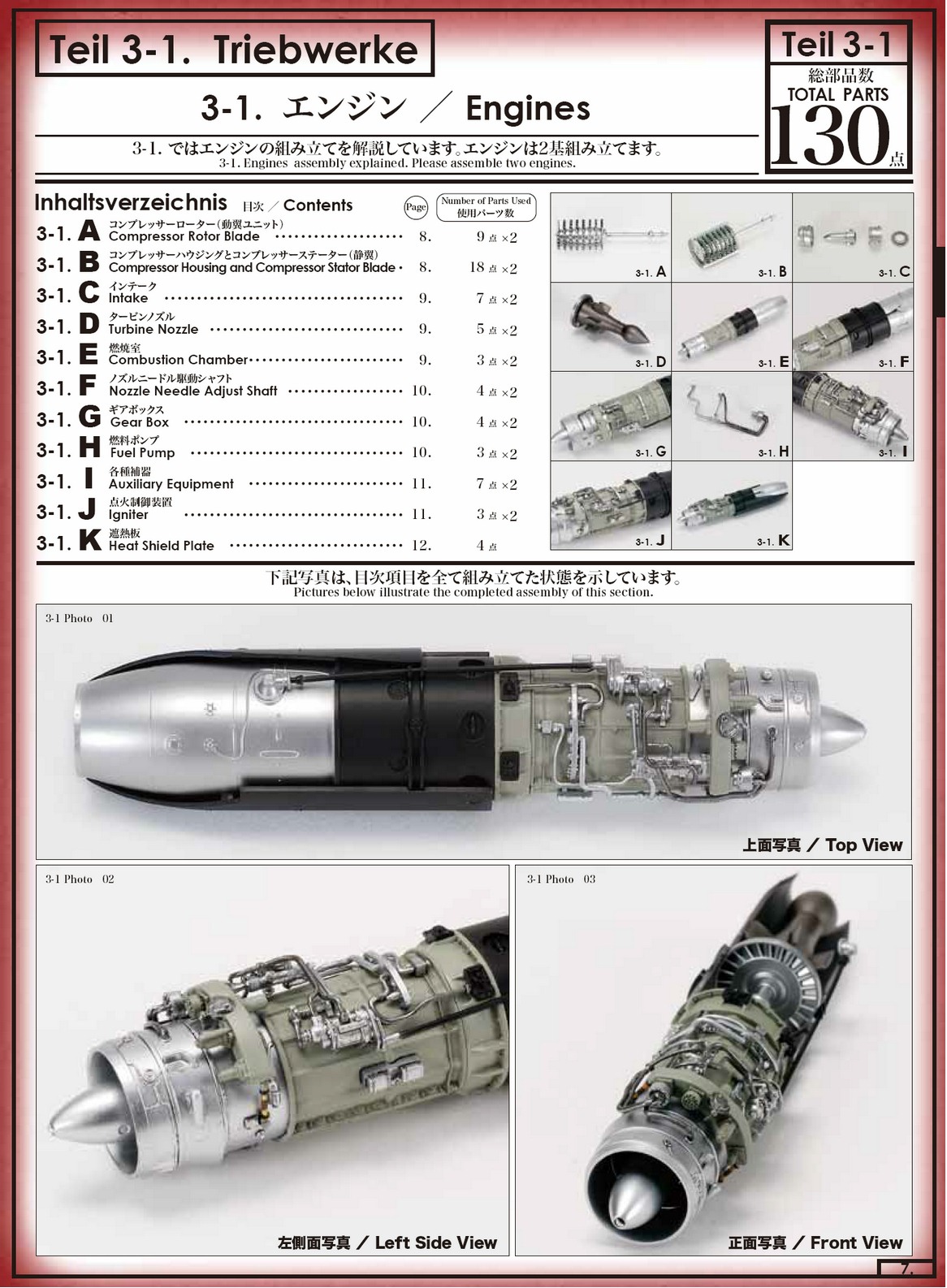

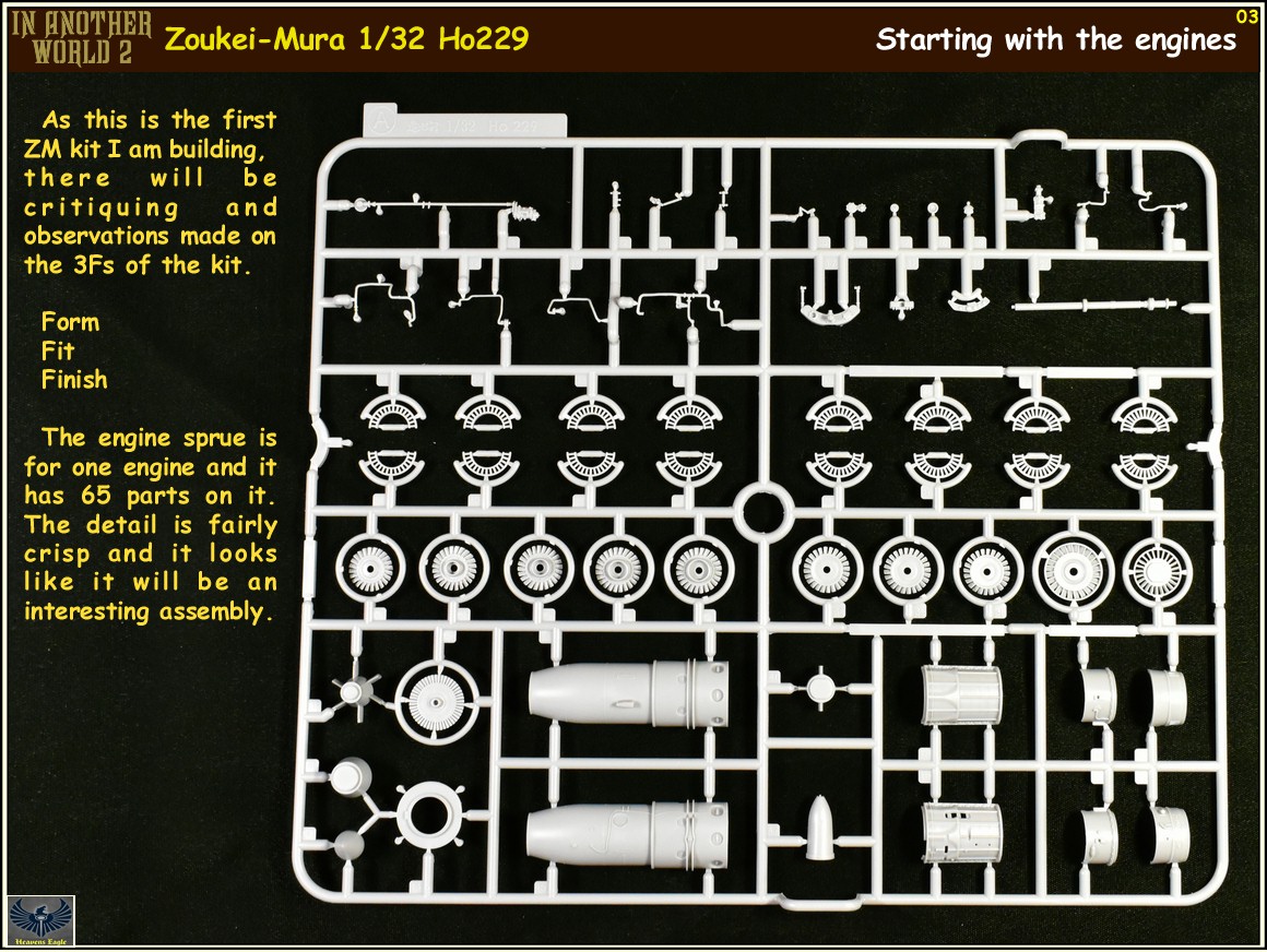

The first thing the instructions have you do is start on the engines. There are 130 parts in just the engines and the kit has something like 319 parts as listed on ZM's site. Of course I have most all of the AM parts to go with this so the build level is starting out on a higher level.
I am also not going to do much to open viewing for the interior parts other than maybe some open panels and maintenance being done.
So, here we go! First off the engine title page from the instructions gives a good breakdown on how the kit build looks.

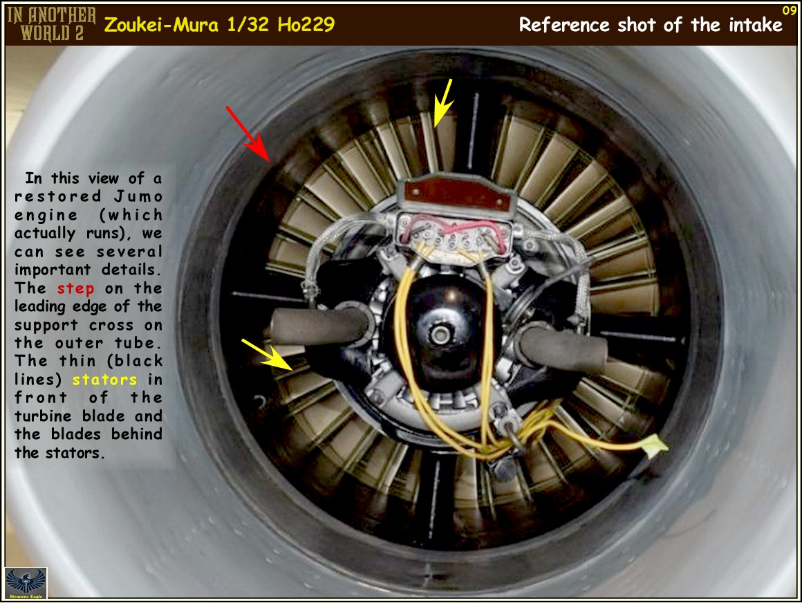

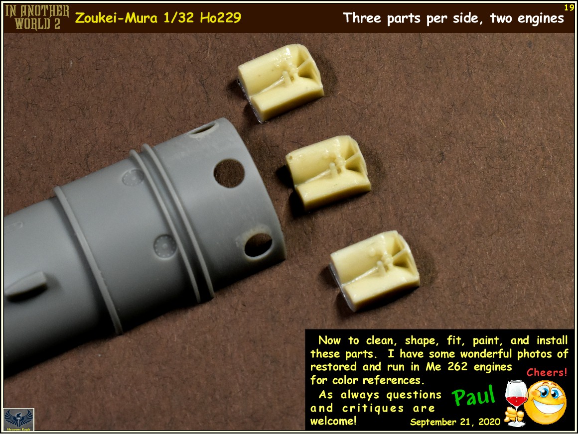

No, most of the engine paintwork will be references from the Paul Allen Me-262 restoration as they have some awesome photos online of these engines.

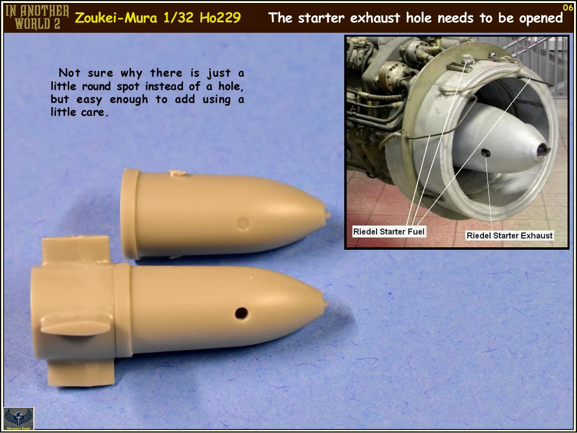

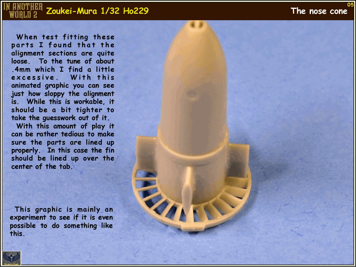

Definitely a different kind of build. I am a little surprised at the things I am discovering with this kit. I am sure there was a ton of research done on it, but the little gaffs I am finding makes me wonder a little bit. I only address the items that pop up when doing research and when the photos show something noticeably different. The engines should never be an issue with errors as they were used in a number of aircraft and the reference photos were easy to find online.

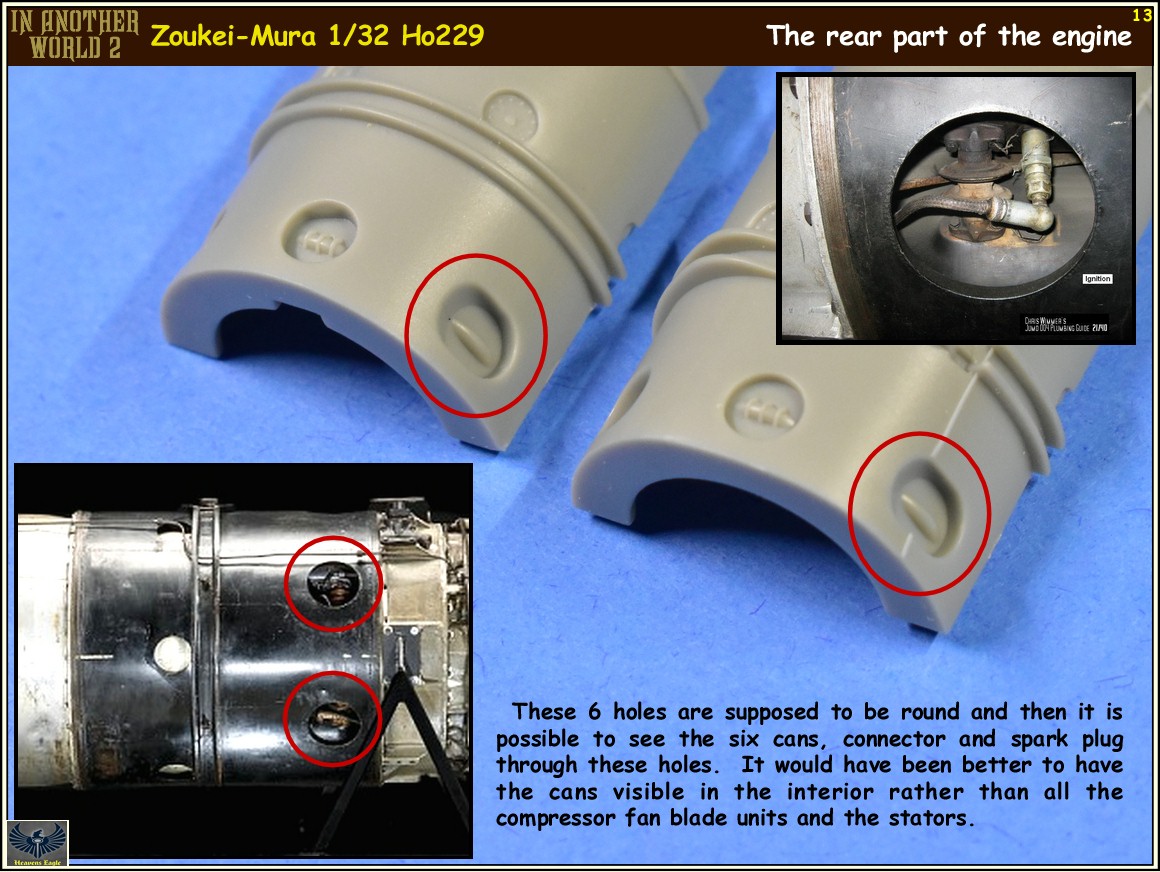

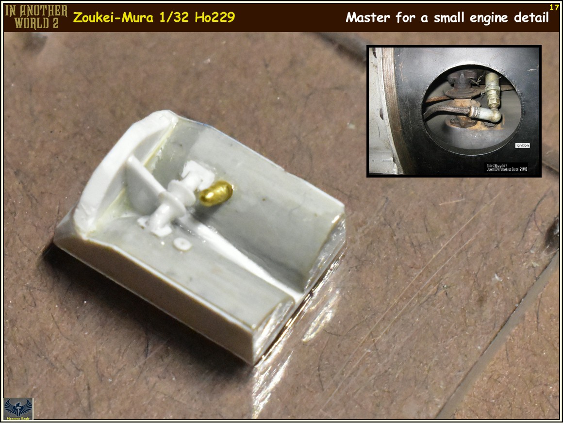

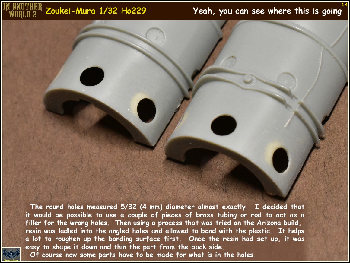

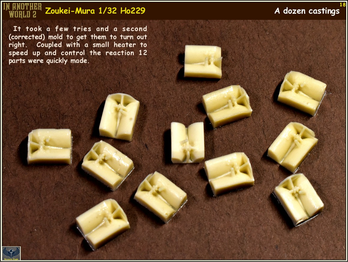

OK, I have a little quick info post here. Right after posting the engine startup I was scanning down the ZM page and they have a resin upgrade to add the combustion chambers. I won't be getting this, but will be making a master to add the details seen through the holes I just added.
Here is what their resin add on looks like.

Bob, I think ZM kind of had that in mind, but the complexity and fit internally doesn't quite work all that well. Too many tolerances that add up weird. I only built the engines with the front 4 sets of stators in order to give it a decent look down the nose.

Bruce, it is an interesting aircraft and it seems that overall ZM did a decent job on the kit. It is a first time building one of their kits. Definitely not a shake and bake kit, but seems decent overall. We will see. Thanks for looking and commenting!

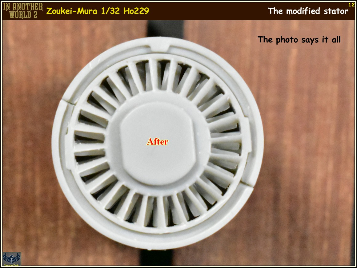

Another quick update on this little beastie.

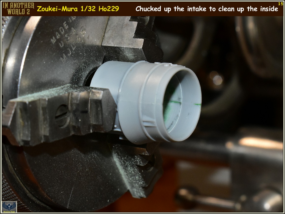

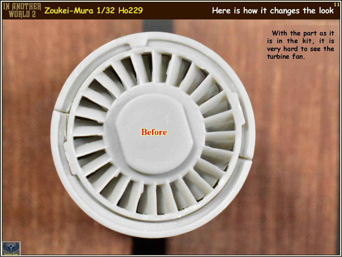

I also took one of my super fine escapement files and thinned down the front stators a bit more. Once painted the front of the engine should be rather interesting if not impressive.
Thanks for looking in!
