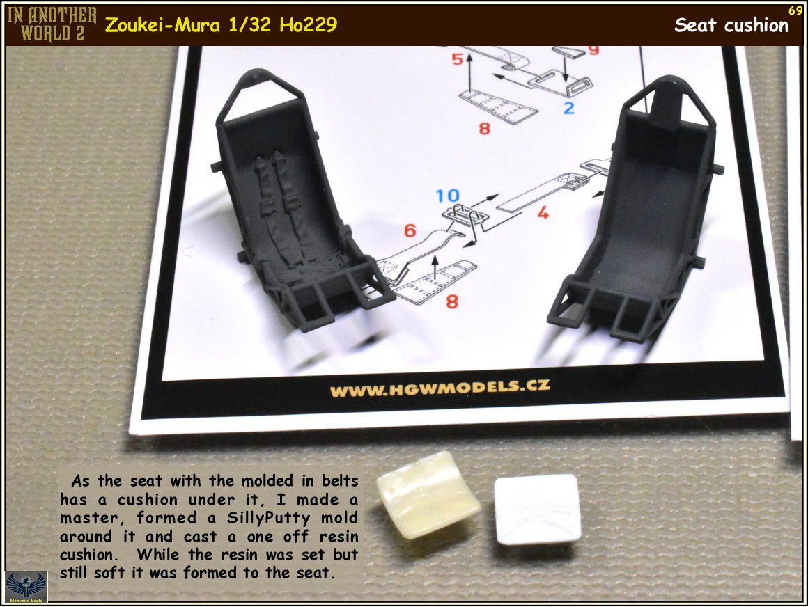

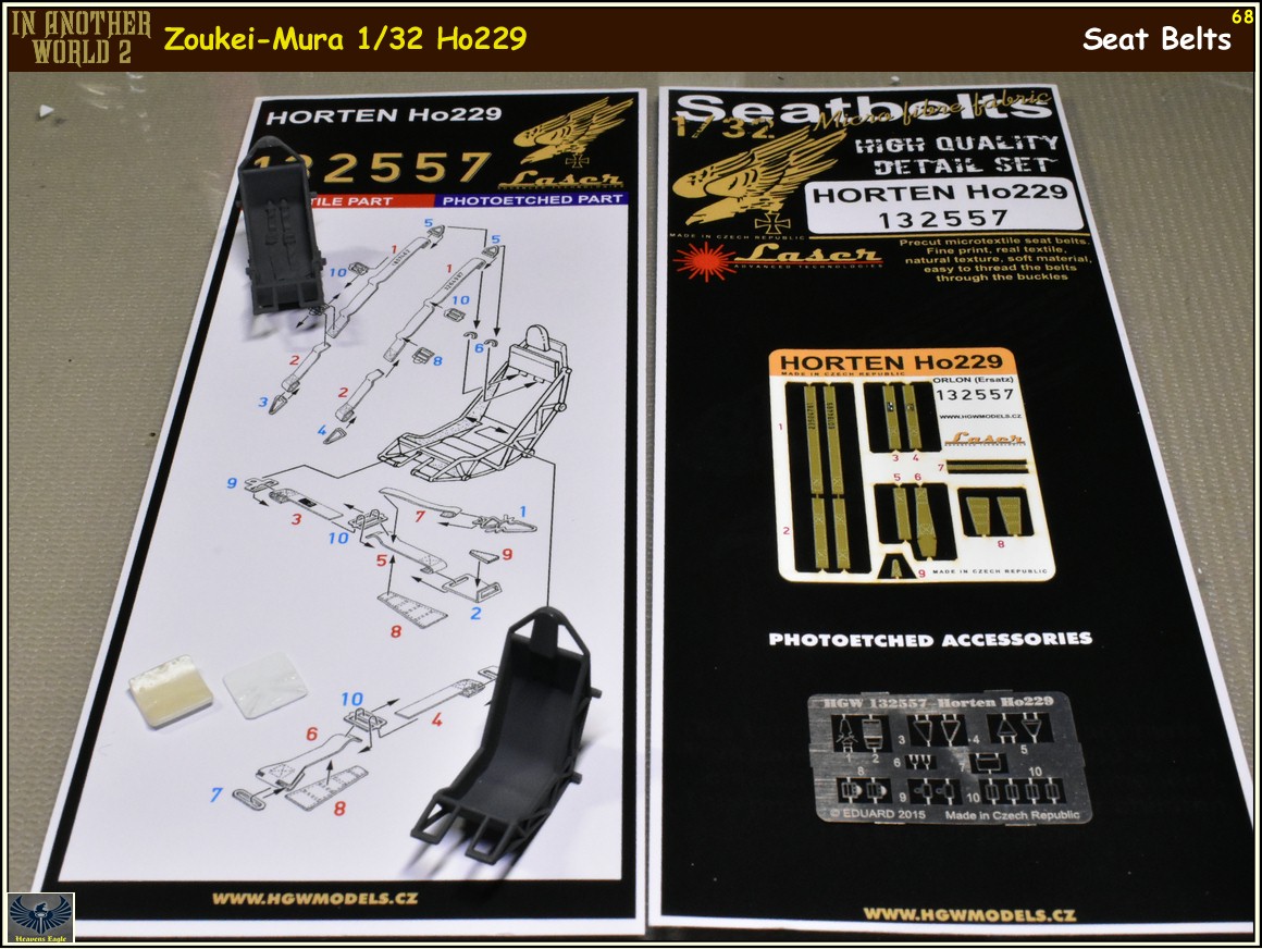

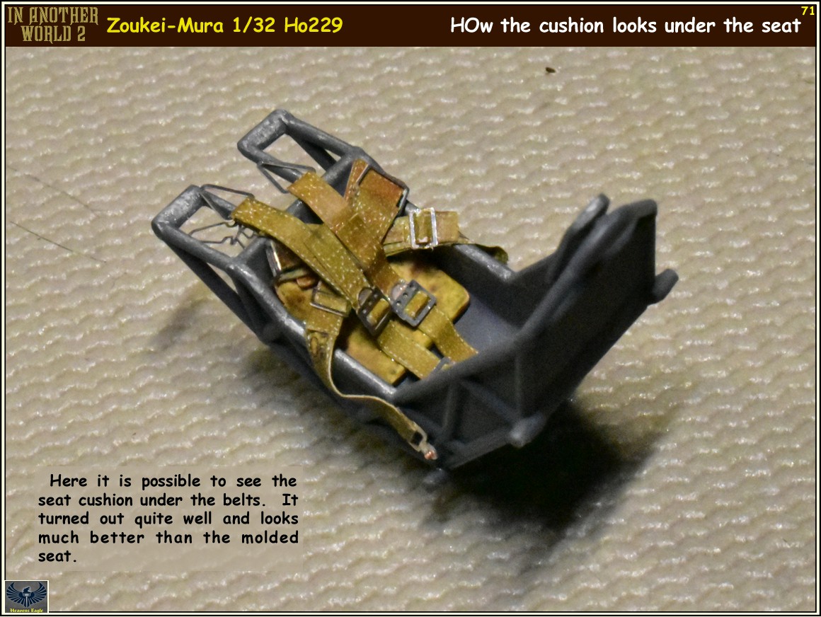

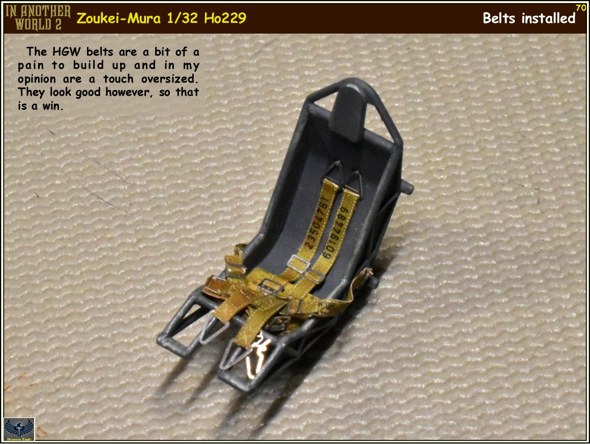

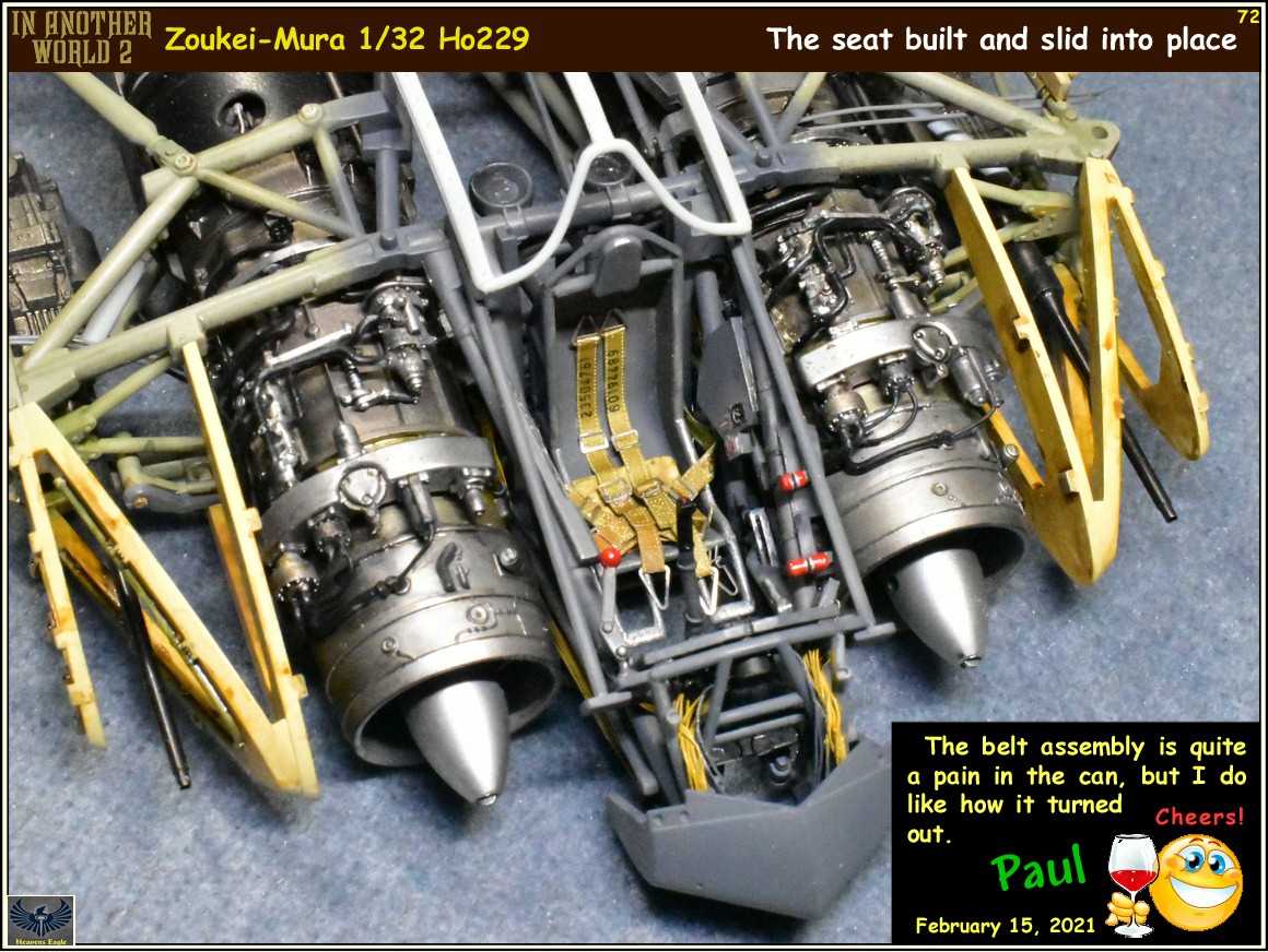

Over the weekend I spent some time on this again and finished another little milestone. I have a number of HGW models seatbelts in my build stash for various kits. The biggest problem is that the assembly drawing does nothing to help assemble the belt set. I went to their site and downloaded photos from other German aircraft that used the same belts but mounted things different. This gave the clues I needed to build these up.
They also say to wad them up a bit before assembling. The color on the top tends to crack when bent sharply. The back sides of the belts are also white when the backing is removed. They are a pain to build and I used a lot of magnification and a number of fine SHARP tweezers to get things to work and assemble up. If you have some of these and want to get some big hints PM me and I will be glad to converse and explain how to make it easier.
Here are the photos.
They look a lot better than the old PE belts that Eduard does, and a lot better than the molded item in the kit.
Bob, Mark, and Martin thanks for looking in. This has been one of the most involved builds I have ever done. The fit is pretty good considering the complexity of the build. The extreme detail is a definite plus.

Thanks for looking in Dave! I like how the HGW belts look I do think they are a touch oversized. I did find that using some CA remover will soften them and make them a little rubbery. Almost blew it there. Somehow I ended up with a second set. Not really a big deal as these are standard German belts and can be modified for a different plane fairly easily.

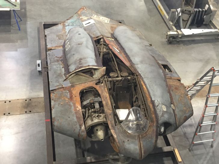

Thanks Ian! I hate how a lot of the detail will end up mostly hidden. That is why I will be cutting loose another access panel over one of the engines. Parts can be seen through the cockpit and I could leave the skin all clear in some areas, but am choosing to remove one of the other panels in order to show one of the engines. This photo will give a little idea what I have to do.
Thanks Paddy! I appreciate your kind words. I don't know about "super hero", but I am working on this as a bunch of sub assemblies. It seems to work best and it helps to have the references such as they are to use.
Thanks John! It is so sad that the Horton in the Udvar-Hazy center is in such poor shape. Apparently it was left to sit outside for a number of years at one point. They are doing some amazing things to refurbish/restore it. At least it still exists and we get to see the original and build the models. The other amazing part is that there are a number of the other Horton brothers flying wings still around and they are either fully restored or also in process.
