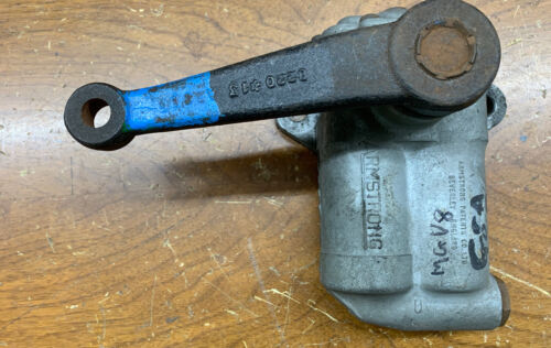

Thats right John, i had a 1967 MGB GT from about 1980 to 1995 and it had what we called, lever arm shocks , bit like small bottle jacks.

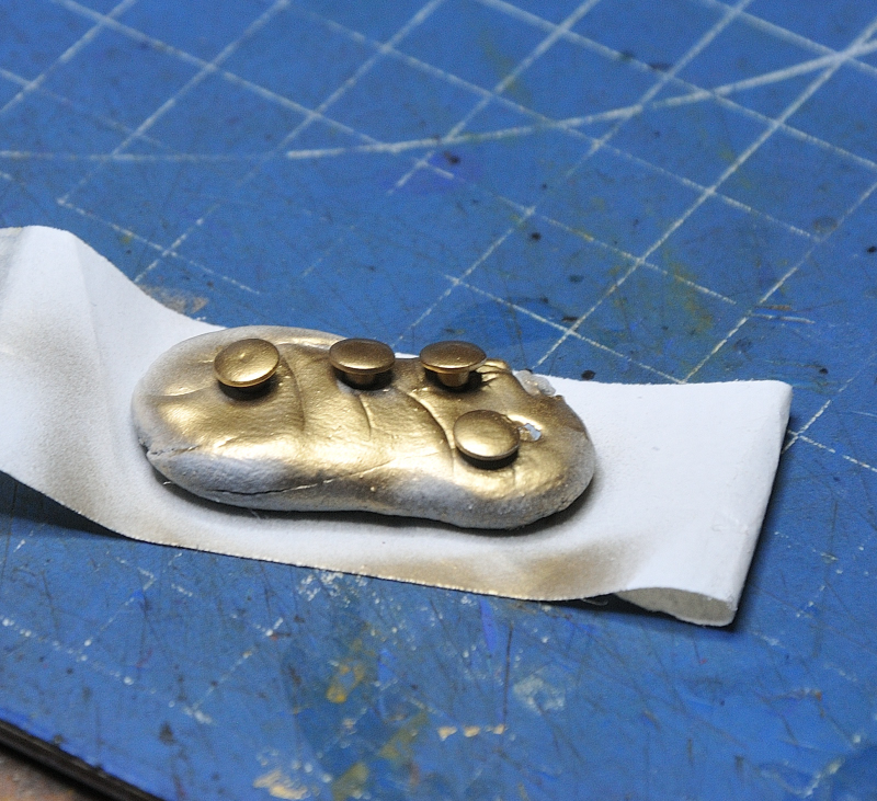

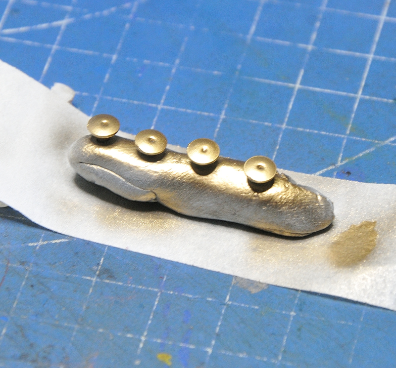

Today i gave myself a lesson in doing things properly :)

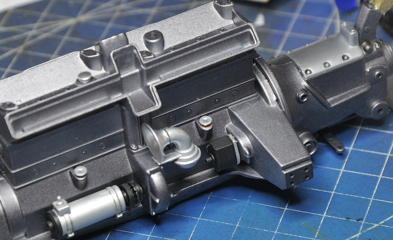

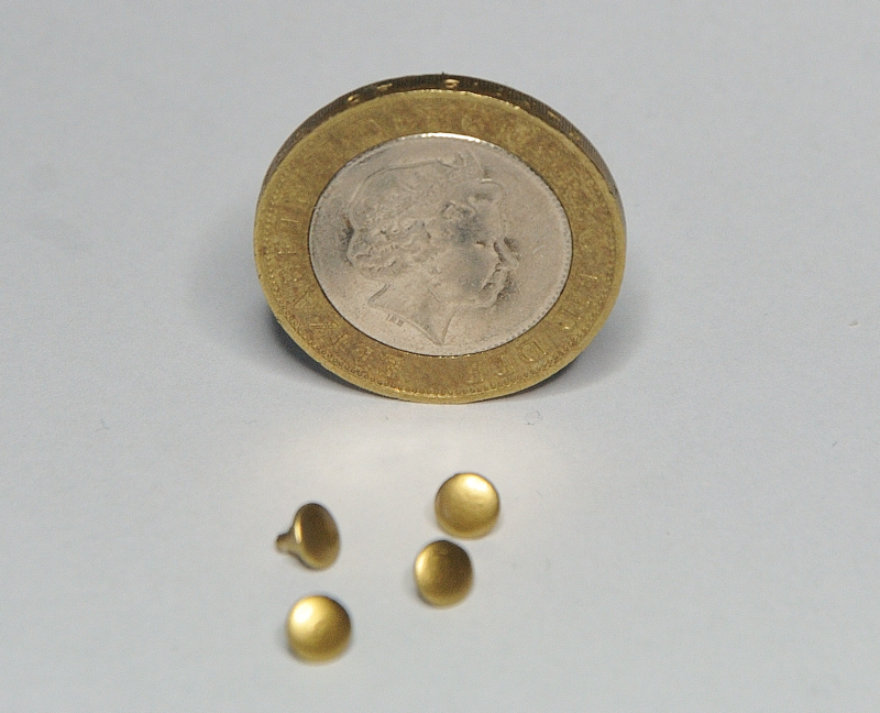

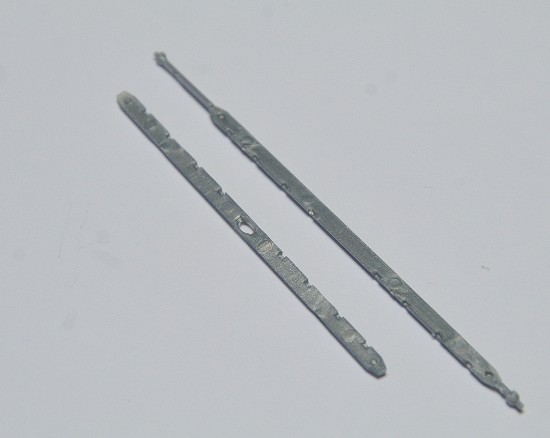

these are the filler caps for the rocker boxes (cam covers, whatever you lot call them :) )
they should be silver, probably nickel plate however i decided to do mine brass.
I was a bit troubled by the holes in the middle but they were so uniform i thought they must be correct, anyway having looked at my reference pics they are sink marks !!
No problem , clean them off and ,throw some filler at them
Better but the filler is contracting as it dries and the holes re appear.
OK paddy, stop messing about , take your time, do it properly...
thats better, so why didnt you do that in the first place. ?

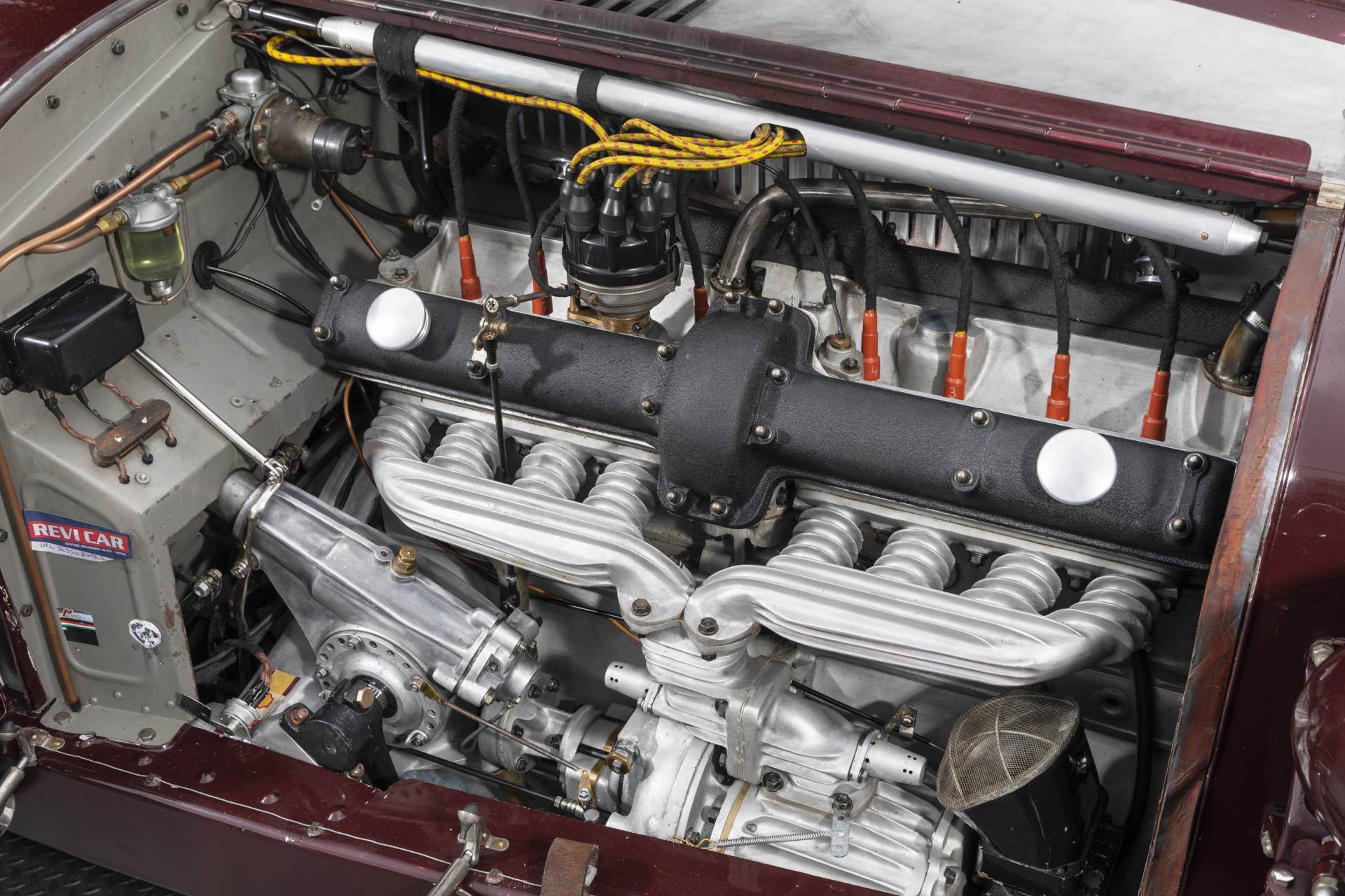

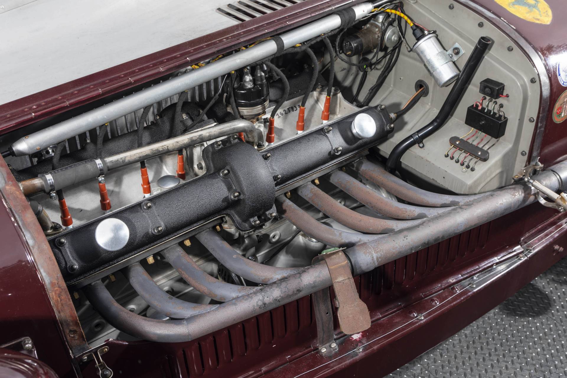

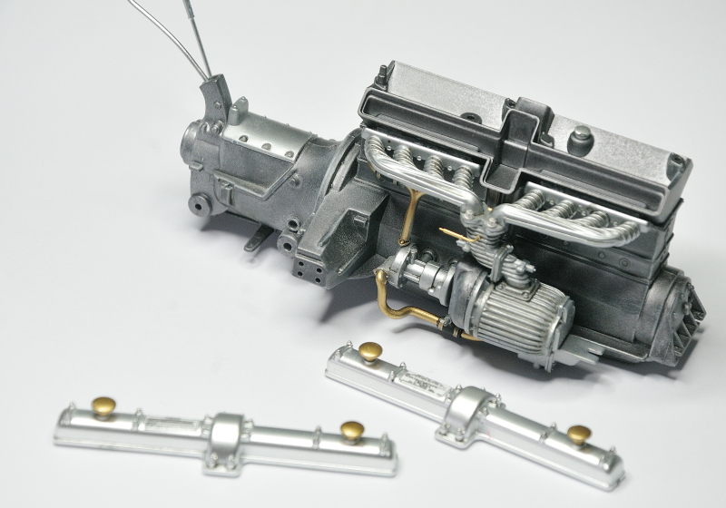

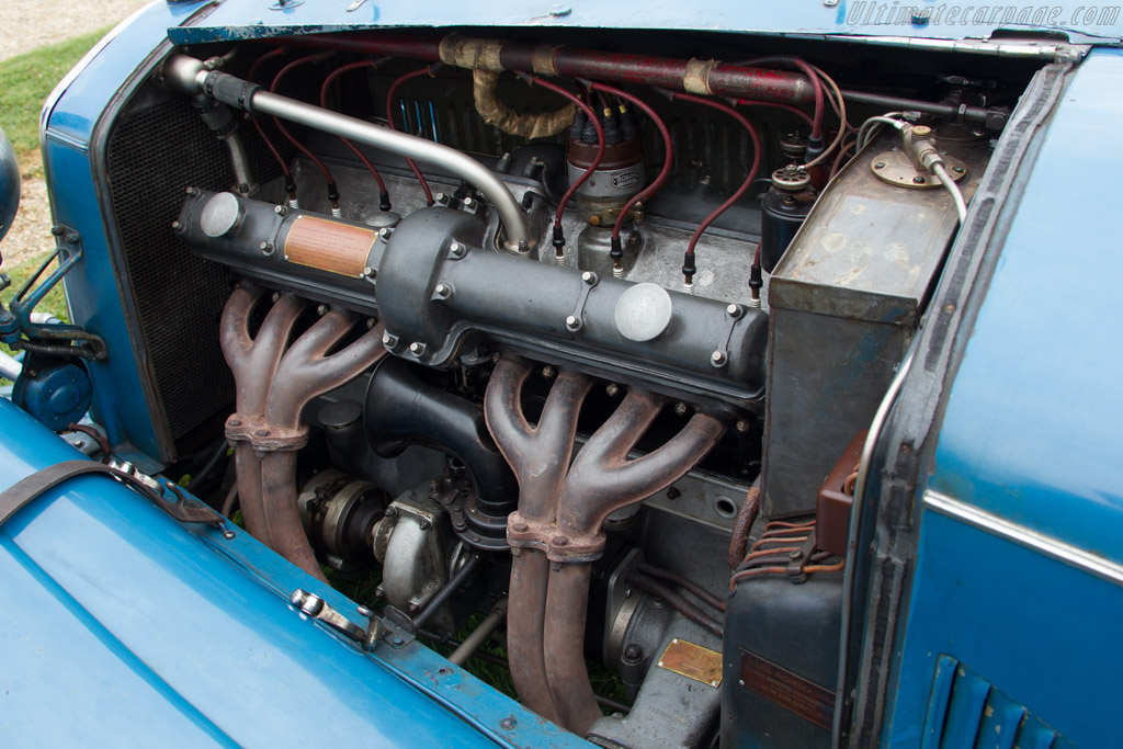

The danger with using replicas and restored cars as reference is they may actually be quite different from the original.
This is my reference but wait ? is that a 1995 Lucas Coil i see ? Surely this would have been on magneto's.
this side has an electric fuel pump ? and filter bowl. the original would had non of this which explains why the there is no detail on the kit Bulkhead. Now do i add the fuel pump to the model and the plumbing to make it all look a bit busier or go with the original. I am leaning towards the fuel pump............................i think but maybe not the coil.

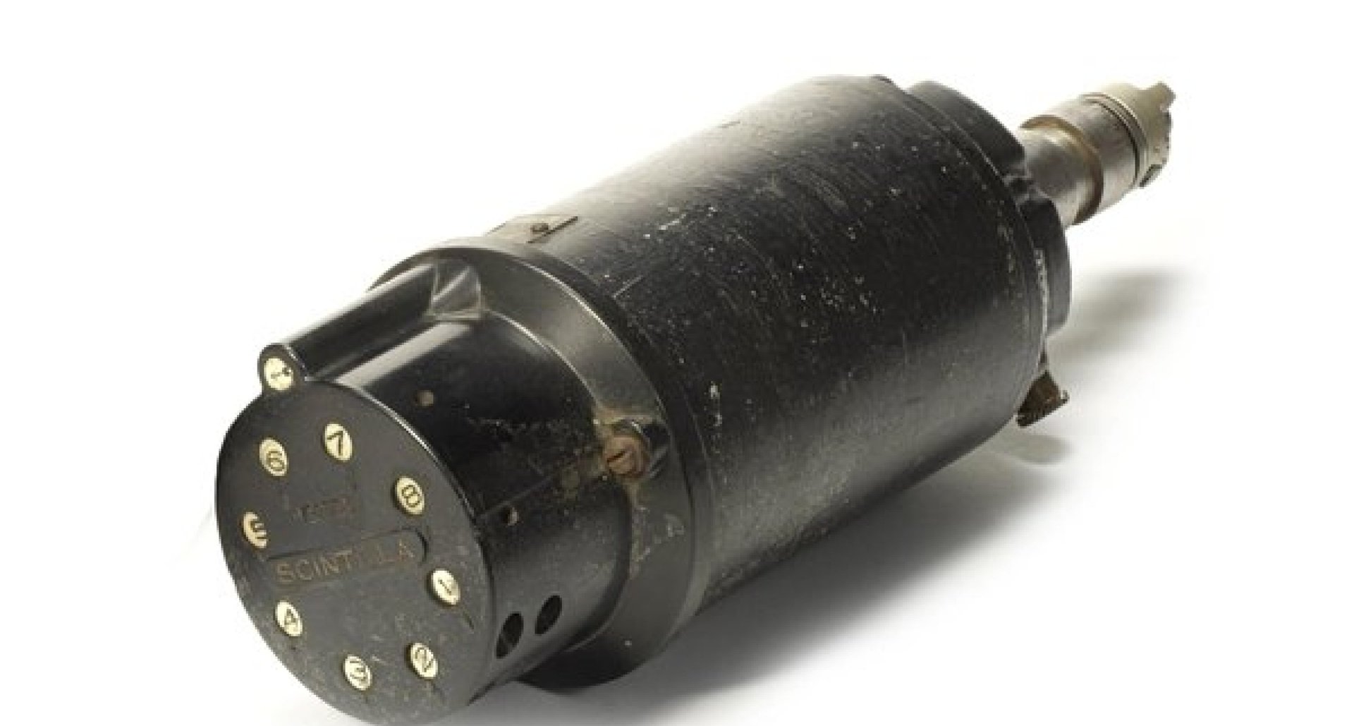

Hi John
this shows the magneto
Its under the rear exhaust down pipes
On the model its in the same place but its the more conventional shape and tyoe

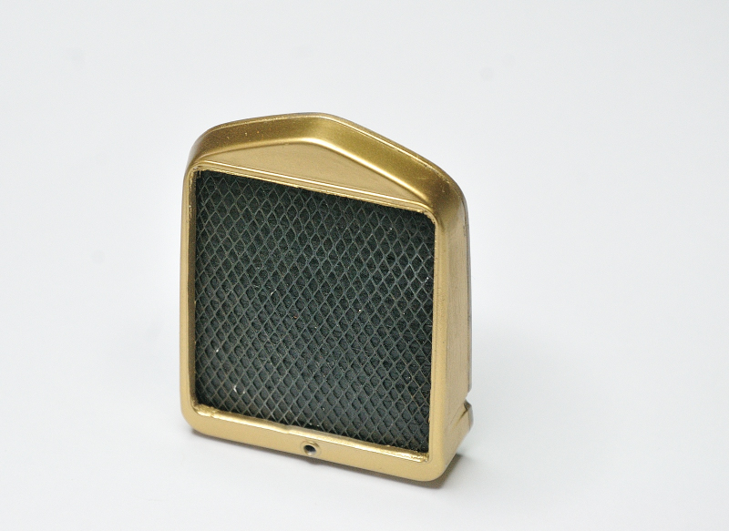

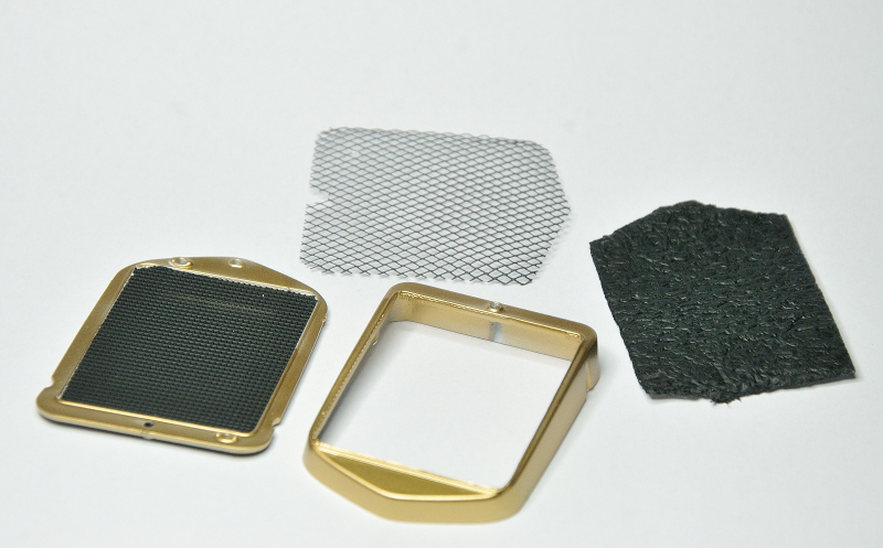

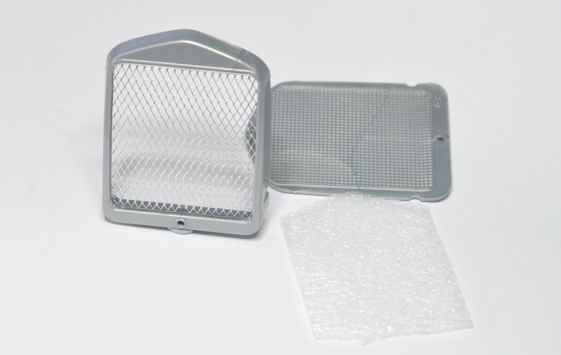

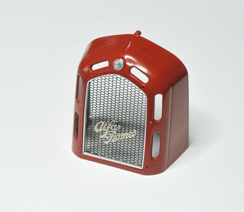

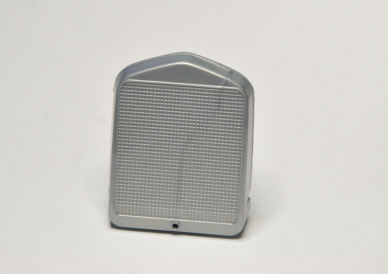

The radiator is nicely moulded front and back with a mesh pattern that would stand out well with a little dry brushing however i decided to cut the middle out and use wire mesh
here it is cut out with the back panel which i will leave as moulded
Here's the wire mesh fitted and a bit of foam to pack it out
and the parts with black and Brass added
I have progressed the radiator cowl to try out my paint choice of flat dull red with a gloss coat. I dont want a modern mirror shine and this method is giving me an orange peel semi gloss which is fitting i think for the 1930's

I like your choice of color/finish. Whether or not it's "correct" I can't say. But to me it "feels" right.

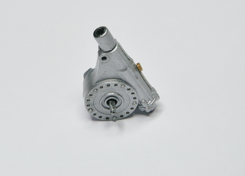

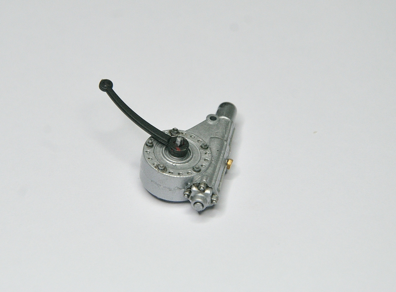

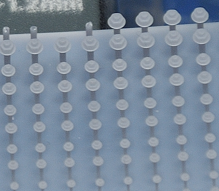

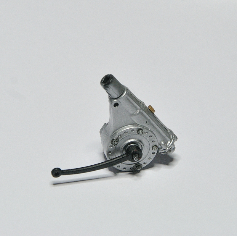

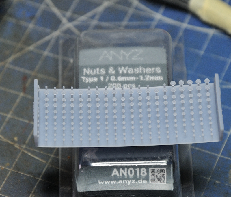

These are quite nice, they are 3D printed nuts and washer combo's in 0.6 - 1.2mm
the effect is very nice as you can see here on the steering box
This is the kit part with very small bolts on the front plate.
And this is with the ANYZ nuts fitted

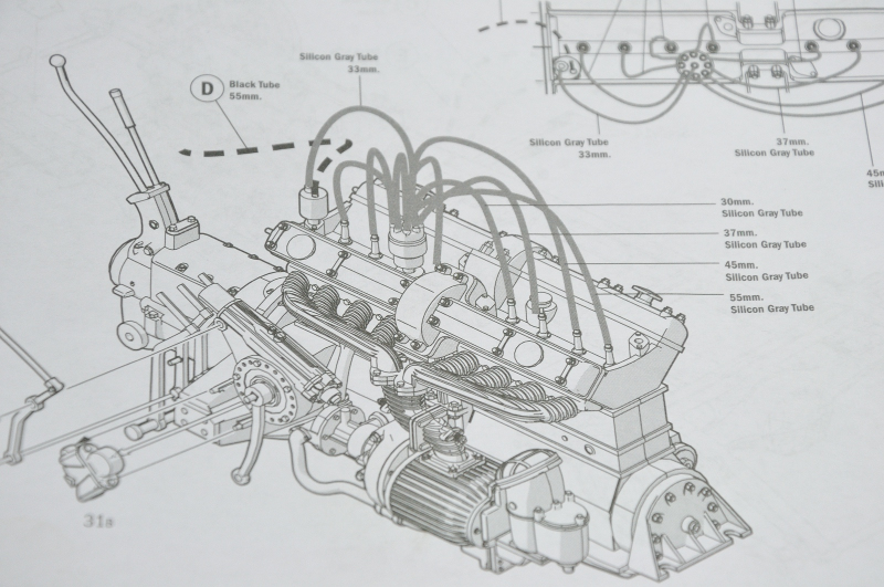

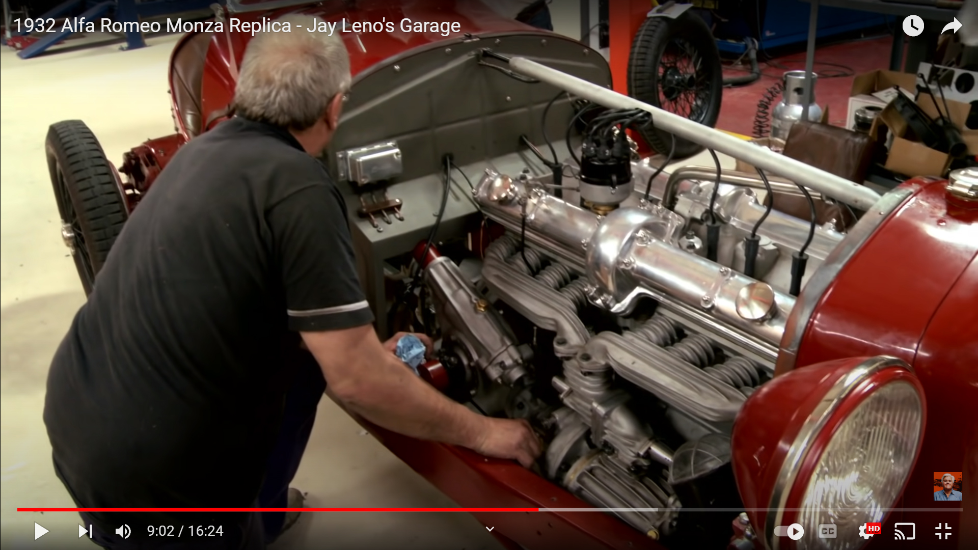

This is interesting, the ignition leads in the instructions are as shown
however looking a JL's car in his you tube video you can see the leads were kept out of the way by putting them in a tube above the engine
The kit actually supplies this tube and shows how to fit it however its completely pointless as its purpose is to carry the plug leads.
I can see why they have done this as its not going to be an easy fit but i think they probably intended this as the tube ( which is solid ) does have an inlet and 8x outlets. I suspect they thought this might be a complication too far for most.
Hands up who likes a challenge ....gotta give it a go. :).
Totally replace that tube with a real one and at the least pipe the wires in and out of it. I've seen that on the WnW kits.
