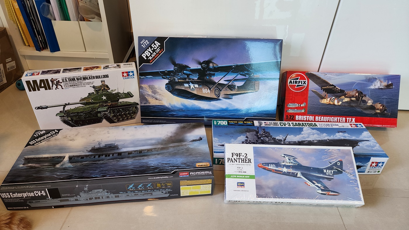

"I'm only going to buy kits one at a time as I build them.... I swear"
hamchuck
Yeah, that's what I said to myself when I got back into the hobby. I even kept to it for a long while. A couple weeks ago I had ONE kit. An impulse buy at the only decent hobby shop in Dubai, then another impulse buy online, then okay, I'll take part in the group build...
I bring it up here because I know you guys understand.
You have broad range of interest that's for sure Al. Which one we building next?
The F9F, for the group build. I'm holding off on the Catalina, first because I might be moving soon and that will be harder to keep intact, and second because I'm thinking about putting it in "water". I've been playing around with epoxy resin to that end. I want to do the ships that way too.
All these are excellent kits! The Panther is dated, but still a fine model. The M-41 is my favorite tank. All your options seem like good ones!

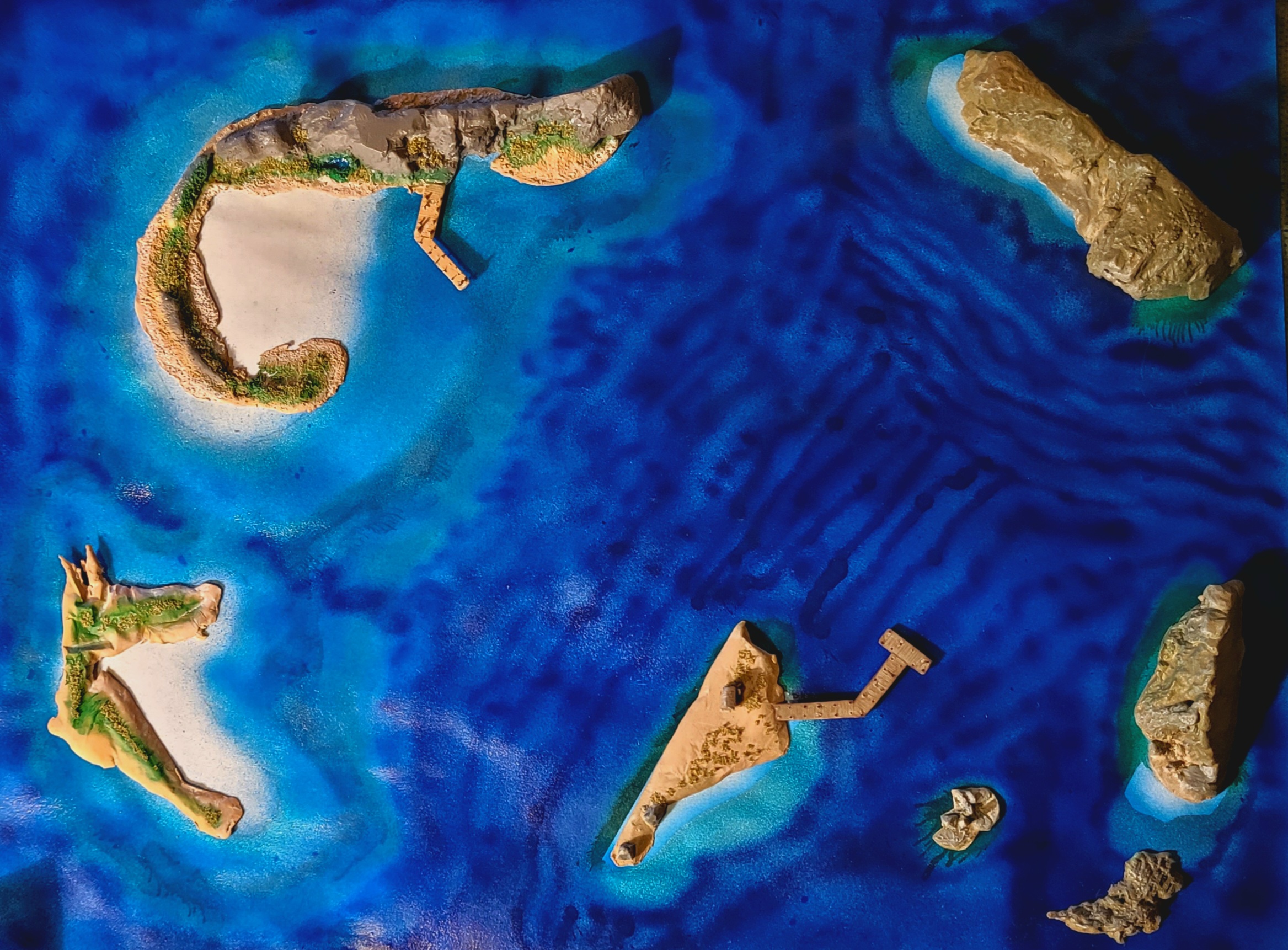

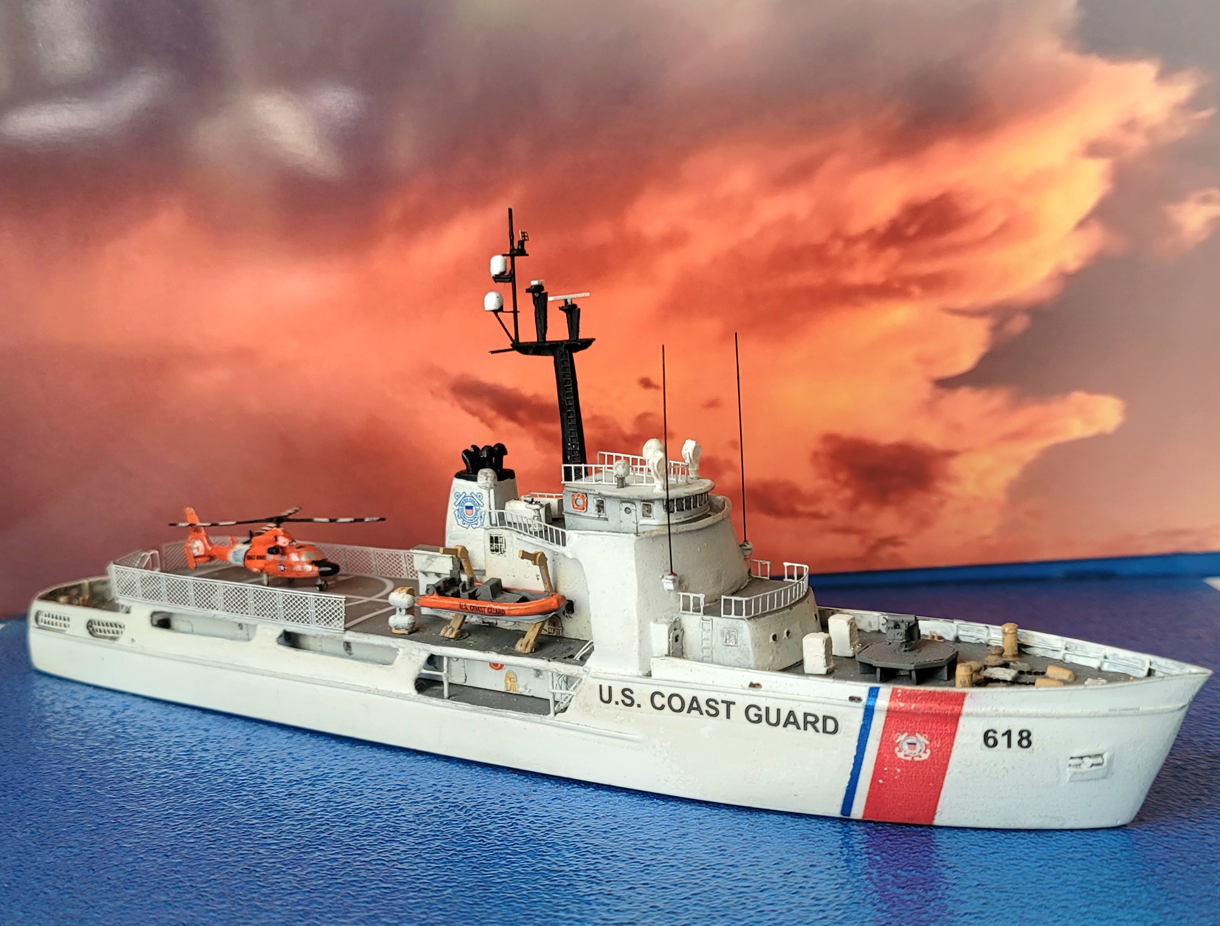

I make a few ship models on water bases at tlarmodels.com
There are lots of materials to use to make convincing water.

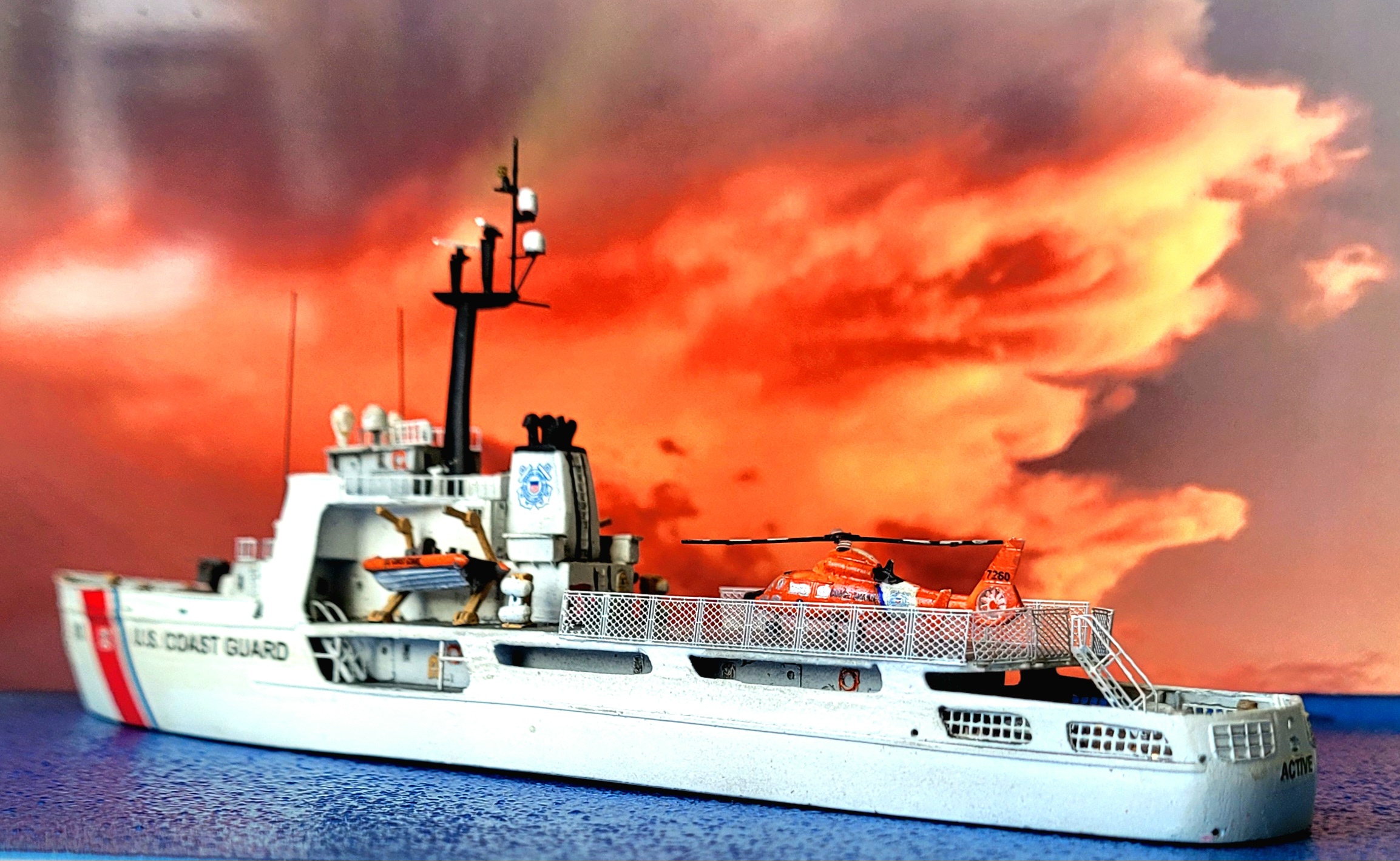

Saran wrap over painted Scluter System shower board, for example, makes an interesting texture for calm seas.
This base has been used in quite a few "At Sea" pictures.

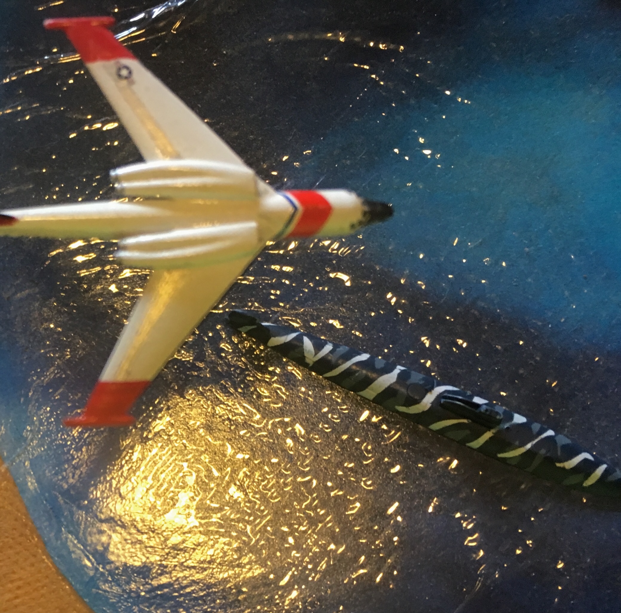

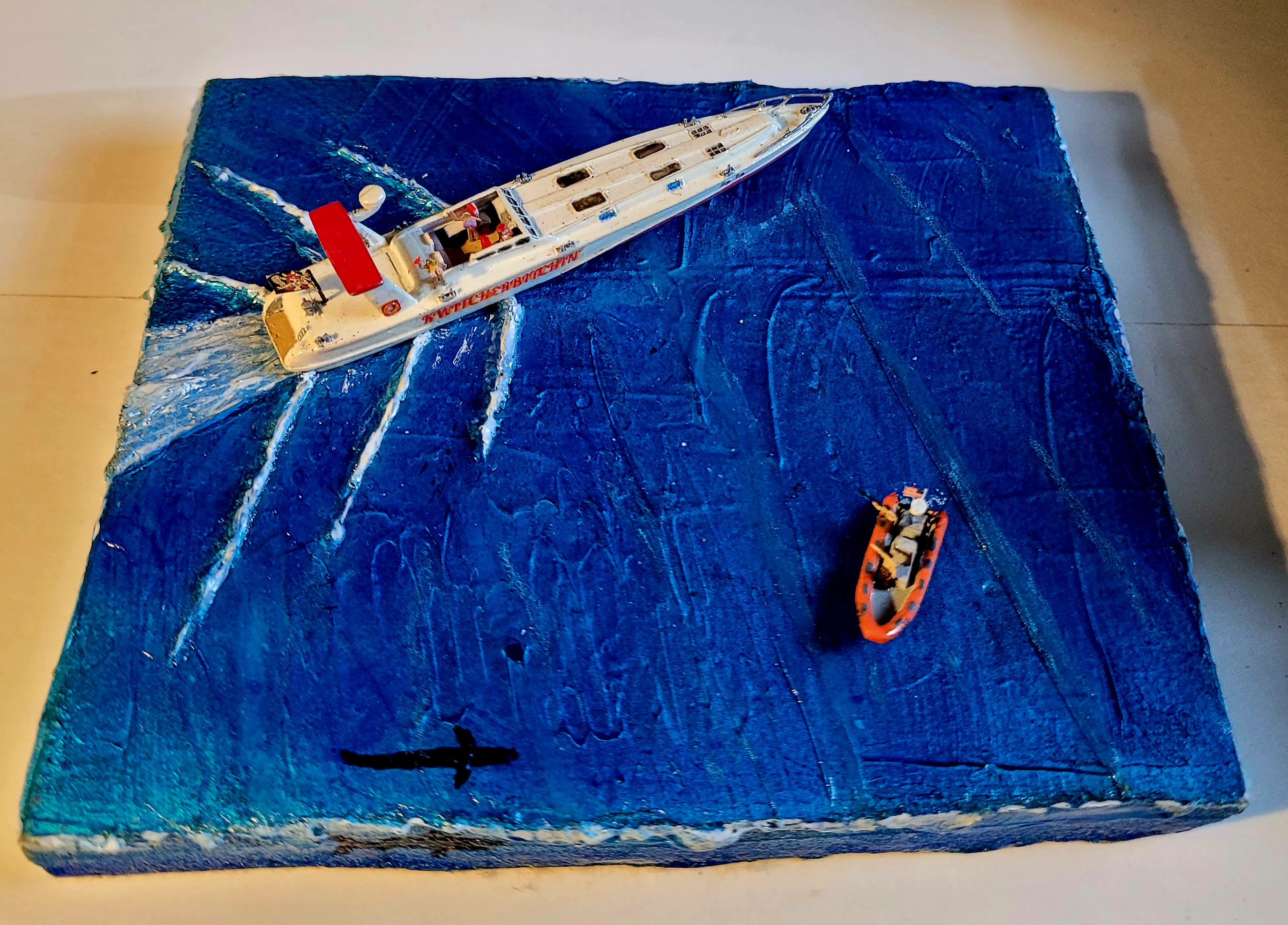

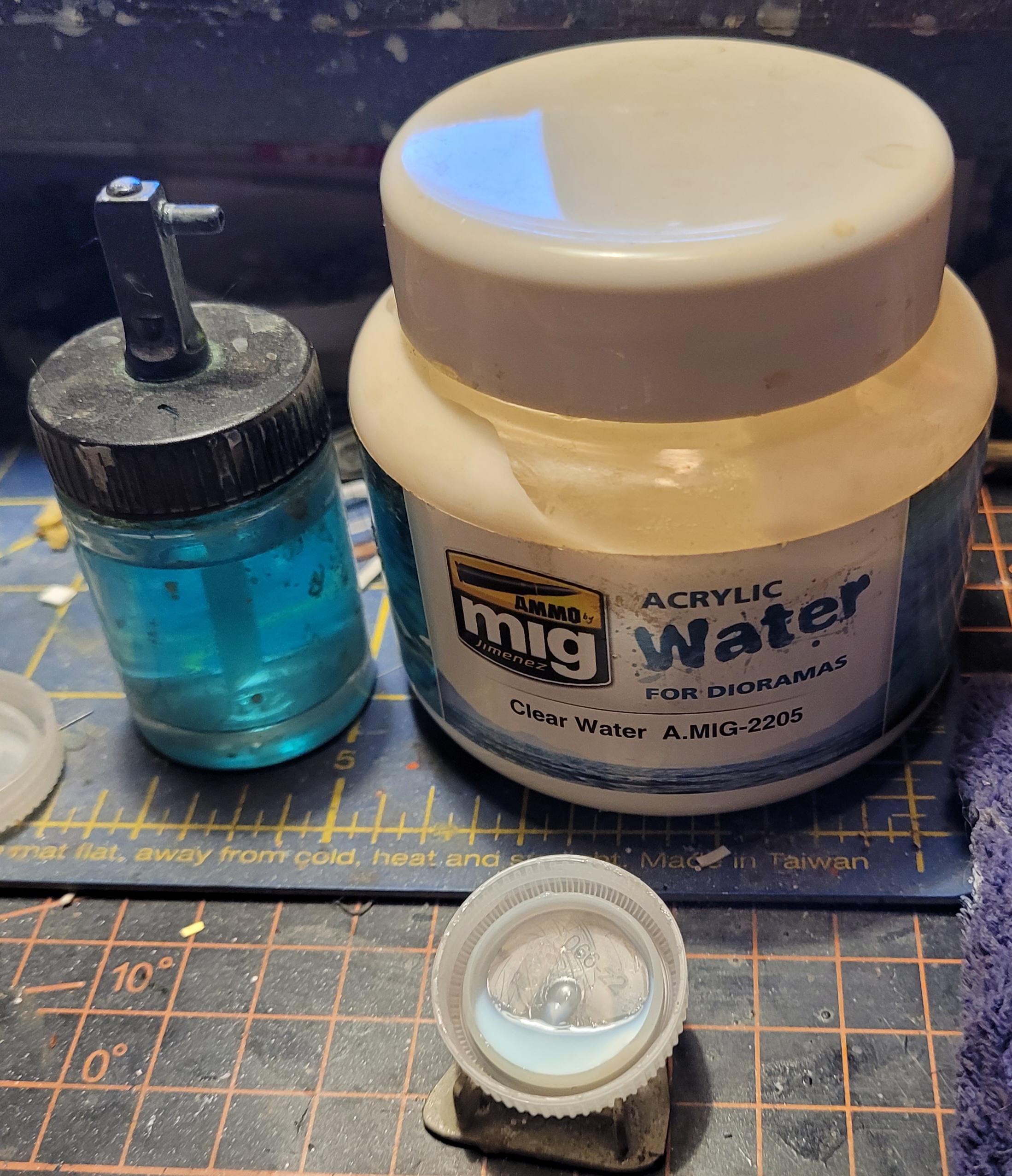

MiG acrylic water thinned with Windex and textured with a dinky spatula and overcoated with Future. What? you can't see the 1/700 scale boat?

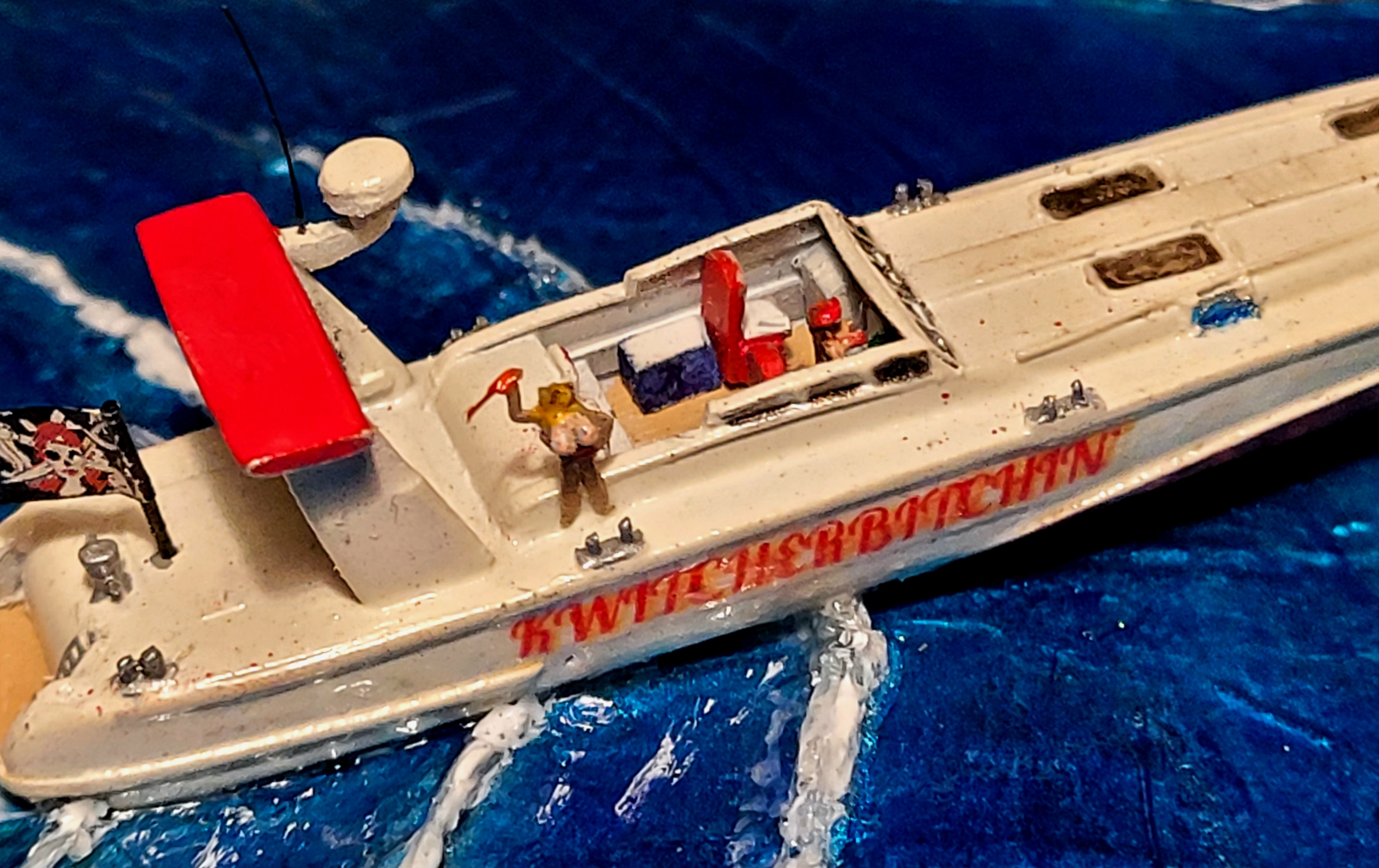

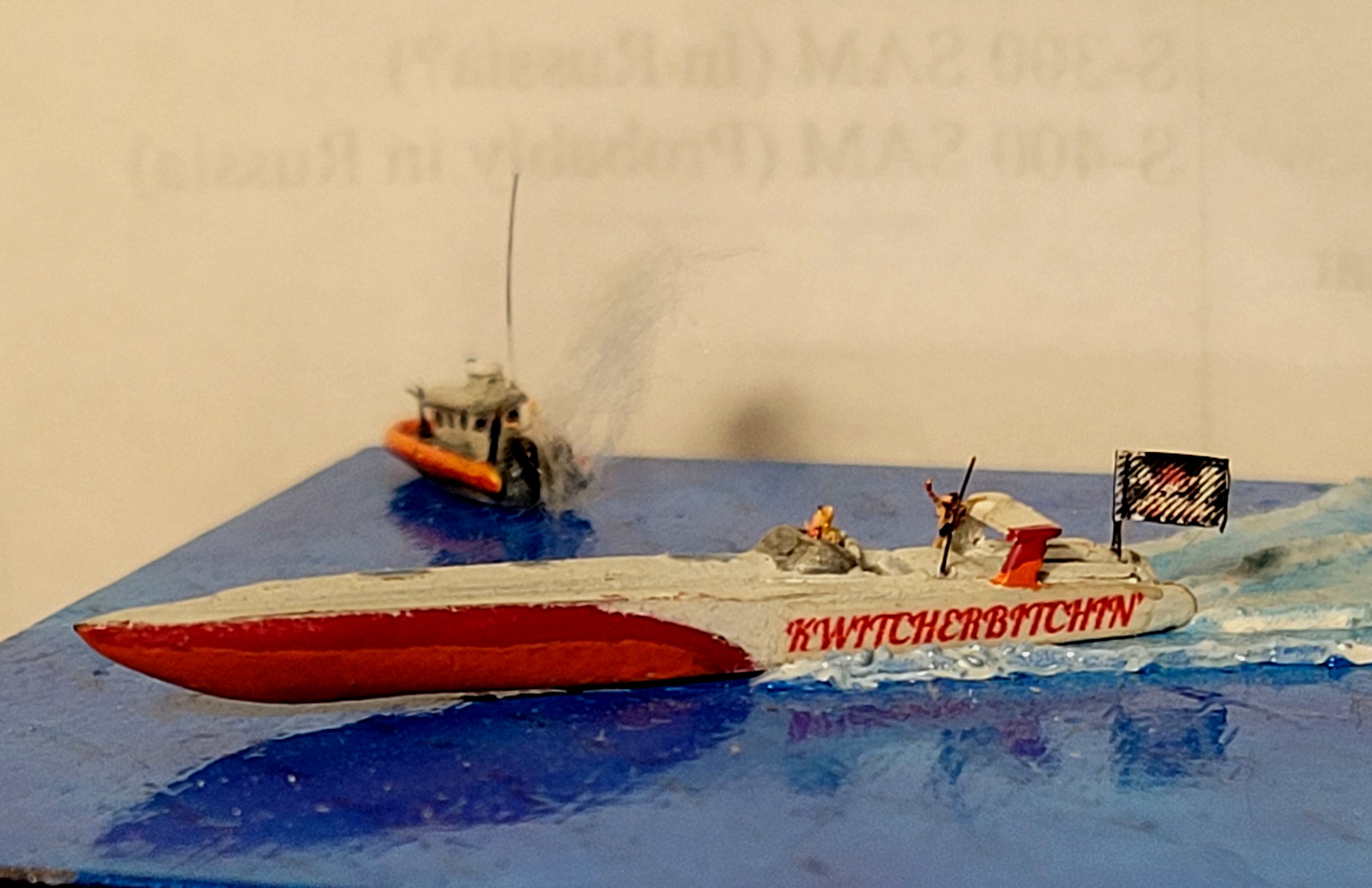

How about now, in 1/350 scale? Better?

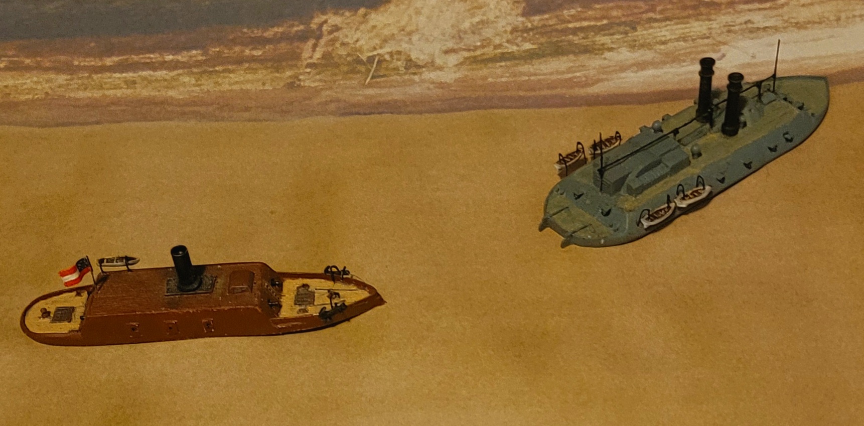

Sometimes a pdf printed on glossy photo paper is a dandy starting place.

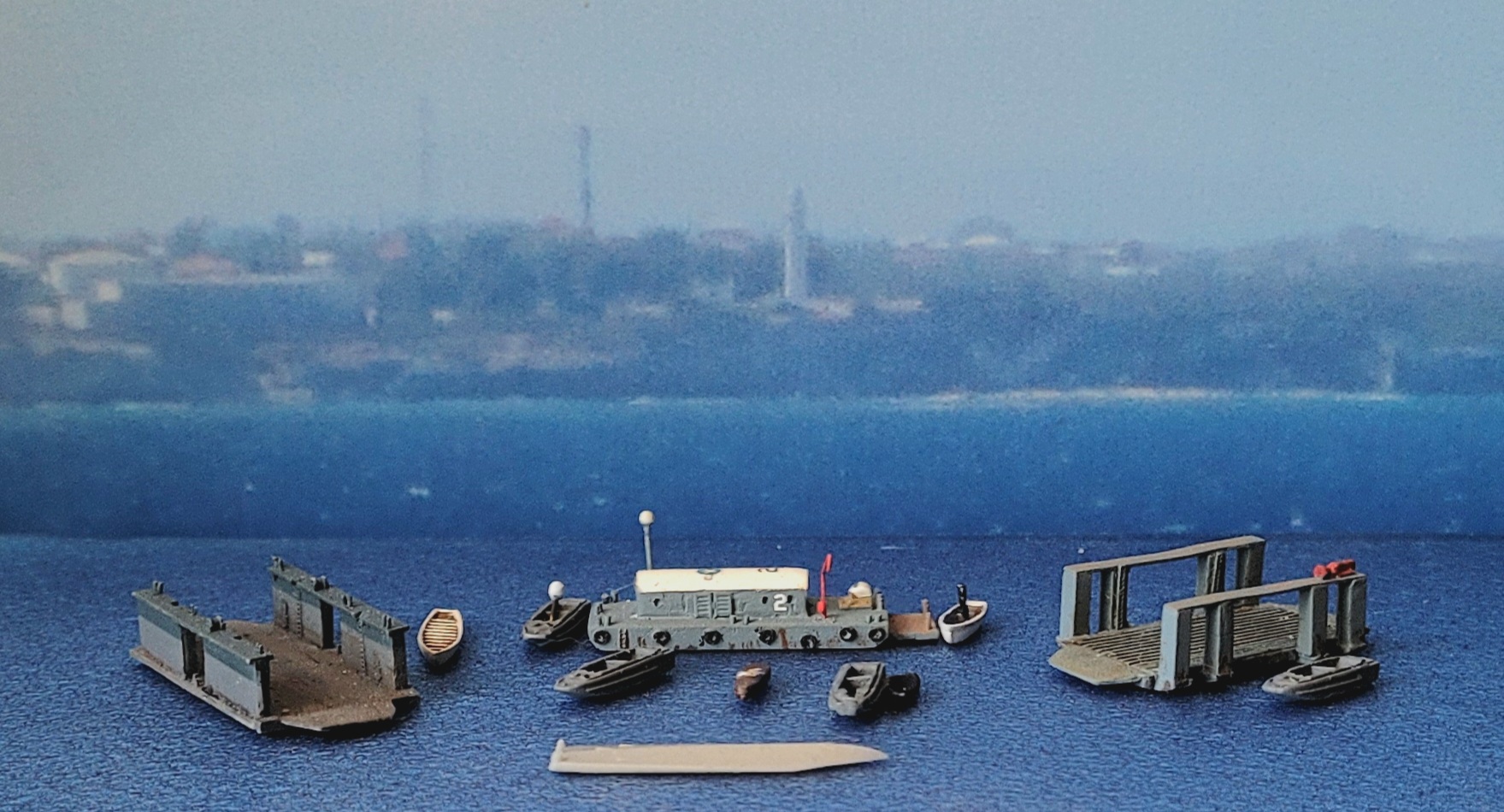

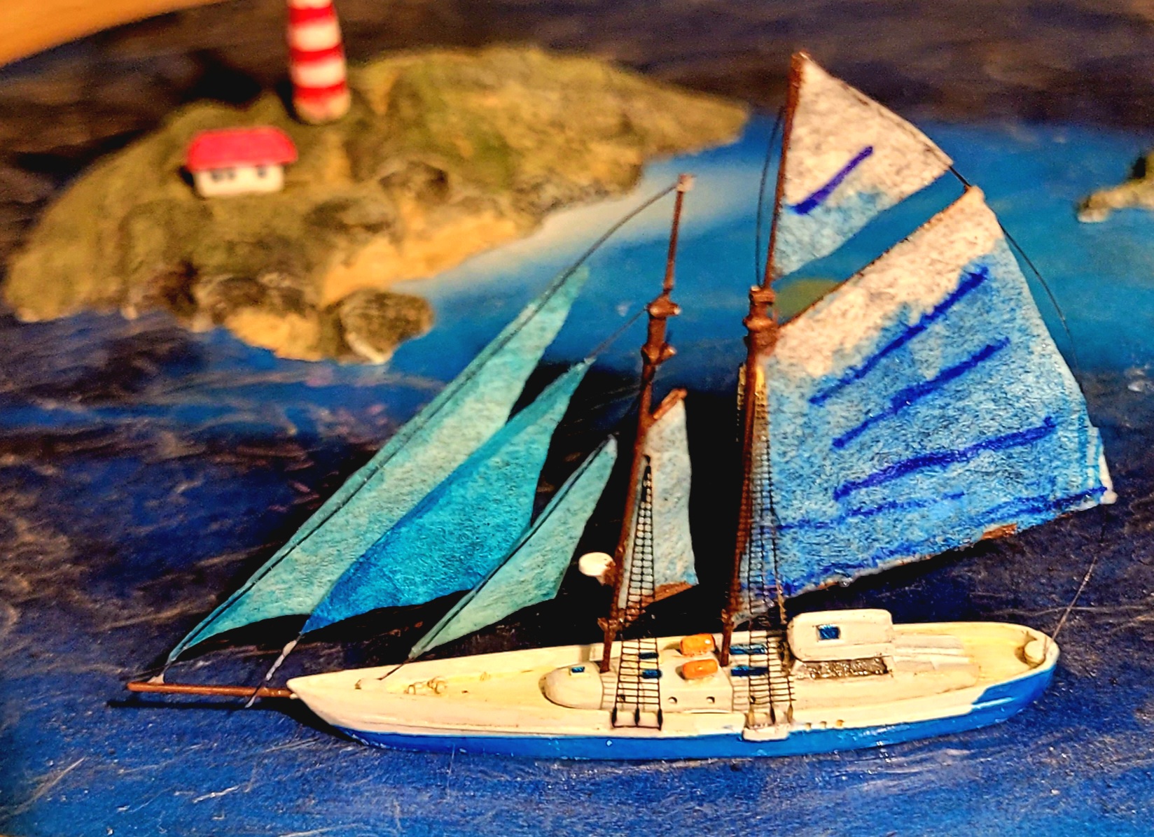

The textured, translucent blue water sheet is commonly used for TLAR box art pictures. There are lots of water possibilities!
Clear epoxy resin can be troublesome for larger ocean bases, but it's great for streams, and puddles.

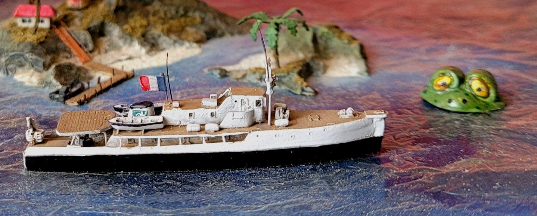

Is that ship with the French flag the Calypso? That's on my Holy Grail list of models. I loved Cousteau's documentaries when I was a kid.

Yes, that is TLAR Models 1/700 RV Calypso. Every French vessel should come with a Froggie. I never did make up a scale Hughes 300D helicopter for her. I almost never missed an episode of the Undersea World of Jacques Cousteau.
