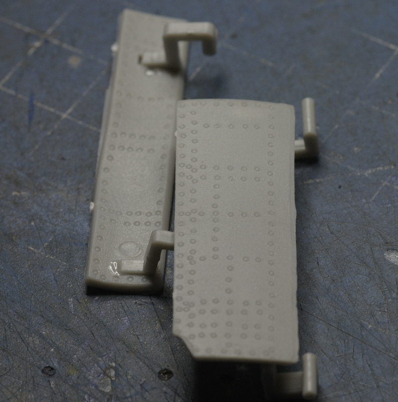

Fast forward 20 years and I saw an online build where the guy was filling each of the literally 1000’s of indents with a mix of super glue and baby talc. This got me thinking, what could I do to clean up that old kit in the cupboard now I have 20 years more experience. This becomes more relevant when you realise this model has recently been re-released by Airfix.

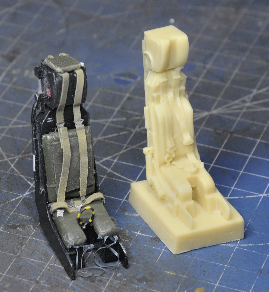

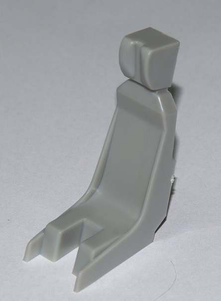

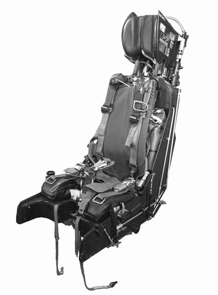

Here is an example. The kit seat and the Martin Baker Mk9.

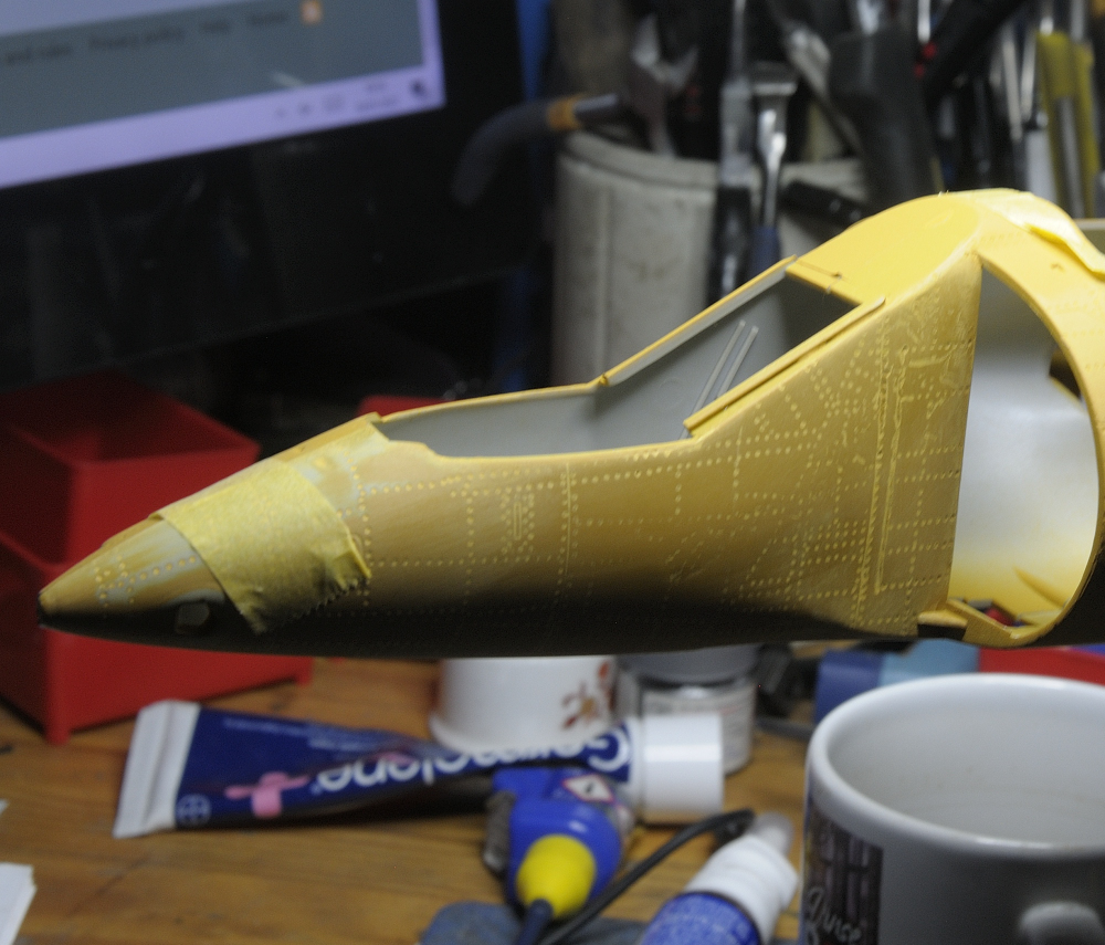

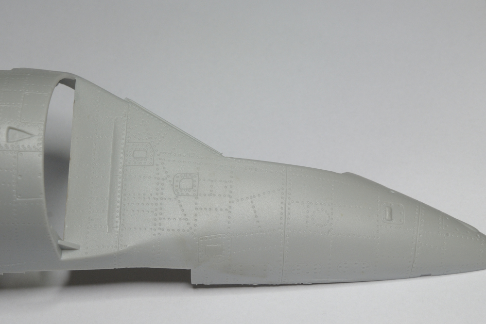

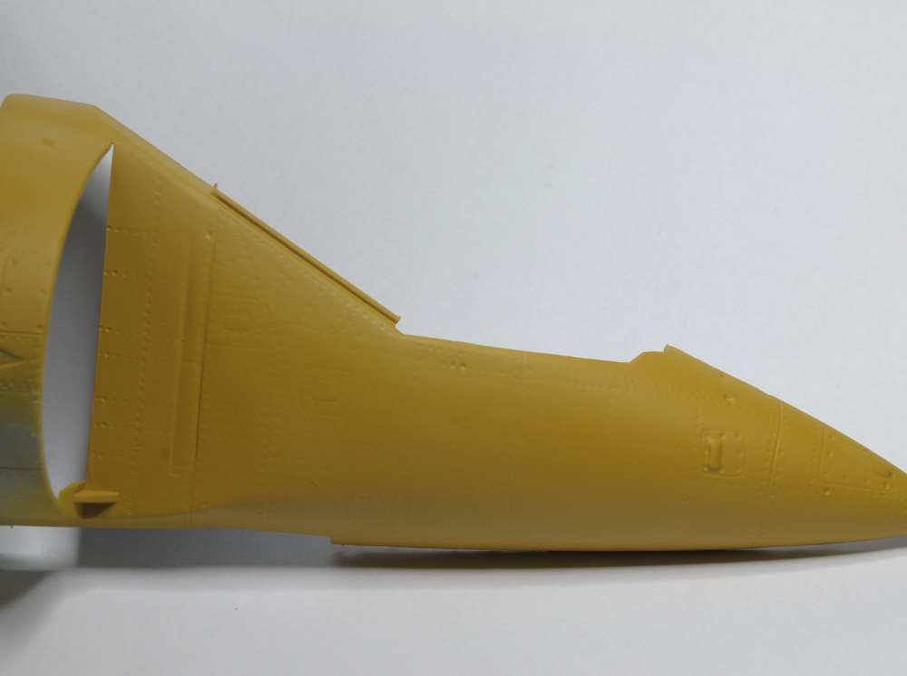

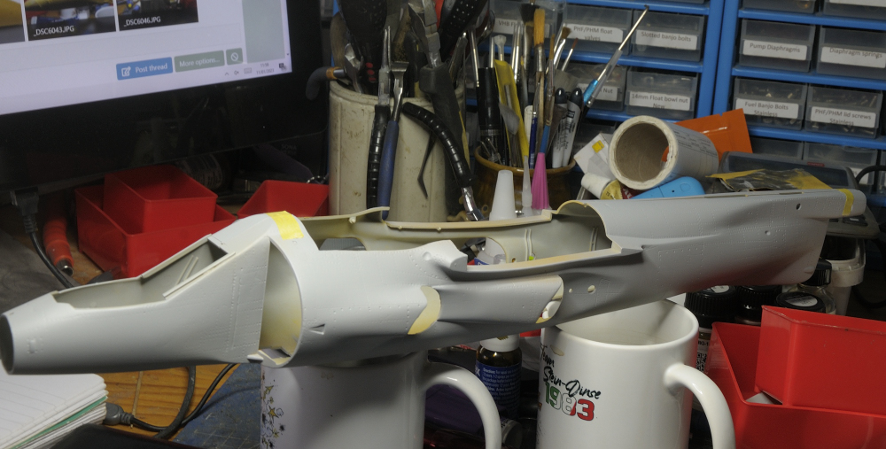

This is what I propose to do with the surface detail. I have rubbed the surface down lightly with (wet) wet and dry paper, 800 grit to take high points off. I then gave it 3 coats of automotive filler primer from a can, rubbed that back then gave it a coat of Tamiya fine grey primer.
Its not perfect but it’s a huge improvement, I will re-add and panel lines I think should be more prominent.

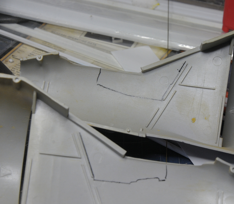

Not gone mad on the nose as it will be cut off soon anyway
And here it is back in Tamiya fine primer with the nose cut off for the GR3 version. ( the kit gives an option of GR1 or GR3 )
Its not perfect, rivet counters will still run out of fingers but it acceptable to me. Its never going to be in a show or subject to scrutiny beyond Modelers alliance so although in some lights you can still see rivets, they dont look out of place (even if they are).

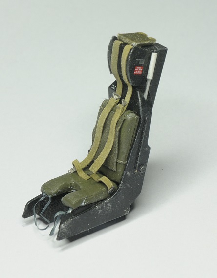

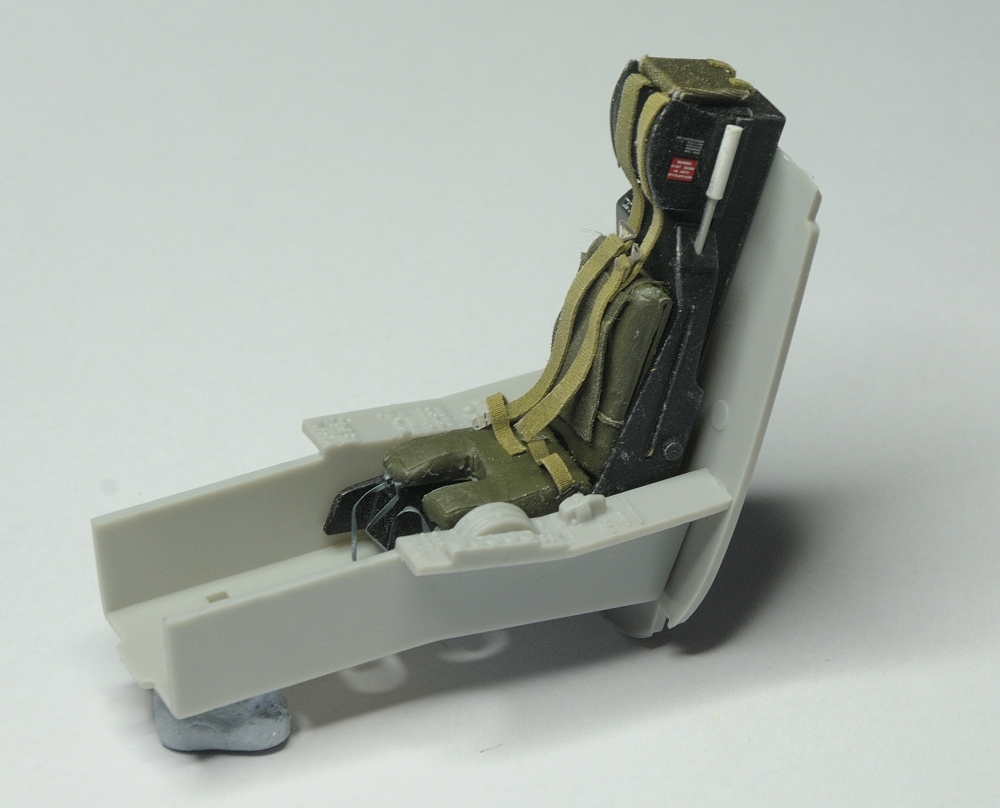

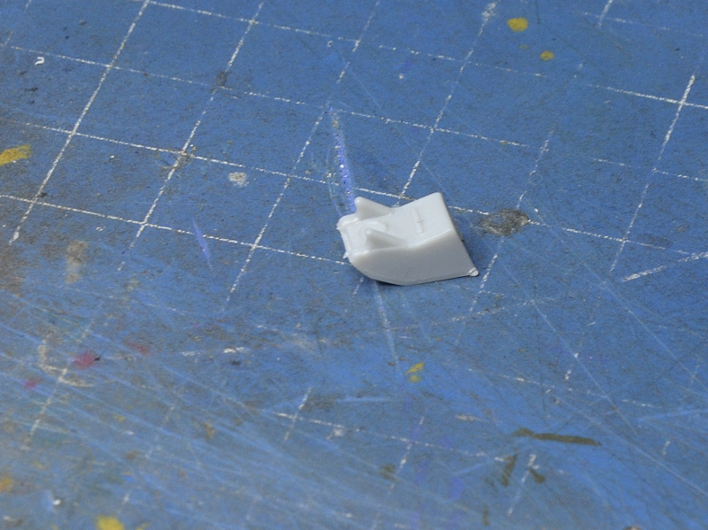

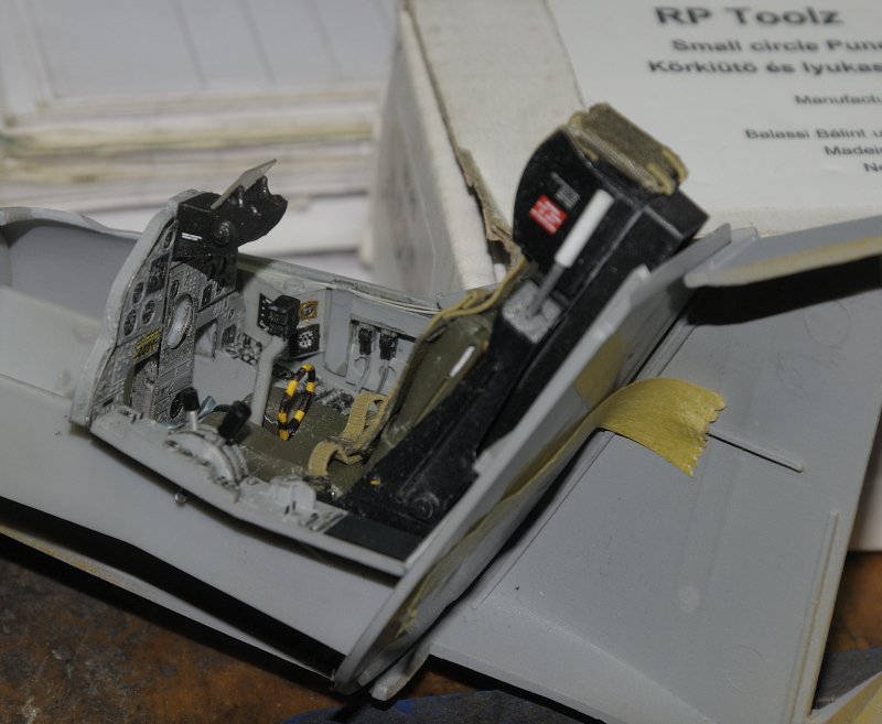

Take a seat, we are off :)

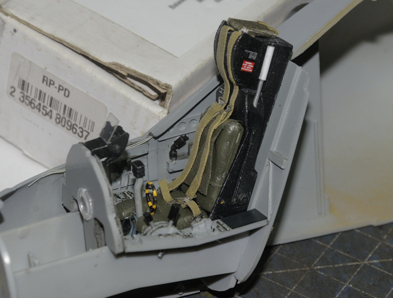

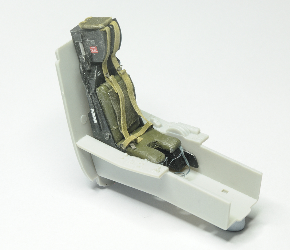

No point on going mad on the detail as only the top bit of the seat is seen
The detail is not spot on correct but then none of the detail the box is spot on either. This is about making the basic kit look a bit more interesting rather than correct ;-)
Head rest sides: plastic card
Seat cushions: blue tac
Belts: painted lens cloth
Deals: Airscale placards
Not made them yet, probably cooking foil. Got to make the ejector seat pull handle as well.
Found some 1/32 buckles that work fine.
Interesting to see the resin seat that flightpath made for this kit years ago
they are ok if you dont want to faff about adding to the kit seat but notice it is a lot narrower because they put so much detail on the side of the seat it wouldn't have fitted in the tub between the side panels.

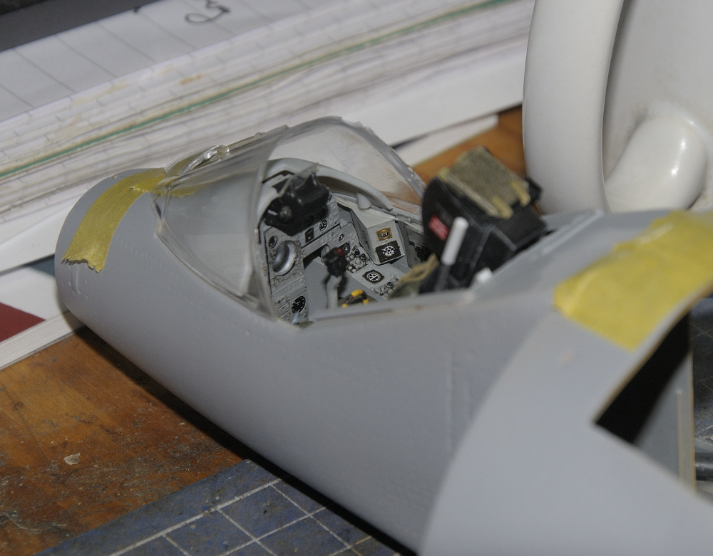

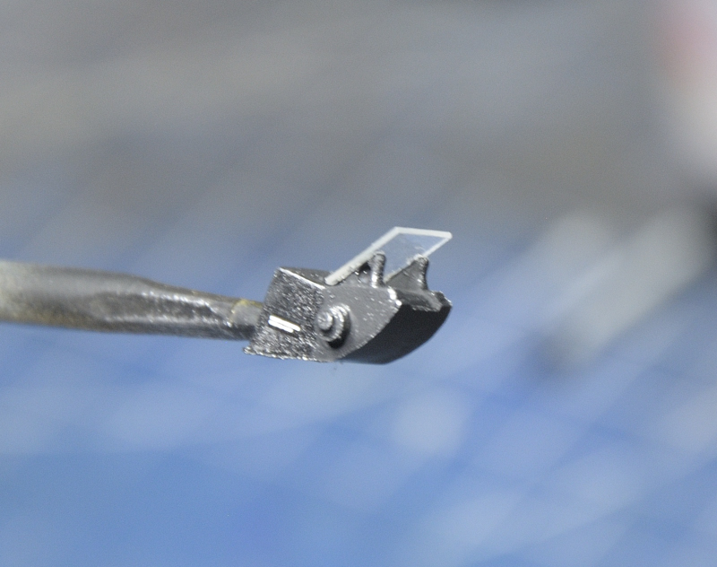

I have been trying to make the cockpit look busy this week.
There is no cockpit side detail in the kit and things like the gun sight are bare minimum. They dont even give you a reflector glass !!
cockpit sides as supplied
Pit as supplied
I did check back and the first harriers did use a reflector sight in the 1960's so no HUD.
harriers are small. the cockpit is small consequently they are even more cluttered than normal with most bit apparently an after thought.
As i say i have tried to make it all look a bit busier than supplied and mocked it up to see how its looking.

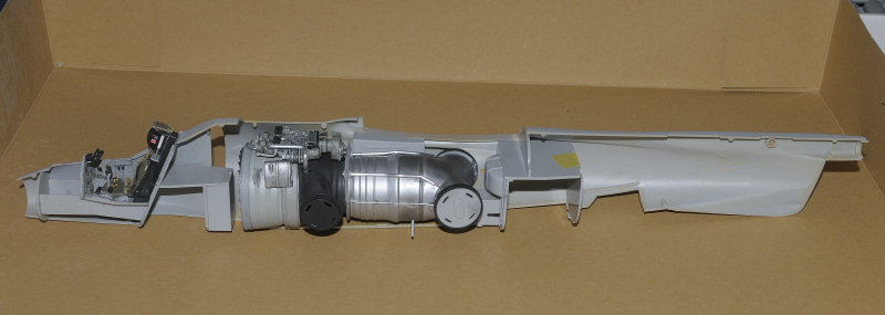

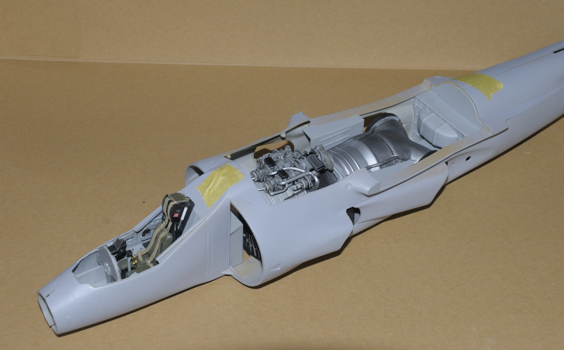

I am going to leave the cockpit now and finish it later, meanwhile i will look at the engine.

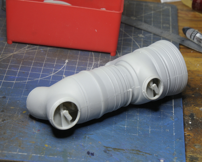

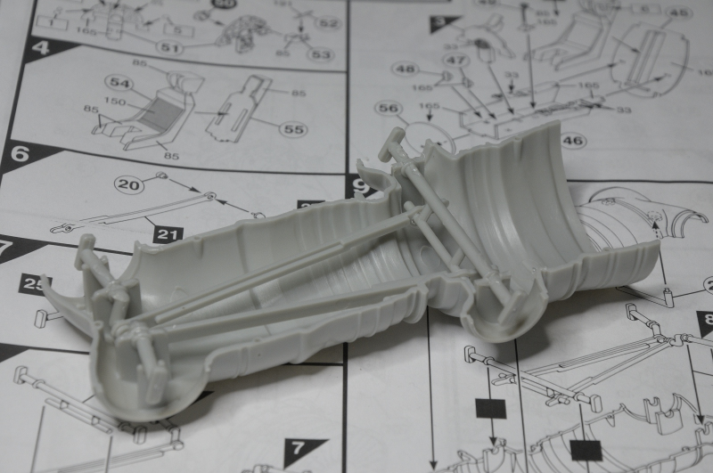

The engine has a mechanism to link all 4 exhaust nozzles. It doesnt take a genius to see this is not going to work :) Moving the centre shaft might well turn all 4 nozzles but once assembled moving a nozzel is never going to work back and turn the other 3......

I could list 100 reasons like it’s so far removed from a Harrier its really just a large toy airplane that sort of looks like a Harrier. It requires extensive reworking to just about every part and is devoid of any detail and what detail there is …is not correct. An example. I have found the top of the engine is missing a lot of key components which have been left off in order for the engine to actually fit in the fuselage. That said the engine will never be seen again once the halves of the fuselage are joined. Ultimately the rivet detail kills this, it’s everywhere and totally incorrect, panels that would have been plain with maybe light riveting round the edge are plastered with row upon row of holes of 1mm rivets that scaled up would be 1” rivets that a battleship would be proud of 😊
