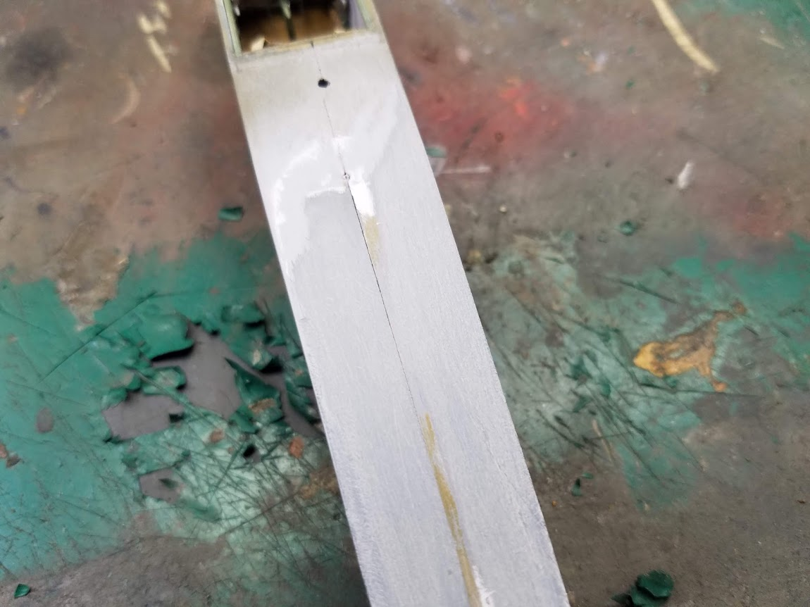

I have been working this seam for 2 weeks now. Fill sand repeat. @errains and @iambrb you both saw what I did to it Sunday. I sprayed some color on it today! That seam came back like "Eff you! I ain't going no where."
It's as if I have done nothing to this one seam.

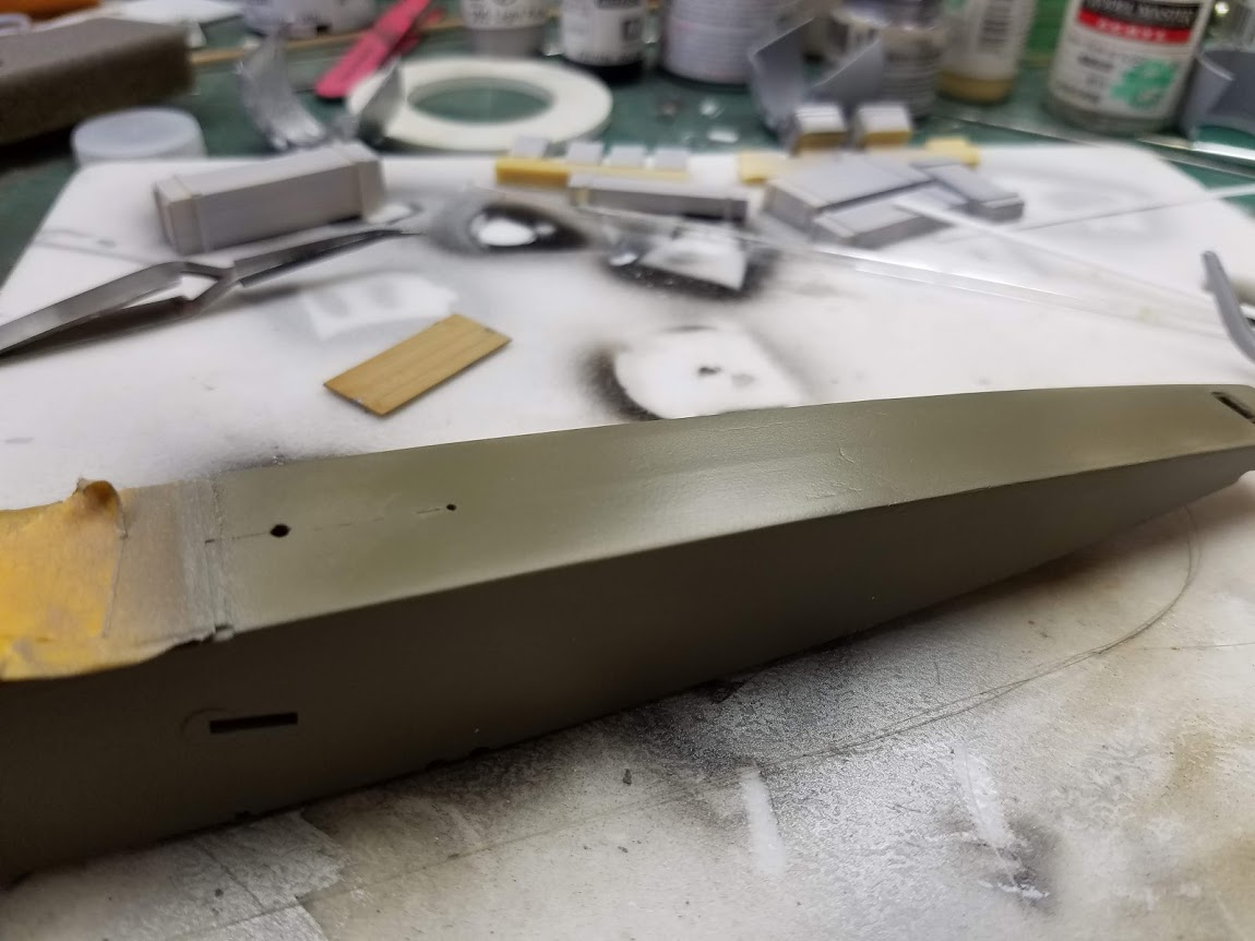

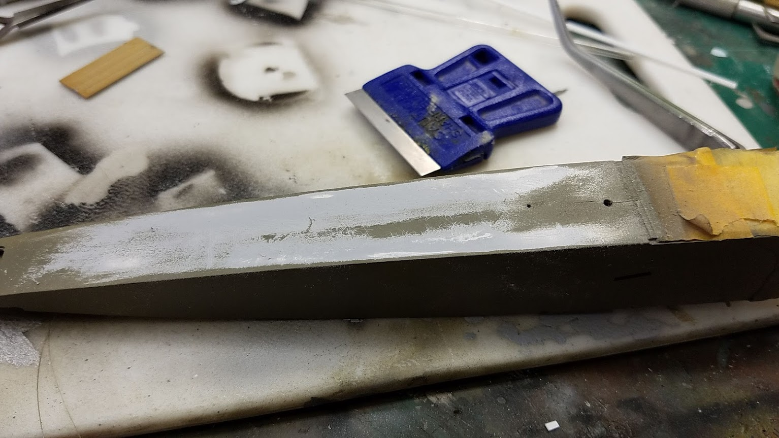

I took a utility blade and scrapped it across the fuselage.
Gives a good idea of the step i'm dealing with now. Next picture will be a cleaned up fuselage with no step seam...or the start of a tank. :soldier
Mist some primer over that and scrape it again, that will tell you if you're high or low. If it scrapes off evenly, you're flat.

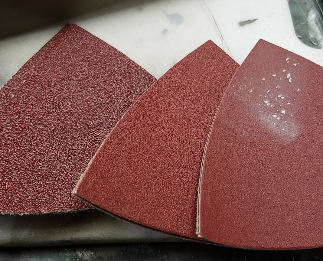

So I got some course sand paper.
80, 120, 240. Sanded down to plastic. Primed sanded again with 1500 up to 3600. Looked good. Primed again. Smoothed that out. Then shot color again.

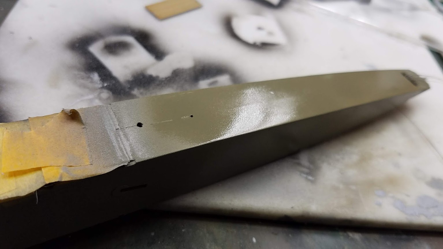

And there it was again.... :bang head
Once again I started sanding then I saw the seam had separated.
so I reached for the fresh bottle of Plas-i-weld and it tipped over. Soaked the underside of the fuselage. ran up under the masking tape running the machining finish on the side panels. Attacked the underside seam stitch detail and the underside panel.
The Eindecker was just not meant to be.
