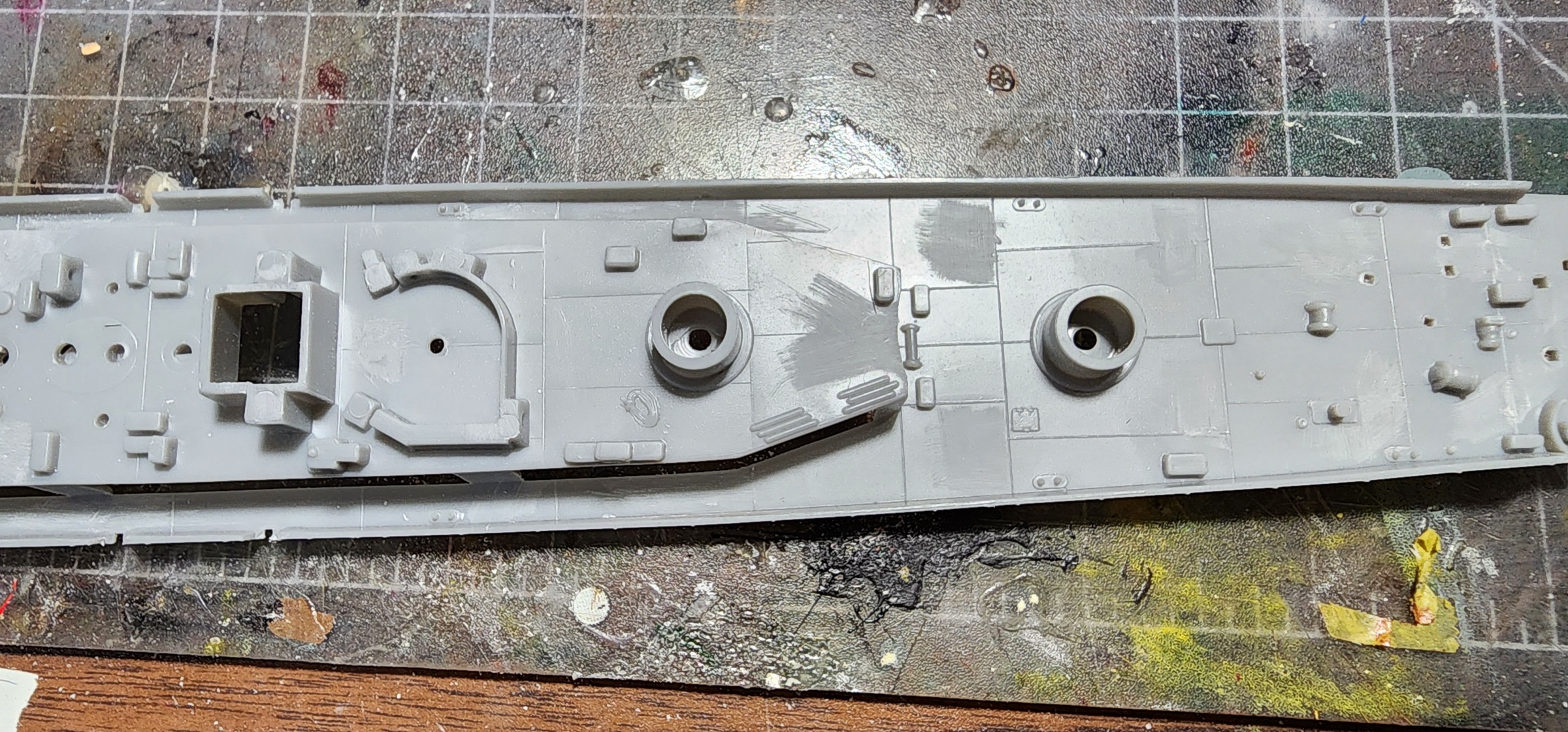

Ok, so this is my first ship build. There are not many parts, so that is good. I noticed the ejection pin marks are on the business side of the main deck. Why in the world did they do that?! Couldn't they have been on the bottom so they won't show...like...ever?!
I did my best to smooth them but some of the weld lines had to be scraped too. I assume those are supposed to be weld lines. Directions say the deck color should be "Tan" which make me think it is wood, but the lines look like weld lines between deck plates. Would they have painted the metal deck in a tan color? I have been out of the Navy for nearly 40 years so I just can't remember what things looked like on my ship. (Entire service after school on the USS Canopus, submarine tender, Kings Bay, GA ).
I can put the lines back easily enough so I guess I will do that.

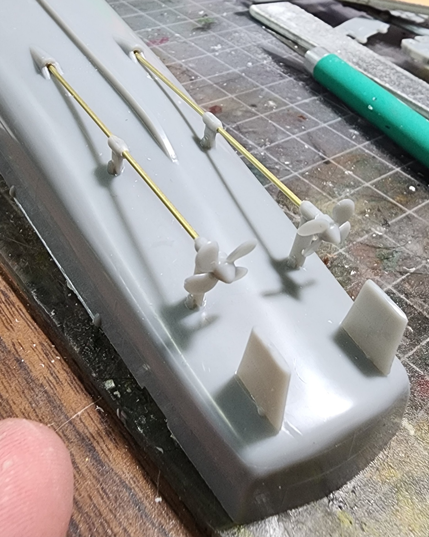

I cut the propeller shafts off and use brass rod instead. T'was a fairly easy operation and looks a lot better than the plastic did.

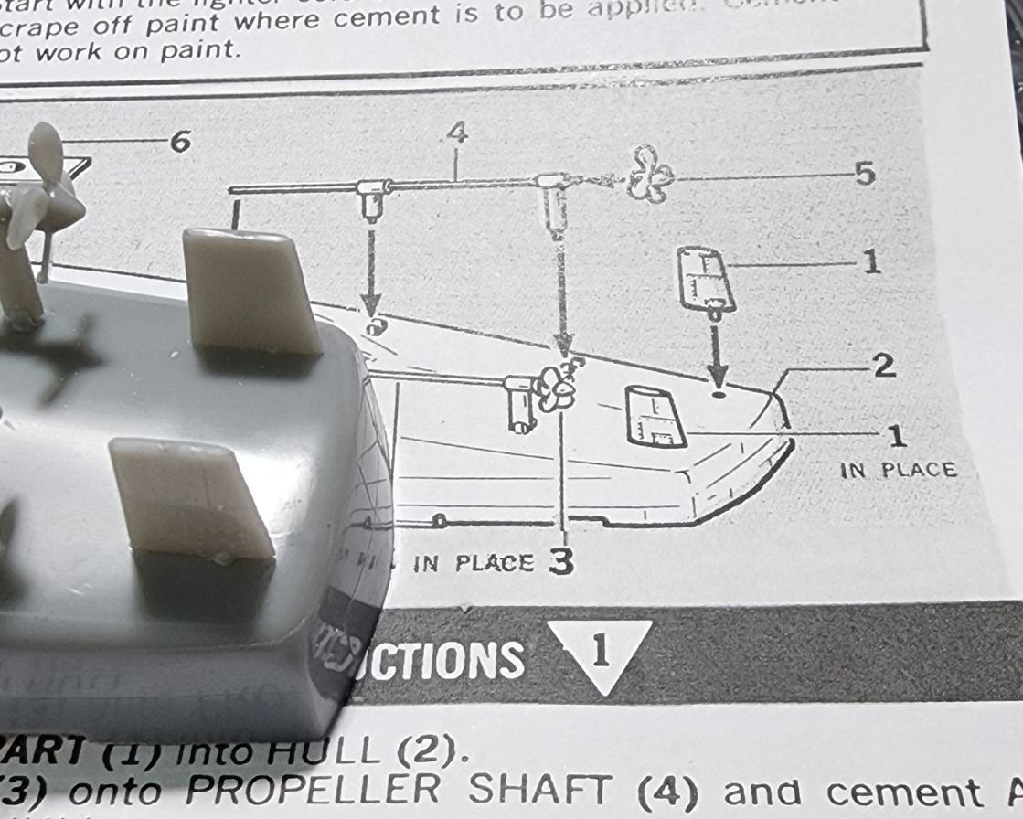

Ponkin, Your rudders are on backwards.
Interesting choice! :victory:
Will you ballast her to float on an even keel, perhaps?

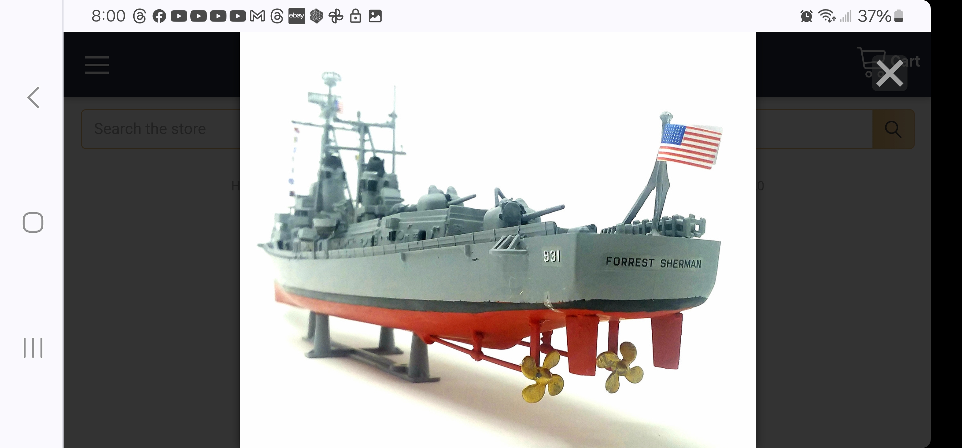

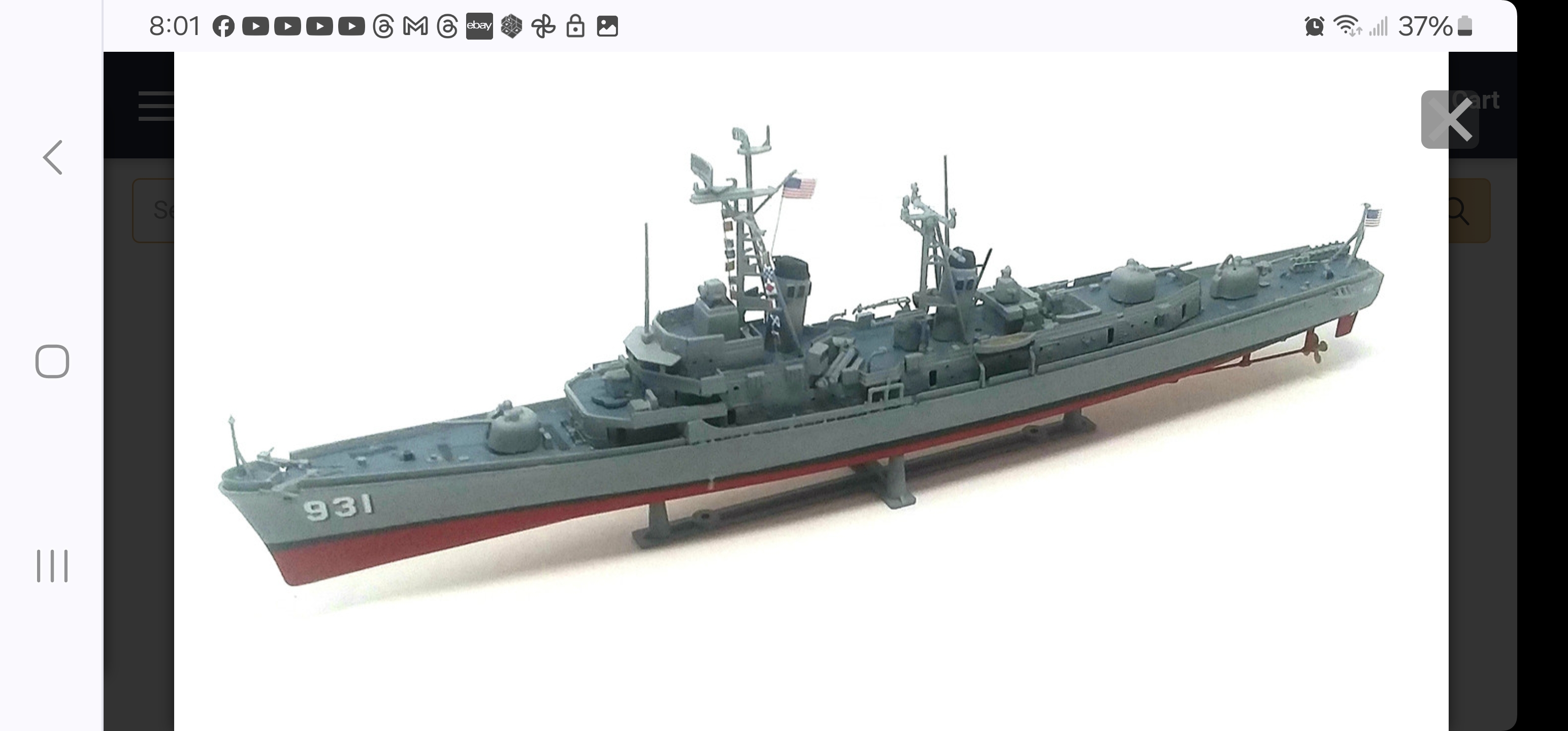

I found these photos on the Atlantis website. The deck looks blue/gray, not tan after all. So, basically forget the instruction sheet?
And the hull below the waterline shows Christmas red! Plus, that's a pretty crappy paint line to be advertising the product! I would think Hull Red, hence the name, would be the red I should use, or at least it is what I would have used before seeing this picture.
Also, that black line above the red, correct or no?
That's what they got showcased on their website? Crips all mighty. Hull red with a black stripe. Maybe some squid will tell us why the black line.
If I remember correctly the black line is where the water line is. It is a thick coating of "something" that will resist waves slapping against it. At least that is what I think I remember.
I wouldn't use the photos from their site if what they show is as crappy as these are. Yuck! I did better when I was a wee lad.

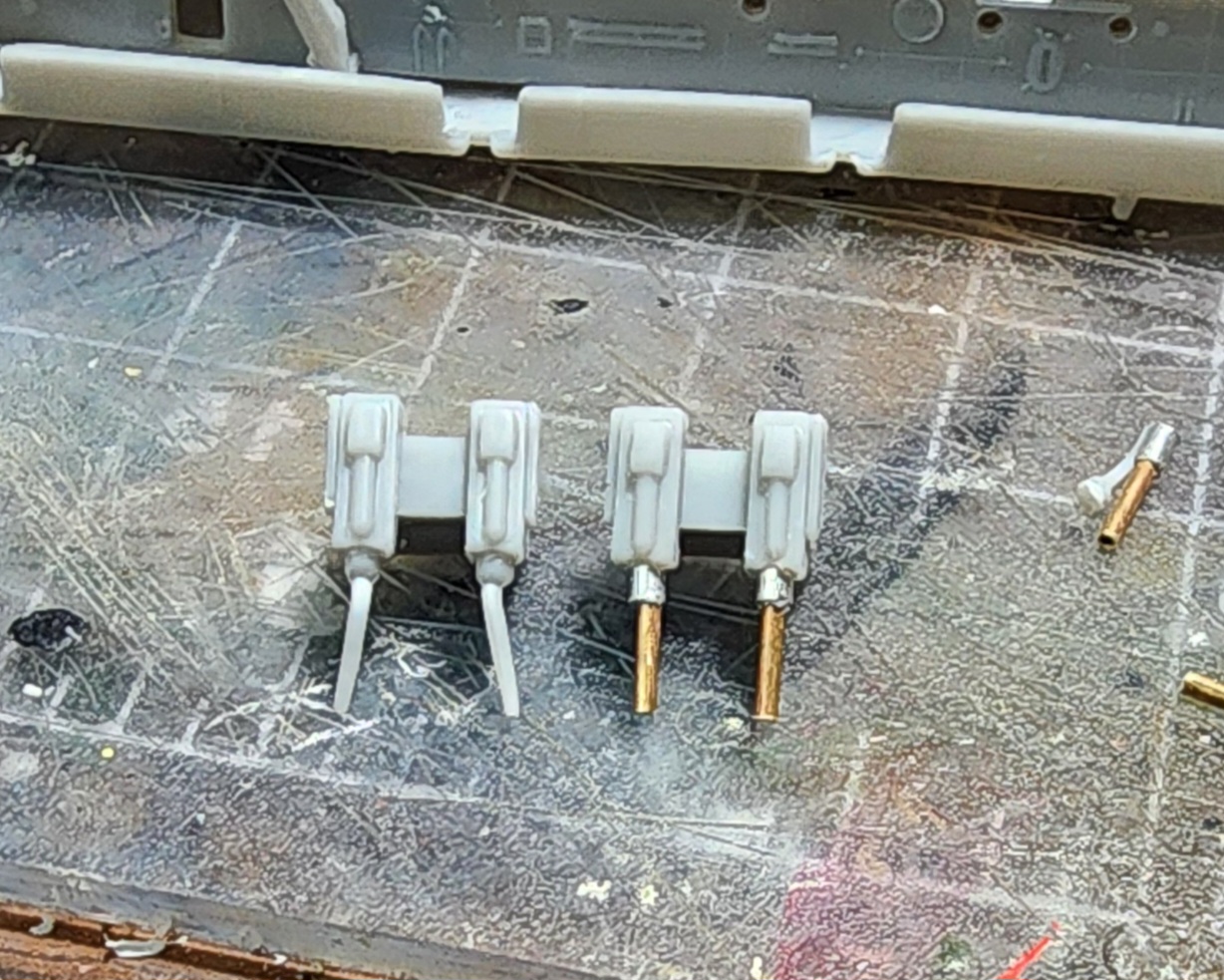

I am replacing the gun barrels with metal ones. They don't taper like the plastic ones do so I hope that it is OK.
I used brass for the main barrel and aluminum for the rear of the barrel (because the brass fit inside it mostly)
