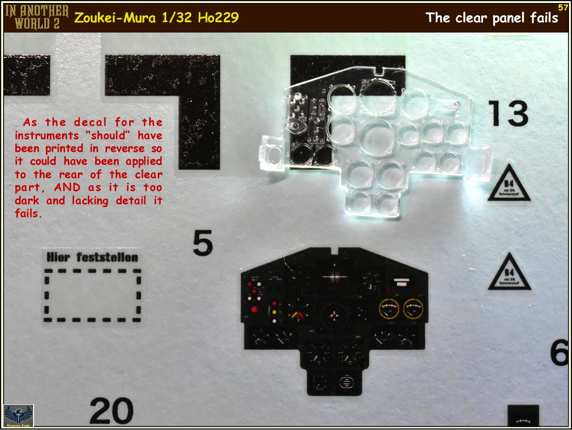

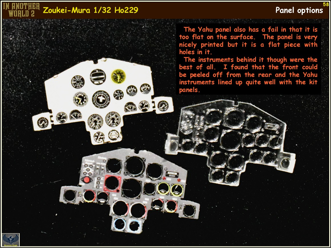

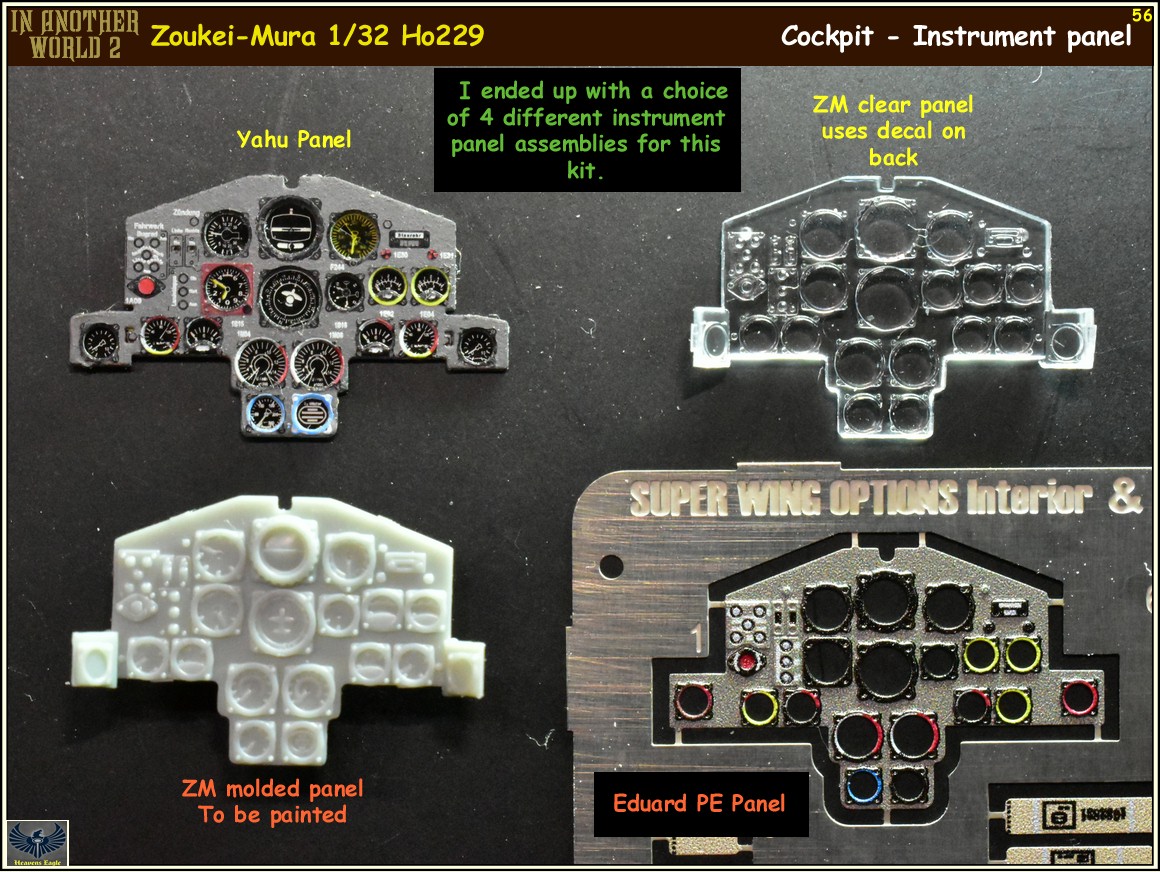

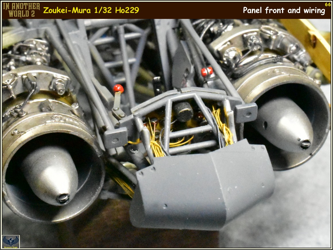

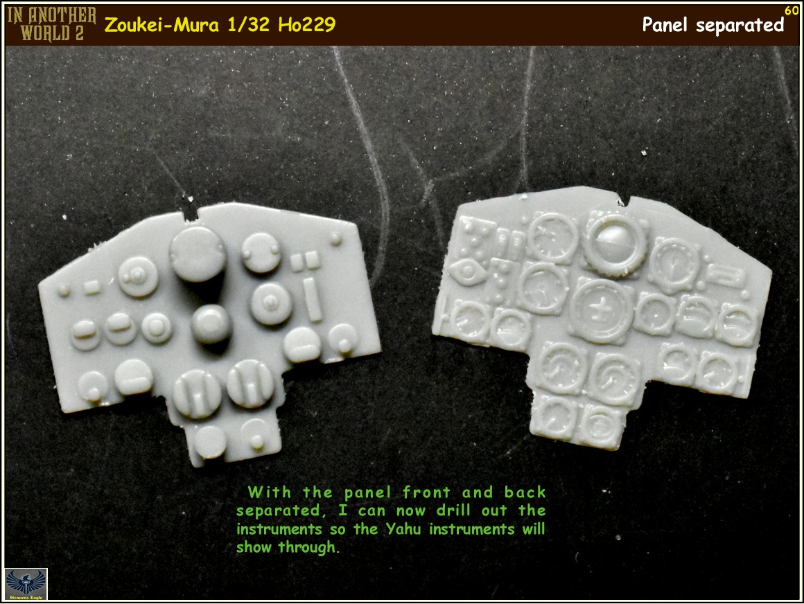

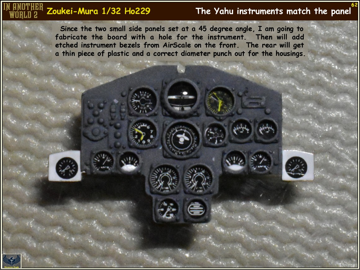

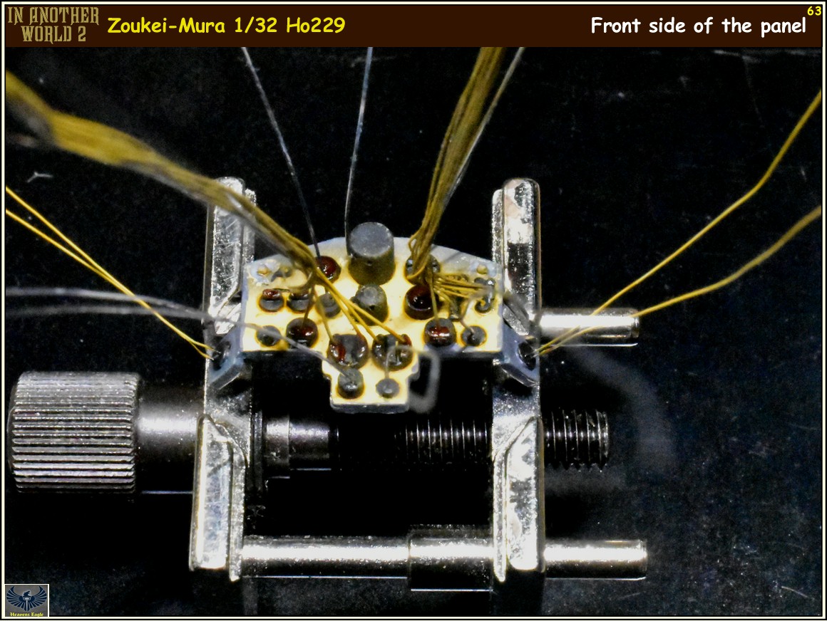

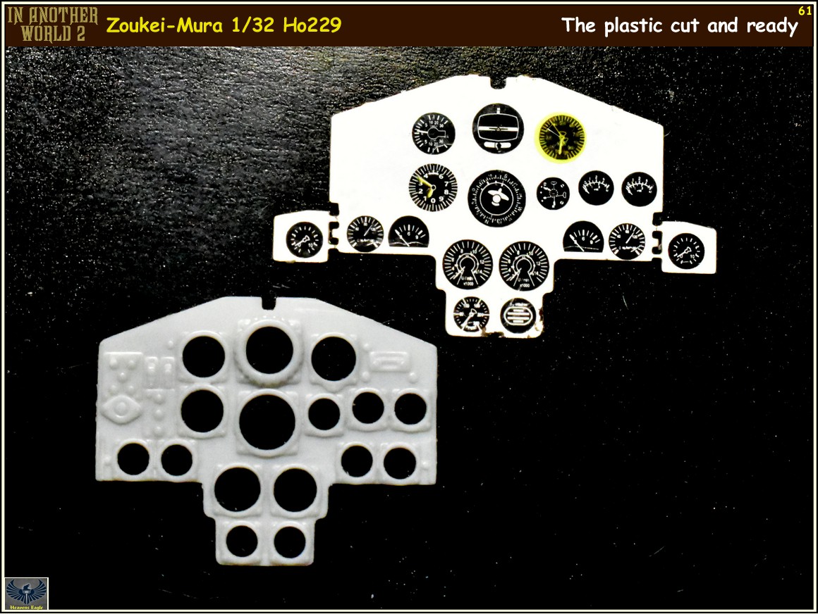

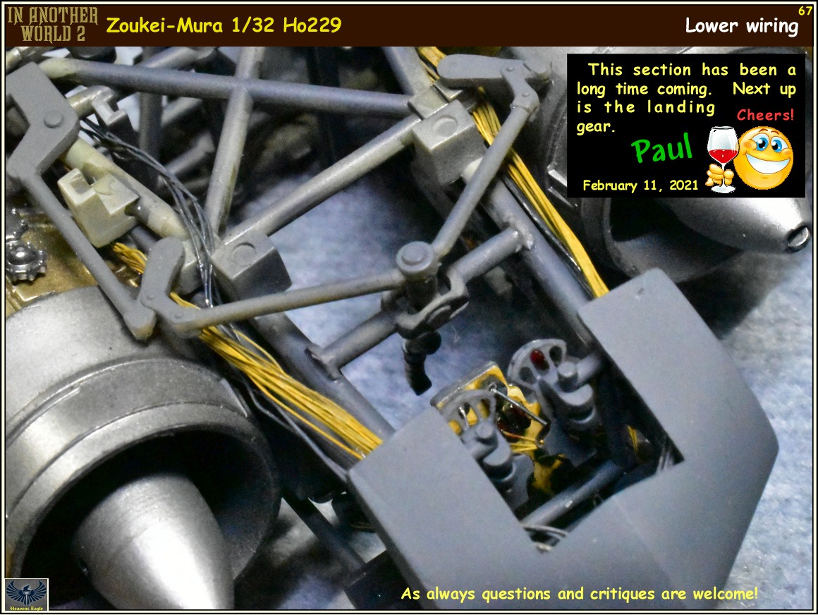

Here is the next step that I am working on.
So far I have 4 options for the instrument panel, 3 options for the pilot seat. Along with the Eduard made PE set and HGW seatbelts it is turning into a bit of a challenge to decide on how the build is going to go. Right now I am taking it a little slow and just cleaning up parts. Trying to get my head around what I want to do and how to make it look the best.

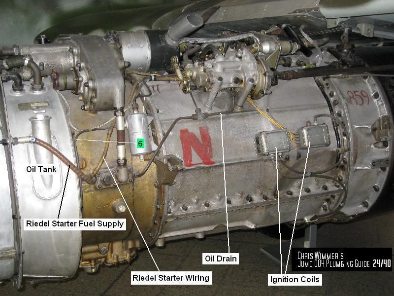

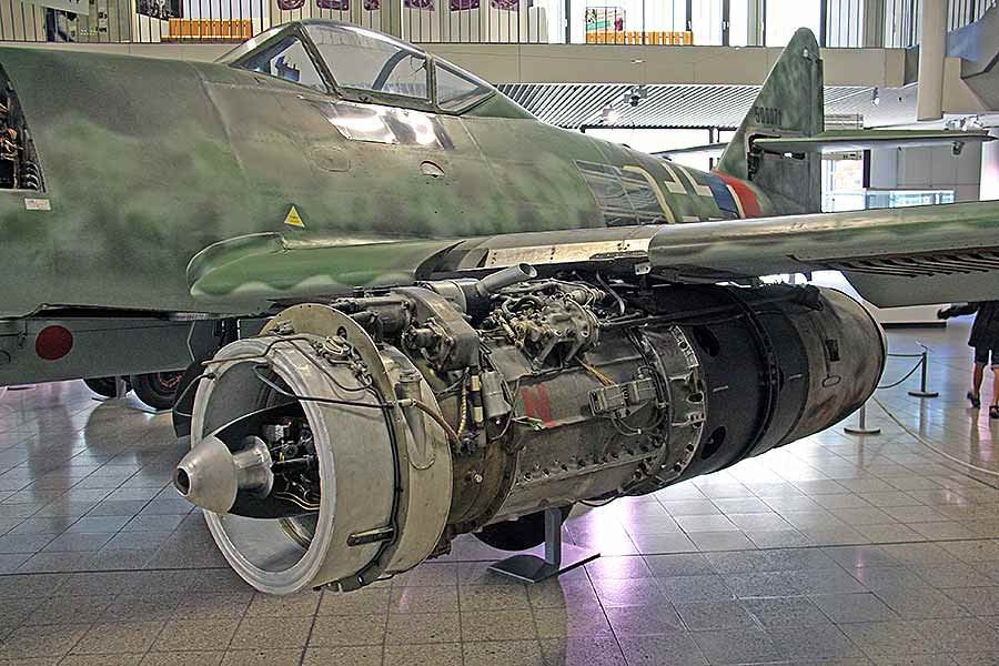

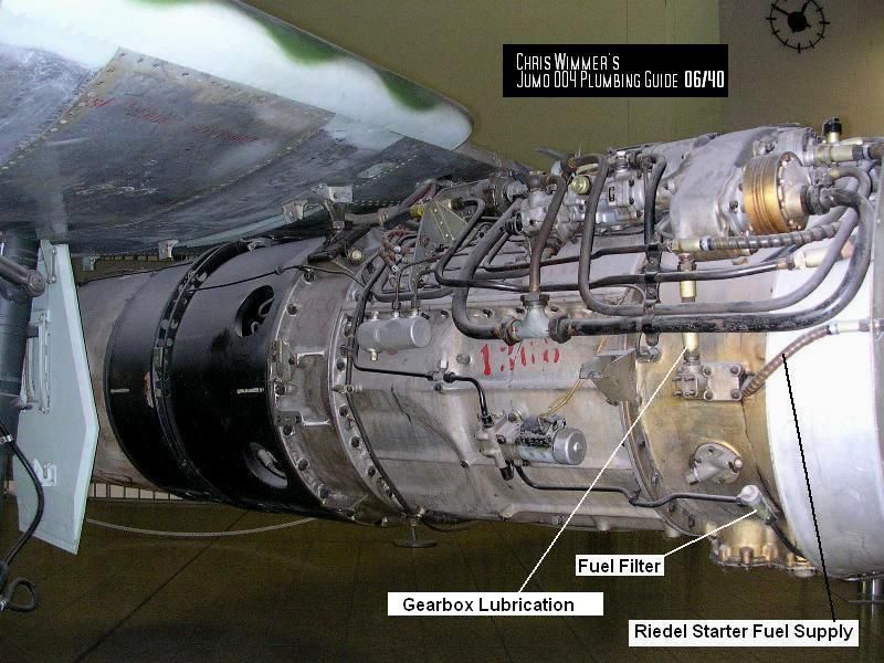

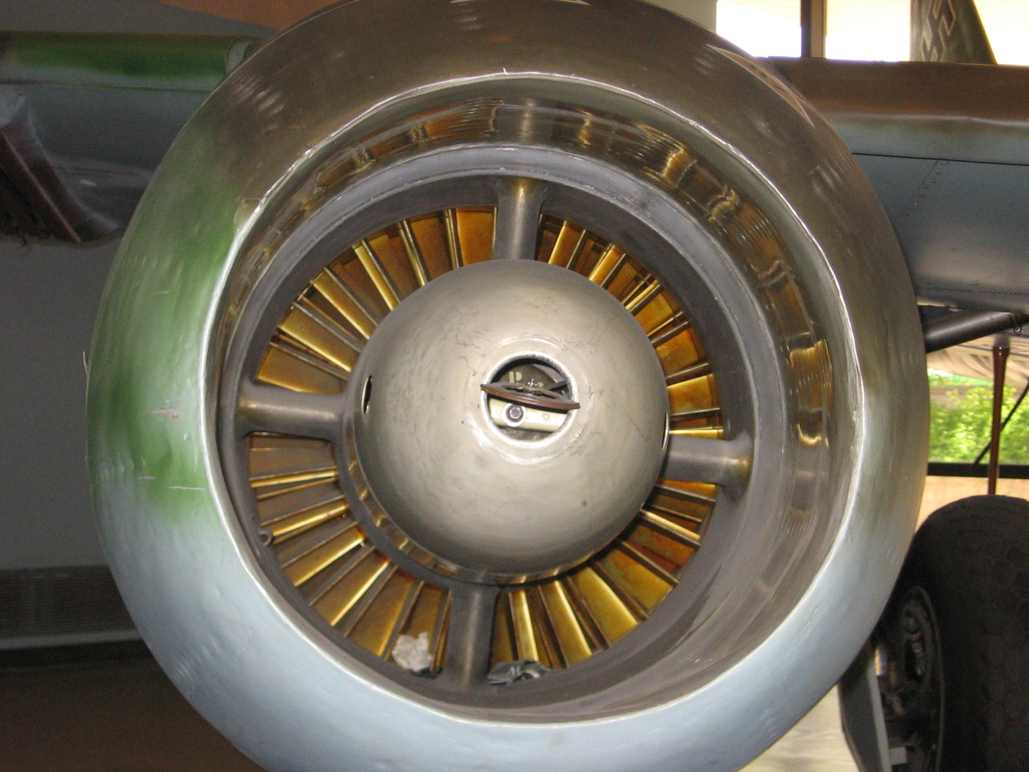

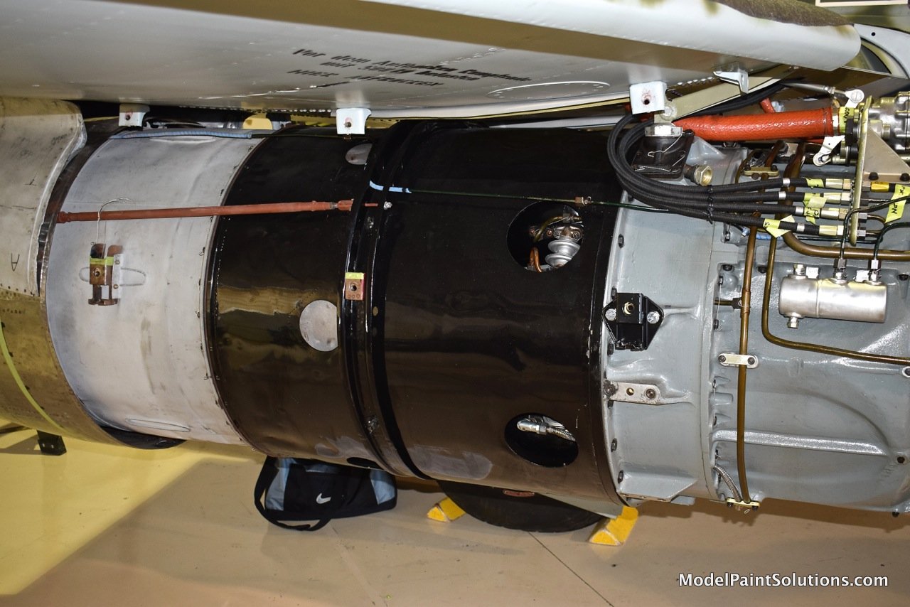

Thanks Ian! I used photos of the actual restored engines from a Me262 for reference. These are clean and well done, but still have some weathering to them as you would expect from a functional aircraft. Here are some of my reference pics. All were found on the internet and made the paint work a lot easier.
Different plane same engines, made the paint work a lot easier once I figured out what I was looking at.
Thanks for looking in!

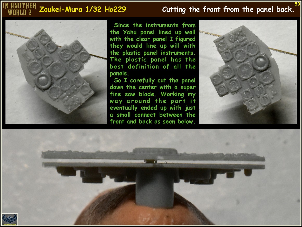

It has been a while since this has been updated, and I finally have some photos to show. Goes to show how bad women can screw things up, and now since I am blessed with being single again (WooHoo:vgood:) Things are starting to get done again.

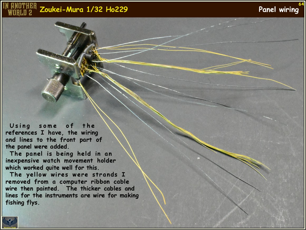

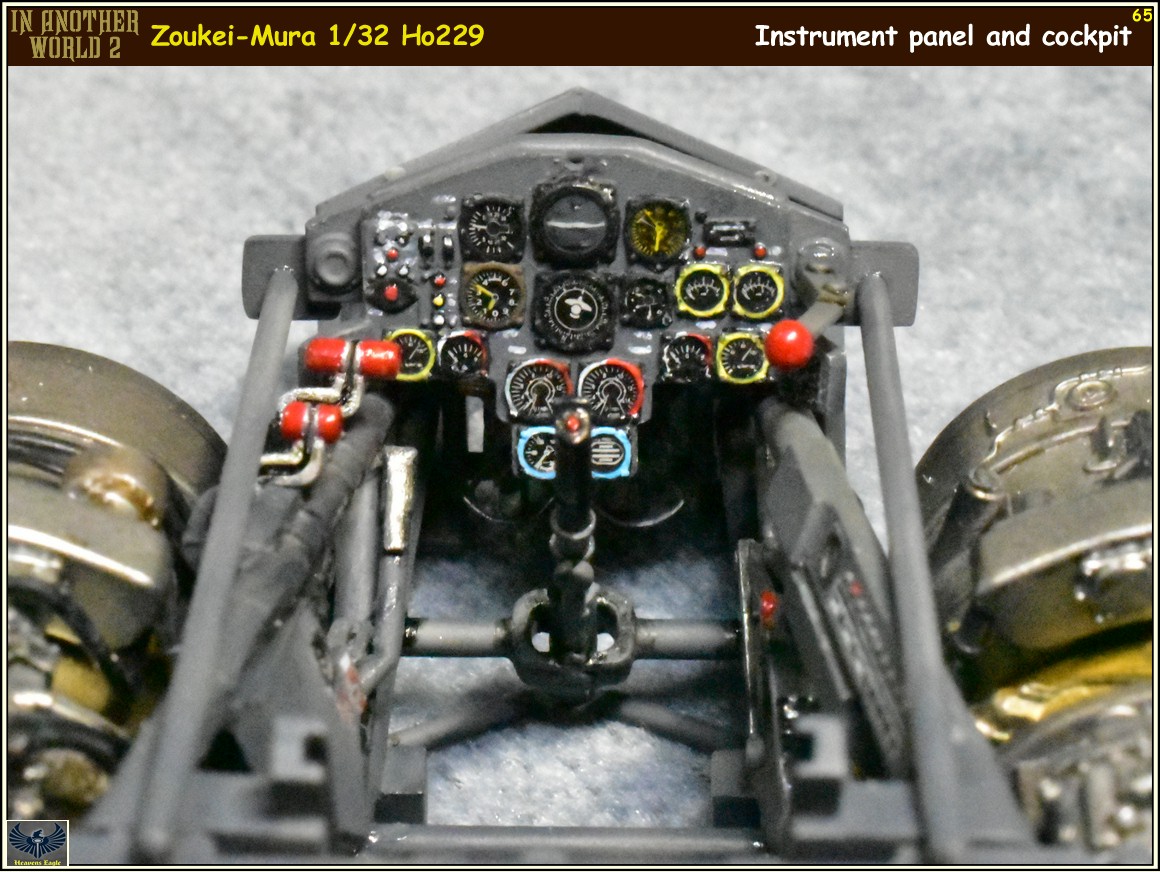

To me the cockpit is where the most attention needs to be placed as there is a lot of small detail there to deal with. This kit is a little more work than most as it is all tubes, wires and lines. I would have found it a little scary to fly if it were me now that I have seen how things fit in.
Anyway, on with the show...
Something that I did not mention in the photos is that the crossbar for the control stick is supposed to be set lower than the tubes on the sides. I cut it loose and reworked the stick and yoke to make it a little closer to the original.
Enjoy!
