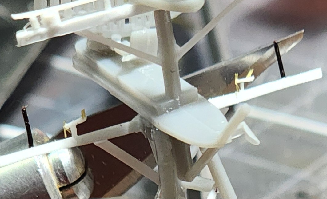

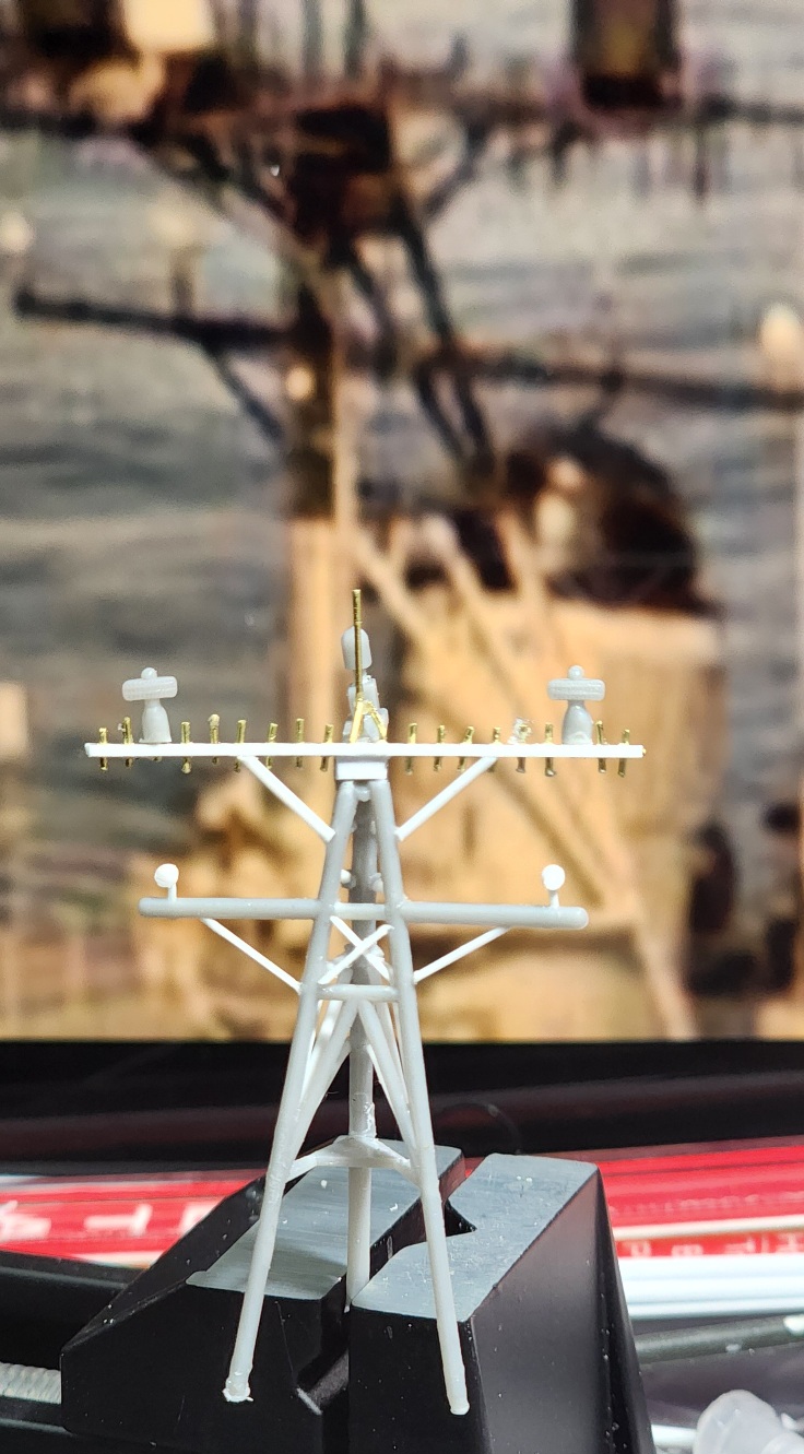

I didn't like the whirligigs I made so after looking at some photos I thought I would try again. I cut a paper thin .5 x 1mm piece of brass sheet and twisted it for the propellar and another small brass piece for the tail. The body is a .5x.5 x 2mm styrene. All held with superglue, which was challenging getting the tweezers to let go. However, Rhino asked " Wouldn't they be pointing in the direction the ship is going?", and since that is an excellent question and since I don't know the answer, they are now pointing forward. Ignore the photo of them pointing somewhat starboard. The #11 Xacto blade is for scale reference.

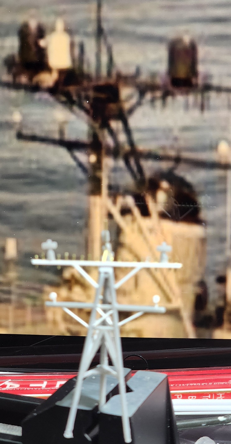

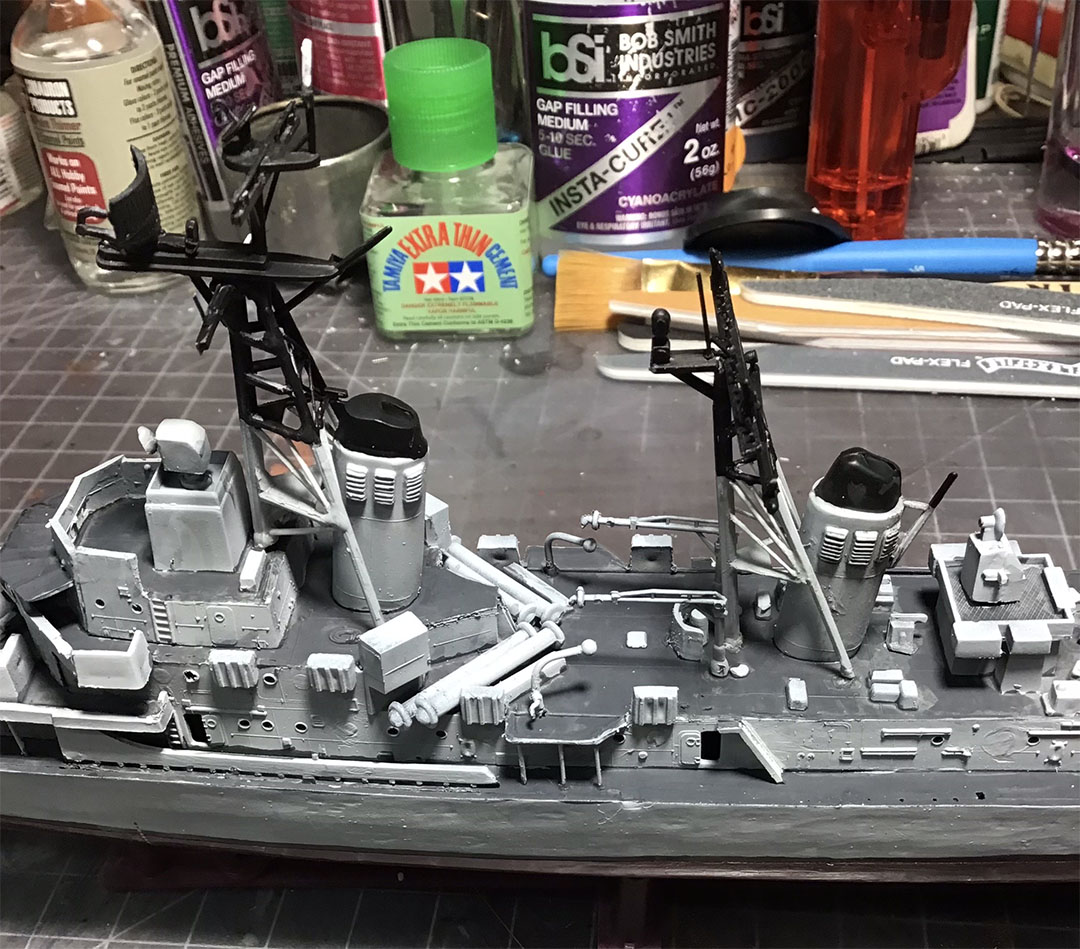

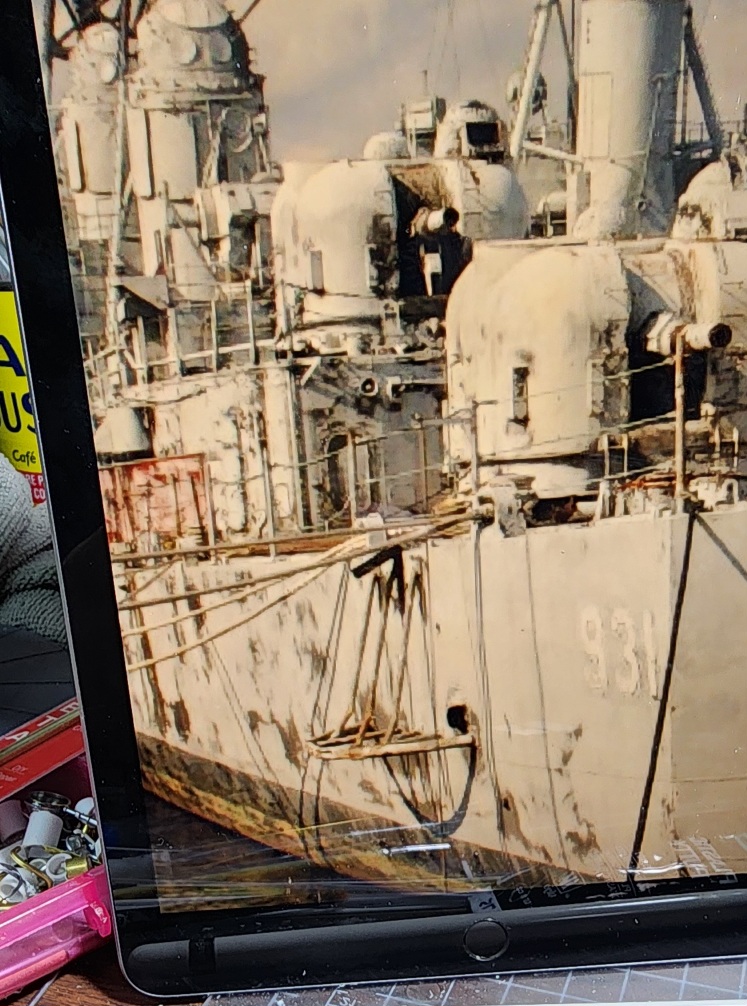

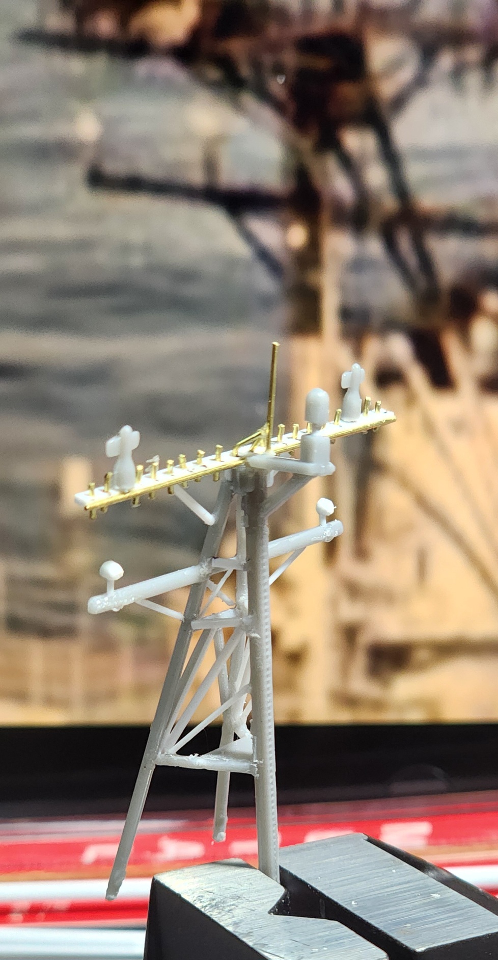

Rear mast is redone. The image is somewhat grainy but I think it may be close enough to show what was there. It's not like someone can go to the ship and compare since it doesn't exist anymore.
Time to let all that dry and work on the ship body.
@Rhino you crack me up!

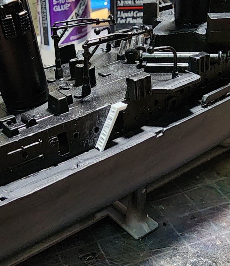

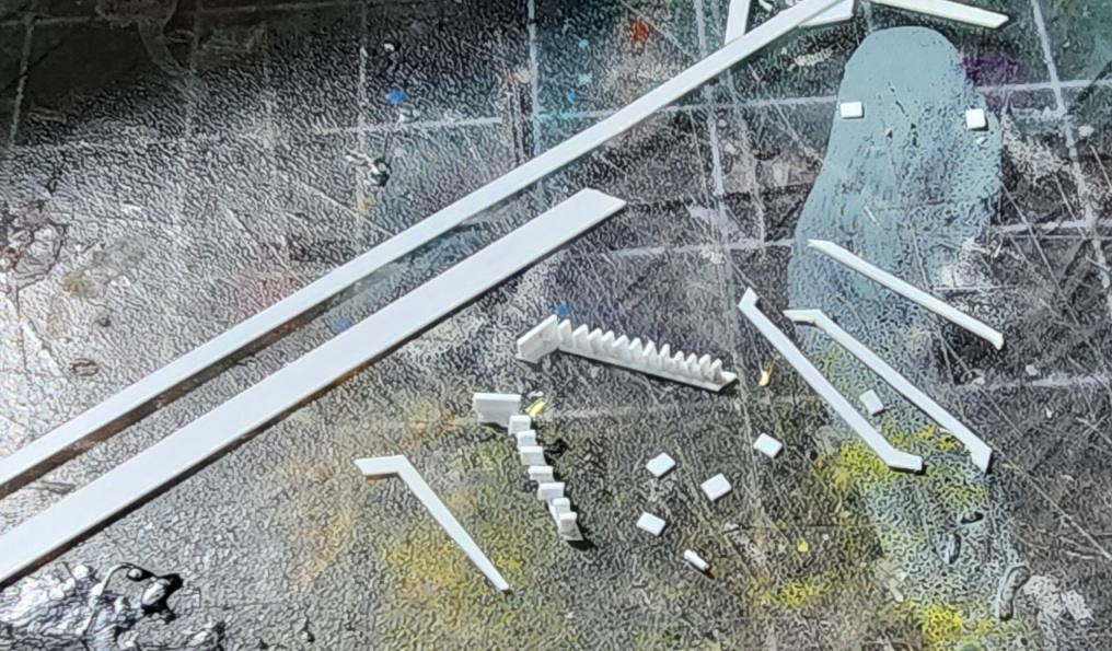

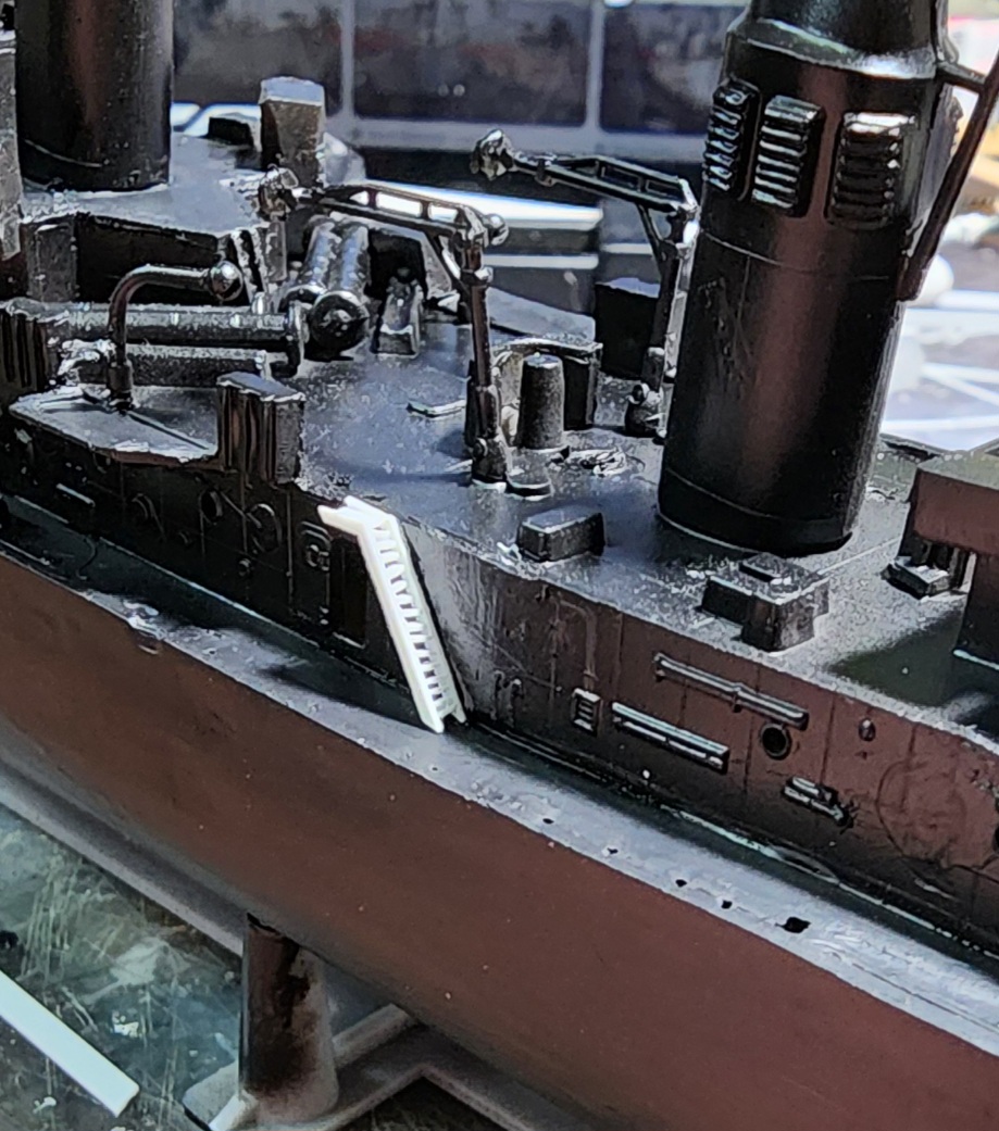

So, I scratchbuilt some ladders. Not as easy as it looks! The sides are .015"x.125" styrene cut in a 1mm wide "7ish" shape. The treads are .010"x.060 styrene cut in 1mm length. I think one side has 15 treads and the other has 16. That is probably a huge hit, but these are the 4th pair I have made to finally be happyish with them. Testors liquid cement glued the stairs together and superglue glued them to the ship.
Here are some leftover pieces that didn't make the cut so you get a sense of the size. The strips are what I used to make the ladders. The wide strips made the sides and the narrow made the treads:
Here are the ones that did:

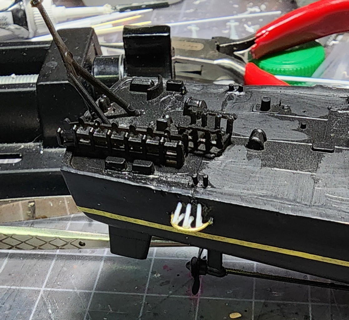

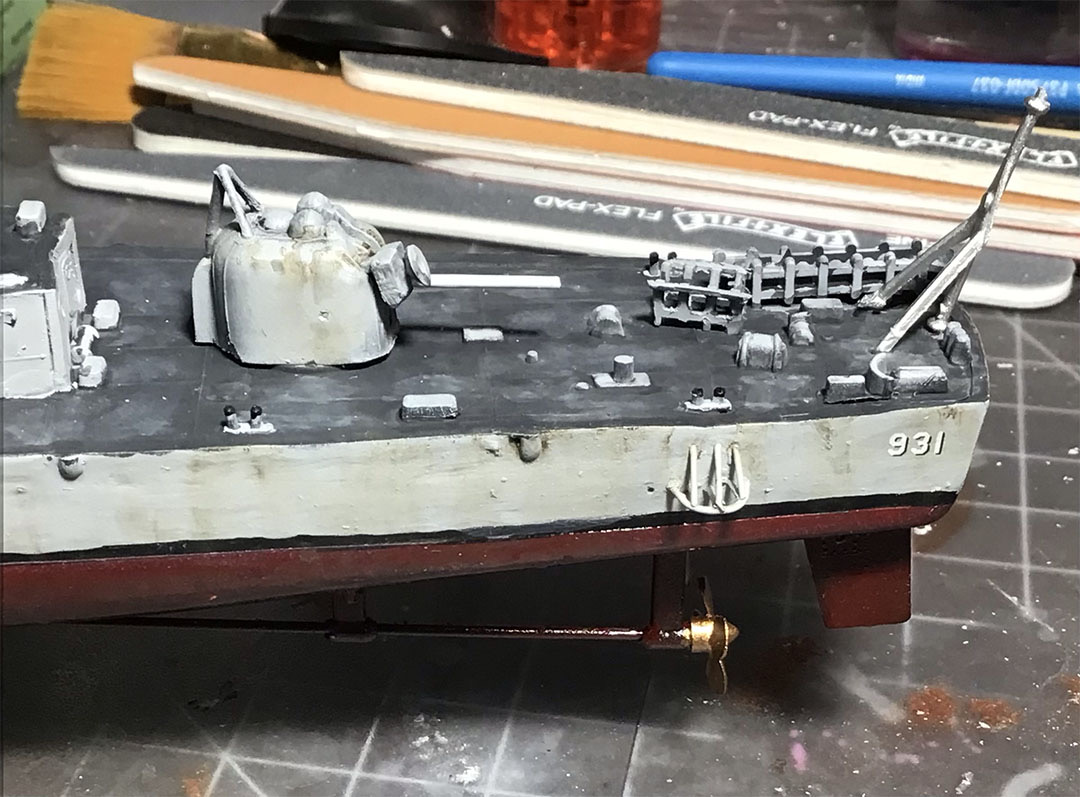

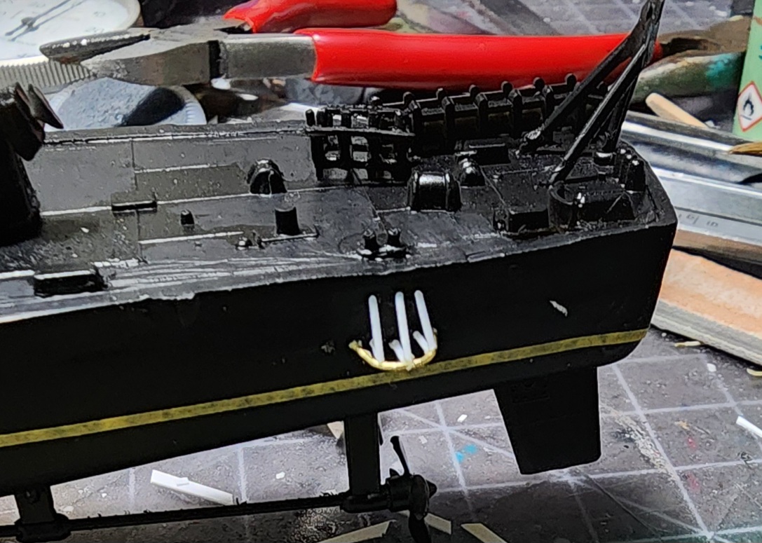

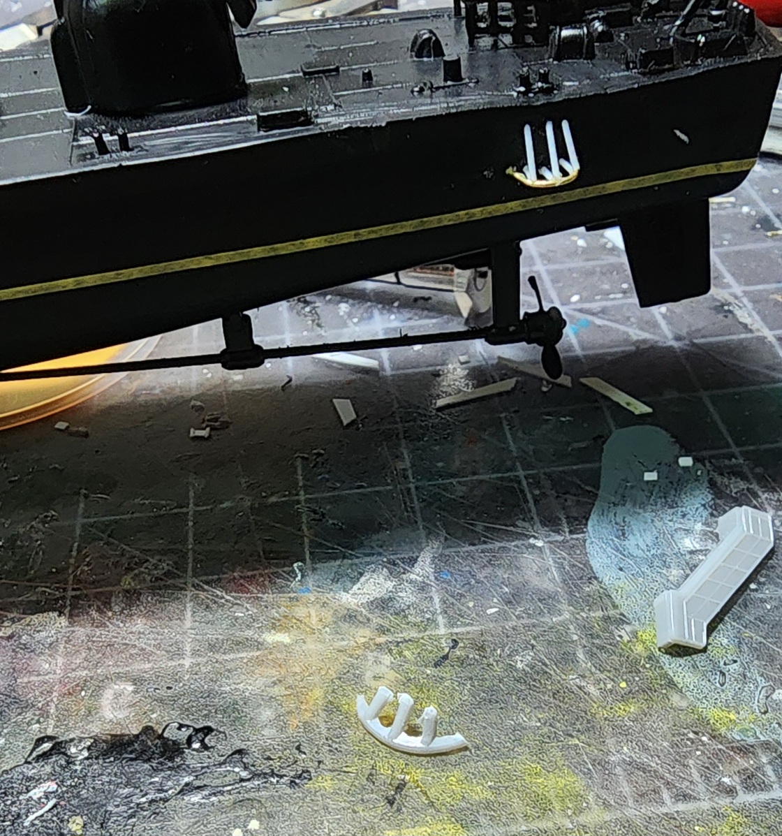

The kit propellar guards were horrible. I made new ones with .5mm brass rod and .5mm styrene rod. 1st, the reference:
Then, the kit part vs what I made:

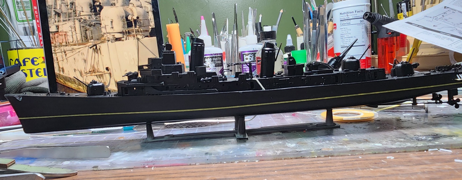

Maybe better, maybe not, but it's done. Also, I have taped off using 1mm Tamiya tape where the black line will be. It should be .8mm to be in scale, but 1mm is going to do. Can my ship pro's tell me if I have it near the waterline? The instructions don't specify and the images I have look similar to where I put it.
Thanks fellers!

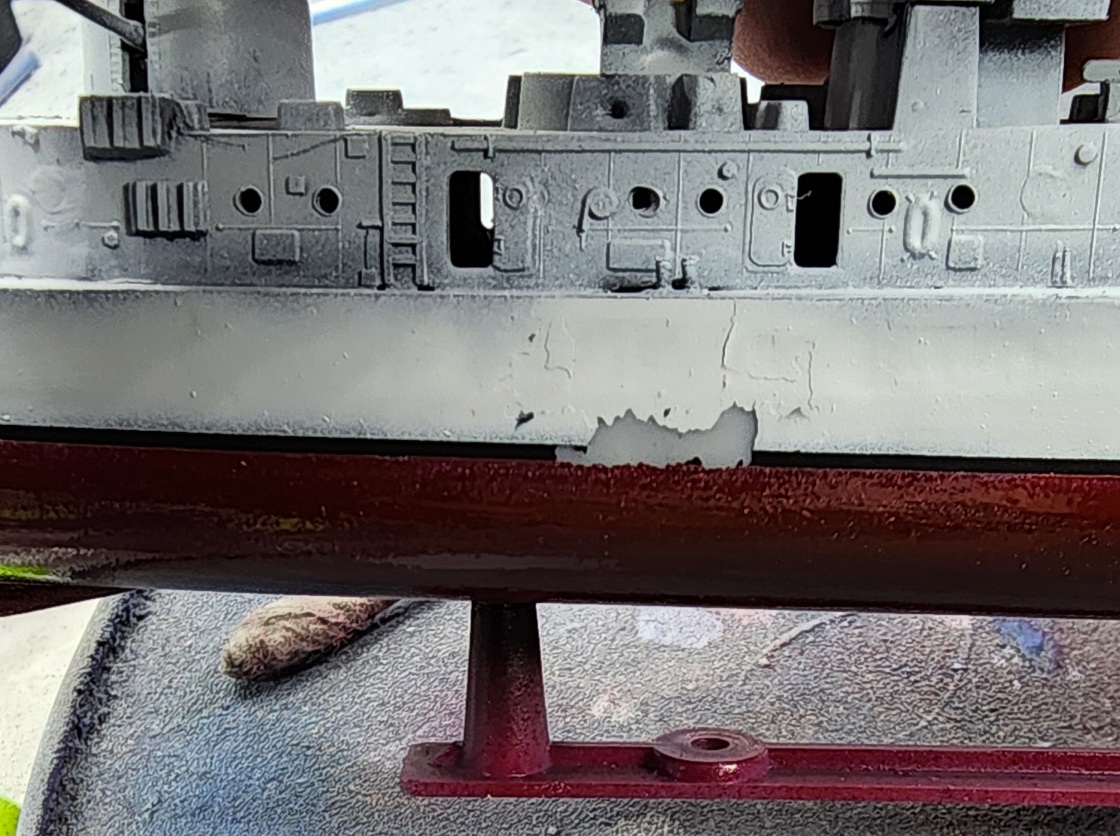

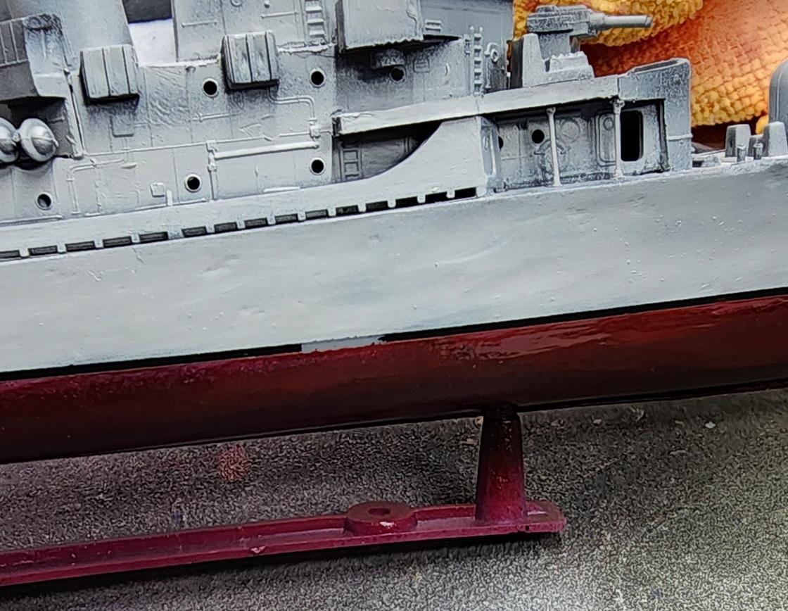

Well dagnabbit!!
I KNOW it was sanded enough so that shouldn't have happened. I used Alclad II BLack microfiller and Tamiya tape. Damn.
:lol:Floquil Reefer Gray is my preferred primer. :lol: 3 drops at a time! :lol:
