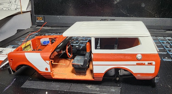

I am trying to make a dual exhaust for the scout. I squished a piece of 21mm long ¹/4" alum pipe but didn't like the resulting shape so I was going to "skin" over it. I don't have anything thin enough except in brass so I used that. I used a file to scuff where the joint will be for mechanical adhesion.

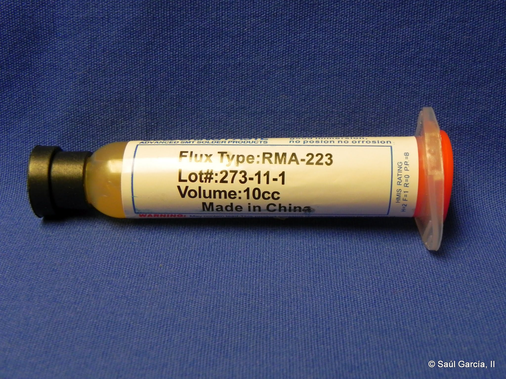

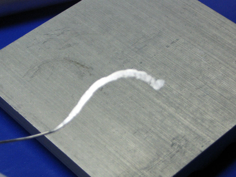

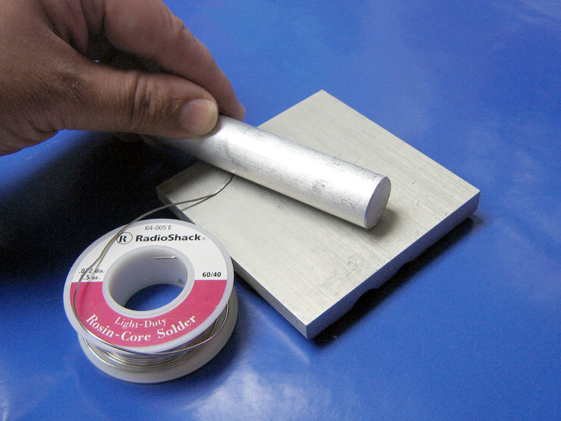

Sometimes I use solder paste but it is expensive and has a short shelf life:

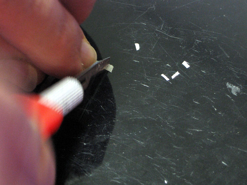

Most of the time, I do as others have suggested, flatten solder wire and cut thin strips as needed.
I worked in electronics for over 20 years as a draftsman/tech. The last 10 years were doing PC board layouts, Making film, etching prototype boards, and then placing the electronic components into the boards. Lots of soldering experience.

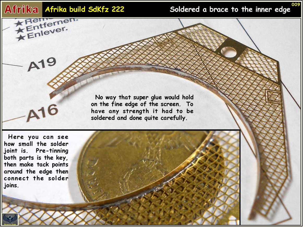

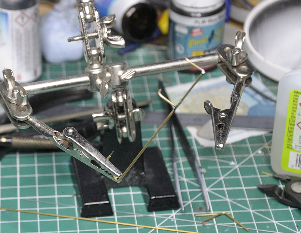

What I use is Kester soldering paste. I place a tiny little bit on the area I am going to solder, "LIGHTLY" pre-tin the areas on the parts to be soldered, and then place the parts together and start tacking the joint together (when it is sheet metal.) Once it is tacked together I then run the soldering iron (with a little wet solder drop on it) along the rest of the joint to finish joining it fully along the length.

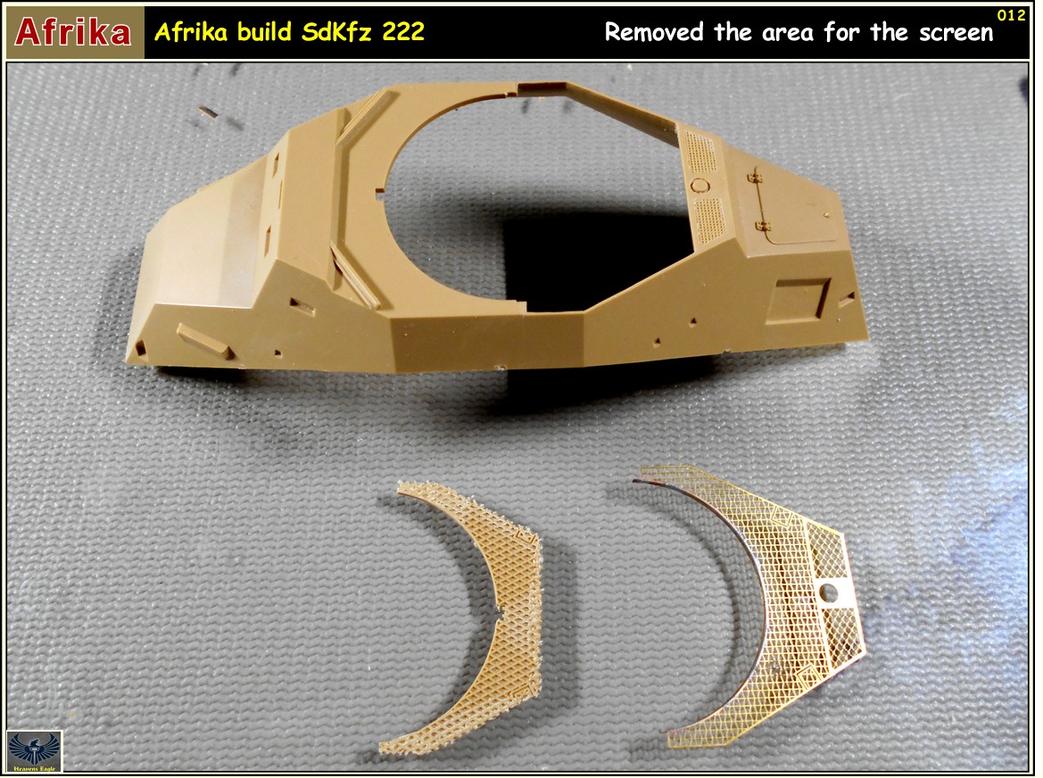

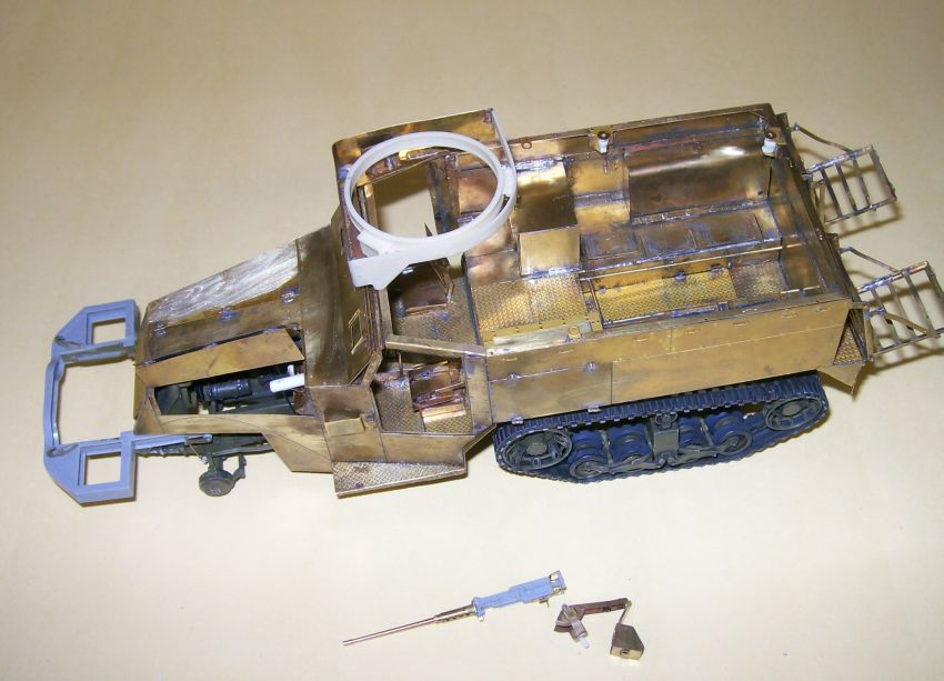

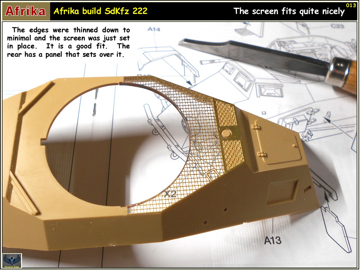

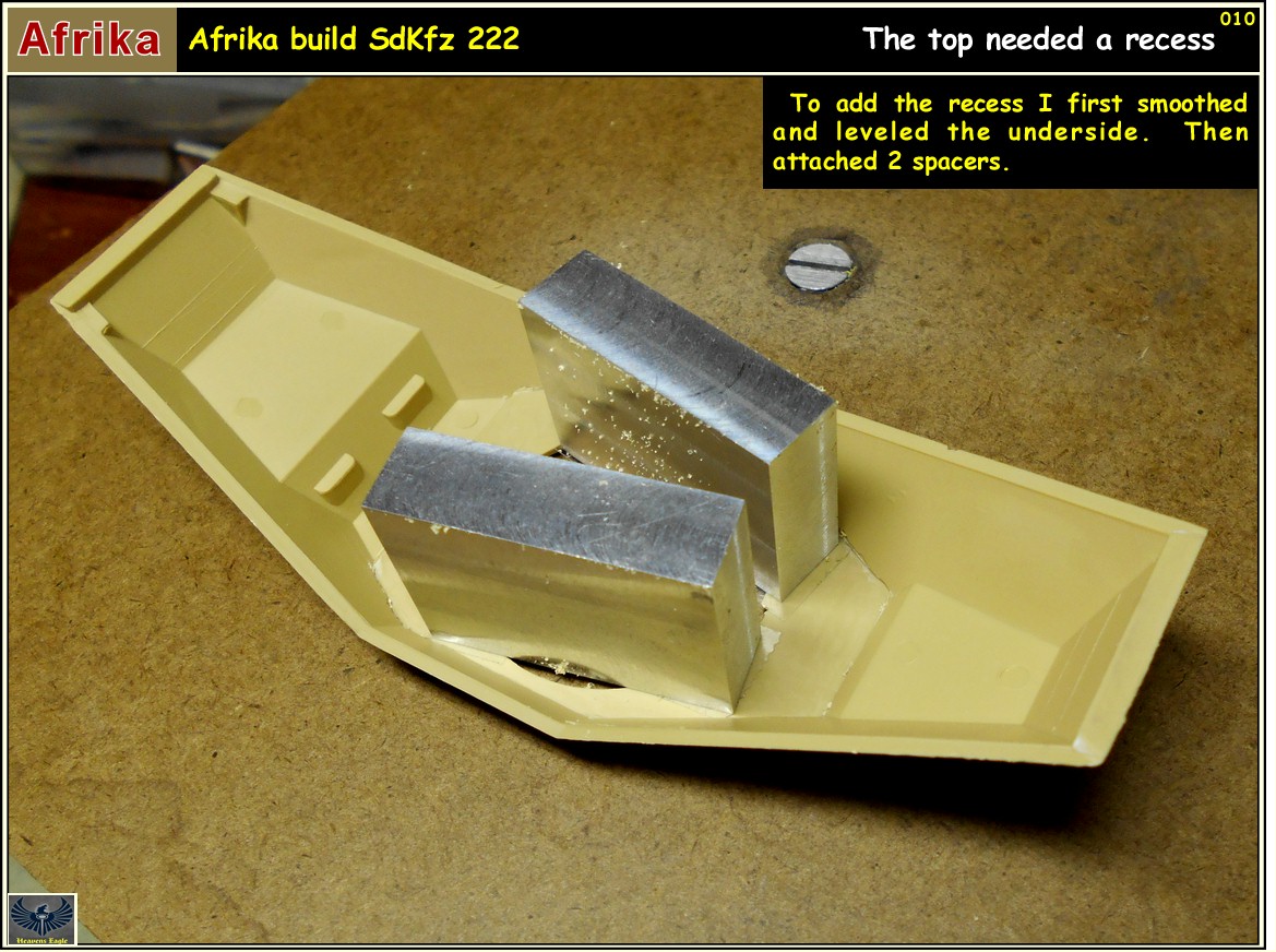

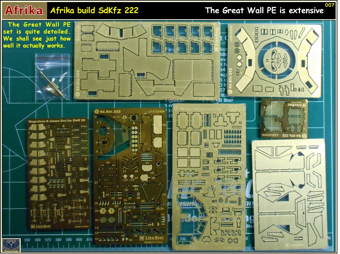

Here is a small section from a build that I have part way done. You might find it interesting.
The PE for this build had a lot of sheet metal to replace fenders, turret, and other items.
This is in my "finish the started builds" pile and will be along sometime after I finish the Ju87A rebuilder. If anyone has any questions, feel free to send a PM or give me a call.

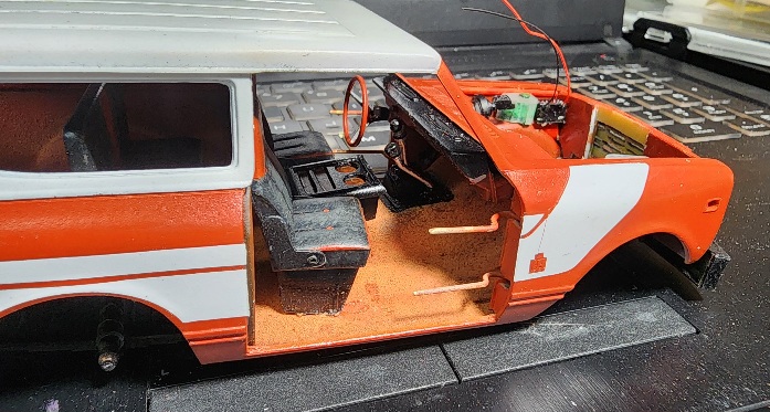

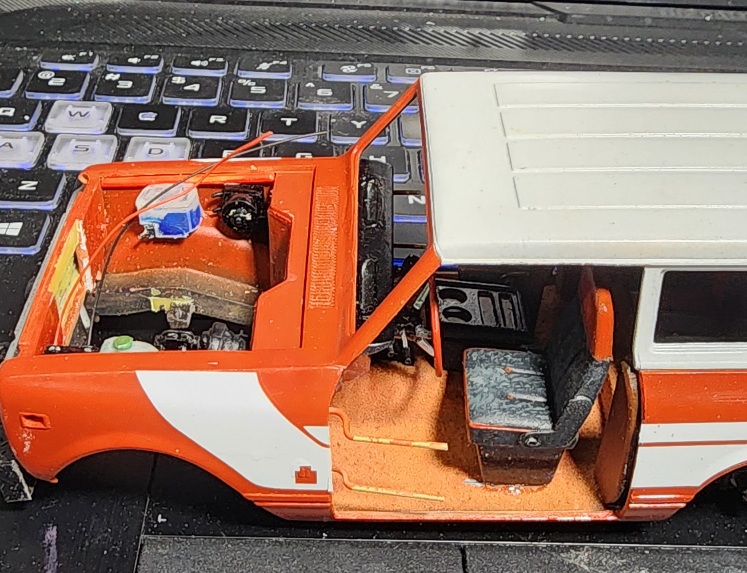

I have worked on the Scout as I feel up to it. As with most of my models, as well as my chess game, my opening and mid-game moves are pretty strong, then things deteriorate toward the end-game. I do have the model painted and the decal, as difficult as it was, is in place. I was afraid I was going to have to mask and paint the graphics!:

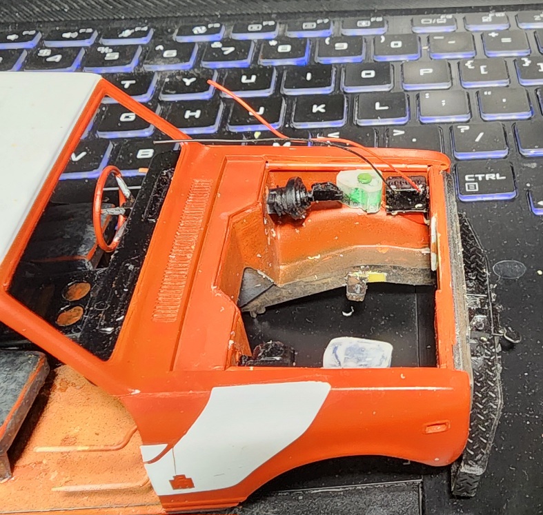

Due to the way I am building and accessorizing I found that I had to put the body onto the chassis before I would have liked to. All of this scratch building and kit changing is not fluid for me yet. So, I will have to add the windshield and other glass after final painting and weathering, which I hope I can do. Fortunately, they are all flat with no curves or fiddly parts to deal with. I had the radiator in place but found that the engine would not go in due to the thickness, despite measuring. I never saw a way to test fit anything really. So, I removed the radiator, took it apart and thinned the main body about .5mm, then trimmed the grill placement area another .5mm. I also moved the engine mount back about 4mm. Test fitting looked promising. I will need to shorted the drive shaft by 4mm:

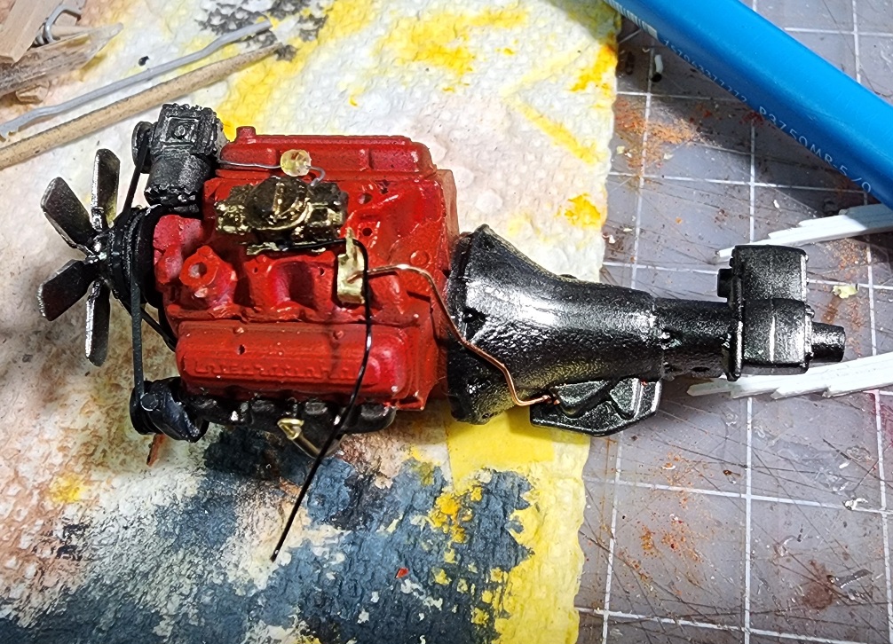

The engine has gone better than expected with all of the additions. I still have not worked out the steering box and shaft. I hope it can still be done. I finally gave up after 2 days trying to make spark plug boots and cheated, buying some 3D printed ones which came in today. I will install the wires before installing the engine, then see what I need to do with the radiator.
