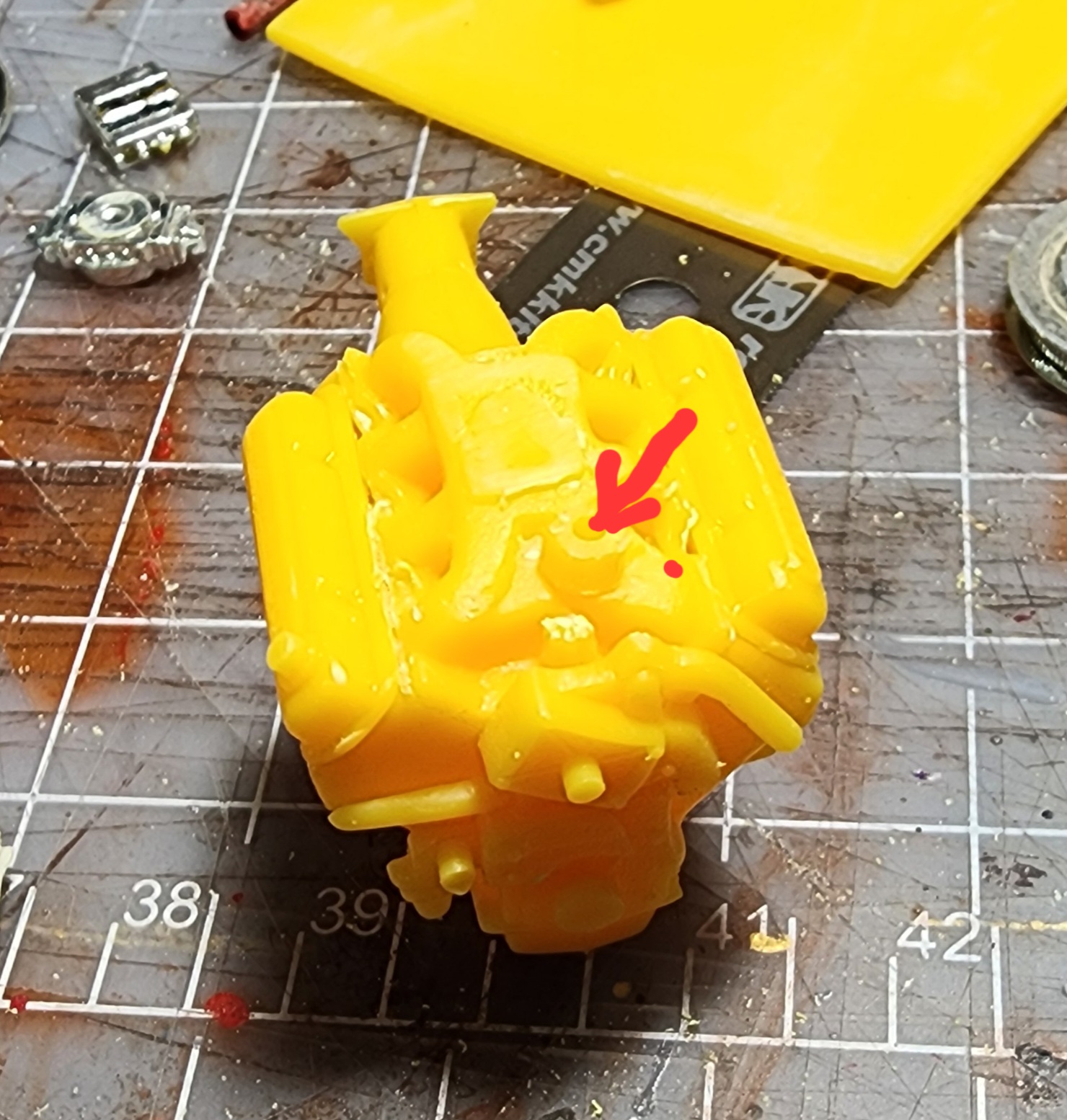

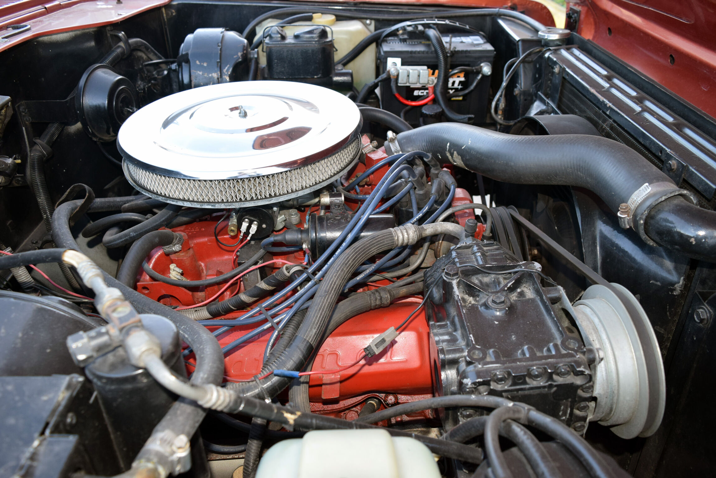

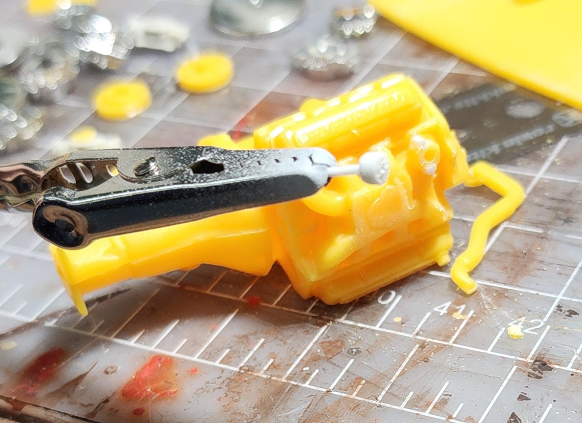

So, with that engine photo as reference I am making changes to the engine.

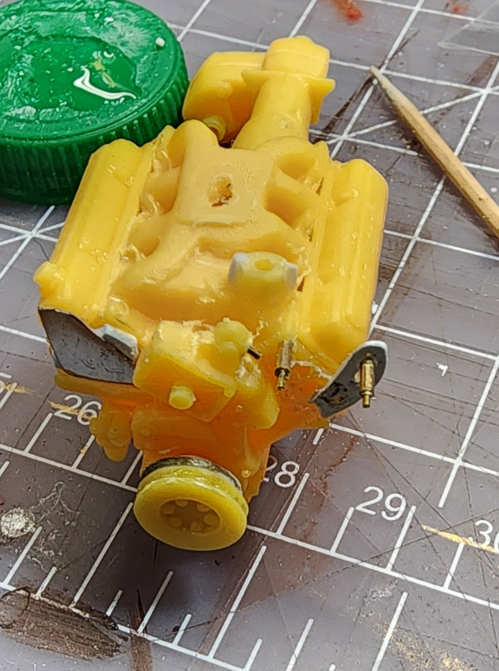

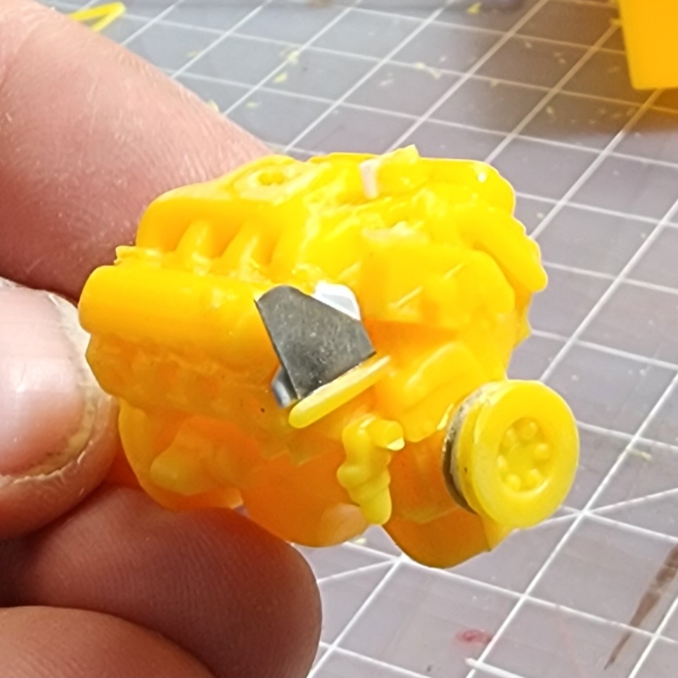

Moving the cooling hose mount over:
And changinging the shape to match the hose mount:
I made a new distributor:
And will wire it later.
I cut the belt off of the pully assembly and with use electricians tape for the new belt. The engine photo has a difficult looking alternator so I simplified it and the mounting plate just a little:

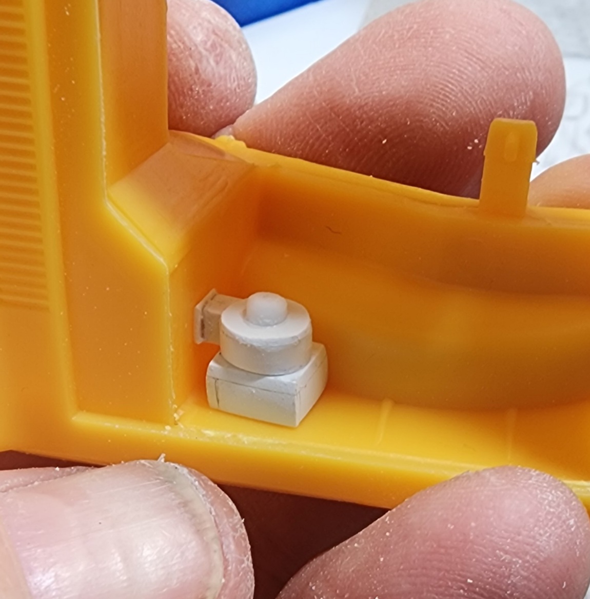

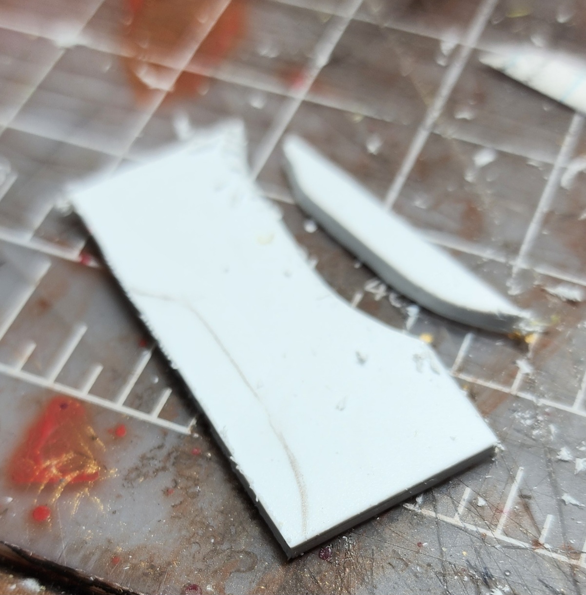

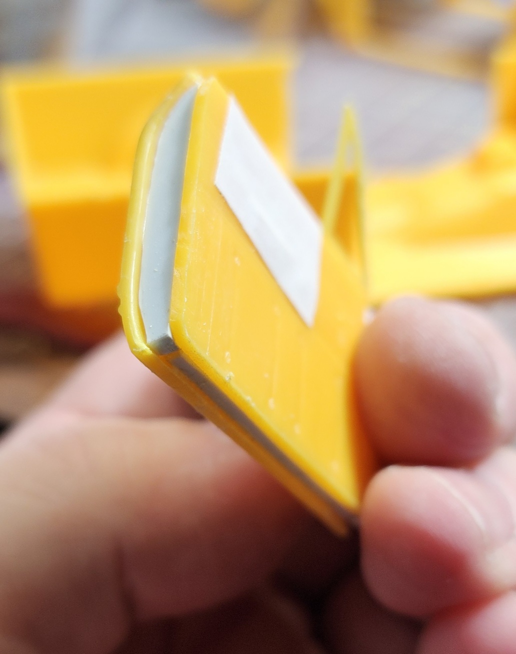

FYI, I am opening the doors on this. I thought about the tailgate but am afraid I don't know how to do that one. Right now I am filling in the voids between the door skin and the interior panel. I made a little paper jig to fit, then cut syrene using it as a guide. I will need to watch the YT video again to refresh my memory on hinging.

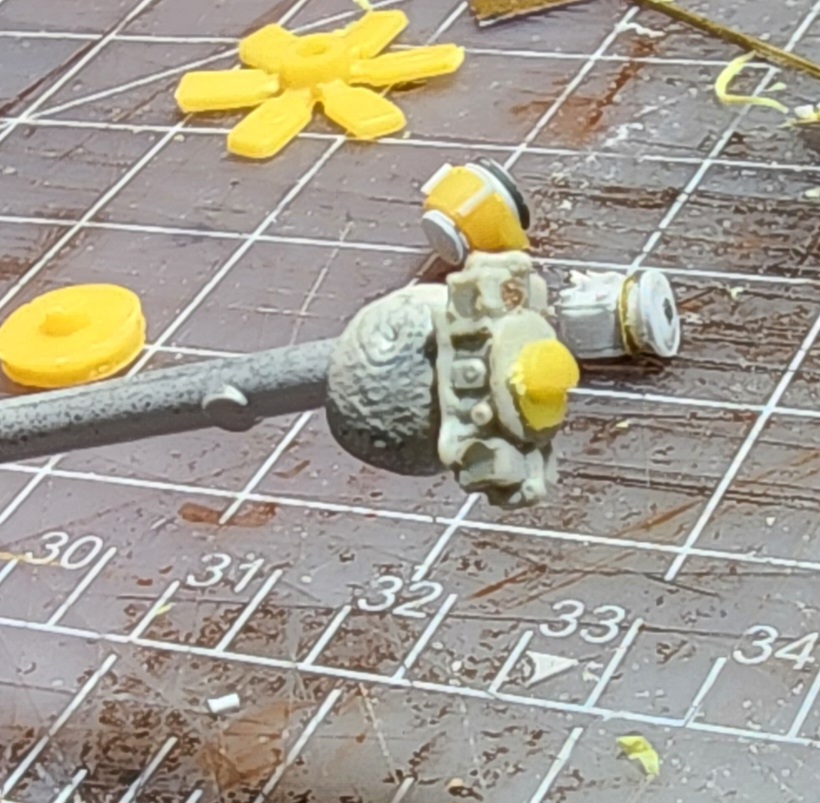

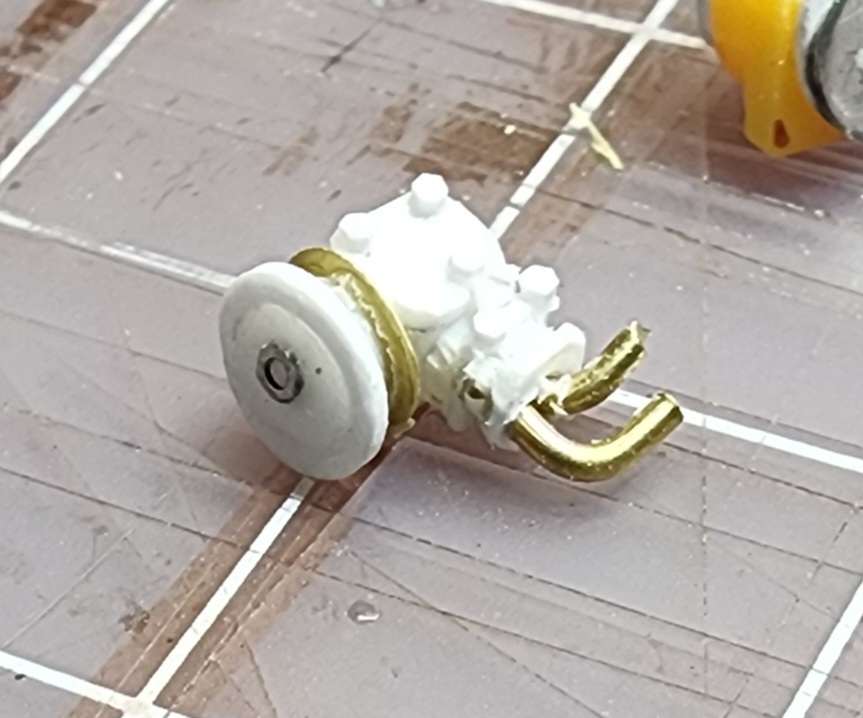

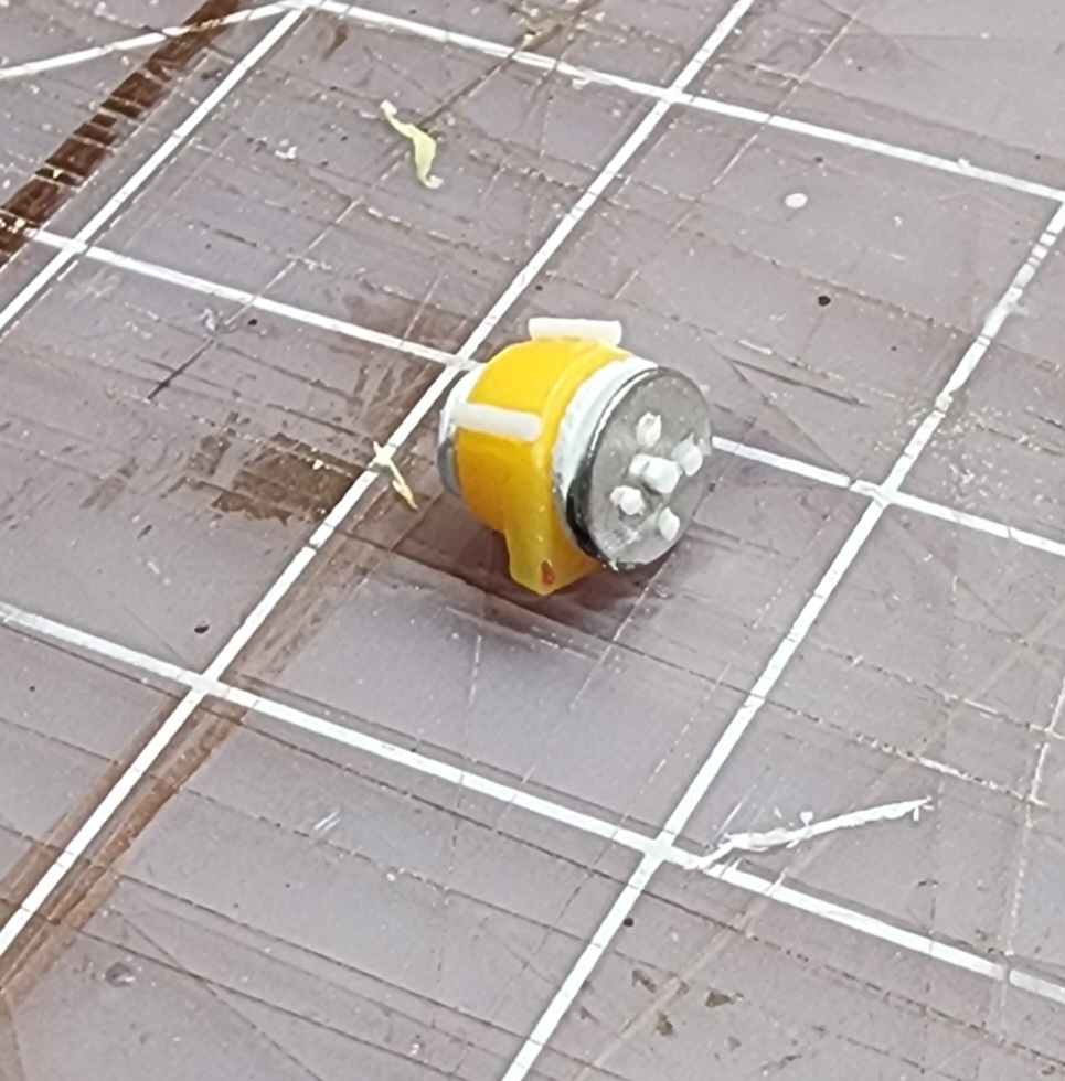

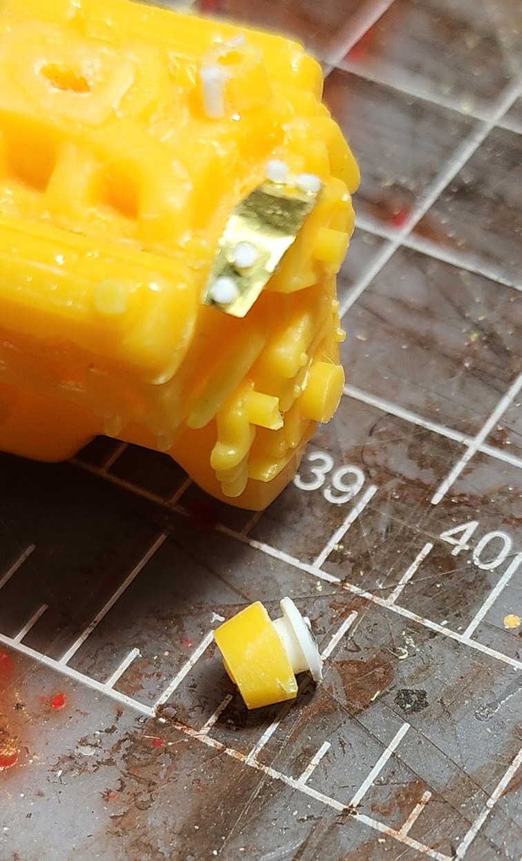

Turns out what I thought was the alternator (because that's where it was on the pulley assy) is actually the A/C. So...I made the AC pump.
The alternator is on the other side of the engine. So I made a new design for that...

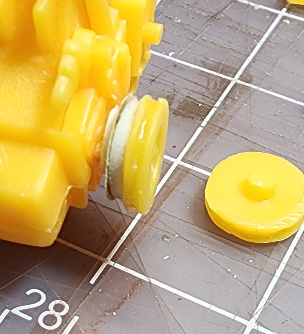

I will make a double pulley for the other two pulleys
More to come. Gonna try to make the brake booster now.
I have doubled the lower pulley. I still need to do the upper one you see laying on the table...
I made a spacer and new mounting bracket for the A/C to align with the outer pulley...

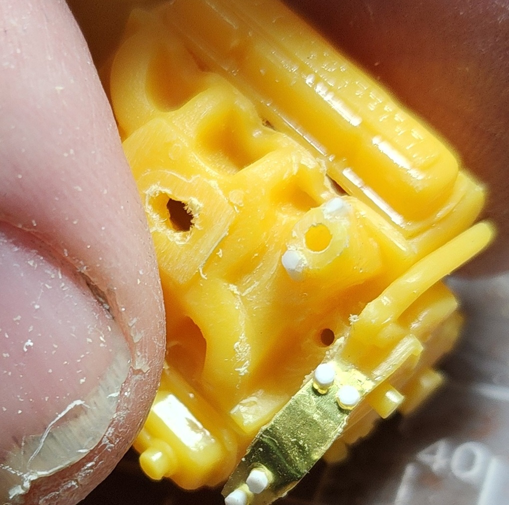

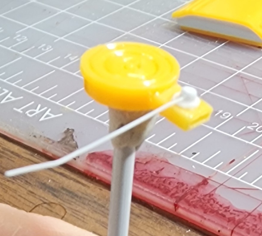

Lastly, I made a vaccuum hose cap for the breather and the hose will connect to the carb (which wasn't on the engine, it just had a square blob for the breather to sit upon)...
I have a selection of carburators and selected this one which was the same height as the blob. I cut the alignment tab off of the blob and glued to the new carb. I will drill a hole for the vaccuum hose...
